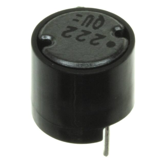

    插件-3,D16xL22mm
    FIXED IND 150UH 2.4A 77 MOHM TH
ELC-15E151 数据手册
Choke Coils ■ Examples Type 10E111L Part No. [Dimensions in mm] (not to scale) 2Ð f 0.7 5.0±1.0 13.0 max. f 10.0 max. 5.0±0.5 Recommended PWB piercing plan 2Ð f1.20±0.05 5.0±0.1 Connection Schematic S F Inductance (µH) Tolerance (%) Test Freq. (kHz) RDC.(W) [at 20ûC] (Tol.±20 %) *IDC. [at 20ûC] (A)max. ELC10E3R9L 3.9 0.024 2.90 ELC10E4R7L 4.7 0.027 2.80 ELC10E5R6L 5.6 0.030 2.70 ELC10E6R8L 6.8 0.032 2.60 ELC10E8R2L 8.2 0.035 2.50 ELC10E100L 10.0 ±20 0.038 2.40 ELC10E120L 12.0 0.040 2.30 ELC10E150L 15.0 0.046 2.20 ELC10E180L 18.0 0.049 2.10 ELC10E220L 22.0 0.056 2.00 ELC10E270L 27.0 0.062 1.90 ELC10E330L 33.0 0.068 1.80 ELC10E390L 39.0 0.074 1.70 ELC10E470L 47.0 0.098 1.50 ELC10E560L 56.0 0.120 1.30 ELC10E680L 68.0 0.150 1.20 ELC10E820L 82.0 0.190 1.00 ELC10E101L 100.0 0.210 0.96 ELC10E121L 120.0 0.240 0.92 ELC10E151L 150.0 0.260 0.83 ELC10E181L 180.0 0.290 0.74 ELC10E221L 220.0 0.410 0.64 ELC10E271L 270.0 0.590 0.54 ELC10E331L 330.0 0.660 0.52 ELC10E391L 390.0 0.720 0.50 ELC10E471L 470.0 0.800 0.45 ELC10E561L 560.0 1.100 0.41 ELC10E681L 680.0 1.200 0.37 ±15 10 ±10 ELC10E821L 820.0 1.600 0.33 ELC10E102L 1000.0 1.800 0.31 ELC10E122L 1200.0 2.000 0.29 ELC10E152L 1500.0 2.800 0.26 ELC10E182L 1800.0 3.200 0.23 ELC10E222L 2200.0 3.600 0.20 ELC10E272L 2700.0 5.200 0.18 ELC10E332L 3300.0 5.900 0.17 ELC10E392L 3900.0 6.500 0.16 ELC10E472L 4700.0 9.600 0.14 ELC10E562L 5600.0 10.800 0.12 ELC10E682L 6800.0 11.900 0.11 ELC10E822L 8200.0 13.200 0.10 *Allowable DC Current:Smaller current value either when the inductance is -10 % or when the temperature has risen 45 degrees Celsius Design, Specifications are subject to change without notice. Ask factory for technical specifications before purchase and/or use. Whenever a doubt about safety arises from this product, please inform us immediately for technical consultation without fail. Choke Coils ■ Examples Type 12E111L Part No. ELC12E4R7L [Dimensions in mm] (not to scale) 3.5±1.0 18.5max. f13.0 max. f0.7 7.0±0.5 Recommended PWB piercing plan 2Ðf 1.20±0.05 7.5±0.1 Connection Schematic S F Inductance (µH) Tolerance (%) Test Freq. (kHz) 4.7 ELC12E5R6L 5.6 ELC12E6R8L 6.8 ±25 RDC.(W) [at 20ûC] (Tol.±20 %) *IDC. [at 20ûC] (A)max. 0.014 4.40 0.016 4.10 0.018 3.90 ELC12E8R2L 8.2 0.020 3.70 ELC12E100L 10.0 0.023 3.50 ELC12E120L 12.0 0.024 3.30 ELC12E150L 15.0 0.028 3.20 ELC12E180L 18.0 0.030 3.10 ELC12E220L 22.0 0.033 2.80 ELC12E270L 27.0 0.037 2.50 ELC12E330L 33.0 0.041 2.40 ELC12E390L 39.0 0.044 2.20 ELC12E470L 47.0 0.048 2.00 ELC12E560L 56.0 0.053 1.80 ELC12E680L 68.0 0.073 1.70 ELC12E820L 82.0 0.098 1.40 ELC12E101L 100.0 0.140 1.30 ELC12E121L 120.0 0.160 1.20 ELC12E151L 150.0 0.180 1.10 ELC12E181L 180.0 0.200 1.00 ELC12E221L 220.0 0.220 0.91 ELC12E271L 270.0 0.320 0.83 ELC12E331L 330.0 0.360 0.79 ±20 10 ELC12E391L 390.0 0.400 0.70 ELC12E471L 470.0 ±10 0.440 0.64 ELC12E561L 560.0 0.490 0.57 ELC12E681L 680.0 0.610 0.52 ELC12E821L 820.0 0.760 0.47 ELC12E102L 1000.0 1.100 0.43 ELC12E122L 1200.0 1.200 0.40 ELC12E152L 1500.0 1.400 0.36 ELC12E182L 1800.0 1.900 0.32 ELC12E222L 2200.0 2.500 0.30 ELC12E272L 2700.0 3.500 0.26 ELC12E332L 3300.0 3.900 0.24 ELC12E392L 3900.0 4.300 0.22 ELC12E472L 4700.0 6.000 0.20 ELC12E562L 5600.0 6.600 0.17 ELC12E682L 6800.0 9.900 0.15 ELC12E822L 8200.0 10.900 0.14 ELC12E103L 10000.0 12.200 0.13 *Allowable DC Current:Smaller current value either when the inductance is -10 % or when the temperature has risen 45 degrees Celsius Rev.02/04 Design, Specifications are subject to change without notice. Ask factory for technical specifications before purchase and/or use. Whenever a doubt about safety arises from this product, please inform us immediately for technical consultation without fail. Choke Coils ■ Examples Type 15E111 [Dimensions in mm] (not to scale) 22.0 max. 4.5±1.0 f 16.0 max. f10.0±0.2 3Ðf 0.7 Recommended PWB piercing plan 3Ðf 1.2±0.1 f 10.0±0.1 RDC.(W) [at 20ûC] (Tol.±20 %) *IDC. [at 20ûC] (A)max. 0.018 5.40 0.024 4.50 33 0.032 4.00 ELC15E560 56 0.039 3.60 ELC15E101 100 0.053 3.00 ELC15E181 180 0.100 2.30 ELC15E331 330 0.170 1.60 Part No. Inductance (µH) ELC15E100 10 ELC15E180 18 ELC15E330 Tolerance (%) Test Freq. (kHz) ±20 10 ELC15E561 560 0.280 1.20 ELC15E102 1000 ±10 0.490 0.95 ELC15E182 1800 0.870 0.75 ELC15E332 3300 1.600 0.53 ELC15E562 5600 2.600 0.39 ELC15E103 10000 4.600 0.30 *Allowable DC Current:Smaller current value either when the inductance is -10 % or when the temperature has risen 45 degrees Celsius ■ Examples Type 18E111 11.3±0.5 8.3±0.5 4Ðf 0.8 3.5±1.0 25.0 max. [Dimensions in mm] (not to scale) f 19.0 max. Recommended PWB piercing plan 8.3±0.1 4Ðf 1.2±0.1 11.3±0.1 (Top View) Part No. Inductance (µH) ELC18E100 10 Tolerance (%) Test Freq. (kHz) ±20 RDC.(W) [at 20ûC] (Tol.±20 %) *IDC. [at 20ûC] (A)max. 0.014 5.90 ELC18E180 18 0.019 5.20 ELC18E330 33 0.026 4.60 ELC18E560 56 0.031 3.80 ELC18E101 100 0.044 3.00 ELC18E181 180 0.067 2.50 ELC18E331 330 0.110 1.90 10 ELC18E561 560 0.170 1.40 ELC18E102 1000 ±10 0.280 1.00 ELC18E182 1800 0.570 0.80 ELC18E332 3300 1.000 0.60 ELC18E562 5600 1.600 0.46 ELC18E103 10000 2.700 0.33 *Allowable DC Current:Smaller current value either when the inductance is -10 % or when the temperature has risen 45 degrees Celsius Design, Specifications are subject to change without notice. Ask factory for technical specifications before purchase and/or use. Whenever a doubt about safety arises from this product, please inform us immediately for technical consultation without fail.
