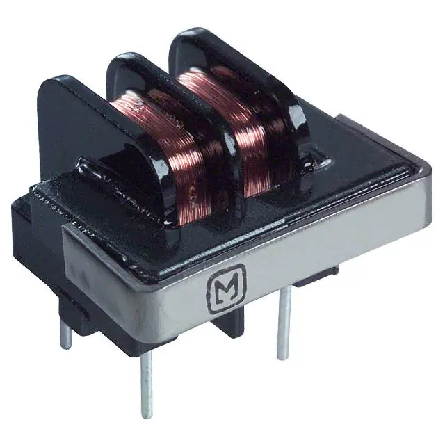

Line Filters ■ Series M ● Type 11M ● Type 14M Dimensions in mm (not to scale) Marking 10.5±0.5 16.0±1.0 4-f0.6±0.1 4.0±1.0 8.0±0.5 12.0±0.5 8.0±0.5 12.0±0.5 7.0±0.5 Recommended PWB piercing plan 4-f1.0±0.1 7.0±0.5 Recommended PWB piercing plan 4 1 4-f1.0±0.1 4 7.00±0.05 8.00±0.05 2 4-f0.6±0.1 10.5±0.5 7.00±0.05 1 14.5±1.0 11.5±0.5 16.0±1.0 Marking 4.0±1.0 16.0±1.0 Dimensions in mm (not to scale) 2 3 ● Standard Parts (Vertical type) 8.00±0.05 3 ● Standard Parts (Horizontal type) Part No. Marking Inductance (mH)min. ELF11M010E ELF11M020E ELF11M030E ELF11M040E ELF11M050E ELF11M060E ELF11M070E ELF11M080E ELF11M090E ELF11M100E 010E 020E 030E 040E 050E 060E 070E 080E 090E 100E 30.0 12.0 6.0 3.5 2.5 1.5 1.0 0.8 0.7 0.5 ✽ R DC (액) [at 20 °C] (Tol ±20 %) 9.70 4.30 2.30 1.35 0.93 0.58 0.36 0.33 0.28 0.25 Current (A rms) max. 0.1 0.2 0.3 0.4 0.5 0.6 0.7 0.8 0.9 1.0 Part No. Marking Inductance (mH)min. ELF14M010E ELF14M020E ELF14M030E ELF14M040E ELF14M050E ELF14M060E ELF14M070E ELF14M080E ELF14M090E ELF14M100E 010E 020E 030E 040E 050E 060E 070E 080E 090E 100E 30.0 12.0 6.0 3.5 2.5 1.5 1.0 0.8 0.7 0.5 ✽ R DC (액) [at 20 °C] (Tol ±20 %) 9.70 4.30 2.30 1.35 0.93 0.58 0.36 0.33 0.28 0.25 Current (A rms) max. 0.1 0.2 0.3 0.4 0.5 0.6 0.7 0.8 0.9 1.0 ✽ DC Resistance ● Type 16M Dimensions in mm (not to scale) Recommended PWB piercing plan Marking 4-f1.2±0.1 10.0±0.5 18.0±1.0 15.0±1.0 2 4.0±1.0 13.0±0.5 4 10.00±0.05 20.0 –1.0 +0.5 1 13.00±0.05 4-f0.7±0.1 3 ● Standard Parts Part No. Marking Inductance (mH)min. ELF16M020A ELF16M030A ELF16M040A ELF16M050A ELF16M060A ELF16M070A 020A 030A 040A 050A 060A 070A 28.0 20.0 15.0 8.0 7.0 5.0 ✽ R DC (액) [at 20 °C] (Tol ±20 %) 3.650 2.700 1.800 0.980 0.800 0.550 Current (A rms) max. 0.2 0.3 0.4 0.5 0.6 0.7 Part No. Marking Inductance (mH)min. ELF16M080A ELF16M100A ELF16M130A ELF16M150A ELF16M170A ELF16M200A 080A 100A 130A 150A 170A 200A 3.5 2.0 1.0 0.8 0.6 0.5 ✽ R DC (액) [at 20 °C] (Tol ±20 %) 0.400 0.270 0.160 0.110 0.078 0.070 Current (A rms) max. 0.8 1.0 1.3 1.5 1.7 2.0 ✽ DC Resistance Design and specifications are each subject to change without notice. Ask factory for the current technical specifications before purchase and/or use. Should a safety concern arise regarding this product, please be sure to contact us immediately. Apr. 2011
