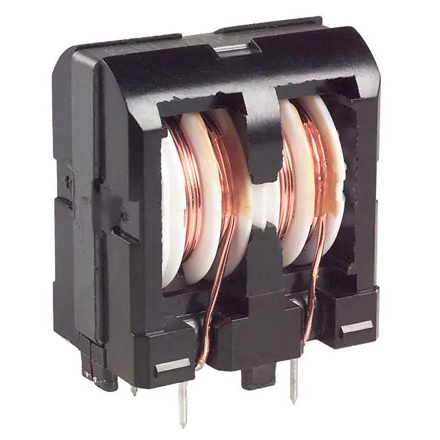

    COMMON MODE CHOKE 2A 2 LN T/H
ELF-18D656K 数据手册
Line Filters ■ Series V ● Type 290 Dimensions in mm (not to scale) Recommended PWB piercing plan Marking 4-f1.2±0.1 21.5±1.0 2 21.0±1.0 16.0±1.0 3 13.00±0.05 10.0±0.5 4.0±1.0 13.0±0.5 10.00±0.05 4 1 4-f0.8±0.1 Examples Part No. Marking ELF18D290H ELF18D290C ELF18D290A ELF18D290G ELF18D290L ELF18D290P ELF18D290M ✽DCR(W) Inductance [at 20 ¡C] (mH)min. (Tol ±20 %) 290H 290C 290A 290G 290L 290P 290M 33.00 22.00 18.00 10.00 8.20 6.80 5.60 2.691 1.707 1.271 0.782 0.681 0.571 0.504 Current (A rms) max. Part No. 0.3 0.4 0.5 0.6 0.6 0.7 0.8 ELF18D290R ELF18D290S ELF18D290E ELF18D290T ELF18D290V ELF18D290D ELF18D290B Marking 290R 290S 290E 290T 290V 290D 290B ✽DCR(W) Inductance [at 20 ¡C] (mH)min. (Tol.±20 %) 3.90 3.30 2.70 2.20 1.80 1.20 0.82 0.305 0.277 0.248 0.186 0.162 0.119 0.072 Current (A rms) max. 1.0 1.1 1.1 1.3 1.5 1.6 2.0 ✽ DC Resistance ● Type 450 Dimensions in mm (not to scale) Recommended PWB piercing plan Marking 4-f1.2±0.1 28.8±1.0 2 3 10.00±0.05 4 1 13.0±0.5 25.0±1.0 4.0±1.0 13.00±0.05 10.0±0.5 18.0±1.0 4-f0.8±0.1 Examples Part No. ELF18D450Q ELF18D450H ELF18D450B ELF18D450J ELF18D450G ELF18D450L Marking ELF450Q ELF450H ELF450B ELF450J ELF450G ELF450L ✽DCR(W) Inductance [at 20 ¡C] (mH)min. (Tol ±20 %) 56.0 39.0 18.0 10.0 8.2 6.8 1.795 1.332 0.655 0.384 0.274 0.253 Current (A rms) max. 0.4 0.5 0.8 1.0 1.1 1.2 Part No. ELF18D450D ELF18D450K ELF18D450A ELF18D450C ELF18D450M Marking ELF450D ELF450K ELF450A ELF450C ELF450M ✽DCR(W) Inductance [at 20 ¡C] (mH)min. (Tol.±20 %) 5.6 3.9 2.7 2.2 1.2 ✽ DC Resistance Design, Specifications are subject to change without notice. Ask factory for technical specifications before purchase and/or use. Whenever a doubt about safety arises from this product, please inform us immediately for technical consultation without fail. 0.191 0.133 0.110 0.084 0.043 Current (A rms) max. 1.4 1.8 2.0 2.2 3.0 Line Filters ■ Series V ● Type 650 Dimensions in mm (not to scale) Recommended PWB piercing plan Marking 4-f1.2±0.1 33.6±1.0 2 3 10.00±0.05 4 1 13.0±0.5 29.0±1.0 4.0±1.0 13.00±0.05 10.0±0.5 21.0±1.0 4-f0.8±0.1 Examples Part No. ELF18D650U ELF18D650H ELF18D650D ELF18D650J ELF18D650W ELF18D650C ELF18D650B ELF18D650G ELF18D650M Marking ELF650U ELF650H ELF650D ELF650J ELF650W ELF650C ELF650B ELF650G ELF650M ✽DCR(W) Inductance [at 20 ¡C] (mH)min. (Tol ±20 %) 47.0 1.212 33.0 0.806 15.0 0.411 12.0 0.309 10.0 0.274 8.2 0.236 3.3 0.101 1.8 0.062 1.5 0.058 Current (A rms) max. 0.7 0.8 1.1 1.3 1.4 1.7 2.4 2.8 3.1 Part No. Marking ELF18D656S ELF18D656V ELF18D656J ELF18D656K ELF18D656X ELF18D656Y ELF18D656Z ELF18D666A ELF656S ELF656V ELF656J ELF656K ELF656X ELF656Y ELF656Z ELF666A ✽DCR(W) Inductance [at 20 ¡C] (mH)min. (Tol.±20 %) 68.0 1.294 27.0 0.515 12.0 0.225 6.8 0.147 5.6 0.111 4.7 0.087 2.7 0.071 2.2 0.058 Current (A rms) max. 0.6 1.0 1.6 2.0 2.2 2.5 2.7 2.8 ✽ DC Resistance ● Type 850 Dimensions in mm (not to scale) Recommended PWB piercing plan 21.0±0.5 Reinforcement terminal 36.0±1.0 4.0±1.0 1 Reinforcement terminal holes 2 15.0±0.5 6-f2.0±0.1 4 15.0±0.1 39.0±1.0 Marking 21.0±0.1 3 6-f1.2±0.1 25.5±1.0 Examples Part No. ELF18D850R ELF18D850T ELF18D850U ELF18D850H ELF18D850Z ELF18D860C ELF18D850Q ELF18D850D Marking ELF850R ELF850T ELF850U ELF850H ELF850Z ELF860C ELF850Q ELF850D ✽DCR(W) Inductance [at 20 ¡C] (mH)min. (Tol ±20 %) 82.0 56.0 47.0 33.0 27.0 22.0 18.0 15.0 0.892 0.608 0.469 0.327 0.274 0.237 0.228 0.161 Current (A rms) max. Part No. Marking 0.8 1.0 1.2 1.4 1.5 1.8 1.9 2.0 ELF18D850W ELF18D850C ELF18D850X ELF18D850Y ELF18D850P ELF18D850B ELF18D860B ELF18D850M ELF850W ELF850C ELF850X ELF850Y ELF850P ELF850B ELF860B ELF850M ✽DCR(W) Inductance [at 20 ¡C] (mH)min. (Tol.±20 %) 10.0 8.2 5.6 4.7 3.9 3.3 2.7 1.5 ✽ DC Resistance Design, Specifications are subject to change without notice. Ask factory for technical specifications before purchase and/or use. Whenever a doubt about safety arises from this product, please inform us immediately for technical consultation without fail. 0.124 0.097 0.065 0.060 0.052 0.041 0.031 0.028 Current (A rms) max. 2.5 3.0 3.4 3.5 3.7 4.2 4.5 5.0 Line Filters ■ Series V ● Type 21V Dimensions in mm (not to scale) Recommended PWB piercing plan 13.0±0.5 29.0±1.0 4-f1.2±0.1 4 1 10.0±0.5 21.0±1.0 4-f 0.8±0.1 2 13.00±0.05 10.00±0.05 4.0±1.0 34.5±1.0 Marking 3 Examples Part No. ELF21V006A ELF21V007A ELF21V008A ELF21V010A ELF21V012A ELF21V013A ELF21V016A Marking 683 563 333 273 183 153 123 06A 07A 08A 10A 12A 13A 16A ✽DCR(W) Inductance [at 20 ¡C] (mH)min. (Tol ±20 %) 68.0 1.294 56.0 1.212 33.0 0.707 27.0 0.515 18.0 0.331 15.0 0.309 12.0 0.226 Current (A rms) max. 0.6 0.7 0.8 1.0 1.2 1.3 1.6 Part No. ELF21V018A ELF21V020A ELF21V022A ELF21V025A ELF21V027A ELF21V030A Marking 822 682 562 452 272 222 18A 20A 22A 25A 27A 30A ✽DCR(W) Inductance [at 20 ¡C] (mH)min. (Tol.±20 %) 8.2 0.155 6.8 0.147 5.6 0.111 4.5 0.087 2.7 0.071 2.2 0.058 Current (A rms) max. 1.8 2.0 2.2 2.5 2.7 3.0 ✽ DC Resistance ● Type 24V Dimensions in mm (not to scale) Recommended PWB piercing plan Marking 41.5±1.0 4-f2.0±0.1 37.0±1.0 15.0±0.1 4.0±1.0 21.0±0.5 4 1 15.0±0.5 2 4-f 1.2±0.1 21.0±0.1 3 24.0±1.0 Examples Part No. ELF24V008A ELF24V010A ELF24V012A ELF24V014A ELF24V015A ELF24V018A ELF24V019A ELF24V020A ELF24V025A ELF24V028A ELF24V030A Marking 823 563 473 333 273 223 183 153 103 902 822 08A 10A 12A 14A 15A 18A 19A 20A 25A 28A 30A ✽DCR(W) Inductance [at 20 ¡C] (mH)min. (Tol ±20 %) 82.00 56.00 47.00 33.00 27.00 22.00 18.00 15.00 10.00 9.00 8.20 0.892 0.608 0.469 0.327 0.274 0.237 0.228 0.161 0.124 0.100 0.090 Current (A rms) max. 0.8 1.0 1.2 1.4 1.5 1.8 1.9 2.0 2.5 2.8 3.0 Part No. Marking ELF24V034A ELF24V035A ELF24V037A ELF24V042A ELF24V045A ELF24V050A ELF24V070A ELF24V080A ELF24V090A ELF24V100A 562 34A 472 35A 392 37A 332 42A 272 45A 152 50A 801 70A 401 80A 261 90A 151 100A ✽DCR(W) Inductance [at 20 ¡C] (mH)min. (Tol.±20 %) 5.60 4.70 3.90 3.30 2.70 1.50 0.80 0.40 0.26 0.15 ✽ DC Resistance Design, Specifications are subject to change without notice. Ask factory for technical specifications before purchase and/or use. Whenever a doubt about safety arises from this product, please inform us immediately for technical consultation without fail. 0.065 0.060 0.052 0.041 0.031 0.028 0.016 0.015max. 0.012max. 0.0085max. Current (A rms) max. 3.4 3.5 3.7 4.2 4.5 5.0 7.0 8.0 9.0 10.0
ELF-18D656K
1. 物料型号:文档列出了不同型号的线滤波器,例如ELF18D290H、ELF18D290R等,以及它们的标记(Marking)。
2. 器件简介:文档提供了线滤波器的尺寸(Dimensions)、推荐PCB布线计划(Recommended PWB piercing plan)和标记说明。
3. 引脚分配:虽然没有直接提到引脚分配,但文档中的表格列出了不同型号的线滤波器的尺寸和推荐PCB布线计划,这可以间接提供引脚分配信息。
4. 参数特性:文档详细列出了每个型号的线滤波器的最小电感值(Inductance)、直流电阻(DCR,即DC Resistance)、电流承载能力(Current)。
5. 功能详解:文档没有直接提供功能详解,但通过电感值、直流电阻和电流承载能力可以推断其功能特性。
6. 应用信息:文档没有明确提供应用信息,但线滤波器通常用于电源线路中,以减少噪声和干扰。
7. 封装信息:文档提供了不同型号线滤波器的尺寸信息,这些信息对于理解封装类型很重要。
