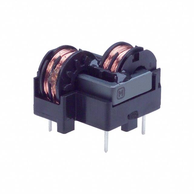

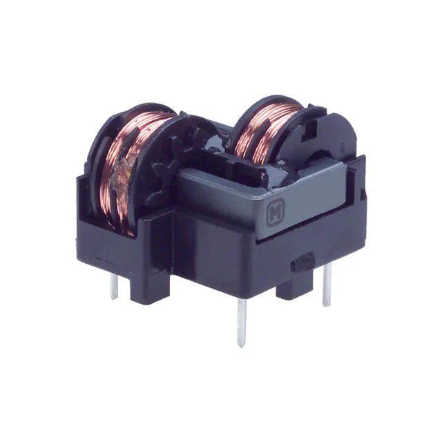

Line Filters Indonesia Japan Combination Line Filters Series: Type: C 21C, 25C Type 21C Combination Line Filters for attenuation of both common and normal mode noise. ■ Features ● Excellent attenuation characteristics ● Compact size and high inductance ● Low profile, suitable for high density mounting Type 25C첸첸첸A ■ Recommended Applications ● Lighting, A/V, communications and power supply equipment Type 25C첸첸첸F ■ Explanation of Part Numbers 1 2 3 4 5 6 7 8 9 10 E L F 2 5 C 0 0 3 A Product Code Type Series Design No. (Current) Option 1 11 12 Option 2 Option 3 ■ Performance Characteristics Item Series Series C Type 21C, 25C Note Operating Temperature –20 °C to 115 °C ✽ Voltage AC 250 Vrms max. Current Refer to examples Inductance Refer to examples Dielectric Withstanding Voltage Temperature Rise Applicable Safety Standards ✽✽ ✽ ✽✽ AC 2 kV 1 min. 45 K max. Resistance method Denki Yohin , UL, CSA, IEC UL, CSA : –20 °C to 100 °C Only the combination line filter does not have safety standards recognition Design and specifications are each subject to change without notice. Ask factory for the current technical specifications before purchase and/or use. Should a safety concern arise regarding this product, please be sure to contact us immediately. Jun. 2006 Line Filters ■ Type 21C ● Dimensions in mm (not to scale) ● Recommended PWB piercing plan (not to scale) Marking 13.00±0.05 17.0±0.5 4-f1.2±0.1 17.0±0.5 21.5±0.5 2 ● Connection Schematics 24.5±0.5 4 13.0±0.5 1 4.0±1.0 17.00±0.05 1 4 2 3 4-f0.8±0.1 3 ● Standard Parts Inductance (mH min.) Part No. Marking For Common Mode (mH) min. (mH) RDC (at 20 °C) Current (A rms) max. For Normal Mode (액) Tol. (%) Tol. (%) ELF21C003A 003A 43.0 1.700 3.07 0.3 ELF21C004A 004A 25.0 0.960 1.75 0.4 ELF21C006A 006A 11.0 0.440 0.79 0.6 ELF21C009A 009A 6.4 0.250 0.45 ±10 0.9 ±20 ELF21C011A 011A 3.9 0.150 0.30 1.1 ELF21C015A 015A 2.3 0.090 0.17 1.5 ELF21C018A 018A 1.7 0.065 0.12 1.8 ELF21C023A 023A 1.0 0.040 0.08 2.3 ● Attenuation Characteristics Normal mode Common Mode 0 0 21C011A 10 21C015A 21C023A Attenuation (dB) Attenuation (dB) 21C004A 20 20 30 40 21C004A 50 21C006A 30 40 21C009A 50 21C011A 21C015A 60 21C006A 60 21C023A 10 70 21C009A 70 80 1 10 100 1,000 Frequency (kHz) 10,000 100,000 1 10 100 1,000 10,000 100,000 Frequency (kHz) Design and specifications are each subject to change without notice. Ask factory for the current technical specifications before purchase and/or use. Should a safety concern arise regarding this product, please be sure to contact us immediately. Feb. 2006 Line Filters ■ Type 25C ● Dimensions in mm (not to scale) ● Recommended PWB piercing plan (not to scale) Marking 15.00±0.05 4.0±1.0 20.0±1.0 4–f1.2±0.1 21.00±0.05 25.0±1.0 25.5±1.0 4 2 3 21.0±0.5 ● Connection Schematics 15.0±0.5 1 1 4 4–f0.8±0.1 2 3 ● Standard Parts Inductance Part No. Marking For Common Mode (mH) min. RDC (at 20 °C) For Normal Mode (mH) min. (액) Tol. (%) Current (A rms) max. ELF25C003A 184 03 184.0 5.30 5.031 0.3 ELF25C005A 723 05 72.0 2.10 1.891 0.5 ELF25C007A 343 07 34.0 0.90 0.916 0.7 ELF25C009A 203 09 20.0 0.52 0.510 0.9 ELF25C012A 113 12 11.0 0.31 0.310 1.2 ±20 ELF25C016A 672 16 6.7 0.18 0.180 1.6 ELF25C020A 442 20 4.4 0.11 0.113 2.0 ELF25C025A 302 25 3.0 0.08 0.080 2.5 ELF25C032A 182 32 1.8 0.05 0.053 3.2 ELF25C038A 122 38 1.2 0.03 0.037 3.8 ● Attenuation Characteristics Common Mode Normal Mode 25C016A 25C020A 25C016A 25C025A 0 25C020A 25C025A 0 25C032A 25C038A 25C032A Attenuation(dB) Attenuation(dB) 20 40 25C003A 25C005A 25C007A 60 25C003A 20 25C005A 25C038A 25C007A 25C009A 40 25C012A 25C009A 25C012A 60 80 100 1 10 100 1,000 Frequency (kHz) 10,000 100,000 80 1 10 100 1,000 Frequency (kHz) 10,000 Design and specifications are each subject to change without notice. Ask factory for the current technical specifications before purchase and/or use. Should a safety concern arise regarding this product, please be sure to contact us immediately. 100,000 Feb. 2006 Line Filters ■ Type 25C첸첸첸F ● Dimensions in mm (not to scale) ● Recommended PWB piercing plan (not to scale) 4-f1.2±0.1 4 21.0±0.05 Marking 4.0+1.0 –0.5 17.5 max. 1 25.0±1.0 25.0±1.0 13.0±0.05 2 1 3 4 21.0±0.5 ● Connection Schematics 2 13.0±0.5 4-f0.8±0.1 3 1 4 2 3 ● Standard Parts Inductance Part No. Marking RDC (at 20 °C) For Common Mode (mH) min. For Normal Mode (mH) min. (액) Tol. (%) Current (A rms) max. ELF25C005F 853 05F 85.0 2.10 1.891 0.5 ELF25C006F 523 06F 52.0 1.28 1.270 0.6 ELF25C007F 343 07F 34.0 0.90 0.916 0.7 ELF25C008F 263 08F 26.0 0.68 0.673 0.8 ±20 ELF25C009F 203 09F 20.0 0.52 0.510 0.9 ELF25C012F 113 12F 11.0 0.31 0.310 1.2 ELF25C016F 672 16F 6.7 0.18 0.180 1.6 ELF25C020F 442 20F 4.4 0.11 0.113 2.0 ● Attenuation Characteristics Common Mode Normal Mode 10 0 25C009F -10 -20 25C016F -30 -40 25C005F -60 -70 25C006F 25C007F 25C008F -20 25C006F -30 25C007F -40 25C008F -50 25C009F -60 -70 -80 -90 0.001 25C020F 25C005F 25C020F -50 25C016F -10 Attenuation (dB) Attenuation (dB) 25C012F 0 25C012F 0.01 0.1 1 Frequency (MHz) 10 100 -80 0.001 0.01 0.1 1 10 100 Frequency (MHz) Design and specifications are each subject to change without notice. Ask factory for the current technical specifications before purchase and/or use. Should a safety concern arise regarding this product, please be sure to contact us immediately. Feb. 2006
