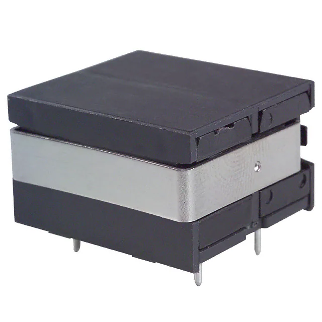

Line Filters ■ Series F ● Type 23F Dimensions in mm (not to scale) Recommended PWB piercing plan Marking 4–f1.2±0.1 2 10.0±0.5 4–f0.8±0.1 24 max. 23 max. 4.0±0.1 16.0±0.5 10.0±0.1 14 max. 1 4 3 16.0±0.1 ● Standard Parts Part No. Marking Inductance (mH)min. ELF23F003A ELF23F004A ELF23F005A ELF23F906A ELF23F007A ELF23F008A ELF23F009A 23F003A 23F004A 23F005A 23F906A 23F007A 23F008A 23F009A 50.0 30.0 20.0 14.0 10.0 8.0 6.0 ✽ R DC (액) [at 20 °C] (Tol ±20 %) 2.989 1.770 1.219 0.949 0.704 0.590 0.468 Current (A rms) max. 0.3 0.4 0.5 0.6 0.7 0.8 0.9 Part No. Marking Inductance (mH)min. ELF23F010A ELF23F012A ELF23F014A ELF23F016A ELF23F018A ELF23F020A ELF23F022A 23F010A 23F012A 23F014A 23F016A 23F018A 23F020A 23F022A 5.0 3.5 2.5 2.0 1.5 1.2 1.0 ✽ R DC (액) [at 20 °C] (Tol ±20 %) 0.328 0.258 0.177 0.156 0.130 0.107 0.097 Current (A rms) max. 1.0 1.2 1.4 1.6 1.8 2.0 2.2 ✽ DC Resistance ● Type 25F Dimensions in mm (not to scale) Recommended PWB piercing plan Marking 4–f1.2±0.1 28 max. 11.0±0.5 4-f0.8±0.1 25 max. 4.0±1.0 21.0±0.5 2 11.0±0.1 15 max. 1 4 3 21.0±0.1 ● Standard Parts Part No. Marking Inductance (mH)min. ELF25F105A ELF25F106A ELF25F107A ELF25F108A ELF25F109A ELF25F110A ELF25F112A ELF25F113A ELF25F114A ELF25F116A 25F105A 25F106A 25F107A 25F108A 25F109A 25F110A 25F112A 25F113A 25F114A 25F116A 40.0 28.0 20.0 15.0 12.0 10.0 7.0 6.0 5.0 4.0 ✽ R DC (액) [at 20 °C] (Tol ±20 %) 1.713 1.240 0.940 0.594 0.528 0.466 0.321 0.285 0.207 0.199 Current (A rms) max. 0.5 0.6 0.7 0.8 0.9 1.0 1.2 1.3 1.4 1.6 Part No. Marking Inductance (mH)min. ELF25F118A ELF25F004A ELF25F005A ELF25F009A ELF25F010A ELF25F012A ELF25F020A ELF25F022A ELF25F025A 25F118A 25F004A 25F005A 25F009A 25F010A 25F012A 25F020A 25F022A 25F025A 3.0 50.0 30.0 10.0 8.0 5.5 2.0 1.6 1.3 ✽ R DC (액) [at 20 °C] (Tol ±20 %) 0.148 2.404 1.560 0.466 0.421 0.281 0.107 0.093 0.071 Current (A rms) max. 1.8 0.4 0.5 0.9 1.0 1.2 2.0 2.2 2.5 ✽ DC Resistance Design and specifications are each subject to change without notice. Ask factory for the current technical specifications before purchase and/or use. Should a safety concern arise regarding this product, please be sure to contact us immediately. Feb. 2006
