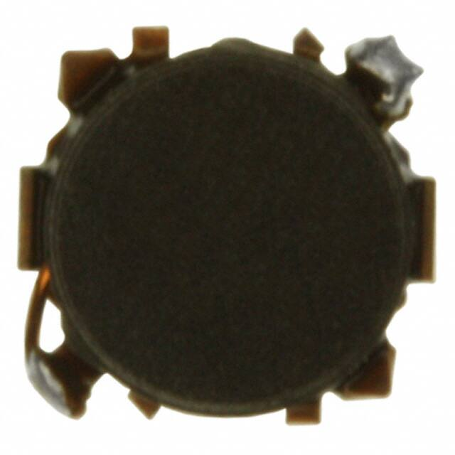

    固定电感器 Nonstandard 2.7µH ±30% 1.55A 63mΩ
ELL-4LG2R7NA 数据手册
Power Inductors Power Inductors / Wire Wound type Series : G Type : ELL4FG-A ELL4GG ELL4LG-A Type ELL4FG–A Type ELL4GG Type ELL4LG–A Features ● Magnetic shielded structure DC resistance and large current capability ● Shock resistant ● RoHS compliant ● Low Recommended Applications ● DSC, Tablet terminal, Portable game device, DC/DC converter circuit for cellular phone Standard Packing Quantity ● 2,000 ● 3,000 pcs./reel (ELL4FG-A/ELL4GG) pcs./reel (ELL4LG-A) ■ As for Soldering Conditions and Safety Precautions, Please see Data Files Explanation of Part Numbers 1 2 3 4 5 6 7 8 9 10 E L L 4 F G 1 0 0 M Outer size Height Structure Product Code ELL Choke Coil (Magnetic shielded type ) F 1.2 max. G 1.4 max. L 1.8 max. Inductance G Series 11 Tolerance Design No. 2R2 → 2.2 µH 150 → 15 µH M → ±20 % N → ±30 % F A G — L A Dimensions in mm (not to scale) 0.70 1.20 3.80±0.2 0.10 1.4 max. H 0.40 (5 .0 0) H 0.10 0.30 0.70 3.80±0.2 Type 1.70 3.80±0.2 1.60 1.00 Marking 1.70 ELL4GG 1.60 1.00 Marking 3.80±0.2 ELL4FG-A ELL4LG-A ELL4FG-A 1.1±0.10 (1.20 max.) ELL4LG-A 1.80 max. Design and specifications are each subject to change without notice. Ask factory for the current technical specifications before purchase and/or use. Should a safety concern arise regarding this product, please be sure to contact us immediately. 02 Oct. 2014 Power Inductors Recommended land patterns in mm (not to scale) ELL4FG-A ELL4LG-A ELL4GG 1.60 1.80 4.20 2.20 4.20 1.00 1.20 1.50 1.50 Standard Parts Series Series 4FG-A Series 4GG Series 4LG-A Part No. ELL4FG1R0NA ELL4FG1R5NA ELL4FG2R0NA ELL4FG3R3NA ELL4FG4R7NA ELL4FG6R8NA ELL4FG100MA ELL4FG150MA ELL4FG220MA ELL4FG330MA ELL4FG470MA ELL4GG1R2N ELL4GG1R8N ELL4GG2R2N ELL4GG3R3N ELL4GG3R9N ELL4GG4R7N ELL4GG5R6N ELL4GG6R8N ELL4GG8R2N ELL4GG100M ELL4GG120M ELL4GG150M ELL4GG220M ELL4GG330M ELL4GG470M ELL4GG101M ELL4LG1R0NA ELL4LG1R5NA ELL4LG2R2NA ELL4LG2R7NA ELL4LG3R3NA ELL4LG4R7NA ELL4LG6R2NA ELL4LG100MA ELL4LG150MA ELL4LG220MA ELL4LG330MA ELL4LG470MA ELL4LG680MA ELL4LG101MA ELL4LG151MA Inductance (100 kHz) (µH) Tol. 1.0 1.5 2.0 ±30 % 3.3 4.7 6.8 10.0 15.0 ±20 % 22.0 33.0 47.0 1.2 1.8 2.2 3.3 3.9 ±30 % 4.7 5.6 6.8 8.2 10.0 12.0 15.0 ±20 % 22.0 33.0 47.0 100.0 1.0 1.5 2.2 2.7 ±30 % 3.3 4.7 6.2 10.0 15.0 22.0 33.0 ±20 % 47.0 68.0 100.0 150.0 RDC (at 20 °C) (mΩ) Tol. 45 60 70 110 160 ±20 % 220 290 480 620 1060 1600 50 71 88 110 120 160 170 200 ±20 % 220 250 380 500 640 980 1250 2400 43 48 55 63 72 90 140 200 ±20 % 300 390 610 920 1300 2200 3000 Saturation Rated Current✽1 (mA max.) 1900 1600 1300 1100 1000 800 700 600 420 360 290 2400 1900 1700 1500 1400 1200 1100 1050 1000 900 800 700 600 450 400 290 2200 1700 1500 1400 1300 1100 930 800 620 550 430 360 270 250 220 Temperature Rise Current✽2 (mA max.) 1950 1700 1550 1220 1000 860 750 580 500 400 330 1900 1550 1400 1200 1150 1000 970 930 870 770 650 580 500 400 350 250 1900 1800 1700 1550 1450 1300 1100 950 730 640 510 410 350 260 220 Marking 01 06 10 16 21 26 31 33 36 39 51 03 09 11 16 19 21 23 26 29 31 32 33 36 39 51 56 01 06 11 13 16 21 25 31 33 36 39 51 53 56 59 ✽1 Saturation Rated Current : This DC current which causes a 30 % inductance reduction from its nominal value. ✽2 Temperature Rise Current : This indicates the value of current when temperature rise dt/t= 40 °C (at 20 °C). Design and specifications are each subject to change without notice. Ask factory for the current technical specifications before purchase and/or use. Should a safety concern arise regarding this product, please be sure to contact us immediately. 02 Oct. 2014 Power Inductors R0 .3 m ax . 4.3±0.1 4.0 ° max. , A-A Section B 0.8 0.8 A, t , B-B Section 5.50±0.05 12.0±0.3 R0 .5 m 0.8 A 0.4±0.1 4.3±0.1 f ax. 4.0±0.1 4.0 ° max. 8.0±0.1 0.8 .1 +0 0 0 1.5 B, 2.00±0.05 1.75±0.10 Embossed Carrier Tape Dimensions in mm (not to scale) R0 .3 Tape running direction m ax . Type t ELL4FG-A 1.4±0.3 ELL4GG 1.6±0.3 ELL4LG-A 2.0±0.3 Quantity 2,000 pcs./reel (ELL4FG-A/ELL4GG) Quantity 3,000 pcs./reel (ELL4LG-A) Design and specifications are each subject to change without notice. Ask factory for the current technical specifications before purchase and/or use. Should a safety concern arise regarding this product, please be sure to contact us immediately. 02 Oct. 2014 Power Inductors Safety Precautions (Common precautions for Power Inductors / Wire Wound type) • When using our products, no matter what sort of equipment they might be used for, be sure to make a written agreement on the specifications with us in advance. The design and specifications in this catalog are subject to change without prior notice. • Do not use the products beyond the specifications described in this catalog. • This catalog explains the quality and performance of the products as individual components. Before use, check and evaluate their operations when installed in your products. • Install the following systems for a failsafe design to ensure safety if these products are to be used in equipment where a defect in these products may cause the loss of human life or other significant damage, such as damage to vehicles (automobile, train, vessel), traffic lights, medical equipment, aerospace equipment, electric heating appliances, combustion/gas equipment, rotating equipment, and disaster/crime prevention equipment. ✽ Systems equipped with a protection circuit and a protection device ✽ Systems equipped with a redundant circuit or other system to prevent an unsafe status in the event of a single fault Precautions for use 1. Operation range and environments 1 These products are designed and manufactured for general and stan dard use in general elec tron ic equipment (e.g. AV equipment, home electric appliances, office equipment, information and communication equipment) 2 These products are not intended for use in the following special conditions. Before using the products, carefully check the effects on their quality and performance, and determine whether or not they can be used. • In liquid, such as water, oil, chemicals, or organic solvent • In direct sunlight, outdoors, or in dust • In salty air or air with a high concentration of corrosive gas, such as Cl2, H2S, NH3, SO2, or NO2 • In an environment where these products cause dew condensation 2. Handling 1 Do not bring magnets or magnetized materials close to the product. The influence of their magnetic field can change the inductance value. 2 Do not apply strong mechanical shocks by either dropping or collision with other parts. Excessive shock can damage the part. 3. Washing of board Kindly consult the Technical department before washing of the PWB with any cleansing agent, and provide the washing condition. 4. Resoldering with a soldering iron The temperature of the tip of the soldering iron should be 360 °C or less, 4 seconds. And resoldering with a soldering iron should be limited to 1 time, and after that should be cooling these. 5. Mounting side External force must be less than 5.0 [N] : while mounting. 6. Storage conditions Normal temperature (–5 to 35 °C), normal humidity (85 % RH max.), shall not be exposed to direct sunlight and harmful gases and care should be taken so as not to cause dew. Package markings include the product number, quantity, and country of origin. In principle, the country of origin should be indicated in English. Design and specifications are each subject to change without notice. Ask factory for the current technical specifications before purchase and/or use. Should a safety concern arise regarding this product, please be sure to contact us immediately. 02 Sep. 2014
ELL-4LG2R7NA
1. 物料型号:文档列出了多个型号的功率电感器,包括ELL4FG-A、ELL4GG和ELL4LG-A系列。
2. 器件简介:这些电感器具有磁屏蔽结构、低直流电阻和大电流承载能力、抗冲击性,并且符合RoHS标准。
3. 引脚分配:文档中没有提供具体的引脚分配图,但提到了电感器的封装信息
4. 参数特性: - 电感值范围从1.0μH到100μH。 - 直流电阻(RDC)在20°C时的测量值,不同型号有不同的参数。 - 饱和额定电流:导致电感值下降30%的直流电流。 - 温升电流:在20°C时,温度上升40°C时的电流值。
5. 功能详解:文档中提到了电感器的推荐应用,包括DSC、平板电脑、便携式游戏设备、手机的DC/DC转换器电路等。
6. 应用信息:电感器适用于多种电子设备,特别是在需要高电流和抗冲击性的应用中。
7. 封装信息:提供了电感器的尺寸信息,以及推荐的焊盘图案和封装胶带的尺寸。
