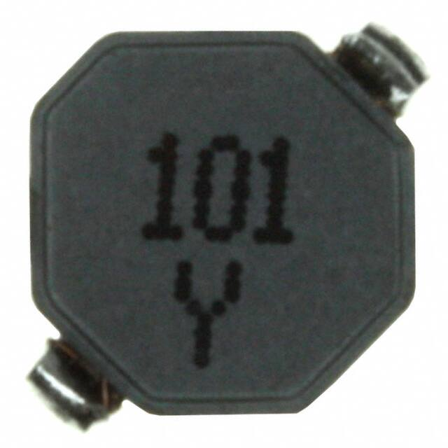

    固定电感器 Nonstandard 100µH ±20% 340mA 1.32Ω
ELL-5PS101M 数据手册
Choke Coils Power Inductors / Wire Wound type Series: Type: Discontinued S ELL5PS ■ Features ● Magnetic shielded structure ● Low DC resistance and large current capability ● RoHS compliant ■ Recommended Applications ● DC-DC converter circuitry for computer peripherals and cellular phones. ● Chopper circuit decoupling chokes for DC- DC converter circuitry ■ Standard Packing Quantity ■ Soldering Conditions and Safety Precautions ● 2000 pcs./Reel Please see Data Files ■ Explanation of Part Numbers 1 2 3 4 5 6 7 8 9 10 & - -  1 4    . Product Code ELL Outer size Height Structure Choke Coil (Magnetic shielded type) P Inductance 2.0 max. S ■ Dimensions in mm (not to scale) Series 11 Tolerance Design No. 2R2  2.2 μH 100  10 μH 101 100 μH M  ±20 % N  ±30 % ■ Recommended Land Pattern in mm (not to scale) 20 1. 2. 00 6. 50 ± 2. 0. 55 50 Date code 30 1. 90 1. 30 1. 2. 5.00±0.50 5.50±0.50 60 7. 00 H 3 1 0. 5.50±0.50 5.00±0.50 Marking 10 0. .55 0 H=1.85±0.15 Design and specifications are each subject to change without notice. Ask factory for the current technical specifications before purchase and/or use. Should a safety concern arise regarding this product, please be sure to contact us immediately. 02 Sep. 2012 42 Choke Coils Discontinued ■ Standard Parts Part Number ELL5PS1R2N ELL5PS1R5N ELL5PS2R2N ELL5PS2R7N ELL5PS3R3N ELL5PS4R7N ELL5PS6R8N ELL5PS100M ELL5PS150M ELL5PS220M ELL5PS330M ELL5PS470M ELL5PS560M ELL5PS680M ELL5PS820M ELL5PS101M ELL5PS221M ELL5PS331M ELL5PS471M ELL5PS561M Inductance (100 kHz) (μH) Tol. 1.2 1.5 2.2 ±30 % 2.7 3.3 4.7 6.8 10.0 15.0 22.0 33.0 47.0 56.0 ±20 % 68.0 82.0 100.0 220.0 330.0 470.0 560.0 R DC (at 20 °C) (mΩ) 22 28 34 40 46 61 96 120 170 290 470 620 680 750 1160 1320 3450 4700 8100 9500 Saturation ✽1 Rated Current (mA max.) 2500 2400 2100 2000 1900 1500 1280 1000 790 650 490 450 430 380 340 300 210 180 160 150 Tol. ±20 % Temperature ✽2 Rise Current (mA max.) 2500 2400 2100 2050 2000 1600 1280 1100 1000 750 490 550 500 480 360 340 210 180 140 125 Marking 1R2 1R5 2R2 2R7 3R3 4R7 6R8 100 150 220 330 470 560 680 820 101 221 331 471 561 ✽1 Saturation Rated Current : This DC current which causes a 30 % inductance reduction from its nominal value. ✽2 Temperature Rise Current : This indicates the value of current when temperature rise dt/t= 40 °C (at 20 °C). 1.75±0.10 . x ma C1.5 4–C0.3 .3 0.3 4–R0.5 max. 0.3 , B-B Section A’ R0 2–C0.8 0.3 A 5.5±0.1 0.3 C1.0 2.1±0.3 0.4±0.1 4 ° max. 1.2±0.1 .1 ±0 .5 f1 5.5±0.1 2.00±0.05 4.0±0.1 2.75±0.10 12.0±0.3 8.0±0.1 B 2.75±0.10 B’ ■ Embossed Carrier Tape Dimensions in mm (not to scale) 4 ° max. 5.5±0.1 R 0.3 ma x. , A-A Section Tape running direction Quantity 2000 pcs./reel Design and specifications are each subject to change without notice. Ask factory for the current technical specifications before purchase and/or use. Should a safety concern arise regarding this product, please be sure to contact us immediately. 02 Sep. 2012 43

物料型号:ELL5PS系列,包括不同型号,如ELL5PS1R2N、ELL5PS1R5N等。
器件简介:这是松下生产的电感器,具有磁屏蔽结构、低直流电阻和大电流承载能力,符合RoHS标准。
引脚分配:文档未提供具体引脚分配信息,但通常电感器有2个引脚。
参数特性:包括电感值、公差、直流电阻(RDC)、饱和额定电流和温升电流等。
功能详解:推荐应用于电脑外设和手机的DC-DC转换器电路,以及DC-DC转换器电路的斩波电路解耦电感。
应用信息:适用于DC-DC转换器电路和斩波电路的解耦。
封装信息:提供了推荐的焊盘图案尺寸,以及元件的外形尺寸。
标准包装数量:每卷2000件。
焊接条件和安全注意事项:详见数据文件。
元件编号解释:提供了如何解读元件编号的方法。
