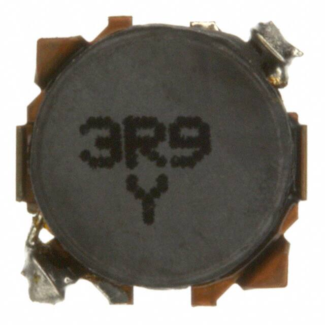

Power Inductors Power Inductors / Wire Wound type Series : G Type : ELL6GG ELL6PG Features ● Magnetic shielded structure DC resistance and large current capability ● RoHS compliant ● Low Recommended Applications ● DSC, Tablet terminal, Portable game device, DC/DC converter circuit for cellular phone Standard Packing Quantity ● 1,000 pcs./reel ■ As for Soldering Conditions and Safety Precautions, Please see Data Files Explanation of Part Numbers 1 2 3 4 5 6 7 8 9 10 E L L 6 P G 1 0 0 M Product Code Inductance Outer size Height Structure ELL Choke Coil (Magnetic shielded type ) G 1.6 max. P 2.0 max. Dimensions in mm (not to scale) G 11 Tolerance Design No. 2R2 → 2.2 µH 150 → 15 µH Series M → ±20 % N → ±30 % 1.60 max. Recommended land patterns in mm (not to scale) 6.0±0.3 Marking 2.9 Date code 1.05 2.7 1.20 6.0±0.3 2.1 0.15 H 0.5 2.1 Type ELL6GG ELL6PG H 1.6 max. 2.0 max. Design and specifications are each subject to change without notice. Ask factory for the current technical specifications before purchase and/or use. Should a safety concern arise regarding this product, please be sure to contact us immediately. 02 Oct. 2014 Power Inductors Standard Parts Series Series 6GG Series 6PG Part No. ELL6GG1R0N ELL6GG1R5N ELL6GG2R2M ELL6GG2R7M ELL6GG3R9M ELL6GG4R7M ELL6GG6R8M ELL6GG100M ELL6GG150M ELL6GG220M ELL6GG330M ELL6GG470M ELL6GG680M ELL6GG101M ELL6PGR08N ELL6PG1R5N ELL6PG2R2N ELL6PG3R3N ELL6PG3R9N ELL6PG4R7N ELL6PG5R6N ELL6PG6R8N ELL6PG100M ELL6PG120M ELL6PG150M ELL6PG220M ELL6PG270M ELL6PG330M ELL6PG470M ELL6PG560M ELL6PG680M ELL6PG820M ELL6PG101M Inductance (100 kHz) (µH) Tol. 1.0 ±30 % 1.5 2.2 2.7 3.9 4.7 6.8 10.0 ±20 % 15.0 22.0 33.0 47.0 68.0 100.0 0.8 1.5 2.2 3.3 ±30 % 3.9 4.7 5.6 6.8 10.0 12.0 15.0 22.0 27.0 ±20 % 33.0 47.0 56.0 68.0 82.0 100.0 RDC (at 20 °C) (mΩ) Tol. 27 36 45 54 60 70 110 ±20 % 170 210 300 510 610 860 1480 24 30 37 44 51 58 65 70 110 140 ±20 % 150 230 260 300 470 520 700 800 1000 Temperature Saturation Rated Current✽1 Rise Current✽2 (mA max.) (mA max.) 2500 2500 2300 2250 1950 2000 1850 1800 1650 1700 1400 1550 1150 1300 900 1000 800 900 620 850 490 580 400 480 380 410 300 350 3800 2800 2500 2500 2200 2200 1700 2000 1600 1900 1500 1750 1450 1650 1400 1600 1300 1300 1100 1200 1000 1100 800 900 730 800 700 750 550 600 500 550 420 500 400 450 380 400 Marking 1R0 1R5 2R2 2R7 3R9 4R7 6R8 100 150 220 330 470 680 101 R08 1R5 2R2 3R3 3R9 4R7 5R6 6R8 100 120 150 220 270 330 470 560 680 820 101 ✽1 Saturation Rated Current : This DC current which causes a 30 % inductance reduction from its nominal value. ✽2 Temperature Rise Current : This indicates the value of current when temperature rise dt/t= 40 °C (at 20 °C). B-B,Section R0 .3 ma x. B 1.5±0.1 6.4±0.1 B A, t 0.4±0.1 4 ° max. A 7.5±0.1 1.5±0.1 R0 .5 , 0m ax . .1 +00 .50 f1 16.0±0.3 2.0±0.1 4.0±0.1 12.0±0.1 1.75±0.10 Embossed Carrier Tape Dimensions in mm (not to scale) 4 ° max. 6.4±0.1 R0 A-A,Section .3 ma x. Type ELL6GG ELL6PG t 1.8±0.3 2.2±0.3 Tape running direction Quantity 1,000 pcs./reel Design and specifications are each subject to change without notice. Ask factory for the current technical specifications before purchase and/or use. Should a safety concern arise regarding this product, please be sure to contact us immediately. 02 Oct. 2014 Power Inductors Safety Precautions (Common precautions for Power Inductors / Wire Wound type) • When using our products, no matter what sort of equipment they might be used for, be sure to make a written agreement on the specifications with us in advance. The design and specifications in this catalog are subject to change without prior notice. • Do not use the products beyond the specifications described in this catalog. • This catalog explains the quality and performance of the products as individual components. Before use, check and evaluate their operations when installed in your products. • Install the following systems for a failsafe design to ensure safety if these products are to be used in equipment where a defect in these products may cause the loss of human life or other significant damage, such as damage to vehicles (automobile, train, vessel), traffic lights, medical equipment, aerospace equipment, electric heating appliances, combustion/gas equipment, rotating equipment, and disaster/crime prevention equipment. ✽ Systems equipped with a protection circuit and a protection device ✽ Systems equipped with a redundant circuit or other system to prevent an unsafe status in the event of a single fault Precautions for use 1. Operation range and environments 1 These products are designed and manufactured for general and stan dard use in general elec tron ic equipment (e.g. AV equipment, home electric appliances, office equipment, information and communication equipment) 2 These products are not intended for use in the following special conditions. Before using the products, carefully check the effects on their quality and performance, and determine whether or not they can be used. • In liquid, such as water, oil, chemicals, or organic solvent • In direct sunlight, outdoors, or in dust • In salty air or air with a high concentration of corrosive gas, such as Cl2, H2S, NH3, SO2, or NO2 • In an environment where these products cause dew condensation 2. Handling 1 Do not bring magnets or magnetized materials close to the product. The influence of their magnetic field can change the inductance value. 2 Do not apply strong mechanical shocks by either dropping or collision with other parts. Excessive shock can damage the part. 3. Washing of board Kindly consult the Technical department before washing of the PWB with any cleansing agent, and provide the washing condition. 4. Resoldering with a soldering iron The temperature of the tip of the soldering iron should be 360 °C or less, 4 seconds. And resoldering with a soldering iron should be limited to 1 time, and after that should be cooling these. 5. Mounting side External force must be less than 5.0 [N] : while mounting. 6. Storage conditions Normal temperature (–5 to 35 °C), normal humidity (85 % RH max.), shall not be exposed to direct sunlight and harmful gases and care should be taken so as not to cause dew. Package markings include the product number, quantity, and country of origin. In principle, the country of origin should be indicated in English. Design and specifications are each subject to change without notice. Ask factory for the current technical specifications before purchase and/or use. Should a safety concern arise regarding this product, please be sure to contact us immediately. 02 Sep. 2014

物料型号:ELL6GG系列和ELL6PG系列
器件简介:这些是Panasonic生产的功率电感器,具有磁屏蔽结构,低直流电阻和大电流承载能力,符合RoHS标准。
引脚分配:文档中没有提供具体的引脚分配图,但通常这类电感器会有至少两个引脚用于连接电路。
参数特性: - 电感值范围从1.0μH到100.0μH,公差从±20%到±30%。 - 直流电阻(RDC)在20°C时的范围从24mΩ到1480mΩ。 - 饱和额定电流和温升电流提供了电感器在不同条件下的最大电流承载能力。
功能详解:这些电感器适用于多种电子设备,包括数字相机、平板电脑、便携式游戏设备、手机的DC/DC转换器电路等。
应用信息:推荐的应用包括上述的电子设备,它们被设计用于一般和标准的电子设备中。
封装信息:提供了两种类型的封装尺寸,ELL6GG和ELL6PG,每种类型都有不同的最大高度。
安全注意事项:文档强调了在使用这些产品时需要遵守的安全预防措施,包括在特殊条件下使用时的注意事项、操作范围和环境、处理、清洗、重新焊接、安装侧和存储条件。
标准包装数量:1,000 pcs./reel。
