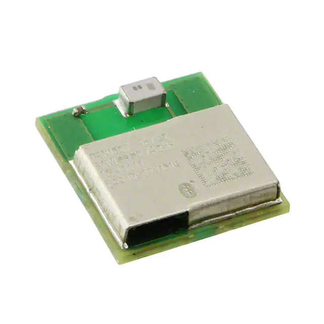

    BLUETOOTH PAN1327 BT+ANT HCI MOD
ENW-89827A2KF 数据手册
CLASSIFICATION SUBJECT PRODUCT SPECIFICATION CLASS 1 or 2 BLUETOOTH MODULE CUSTOMER’S CODE PAN13XX Core Specification PANASONIC’S CODE See Chapter Ordering Information No. DS-13xx-2400-102 REV. 4.8 PAGE 1 of 60 DATE 23.09.2015 Product Specification Applicant / Manufacturer Hardware Panasonic Industrial Devices Europe GmbH Zeppelinstrasse 19 21337 Lüneburg Germany Applicant / Manufacturer Software Not applicable Software Version Not applicable Contents Approval for Mass Production Customer Bluetooth QDL ID Qualified Design Listing (QDL) ID: B019784 As Controller Sub-System Listing for PAN13xx Series. By purchase of any products described in this document the customer accepts the document's validity and declares their agreement and understanding of its contents and recommendations. Panasonic reserves the right to make changes as required without notification. Power Electronics R&D Center Wireless Connectivity Panasonic Industrial Devices Europe GmbH APPROVED CHECKED DESIGNED CLASSIFICATION SUBJECT PRODUCT SPECIFICATION CLASS 1 or 2 BLUETOOTH MODULE CUSTOMER’S CODE PAN13XX Core Specification PANASONIC’S CODE See Chapter Ordering Information No. DS-13xx-2400-102 REV. 4.8 PAGE 2 of 60 DATE 23.09.2015 TABLE OF CONTENTS 1 2 3 4 5 6 7 8 9 10 11 12 13 14 Scope of this Document ................................................................................................ 5 1.1 New PAN13x5B, PAN13x6B ................................................................................ 5 Key Features ................................................................................................................. 6 Applications for the Module ........................................................................................... 7 Description for the Module............................................................................................. 7 Detailed Description ...................................................................................................... 8 5.1 Terminal Layout ................................................................................................... 8 5.1.1 5.1.1. Terminal Layout PAN131x without antenna ................................... 8 5.1.2 5.1.2. Terminal Layout PAN132x with antenna........................................ 9 5.2 Pin Description ................................................................................................... 10 5.3 Device Power Supply ......................................................................................... 11 5.4 Clock Inputs ....................................................................................................... 12 Bluetooth Features ...................................................................................................... 12 Block Diagram ............................................................................................................. 13 Test Conditions ........................................................................................................... 14 General Device Requirements and Operation ............................................................. 14 9.1 Absolute Maximum Ratings ................................................................................ 14 9.2 Recommended Operating Conditions................................................................. 15 9.3 Current Consumption ......................................................................................... 16 9.4 General Electrical Characteristics ...................................................................... 17 9.5 nSHUTD Requirements...................................................................................... 17 9.6 External Digital Slow Clock Requirements.......................................................... 17 Host Controller Interface ............................................................................................. 18 Audio/Voice Codec Interface ....................................................................................... 19 11.1 PCM Hardware Interface .................................................................................... 19 11.2 Data Format ....................................................................................................... 19 11.3 Frame Idle Period............................................................................................... 20 11.4 Clock-Edge Operation ........................................................................................ 21 11.5 Two-Channel PCM Bus Example ....................................................................... 21 11.6 Audio Encoding .................................................................................................. 21 11.7 Improved Algorithm For Lost Packets................................................................. 22 11.8 Bluetooth/PCM Clock Mismatch Handling .......................................................... 22 11.9 Bluetooth Inter-IC Sound (I2S) ........................................................................... 22 11.10 Current Consumption for Different Bluetooth Scenarios ..................................... 23 Bluetooth RF Performance .......................................................................................... 23 Soldering Temperature-Time Profile (for reflow soldering)........................................... 26 13.1 For lead solder ................................................................................................... 26 13.2 For leadfree solder ............................................................................................. 27 Module Dimension....................................................................................................... 28 PANASONIC INDUSTRIAL DEVICES EUROPE GMBH www.pideu.panasonic.de CLASSIFICATION SUBJECT PRODUCT SPECIFICATION CLASS 1 or 2 BLUETOOTH MODULE CUSTOMER’S CODE PAN13XX Core Specification 15 16 17 18 19 20 21 22 23 24 25 26 27 28 29 30 31 32 33 PANASONIC’S CODE See Chapter Ordering Information No. DS-13xx-2400-102 REV. 4.8 PAGE 3 of 60 DATE 23.09.2015 14.1 Module Dimensions PAN131X without Antenna ................................................. 28 14.2 Module Dimensions PAN132X with Antenna ...................................................... 29 Footprint of the Module ............................................................................................... 30 15.1 Footprint PAN131x without antenna ................................................................... 30 15.2 Footprint PAN132x with antenna ........................................................................ 31 Labeling Drawing ........................................................................................................ 32 Mechanical Requirements ........................................................................................... 32 Recommended Foot Pattern ....................................................................................... 33 18.1 recommended foot pattern PAN131x without antenna ....................................... 33 18.2 recommended foot pattern PAN132x with antenna ............................................ 34 Radiation Pattern ........................................................................................................ 35 Layout Recommendations with Antenna (PAN132x) ................................................... 36 Bluetooth LE (LOW ENERGY) PAN1316/26 ............................................................... 36 21.1 Network Topology .............................................................................................. 36 21.2 module features ................................................................................................. 37 21.3 Current consumption for different LE scenarios .................................................. 38 ANT PAN1317/27 ........................................................................................................ 38 22.1 Network topology ............................................................................................... 38 22.2 module features ................................................................................................ 39 22.3 ANT Current consumption .................................................................................. 39 Triple mode (BR/EDR + Bluetooth low energy or ANT) PAN1323 .............................. 40 23.1 Triple Mode Current consumption ...................................................................... 40 Development of Applications ....................................................................................... 41 24.1 Tools to be needed ............................................................................................ 41 List of Profiles.............................................................................................................. 42 Reliability Tests ........................................................................................................... 42 Cautions ...................................................................................................................... 43 27.1 Design Notes ..................................................................................................... 43 27.2 Installation Notes................................................................................................ 43 27.3 Usage Conditions Notes..................................................................................... 44 27.4 Storage Notes .................................................................................................... 44 27.5 Safety Cautions .................................................................................................. 45 27.6 Other cautions .................................................................................................... 45 Packaging ................................................................................................................... 46 28.1 Packaging of PAN131x without antenna ............................................................ 46 28.2 Packaging for PAN132x with antenna ................................................................ 49 Ordering Information ................................................................................................... 50 Data Sheet Status ....................................................................................................... 51 History for this Document ............................................................................................ 52 Related Documents ..................................................................................................... 53 General Information..................................................................................................... 54 PANASONIC INDUSTRIAL DEVICES EUROPE GMBH www.pideu.panasonic.de CLASSIFICATION SUBJECT PRODUCT SPECIFICATION CLASS 1 or 2 BLUETOOTH MODULE CUSTOMER’S CODE PAN13XX Core Specification 34 35 PANASONIC’S CODE See Chapter Ordering Information No. DS-13xx-2400-102 REV. 4.8 PAGE 4 of 60 DATE 23.09.2015 Regulatory Information ................................................................................................ 54 34.1 FCC for US ........................................................................................................ 54 34.1.1 FCC Notice ........................................................................................... 54 34.1.2 Caution ................................................................................................. 55 34.1.3 Labeling Requirements ......................................................................... 55 34.1.4 Antenna Warning .................................................................................. 55 34.1.5 Approved Antenna List (PAN1315, PAN1325) ...................................... 56 34.1.6 Approved Antenna List (PAN1316, PAN1317, PAN1326, PAN1327) .... 56 34.1.7 RF Exposure PAN13xx ......................................................................... 56 34.2 Industry Canada Certification ............................................................................. 57 34.2.1 IC Notice ............................................................................................... 57 34.2.2 Labeling Requirements ......................................................................... 58 34.3 European R&TTE Declaration of Conformity ...................................................... 59 34.4 Japanese Radio Law and Japanese Telecommunications Business Law Compliance: ......................................................................................... 60 34.5 Bluetooth SIG Statement.................................................................................... 60 Life Support Policy ...................................................................................................... 60 PANASONIC INDUSTRIAL DEVICES EUROPE GMBH www.pideu.panasonic.de CLASSIFICATION SUBJECT PRODUCT SPECIFICATION CLASS 1 or 2 BLUETOOTH MODULE CUSTOMER’S CODE PAN13XX Core Specification 1 PANASONIC’S CODE See Chapter Ordering Information No. DS-13xx-2400-102 REV. 4.8 PAGE 5 of 60 DATE 23.09.2015 SCOPE OF THIS DOCUMENT This product specification describes Panasonic’s HCI, Class 1.5 , TI based, Bluetooth®1 modules, series number 13xx. For detailed family overview that includes part numbers see Chapter 29, Ordering Information. Non-antenna versions will be refered to as PAN131x, versions with antenna will be refered to as PAN132x in this document. For information and features on Bluetooth Low Energy 4.0 refer to Chapter 20, for information on ANT refer to Chapter 22. 1.1 NEW PAN13X5B, PAN13X6B The PAN13x5B and PAN13x6B Series are based on Texas Instruments’ NEW CC2560B and CC2564B controller respectively. The NEW PAN13x5B/13x6B Series Modules support assisted mode for the HFP1.6 (WBS) profile or the A2DP profile. The PAN13x6B also supports 10 LE connections (instead of 6 before). Compatibility: PAN1315(A/B) and PAN1316(B) are 100% footprint compatible PAN1325(A/B) and PAN1326(B) are 100% footprint compatible NOTE: In the following chapters PAN13x5, PAN13x6 naming also considers the A and B version. As an updated initialization script resident on the application microcontroller is required for modules based on the CC2560B and CC2564B, compatibility between the basic, A and B version is dependent on the Bluetooth stack. BT-Stack solutions provided by software development partners are available for most processors, including linux based host systems. For detailed family overview that includes part numbers see Chapter 29 Ordering Information. Contact your stack provider or local Panasonic sales company for currently available Bluetooth Profiles. 1 Bluetooth is a registered trademark of the Bluetooth Special Interest Group. PANASONIC INDUSTRIAL DEVICES EUROPE GMBH www.pideu.panasonic.de CLASSIFICATION SUBJECT PRODUCT SPECIFICATION CLASS 1 or 2 BLUETOOTH MODULE CUSTOMER’S CODE PAN13XX Core Specification 2 PANASONIC’S CODE See Chapter Ordering Information No. DS-13xx-2400-102 REV. 4.8 PAGE 6 of 60 DATE 23.09.2015 KEY FEATURES                     Bluetooth specification v2.1 + EDR (Enhanced Data Rate) Surface mount type 6.5(9.5 w. Ant.) x 9.0 x 1.8 mm³ Up to 10 dBm Tx power with transmit power control High sensitivity (-93 dBm typ.) Texas Instrument’s CC256X BlueLink 7.0 inside Fast Connection Setup Extended SCO Link Supports convenient direct connection to battery (2.2-4.8 V), or connect to DC/DC (1.7-1.98 V) for improved power efficiency Internal crystal oscillator (26MHz) Fully shielded for immunity Full Bluetooth data rate up to 2,178kbps asymmetric Support for Bluetooth power saving modes (Sniff, Hold) Support for very low-power modes (deep sleep and power down) Optional support for ultra-low-power mode. Standby with Battery-Backup PCM Interface Master / Slave supporting 13 or 16 bit linear, 8 bit µ-law or A-law Codecs and CVSD transcoders on up to 3 SCO channels Full 8- to 128-bit encryption UART, I²C and PCM Interface IO operating voltage = 1.8 V nominal Bluetooth profiles such as SPP, A2DP and others are available. Refer to Panasonic’s RF module website for a listing of the most current releases. Manufactured in conformance with RoHS PANASONIC INDUSTRIAL DEVICES EUROPE GMBH www.pideu.panasonic.de CLASSIFICATION SUBJECT PRODUCT SPECIFICATION CLASS 1 or 2 BLUETOOTH MODULE CUSTOMER’S CODE PAN13XX Core Specification 3 PANASONIC’S CODE See Chapter Ordering Information No. DS-13xx-2400-102 REV. 4.8 PAGE 7 of 60 DATE 23.09.2015 APPLICATIONS FOR THE MODULE All Embedded Wireless Applications       4 Smart Phones Industrial Control Medical Scanners Wireless Sensors Low Power       Cable Replacement Automotive Access Points Consumer Electronics Monitoring and Control Access Points DESCRIPTION FOR THE MODULE The PAN1315 and PAN1315A are short-range, Class 1 or 2, HCI modules for implementing Bluetooth functionality into various electronic devices. A block diagram can be found in Chapter 7. Communication between the module and the host controller is carried out via UART. New designs can be completed quickly by mating the PAN13xx series modules with Texas Instruments’ MSP430BT5190 that contains Mindtree’s EtherMind Bluetooth Protocol Stack and serial port profile, additional computing power can be achieved by choosing TI’s Stellaris ARM7 controller that includes StoneStreet One's A2DP profile. Other BT profiles are available on custom development basis. Additional controllers are also supported by the PAN13xx series by using a TI/Panasonic software development partner to port the Bluetooth stack and profiles. Mindtree's Software Development Kit (SDK) is available on TI's website -- www.ti.com/connectivity.com Contact your local sales office for further details on additional options and services, by visiting www.panasonic.com/rfmodules or write an e-mail to wireless@eu.panasonic.com. PANASONIC INDUSTRIAL DEVICES EUROPE GMBH www.pideu.panasonic.de CLASSIFICATION PRODUCT SPECIFICATION SUBJECT CLASS 1 or 2 BLUETOOTH MODULE CUSTOMER’S CODE PAN13XX Core Specification 5 PANASONIC’S CODE See Chapter Ordering Information No. DS-13xx-2400-102 REV. 4.8 PAGE 8 of 60 DATE 23.09.2015 DETAILED DESCRIPTION 5.1 TERMINAL LAYOUT 5.1.1 5.1.1. Terminal Layout PAN131x without antenna 9,00 mm 19 6,50 mm 20 17 18 15 16 13 12 14 21 Pad = 24 x 0.60mm x 0.60mm 11 Module Height 1.8 mm 22 23 2 24 4 1 No Pin Name 1 2 3 4 5 6 7 GND TX_DBG HCI_CTS HCI_RTS HCI_RX HCI_TX AUD_FSYNC 8 SLOW_CLK_IN 9 10 11 12 13 14 15 16 17 18 19 20 21 22 23 24 NC MLDO_OUT CL1.5_LDO_IN GND RF GND MLDO_IN nSHUTD AUD_OUT AUD_IN AUD_CLK GND NC VDD_IO NC NC 10 Top View 3 5 Pull at Reset PU PU PU PU PU PD 9 6 Def. Dir. 2 8 7 I/O Type 3 Description of Options (Common) 2 mA 8 mA 8 mA 8 mA 8 mA 4 mA Connect to Ground Logger output HCI UART clear-to-send. HCI UART request-to-send. HCI UART data receive HCI UART data transmit PCM frame synch. (NC if not used) Fail safe4 I 32.768-kHz clock in Fail safe IO O I Not connected Main LDO output (1.8 V nom.) PA LDO input Connect to Ground Bluetooth RF IO Connect to Ground Main LDO input Shutdown input (active low). PCM data output. (NC if not used) PCM data input. (NC if not used) PCM clock. (NC if not used) Connect to Ground EEPROM I²C SDA (Internal) I/O power supply 1.8 V Nom EEPROM I²C SCL (Internal) Not connected O I O I O IO IO PD PD PD PD I I O I IO PI IO 4 mA 4 mA HY, 4 mA Fail safe Fail safe Fail safe 2 I = input; O = output; IO = bidirectional; P = power; PU = pulled up; PD = pulled down 3 I/O Type: Digital I/O cells. HY = input hysteresis, current = typ. output current 4 No signals are allowed on the IO pins if no VDD_IO (Pin 22) power supplied, except pin 7, 8, 17-19. PANASONIC INDUSTRIAL DEVICES EUROPE GMBH www.pideu.panasonic.de CLASSIFICATION PRODUCT SPECIFICATION SUBJECT CLASS 1 or 2 BLUETOOTH MODULE CUSTOMER’S CODE PAN13XX Core Specification PANASONIC’S CODE See Chapter Ordering Information No. DS-13xx-2400-102 REV. 4.8 PAGE 9 of 60 DATE 23.09.2015 5.1.2 5.1.2. Terminal Layout PAN132x with antenna 0,55 C D A B 19 20 17 18 15 16 13 9.50 1.80 9.00 12 14 21 Pad = 28 x 0.60mm x 0.60mm 11 Top View 10 23 2 24 1 No Pin Name A B C D GND GND GND GND 9 4 3 Pull at Reset 6 5 Def. Dir. 5 8 0,60 22 7 I/O Type 6 Description of Options (Common) Connect to Ground Connect to Ground Connect to Ground Connect to Ground No 1-24 see above in Chapter 5.1.1. Except PIN 13 is not connected. For RF conducted measurements, either use the PAN1323ETU or de-solder the antenna and solder an antenna connector to the hot pin. 5 I = input; O = output; IO = bidirectional; P = power; PU = pulled up; PD = pulled down 6 I/O Type: Digital I/O cells. HY = input hysteresis, current = typ. output current PANASONIC INDUSTRIAL DEVICES EUROPE GMBH www.pideu.panasonic.de CLASSIFICATION SUBJECT CLASS 1 or 2 BLUETOOTH MODULE CUSTOMER’S CODE PAN13XX Core Specification 5.2 Pin Name No. DS-13xx-2400-102 PRODUCT SPECIFICATION No PANASONIC’S CODE See Chapter Ordering Information REV. 4.8 PAGE 10 of 60 DATE 23.09.2015 PIN DESCRIPTION ESD 7 (V) Pull at Reset Def. Dir. 8 I/O Type 9 Description of Options Bluetooth IO SIGNALS HCI_RX 5 750 PU I 8 mA HCI UART data receive HCI_TX 6 750 PU O 8 mA HCI UART data transmit HCI_RTS 4 750 PU O 8 mA HCI UART request-to-send. HCI_CTS 3 750 PU I 8 mA HCI UART clear-to-send. AUD_FYSNC AUD_CLK AUD_IN AUD_OUT 7 19 18 17 500 500 500 500 PD PD PD PD IO IO I O 4 mA HY, 4 mS 4 mA 4 mA PCM PCM PCM PCM TX_DBG 2 1000 PU O 2 mA CLOCK SIGNALS SLOW_CLK_IN 8 1000 Bluetooth ANALOG SIGNALS RF 13 1000 nSHUTD 16 1000 PD Bluetooth POWER AND GND SIGNALS VDD_IO 22 1000 frame synch clock data input data output (NC (NC (NC (NC if if if if not not not not used) used) used) used) Fail safe Fail safe Fail safe Fail safe Logger output OPTION: nTX_DBG – logger out (low = 1) I 32.768-kHz clock in Fail safe IO I Bluetooth RF IO (not connected with antenna) Shutdown input (active low). PI I/O power supply 1.8 V Nom Main LDO input MLDO_IN 15 1000 I Connect directly to battery or to a pre-regulated 1.8-V supply Main LDO output (1.8 V nom.) Can not be used as 1.8V supply MLDO_OUT 10 1000 O due to internal connection to the RF part. PA LDO input CL1.5_LDO_IN 11 1000 I Connect directly to battery or to a pre-regulated 1.8-V supply GND 1 P Connect to Ground GND 12 P Connect to Ground GND 14 P Connect to Ground GND 20 P Connect to Ground EEPROM IO SIGNALS (EEPROM is optional in PAN13x product line) NC 23 1000 PU/PD I HY, 4mA EEPROM I²C SCL (Internal) NC 21 1000 PU/PD IO HY, 4mA EEPROM I²C IRQ (Internal) Remark: HCI_CTS is an input signal to the CC256X device: When HCI_CTS is low, then CC256X is allowed to send data to Host device. When HCI_CTS is high, then CC256X is not allowed to send data to Host device. 7 ESD: Human Body Model (HBM). JEDEC 22-A114 8 I = input; O = output; IO = bidirectional; P = power; PU = pulled up; PD = pulled down 9 I/O Type: Digital I/O cells. HY = input hysteresis, current = typ output current PANASONIC INDUSTRIAL DEVICES EUROPE GMBH www.pideu.panasonic.de CLASSIFICATION SUBJECT PRODUCT SPECIFICATION CLASS 1 or 2 BLUETOOTH MODULE CUSTOMER’S CODE PAN13XX Core Specification 5.3 PANASONIC’S CODE See Chapter Ordering Information No. DS-13xx-2400-102 REV. 4.8 PAGE 11 of 60 DATE 23.09.2015 DEVICE POWER SUPPLY The PAN13XX Bluetooth radio solution is intended to work in devices with a limited power budget such as cellular phones, headsets, hand-held PC’s and other batteryoperated devices. One of the main differentiators of the PAN13XX is its power management – its ability to draw as little current as possible. The PAN13XX device requires two kinds of power sources: • Main power supply for the Bluetooth - VDD_IN = VBAT • Power source for the 1.8 V I/O ring - VDD_IO The PAN13XX includes several on-chip voltage regulators for increased noise immunity. The PAN13XX can be connected either directly to the battery or to an external 1.8-V DC to DC converter. There are three ways to supply power:  Full-VBAT system: Maximum RF output power, but not optimum system power:  Full-DC2DC system: Lower RF output power, but optimum system power: PANASONIC INDUSTRIAL DEVICES EUROPE GMBH www.pideu.panasonic.de CLASSIFICATION SUBJECT PRODUCT SPECIFICATION CLASS 1 or 2 BLUETOOTH MODULE CUSTOMER’S CODE PAN13XX Core Specification PANASONIC’S CODE See Chapter Ordering Information No. DS-13xx-2400-102 REV. 4.8 PAGE 12 of 60 DATE 23.09.2015  Mixed DC2DC-VBAT system: Maximum RF output power and optimum system power, but requires routing of VBAT: 5.4 CLOCK INPUTS The slow clock is always supplied from an external source. It is connected to the SLOW_CLK_IN pin number 8 and can be a digital signal with peak to peak of 0-1.8 V. The slow clock's frequency accuracy must be 32.768 kHz 250 ppm for Bluetooth usage (according to the Bluetooth specification). The Slow Clock 32.768 kHz is mandatory to start the internal controller, otherwise the module does not start up. 6 BLUETOOTH FEATURES        Support of Bluetooth2.1+EDR (Lisbon Release) up to HCI level. Very fast AFH algorithm for both ACL and eSCO. Supports typically 4 dBm Class 2 TX power w/o external PA, improving Bluetooth link robustness. Adjusting the host settings, the TX power can be increased to 10 dBm. However it is important, that the national regulations and Bluetooth specification are met. Digital Radio Processor (DRP) single-ended 50 ohm. Internal temperature detection and compensation ensures minimal variation in the RF performance over temperature. Flexible PCM and I2S digital audio/voice interfaces: Full flexibility of data-format (Linear, a-Law, µ-Law), data-width, data order, sampling and slot positioning, master/slave modes, high clock rates up to 15 MHz for slave mode (or 4.096 MHz for Master Mode). Lost packet concealment for improved audio. Proprietary low-power scan method for page and inquiry scans, achieves page and inquiry scans at 1/3rd normal power. PANASONIC INDUSTRIAL DEVICES EUROPE GMBH www.pideu.panasonic.de CLASSIFICATION SUBJECT CLASS 1 or 2 BLUETOOTH MODULE CUSTOMER’S CODE PAN13XX Core Specification 7 No. DS-13xx-2400-102 PRODUCT SPECIFICATION PANASONIC’S CODE See Chapter Ordering Information REV. 4.8 PAGE 13 of 60 DATE 23.09.2015 BLOCK DIAGRAM Vsupply Audio PCM / I2S UART CC256x BT-HCI from TI Filter Slow Clock 32.768 kHz Crystal 26 MHz Vsupply Audio PCM / I2S UART CC256x BT-HCI from TI PAN131x Filter Slow Clock 32.768 kHz Crystal 26 MHz PAN132x Note: The Slow Clock 32.768 kHz is mandatory, otherwise the module does not start up, refer to Chapter 5.4 for additional information. Note: The IO are 1.8V driven and might need external level shifter and LDO. The MLDO_OUT PIN can not be used as reference due to RF internal connection. The total capacity will not exceed 2.8uF and the total inductance will not exceed 0nH. There are no voltage multiplying or voltage boosting circuits. PANASONIC INDUSTRIAL DEVICES EUROPE GMBH www.pideu.panasonic.de CLASSIFICATION SUBJECT CLASS 1 or 2 BLUETOOTH MODULE CUSTOMER’S CODE PAN13XX Core Specification 8 No. DS-13xx-2400-102 PRODUCT SPECIFICATION PANASONIC’S CODE See Chapter Ordering Information REV. 4.8 PAGE 14 of 60 DATE 23.09.2015 TEST CONDITIONS Measurements shall be made under room temperature and humidity unless otherwise specified. 9 GENERAL DEVICE REQUIREMENTS AND OPERATION Temperature Humidity SW-Patch Supply Voltage 25 40 V2.30 3.3V ± to 10°C 85%RH All specifications are over temperature and process, unless indicated otherwise. 9.1 ABSOLUTE MAXIMUM RATINGS Over operating free-air temperature range (unless otherwise noted). Note All parameters are measured as follows unless stated otherwise: VDD_IN 10 = 3.3 V, VDD_IO = 1.8 V. No See 11 Value Unit –0.5 to 5.5 V 12 Ratings Over Operating Free-Air Temperature Range 10 11 1 VDD_IN Supply voltage range 2 VDDIO_1.8V –0.5 to 2.145 V 3 Input voltage to RF (Pin 13) –0.5 to 2.1 V VDD_IN is supplied to MLDO_IN (Pin 15) and CL1.5_LDO_IN (Pin 11), other options are described in Chapter 5.3. Stresses beyond those listed under “absolute maximum ratings” may cause permanent damage to the device. These are stress ratings only and functional operation of the device at these or any other conditions beyond those indicated under “recommended operating conditions” is not implied. Exposure to absolute-maximum-rated conditions for extended periods may affect device reliability. 12 Maximum allowed depends on accumulated time at that voltage: VDD_IN is defined in Reference schematics. When DC2DC supply is used, maximum voltage into MLDO_OUT and LDO_IN = 2.145 V. PANASONIC INDUSTRIAL DEVICES EUROPE GMBH www.pideu.panasonic.de CLASSIFICATION SUBJECT CLASS 1 or 2 BLUETOOTH MODULE CUSTOMER’S CODE PAN13XX Core Specification No PANASONIC’S CODE See Chapter Ordering Information REV. 4.8 PAGE 15 of 60 DATE 23.09.2015 See 11 Value Unit 13 4 Operating ambient temperature range –40 to 85 5 Storage temperature range –40 to 125 °C 6 Bluetooth RF inputs (Pin 13) 10 dBm 7 ESD: Human Body Model (HBM). JEDEC 22-A114 500 V 9.2 No °C RECOMMENDED OPERATING CONDITIONS Rating Condition Symbol Min Max Unit VDD_IN 1.7 4.8 V VDD_IO 1.62 1.92 V Default VIH 0.65 x VDD_IO VDD_IO V Default VIL 0 0.35 x VDD_IO V Tr/Tf 1 10 ns 14 1 Power supply voltage 2 IO power supply voltage 3 High-level input voltage 4 Low-level input voltage 5 IO Input rise/fall times, 10% to 90% 15 6 13 No. DS-13xx-2400-102 PRODUCT SPECIFICATION Maximum ripple on VDD_IN (Sine wave) for 1.8 V (DC2DC) mode 0 to 0.1 MHz 60 0.1 to 0.5 MHz 50 0.5 to 2.5 MHz 30 2.5 to 3.0 MHz 15 > 3.0 MHz 5 mVp-p 7 Voltage dips on VDD_IN (VBAT) (duration = 577 s to 2.31 ms, period = 4.6 ms) 400 mV 8 Maximum ambient operating temperature 16 85 C 9 Minimum ambient operating temperature 17 -40 Older generation parts, which are not recommended for new designs, will support a temperature range -20 to 70. See chapter 28, ordering information, for details. 14 Excluding 1.98 < VDD_IN < 2.2 V range – not allowed. 15 Asynchronous mode. 16 The device can be reliably operated for 7 years at Tambient of 85°C, assuming 25% active mode and 75% sleep mode (15,400 cumulative active power-on hours). Older generation parts, which are not recommended for new designs, will support a temperature range -20 to 70. See chapter 28, ordering information, for details. 17 The device can be reliably operated for 7 years at T ambient of 85°C, assuming 25% active mode and 75% sleep mode (15,400 cumulative active power-on hours). Older generation parts, which are not recommended for new designs, will support a temperature range -20 to 70. See chapter 28, ordering information, for details. PANASONIC INDUSTRIAL DEVICES EUROPE GMBH www.pideu.panasonic.de CLASSIFICATION SUBJECT No. DS-13xx-2400-102 PRODUCT SPECIFICATION CLASS 1 or 2 BLUETOOTH MODULE CUSTOMER’S CODE PAN13XX Core Specification 9.3 No 1 2 3 4 PANASONIC’S CODE See Chapter Ordering Information REV. 4.8 PAGE 16 of 60 DATE 23.09.2015 CURRENT CONSUMPTION Characteristics Current consumption in shutdown mode 18 Current consumption in deep sleep mode 19 Total IO current consumption for active mode Current consumption during transmit DH5 full throughput 18 Vbat + Vio 19 Vbat + Vio + Vsd (shutdown) Min 25°C Typ 25°C Max 25°C 1 40 Min -40°C Max +85°C Unit 3 7 A 105 700 A 1 mA 1 40 PANASONIC INDUSTRIAL DEVICES EUROPE GMBH Typ -40°C Max -40°C 1 Min +85°C Typ +85°C mA www.pideu.panasonic.de CLASSIFICATION SUBJECT CLASS 1 or 2 BLUETOOTH MODULE CUSTOMER’S CODE PAN13XX Core Specification 9.4 PANASONIC’S CODE See Chapter Ordering Information Rating 1 High-level output voltage, VOH 3 4 5 Low-level output voltage, VOL IO input impedance Output rise/fall times,10% to 90% (Digital pins) TX_DBG, PCM bus IO pull currents All others 9.5 No DATE 23.09.2015 Max Value at 2/4/8 mA 0.8 x VDD_IO VDD_IO V at 0.1 mA VDD_IO – 0.2 VDD_IO V at 2/4/8 mA 0 0.2 x VDD_IO V at 0.1 mA 0 0.2 V Resistance 1 M Capacitance 5 pF CL = 20 pF 10 Ns PU typ = 6.5 3.5 9.7 PD typ = 27 9.5 55 PU typ = 100 100 300 PD typ = 100 100 360 µA µA NSHUTD REQUIREMENTS 20 Operation mode level 2 Shutdown mode level 3 Minimum time for nSHUT_DOWN low to reset the device 4 Rise/fall times Symbol Min Max Unit VIH 1.42 1.98 V VIL 0 0.4 V 5 Tr/Tf ms 20 µs EXTERNAL DIGITAL SLOW CLOCK REQUIREMENTS No Characteristics 1 Input slow clock frequency 3 17 of 60 Min 1 2 PAGE Condition Parameter 9.6 REV. 4.8 GENERAL ELECTRICAL CHARACTERISTICS No 2 Input slow clock accuracy (Initial + temp + aging) Input transition time Tr/Tf – 10% to 90% Condition Symbol Min Typ Max 32768 Bluetooth Tr/Tf ±250 Ppm 100 Ns 5 Phase noise at 1 kHz -125 dBc/Hz Jitter Integrated over 300 to 15000 Hz 1 Hz 7 8 Input impedance 9 Input capacitance 50% Hz Frequency input duty cycle Slow clock input voltage limits 15% Unit 4 6 20 No. DS-13xx-2400-102 PRODUCT SPECIFICATION 85% VIH 0.65 x VDD_IO VDD_IO VIL 0 0.35 x VDD_IO Square wave, DC coupled V peak 1 M 5 pF Internal pull down retains shut down mode when no external signal is applied to this pin. PANASONIC INDUSTRIAL DEVICES EUROPE GMBH www.pideu.panasonic.de CLASSIFICATION SUBJECT PRODUCT SPECIFICATION CLASS 1 or 2 BLUETOOTH MODULE CUSTOMER’S CODE PAN13XX Core Specification 10 PANASONIC’S CODE See Chapter Ordering Information No. DS-13xx-2400-102 REV. 4.8 PAGE 18 of 60 DATE 23.09.2015 HOST CONTROLLER INTERFACE The CC256X incorporates one UART module dedicated to the host controller interface (HCI) transport layer. The HCI interface transports commands, events, ACL, and synchronous data between the Bluetooth device and its host using HCI data packets. The UART module supports H4 (4-wires) protocol with maximum baud rate of 4 Mbps for all fast clock frequencies. After power up the baud rate is set for 115.2 kbps, irrespective of fast clock frequency. The baud rate can thereafter be changed with a vendor specific command. The CC256X responds with a Command Complete Event (still at 115.2 kbps), after which the baud rate change takes place. HCI hardware includes the following features: • Receiver detection of break, idle, framing, FIFO overflow, and parity error conditions • Transmitter underflow detection • CTS/RTS hardware flow control The interface includes four signals: TXD, RXD, CTS, and RTS. Flow control between the host and the CC256X is byte-wise by hardware. Flow control is obtained by the following: When the UART RX buffer of the CC256X passes the “flow control” threshold, it will set the UART_RTS signal high to stop transmission from the host. When the UART_CTS signal is set high, the CC256X will stop its transmission on the interface. In case HCI_CTS is set high in the middle of transmitting a byte, the CC256X will finish transmitting the byte and stop the transmission. PANASONIC INDUSTRIAL DEVICES EUROPE GMBH www.pideu.panasonic.de CLASSIFICATION SUBJECT PRODUCT SPECIFICATION CLASS 1 or 2 BLUETOOTH MODULE CUSTOMER’S CODE PAN13XX Core Specification 11 PANASONIC’S CODE See Chapter Ordering Information No. DS-13xx-2400-102 REV. 4.8 PAGE 19 of 60 DATE 23.09.2015 AUDIO/VOICE CODEC INTERFACE The codec interface is a fully-dedicated programmable serial port that provides the logic to interface to several kinds of PCM or I2S codec’s. PAN13XX supports all voice coding schemes required by Bluetooth specification – Log PCM (A-Law or μ-Law) and Linear (CVSD). In addition, module also supports transparent scheme: • Two voice channels • Master / slave modes • µ-Law, A-Law, Linear, Transparent coding schemes • Long and short frames • Different data sizes, order, and positions. • High rate PCM interface for EDR • Enlarged interface options to support a wider variety of codecs • PCM bus sharing 11.1 PCM HARDWARE INTERFACE The PCM interface is one implementation of the codec interface. It contains the following four lines: • Clock—configurable direction (input or output) • Frame Sync—configurable direction (input or output) • Data In—Input • Data Out—Output/3-state The Bluetooth device can be either the master of the interface where it generates the clock and the frame-sync signals, or slave where it receives these two signals. The PCM interface is fully configured by a vendor specific command. For slave mode, clock input frequencies of up to 16 MHz are supported. At clock rates above 12 MHz, the maximum data burst size is 32 bits. For master mode, the CC256X can generate any clock frequency between 64 kHz and 6 MHz. When the I2S bus is used in an application, Panasonic recommends adding a low pass filter (series resistor and capacitor to GND) to the bus for better noise suppression. Connecting the host μController/DSP directly with the module’s I2S interface is not recommended. The suggested low pass filter component values are: 470pf 120 ohms 11.2 DATA FORMAT The data format is fully configurable: • The data length can be from 8 to 320 bits, in 1-bit increments, when working with two channels, or up to 640 bits when using 1 channel. The Data length can be set independently for each channel. PANASONIC INDUSTRIAL DEVICES EUROPE GMBH www.pideu.panasonic.de CLASSIFICATION SUBJECT PRODUCT SPECIFICATION CLASS 1 or 2 BLUETOOTH MODULE CUSTOMER’S CODE PAN13XX Core Specification PANASONIC’S CODE See Chapter Ordering Information No. DS-13xx-2400-102 REV. 4.8 PAGE 20 of 60 DATE 23.09.2015 • The data position within a frame is also configurable in with 1 clock (bit) resolution and can be set independently (relative to the edge of the Frame Sync signal) for each channel. • The Data_In and Data_Out bit order can be configured independently. For example; Data_In can start with the MSB while Data_Out starts with LSB. Each channel is separately configurable. The inverse bit order (that is, LSB first) is supported only for sample sizes up to 24 bits. • It is not necessary for the data in and data out size to be the same length. • The Data_Out line is configured to ‘high-Z’ output between data words. Data_Out can also be set for permanent high-Z, irrespective of data out. This allows the CC256X to be a bus slave in a multi-slave PCM environment. At powerup, Data Out is configured as high-Z. 11.3 FRAME IDLE PERIOD The codec interface has the capability for frame idle periods, where the PCM clock can “take a break” and become ‘0’ at the end of the PCM frame, after all data has been transferred. The CC256X supports frame idle periods both as master and slave of the PCM bus. When CC256X is the master of the interface, the frame idle period is configurable. There are two configurable parameters: • Clk_Idle_Start – Indicates the number of PCM clock cycles from the beginning of the frame until the beginning of the idle period. After Clk_Idle_Start clock cycles, the clock will become ‘0’. • Clk_Idle_End – Indicates the time from the beginning of the frame till the end of the idle period. This time is given in multiples of PCM clock periods. The delta between Clk_Idle_Start and Clk_Idle_End is the clock idle period. For example, for PCM clock rate = 1 MHz, frame sync period = 10 kHz, Clk_Idle_Start = 60, Clk_Idle_End = 90. Between each two frame syncs there are 70 clock cycles (instead of 100). The clock idle period starts 60 clock cycles after the beginning of the frame, and lasts 90 – 60 = 30 clock cycles. This means that the idle period ends 100 – 90 = 10 clock cycles before the end of the frame. The data transmission must end prior to the beginning of the idle period. PANASONIC INDUSTRIAL DEVICES EUROPE GMBH www.pideu.panasonic.de CLASSIFICATION SUBJECT PRODUCT SPECIFICATION CLASS 1 or 2 BLUETOOTH MODULE CUSTOMER’S CODE PAN13XX Core Specification PANASONIC’S CODE See Chapter Ordering Information No. DS-13xx-2400-102 REV. 4.8 PAGE 21 of 60 DATE 23.09.2015 11.4 CLOCK-EDGE OPERATION The codec interface of the CC256X can work on the rising or the falling edge of the clock. It also has the ability to sample the frame sync and the data at inversed polarity. This is the operation of a falling-edge-clock type of codec. The codec is the master of the PCM bus. The frame sync signal is updated (by the codec) on the falling clock edge and therefore shall be sampled (by the CC256X) on the next rising clock. The data from the codec is sampled (by the CC256X) on the clock falling edge. 11.5 TWO-CHANNEL PCM BUS EXAMPLE In below figure, a 2-channel PCM bus is shown where the two channels have different word sizes and arbitrary positions in the bus frame. (FT stands for Frame Timer) 11.6 AUDIO ENCODING The CC256X codec interface can use one of four audio-coding patterns: • A-Law (8-bit) • µ-Law (8-bit) • Linear (8- or 16-bit) PANASONIC INDUSTRIAL DEVICES EUROPE GMBH www.pideu.panasonic.de CLASSIFICATION SUBJECT PRODUCT SPECIFICATION CLASS 1 or 2 BLUETOOTH MODULE CUSTOMER’S CODE PAN13XX Core Specification PANASONIC’S CODE See Chapter Ordering Information No. DS-13xx-2400-102 REV. 4.8 PAGE 22 of 60 DATE 23.09.2015 11.7 IMPROVED ALGORITHM FOR LOST PACKETS The CC256X features an improved algorithm for improving voice quality when received voice data packets are lost. There are two options: • Repeat the last sample – possible only for sample sizes up to 24 bits. For sample sizes >24 bits, the last byte is repeated. • Repeat a configurable sample of 8 to 24 bits (depends on the real sample size), in order to simulate silence (or anything else) in the PCM bus. The configured sample will be written in a specific register for each channel. The choice between those two options is configurable separately for each channel. 11.8 BLUETOOTH/PCM CLOCK MISMATCH HANDLING In Bluetooth RX, the CC256X receives RF voice packets and writes these to the codec I/F. If the CC256X receives data faster than the codec I/F output allows, an overflow will occur. In this case, the Bluetooth has two possible behaviour modes: ‘allow overflow’ and ‘don’t allow overflow’. • If overflow is allowed, the Bluetooth will continue receiving data and will overwrite any data not yet sent to the codec. • If overflow is not allowed, RF voice packets received when buffer is full will be discarded. 11.9 BLUETOOTH INTER-IC SOUND (I2S) The CC256X can be configured as an Inter-IC Sound (I2S) serial interface to an I2S codec device. In this mode, the CC256X audio codec interface is configured as a bidirectional, full-duplex interface, with two time slots per frame: Time slot 0 is used for the left channel audio data and time slot 1 for the right channel audio data. Each time slot is configurable up to 40 serial clock cycles in length and the frame is configurable up to 80 serial clock cycles in length. Do not connect the the microcontroller/DSP directly to the module’s PCM interface, a simple RC low pass filter is recommended to improve noise suppression. PANASONIC INDUSTRIAL DEVICES EUROPE GMBH www.pideu.panasonic.de CLASSIFICATION SUBJECT No. DS-13xx-2400-102 PRODUCT SPECIFICATION CLASS 1 or 2 BLUETOOTH MODULE CUSTOMER’S CODE PAN13XX Core Specification PANASONIC’S CODE See Chapter Ordering Information REV. 4.8 PAGE 23 of 60 DATE 23.09.2015 11.10 CURRENT CONSUMPTION FOR DIFFERENT BLUETOOTH SCENARIOS The following table gives average current consumption for different Bluetooth scenarios. Conditions: VDD_IN = 3.6 V, 25°C, 26-MHz fast clock, nominal unit, 4 dBm output power. 12 BLUETOOTH RF PERFORMANCE No Characteristics Typ BT Spec Max Class1 BT Spec Min Class1 1 Average Power Hopping DH5 [dBm] 22, 23 7.2 20 4 2 Average Power: Ch0 [dBm] 22, 23 7.5 20 4 22, 23 3 Peak Power: Ch0 [dBm] 7.7 23 4 Average Power: Ch39 [dBm] 22, 23 7.0 20 5 Peak Power: Ch39 [dBm] 22, 23 7.2 23 6 Average Power: Ch78 [dBm] 22, 23 6.7 20 7 Peak Power: Ch78 [dBm] 22, 23 7.0 23 8 Max. Frequency Tolerance: Ch0 [kHz] -2.6 75 -75 9 Max. Frequency Tolerance: Ch39 [kHz] -2.2 75 -75 10 Max. Frequency Tolerance: Ch78 [kHz] -2.1 75 -75 11 Max. Drift: Ch0_DH1 [kHz] 3.6 25 -25 12 Max. Drift: Ch0_DH3 [kHz] 3.7 40 -40 13 Max. Drift: Ch0_DH5 [kHz] 4.0 40 -40 14 Max. Drift Rate: Ch0_DH1 [kHz] -2.6 20 -20 15 Max. Drift Rate: Ch0_DH3 [kHz] -3.2 20 -20 16 Max. Drift Rate: Ch0_DH5 [kHz] -3.3 20 -20 17 Max. Drift: Ch39_DH1 [kHz] 4.0 25 -25 18 Max. Drift: Ch39_DH3 [kHz] 4.3 40 -40 19 Max. Drift: Ch39_DH5 [kHz] 4.3 40 -40 20 Max. Drift Rate: Ch39_DH1 [kHz] -3.1 20 -20 21 Max. Drift Rate: Ch39_DH3 [kHz] -3.6 20 -20 PANASONIC INDUSTRIAL DEVICES EUROPE GMBH 4 4 www.pideu.panasonic.de CLASSIFICATION SUBJECT No. DS-13xx-2400-102 PRODUCT SPECIFICATION CLASS 1 or 2 BLUETOOTH MODULE CUSTOMER’S CODE PAN13XX Core Specification PANASONIC’S CODE See Chapter Ordering Information PAGE 24 of 60 DATE 23.09.2015 No Characteristics Typ BT Spec Max Class1 BT Spec Min Class1 22 Max. Drift Rate: Ch39_DH5 [kHz] -3.7 20 -20 23 Max. Drift: Ch78_DH1 [kHz] 4.1 25 -25 24 Max. Drift: Ch78_DH3 [kHz] 4.5 40 -40 25 Max. Drift: Ch78_DH5 [kHz] 4.4 40 -40 26 Max. Drift Rate: Ch78_DH1 [kHz] -3.4 20 -20 27 Max. Drift Rate: Ch78_DH3 [kHz] -3.9 20 -20 28 Max. Drift Rate: Ch78_DH5 [kHz] -4.1 20 -20 29 Delta F1 Avg: Ch0 [kHz] 159.5 175 140 30 Delta F2 Max.: Ch0 [%] 100.0 31 Delta F2 Avg/Delta F1 Avg: Ch0 0.9 32 Delta F1 Avg: Ch39 [kHz] 159.8 33 Delta F2 Max.: Ch39 [%] 100.0 99.9 34 Delta F2 Avg/Delta F1 Avg: Ch39 0.9 0.8 35 Delta F1 Avg: Ch78 [kHz] 159.1 36 Delta F2 Max.: Ch78 [%] 100.0 99.9 37 Delta F2 Avg/Delta F1 Avg: Ch78 0.9 0.8 45 Sensitivity -93.0 46 f(H)-f(L): Ch0 [kHz] 918.4 1000 47 f(H)-f(L): Ch39 [kHz] 918.3 1000 48 f(H)-f(L): Ch78 [kHz] 918.2 1000 49 ACPower -3: Ch3 [dBm] -51.5 -40 50 ACPower -2: Ch3 [dBm] -50.4 -40 51 ACPower -1: Ch3 [dBm] -18.5 52 ACPower Center: Ch3 [dBm] 8.1 53 ACPower +1: Ch3 [dBm] -19.2 54 ACPower +2: Ch3 [dBm] -50.7 -40 55 ACPower +3: Ch3 [dBm] -53.3 -40 56 ACPower -3: Ch39 [dBm] -51.6 -40 57 ACPower -2: Ch39 [dBm] -50.7 -40 58 ACPower -1: Ch39 [dBm] -19.0 59 ACPower Center: Ch39 [dBm] 7.7 60 ACPower +1: Ch39 [dBm] -19.7 61 ACPower +2: Ch39 [dBm] -50.9 -40 62 ACPower +3: Ch39 [dBm] -53.2 -40 63 ACPower -3: Ch75 [dBm] -51.7 -40 64 ACPower -2: Ch75 [dBm] -50.7 -40 65 ACPower -1: Ch75 [dBm] -19.2 66 ACPower Center: Ch75 [dBm] 7.5 67 ACPower +1: Ch75 [dBm] -20.0 68 ACPower +2: Ch75 [dBm] -51.0 -40 69 ACPower +3: Ch75 [dBm] -53.4 -40 70 omega i 2-DH5: Ch0 [kHz] -4.7 75 -75 71 omega o + omega i 2-DH5: Ch0 [kHz] -6.0 75 -75 72 omega o 2-DH5: Ch0 [kHz] -1.5 10 -10 73 DEVM RMS 2-DH5: Ch0 [%] 0.0 0.2 PANASONIC INDUSTRIAL DEVICES EUROPE GMBH REV. 4.8 99.9 0.8 175 175 140 140 -81 20 20 20 4 4 4 www.pideu.panasonic.de CLASSIFICATION SUBJECT CLASS 1 or 2 BLUETOOTH MODULE CUSTOMER’S CODE PAN13XX Core Specification PANASONIC’S CODE See Chapter Ordering Information 25 of 60 DATE 23.09.2015 Characteristics Typ BT Spec Max Class1 74 DEVM Peak 2-DH5: Ch0 [%] 0.1 0.35 75 DEVM 99% 2-DH5: Ch0 [%] 100.0 76 omega i 3-DH5: Ch0 [kHz] -3.7 75 -75 77 omega o + omega i 3-DH5: Ch0 [kHz] -5.8 75 -75 78 omega o 3-DH5: Ch0 [kHz] -2.6 10 -10 79 DEVM RMS 3-DH5: Ch0 [%] 0.0 0.13 80 DEVM Peak 3-DH5: Ch0 [%] 0.1 0.25 81 DEVM 99% 3-DH5: Ch0 [%] 100.0 82 omega i 2-DH5: Ch39 [kHz] -4.8 75 -75 83 omega o + omega i 2-DH5: Ch39 [kHz] -6.1 75 -75 84 omega o 2-DH5: Ch39 [kHz] -1.4 10 -10 85 DEVM RMS 2-DH5: Ch39 [%] 0.0 0.2 86 DEVM Peak 2-DH5: Ch39 [%] 0.1 0.35 87 DEVM 99% 2-DH5: Ch39 [%] 100.0 88 omega i 3-DH5: Ch39 [kHz] -3.8 75 -75 89 omega o + omega i 3-DH5: Ch39 [kHz] -5.9 75 -75 90 omega o 3-DH5: Ch39 [kHz] -2.6 10 -10 91 DEVM RMS 3-DH5: Ch39 [%] 0.0 0.13 92 DEVM Peak 3-DH5: Ch39 [%] 0.1 0.25 93 DEVM 99% 3-DH5: Ch39 [%] 100.0 94 omega i 2-DH5: Ch78 [kHz] -4.9 75 -75 95 omega o + omega i 2-DH5: Ch78 [kHz] -6.2 75 -75 96 omega o 2-DH5: Ch78 [kHz] -1.4 10 -10 97 DEVM RMS 2-DH5: Ch78 [%] 0.0 0.2 98 DEVM Peak 2-DH5: Ch78 [%] 0.1 0.35 99 DEVM 99% 2-DH5: Ch78 [%] 100.0 100 omega i 3-DH5: Ch78 [kHz] -3.8 75 -75 101 omega o + omega i 3-DH5: Ch78 [kHz] -6.0 75 -75 102 omega o 3-DH5: Ch78 [kHz] -2.7 10 -10 103 DEVM RMS 3-DH5: Ch78 [%] 0.0 0.13 104 DEVM Peak 3-DH5: Ch78 [%] 0.1 0.25 105 DEVM 99% 3-DH5: Ch78 [%] 100.0 Characteristics 1 Operation frequency range 2 Channel spacing 3 Input impedance Sensitivity, Dirty Tx on Condition Min BT Spec Min Class1 99 99 99 99 99 99 Typ 2402 Max BT Spec 2480 Unit MHz 1 MHz  50 GFSK, BER = 0.1% -93.0 -70 Pi/4-DQPSK, BER = 0.01% -92.5 -70 8DPSK, BER = 0.01% -85.5 -70 PANASONIC INDUSTRIAL DEVICES EUROPE GMBH REV. 4.8 PAGE No No 4 No. DS-13xx-2400-102 PRODUCT SPECIFICATION dBm www.pideu.panasonic.de CLASSIFICATION PRODUCT SPECIFICATION SUBJECT CLASS 1 or 2 BLUETOOTH MODULE CUSTOMER’S CODE PAN13XX Core Specification No 1 2 3 PANASONIC’S CODE See Chapter Ordering Information Characteristics No. DS-13xx-2400-102 PAGE 26 of 60 DATE 23.09.2015 Condition Typ 21 22 23 Max Unit Tx and Rx out-of-band emissions Output signal = 7dBm 30 kHz to 1 GHz , , -30 21, 22, 23 -30 2nd harmonic at 7dBm output power 21, 22, 23 -30 dBm 21, 22, 23 -30 dBm rd 3 harmonic 1 to 12.75 GHz at 7dBm output power REV. 4.8 dBm The values are measured conducted. Better suppression of the spurious emissions with an antenna can be expected as, antenna frequently have band pass filter characteristics. 13 SOLDERING TEMPERATURE-TIME PROFILE (FOR REFLOW SOLDERING) 13.1 FOR LEAD SOLDER 10 1s Recommended temp. profile for reflow soldering 30 +20/-10s Temp.[°C] 235°C max. 220 5°C 200°C 150 10°C 90 30s Time [s] 21 Includes effects of frequency hopping 22 Average according FCC, IC and ETSI requirements. Above +7dBm output power (refer also to 23) the customer has to verify the final product against national regulations. 23 +7dBm related to power register value 18, according to TI service pack 2.30 PANASONIC INDUSTRIAL DEVICES EUROPE GMBH www.pideu.panasonic.de CLASSIFICATION PRODUCT SPECIFICATION SUBJECT CLASS 1 or 2 BLUETOOTH MODULE CUSTOMER’S CODE PAN13XX Core Specification PANASONIC’S CODE See Chapter Ordering Information No. DS-13xx-2400-102 REV. 4.8 PAGE 27 of 60 DATE 23.09.2015 13.2 FOR LEADFREE SOLDER Our used temp. profile for reflow soldering 30 +20/-10s Temp.[°C] 230°C -250°C max. 220°C 150°C – 190°C 90 30s Time [s] Reflow permissible cycle: 2 Opposite side reflow is prohibited due to module weight. PANASONIC INDUSTRIAL DEVICES EUROPE GMBH www.pideu.panasonic.de CLASSIFICATION SUBJECT PRODUCT SPECIFICATION CLASS 1 or 2 BLUETOOTH MODULE CUSTOMER’S CODE PAN13XX Core Specification 14 PANASONIC’S CODE See Chapter Ordering Information No. DS-13xx-2400-102 REV. 4.8 PAGE 28 of 60 DATE 23.09.2015 MODULE DIMENSION 14.1 MODULE DIMENSIONS PAN131X WITHOUT ANTENNA No. Item Dimension Tolerance 1 Width 6.50  0.20 2 Lenght 9.00  0.20 3 Height 1.80  0.20 Remark With case PAN131X Module Drawing PANASONIC INDUSTRIAL DEVICES EUROPE GMBH www.pideu.panasonic.de CLASSIFICATION SUBJECT PRODUCT SPECIFICATION CLASS 1 or 2 BLUETOOTH MODULE CUSTOMER’S CODE PAN13XX Core Specification PANASONIC’S CODE See Chapter Ordering Information No. DS-13xx-2400-102 REV. 4.8 PAGE 29 of 60 DATE 23.09.2015 14.2 MODULE DIMENSIONS PAN132X WITH ANTENNA No. Item Dimension Tolerance 1 Width 9.50  0.20 2 Lenght 9.00  0.20 3 Height 1.80  0.20 Remark With case PAN132X Module Drawing PANASONIC INDUSTRIAL DEVICES EUROPE GMBH www.pideu.panasonic.de CLASSIFICATION SUBJECT CLASS 1 or 2 BLUETOOTH MODULE CUSTOMER’S CODE PAN13XX Core Specification 15 No. DS-13xx-2400-102 PRODUCT SPECIFICATION PANASONIC’S CODE See Chapter Ordering Information REV. 4.8 PAGE 30 of 60 DATE 23.09.2015 FOOTPRINT OF THE MODULE 15.1 FOOTPRINT PAN131X WITHOUT ANTENNA All dimensions are The outer dimensions have a tolerance of  0.2mm. in millimeters. The layout is symetric to center. The inner pins (2,4,6,9,11,14,16,18,21,23) are shifted to the center by 1mm. 3.95 2.95 1.80 0.90 20 17 18 15 16 13 12 14 6,50 21 Pad = 24 x 0.60mm x 0.60mm 11 Top View 22 10 23 9 2 24 1 0.90 1.70 1.80 2.70 19 4 3 6 5 8 7 9,00 PANASONIC INDUSTRIAL DEVICES EUROPE GMBH www.pideu.panasonic.de CLASSIFICATION SUBJECT No. DS-13xx-2400-102 PRODUCT SPECIFICATION CLASS 1 or 2 BLUETOOTH MODULE CUSTOMER’S CODE PAN13XX Core Specification PANASONIC’S CODE See Chapter Ordering Information REV. 4.8 PAGE 31 of 60 DATE 23.09.2015 15.2 FOOTPRINT PAN132X WITH ANTENNA All dimensions are The outer dimensions have a tolerance of  0.2mm. in millimeters. The layout is symetric to center. The inner pins (2,4,6,9,11,14,16,18,21,23) are shifted to the center by 1mm. C D A B 9.50 19 20 17 18 15 16 13 12 14 21 Pad = 28 x 0.60mm x 0.60mm 11 Top View 22 10 23 0.55 1.00 9 2 24 1 0.90 1.70 1.80 2.70 1.80 1.80 3.95 2.95 2.70 1.80 0.90 4 3 6 5 8 7 9,00 PANASONIC INDUSTRIAL DEVICES EUROPE GMBH www.pideu.panasonic.de CLASSIFICATION SUBJECT PRODUCT SPECIFICATION CLASS 1 or 2 BLUETOOTH MODULE CUSTOMER’S CODE PAN13XX Core Specification 16 PANASONIC’S CODE See Chapter Ordering Information No. DS-13xx-2400-102 REV. 4.8 PAGE 32 of 60 DATE 23.09.2015 LABELING DRAWING PAN1315 01/01 ENW89818C2xF YYWWDLL FCC ID: T7V1315 Machine readable 2D-Barcode The above pictures show the laser marking on the top case, this is only an example from PAN1315. For the antenna versions the label includes the MIC certification numbers. For example: 17 MECHANICAL REQUIREMENTS No. Item 1 Solderability 2 Resistance to soldering heat Limit Condition More than 75% of the soldering area shall be coated by solder It shall be satisfied electrical requirements and not be mechanical damage Reflow soldering with recommendable temperature profile PANASONIC INDUSTRIAL DEVICES EUROPE GMBH See Chapter 13.2 www.pideu.panasonic.de CLASSIFICATION SUBJECT CLASS 1 or 2 BLUETOOTH MODULE CUSTOMER’S CODE PAN13XX Core Specification 18 No. DS-13xx-2400-102 PRODUCT SPECIFICATION PANASONIC’S CODE See Chapter Ordering Information REV. 4.8 PAGE 33 of 60 DATE 23.09.2015 RECOMMENDED FOOT PATTERN 18.1 RECOMMENDED FOOT PATTERN PAN131X WITHOUT ANTENNA Dimensions in mm. 9,00 19 20 17 18 15 16 13 12 14 Top View 22 10 23 9 2 24 1 6,50 6,00 21 Pad = 24 x 0.60mm x 0.60mm 11 4 3 6 5 8 7 8,50 The land pattern dimensions above are meant to serve only as a guide. This information is provided without any legal liability. For the solder paste screen, use as a first guideline the same foot print as shown in the figure above. Solder paste screen cutouts (with slightly different dimensions) might be optimum depending on your soldering process. For example, the solder paste screen thickness chosen might have an effect. The solder screen thickness depends on your production standard 120µm to 150µm is recommended. IMPORTANT: Although the bottom side of PAN131X is fully coated, no copper such as through hole vias, planes or tracks on the board component layer should be located below the PAN131X to avoid creating a short. In cases where a track or through hole via has to be located under the module, it must be kept away from PAN131X bottom pads. The PAN131X multilayer pcb contains an inner RF shielding plane, therefore no pcb shielding plane below the module is needed. When using an onboard ceramic antenna, place the antenna on the edge of your carrier board (if allowable). If you have any questions on these points, contact your local Panasonic representative. Schematics and layouts may be sent to wireless@eu.panasonic.com for final review. PANASONIC INDUSTRIAL DEVICES EUROPE GMBH www.pideu.panasonic.de CLASSIFICATION SUBJECT No. DS-13xx-2400-102 PRODUCT SPECIFICATION CLASS 1 or 2 BLUETOOTH MODULE CUSTOMER’S CODE PAN13XX Core Specification PANASONIC’S CODE See Chapter Ordering Information REV. 4.8 PAGE 34 of 60 DATE 23.09.2015 18.2 RECOMMENDED FOOT PATTERN PAN132X WITH ANTENNA Dimensions in mm. 0,55 C D A B 19 20 17 18 15 16 13 9.50 1.80 9.00 12 14 21 Pad = 28 x 0.60mm x 0.60mm 11 Top View 10 23 9 2 24 1 4 3 6 5 8 0,60 22 7 The land pattern dimensions above are meant to serve only as a guide. For the solder paste screen, use as a first guideline the same foot print as shown in the Figure above. Solder paste screen cutouts (with slightly different dimensions) might be optimum depending on your soldering process. For example, the solder paste screen thickness chosen might have an effect. The solder screen thickness depends on your production standard 120μm to 150μm is recommended. IMPORTANT: In cases where a track or through hole via has to be located under the module, it must be kept away from PAN132X bottom pads. The PAN132X multilayer pcb contains an inner RF shielding plane, therefore no pcb shielding plane below the module is needed. If you have any questions on these points, contact your local Panasonic representative. Schematics and layouts may be sent to wireless@eu.panasonic.com for final review. PANASONIC INDUSTRIAL DEVICES EUROPE GMBH www.pideu.panasonic.de CLASSIFICATION SUBJECT PRODUCT SPECIFICATION CLASS 1 or 2 BLUETOOTH MODULE CUSTOMER’S CODE PAN13XX Core Specification 19 PANASONIC’S CODE See Chapter Ordering Information No. DS-13xx-2400-102 REV. 4.8 PAGE 35 of 60 DATE 23.09.2015 RADIATION PATTERN PANASONIC INDUSTRIAL DEVICES EUROPE GMBH www.pideu.panasonic.de CLASSIFICATION SUBJECT PRODUCT SPECIFICATION CLASS 1 or 2 BLUETOOTH MODULE CUSTOMER’S CODE PAN13XX Core Specification PANASONIC’S CODE See Chapter Ordering Information No. DS-13xx-2400-102 REV. 4.8 PAGE 36 of 60 DATE 23.09.2015 20 LAYOUT RECOMMENDATIONS WITH ANTENNA (PAN132X) 21 BLUETOOTH LE (LOW ENERGY) PAN1316/26 21.1 NETWORK TOPOLOGY Bluetooth Low Energy is designed to reduce power consumption. It can be put into a sleep mode and is only activated for event activities such as sending files to a gateway, PC or mobile phone. Furthermore the maximum power consumption is set to less than 15 mA and the average power consumption is about 1 uA. The benefit of low energy consumption are short messages and establishing very fast connections (few ms). Using these techniques, energy consumption is reduced to a tenth of a Classic Bluetooth unit. Thus, a small coin cell – such as a CR2032 – is capable of powering a device for up to 10 years of operation. To be backwards compatible with Classic Bluetooth and to be able to offer an affordable solution for very inexpensive devices, Panasonic Low Energy Bluetooth modules are offered in two versions: PANASONIC INDUSTRIAL DEVICES EUROPE GMBH www.pideu.panasonic.de CLASSIFICATION SUBJECT PRODUCT SPECIFICATION CLASS 1 or 2 BLUETOOTH MODULE CUSTOMER’S CODE PAN13XX Core Specification PANASONIC’S CODE See Chapter Ordering Information No. DS-13xx-2400-102 REV. 4.8 PAGE 37 of 60 DATE 23.09.2015 Dual-mode: Bluetooth Low Energy technology combined with Classic Bluetooth functionality on a single module. Dual mode devices act as gateways between these two technologies. Single Mode: Bluetooth Low Energy technology to optimize power consumption, which is particularly useful for products powered by small batteries. These modules have embedded controllers allowing the module to operate autonomously in low cost applications that lack intelligence. This data sheet describes dual-mode Bluetooth Low Energy technology combined with Classic Bluetooth functionality on a single module. Additional information on Panasonic’s single mode products can be found by visiting www.panasonic.com/rfmodules or write an e-mail to wireless@eu.panasonic.com. 21.2 MODULE FEATURES Fully compliant with Bluetooth 4.0:      Optimized for proximity and sports use Supports up to 10 simultaneous connections Multiple sniff instances are tightly coupled to minimize power consumption Independent buffering allows a large number of multiple connections without affecting BR/EDR performance Includes built-in coexistence and prioritization handling for BR/EDR and LE PANASONIC INDUSTRIAL DEVICES EUROPE GMBH www.pideu.panasonic.de CLASSIFICATION SUBJECT PRODUCT SPECIFICATION CLASS 1 or 2 BLUETOOTH MODULE CUSTOMER’S CODE PAN13XX Core Specification PANASONIC’S CODE See Chapter Ordering Information No. DS-13xx-2400-102 REV. 4.8 PAGE 38 of 60 DATE 23.09.2015 21.3 CURRENT CONSUMPTION FOR DIFFERENT LE SCENARIOS Conditions: VDD_IN = 3.6 V, 25°C, 26-MHz fast clock, nominal unit, 10 dBm output power Mode Description Advertising, non-connectable Advertising, discoverable Scanning Connected (master role) 22 Advertising in all 3 channels 1.28msec advertising interval 15Bytes advertise Data Advertising in all 3 channels 1.28msec advertising interval 15Bytes advertise Data Listening to a single frequency per window 1.28msec scan interval 11.25msec scan window 500msec connection interval 0msec Slave connection latency Empty Tx/Rx LL packets Average Current Unit 104 µA 121 µA 302 µA 169 µA ANT PAN1317/27 ANT+ (sometimes ANT + or ANT Plus) is an interoperability function that can be added to the base ANT protocol (a proprietary wireless sensor network technology).[ 22.1 NETWORK TOPOLOGY ANT™ is a wireless sensor network protocol operating in the 2.4 GHz spectrum. Designed for ultra-low power, ease of use, efficiency and scalability, ANT supports peer-to-peer, star, tree and fixed mesh topologies. It provides reliable data communications, flexible and adaptive network operation and cross-talk immunity. The ANT protocol stack is compact, requiring minimal microcontroller resources to reduce system costs, lighten the computational burden and improve efficiency. Low-level security is implemented to allow user-defined network security. PAN1317/1327 provides the first wireless, single-chip solution with dual-mode ANT and Bluetooth connectivity with inclusion of TI’s CC2564 device. This solution wirelessly connects 13 million ANT-based devices to the more than 3 billion Bluetooth endpoint devices used by people every day, creating new market opportunities for companies building ANT products and Bluetooth products alike. CC2564 requires 80% less board area than a design with two single-mode solutions (one ANT+, one Bluetooth) and increases the wireless transmission range up to two times the distance of a single-mode ANT+ solution. PANASONIC INDUSTRIAL DEVICES EUROPE GMBH www.pideu.panasonic.de CLASSIFICATION SUBJECT PRODUCT SPECIFICATION CLASS 1 or 2 BLUETOOTH MODULE CUSTOMER’S CODE PAN13XX Core Specification PANASONIC’S CODE See Chapter Ordering Information No. DS-13xx-2400-102 REV. 4.8 PAGE 39 of 60 DATE 23.09.2015 22.2 MODULE FEATURES Fully compliant with ANT protocol: • ANT solution optimized for fitness, health and consumers use cases • Supports up to eight simultaneous connections, various network topologies and highresolution proximity pairing • Includes built-in coexistence and prioritization handling for BR/EDR and ANT Features Benefits Dual-mode ANT+ and Bluetooth (Bluetooth v2.1 + EDR) on a single chip - Requires 80% less board area than any dual module or device design - Reduces costs associated with incorporating two wireless technologies Fully validated optimized single antenna solution - Enables simultaneous operation of ANT+ and Bluetooth without the need for two devices or modules - Includes built-in coexistence Best-in-class Bluetooth and ANT RF performance: - +10 dBm Tx power with transmit power control - -93 dBm sensitivity - Delivers twice the distance between the aggregator and ANT sensor device than competitive single-mode ANT solutions - Enables a robust and high-throughput connection with extended range Support for: - ANT+ ultra low power (master and slave devices) - Bluetooth power saving modes (park, sniff, hold) - Bluetooth ultra low power modes (deep sleep, power down) - Improves battery life and power efficiency of the finished product Turnkey solution: - Fully integrated module - Complete development kit with software and documentation - TI MSP430 hardware and software platform integration (optional) - Ease of integration into system allows quick time to market - Reduces costs and time associated with certification 22.3 ANT CURRENT CONSUMPTION Mode Description Average Current Unit Rx message mode 250msec interval 380 µA Rx message mode 500msec interval 205 µA Rx message mode 1000msec interval 118 µA PANASONIC INDUSTRIAL DEVICES EUROPE GMBH www.pideu.panasonic.de CLASSIFICATION SUBJECT PRODUCT SPECIFICATION CLASS 1 or 2 BLUETOOTH MODULE CUSTOMER’S CODE PAN13XX Core Specification 23 PANASONIC’S CODE See Chapter Ordering Information No. DS-13xx-2400-102 REV. 4.8 PAGE 40 of 60 DATE 23.09.2015 TRIPLE MODE (BR/EDR + BLUETOOTH LOW ENERGY OR ANT) PAN1323 The PAN1323 has been engineered to give designers the flexibility to implement Bluetooth Classic (BR/EDR), Bluetooth Low Energy or ANT into an application using a single module, reducing cost and footprint area. Refer to the paragraphs above for complete descriptions on each of the three protocols. The module is fully hardware compatible with the PAN1315, 16, 17, 25, 26 and 27. A highly efficent single RF block serves all three protocols. Protocols access the RF block using time division multiplexing. The application layer determines the priority and timing of the RF block. Customers interested in this unique module are encouraged to contact StoneStreetOne for a Bluetooth SIG certified stack. Note ANT and BLE can not be used simultaniously. 23.1 TRIPLE MODE CURRENT CONSUMPTION The current consumption of the PAN1323 is a function of the protocol that the module is running at any point in time. Refer to the paragraphs above for details on current consumption for each of the three protocols or software vendor. PANASONIC INDUSTRIAL DEVICES EUROPE GMBH www.pideu.panasonic.de CLASSIFICATION SUBJECT PRODUCT SPECIFICATION CLASS 1 or 2 BLUETOOTH MODULE CUSTOMER’S CODE PAN13XX Core Specification 24 PANASONIC’S CODE See Chapter Ordering Information No. DS-13xx-2400-102 REV. 4.8 PAGE 41 of 60 DATE 23.09.2015 DEVELOPMENT OF APPLICATIONS Mindtree Ltd. Has developed a Bluetooth SPP freeware for Tis MSP430 and Panasonics PAN1315 and PAN1325. For other software refer to Chapter 25 or visit the following link www.panasonic.com/rfmodules. 24.1 TOOLS TO BE NEEDED Tool Source TI – MSP-EXP430F5438 – Experimenter Board MSP-EXP430F5438 MSP-FET430UIF430 TI PAN1323EMK PAN1323EMK – Bluetooth Evaluation Module Kit for MSP430 Panasonic PAN1323ETU TI – MSP-FET430UIF430 – Debugging Interface PAN1323ETU In addition you need the software development environment, e.g. IAR Embedded Workbench, refer to: http://processors.wiki.ti.com/index.php/CC256x_Bluetooth http://processors.wiki.ti.com/index.php/IAR_Embedded_Workbench_for_TI_MSP430 Evaluation kits and modules are available through Panasonic’s network of authorized distributors. For any additional information, please visit www.panasonic.com/rfmodules. PANASONIC INDUSTRIAL DEVICES EUROPE GMBH www.pideu.panasonic.de CLASSIFICATION SUBJECT PRODUCT SPECIFICATION CLASS 1 or 2 BLUETOOTH MODULE CUSTOMER’S CODE PAN13XX Core Specification 25 PANASONIC’S CODE See Chapter Ordering Information No. DS-13xx-2400-102 REV. 4.8 PAGE 42 of 60 DATE 23.09.2015 LIST OF PROFILES The PAN13xx series is capable of running all Bluetooth profiles, BLE and Classic. Contact a software developer for availability. 26 RELIABILITY TESTS The measurement should be done after being exposed to room temperature and humidity for 1 hour. No. Item Limit Condition 1 Vibration test Electrical parameter should be in specification a) Freq.:10~50Hz,Amplitude:1.5mm a) 20min. / cycle,1hrs. each of XYZ axis b) Freq.:30~100Hz, 6G b) 20min. / cycle,1hrs. each of XYZ axis 2 Shock test the same as above Dropped onto hard wood from height of 50cm for 3 times 3 Heat cycle test the same as above -40°C for 30min. and +85°C for 30min.; each temperature 300 cycles 4 Moisture test the same as above +60°C, 90% RH, 300h 5 Low temp. test the same as above -40°C, 300h 6 High temp. test the same as above +85°C, 300h PANASONIC INDUSTRIAL DEVICES EUROPE GMBH www.pideu.panasonic.de CLASSIFICATION SUBJECT PRODUCT SPECIFICATION CLASS 1 or 2 BLUETOOTH MODULE CUSTOMER’S CODE PAN13XX Core Specification 27 PANASONIC’S CODE See Chapter Ordering Information No. DS-13xx-2400-102 REV. 4.8 PAGE 43 of 60 DATE 23.09.2015 CAUTIONS Failure to follow the guidelines set forth in this document may result in degrading of the product’s functions and damage to the product. 27.1 DESIGN NOTES (1) (2) (3) (4) (5) (6) (7) Follow the conditions written in this specification, especially the control signals of this module. The supply voltage has to be free of AC ripple voltage (for example from a battery or a low noise regulator output). For noisy supply voltages, provide a decoupling circuit (for example a ferrite in series connection and a bypass capacitor to ground of at least 47uF directly at the module). This product should not be mechanically stressed when installed. Keep this product away from heat. Heat is the major cause of decreasing the life of these products. Avoid assembly and use of the target equipment in conditions where the products’ temperature may exceed the maximum tolerance. The supply voltage should not be exceedingly high or reversed. It should not carry noise and/or spikes. Keep this product away from other high frequency circuits. 27.2 INSTALLATION NOTES (1) (2) (3) (4) (5) (6) (7) (8) (9) Reflow soldering is possible twice based on the conditions in Chapter 15. Set up the temperature at the soldering portion of this product according to this reflow profile. Carefully position the products so that their heat will not burn into printed circuit boards or affect the other components that are susceptible to heat. Carefully locate these products so that their temperatures will not increase due to the effects of heat generated by neighboring components. If a vinyl-covered wire comes into contact with the products, then the cover will melt and generate toxic gas, damaging the insulation. Never allow contact between the cover and these products to occur. This product should not be mechanically stressed or vibrated when reflowed. To repair a board by hand soldering, keep the conditions of this chapter. Do not wash this product. Refer to the recommended pattern when designing a board. Pressing on parts of the metal cover or fastening objects to the metal will cause damage to the unit. PANASONIC INDUSTRIAL DEVICES EUROPE GMBH www.pideu.panasonic.de CLASSIFICATION SUBJECT PRODUCT SPECIFICATION CLASS 1 or 2 BLUETOOTH MODULE CUSTOMER’S CODE PAN13XX Core Specification PANASONIC’S CODE See Chapter Ordering Information No. DS-13xx-2400-102 REV. 4.8 PAGE 44 of 60 DATE 23.09.2015 27.3 USAGE CONDITIONS NOTES (1) (2) (3) (4) (5) (6) (7) Take measures to protect the unit against static electricity. If pulses or other transient loads (a large load applied in a short time) are applied to the products, check and evaluate their operation befor assembly on the final products. Do not use dropped products. Do not touch, damage or soil the pins. Follow the recommended condition ratings about the power supply applied to this product. Electrode peeling strength: Do not add pressure of more than 4.9N when soldered on PCB. Pressing on parts of the metal cover or fastening objects to the metal cover will cause damage. These products are intended for general purpose and standard use in general electronic equipment, such as home appliances, office equipment, information and communication equipment. 27.4 STORAGE NOTES (1) (2) (3) (4) (5) The module should not be stressed mechanically during storage. Do not store these products in the following conditions or the performance characteristics of the product, such as RF performance will be adversely affected:  Storage in salty air or in an environment with a high concentration of corrosive gas, such as Cl2, H2S, NH3, SO2, or NOX  Storage in direct sunlight  Storage in an environment where the temperature may be outside the range of 5°C to 35°C range, or where the humidity may be outside the 45 to 85% range.  Storage of the products for more than one year after the date of delivery Storage period: check the adhesive strength of the embossed tape and soldering after 6 months of storage. Keep this product away from water, poisonous gas and corrosive gas. This product should not be stressed or shocked when transported. Follow the specification when stacking packed crates (max. 10). PANASONIC INDUSTRIAL DEVICES EUROPE GMBH www.pideu.panasonic.de CLASSIFICATION SUBJECT PRODUCT SPECIFICATION CLASS 1 or 2 BLUETOOTH MODULE CUSTOMER’S CODE PAN13XX Core Specification PANASONIC’S CODE See Chapter Ordering Information No. DS-13xx-2400-102 REV. 4.8 PAGE 45 of 60 DATE 23.09.2015 27.5 SAFETY CAUTIONS These specifications are intended to preserve the quality assurance of products and individual components. Before use, check and evaluate the operation when mounted on your products. Abide by these specifications, without deviation when using the products. These products may short-circuit. If electrical shocks, smoke, fire, and/or accidents involving human life are anticipated when a short circuit occurs, then provide the following failsafe functions, as a minimum. (1) (2) Ensure the safety of the whole system by installing a protection circuit and a protection device. Ensure the safety of the whole system by installing a redundant circuit or another system to prevent a single fault causing an unsafe status. 27.6 OTHER CAUTIONS (1) (2) (3) (4) (5) (6) (7) This specification sheet is copyrighted. Do not use the products for other purposes than those listed. Be sure to provide an appropriate fail-safe function on your product to prevent an additional damage that may be caused by the abnormal function or the failure of the product. This product has been manufactured without any ozone chemical controlled under the Montreal Protocol. These products are not intended for other uses, other than under the special conditions shown below. Before using these products under such special conditions, check their performance and reliability under the said special conditions carefully to determine whether or not they can be used in such a manner.  In liquid, such as water, salt water, oil, alkali, or organic solvent, or in places where liquid may splash.  In direct sunlight, outdoors, or in a dusty environment  In an environment where condensation occurs.  In an environment with a high concentration of harmful gas (e.g. salty air, HCl, Cl2, SO2, H2S, NH3, and NOX) If an abnormal voltage is applied due to a problem occurring in other components or circuits, replace these products with new products because they may not be able to provide normal performance even if their electronic characteristics and appearances appear satisfactory. When you have any question or uncertainty, contact Panasonic. PANASONIC INDUSTRIAL DEVICES EUROPE GMBH www.pideu.panasonic.de CLASSIFICATION SUBJECT CLASS 1 or 2 BLUETOOTH MODULE CUSTOMER’S CODE PAN13XX Core Specification 28 No. DS-13xx-2400-102 PRODUCT SPECIFICATION PANASONIC’S CODE See Chapter Ordering Information REV. 4.8 PAGE 46 of 60 DATE 23.09.2015 PACKAGING 28.1 PACKAGING OF PAN131X WITHOUT ANTENNA Tape Dimension Y X X Y SECTION SCALE 3.5 Y-Y :1 SECTION SCALE 3.5 X-X :1 o A o B Ko K1 F P1 W 6.90 9.40 2.80 2.00 7.50 12.00 16.00 +/- 0.10 +/- 0.10 +/- 0.10 +/- 0.10 +/- 0.10 +/- 0.10 +/- 0.30 (I) (II) (III) (IV) Forming format : Flatbed - 9 Estimated max. length : 72 meter/22B3 reel to centreline of pocket. Cumulative tolerance of 10 sprocket holes is ± 0.20 . Measured from centreline of sprocket hole to centreline of pocket. Other material available. ALL DIMENSIONS IN MILLIMETRES UNLESS OTHERWISE STATED. Packing in Tape trailer (empty) 1 x circumference / hub (min 160mm) Machine readable 2D-Barcode PAN1315 01/01 ENW89809M5A YYWWDLL FCC ID: T7V1315 PAN1315 01/01 ENW89809M5A YYWWDLL FCC ID: T7V1315 Machine readable 2D-Barcode Direction of unreeling (for customer) component packed area standard 1500pcs leader (empty) minimum 10 pitch Top cover tape more than 1 x circumference plus 100mm to avoid fixing of tape end on sealed modules. Empty spaces in component packed area shall be less than two per reel and those spaces shall not be consecutive. Top cover tape shall not be found on reel holes and shall not stick out from reel. PANASONIC INDUSTRIAL DEVICES EUROPE GMBH www.pideu.panasonic.de CLASSIFICATION No. DS-13xx-2400-102 PRODUCT SPECIFICATION SUBJECT CLASS 1 or 2 BLUETOOTH MODULE CUSTOMER’S CODE PAN13XX Core Specification PANASONIC’S CODE See Chapter Ordering Information REV. 4.8 PAGE 47 of 60 DATE 23.09.2015 Component direction Machine readable 2D-Barcode Pin 1 Marking (Top Side) Pin 1 Marking (Bottom Side) Circle r = 0.5 mm on solder resist near Pin 1 PAN1315 01/01 ENW89809M5A YYWWDLL FCC ID: T7V1315 Direction of unreeling (for customer) Reel dimension TAPE SIZE A MAX B MIN 24mm 330.0 1.5 C 13 +0.5 -0.2 D MIN ±1.0 N 20.2 100.0 All dimensions in millimeters unless otherwise stated PANASONIC INDUSTRIAL DEVICES EUROPE GMBH W1 25.0 +2.0 -0.0 W2 MAX 30.4 W3 24.4 +3.0 -0.5 Assembly Method *Latch *Latch (2PC) www.pideu.panasonic.de CLASSIFICATION No. DS-13xx-2400-102 PRODUCT SPECIFICATION SUBJECT CLASS 1 or 2 BLUETOOTH MODULE CUSTOMER’S CODE PAN13XX Core Specification PANASONIC’S CODE See Chapter Ordering Information REV. 4.8 PAGE 48 of 60 DATE 23.09.2015 Label for Package 105 mm 51 mm PAN1315 Customer Code (1T) (1P) (2P) (9D) (Q) (HW/SW) ENW89818C2JF Lotcode [YYWWDLL] Example from above: YY year printed 08 WW normal calendar week printed 01 D day printed 5 (Friday) L line identifier, if more as one printed 1 L lot identifier per day printed 1 Customer Order Code, if any, otherwise company name will be printed Panasonic Order Code refer to chapter 29 Ordering Information Datecode as [YYWW] Quantity [XXXX], variable max. 1500 Hardware /Software Release Total Package moisture-sensitive print (already exist on barrier bag) barcode label barrier bag sealed desiccant 1) 2) moisture indicator barcode label 1) quantity of desiccant according to calculation 2) optional: desiccant placed into the corner of the barrier bag inner carton box size 340 x 340 x 41 mm³ PANASONIC INDUSTRIAL DEVICES EUROPE GMBH www.pideu.panasonic.de CLASSIFICATION No. DS-13xx-2400-102 PRODUCT SPECIFICATION SUBJECT CLASS 1 or 2 BLUETOOTH MODULE CUSTOMER’S CODE PAN13XX Core Specification PANASONIC’S CODE See Chapter Ordering Information REV. 4.8 PAGE 49 of 60 DATE 23.09.2015 28.2 PACKAGING FOR PAN132X WITH ANTENNA Tape Dimension Y X X Y SECTION YSCALE 3.5 : Y 1 SECTION XSCALE 3.5 : X 1 Ao Bo Ko K1 F P1 W 9.90 9.40 2.80 2.00 7.50 12.00 16.00 +/- 0.10 +/- 0.10 +/- 0.10 +/- 0.10 +/- 0.10 +/- 0.10 +/- 0.30 (I) (II) (III) (IV) Tooling code: Flatbed - 9 Estimated Max Length: 72m per 22B3 Measured from centreline of sprocket hole to centreline of pocket. Cumulative tolerance of 10 sprocket holes is ± 0.20 . Measured from centreline of sprocket hole to centreline of pocket. Other material available. ALL DIMENSIONS IN MILLIMETRES UNLESS OTHERWISE STATED. Packing in Tape Direction of unreeling (for customer) trailer (empty) 1 x circumference /hub (min 160mm) component packed area standard 1500pcs leader (empty) minimum 10 pitch Pin1 Marking Top cover tape more than 1 x circumference plus 100mm to avoid fixing of tape end on sealed modules. All other packaging information is similar to Chapter 28.1 PANASONIC INDUSTRIAL DEVICES EUROPE GMBH www.pideu.panasonic.de CLASSIFICATION SUBJECT CLASS 1 or 2 BLUETOOTH MODULE CUSTOMER’S CODE PAN13XX Core Specification 29 No. DS-13xx-2400-102 PRODUCT SPECIFICATION PANASONIC’S CODE See Chapter Ordering Information REV. 4.8 PAGE 50 of 60 DATE 23.09.2015 ORDERING INFORMATION Model Temp. Part Number TI-Device Remark PAN1315A -20°C to +70°C ENW89829C2JF CC2560A NR for new designs PAN1315A -40°C to +85°C ENW89829C2KF CC2560A NR for new designs PAN1315B -40°C to +85°C ENW89829C3KF CC2560B Recommended for new designs PAN1316 -20°C to +70°C ENW89823C2JF CC2564 NR for new designs PAN1316 -40°C to +85°C ENW89823C2KF CC2564 NR for new designs PAN1316B -40°C to +85°C ENW89823C3KF CC2564B Recommended for new designs PAN1317 -20°C to +70°C ENW89827C2JF CC2564 NR for new designs PAN1317 -40°C to +85°C ENW89827C2KF CC2564 NR for new designs PAN1323 -20°C to +70°C ENW89842A2JF CC2564 NR for new designs PAN1323 -40°C to +85°C ENW89842A2KF CC2564 NR for new designs PAN1325A -20°C to +70°C ENW89829A2JF CC2560A NR for new designs PAN1325A -40°C to +85°C ENW89829A2KF CC2560A NR for new designs PAN1325B -40°C to +85°C ENW89829A3KF CC2560B Recommended for new designs PAN1326 -20°C to +70°C ENW89823A2JF CC2564 NR for new designs PAN1326 -40°C to +85°C ENW89823A2KF CC2564 NR for new designs PAN1326B -40°C to +85°C ENW89823A3KF CC2564B Recommended for new designs PAN1327 -20°C to +70°C ENW89827A2JF CC2564 NR for new designs PAN1327 -40°C to +85°C ENW89827A2KF CC2564 NR for new designs NR: Not recommended ETU: Easy to use development board PANASONIC INDUSTRIAL DEVICES EUROPE GMBH www.pideu.panasonic.de CLASSIFICATION SUBJECT PRODUCT SPECIFICATION CLASS 1 or 2 BLUETOOTH MODULE CUSTOMER’S CODE PAN13XX Core Specification PANASONIC’S CODE See Chapter Ordering Information No. DS-13xx-2400-102 REV. 4.8 PAGE 51 of 60 DATE 23.09.2015 RoHS Declaration Declaration of environmental compatibility for supplied products: Hereby we declare to our best present knowledge based on declaration of our suppliers that this product do not contain by now the following substances which are banned by Directive 2002/95/EC (RoHS) or if contain a maximum concentration of 0,1% by weight in homogeneous materials for      Lead and lead compounds Mercury and mercury compounds Chromium (VI) PBB (polybrominated biphenyl) category PBDE (polybrominated biphenyl ether) category And a maximum concentration of 0,01% by weight in homogeneous materials for  30 Cadmium and cadmium compounds DATA SHEET STATUS This data sheet contains the final specification (RELEASE). Panasonic reserves the right to make changes at any time without notice in order to improve design and supply the best possible product. Supplementary data will be published at a later date. Consult the most recently issued data sheet before initiating or completing a design. Use this URL to search for the most recent version of this data sheet: PAN13xx Latest Data Sheet! PANASONIC INDUSTRIAL DEVICES EUROPE GMBH www.pideu.panasonic.de CLASSIFICATION SUBJECT PRODUCT SPECIFICATION CLASS 1 or 2 BLUETOOTH MODULE CUSTOMER’S CODE PAN13XX Core Specification 31 PANASONIC’S CODE See Chapter Ordering Information No. DS-13xx-2400-102 REV. 4.8 PAGE 52 of 60 DATE 23.09.2015 HISTORY FOR THIS DOCUMENT Revision Date Modification / Remarks 1.00 04.11.2010 1st internal Release. 1.01 03.12.2010 Included reference to PAN1325 Application Note. AN-1325-2420-111.pdf. 1.02 10.01.2011 Changed wording in Chapter 34.2 ”Industry Canada Certification”. 1.03 23.05.2011 Included DOC for PAN1315 series. Included PAN13xx ANT and BLE Addendum Rev1.x.pdf reference. Included Note for IO voltage and MLD_OUT pin. 1.04 02.07.2011 Corrected wording in Chapter 34.3 European R&TTE Declaration of Conformity. 1.05 28.10.2011 1.06 15.11.2011 3.00 11.01.2012 Merging PAN13xx documents into this specification and correct some format. 3.10 16.01.2012 Minor mistakes fixed. 3.20 29.05.2012 DoC replaced with revised version. 3.30 11.06.2012 3.31 27.06.2012 3.40 18.07.2012 Re-organize chapter Regulatory Information and added 2 chapters. 3.50 31.10.2012 Changed the Overview in chapter Ordering Information Included -40°C to 85°C Version ENW898xxA2KF. So called K-Version. 3.60 17.05.2013 Changed FCC-ID for models ENW89823xxx and ENW89827xxx. 3.70 31.05.2013 DoC replaced with revised version, updated links. 3.71 15.08.2013 Added component values for low pass filter on PCM interface. 3.80 11.11.2013 Changed CC2567 to CC2564 in chapter ordering information. 3.90 03.12.2013 Included CC2560/4B PAN1325/6B in chapter 1.1. 4.00 19.12.2013 Updated chapter European R&TTE Declaration of Conformity. 4.10 10.01.2014 Added chapter 19 Radiation Pattern. 4.20 28.02.2014 Changed chapter Key Features according to EN regulations. 4.3 24.09.2014 Added chapter 27. 4.4 06.11.2014 Added DoC. 4.5 29.04.2015 Removed chapter 27 and updated chapter 7 Block Diagram. 4.6 07.05.2015 Removed Taiwan Regulatory chapter. 4.61 19.05.2015 Deleted Chapter 2.1 Software Blockdiagram. 4.7 11.06.2015 Changed the wording in chapter 7 Block Diagram. 4.8 23.09.2015 Added Japanese radio law requirements for labeling. Including CC2560A silicon PAN1315A HW40 at Chapter 1.1, Chapter New PAN13x5 and Chapter 0. Deleted ES label in Chapter. Added overview for the core specification and their addendums. Updated front page. Updated Related Documents. Added triple mode stack Module PAN1323, add PAN1323 to ordering and software information overview, Software Block Diagram added, Bluetooth Inter IC-Sound chapter information added Layout Recommandations with Antenna added, Application Note LGA added Added design information to use low pass filter (chapter 11.1 / 11.9) for better noise surpression when using PCM interface. PANASONIC INDUSTRIAL DEVICES EUROPE GMBH www.pideu.panasonic.de CLASSIFICATION SUBJECT PRODUCT SPECIFICATION CLASS 1 or 2 BLUETOOTH MODULE CUSTOMER’S CODE PAN13XX Core Specification 32 PANASONIC’S CODE See Chapter Ordering Information No. DS-13xx-2400-102 REV. 4.8 PAGE 53 of 60 DATE 23.09.2015 RELATED DOCUMENTS For an update, search in the suitable homepage. [1] PAN1323ETU Design-Guide: http://www.panasonic.com/industrial/includes/pdf/PAN1323ETUDesignGuide.pdf [2] CC2560 Product Bulletin: http://focus.ti.com/pdfs/wtbu/cc2560_slyt377.pdf [3] Bluetooth SW for MSP430 is supported by IAR IDE service pack 5.10.6 and later. Use full IAR version edition (not the kick-start version). You can find info on IAR at http://www.iar.com/website1/1.0.1.0/3/1/ and www.MSP430.com . Note, that there is an option for a 30-day free version of IAR evaluation edition. [4] PAN13xx CAD data: http://www.pedeu.panasonic.de/pdf/174ext.zip [5] To aide in the implementation of this reference design, Eagle formatted application and layout files are available on the web at the address below. [6] www.panasonic.com/industrial/includes/pdf/PAN1323ETU_Eagle_Ver1_1.zip [7] Application Note Land Grid Array: http://www.pedeu.panasonic.de/pdf/184ext.pdf PANASONIC INDUSTRIAL DEVICES EUROPE GMBH www.pideu.panasonic.de CLASSIFICATION SUBJECT PRODUCT SPECIFICATION CLASS 1 or 2 BLUETOOTH MODULE CUSTOMER’S CODE PAN13XX Core Specification 33 PANASONIC’S CODE See Chapter Ordering Information No. DS-13xx-2400-102 REV. 4.8 PAGE 54 of 60 DATE 23.09.2015 GENERAL INFORMATION © Panasonic Industrial Devices Europe GmbH. All rights reserved. This document may contain errors. Panasonic reserves the right to make corrections, modifications, enhancements, improvements, and other changes to its literature at any time. Customers should obtain the latest relevant information before placing orders and should verify that such information is current and complete. All products are sold subject to Panasonic’s terms and conditions of sale supplied at the time of order acknowledgment. If we deliver ES samples to the customer, these samples have the status Engineering Samples. This means, the design of this product is not yet concluded. Engineering Samples may be partially or fully functional, and there may be differences to be published Data Sheet. Engineering Samples are not qualified and are not to be used for reliability testing or series production. Disclaimer: Customer acknowledges that samples may deviate from the Data Sheet and may bear defects due to their status of development and the lack of qualification mentioned above. Panasonic rejects any liability or product warranty for Engineering Samples. In particular, Panasonic disclaims liability for damages caused by  the use of the Engineering Sample other than for Evaluation Purposes, particularly the installation or integration in an other product to be sold by Customer,  deviation or lapse in function of Engineering Sample,  improper use of Engineering Samples. Panasonic disclaimes any liability for consequential and incidental damages. Panasonic assumes no liability for applications assistance or customer product design. Customers are responsible for their products and applications using Panasonic components. To minimize the risks associated with customer products and applications, customers should provide adequate design and operating safeguards. In case of any questions, contact your local sales representative. 34 REGULATORY INFORMATION 34.1 FCC FOR US 34.1.1 FCC Notice The devices PAN13xx, for details refer to Chapter 28 in this document, including the antennas, which are listed in Chapter 34.1.5 of this data sheet, complies with Part 15 of the FCC Rules. The device meets the requirements for modular transmitter approval as detailed in FCC public Notice DA00-1407.transmitter. Operation is subject to the following two conditions: (1) This device may not cause harmful interference, and (2) This device must accept any interference received, including interference that may cause undesired operation. PANASONIC INDUSTRIAL DEVICES EUROPE GMBH www.pideu.panasonic.de CLASSIFICATION SUBJECT PRODUCT SPECIFICATION CLASS 1 or 2 BLUETOOTH MODULE CUSTOMER’S CODE PAN13XX Core Specification PANASONIC’S CODE See Chapter Ordering Information No. DS-13xx-2400-102 REV. 4.8 PAGE 55 of 60 DATE 23.09.2015 34.1.2 Caution The FCC requires the user to be notified that any changes or modifications made to this device that are not expressly approved by Panasonic Industrial Devices Europe GmbH may void the user's authority to operate the equipment. This equipment has been tested and found to comply with the limits for a Class B digital device, pursuant to Part 15 of the FCC Rules. These limits are designed to provide reasonable protection against harmful interference in a residential installation. This equipment generates, uses and can radiate radio frequency energy and, if not installed and used in accordance with the instructions, may cause harmful interference to radio communications. However, there is no guarantee that interference will not occur in a particular installation. If this equipment does cause harmful interference to radio or television reception, which can be determined by turning the equipment off and on, the user is encouraged to try to correct the interference by one or more of the following measures:  Reorient or relocate the receiving antenna.  Increase the separation between the equipment and receiver.  Connect the equipment into an outlet on a circuit different from that to which the receiver is connected.  Consult the dealer or an experienced radio/TV technician for help 34.1.3 Labeling Requirements The Original Equipment Manufacturer (OEM) must ensure that FCC labelling requirements are met. This includes a clearly visible label on the outside of the OEM enclosure specifying the appropriate Panasonic FCC identifier for this product as well as the FCC Notice above. The FCC identifiers are: FCC ID: T7V1315 for PAN1315 and PAN1325 FCC ID: T7V1316 for PAN1316, PAN1317, PAN1326 and PAN1327 This FCC identifiers are valid for all PAN13xx modules, for details, see the Chapter 29. Ordering Information. In any case the end product must be labelled exterior with "Contains FCC ID: T7V1315" (PAN1315, PAN1325) or "Contains FCC ID: T7V1316" (PAN1316, PAN1317, PAN1326 and PAN1327). 34.1.4 Antenna Warning For the related part number of PAN13xx refer to Chapter 29. Ordering Information. These devices are tested with a standard SMA connector and with the antennas listed below. When integrated in the OEMs product, these fixed antennas require installation preventing end-users from replacing them with non-approved antennas. Any antenna not in the following tables must be tested to comply with FCC Section 15.203 for unique antenna connectors and Section 15.247 for emissions. The FCC identifier for this device with the antenna listed below are the same (FCC ID: T7V1315 or T7V1316). PANASONIC INDUSTRIAL DEVICES EUROPE GMBH www.pideu.panasonic.de CLASSIFICATION SUBJECT PRODUCT SPECIFICATION CLASS 1 or 2 BLUETOOTH MODULE CUSTOMER’S CODE PAN13XX Core Specification PANASONIC’S CODE See Chapter Ordering Information No. DS-13xx-2400-102 REV. 4.8 PAGE 56 of 60 DATE 23.09.2015 34.1.5 Approved Antenna List (PAN1315, PAN1325) Note: We are able to qualify your antenna and will add to this list as that process is completed. Item Part Number Manufacturer Frequency Band Type Gain (dBi) 1 2450AT43B100 Johanson Technologies 2.4GHz Chip-Antenna +1.3 2 LDA212G3110K Murata 2.4GHz Chip-Antenna +0.9 3 4788930245 2.4GHz Chip-Antenna +0.5 Würth Elektronik 34.1.6 Approved Antenna List (PAN1316, PAN1317, PAN1326, PAN1327) Note: We are able to qualify your antenna and will add to this list as that process is completed. Item Part Number Manufacturer 1 LDA212G3110K Murata Frequency Band Type Gain (dBi) 2.4GHz Chip-Antenna +0.9 34.1.7 RF Exposure PAN13xx To comply with FCC RF Exposure requirements, the Original Equipment Manufacturer (OEM) must ensure that the approved antenna in the previous tables must be installed. The preceding statement must be included as a CAUTION statement in manuals for products operating with the approved antennas in the previous table to alert users on FCC RF Exposure compliance. Any notification to the end user of installation or removal instructions about the integrated radio module is not allowed. The radiated output power of PAN13xx with mounted ceramic antenna (FCC ID: T7V1315 or T7V1316) is far below the FCC radio frequency exposure limits. Nevertheless, the PAN13xx shall be used in such a manner that the potential for human contact during normal operation is minimized. End users may not be provided with the module installation instructions. OEM integrators and end users must be provided with transmitter operating conditions for satisfying RF exposure compliance. PANASONIC INDUSTRIAL DEVICES EUROPE GMBH www.pideu.panasonic.de CLASSIFICATION SUBJECT PRODUCT SPECIFICATION CLASS 1 or 2 BLUETOOTH MODULE CUSTOMER’S CODE PAN13XX Core Specification PANASONIC’S CODE See Chapter Ordering Information No. DS-13xx-2400-102 REV. 4.8 PAGE 57 of 60 DATE 23.09.2015 34.2 INDUSTRY CANADA CERTIFICATION 34.2.1 IC Notice This device complies with Industry Canada RSS-210 (Rev.8). Operation is subject to the following two conditions 1) this device may not cause interference, and 2) this device must accept any interference, including interference that may cause undesired operation of the device. PAN131x is licensed to meet the regulatory requirements of Industry Canada (IC), license: IC: 216Q-1315 (PAN1315, PAN1325) IC: 216Q-1316 (PAN1316, PAN1317, PAN1326, PAN1327) Manufacturers of mobile, fixed or portable devices incorporating this module are advised to clarify any regulatory questions and ensure compliance for SAR and/or RF exposure limits. Users can obtain Canadian information on RF exposure and compliance from www.ic.gc.ca. This device has been designed to operate with the antennas listed in Tables 34.1.5 and 34.1.6 above, having a maximum gain of 1.3 dBi (PAN13x6: 0.9dBi). Antennas not included in this list or having a gain greater than 1.3 dBi (PAN13x6: 0.9dBi) are strictly prohibited for use with this device. The required antenna impedance is 50 ohms. The antenna used for this transmitter must not be co-located or operating in conjunction with any other antenna or transmitter. Due to the model size the IC identifier is displayed in the installation instruction. Le présent appareil est conforme aux CNR d'Industrie Canada applicables aux appareils radio exempts de licence. L'exploitation est autorisée aux deux conditions suivantes : (1) l'appareil ne doit pas produire de brouillage, et (2) l'utilisateur de l'appareil doit accepter tout brouillage radioélectrique subi, même si le brouillage est susceptible d'en compromettre le fonctionnement. PAN131x est garanti conforme aux dispositions règlementaires d’Industry Canada (IC), licences: IC: 216Q-1315 (PAN1315, PAN1325) IC: 216Q-1316 (PAN1316, PAN1317, PAN1326, PAN1327) Il est recommandé aux fabricants d’appareils fixes, mobiles ou portables de consulter la réglementation en vigueur et de vérifier la conformité de leurs produits relativement aux limites d’exposition aux rayonnements radiofréquence ainsi qu’au débit d’absorption spécifique maximum autorisé. Des informations pour les utilisateurs sur la réglementation Canadienne concernant l’exposition aux rayonnements RF sont disponibles sur le site www.ic.gc.ca. Ce produit a été développé pour fonctionner spécifiquement avec les antennes listées dans le tableau ci-dessus, présentant un gain maximum de 1.3dBi (PAN13x6:0.9dBi). PANASONIC INDUSTRIAL DEVICES EUROPE GMBH www.pideu.panasonic.de CLASSIFICATION SUBJECT PRODUCT SPECIFICATION CLASS 1 or 2 BLUETOOTH MODULE CUSTOMER’S CODE PAN13XX Core Specification PANASONIC’S CODE See Chapter Ordering Information No. DS-13xx-2400-102 REV. 4.8 PAGE 58 of 60 DATE 23.09.2015 Des antennes autres que celles listées ici, ou présentant un gain supérieur a 1.3dBi (PAN13x6: 0.9dBi) ne doivent en aucune circonstance être utilises en combinaison avec ce produit. L’impédance des antennes compatibles est 50Ohm. L’antenne utilisée avec ce produit ne doit ni être située à proximité d’une autre antenne ou d’un autre émetteur, ni être utilisée conjointement avec une autre antenne ou un autre émetteur. En raison de la taille du produit, l’identifiant IC est fourni dans le manuel d’installation. 34.2.2 Labeling Requirements The Original Equipment Manufacturer (OEM) must ensure that IC labelling requirements are met. This includes a clearly visible label on the outside of the OEM enclosure specifying the appropriate Panasonic IC identifier for this product as well as the IC Notice above. The IC identifiers are: IC: 216Q-1315 (PAN1315, PAN1325) IC: 216Q-1316 (PAN1316, PAN1317, PAN1326, PAN1327) This IC identifiers are valid for all PAN13xx modules, for details, see the Chapter 29. Ordering Information. In any case the end product must be labelled exterior with "Contains IC: 216Q-1315" (PAN1315, PAN1325) or "Contains IC: 216Q-1316" (PAN1316, PAN1317, PAN1326 and PAN1327). Obligations d’étiquetage Les fabricants d’équipements (OEM) doivent s’assurer que les obligations d’étiquetage du produit final sont remplies. Ces obligations incluent une étiquette clairement visible à l’extérieur de l’emballage externe, comportant l’identifiant IC du module Panasonic inclus, ainsi que la notification ci-dessus. Les identifiants IC sont: IC: 216Q-1315 (PAN1315, PAN1325) IC: 216Q-1316 (PAN1316, PAN1317, PAN1326, PAN1327) Ces identifiants sont valides pour tous les modules PAN13xx (Chapter 29. Ordering Information). Dans tous les cas les produits finaux doivent indiquer sur leur emballage externe une des mentions suivantes: "Contient IC: 216Q-1315” (PAN1315, PAN1325) ou "Contient IC: 216Q-1316” (PAN1316, PAN1317, PAN1326, PAN1327). PANASONIC INDUSTRIAL DEVICES EUROPE GMBH www.pideu.panasonic.de CLASSIFICATION SUBJECT PRODUCT SPECIFICATION CLASS 1 or 2 BLUETOOTH MODULE CUSTOMER’S CODE PAN13XX Core Specification PANASONIC’S CODE See Chapter Ordering Information No. DS-13xx-2400-102 REV. 4.8 PAGE 59 of 60 DATE 23.09.2015 34.3 EUROPEAN R&TTE DECLARATION OF CONFORMITY PANASONIC INDUSTRIAL DEVICES EUROPE GMBH www.pideu.panasonic.de CLASSIFICATION SUBJECT PRODUCT SPECIFICATION CLASS 1 or 2 BLUETOOTH MODULE CUSTOMER’S CODE PAN13XX Core Specification PANASONIC’S CODE See Chapter Ordering Information No. DS-13xx-2400-102 REV. 4.8 PAGE 60 of 60 DATE 23.09.2015 As a result of the conformity assessment procedure described in Annex III of the Directive 1999/5/EC, the end-customer equipment should be labelled as follows: PAN13xx and their versions in the specified reference design can be used in the following countries: Austria, Belgium, Cyprus, Czech Republic, Denmark, Estonia, Finland, France, Germany, Greece, Hungary, Ireland, Italy, Latvia, Lithuania, Luxembourg, Malta, Poland, Portugal, Slovakia, Slovenia, Spain, Sweden, The Netherlands, the United Kingdom, Switzerland, and Norway. 34.4 JAPANESE RADIO LAW AND JAPANESE TELECOMMUNICATIONS BUSINESS LAW COMPLIANCE: This device is granted pursuant to the Japanese Radio Law (電波法) and the Japanese Telecommunications Business Law (電気通信事業法) This device should not be modified (otherwise the granted designation number will become invalid) The following models are qualified for Japanese market: ENW89823A2KF MIC ID: [R]202-LSD072 ENW89823A3KF MIC ID: [R]202-LSD072 ENW89829A2KF MIC ID: [R]202-LSD073 ENW89829A3KF MIC ID: [R]202-LSD073 34.5 BLUETOOTH SIG STATEMENT The Design is listed as Controller Subsystem with QDID: B019784 https://www.bluetooth.org/tpg/QLI_viewQDL.cfm?qid=19784 35 LIFE SUPPORT POLICY This Panasonic product is not designed for use in life support appliances, devices, or systems where malfunction can reasonably be expected to result in a significant personal injury to the user, or as a critical component in any life support device or system whose failure to perform can be reasonably expected to cause the failure of the life support device or system, or to affect its safety or effectiveness. Panasonic customers using or selling these products for use in such applications do so at their own risk and agree to fully indemnify Panasonic for any damages resulting. PANASONIC INDUSTRIAL DEVICES EUROPE GMBH www.pideu.panasonic.de
ENW-89827A2KF
物料型号:文档中提到了多种物料型号,例如PAN1315A、PAN1315B、PAN1316、PAN1317等,这些型号属于PAN13xx系列蓝牙模块。
器件简介:PAN13xx系列蓝牙模块是Panasonic工业设备欧洲有限公司生产的产品,支持蓝牙2.1+EDR(增强数据速率)标准,具有HCI(主机控制器接口)和多种音频/语音编解码器接口。
引脚分配:文档详细列出了模块的引脚分配,包括GND、TX_DBG、HCI_CTS、HCI_RTS、HCI_RX、HCI_TX等,每个引脚都有其特定的功能和配置。
参数特性:模块支持多种电源配置,包括直接连接到电池或通过DC/DC转换器供电。它还具有低功耗模式,如深度睡眠和关闭模式,以及支持蓝牙省电模式。
功能详解:模块提供了丰富的功能,包括快速连接设置、扩展SCO链接、高灵敏度接收、内部晶体振荡器、全蓝牙数据速率、支持蓝牙省电模式等。
应用信息:适用于所有嵌入式无线应用,如智能手机、工业控制、医疗设备、扫描仪、无线传感器、汽车、消费电子、监控和控制等。
封装信息:文档提供了模块的尺寸信息,包括PAN131x无天线版本和PAN132x有天线版本的宽度、长度和高度。
此外,文档还包含了关于模块的测试条件、电气特性、主机控制器接口、音频/语音编解码器接口、射频性能、焊接温度-时间曲线、模块尺寸、标签图、机械要求、推荐的焊盘模式、辐射模式、布局建议、蓝牙低功耗(LE)模块特性、ANT模块特性、三模式模块(BR/EDR + 蓝牙低功耗或ANT)、应用开发、可靠性测试、注意事项、包装、订购信息、数据表状态、文档历史、相关文档、一般信息、监管信息、FCC声明、IC认证、欧洲R&TTE合规声明、日本无线电法和电信业务法合规声明、蓝牙SIG声明、生命支持政策等详细信息。
