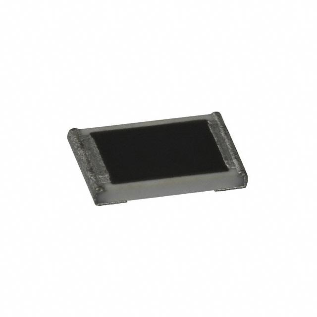

    330 Ohms ±5% 0.03W,1/32W 芯片电阻 01005(0402 公制) 厚膜
ERJ-XGEJ331Y 数据手册
Thick Film Chip Resistors Thick Film Chip Resistors Type: ERJ XG, 1G, 2G, 3G, 6G, 8G, 14, 12, 12Z, 1T Features ● Small size and lightweight reliability Metal glaze thick film resistive element and three layers of electrodes ● Compatible with placement machines Taping packaging available ● Suitable for both reflow and flow soldering ● Reference Standards IEC 60115-8, JIS C 5201-8, EIAJ RC-2134B ● AEC-Q200 qualified (Exemption ERJXG) ● RoHS compliant ● High ■ As for Packaging Methods, Land Pattern, Soldering Conditions and Safety Precautions, Please see Data Files Explanation of Part Numbers ● ERJXGN, 1GN, 2GE, 3GE, 6GE, 8GE, 14, 12, 12Z, 1T Type, ±5 % 1 2 3 4 5 6 7 8 9 10 11 12 E R J 3 G E Y J 1 0 2 V Product Code Thick Film Chip Resistors Size, Power Rating Code Inch Power R. XGN 01005 0.031 W 0.05 W 1GN 0201 0.1 W 2GE 0402 0.1 W 3GE 0603 6GE 0805 0.125 W 0.25 W 8GE 1206 0.5 W 14 1210 0.75 W 12 1812 0.75 W 12Z 2010 1W 1T 2512 Code Resistance Tolerance Marking Marking Code J 0 Tolerance ±5 % Jumper Code Packaging Methods Packaging Part No. Y Pressed Carrier Taping W8P2, 20,000 pcs. U Embossed Carrier Taping W4P1, 40,000 pcs. Resistance Value C Pressed Carrier Taping 2 mm pitch, 15,000 pcs. ERJ1GN The first two digits are significant figures of resistance and the third one denotes number of zeros following. Decimal Point is expressed by R as 4.7 = 4R7. Jumper is expressed by R00. X Punched Carrier Taping 2 mm pitch, 10,000 pcs. Y Punched Carrier Taping 2 mm pitch, 20,000 pcs. V Punched Carrier Taping 4 mm pitch, 5,000 pcs. Y ✽Nil Value Marking on black side No marking ✽ When omitted, the rest of the P/N factors shall be moved up respectively. (Only XGN, 1GN, 2GE type) U ERJXGN ERJ2GE ERJ3GE ERJ6GE ERJ8GE ERJ14 Embossed Carrier Taping ERJ12 4 mm pitch, 5,000 pcs. ERJ12Z Embossed Carrier Taping ERJ1T 4 mm pitch, 4,000 pcs. Design and specifications are each subject to change without notice. Ask factory for the current technical specifications before purchase and/or use. Should a safety concern arise regarding this product, please be sure to contact us immediately. 05 Mar. 2015 Thick Film Chip Resistors Construction Dimensions in mm (not to scale) L a W Protective coating Electrode (Inner) Alumina substrate t b Dimensions (mm) Part No. (inch size) ERJXG (01005) ERJ1G (0201) ERJ2G (0402) ERJ3G (0603) ERJ6G (0805) ERJ8G (1206) ERJ14 (1210) ERJ12 (1812) ERJ12Z (2010) ERJ1T (2512) Electrode (Between) Thick film resistive element Electrode (Outer) Mass (Weight) (g/1000 pcs.) L W a b t 0.40±0.02 0.20±0.02 0.10±0.03 0.10±0.03 0.13±0.02 0.04 ±0.03 ±0.03 ±0.05 ±0.05 ±0.03 0.15 ±0.05 0.8 ±0.10 2 ±0.10 4 ±0.10 10 ±0.10 0.60 ±0.05 1.00 ±0.15 1.60 ±0.20 2.00 +0.05 –0.20 3.20 ±0.20 0.30 ±0.05 0.50 +0.15 –0.05 0.80 ±0.10 1.25 +0.05 –0.15 1.60 ±0.20 0.10 ±0.10 0.20 ±0.20 0.30 ±0.20 0.40 ±0.20 0.50 ±0.20 0.15 ±0.05 0.25 ±0.15 0.30 ±0.20 0.40 ±0.20 0.50 ±0.20 0.23 0.35 0.45 0.60 0.60 3.20 2.50 0.50 0.50 0.60 16 4.50±0.20 3.20±0.20 0.50±0.20 0.50±0.20 0.60±0.10 27 5.00±0.20 2.50±0.20 0.60±0.20 0.60±0.20 0.60±0.10 27 ±0.20 ±0.20 ±0.20 ±0.20 ±0.10 45 6.40 3.20 0.65 0.60 0.60 Ratings [For Resistor] Part No. (inch size) Power Rating Limiting Element Maximum Overload Resistance Voltage(1) Voltage(2) Tolerance at 70 °C (%) (W) (V) (V) Resistance Range (Ω) T.C.R. (×10–6/°C) Category Temperature Range (°C) ERJXG (01005) 0.031 15 30 ±5 –55 to +125 ERJ1G
ERJ-XGEJ331Y
物料型号:文档列出了多种型号,包括ERJ XG, 1G, 2G, 3G, 6G, 8G, 14, 12, 12Z, 1T。
器件简介:这些是薄膜芯片电阻器,具有小尺寸、轻量级、高可靠性的特点。它们使用金属釉料厚膜电阻元件和三层电极,并且兼容自动贴装机。
引脚分配:文档中没有明确提到引脚分配,但通常这类电阻器是无引脚的表面贴装元件。
参数特性:电阻器符合多种国际标准,如IEC 60115-8, JIS C 5201-8, EIAJ RC-2134B,并通过了AEC-Q200认证(ERJXG型号除外)。它们还符合RoHS标准。
功能详解:文档提供了电阻值的编码方式,例如“4R7”表示4.7欧姆,“R00”表示跳线。还提供了不同尺寸的电阻器的尺寸、重量、功率额定值、电阻公差、电阻范围、温度系数以及工作温度范围。
应用信息:这些电阻器适用于回流焊和波峰焊,并且有多种包装方法,如带式包装。
封装信息:提供了不同型号的电阻器的尺寸和重量,以及它们的功率额定值和电阻公差。
