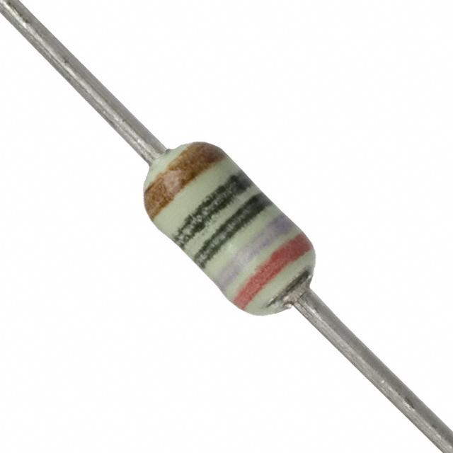

    NAIS(松下)
    插件,D1.7xL3.2mm
    270 Ohms ±1% 0.25W,1/4W 轴向 通孔电阻器 金属薄膜
ERO-S2PHF2700 数据手册
Discontinued Metal Film Resistors Metal Film Resistors Type: EROS2 (0.25 W) ERO25 (0.25 W) ■ Features ● Performance, Reliability...... Low T.C.R. and noise, high reliability ● Automatic insertion ............. Taping style for automatic inserting machine ● Marking............................... 5 color code marking ● Reference Standards ......... IEC 60115-2, JIS C 5201-2 ■ Explanation of Part Numbers 1 2 3 4 5 6 7 8 9 10 11 12 E R O S 2 C H F 1 0 0 2 Product Code Metal Film Resistors Special Feature and Cut & Formed Style Power Rating at 70 °C Amb. S2 25 0.25 W 0.25 W C P T Standard Taped & Box (52 mm) Taped & Box (26 mm) ■ Construction Temperature Coefficient ҂10–6/°C(ppm/°C) ± 50 H Resistance Tolerance D F ■ Dimensions in mm (not to scale) H Metal film ± 0.5 % ±1% Resistance Value The first three digits are significant figures of resistance and the 4th digit denote number of zeros following. Decimal point is expressed by R as 97.6 = 97R6. L Lead wire fd 1st significant figure Ceramic core, high thermal conductivity fD H Insulative coating 2nd significant figure Resistance tolerance 3rd significant figure Multiplier Standard Quantity : 2000 pcs. Spiraling Marking Dimensions (mm) Type L EROS2C 3.20 ERO25C 6.30 ±0.20 fD +0.20 1.70 –0.10 fd 0.45 ±0.05 H 30 ±3 Mass (Weight) [mg/pc.] 107 End cap ±0.50 2.30 ±0.50 0.60 ±0.05 30 Design and specifications are each subject to change without notice. Ask factory for the current technical specifications before purchase and/or use. Should a safety concern arise regarding this product, please be sure to contact us immediately. ±3 228 Feb. 2006 Discontinued Metal Film Resistors ■ Ratings Limiting Element Voltage (1) (Maximum RCWV) (V) Power Rating at 70 °C (W) Type Maximum Overload (2) Voltage (V) Dielectric Withstanding Voltage (VAC) Resistance Tolerance (%) T.C.R. –6 [҂10 /°C (ppm/°C)] EROS2 0.25 250 500 300 ±50 ERO25 0.25 250 500 500 ±50 F(±1) D(±0.5) F(±1) D(±0.5) Resistance ResisRange tance (액) Value min. max. 10 1 M 10 1 M E24 E96 E24 E96 (1) Rated Continuous Working Voltage (RCWV) shall be determined from RCWV= =앀Power Rating҂Resistance Value, or Limiting Element Voltage (maximum RCWV) listed above, whichever less. (2) Overload (Short-time Overload) Test Voltage (SOTV) shall be determined from SOTV=2.5҂Power Rating or max. Overload Voltage listed above whichever less. Power Derating Curve For resistors operated in ambient temperatures above 70 °C, power rating shall be derated in accordance with the figure on the right. Rated Load (%) 120 100 –55 °C 70 °C 80 60 40 20 0 –60 –40 –20 0 150 °C 20 40 60 80 100 120 140 160 180 Ambient Temperature (°C) ■ Shape and Packaging ● Axial taping type 6±1 3.2 min. L 0.5 max. Shape P 0 L1 0.8 max. L2 1 max. P fD fd 0.5 max. W 1 2 3 4 L max. 3.4 3.4 6.5 6.5 fD max. 1.9 1.9 2.5 2.5 fd 0.45 0.45 0.6 0.6 P ±0.3 5.0 5.0 5.0 5.0 W W0 26+1 –0 52±1 +1 26 – 0 52±1 41.5max. 64.5±0.5 41.5max. 64.5±0.5 쪧 |L1– L 2|

物料型号: - EROS2 (0.25 W) - ERO25 (0.25 W)
器件简介: - 这些金属膜电阻器具有高性能、高可靠性,低温度系数(T.C.R.)和噪声。
引脚分配: - 文档中未明确提供引脚分配信息,但通常金属膜电阻器为两端引脚。
参数特性: - 电阻值:由前三位数字表示,第四位表示零的数量。例如,97.6Ω表示为97R6。 - 温度系数:10^-6/°C(ppm/°C) - 电阻公差:±1% 或 ±0.5% - 功率等级:0.25 W - 额定工作电压:70°C环境下,EROS2和ERO25均为250V。
功能详解: - 自动插入:适合自动插入机的带状风格。 - 标记:5色代码标记。 - 参考标准:IEC 60115-2, JIS C 5201-2。
应用信息: - 电阻器设计用于一般电子设备,如音视频设备、家用电器、办公设备、信息和通信设备等。
封装信息: - 提供了不同尺寸和形状的封装,包括轴向胶带封装和扁平盒封装。 - 标准数量:2000件/箱。
安全注意事项: - 遵守额定功率和环境温度的降额曲线。 - 如果预计会有瞬态负载(如脉冲),在实际使用前检查和评估安装在产品中的电阻器的操作。 - 如果电阻器的保护涂层受损,可能会影响电阻器的特性。
设计和规格: - 设计和规格如有变更,恕不另行通知。在购买和/或使用前,请向工厂询问当前的技术规格。 - 如果此产品出现安全问题,请立即与我们联系。
