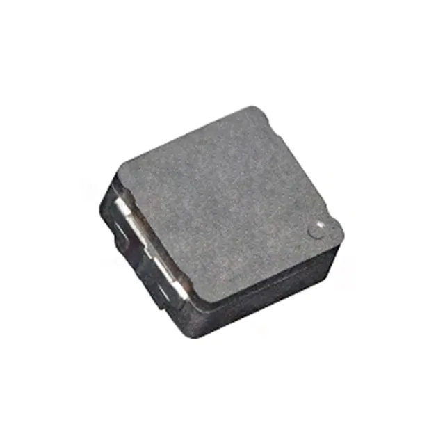

Power Inductors Power Choke Coil (Automotive Grade) PCC-M0530M-H series PCC-M0630M-H series High heat resistance and high reliability using metal composite core (MC) Features ● Reduce core loss in high frequency band (More than 2 MHz) ● High heat resistance : Operation up to 150 ℃ including self-heating ● Low profile : 3mm max. height ● SMD type : High vibration resistance as result of newly developed integral construction ; ● High-reliability under severe reliability conditions of automotive and other strenuous applications ● High bias current : Excellent inductance stability using ferrous alloy magnetic material ● Temp. stability : Excellent inductance stability over broad temp. range ● Low audible (buzz) noise : A gapless structure achieved with metal composite core ● High efficiency : Low DC resistance of winding and low eddy-current loss of the core ● Shielded construction ● AEC-Q200 compliant ● RoHS compliant Recommended applications ● Noise filter for various drive circuitry requiring high temp. operation and peak current handling capability ● Boost-Converter, Buck-Converter DC/DC Standard packing quantity (Minimum quantity/Packing unit) ● 2,000 pcs/box (2 reel) Explanation of part numbers 1 2 3 4 E T Q P Product code 5 Classification 6 7 8 9 M Height Inductance Winding 10 11 H F Core Suffix 12 Size (Example) Code Inductance Code Size 2R2 2.2 μH P □ 5 mm 100 10 μH N □ 6 mm Temperature rating Operating temperature range Storage condition After PWB mounting Before PWB mounting Tc : -40 ℃ to +150 ℃ (Including self-temperature rise) Ta : -5 ℃ to +35 ℃ 85%RH max. Design and specifications are each subject to change without notice. Ask factory for the current technical specifications before purchase and/or use. Should a safety concern arise regarding this product, please be sure to contact us immediately. 6-Aug-21 Power Choke Coil (Automotive Grade) PCC-M0530M-H / PCC-M0630M-H series (ETQP3M□□□HFP/ETQP3M□□□HFN) Standard parts DCR (at 20 ℃) (mΩ) Inductance*1 Part No. L0 (μH) ETQP3M2R2HFP 2.2 ETQP3M100HFN 10.0 Tolerance Tolerance (%) 19.5 (21.45) ±20 ±20 68.0 (74.8) 144.0 (158.4) 22.0 ETQP3M220HFN Typ. (max.) (%) MSL level Rated current (A) Typ. *2 △T= 40 K Series [Size (mm)] △L= –30 %*4 *5 6.3 (5.2) 9.0 1 PCC-M0530M-H [5.5×5.0×3.0] 3.7 (3.0) 5.5 1 PCC-M0630M-H 2.5 (2.1) 4.0 1 [6.5×6.0×3.0] ( )*3 *1: Measured at 100 kHz *2: The proved current value for making the overall temperature rise of 40K, when mounted on a multi-layer board with high-heat dissipation (heat dissipation constant : approx. 20 K/W). *3: The proved current value for making the overall temperature rise of 40K, when mounted on a 4-layer circuit board of FR4 t=1.6 mm and DC current is applied. *4: Saturation rated current : DC current which causes L(0) drop –30 %. *5: The solderability is guaranteed for 1 year only. The product out of expiration date shall not be used. ◆ Within a suitable application, the part’s temperature depends on circuit design and certain heat dissipation conditions. This should be double checked in a worst case operation mode. In normal case, the max.standard operating temperature of +150°C should not be exceeded. For higher operating temperature conditions, please contact Panasonic representative in your area. Performance characteristics (Reference①) ● Inductance vs DC Current 12 10 2.0 Inductors (μH) Inductors (μH) [ ETQP3M100HFN ] [ ETQP3M2R2HFP ] 2.5 1.5 1.0 0.5 0 0 2 4 6 10 8 12 14 DC Bias (A) 8 6 4 2 0 0 1 2 3 4 5 6 7 8 9 DC Bias (A) [ ETQP3M220HFN ] 25 Inductors (μH) 20 15 10 5 0 0 1 2 3 4 5 6 7 8 DC Bias (A) Design and specifications are each subject to change without notice. Ask factory for the current technical specifications before purchase and/or use. Should a safety concern arise regarding this product, please be sure to contact us immediately. 6-Aug-21 Power Choke Coil (Automotive Grade) Performance characteristics (Reference②) ● Case Temperature vs DC Current PWB condition A : Four-layer PWB (1.6 mm FR4).*3 PWB condition B : Multilayer PWB with high heat dissipation performance.*2 [ ETQP3M100HFN ] Temperature rise ΔT(K) Temperature rise ΔT(K) [ ETQP3M2R2HFP ] 80 60 40 20 0 0 1 2 3 4 5 6 7 8 80 60 40 20 0 0 1 2 DC Bias (A) 3 4 5 6 DC Bias (A) Temperature rise ΔT(K) ETQP3M2208/208/208/20HFN 80 60 40 20 0 0 1 2 3 4 DC Bias (A) Design and specifications are each subject to change without notice. Ask factory for the current technical specifications before purchase and/or use. Should a safety concern arise regarding this product, please be sure to contact us immediately. 6-Aug-21 Power Choke Coil (Automotive Grade) Dimensions in mm (not to scale) Dimensional tolerance unless noted : ±0.5 Series PCC-M0530M-H Series PCC-M0630M-H (ETQP3M□□□HFP) (ETQP3M□□□HFN) Suffix Inductance 1.5 Polarity 0.05 min. 3.0 max. Date Code 3.0±0.3 6.0±0.4 3.0±0.3 5.0±0.4 1.2±0.4 1.2±0.4 Polarity 0.05 min. Date Code Suffix 6.5±0.4 5.5±0.4 1.5 3.0 max. Inductance Unit : mm Recommended land pattern in mm (not to scale) Dimensional tolerance unless noted : ±0.5 Series PCC-M0530M-H Series PCC-M0630M-H (ETQP3M□□□HFP) (ETQP3M□□□HFN) 3.6 6.0 3.6 7.0 7.1 6.1 2.2 7.2 2.8 8.8 ※Don't wire on the pattern on shaded portion the PWB. Unit : mm ■ As for soldering conditions and safety precautions (Power choke coils (Automotive grade)), please see data files Design and specifications are each subject to change without notice. Ask factory for the current technical specifications before purchase and/or use. Should a safety concern arise regarding this product, please be sure to contact us immediately. 6-Aug-21 Power Choke Coil (Automotive Grade) Packaging methods (Taping) ● Embossed carrier tape dimensions in mm (not to scale) P0 t1 E P2 øD0 B W F A t2 P1 Tape running direction Unit : mm Series A B W E F P1 PCC-M0530M-H 5.6 6.1 16 1.75 7.5 12 PCC-M0630M-H 7.1 6.6 16 1.75 7.5 12 P2 P0 øD0 t1 t2 4 1.5 0.4 3.3 2 4 1.5 0.4 3.3 2 ● Taping reel dimensions in mm (not to scale) Unit : mm Series E PCC-M0530M-H C B PCC-M0630M-H A B C øD E W 330 (100) 13 21 2 17.5 øD W A Parts mounting (Taping) SeriesPCC-M0630M-H Terminal Series PCC-M0530M-H Standard packing quantity / Reel Serise Part No. PCC-M0530M-H ETQP3M□□□HFP PCC-M0630M-H ETQP3M□□□HFN Minimum quantity / Packing unit Quantity per reel 2,000 pcs / box(2 reel) 1,000 pcs Design and specifications are each subject to change without notice. Ask factory for the current technical specifications before purchase and/or use. Should a safety concern arise regarding this product, please be sure to contact us immediately. 6-Aug-21 Guidelines and precautions regarding the technical information and use of our products described in this online catalog. ■ If you want to use our products described in this online catalog for applications requiring special qualities or reliability, or for applications where the failure or malfunction of the products may directly jeopardize human life or potentially cause personal injury (e.g. aircraft and aerospace equipment, traffic and transportation equipment, combustion equipment, medical equipment, accident prevention, anti-crime equipment, and/or safety equipment), it is necessary to verify whether the specifications of our products fit to such applications. Please ensure that you will ask and check with our inquiry desk as to whether the specifications of our products fit to such applications use before you use our products. ■ The quality and performance of our products as described in this online catalog only apply to our products when used in isolation. Therefore, please ensure you evaluate and verify our products under the specific circumstances in which our products are assembled in your own products and in which our products will actually be used. ■ If you use our products in equipment that requires a high degree of reliability, regardless of the application, it is recommended that you set up protection circuits and redundancy circuits in order to ensure safety of your equipment. ■ The products and product specifications described in this online catalog are subject to change for improvement without prior notice. Therefore, please be sure to request and confirm the latest product specifications which explain the specifications of our products in detail, before you finalize the design of your applications, purchase, or use our products. ■ The technical information in this online catalog provides examples of our products' typical operations and application circuits. We do not guarantee the non-infringement of third party's intellectual property rights and we do not grant any license, right, or interest in our intellectual property. ■ If any of our products, product specifications and/or technical information in this online catalog is to be exported or provided to non-residents, the laws and regulations of the exporting country, especially with regard to security and export control, shall be observed. ■ The switchover date for compliance with the RoHS Directive/REACH Regulations varies depending on the part number or series of our products. ■ When you use the inventory of our products for which it is unclear whether those products are compliant with the RoHS Directive/REACH Regulation, please select "Sales Inquiry" in the website inquiry form and contact us. We do not take any responsibility for the use of our products outside the scope of the specifications, descriptions, guidelines and precautions described in this online catalog. 16-Apr-21 Power Choke Coil (Automotive Grade)   Application Guidelines (Automotive grade) Safety precautions ・ When using our products, no matter what sort of equipment they might be used for, be sure to make a written ・ ・ ・ agreement on the specifications with us in advance. The design and specifications in this catalog are subject to change without prior notice. Do not use the products beyond the specifications described in this catalog. This catalog explains the quality and performance of the products as individual components. Before use, check and evaluate their operations when installed in your products. Install the following systems for a failsafe design to ensure safety if these products are to be used in equipment where a defect in these products may cause the loss of human life or other significant damage, such as damage to vehicles (automobile, train, vessel), traffic lights, medical equipment, aerospace equipment, electric heating appliances, combustion/gas equipment, rotating equipment, and disaster/crime prevention equipment. ✽ Systems equipped with a protection circuit and a protection device. ✽ Systems equipped with a redundant circuit or other system to prevent an unsafe status in the event of a single fault. Precautions for use 1. Provision to abnormal condition This power choke coil itself does not have any protective function in abnormal condition such as overload, short-circuit and open-circuit conditions, etc. Therefore, it shall be confirmed as the end product that there is no risk of smoking, fire, dielectric withstand voltage, insulation resistance, etc. in abnormal conditions to provide protective devices and/or protection circuit in the end product. 2. Temperature rise Temperature rise of power choke coil depends on the installation condition in end products. It shall be confirmed in the actual end product that temperature rise of power choke coil is in the limit of specified temperature class. 3. Dielectric strength Dielectric withstanding test with higher voltage than specific value will damage Insulating material and shorten its life. 4. Water This Power choke coil must not be used in wet condition by water, coffee or any liquid because insulation strength becomes very low in such condition. 5. Potting If this power choke coil is potted in some compound, coating material of magnet wire might be occasionally damaged. Please ask us if you intend to pot this power choke coil. 6. Model When this power choke coil is used in a similar or new product to the original one, it might be unable to satisfy he specifications due to difference of condition of usage. Please ask us if you use this power choke coil in the manner such as above. 7. Drop If the power choke coil receives mechanical stress such as drop, characteristics may become poor (due to damage on coil bobbin, etc.). Never use such stressed power choke coil. 8. Buzz Noise When this coil is used in the frequency band of the audible range (≒ 20 Hz to 20 kHz), or, when using in burst mode, depending on the operating conditions (conditions of the energized waveform) sounds (buzz noise) may occur. Depending on the circuit / board installation environment it may be heard as abnormal sounds, so please check in advance. 9. Solvent (Series MC) If this power choke coil is dipped in the cleaning agent, and the coating agent of the toluene and the xylene system, there is a possibility that the performance decreases greatly. Please ask us if you intend to pot this power choke coil. 10. Static electricity measures (Series MC) ①Circuit design Please set up the ESD measures parts such as capacitors in the former steps of this power choke coil for static electricity when there is a possibility that static electricity is impressed to the choke coil on the circuit. Moreover, please consult our company about such a case once. 1-Oct-19 Power Choke Coil (Automotive Grade) ②Treatment with single Take countermeasures against static electricity when using single power choke coil. (process and equipment) There is a possibility that the characteristic changes when the voltage of 200 V or more is impressed to this power choke coil. Please handle 200 V or less. 11. Printed circuit board design ①Land pattern and Via which exceed Operating Voltage, should not be placed top layer PWB under the products for keeping isolation between inside coil and surface of PWB. (Series DUST) ②To the opposing part in this power choke coil bottom please install neither pattern nor the beer, etc. (Series MC) 8 8.4 3.8 The opposing part in the choke coil bottom 2.8 10 ③Parts arranged around this power choke coil do not touch the surface of this power choke coil (Top side and side). (Series MC) The opposing part in the choke coil bottom Side Top side (PWB) Side ④This power choke coil is different from the ferrite core-type that installs general concentration GAP. It has the leakage magnetic bunch distribution of the choke coil to the vertical direction. Please be cautious when using parts and circuit compositions which are easily affected by the leakage flux. 12. Other using emviroment This power choke coil is not designed for the use in the following, special environment. Therefore, please do not use it in the following special environment. ・Use in place where a lot of causticity gases such as sea breeze, Cl2, H2S, NH3, SO2, and NOx exist. ・Use in place where out-of-door exposure and direct sunshine strike. 13. Core Chipping and Core Crack This choke coil has a possibility to make partial chipping or crack in the core due to excessive mechanical stress from outside, and might have initially a partial chipping and/or cracks that do not affect the quality. 14. Keeping environment If this power choke coil is kept under following environment and condition, there is a possibility that the performance and soldering decreases greatly. ・Keep in place where a lot of causticity gases such as sea breeze, Cl2, H2S, NH3, SO2, and NOx exist. ・Keep in place where out-of-door exposure and direct sunshine strike. <Package markings> Package markings include the product number, quantity, and country of origin. In principle, the country of origin should be indicated in English.  AEC-Q200 Compliant The products are tested based on all or part of the test conditions and methods defined in AEC-Q200. Please consult with Panasonic for the details of the product specification and specific evaluation test results, etc., and please review and approve Panasonic's product specification before ordering. 1-Oct-19
