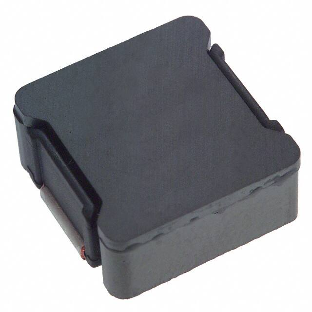

    FIXED IND 800NH 14.2A 2.24 MOHM
ETQ-P6F0R8LFA 数据手册
Choke Coils Power Choke Coil Series: PCC-F126F (N6) Thin, compact and high power ■ Features ● ● ● ● High power (Isat 20 A /100 °C) Thin profile (5.7 mm height)/SMD Low leakage flux RoHS compliant ■ Recommended Applications ● DC-DC converter for driving PCs at high speed ● On-board power supply module for DC-DC converters (10 to 40 W) ■ Standard Packing Quantity ● 500 pcs./Reel ■ Explanation of Part Numbers 1 2 3 4 & 5 2 1 Product code 5 6 7 8 9 10 11 12 Core Packaging Suffix ' Classification Size Winding Inductance ■ Standard Parts Parts No. Type Initial inductance at 25 °C L0 (μH) ETQP6F1R2HFA ETQP6F2R0HFA ETQP6F3R2HFA ETQP6F4R6HFA ETQP6F6R4HFA ETQP6F8R2HFA ETQP6F102HFA ETQP6F1R0SFA ETQP6F1R6SFA ETQP6F2R5SFA ETQP6F3R5SFA ETQP6F0R8LFA ETQP6F1R3LFA ETQP6F2R0LFA ETQP6F2R9LFA ETQP6F4R1LFA HL SP LB 2.3 3.5 4.8 6.6 8.3 10.4 12.5 1.9 2.8 3.6 4.9 1.8 2.5 3.1 4.1 5.0 Tol. (%) ±30 ±25 ±30 ±20 Inductance at flat point at 25 °C L1 (μH) 1.2 2.0 3.2 4.6 6.4 8.2 10.2 1.0 1.6 2.5 3.5 0.8 1.3 2.0 2.9 4.1 Tol. (%) ±30 ±25 ±30 ±20 Saturation current at 25 °C at 100 °C I sat I sat (A) (A) min. min. 14.3 11.7 10.7 8.7 8.6 7.1 7.3 6.0 6.2 5.2 6.0 5.0 4.7 4.0 19.4 15.4 14.9 12.2 11.3 9.3 9.5 8.0 25.2 20.0 18.6 15.8 15.1 12.1 12.0 10.0 10.8 8.7 Heat DC resistance current at 20 °C ΔT=40 °C I 0 (A) 14.2 12.5 10.8 9.3 7.9 7.2 6.5 14.2 12.5 10.8 9.3 14.2 12.5 10.8 9.3 7.9 RDC (mΩ) max. 2.24 3.30 4.92 6.48 8.64 10.90 13.30 2.24 3.30 4.92 6.48 2.24 3.30 4.92 6.48 8.64 (Note1) Inductance is measured at 100 kHz (Note2) For definitions of L0 & L1 please see the next page (Note3) Saturation current (I sat) is the current value that inductance (L1) decreases to 80 % of initial value. (Note4) Heat current (I0) is the actual value of the current at which the temperature rise of the coil becomes 40 dc from its initial (ambient temperature) value. The case temperature of the power choke coil is determined by the ambient temperature plus the heat generated by the operating current. Design and specifications are each subject to change without notice. Ask factory for the current technical specifications before purchase and/or use. Should a safety concern arise regarding this product, please be sure to contact us immediately. 01 Oct. 2012 Choke Coils ■ Figure 1: L0,L1:Definition DC Bias Characteristic L0 L (μH) L1 L0 : (Initial Inductance) Inductance when Idc is zero L1 : (Inductance at flat point) point where the measured inductance is 80 % of its initial value 0 0 Idc (A) ■ Figure 2: Dimensions in mm (not to scale) ■ Recommended Land Pattern in mm (not to scale) 5.6 (6.0) 12.5±0.4 12.5±0.3 6 Date code 5.7 max. MARKING 1.2±0.2 10.8 2.0 ( ) : Reference value 0.05 min.: Clearance between the Terminal surface and the case surface 2.1 min. 8.0±0.2 5.0±0.1 8.0±0.2 0.6 min. 2.0 (10.0) 1.2±0.2 1.3±0.2 0.3 min.: Clearance between the Terminal surface and the surface of the molded resin case ■ Packaging Methods, Soldering Conditions and Safety Precautions (Power Choke Coils for Consumer use) Please see Data Files Design and specifications are each subject to change without notice. Ask factory for the current technical specifications before purchase and/or use. Should a safety concern arise regarding this product, please be sure to contact us immediately. 01 Oct. 2012 Choke Coils ■ Packaging Methods (Taping) ● Embossed Carrier Tape Dimensions in mm (not to scale) P0 B Tape running direction P1 Power Choke Coils for consumer use Series A PCC-M0512W 5.6 PCC-M0630L 7.1 PCC-M0630W 7.2 PCC-M0730L 7.6 PCC-M074L 7.6 PCC-M104W 10.6 PCC-M104L 10.6 PCC-M125L 13.1 PCC-D124H PCC-D125H 13.5 PCC-D126H PCC-D126F 13.0 PCC-F126F B 5.85 8.0 7.5 8.9 8.9 11.0 11.8 14.8 13.5 t2 F W A Power Choke Coils for high reliability use Series A B PCC-M0530M 5.6 6.1 PCC-M0540M PCC-M0630M 7.1 6.6 PCC-M0645M PCC-M0754M 8.1 7.6 PCC-M0854M/M0850M 9.1 8.6 PCC-M1054M/M1050M 10.7 11.9 PCC-M1050ML/M1060ML t1 E P2 0 fD W E 16.0 F P1 7.5 12.0 1.75 P2 P0 fD0 2.0 4.0 1.5 t1 t2 3.3 4.3 3.3 5.0 0.4 6.0 24.0 W 12.0 E 16.0 11.5 16.0 F 5.5 P1 8.0 7.5 12.0 P2 P0 fD0 0.5 6.3 t1 t2 1.4 3.2 3.3 4.2 4.3 1.75 24.0 2.0 11.5 4.0 1.5 0.4 5.2 5.3 16.0 5.2 6.2 13.0 6.0 ● Taping Reel Dimensions in mm (not to scale) B E C D W A Power Choke Coils for high reliability use Series PCC-M0530M/M0540M PCC-M0630M/M0645M PCC-M0754M PCC-M0854M/M0850M PCC-M1054M/M1050M PCC-M1050ML/M1060ML A B C D E 330 100 13 21 2 W 17.5 25.5 Power Choke Coils for consumer use Series PCC-M0512W PCC-M0630L/M0630W PCC-M104W PCC-M0730L/M074L PCC-M104L PCC-M125L/D124H/D125H/ D126H/D126F/F126F A B (80) C D E 13 21 2 330 80 380 W 13.5 17.5 25.5 17.5 25.4 Design and specifications are each subject to change without notice. Ask factory for the current technical specifications before purchase and/or use. Should a safety concern arise regarding this product, please be sure to contact us immediately. 04 Dec. 2013 Choke Coils ■ Component Placement (Taping) ● Power Choke Coils for high reliability use ● Power Choke Coils for consumer use Series M0630M/M0645M M0754M M0854M/M0850M Series M0512W/M0630W/M104W Terminal Series M0630L/M0730L/M074L/M104L/ M125L/D126F/F126F Terminal Series M0530M/M0540M M1054M/M1050M M1050ML/M1060ML Series D124H/D125H/D126H ■ Standard Packing Quantity/Reel ● Power Choke Coils for high reliability use Series PCC-M0530M/M0540M PCC-M0630M PCC-M0645M PCC-M0754M PCC-M0854M/M0850M PCC-M1054M/M1050M PCC-M1050ML/M1060ML Minimum Quantity / Packing Unit Quantity per reel 2000 pcs. / box (2 reel) 1000 pcs. 1000 pcs. / box (2 reel) 500 pcs. ● Power Choke Coils for consumer use Series PCC-M0512W PCC-M0730L PCC-M074L PCC-M0630L PCC-M0630W PCC-M104L PCC-M104W PCC-M125L PCC-D124H PCC-D125H PCC-D126H PCC-D126F PCC-F126F Minimum Quantity / Packing Unit 6000 pcs. / box (2 reel) Quantity per reel 3000 pcs. 3000 pcs. / box (2 reel) 1500 pcs. 2000 pcs. / box (2 reel) 1000 pcs. 1000 pcs. / box (2 reel) 500 pcs. Design and specifications are each subject to change without notice. Ask factory for the current technical specifications before purchase and/or use. Should a safety concern arise regarding this product, please be sure to contact us immediately. 04 Dec. 2013 Choke Coils Soldering Conditions Temperature (°C) ■ Reflow soldering conditions T3 T2 T1 t2 t1 0 Time ● Pb free solder recommended temperature profile Power Choke Coils for high reliability use Series PCC-D1413H PCC-M0530M/M0540M PCC-M0630M/M0645M PCC-M0754M PCC-M0854M/M0850M PCC-M1054M/M1050M PCC-M1050ML/M1060ML Preheat Soldering T1 [°C] t1 [s] T2 [°C] t2 [s] 150 to 170 60 to 120 230 °C 30 to 40 Peak Temperature T3 T3 Limit Time of Reflow 250 °C, 5 s 260 °C, 10 s 2 times max. Power Choke Coils for consumer use Series PCC-M0512W PCC-M0630L PCC-M0630W PCC-M0730L PCC-M074L PCC-M104L PCC-M104W PCC-M125L PCC-D124H PCC-D125H PCC-D126H PCC-D126F PCC-F126F Preheat Soldering T1 [°C] t1 [s] T2 [°C] t2 [s] 150 to 170 60 to 120 230 °C 30 to 40 Peak Temperature T3 T3 Limit Time of Reflow 250 °C, 5 s 260 °C, 10 s 2 times max. Design and specifications are each subject to change without notice. Ask factory for the current technical specifications before purchase and/or use. Should a safety concern arise regarding this product, please be sure to contact us immediately. 04 Dec. 2013 Choke Coils Safety Precautions (Common precautions for Power Choke Coils for consumer use) • When using our products, no matter what sort of equipment they might be used for, be sure to make a written agreement on the specifications with us in advance. The design and specifications in this catalog are subject to change without prior notice. • Do not use the products beyond the specifications described in this catalog. • This catalog explains the quality and performance of the products as individual components. Before use, check and evaluate their operations when installed in your products. • Install the following systems for a failsafe design to ensure safety if these products are to be used in equipment where a defect in these products may cause the loss of human life or other significant damage, such as damage to vehicles (au to mo bile, train, vessel), traffic lights, medical equipment, aerospace equipment, elec tric heating appliances, combustion/gas equipment, rotating equipment, and disaster/crime prevention equipment. ✽ Systems equipped with a protection circuit and a protection device ✽ Systems equipped with a redundant circuit or other system to prevent an unsafe status in the event of a single fault Precautions for use 1. Provision to abnormal condition This power choke coil itself does not have any protective function in abnormal condition such as overload, short-circuit and open-circuit conditions, etc. Therefore, it shall be confirmed as the end product that there is no risk of smoking, fire, dielectric withstand voltage, insulation resistance, etc. in abnormal conditions to provide protective devices and/or protection circuit in the end product. 2. Temperature rise Temperature rise of power choke coil depends on the installation condition in end products. It shall be confirmed in the actual end product that temperature rise of power choke coil is in the limit of specified temperature class. 3. Dielectric strength Dielectric withstanding test with higher voltage than specific value will damage Insulating material and shorten its life. 4. Water This Power choke coil must not be used in wet condition by water, coffee or any liquid because insulation strength becomes very low in the condition. 5. Potting If this power choke coil is potted in some compound, coating material of magnet wire might be occasionally damaged. Please ask us if you intend to pot this power choke coil. 6. Detergent Please consult our company in case of this because the confirmation of reliablility etc. is needed when the washing is used for the power choke coil. 7. Storage temperature -5 °C to +35 °C 8. Operating temperature Minimum temperature : -40 °C(Ambient temperature of the power choke coil) Maximum temperature : 130 °C(Ambient temperature of the power choke coil plus the temperature rise) 100 °C(Only series : PCC-F126F(N6)) 9. Model When this power choke coil was used in a similar or new product to the original one, sometimes it might be unable to satisfy the specifications due to difference of condition of usage. Please ask us if you would use this power choke coil in the manner such as above. 10. Drop If the power choke coil suffered mechanical stress such as drop, characteristics may become poor (due to damage on coil bobbin, etc.). Never use such stressed power choke coil. Package markings include the product number, quantity, and country of origin. In principle, the country of origin should be indicated in English. Design and specifications are each subject to change without notice. Ask factory for the current technical specifications before purchase and/or use. Should a safety concern arise regarding this product, please be sure to contact us immediately. 01 Oct. 2012
