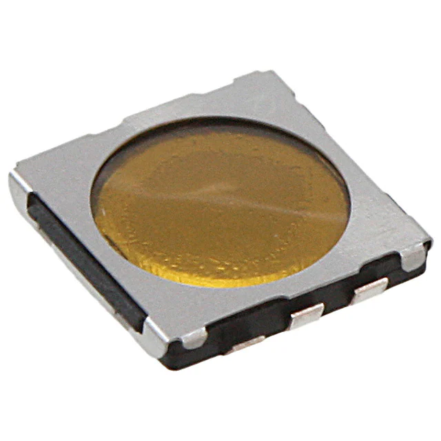

    SWITCH TACTILE SPDT 0.02A 15V
EVP-AHBD6A 数据手册
Light Touch Switches/EVPAH 4 mm Square Double-action SMD Light Touch Switches Type: EVPAH ■ Features ■ Recommended Applications ● External dimensions : 4.0 mm҂4.1 mm, Height 0.59 mm ● Long operation life ● Wide selection of double action operating variations ● Camera function (Digital still cameras, Camcorders, Mobile phones, etc.) for shutter switches. ■ Explanation of Part Numbers 1 2 3 4 5 E V P A H Product Code 6 7 A B C 9 Height Type 6th 8 Operating Force 1st 2nd 0.8 N 1.6 N 0.9 N 2.0 N 1.0 N 2.6 N 7th D E Terminal Type J-bent J-bent Positioning Boss Without With ■ Specifications Type Snap action/Push-on type SPDT Rating Contact Resistance Electrical Insulation Resistance Dielectric Withstanding Voltage Bouncing Operating Force Mechanical Travel Endurance Operating Life Operating Temperature Storage Temperature Minimum Quantity/Packing Unit Quantity/Carton 10 µA 2 Vdc to 20 mA 15 Vdc (Resistive load) 500 m액 max. 100 M액 min. (at 100 Vdc) 250 Vac for 1 minute 20 ms max. (ON, OFF) 1st : 0.8 N, 0.9 N, 1.0 N 2nd : 1.6 N, 2.0 N, 2.6 N 1st: 0.15 mm 2nd: 0.3 mm 1.6 N : 100000 cycles min. 2.0 N : 100000 cycles min. 2.6 N : 30000 cycles min. –20 °C to +70 °C –40 °C to +85 °C (Bulk) –20 °C to +60 °C (Taping) 8000 pcs. Embossed Taping (Reel Pack) 40000 pcs. Design and specifications are each subject to change without notice. Ask factory for the current technical specifications before purchase and/or use. Should a safety concern arise regarding this product, please be sure to contact us immediately. Jun. 2008 Light Touch Switches/EVPAH ■ Dimensions in mm (not to scale) EVPAH With J-bent terminals +0.1 2-4.25 –0.3 (3.4) +0.3 .3 C’ B B’ D A 1.9 C 0.5 0.5 4.1 0.2 φ3 0.5 4 –0.1 0.59 (0.63) +0.3 0.35 0.25 4.55 –0.1 Washer D terminal Ground terminal (Washer to D terminal) 1st operation C 0.75 4.8 3.4 2nd operation C’ 1.2 2.7 B’ B D A (Washer) Circuit Diagram PWB land pattern for reference (View from mounting side) ✽ C or/and C’ shall be used as common/ground terminal. (2.8) (2.7) C C’ B B’ D A Please do not Provide any Land pattern in this area. Part Numbers Boss Ground Terminal EVPAHAD6A Without EVPAHBD6A EVPAHCD6A Operating Force Height Operating Life 1.6 N 0.59 100000 cycles 0.9 N 2.0 N 0.59 100000 cycles 1.0 N 2.6 N 0.59 30000 cycles 1 th 2 th With 0.8 N Without With Without With Design and specifications are each subject to change without notice. Ask factory for the current technical specifications before purchase and/or use. Should a safety concern arise regarding this product, please be sure to contact us immediately. Mar. 2008 Light Touch Switches/EVPAH ■ Recommended Reflow Soldering Conditions ● Embossed Carrier Taping Fan or Normal Temp. Tape width=12.0 mm 230 180 t1 Feeding hole Chip pocket P2 P0 φD0 E 150 F W A B Operation Top (°C) MAX. 260 (Normal Temp.) t2 90±30 P1 Chip component Tape running direction 40±10 Soldering Time (s) Unit: mm Part No. Height A B W EVPAH 0.59 4.36±0.2 4.4±0.2 12.0 –0.1 +0.3 F E P1 P2 P0 D0 Dia. 5.5±0.1 1.75±0.1 8.0±0.1 2.0±0.1 4.0±0.1 1.5 –0 Item A +0.1 t1 t2 0.3±0.05 1.25 –0.1 +0.2 ● Standard Reel Dimensions in mm (not to scale) T E C B B Rate (mm) φ380.0±2.0 φ80.0±1.0 D r Item W Rate (mm) 13.5±1.0 A W ■ Recommended Shape of Test Pole C D E φ13.0±0.5 φ21.0±1.0 2.0±0.5 T t r 17.5±1.0 1.0 to 3.0 1.0±0.5 t ■ Recommended Operating Conditions 0.3 mm max. φ1.2 Test pole Leaning angle range 90 °±4 ° (vertical direction) Switch R0.05 Mounting surface Design and specifications are each subject to change without notice. Ask factory for the current technical specifications before purchase and/or use. Should a safety concern arise regarding this product, please be sure to contact us immediately. Mar. 2008
