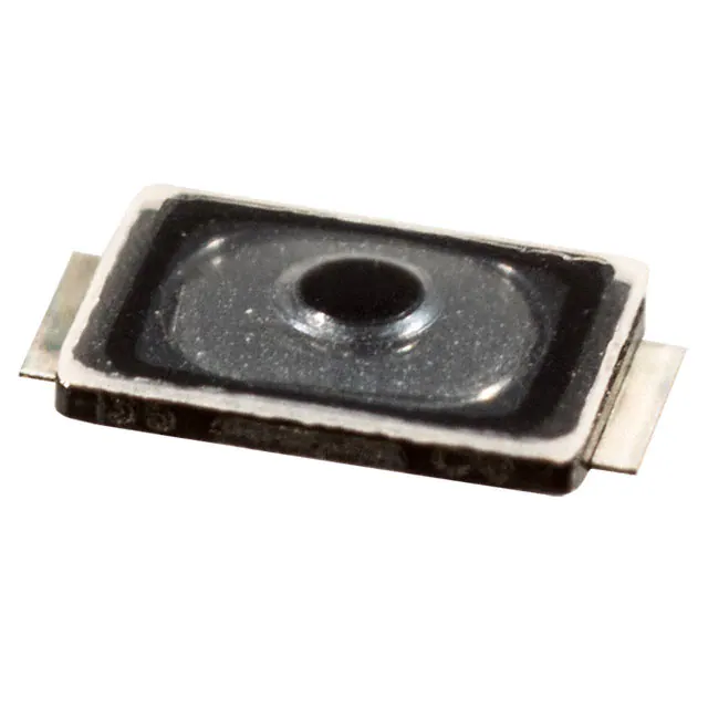

Light Touch Switches/EVPAW 3.0 mm×2.0 mm SMD Light Touch Switches Type: EVPAW ■ Features ● External dimensions : 3.0 mm×2.0 mm, Height 0.6 mm ● High operability Equipped with an actuator (push plate) ● IP67 characteristic ■ Recommended Applications ● Operation switches for portable electronic equipment (Mobile phone, Portable audio) ■ Explanation of Part Numbers 1 2 3 4 5 & 7 1 " 8 Product Code 6 7 Type 8 9 Height 7 th A D Type Terminal without cutout type Terminal with cutout type ■ Specifications Type Snap action/Push-on type SPST Rating 10 μA 2 Vdc to 20 mA 15 Vdc (Resistive load) Contact Resistance Electrical Insulation Resistance Dielectric Withstanding Voltage Bouncing Mechanical Endurance IP67(✽1) 50 MΩ min. (at 100 Vdc) 250 Vac for 1 minute 10 ms max. (ON, OFF) Operating Force 1.6 N, 2.4 N, 3.3 N Travel 1.6 N, 2.4 N : 0.13 mm 3.3 N : 0.15 mm Operating Life 1.6 N, 2.4 N : 500000 cycles min. 3.3 N : 300000 cycles min. IP6x (Dust resistance) Dust : Talc (Type4) 8h IPx7 (Water resistance) Immersion depth : 1 m 30 min. Operating Temperature Storage Temperature Minimum Quantity/Packing Unit Quantity/Carton 500 mΩ max. –40 °C to +85 °C –40 °C to +85 °C (Bulk) –20 °C to +60 °C (Taping) 10000 pcs. Embossed Taping (Reel Pack) 50000 pcs. Note: Non washable (✽1) IP67 : Switch shall not be operated during test. Water or dust ingress shall be limited enough to prevent deleterious effect to the switch function. However, IP67 shall be guaranteed under single product state, then there is a possibility that IP67 performance become impaired depending on your mounting condition or usage. So, please ask us in advance, if the switch is applied to important usage for water and dust resistant. Design and specifications are each subject to change without notice. Ask factory for the current technical specifications before purchase and/or use. Should a safety concern arise regarding this product, please be sure to contact us immediately. 02 Apr. 2015 Light Touch Switches/EVPAW ■ Dimensions in mm (not to scale) EVPAW (Embossed Taping) Terminal without cutout type General dimension tolerance : ± 0.05 ( )dimensions are reference dimensions. This reference specifications are subject to change. 0.6±0.1 without the film and remainder of the gate 2 2-1.3 (0.385) (f0.85) A A' 3.5 2-3.69 2-2.85 2-1.45 3 Without film 2-0.25 0.04±0.03 Circuit diagram 0.1 max. Stencil mask plan A A' 2-1.5 0.1 max. 3.8 2.7 PWB land pattern for reference Soldering thickness t=0.08±0.01 =Soldering failure may occur depending on applied solder amount, so, please consider to use our recommended stencil and land pattern desing. Part Numbers Operating Force Height Operating Life EVPAWBA2A 1.6 N 0.6 mm 500000 cycles EVPAWCA2A 2.4 N 0.6 mm 500000 cycles EVPAWEA2A 3.3 N 0.6 mm 300000 cycles Design and specifications are each subject to change without notice. Ask factory for the current technical specifications before purchase and/or use. Should a safety concern arise regarding this product, please be sure to contact us immediately. 02 Apr. 2015 Light Touch Switches/EVPAW ■ Dimensions in mm (not to scale) EVPAW (Embossed Taping) Terminal with cutout type General dimension tolerance : ± 0.05 ( )dimensions are reference dimensions. This reference specifications are subject to change. 2 2-1.3 (2-0.8) without the film and remainder of the gate 0.6±0.1 (0.385) 3.3 There should be cutout on the terminal (f0.85 ) A A' Circuit diagram 0.04±0.03 3 Without film 3.5 The thickness of the solder stencil shall be 0.1 mm, and the opening ratio of the solder stencil to a land pattern shall be 60 to 100 % (recommend 80 %.) 3.8 2.7 0.1max. 0.1max. No Soldering area A’ 2-1.5 A (2) (1.9) Land pattern plan =Soldering failure may occur depending on applied solder amount, so, please consider to use our recommended stencil and land pattern desing. : Recommended land pattern area : No soldering area • Any land pattern or via holes shall not be provided at area. • If it's necessary to design land pattern or via holes at area, please apply resist to them to protect their metal part completely. • If their metal parts are not protected completely, short circuit failure may occur, • Besides, there should be convexoconcave by designing additional pattern, it may cause swith tilt, influence on solder-ability or flux intrusion after reflow soldering. • Therefore, please study any influence of additioan land pattern or via holes at area in advance. Part Numbers Operating Force Height Operating Life EVPAWBD4A 1.6 N 0.6 mm 500000 cycles EVPAWCD4A 2.4 N 0.6 mm 500000 cycles EVPAWED4A 3.3 N 0.6 mm 300000 cycles Design and specifications are each subject to change without notice. Ask factory for the current technical specifications before purchase and/or use. Should a safety concern arise regarding this product, please be sure to contact us immediately. 02 Apr. 2015 Light Touch Switches/EVPAW ■ Recommended Reflow Soldering Conditions Operation Top (°C) MAX. 260 Fan or Normal Temp. 230 180 150 (Normal Temp.) 90±30 40±10 Soldering Time (s) ✽ Reflow temperature may vary by location even in the same reflow condition. Please check the reflow temperature at terminals and at the top of a switch to make sure the both temperatures are withiin the specification. If even one of them is out of the specifications, please adjust. ● Embossed Carrier Taping Tape width=12.0 mm Chip pocket E F J H A K C I D fG B Feeding hole t Tape running direction Taping condition : Lack of products in the middle of taping should be one MAX, but total quantity specified in the specifications should be secured. Peeling off strength of top tape : It should be within 0.2N to 1. ON at 165 degree in peeling off angle. Joint of carrier tape : One joint per one reel may exist. Unit: mm Part No. Height EVPAW 0.6 A B C 12.0±0.3 1.75±0.10 5.5±0.1 D E F G H I 8.0±0.1 4.0±0.1 2.0±0.1 1.5±0.3 3.8±0.2 Item A J K 2.3±0.2 0.75±0.20 (10.25) t 0.3+0.15 –0.10 ● Standard Reel Dimensions in mm (not to scale) G E C B D E 013.0±0.5 021.0±1.0 2.0±0.5 B Rate (mm) 0380.0±2.0 080.0±1.0 C D A Item F G Rate (mm) 13.5±1.0 17.5±1.0 F Design and specifications are each subject to change without notice. Ask factory for the current technical specifications before purchase and/or use. Should a safety concern arise regarding this product, please be sure to contact us immediately. 02 Apr. 2015
