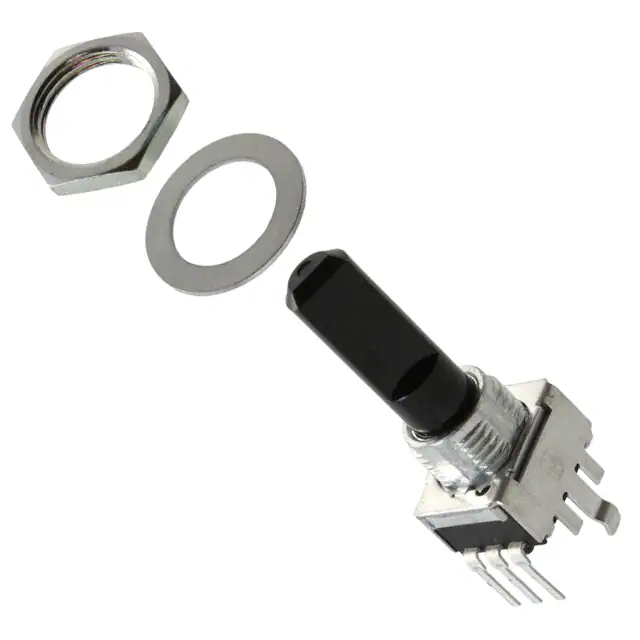

Rotary Potentiometers/EVUE/EVUF Japan Malaysia 9 mm Square Rotary Potentiometers with Insulated Shaft Type: EVUE/EVUF ■ Features ● Multi-gang block can be provided upon request ● DC voltage available ● Rigid rectangular shape suited for automatic insertion ■ Recommended Applications ● ● ● ● Audio Equipment Video Equipment Electronic Musical Instruments Audio Mixers ■ Explanation of Part Numbers 1 2 E 3 V U 4 E Product Code 5 6 7 8 9 10 11 12 F Specifications Shaft Trims & Dimensions Taper & Resistance ■ Product Chart Construction Style Height (H=mm) 6.5 Without bushing 10.0 12.5 Horizontal 6.5 With bushing 10.0 6.5 With sleeve 10.0 Without bushing — 7.5 With bushing Vertical 8.5 7.5 With sleeve 8.5 Detent Type Without detent EVUE20 Midpoint EVUE30 Without detent EVUE2A Midpoint EVUE3A Without detent EVUE21 Midpoint EVUE31 Without detent EVUE25 Midpoint EVUE35 Without detent EVUE2J Midpoint EVUE3J Without detent EVUE27 Midpoint EVUE37 Without detent EVUE2K Midpoint EVUE3K Without detent EVUF2A Midpoint EVUF3A Without detent EVUF2J Midpoint EVUF3J Without detent EVUF2M Midpoint EVUF3M Without detent EVUF2K Midpoint EVUF3K Without detent Midpoint EVUF2L EVUF3L Design and specifications are each subject to change without notice. Ask factory for the current technical specifications before purchase and/or use. Should a safety concern arise regarding this product, please be sure to contact us immediately. Nov. 2005 Rotary Potentiometers/EVUE/EVUF ■ Specifications Classification Item Type without bushing Type with bushing Type with sleeve Rotation Angle 300 ° Rotation Torque 1 mN·m to 8 mN·m (after rotation started) 1 mN·m to 20 mN·m (after rotation started) 1 mN·m to 20 mN·m (after rotation started) Shaft Stopper Strength 300 mN·m ● Shaft bend and shaft wobble shall be ● Shaft bend and shaft wobble shall be ● Shaft bend and shaft wobble shall be 0.8  L (mm) max. (for one side) 20 Mechanical Specifications Shaft wobble ( When moment of 25 mN·m is applied. 0.5  L (mm) max. (for one side) 30 0.7  L (mm) max. (for one side) 30 When moment of When moment of ) ( 50 mN·m is applied. ) ( 50 mN·m is applied. ) ● L=Distance between mounting ● L=Distance between mounting ● L=Distance between mounting surface and measuring point Shaft Pull/Push Strength surface and measuring point surface and measuring point Push strength Pull strength Push strength Pull strength Push strength Pull strength 100 N min. 100 N min. 100 N min. 100 N min. 100 N min. 100 N min. Nut Tightening Torque — 1 N·m max. — Nominal Total Resistance 1 k to 1 M, 300 k to 2 M for taper B (Tolerance ±20 %) Taper A, B, C, D, G Power Derating Curve 100 Standard Electrical Specifications Residual Resistance Semi-standard R < 2 k 2 k < R < 50 k 50 k < R < 250 k R >250 k Insulation Resistance Rated Load(%) Power Rating 0.05 W (0 °C to 50 °C) For potentiometers operating in ambient temperatures above 50 °C, Rating should be derated in accordance with the figure on the right. 60 40 33 20 0 20 40 60 70 Ambient Temperature(˚C) R < 50 k 50 k < R < 1 M 1 M < R < 2 M A, B, D, G T1 & T2 80 B, C, G T2 & T3 2  max. 2  max. 25  max. 100  max. 50  max. 100  max. 200  max. A, D T2 & T3 C T1 & T2 20  max. 25  max. 50  max. 100  max. 50 M min. at 250 Vdc Dielectric Withstand Voltage 250 Vac for 1 minute Endurance Noise Level 100 mV max. Apply 20 V (When Voltage Rating < 20 V, use the rated voltage.) Rotate shaft at 30 r/min. Operating Life 10000 cycles min. Minimum Quantity/Packing Unit EVUE/EVUF : 200 pcs. Polyethylene Bag (Bulk) Quantity/Carton EVUE/EVUF : 2000 pcs. Design and specifications are each subject to change without notice. Ask factory for the current technical specifications before purchase and/or use. Should a safety concern arise regarding this product, please be sure to contact us immediately. Dec. 2005 Rotary Potentiometers/EVUE/EVUF ■ Dimensions in mm (not to scale) without midpoint detent: EVUE20, EVUE2A, EVUE21 ● Single Type without Bushing Horizontal, Snap-in ............................................................................... with midpoint detent: EVUE30, EVUE3A, EVUE31 No. 1 #3 #2 #1 2.1 +0.1 0 3-0.8±0.1 3.3 6.85 L±0.5 2.4 5.0 +0.2 7.4 -0.4 9.8±0.4 +0.1 0 5.00±0.05 X’ 6.0 X 3-f1.1 1.6 2-f1.4 -0.1 8.20±0.05 4.6 4.3 2.0 -0.1 3.30±0.05 0 5.0 3.5 3.8 H 6.5 4.0 0 9.5±0.2 2-f1.4 hole 10.0 5.5 6.8 4.8 1.1 2-f1.4 3.5 Japan Malaysia Recommended PWB piercing plan (Pitch tolerance : ±0.1) View from mounting side without midpoint detent: EVUF2A Vertical, Snap-in ................................................................................................................... with midpoint detent: EVUF3A 0 10.60±0.05 X’ 1.6 #1 #2 #3 +0.1 3-f1.1 0 5.00±0.05 3.25 +0.6 8.7 -0.4 #1 #2 #3 2.1 X 4.8 3-0.8±0.1 5.0 2-f1.4 -0.1 5.0 +0.1 0 4.6 4.3 2.0 -0.1 0 9.5±0.2 2-f1.4 hole 6.0 5.5 L ±0.5 3.7 6.9 1.1 6.3 7.0 4.0 3.5 2-f1.4 7.00±0.05 No. 2 Japan Malaysia Recommended PWB piercing plan (Pitch tolerance: ±0.1) View from mounting side +0.4 11.2-0.2 without midpoint detent: EVUE25, EVUE2J ● Single Type with Bushing Horizontal, Snap-in ............................................................................................... with midpoint detent: EVUE35, EVUE3J #3 #2 #1 2.4 2.2 7.5 3-0.8 – 00.1 Mounting surface 5.0 –0.4 7.4+0.2 9.8±0.4 8.20±0.05 3.8 3.5 M9,P=0.75 2.0±0.1 0 3-f1.1 +0.1 0 8.0 – 0.2 6.5 6.0 4.6 4.3 H 2.2 0 2.2 +0.1 5.00±0.05 9.7 0 8.0 – 0.2 5.0 8.5 L 6.5 5.0 1.6 No. 3 Japan Mounting surface 7.5 Recommended PWB piercing plan (Pitch tolerance: ±0.1) View from mounting side without midpoint detent: EVUF2J Vertical, Snap-in .................................................................................................................. with midpoint detent: EVUF3J No. 4 9.7 0 8.0 – 0.2 5.0 Mounting surface M9,P=0.75 #1 #2 #3 4.03.5 7.00±0.05 6.5 6.0 4.64.3 7.0 6.3 3.7 2-f1.6 +0.1 0 10.60±0.05 1.6 +0.1 0 L 5.0 2.2 H=7.5 0 8.0–0.2 3.7 1.6 max. 2.0±0.1 Japan 5.00±0.05 #1 #2 #3 3-f1.1 +0.1 0 Recommended PWB piercing plan (Pitch tolerance: ±0.1) View from mounting side Design and specifications are each subject to change without notice. Ask factory for the current technical specifications before purchase and/or use. Should a safety concern arise regarding this product, please be sure to contact us immediately. Mar. 2005 Rotary Potentiometers/EVUE/EVUF 9.7 0 8.0 – 0.2 5.0 L 10.60±0.05 1.6 3.7 Mounting surface M9,P=0.75 2.2 7.0 6.3 6.5 6.0 4.64.3 2.0±0.1 5.0 +0.1 0 H=8.5 3.7 0 8.0 –0.2 Japan 7.00±0.05 without midpoint detent: EVUF2M Vertical, Snap-in .................................................................................................................. with midpoint detent: EVUF3M No. 5 #1 #2 #3 #1 #2 #3 3-f1.1+0.1 0 5.00±0.05 Recommended PWB piercing plan (Pitch tolerance: ±0.1) View from mounting side without midpoint detent: EVUE27, EVUE2K ● Single Type with Sleeve Horizontal, Snap-in, Mounting Height H=10.0 mm .............................................. with midpoint detent: EVUE37, EVUE3K 9.7 H=8.5 L 6.5 5.0 0 8.0 –0.2 0 +0.1 0 2.2 3-0.8 –0.1 Side A 5.0 7.5 #3 #2 #1 0 3.8 2.0±0.1 2.2 2.4 1.6 8.20±0.05 8.0 –0.2 6.5 6.0 4.6 4.3 H 6.8 3.5 f9.0 3-f1.1+ 0.1 0 2.2 5.0 5.00±0.05 No. 6 Japan 7.5 Side A +0.2 7.4 –0.4 9.8±0.4 Recommended PWB piercing plan (Pitch tolerance: ±0.1) View from mounting side without midpoint detent: EVUF2K Vertical, Snap-in ................................................................................................................... with midpoint detent: EVUF3K No. 7 9.7 +0.1 0 f9.0 Side A 3.5 2.2 3.7 10.60±0.05 1.6 4.0 5.0 0 8.0 –0.2 5.0 7.00±0.05 2-f1.6+ 0.1 0 0 L 8.0 –0.2 H=7.5 6.5 6.0 4.64.3 3.7 1.6 max. 7.0 6.3 2.0±0.1 Japan #1 #2 #3 3-f1.1+ 0.1 0 #1 #2 #3 5.00±0.05 Recommended PWB piercing plan (Pitch tolerance: ±0.1) View from mounting side without midpoint detent: EVUF2L Vertical, Snap-in .................................................................................................................. with midpoint detent: EVUF3L No. 8 9.7 8.0 –0.2 5.0 3.7 f9.0 Side A 10.60±0.05 1.6 +0.1 0 6.5 6.0 4.6 4.3 7.0 6.3 2.0±0.1 5.0 7.00±0.05 0 L #1 #2 #3 2.2 H=8.5 0 3.7 8.0 –0.2 Japan #1 #2 #3 5.00±0.05 3-f1.1+ 0.1 0 Recommended PWB piercing plan (Pitch tolerance: ±0.1) View from mounting side Design and specifications are each subject to change without notice. Ask factory for the current technical specifications before purchase and/or use. Should a safety concern arise regarding this product, please be sure to contact us immediately. Mar. 2005 Rotary Potentiometers/EVUE/EVUF ● Shaft Trims and Dimensions in mm for Type without Bushing (Drawings are at full CCW position.) F30 L 15.0 20.0 25.0 30.0 k 6.0 7.0 L±0.5 ±0.2 (30 ˚ ) 0 F25 0 F20 4.5 -0.1 Product No. F15 7·8·9 th f6.00 -0.10 Type F (Flat) C 12.0 12.0 Type E (40 teeth serrations) E20 E25 E30 E35 L±0.5 ±0.2 L 15.0 (17.0) 20.0 25.0 30.0 35.0 k 6.0 7.0 7.0 7.0 7.0 (30 ˚ ) +0.05 E17 f6.00 -0.15 Product No. E15 7·8·9 th 0.7 ±0 .1 C 7.0 Type M (24 teeth serrations) L k 7.0 7.0 7.0 +0.05 L±0.5 ±0.2 20.0 25.0 30.0 35.0 (30 f4.00 -0.10 Product No. M20 M25 M30 M35 7·8·9 th ˚) 0.7 ± 0.1 C 7.0 Type S (with screw slot) +0.05 f6.00 -0.15 Product No. S01 7·8·9 th L=9.5±0.5 L 9.5 k _ 30°±5 X C X' 1 Type H (40 teeth serrations, with screw slot) H20 H25 +0.05 L±0.5 ±0.2 L k 15.0 20.0 25.0 6.0 7.0 0.5 C 7.0 0.5 4.0± (30˚ ) 6.00-0.15 Product No. H15 7·8·9 th 1.0 +0.1 0 ● Shaft Trims and Dimensions in mm for Types with Bushing or Sleeve (Drawings are at full CCW position.) Type F (Flat) Product No. FK1 7·8·9 th k FK4 FK5 FL3 L FK6 12.5 15.0 17.5 20.0 21.5 22.5 7.0 7.0 12.0 12.0 12.0 12.0 30±5° k 5.0 0 4.5 – 0.1 f6.0 – 00.1 L FK3 Mounting surface M9 P=0.75 or f9 C1 Note: When you have special requirements other than the above, consult our salesmen. Design and specifications are each subject to change without notice. Ask factory for the current technical specifications before purchase and/or use. Should a safety concern arise regarding this product, please be sure to contact us immediately. Nov. 2005

物料型号:EVUE/EVUF系列,具体型号根据产品代码和规格确定。
器件简介:9毫米方形旋转电位器,带绝缘轴,适用于音频设备、视频设备、电子乐器和音频混音器等。
引脚分配:文档中未明确列出引脚分配,但提供了产品代码规格表,可能包含引脚信息。
参数特性:包括旋转角度300度,旋转扭矩1 mN-m到20 mN-m,轴向摆动和弯曲量,轴向挡块强度300 mN-m,以及电气规格如标称总电阻1 kΩ到1 MΩ等。
功能详解:文档提供了详细的产品规格和机械、电气特性,但没有具体的功能描述。
应用信息:推荐应用于音频设备、视频设备、电子乐器和音频混音器。
封装信息:提供了详细的尺寸图和安装孔位图,以及推荐的PCB穿透计划。
