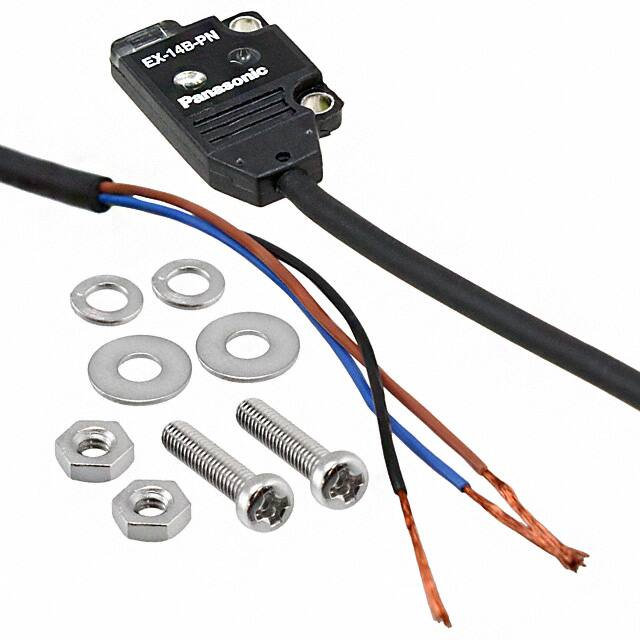

Ultra-slim Photoelectric Sensor 279 Amplifier Built-in EX-10 SERIES Ver.2 FIBER SENSORS Related Information ■■General terms and conditions.............. F-3   Glossary of terms / General precautions......P.1549~ / P.1552~ ■■Selection guide.............................. P.231~ ■■Korea’s S-mark.............................. P.1602 LASER SENSORS PHOTOELECTRIC SENSORS Ver.2 Recognition (Excluding some models) MICRO PHOTOELECTRIC SENSORS AREA SENSORS Certified (Some models only) SAFETY LIGHT CURTAINS / SAFETY COMPONENTS PRESSURE / FLOW SENSORS INDUCTIVE PROXIMITY SENSORS PARTICULAR USE SENSORS SENSOR OPTIONS SIMPLE WIRE-SAVING UNITS WIRE-SAVING SYSTEMS MEASUREMENT SENSORS panasonic.net/id/pidsx/global STATIC CONTROL DEVICES LASER MARKERS PLC HUMAN MACHINE INTERFACES ENERGY MANAGEMENT SOLUTIONS FA COMPONENTS MACHINE VISION SYSTEMS Amplifier built-in extraordinarily small and slim size Smallest body, just 3.5 mm 0.138 in thick Flexible mounting It can be mounted in a very small space as its size is just W10 × H14.5 × D3.5 mm W0.394 × H0.571 × D0.138 in (thru-beam, front sensing type). The diffuse reflective type sensor is front sensing and is so thin that it gives an impression of being just pasted on the mounting base. The thru-beam type is available as front sensing type, as well as, side sensing type, allowing flexible mounting. Thru-beam • Front sensing type UV CURING SYSTEMS Selection Guide Amplifier Built-in Power Supply Built-in Amplifierseparated EX-Z CX-400 CY-100 EX-10 EX-20 EX-30 PNP output type available • Side sensing type A wide variety of narrow-beam type! Light diffusion is approx. 1/2 of standard type. Less interference with no slit, narrow-pitch can be set. The pitch of installation is 1/2 of conventional models, so that the close-installation is possible. No cost is necessary to purchase or install a slit. Possible to sense a minute object less than ø0.5 mm ø0.039 in with no slit. The series is applicable to sense a minute object without any cost. A long 1 m 3.281 ft sensing range is possible with narrow beam. EX-11□ / EX-11E□ EQ-30 ø0.5mm EX-11S□ EQ-500 MQ-W EX-11S□ / EX-11SE□ RX-LS200 RX RT-610 EX-□S□ Long sensing range of 1 m 3.281 ft with narrow beam EX-40 CX-440 Diffuse reflective • Front sensing type EX-19S□ Ultra-slim Photoelectric Sensor EX-10 SERIES Ver.2 APPLICATIONS 280 FIBER SENSORS Positioning of PCBs Detecting ICs Detecting PCB rack LASER SENSORS PHOTOELECTRIC SENSORS MICRO PHOTOELECTRIC SENSORS EX-19S□ SAFETY LIGHT CURTAINS / SAFETY COMPONENTS PRESSURE / FLOW SENSORS INDUCTIVE PROXIMITY SENSORS Transparent stick IC EX-15□ EX-14□ Detecting wafer cassette Detecting thin ring AREA SENSORS Checking for absence of capacitor in tray PARTICULAR USE SENSORS SENSOR OPTIONS EX-14□ SIMPLE WIRE-SAVING UNITS WIRE-SAVING SYSTEMS MEASUREMENT SENSORS STATIC CONTROL DEVICES EX-13E□ Guide EX-14□ LASER MARKERS PLC BASIC PERFORMANCE HUMAN MACHINE INTERFACES Electric power saving * High-speed response time: 0.5 ms The EX-10 series achieves reductions in power consumption of up to 65 %. These sensors contribute to environmental friendliness. The sensor is suitable for detecting small and highspeed traveling objects. 35 A maximum % reduction compared to conventional sensors FA COMPONENTS MACHINE VISION SYSTEMS UV CURING SYSTEMS * Effective from production in October 2010. Minimum sensing object: ø1 mm ø0.039 in EX-11(E)□, EX-15(E)□ Long sensing range: 1 m 3.281 ft EX-19(E)□ EX-11□, EX-11E□, EX-15 and EX-15E are incorporated with ø1 mm ø0.039 in slit masks so that ø1 mm ø0.039 in, or more, object can be detected. Hence, they are suitable for precise positioning or small parts detection. A sensing range of 1 m 3.281 ft has been realized with a slim size of just 3.5 mm 0.138 in. It can be used to detect even wide IC trays. 1m 3.281 ft Selection Guide Amplifier Built-in Power Supply Built-in Amplifierseparated EX-Z CX-400 CY-100 EX-10 EX-20 EX-14□ Background suppression Hardly affected by background Even a specular background separated by 100 mm 3.937 in, or more, is not detected. (However, the background should be directly opposite. A spherical or curved background may be detected.) ENERGY MANAGEMENT SOLUTIONS Background Black object reliably detected 100 mm 3.937 in It can reliably detect dark color objects since it is convergent reflective type. The best distance is approx. 10 mm 0.394 in from the object. EX-30 EX-40 CX-440 EQ-30 EQ-500 MQ-W RX-LS200 RX RT-610 281 Ultra-slim Photoelectric Sensor FIBER SENSORS LASER SENSORS PHOTOELECTRIC SENSORS MICRO PHOTOELECTRIC SENSORS AREA SENSORS EX-10 SERIES Ver.2 ENVIRONMENTAL RESISTANCE Incorporated an inverter countermeasure circuit * The EX-10 series become significantly stronger against inverter light and other extraneous light. The sensors features an IP67 rating to allow their use in process lines where water is used or splashed. Rust-resistant stainless steel sensor mounting brackets are available. Fluorescent light * Effective from production in October 2010. Note: If water splashes on the sensor during sensing operation, it may sense water as an object. SAFETY LIGHT CURTAINS / SAFETY COMPONENTS PRESSURE / FLOW SENSORS INDUCTIVE PROXIMITY SENSORS PARTICULAR USE SENSORS SENSOR OPTIONS SIMPLE WIRE-SAVING UNITS WIRE-SAVING SYSTEMS MEASUREMENT SENSORS STATIC CONTROL DEVICES Waterproof IP67 EX-□-R Bending durability Bending-resistant cable type EX-□-R is available. It is most suitable for moving parts, such as robot arm, etc. MOUNTING / SIZE Mountable with M3 screws Non-corrosive stainless steel type sensor mounting bracket is also available. • MS-EX10-1 [Cold rolled carbon steel (SPCC)] MS-EX10-11 [Stainless steel (SUS304)] mounting bracket for the front sensing type • MS-EX10-2 [Cold rolled carbon steel (SPCC)] MS-EX10-12 [Stainless steel (SUS304)] mounting bracket for the side sensing type • MS-EX10-3 [Cold rolled carbon steel (SPCC)] MS-EX10-13 [Stainless steel (SUS304)] (L-shaped mounting bracket) M3 screws LASER MARKERS PLC M3 screws HUMAN MACHINE INTERFACES ENERGY MANAGEMENT SOLUTIONS FA COMPONENTS MACHINE VISION SYSTEMS UV CURING SYSTEMS Selection Guide Amplifier Built-in Power Supply Built-in Amplifierseparated M3 screws Note: Sensor mounting brackets can not be used for the narrow beam type (EX-□S□). Red beam makes beam alignment easy The red LED beam projected from the emitter helps you to align the sensor heads. FUNCTIONS VARIETIES Bright 2-color indicator Operation mode switch A convenient 2-color indicator has been incorporated in the miniature body. Thru-beam type sensor incorporated with an operation mode switch on the bifurcation is also available. It helps you to test the operability before start-up. 2-color indicator Orange: Operation indicator Green: Stability indicator EX-Z CX-400 CY-100 EX-10 EX-20 EX-30 EX-40 CX-440 EQ-30 EQ-500 MQ-W RX-LS200 RX RT-610 Operation mode switch Operation indicator (Orange) OTHERS Less resources used * Based on environmental considerations, simplified packaging is used in order to reduce waste. In addition, the bag is made from polyethylene which produces no toxic gases even when burned. * Effective from production in October 2010. EX-15□/17□ SENS. EX -17 Even for the thru-beam type sensor, only three wires have to be connected. Ultra-slim Photoelectric Sensor EX-10 SERIES Ver.2 ORDER GUIDE Type Appearance FIBER SENSORS Sensing range 1m 3.281 ft 150 mm 5.906 in 500 mm 19.685 in 500 mm 19.685 in 1m 3.281 ft With operation mode switch on the bifurcation Side sensing 150 mm 5.906 in Front sensing Convergent reflective (Diffused beam type) 500 mm 19.685 in With operation mode switch on the bifurcation Thru-beam Standard type Front sensing 150 mm 5.906 in Front sensing Side sensing Thru-beam Model No.(Note 2) NPN output 500 mm 19.685 in PNP output Output operation LASER SENSORS Output EX-11A-PN Light-ON EX-11B EX-11B-PN Dark-ON EX-13A EX-13A-PN Light-ON AREA SENSORS EX-13B EX-13B-PN Dark-ON EX-19A EX-19A-PN Light-ON SAFETY LIGHT CURTAINS / SAFETY COMPONENTS EX-19B EX-19B-PN Dark-ON PRESSURE / FLOW SENSORS EX-15 EX-15 -PN INDUCTIVE PROXIMITY SENSORS EX-17 EX-17-PN Switchable either Light-ON or Dark-ON EX-11EA EX-11EA-PN EX-11EB EX-11EB-PN Dark-ON EX-13EA EX-13EA-PN Light-ON EX-13EB EX-13EB-PN Dark-ON EX-19EA EX-19EA-PN Light-ON EX-19EB EX-19EB-PN Dark-ON EX-17E - Light-ON MICRO PHOTOELECTRIC SENSORS PARTICULAR USE SENSORS NPN opencollector transistor or PNP opencollector transistor 500 mm 19.685 in 1m 3.281 ft 150 mm 5.906 in 500 mm 19.685 in SENSOR OPTIONS SIMPLE WIRE-SAVING UNITS WIRE-SAVING SYSTEMS MEASUREMENT SENSORS STATIC CONTROL DEVICES Switchable either Light-ON or Dark-ON LASER MARKERS PLC EX-14A EX-14A-PN Light-ON HUMAN MACHINE INTERFACES EX-14B EX-14B-PN Dark-ON ENERGY MANAGEMENT SOLUTIONS EX-11SA EX-11SA-PN Light-ON FA COMPONENTS EX-11SB EX-11SB-PN Dark-ON EX-13SA EX-13SA-PN Light-ON MACHINE VISION SYSTEMS EX-13SB EX-13SB-PN Dark-ON EX-19SA EX-19SA-PN Light-ON EX-19SB EX-19SB-PN Dark-ON EX-11SEA EX-11SEA-PN Light-ON EX-11SEB EX-11SEB-PN Dark-ON EX-13SEA EX-13SEA-PN Light-ON EX-13SEB EX-13SEB-PN Dark-ON 2 to 25 mm 0.079 to 0.984 in (Note 1) (Convergent point: 10 mm 0.394 in) PHOTOELECTRIC SENSORS EX-11A EX-15E 150 mm 5.906 in 150 mm 5.906 in Narrow beam type 282 NPN opencollector transistor or PNP opencollector transistor NOTE: Mounting bracket is not supplied with the sensor. Please select from the range of optional sensor mounting brackets (MS-EX10-□). Sensor mounting brackets (MS-EX10-□) can not be used for the narrow beam type (EX-□S□). Notes: 1) The sensor does not detect even a specular background if it is separated by 100 mm 3.937 in or more. (However, the background should be directly opposite. A spherical or curved background may be detected.) 2) The model No. with “P” shown on the label affixed to the thru-beam type sensor is the emitter, “D” shown on the label is the receiver. Bending-resistant cable type Bending-resistant cable type is also available for NPN output type. (excluding narrow beam type EX-□S□ and sensor with operation mode switch on the bifurcation EX-15□/17□) When ordering this type, suffix “-R” to the model No. (e.g.) Bending-resistant cable type of EX-11A is “EX-11A-R”. 5 m 16.404 ft cable length type 5 m 16.404 ft cable length type (standard: 2 m 6.562 ft) is also available for NPN output type. (excluding narrow beam type EX-□S□ and bending-resistant cable type) When ordering this type, suffix “-C5” to the model No. (e.g.) 5 m 16.404 ft cable length type of EX-11A is “EX-11A-C5”. UV CURING SYSTEMS Selection Guide Amplifier Built-in Power Supply Built-in Amplifierseparated EX-Z CX-400 CY-100 EX-10 EX-20 EX-30 EX-40 CX-440 EQ-30 EQ-500 MQ-W RX-LS200 RX RT-610 283 FIBER SENSORS LASER SENSORS Ultra-slim Photoelectric Sensor EX-10 SERIES Ver.2 OPTIONS NOTE: Sensor mounting brackets can not be used for the narrow beam type (EX-□S□). MICRO PHOTOELECTRIC SENSORS Designation Model No. MS-EX10-1 Mounting bracket for the front sensing type sensor [Cold rolled carbon steel (SPCC)] (The thru-beam type sensor needs two brackets.) SAFETY LIGHT CURTAINS / SAFETY COMPONENTS MS-EX10-2 Mounting bracket for the side sensing type sensor [Cold rolled carbon steel (SPCC)] (The thru-beam type sensor needs two brackets.) Sensor mounting MS-EX10-3 bracket (Note 1) L-shaped mounting bracket sensor [Cold rolled carbon steel (SPCC)] (The thru-beam type sensor needs two brackets.) INDUCTIVE PROXIMITY SENSORS PARTICULAR USE SENSORS SENSOR OPTIONS SIMPLE WIRE-SAVING UNITS WIRE-SAVING SYSTEMS MS-EX10-11 Mounting bracket for the front sensing type sensor [Stainless steel (SUS304)] (The thru-beam type sensor needs two brackets.) MS-EX10-12 Mounting bracket for the side sensing type sensor [Stainless steel (SUS304)] (The thru-beam type sensor needs two brackets.) MS-EX10-13 L-shaped mounting bracket [Stainless steel (SUS304)] (The thru-beam type sensor needs two brackets.) Slit on one side Slit on both sides • Sensing range: 400 mm 15.748 in [EX-19□] 200 mm 7.874 in [EX-13□, EX-17□] • Min. sensing object: ø1.2 mm ø0.047 in Slit on one side • Sensing range: 800 mm 31.496 in [EX-19□] 350 mm 13.780 in [EX-13□] • Min. sensing object: ø2 mm ø0.079 in Slit on both sides • Sensing range: 500 mm 19.685 in [EX-19□] 300 mm 11.811 in [EX-13□] • Min. sensing object: ø1.5 mm ø0.059 in Slit on one side • Sensing range: 400 mm 15.748 in [EX-19E□] (Note 3) 250 mm 9.843 in [EX-13E□, EX-17E□] • Min. sensing object: ø2 mm ø0.079 in Slit on both sides • Sensing range: 200 mm 7.874 in [EX-13E□, EX-17E□] • Min. sensing object: ø1.2 mm ø0.047 in (Slit size ø1.2 mm ø0.047 in) STATIC CONTROL DEVICES LASER MARKERS Slit mask PLC OS-EX10-15 (Slit size ø1.5 mm ø0.059 in) HUMAN MACHINE INTERFACES ENERGY MANAGEMENT SOLUTIONS OS-EX10E-12 (Slit size ø1.2 mm ø0.047 in) FA COMPONENTS MACHINE VISION SYSTEMS Sensor checker (Note 2) CHX-SC2 It is useful for beam alignment of thru-beam type sensors. The optimum receiver position is given by indicators, as well as an audio signal. UV CURING SYSTEMS Mounting screw MS-M2 Mounting screws with washers (50 pcs. lot). It can mount securely as it is spring washer attached. Selection Guide Amplifier Built-in Power Supply Built-in Amplifierseparated Notes: 1) Can not be used for the narrow beam type (EX-□S□). 2) Refer to p.959~ for the sensor checker CHX-SC2. 3) Since EX-19E□ has a built-in ø1 mm ø 0.039 in slit in the emitter, be sure to mount it in the receiver. Sensor checker Slit mask • OS-EX10-12 • OS-EX10-15 • OS-EX10E-12 Example of mounting (OS-EX10E-12) W ER C H LE VE L EX-Z CX-400 Sensor checker CY-100 EX-10 EX-20 EX-30 EX-40 CX-440 EQ-30 EQ-500 MQ-W RX-LS200 RX RT-610 Tighten along with the sensor mounting bracket. X- Two M2 (length 4 mm 0.157 in) pan head screws are attached. Material: Cold rolled carbon steel (SPCC) (Uni-chrome plated) Two M2 (length 8 mm 0.315 in) pan head screws are attached. • MS-EX10-3 Material: Cold rolled carbon steel (SPCC) (Uni-chrome plated) Two M2 (length 4 mm 0.157 in) pan head screws, and two M2 (length 8 mm 0.315 in) pan head screws are attached. • CHX-SC2 PO Material: Cold rolled carbon steel (SPCC) (Uni-chrome plated) • MS-EX10-2 • Sensing range: 600 mm 23.622 in [EX-19□] 250 mm 9.843 in [EX-13□, EX-17□] • Min. sensing object: ø2 mm ø0.079 in OS-EX10-12 MEASUREMENT SENSORS • MS-EX10-11 Description AREA SENSORS PRESSURE / FLOW SENSORS Sensor mounting bracket • MS-EX10-1 PHOTOELECTRIC SENSORS SC 2 Material: Stainless steel (SUS304) Two M2 (length 4 mm 0.157 in) pan head screws [stainless steel (SUS304)] are attached. • MS-EX10-12 Material: Stainless steel (SUS304) Two M2 (length 8 mm 0.315 in) pan head screws [stainless steel (SUS304)] are attached. • MS-EX10-13 Material: Stainless steel (SUS304) Two M2 (length 4 mm 0.157 in) pan head screws [stainless steel (SUS304)] and two M2 (length 8 mm 0.315 in) pan head screws [stainless steel (SUS304)] are attached. Ultra-slim Photoelectric Sensor EX-10 SERIES Ver.2 SPECIFICATIONS FIBER SENSORS Item Front sensing Side sensing Front sensing Side sensing Front sensing Side sensing Light-ON EX-11A(-PN) EX-11EA(-PN) EX-13A(-PN) EX-13EA(-PN) EX-19A(-PN) EX-19EA(-PN) Dark-ON EX-11B(-PN) EX-11EB(-PN) EX-13B(-PN) EX-13EB(-PN) EX-19B(-PN) EX-19EB(-PN) CE marking directive compliance Sensing range Min. sensing object Hysteresis Repeatability (perpendicular to sensing axis) EMC Directive, RoHS Directive 150 mm 5.906 in 500 mm 19.685 in ø1 mm ø0.039 in opaque object (Completely beam interrupted object) Setting distance between emitter and receiver: 150 mm 5.906 in ø2 mm ø0.079 in opaque object (Completely beam interrupted object) Setting distance between emitter and receiver: 500 mm 19.685 in Current consumption Emitter: 10 mA or less, Receiver: 10 mA or less Utilization category Short-circuit protection Response time Operation indicator Incident beam indicator Stability indicator Pollution degree Protection Ambient temperature Ambient humidity Ambient illuminance Voltage withstandability ø2 mm ø0.079 in opaque object Completely beam interrupted object Setting distance between emitter and receiver: 1 m 3.281 ft 0.05 mm 0.002 in or less 12 to 24 V DC ±10 %   Ripple P-P 10 % or less Output 1 m 3.281 ft – Supply voltage Environmental resistance LASER SENSORS Thru-beam • standard type Type Model No. (Note 2) 284 NPN open-collector transistor • Maximum sink current: 50 mA • Applied voltage: 30 V DC or less (between output and 0 V) • Residual voltage: 2 V or less (at 50 mA sink current) 1 V or less (at 16 mA sink current) PNP open-collector transistor • Maximum source current: 50 mA • Applied voltage: 30 V DC or less (between output and +V) • Residual voltage:2  V or less (at 50 mA source current) 1 V or less (at 16 mA source current) DC-12 or DC-13 Incorporated 0.5 ms or less Orange LED (lights up when the output is ON) – Green LED (lights up under stable light received condition or stable dark condition) 3 (Industrial environment) IP67 (IEC) −25 to +55 °C −13 to +131 °F (No dew condensation or icing allowed), Storage: −30 to +70 °C −22 to +158 °F 35 to 85 % RH, Storage: 35 to 85 % RH PHOTOELECTRIC SENSORS MICRO PHOTOELECTRIC SENSORS AREA SENSORS SAFETY LIGHT CURTAINS / SAFETY COMPONENTS PRESSURE / FLOW SENSORS INDUCTIVE PROXIMITY SENSORS PARTICULAR USE SENSORS SENSOR OPTIONS SIMPLE WIRE-SAVING UNITS WIRE-SAVING SYSTEMS MEASUREMENT SENSORS STATIC CONTROL DEVICES LASER MARKERS PLC HUMAN MACHINE INTERFACES ENERGY MANAGEMENT SOLUTIONS FA COMPONENTS MACHINE VISION SYSTEMS UV CURING SYSTEMS Incandescent light: 3,000 ℓx or less at the light-receiving face 1,000 V AC for one min. between all supply terminals connected together and enclosure Insulation resistance 20 MΩ, or more, with 250 V DC megger between all supply terminals connected together and enclosure Selection Guide Vibration resistance 10 to 500 Hz frequency, 3 mm 0.118 in double amplitude in X, Y and Z directions for two hours each Amplifier Built-in 500 m/s2 acceleration (50 G approx.) in X, Y and Z directions three times each Power Supply Built-in Red LED [Peak emission wavelength: 680 nm 0.027 mil (EX-19E□: 624 nm 0.025 mil), modulated] Amplifierseparated Shock resistance Emitting element Material Cable (Note 3) Cable extension Weight Accessories Enclosure: Polyethylene terephthalate, Lens: Polyalylate 0.1 mm2 3-core (thru-beam type emitter: 2-core) cabtyre cable, 2 m 6.562 ft long Extension up to total 50 m 164 ft is possible with 0.3 mm2, or more, cable (thru-beam type: emitter and receiver). Net weight (each emitter and receiver): 20 g approx., Gross weight: 50 g approx. Mounting screws: 1 set Notes: 1) Where measurement conditions have not been specified precisely, the conditions used were an ambient temperature of +23 °C +73.4 °F. 2) Model Nos. having the suffix “-PN” are PNP output type. 3) The bending-resistant cable type (model Nos. having suffix “-R”) has a 0.1 mm2 3-core (thru-beam type emitter: 2-core) bending-resistant cabtyre cable, 2 m 6.562 ft long. EX-Z CX-400 CY-100 EX-10 EX-20 EX-30 EX-40 CX-440 EQ-30 EQ-500 MQ-W RX-LS200 RX RT-610 285 Ultra-slim Photoelectric Sensor SPECIFICATIONS FIBER SENSORS LASER SENSORS PHOTOELECTRIC SENSORS Type SAFETY LIGHT CURTAINS / SAFETY COMPONENTS PRESSURE / FLOW SENSORS Item Model No. (Note 2) Light-ON EX-11SA(-PN) EX-11SEA(-PN) EX-13SA(-PN) EX-13SEA(-PN) EX-19SA(-PN) EX-14A(-PN) Dark-ON EX-11SB(-PN) EX-11SEB(-PN) EX-13SB(-PN) EX-13SEB(-PN) EX-19SB(-PN) EX-14B(-PN) CE marking directive compliance Sensing range INDUCTIVE PROXIMITY SENSORS PARTICULAR USE SENSORS Min. sensing object SENSOR OPTIONS SIMPLE WIRE-SAVING UNITS WIRE-SAVING SYSTEMS MEASUREMENT SENSORS STATIC CONTROL DEVICES LASER MARKERS Hysteresis Repeatability (perpendicular to sensing axis) Supply voltage Current consumption Output PLC ENERGY MANAGEMENT SOLUTIONS FA COMPONENTS MACHINE VISION SYSTEMS UV CURING SYSTEMS Selection Guide Amplifier Built-in Power Supply Built-in Amplifierseparated EX-Z CX-400 Utilization category Incident beam indicator Stability indicator Pollution degree EX-20 EX-30 EX-40 CX-440 EQ-30 EQ-500 MQ-W RX-LS200 RX RT-610 500 mm 19.685 in Ambient illuminance Voltage withstandability EX-17 (Note 3) 2 to 25 mm 0.079 1 m 3.281 ft to 0.984 in (Note 4) (Conv. point: 10 mm 0.394 in) 150 mm 5.906 in 500 mm 19.685 in – 15 % or less of operation distance (Note 4) – 0.05 mm 0.002 in or less 0.1 mm 0.004 in or less 0.05 mm 0.002 in or less 12 to 24 V DC ±10 %   Ripple P-P 10 % or less 13 mA or less Emitter: 10 mA or less, Receiver: 10 mA or less 25 mA or less PNP open-collector transistor NPN open-collector transistor • M  aximum source current: 50 mA • M  aximum sink current: 50 mA • A pplied voltage: 30 V DC or less (between output and 0 V) • A pplied voltage: 30 V DC or less (between output and +V) • R esidual voltage: 2 V or less (at 50 mA sink current) • R esidual voltage: 2 V or less (at 50 mA source current) 1 V or less (at 16 mA source current) 1 V or less (at 16 mA sink current) NPN open-collector transistor • Maximum sink current: 100 mA • Applied voltage: 30 V DC or less (between output and 0 V) • R  esidual voltage: 2 V or less (at 100 mA sink current) 1 V or less (at 16 mA sink current) DC-12 or DC-13 – Incorporated 0.5 ms or less Orange LED (lights up when the output is ON), located on the bifurcation Orange LED (lights up when the output is ON) Orange LED (lights up under light received condition), located on the receiver – Green LED (lights up under stable light received condition or stable dark condition) Green LED (lights up under stable light received condition or stable dark condition), located on the receiver 3 (Industrial environment) – IP67 (IEC) −25 to +55 °C −13 to +131 °F (No dew condensation or icing allowed), Storage: −30 to +70 °C −22 to +158 °F 35 to 85 % RH, Storage: 35 to 85 % RH Incandescent light: 3,000 ℓx or less at the light-receiving face 1,000 V AC for one min. between all supply terminals connected together and enclosure Insulation resistance 20 MΩ, or more, with 250 V DC megger between all supply terminals connected together and enclosure Vibration resistance 10 to 500 Hz frequency, 3 mm 0.118 in double amplitude in X, Y and Z directions for two hours each Shock resistance Emitting element Material Cable (Note 6) Cable extension Weight Accessories EX-17E (Note 3) ø0.5 mm ø1 mm ø0.039 in opaque object ø2 mm ø0.079 in opaque object ø0.002 in ø1 mm ø0.039 in opaque object ø2 mm ø0.079 in opaque object ø0.1 mm ø0.004 (Completely beam interrupted object) (Completely beam interrupted object) opaque object Setting distance Setting distance (Completely beam interrupted object) (Completely beam interrupted object) in copper wire (Completely between emitter between emitter (Note 5) (Note 5) Setting distance: beam interrupted and receiver: and receiver: 10 mm 0.394 in object) 150 mm 5.906 in 500 mm 19.685 in (Note 5) Ambient humidity CY-100 EX-10 150 mm 5.906 in Protection Ambient temperature EX-15E (Note 3) – Short-circuit protection Operation indicator EX-15 (Note 3) EMC Directive, RoHS Directive Response time Environmental resistance HUMAN MACHINE INTERFACES Convergent reflective Thru-beam · with operation mode switch on bifurcation (Diffused beam type) Thru-beam • narrow beam type Front sensing Side sensing Front sensing Side sensing Front sensing Front sensing Front sensing Side sensing Front sensing Side sensing MICRO PHOTOELECTRIC SENSORS AREA SENSORS EX-10 SERIES Ver.2 500 m/s2 acceleration (50 G approx.) in X, Y and Z directions three times each Red LED (Peak emission wavelength: 650 nm 0.026 mil, modulated) Red LED (Peak emission wavelength: 680 nm 0.027 mil, modulated) Enclosure: Polyethylene terephthalate Lens: Polyalylate Enclosure: Polyethylene terephthalate Lens: Polyalylate, Bifurcation: Polyalylate 0.1 mm2 3-core (thru-beam type emitter: 2-core) cabtyre cable, 2 m 6.562 ft long 0.2 mm2 3-core cabtyre cable, 2 m 6.562 ft long (beyond bifurcation; from emitter / receiver to bifurcation: 0.5 m 1.640 ft long) Extension up to total 50 m 164 ft is possible with 0.3 mm2, or more, cable (thru-beam type: emitter and receiver). Extension up to total 100 m 328 ft is possible with 0.3 mm2, or more, cable. Net weight (each emitter and receiver): 20 g approx., Gross weight: 50 g approx. Net weight: 20 g approx. Net weight: 55 g approx., Gross weight: 80 g approx. Gross weight: 40 g approx. Mounting screws: 1 set Mounting screws: 1 set Mounting screws: 1 set, Adjusting screwdriver: 1 pc. Notes: 1) Where measurement conditions have not been specified precisely, the conditions used were an ambient temperature of +23 °C +73.4 °F. 2) Model Nos. having the suffix “-PN” are PNP output type. 3) Either Light-ON or Dark-ON can be selected by the operation mode switch. 4) The sensing range and the hysteresis of convergent reflective type sensor are specified for white non-glossy paper (50 × 50 mm 1.969 × 1.969 in) as the object. 5) The min. sensing objects are specified in case the emitter / reciever sensing range is to set the maximum. 6) The bending-resistant cable type (model Nos. having suffix “-R”) has a 0.1 mm2 3-core (thru-beam type emitter: 2-core) bending-resistant cabtyre cable, 2 m 6.562 ft long. Ultra-slim Photoelectric Sensor EX-10 SERIES Ver.2 I/O CIRCUIT AND WIRING DIAGRAMS FIBER SENSORS EX-11□  EX-11S□  EX-13□  EX-13S□  EX-19□  EX-19S□  EX-14□ I/O circuit diagram NPN output type Wiring diagram Sensor circuit Tr MICRO PHOTOELECTRIC SENSORS (Brown) +V D2 (Black) Output (Note) Load + − 50 mA max. ZD 12 to 24 V DC ±10 % AREA SENSORS Brown Black (Note) Load + − (Blue) 0 V SAFETY LIGHT CURTAINS / SAFETY COMPONENTS 12 to 24 V DC ±10 % PRESSURE / FLOW SENSORS Blue Internal circuit Users’ circuit Note: The emitter of the thru-beam type sensor does not incorporate the output. Note: The emitter of the thru-beam type sensor does not incorporate the black wire. Symbols … D1: Reverse supply polarity protection diode D2: Reverse output polarity protection diode ZD: Surge absorption zener diode Tr : NPN output transistor PNP output type Wiring diagram STATIC CONTROL DEVICES Sensor circuit (Brown) +V 50 mA max. D1 (Black) Output (Note) Load (Blue) 0 V Internal circuit Users’ circuit + 12 to 24 V DC ±10 % − LASER MARKERS Brown + Black (Note) Blue Note: The emitter of the thru-beam type sensor does not incorporate the output. Load − PLC 12 to 24 V DC ±10 % HUMAN MACHINE INTERFACES Note: The emitter of the thru-beam type sensor does not incorporate the black wire. MACHINE VISION SYSTEMS EX-15□  EX-15E□  EX-17□  EX-17E□ NPN output type I/O circuit diagram Color code Sensor circuit Tr ZD UV CURING SYSTEMS EX-15□, EX-15E□, EX-17□, EX-17E□ wiring diagram Selection Guide (Brown) +V D2 ENERGY MANAGEMENT SOLUTIONS FA COMPONENTS Symbols … D1: Reverse supply polarity protection diode D2: Reverse output polarity protection diode ZD: Surge absorption zener diode Tr : PNP output transistor D1 WIRE-SAVING SYSTEMS MEASUREMENT SENSORS Color code D2 PARTICULAR USE SENSORS SIMPLE WIRE-SAVING UNITS I/O circuit diagram ZD INDUCTIVE PROXIMITY SENSORS SENSOR OPTIONS EX-11□-PN  EX-11S□-PN  EX-13□-PN  EX-13S□-PN  EX-19□-PN  EX-19S□-PN  EX-14□-PN Tr LASER SENSORS PHOTOELECTRIC SENSORS Color code D1 286 (Black) Output Load 100 mA max. Amplifier Built-in + − Power Supply Built-in 12 to 24 V DC ±10 % Amplifierseparated (Blue) 0 V EX-Z Internal circuit Users’ circuit CX-400 CY-100 Symbols … D1: Reverse supply polarity protection diode D2: Reverse output polarity protection diode ZD: Surge absorption zener diode Tr : NPN output transistor EX-10 EX-20 EX-30 EX-40 Brown Black Load CX-440 + − Blue 12 to 24 V DC ±10 % EQ-30 EQ-500 MQ-W RX-LS200 RX RT-610 287 Ultra-slim Photoelectric Sensor SENSING CHARACTERISTICS (TYPICAL) FIBER SENSORS LASER SENSORS INDUCTIVE PROXIMITY SENSORS 100 3.937 150 5.906 EX-11□ EX-15□ Emitter 50 1.969 ℓ EX-11E□ EX-15E□ Emitter ℓ L L SENSOR OPTIONS Emitter 2 Receiver 1 Emitter 1 Receiver 2 Emitter 1 Receiver 1 EX-11E□ EX-15E□ Emitter Emitter 50 1.969 0 20 θ θ L EX-11□ EX-15□ Receiver L EX-11E□ Receiver EX-15E□ 10 0 10 20 Center Left Right Operating angle θ ( ° ) Emitter 2 Thru-beam type Parallel deviation Angular deviation Parallel deviation with slit masks (ø1.2 mm ø0.047 in) Parallel deviation with slit masks (ø1.5 mm ø0.059 in) 800 31.496 800 31.496 400 15.748 400 15.748 HUMAN MACHINE INTERFACES 400 15.748 EX-13E□ EX-17E□ Emitter Emitter 200 7.874 ℓ ℓ L L EX-13□ EX-13E□ Receiver EX-17□ EX-17E□ Receiver 0 100 50 0 50 100 3.937 1.969 1.969 3.937 Center Left Right Operating point ℓ (mm in) ENERGY MANAGEMENT SOLUTIONS FA COMPONENTS MACHINE VISION SYSTEMS 600 23.622 EX-13□ EX-17□ 300 11.811 EX-13□ EX-17□ EX-13E□ EX-17E□ Emitter 400 15.748 200 7.874 0 20 200 7.874 Emitter θ L EX-13E□ Receiver EX-17E□ θ L EX-13□ EX-17□ Receiver 10 0 10 Center Left Right Operating angle θ ( ° ) Parallel deviation Angular deviation 0 200 7.874 CY-100 Parallel deviation MQ-W RX-LS200 RX RT-610 Setting distance L (mm in) 20 0 20 Center Left Right Operating angle θ ( ° ) 150 5.906 Emitter ℓ 0 200 7.874 L Receiver 100 0 100 200 3.937 3.937 7.874 Left Center Right Operating point ℓ (mm in) 100 3.937 50 1.969 Emitter L Receiver EX-11SE□ EX-11S□ Emitter EX-11SE□ L L EX-13S□/EX-13SE□ Thru-beam type Parallel deviation EX-11S□ ℓ ℓ Emitter ℓ L Receiver Receiver 0 50 25 0 25 50 0.984 0.984 1.969 1.969 Left Center Right Operating point ℓ (mm in) 200 7.874 ℓ L Receiver EX-13S□ 0 50 1.969 ℓ L Receiver 100 0 100 200 3.937 3.937 7.874 Center Left Right Operating point ℓ (mm in) Thru-beam type Parallel deviation EX-13SE□ 400 15.784 Emitter Emitter EX-19S□ EX-13S□ 600 23.622 Slit on both sides 0 200 7.874 100 0 100 200 3.937 3.937 7.874 Center Left Right Operating point ℓ (mm in) 800 31.496 Slit on one side 500 19.685 Receiver 0 200 7.874 40 Parallel deviation 1,000 39.370 500 19.685 ℓ 50 0 50 100 1.969 1.969 3.937 Center Left Right Operating point ℓ (mm in) 1,000 39.370 200 7.874 Slit on both sides Setting distance L (mm in) EQ-30 EQ-500 L Receiver 200 7.874 Setting distance L (mm in) CX-440 θ EX-11S□/EX-11SE□ Thru-beam type Thru-beam type Slit on one side 400 15.748 Emitter 0 40 100 0 100 200 3.937 3.937 7.874 Center Left Right Operating point ℓ (mm in) EX-30 EX-40 Setting distance L (mm in) L Receiver EX-19E□ Emitter Parallel deviation with slit masks (ø1.5 mm ø0.059 in) 600 23.622 500 19.685 Emitter ℓ CX-400 EX-20 0 100 3.937 Parallel deviation with slit masks (ø1.2 mm ø0.047 in) 1,000 39.370 500 19.685 EX-Z EX-10 Receiver 20 0 20 40 0.787 0.787 1.575 Center Left Right Operating point ℓ (mm in) 800 31.496 Setting distance L (mm in) Amplifierseparated 100 3.937 Slit on one side, sensing range: 350 mm 13.78 in Slit on both sides, sensing range: 300 mm 11.81 in Thru-beam type Setting distance L (mm in) Power Supply Built-in L 200 7.874 EX-19□ 1,000 39.370 Amplifier Built-in Emitter ℓ 0 40 1.575 20 Slit on one side or both sides 300 11.811 100 3.937 UV CURING SYSTEMS Selection Guide EX-13□/17□ Slit on one side EX-13□/17□ Slit on both sides EX-13E□/17E□ Slit on one side EX-13E□/17E□ Slit on both sides Setting distance L (mm in) PLC 600 23.622 Setting distance L (mm in) LASER MARKERS Receiver 2 L EX-13□  EX-13E□  EX-17□  EX-17E□ Setting distance L (mm in) STATIC CONTROL DEVICES There is no problem when sensors are installed in parallel (although the distance between sensors should be ℓ × 2 or more). ℓ × 2 or more WIRE-SAVING SYSTEMS MEASUREMENT SENSORS Beam from Emitter 1 may be caught by Receiver 2. EX-11□ EX-15□ 100 3.937 Receiver Receiver 0 50 25 0 25 50 1.969 1.969 0.984 0.984 Center Left Right Operating point ℓ (mm in) PARTICULAR USE SENSORS SIMPLE WIRE-SAVING UNITS EX-11E□ EX-15E□ 150 5.906 Setting distance L (mm in) PRESSURE / FLOW SENSORS 200 7.874 EX-11□ EX-15□ Setting distance L (mm in) SAFETY LIGHT CURTAINS / SAFETY COMPONENTS Angular deviation 200 7.874 *Optical properties of side sensing types (EX-□E□) Due to the optical properties of side sensing types, note that sensing may be affected if multiple sensors are positioned in such a way that optical axes intersect as shown in the diagram below. Emitter ℓ L Receiver EX-13SE□ 25 0 25 50 0.984 0.984 1.969 Left Center Right Operating point ℓ (mm in) Setting distance L (mm in) AREA SENSORS Thru-beam type Parallel deviation Setting distance L (mm in) MICRO PHOTOELECTRIC SENSORS EX-11□  EX-11E□  EX-15□  EX-15E□ Setting distance L (mm in) PHOTOELECTRIC SENSORS EX-10 SERIES Ver.2 1,000 39.370 500 19.685 Emitter ℓ 0 100 3.937 L Receiver 50 0 50 100 1.969 1.969 3.937 Left Center Right Operating point ℓ (mm in) Ultra-slim Photoelectric Sensor EX-10 SERIES Ver.2 288 SENSING CHARACTERISTICS (TYPICAL) FIBER SENSORS EX-14□ Convergent reflective type PHOTOELECTRIC SENSORS Sensing fields • Horizontal (left and right) direction 40 1.575 • Vertical (up and down) direction 30 1.181 ℓ L 20 0.787 10 0.394 50 × 50 mm 1.969 × 1.969 in Non-glossy paper White 20 0.787 White 7.75 mm 0.305 in N4 0 10 0.394 5 0 5 10 0.197 0.197 0.394 Center Left Right Operating point ℓ (mm in) SAFETY LIGHT CURTAINS / SAFETY COMPONENTS PRESSURE / FLOW SENSORS 10 0.394 N4 0 10 0.394 AREA SENSORS Setting distance L (mm in) Setting distance L (mm in) 30 1.181 7 mm 0.276 in MICRO PHOTOELECTRIC SENSORS 40 1.575 50 × 50 mm 1.969 × 1.969 in Non-glossy paper INDUCTIVE PROXIMITY SENSORS ℓ 5 0 5 0.197 0.197 Center Down Up Operating point ℓ (mm in) L PARTICULAR USE SENSORS 10 0.394 SENSOR OPTIONS Correlation between lightness and sensing range Correlation between material (50 × 50 mm 1.969 × 1.969 in) and sensing range 40 1.575 80 3.150 N1 N2 N3 N4 N5 N6 N7 N8 N9 Lightness shown on the left may differ slightly from the actual object condition. PRECAUTIONS FOR PROPER USE • Never use this product as a sensing device for personnel protection. • In case of using sensing devices for personnel protection, use products which meet laws and standards, such as OSHA, ANSI or IEC etc., for personnel protection applicable in each region or country. Side sensing Sensing direction Attached screw [M2 (length 10 0.394)] Front sensing Attached screw [M2 (length 8 0.315)] M2 × 0.4 0.016 hole tapped, 7 0.276 deep M2 × 0.4 0.016 hole tapped, 6 0.157 deep • In case of using attached screws and nuts (Unit: mm in) Side sensing Front sensing Flat washers 11 0.433 Sensing direction Attached screw [M2 (length 10 0.394)] Thickness of mounting plate: 2 0.079 or less Sensing direction Nuts Spring washers Attached screw [M2 (length 8 0.315)] WIRE-SAVING SYSTEMS MEASUREMENT SENSORS STATIC CONTROL DEVICES LASER MARKERS PLC HUMAN MACHINE INTERFACES FA COMPONENTS MACHINE VISION SYSTEMS UV CURING SYSTEMS Operation mode switch L: Light-ON D: Dark-ON Operation indicator (Orange) Lights up when the output is ON. Switch position 11 0.433 The tightening torque should be 0.2 N·m or less. SIMPLE WIRE-SAVING UNITS ENERGY MANAGEMENT SOLUTIONS Operation mode switch (EX-15□, EX-15E□, EX-17□ and EX-17E□ only) Sensing direction 11 0.433 The bars in the graph indicate the sensing range (typical) for the respective material. However, there is a slight variation in the sensing range depending on the product. Further, if there is a reflective object (conveyor, etc.) in the background of the sensing object, since it affects the sensing, separate it by more than twice the sensing range shown in the left graph. Refer to p.1552~ for general precautions. Mounting • In case of mounting on tapped holes (Unit: mm in) Aluminum-evaporated mirror N8 Light Distance to convergent point N4 N6 Lightness Aluminum plate (Hair line) N2 Dark 20 0.787 10 0.394 0 Stainless steel plate 0 Distance to convergent point 10 0.394 40 1.575 Black circuit board Sensing region Black rubber sheet IC tray (Black) Glass epoxy printed circuit board (Green masked surface) Ceramic circuit board White non-glossy paper Sensing range L (mm in) 20 0.787 60 2.362 Sensing range L (mm in) The sensing region (typical) is represented by oblique lines in the left figure. However, the sensitivity should be set with enough margin because of slight variation in products. 30 1.181 LASER SENSORS Selection Guide Amplifier Built-in Power Supply Built-in Amplifierseparated Description EX-Z Light-ON mode is set when the switch is turned fully clockwise (L side). CX-400 Dark-ON mode is set when the switch is turned fully counterclockwise (D side). EX-10 Others • Do not use during the initial transient time (50 ms) after the power supply is switched on. • Excess bending of the cable or stress applied to the cable may disconnect the internal lead wire. CY-100 EX-20 EX-30 EX-40 CX-440 EQ-30 EQ-500 MQ-W 11 0.433 Thickness of mounting plate: 2.5 0.098 or less The tightening torque should be 0.2 N·m or less. RX-LS200 RX RT-610 289 FIBER SENSORS LASER SENSORS Ultra-slim Photoelectric Sensor EX-10 SERIES Ver.2 DIMENSIONS (Unit: mm in) The CAD data can be downloaded from our website. EX-11□  EX-11S□  EX-13□  EX-13S□  EX-19□  EX-19S□ Sensor PHOTOELECTRIC SENSORS MICRO PHOTOELECTRIC SENSORS AREA SENSORS 3.5 0.138 2.1 0.083 SAFETY LIGHT CURTAINS / SAFETY COMPONENTS 10 0.394 5.5 0.217 1.75 0.069 1.75 0.069 PRESSURE / FLOW SENSORS INDUCTIVE PROXIMITY SENSORS 14.5 11 0.571 0.433 PARTICULAR USE SENSORS 4 0.157 2-ø2.2 ø0.087 mounting holes SIMPLE WIRE-SAVING UNITS ø2.5 ø0.098 cable, 2 m 6.562 ft long 6.5 0.256 6.5 0.256 EX-11E□  EX-11SE□  EX-13E□  EX-13SE□  EX-19E□  HUMAN MACHINE INTERFACES 10 0.394 1.75 0.069 4.5 0.177 1.75 0.069 ENERGY MANAGEMENT SOLUTIONS FA COMPONENTS 14.5 11 0.571 0.433 MACHINE VISION SYSTEMS Sensor Stability indicator (Green) Operation indicator (Orange) 4.5 0.177 2.25 0.089 Beamemitting part 4 0.157 2-ø2.2 ø0.087 mounting holes 6.5 0.256 EX-20 EX-30 EX-40 Emitter 6.5 0.256 3.5 0.138 2.1 0.083 14.5 11 0.571 0.433 Receiver 5.5 0.217 Stability indicator (Green) Incident beam indicator (Orange) 10 0.394 6.45 0.254 5.5 0.217 1.75 0.069 4.5 0.177 2-ø2.2 ø0.087 mounting holes EQ-30 2-ø2.2 ø0.087 500 mounting holes 19.685 ø2.5 ø0.098 cable, 2 m 6.562 ft long 2.1 0.083 Stability indicator (Green) 10 1.75 0.394 0.069 1.75 0.069 4 0.157 14.5 11 0.571 0.433 4.5 0.177 2-ø2.2 ø0.087 mounting holes Beamemitting part 4.2 0.165 4.5 0.177 2.25 0.089 4.5 0.177 2.25 0.089 Beamreceiving part 4.2 0.165 7 0.276 1 0.039 8 0.315 4.5 0.177 2-ø2.2 ø0.087 mounting holes Operation mode switch ø3.8 ø0.150 cable, 2 m 6.562 ft long RX 500 19.685 11 14.5 0.433 0.571 19.2 0.756 38 1.496 Operation mode switch RX-LS200 Receiver 6.45 0.254 1.75 0.069 1.5 4 1.75 0.059 0.157 0.069 15.2 0.598 Operation indicator (Orange) 38 1.496 10 0.394 Incident beam indicator (Orange) ø2.5 ø0.098 cables 19.2 0.756 MQ-W Sensor Emitter 3.5 0.138 15.2 0.598 Operation indicator (Orange) EQ-500 1.5 1.75 0.069 0.059 4 0.157 11 14.5 0.433 0.571 4.5 0.177 Beam- Beamemitting receiving part part ø2.5 ø0.098 cables 2-ø2.2 ø0.087 mounting holes EX-15E  EX-17E Sensor 10 0.394 1.75 0.069 1.75 4 0.069 0.157 CX-440 RT-610 11 14.5 0.433 0.571 Receiver EX-15  EX-17 Amplifierseparated EX-10 4 0.157 4.2 0.165 4.2 0.165 Emitter Selection Guide CY-100 Beamreceiving part 1.75 1.5 0.069 0.059 4.5 0.177 ø2.5 ø0.098 cable, 2 m 6.562 ft long CX-400 2.25 0.089 10 0.394 6.45 0.254 1.75 0.069 4.5 0.177 UV CURING SYSTEMS EX-Z 2-ø2.2 ø0.087 mounting holes Receiver PLC Power Supply Built-in 11 14.5 0.433 0.571 ø2.5 ø0.098 cable, 2 m 6.562 ft long LASER MARKERS Amplifier Built-in 3.5 0.138 2.1 0.083 4.5 0.177 Beamemitting part Emitter WIRE-SAVING SYSTEMS STATIC CONTROL DEVICES 4 0.157 Beamreceiving part 4.5 0.177 SENSOR OPTIONS MEASUREMENT SENSORS Stability indicator (Green) Operation indicator (Orange) 1.75 1.5 0.069 0.059 10 0.394 6.45 5.5 0.254 0.217 1.75 0.069 ø3.8 ø0.150 cable, 2 m 6.562 ft long 7 0.276 1 0.039 8 0.315 EX-10 SERIES Ver.2 Ultra-slim Photoelectric Sensor DIMENSIONS (Unit: mm in) 290 The CAD data can be downloaded from our website. EX-14□ Sensor FIBER SENSORS LASER SENSORS PHOTOELECTRIC SENSORS MICRO PHOTOELECTRIC SENSORS 13 0.512 6.45 0.254 5 0.197 Stability indicator (Green) 3.5 0.138 Operation indicator (Orange) 2.75 0.108 1.75 0.069 AREA SENSORS SAFETY LIGHT CURTAINS / SAFETY COMPONENTS 2.1 0.083 1.75 1.5 0.069 0.059 4.5 0.177 Beamreceiving part PRESSURE / FLOW SENSORS INDUCTIVE PROXIMITY SENSORS 11 14.5 0.433 0.571 Beam-emitting part PARTICULAR USE SENSORS 4.5 0.177 8 0.315 SENSOR OPTIONS 2-ø2.2 ø0.087 mounting holes SIMPLE WIRE-SAVING UNITS ø2.5 ø0.098 cable, 2 m 6.562 ft long WIRE-SAVING SYSTEMS MS-EX10-1 Sensor mounting bracket (Optional) Assembly dimensions t 1.2 t 0.047 STATIC CONTROL DEVICES Mounting drawing with EX-14□ 7.6 0.299 LASER MARKERS 20 0.787 (0.7) 7.6 (0.028) 0.299 t 1.2 t 0.047 PLC 3.7 0.146 4-M2 × 0.4 0.016 thru-hole threads 20 0.787 6.5 8 3.5 0.256 0.315 0.138 15 8 0.315 0.591 11 0.433 Beamemitting part 22.75 0.896 13 0.512 5 10.75 0.423 0.197 8 0.315 ENERGY MANAGEMENT SOLUTIONS 3.5 0.138 FA COMPONENTS 1.25 0.049 (8.8) (0.346) MACHINE VISION SYSTEMS UV CURING SYSTEMS 3 0.118 11 15 8 0.315 0.433 0.591 Beamreceiving part Material: Cold rolled carbon steel (SPCC) (Uni-chrome plated) HUMAN MACHINE INTERFACES (4.9) (0.193) 3.7 3.5 0.146 0.138 2-ø3.4 ø0.134 mounting holes 4.25 0.167 Two M2 (length 4 mm 0.157 in) pan head screws are attached. 2-ø3.4 ø0.134 mounting holes MS-EX10-2 Selection Guide Sensor mounting bracket (Optional) Assembly dimensions t 1.2 t 0.047 7.6 0.299 7.6 0.299 t 1.2 t 0.047 20 0.787 3.2 0.126 4.5 6.25 0.246 0.177 1.4 0.055 4 0.157 (1.3) (0.051) 10 0.25 0.394 0.010 8 15 0.315 0.591 11 0.433 15 11 0.591 0.433 8 0.315 Two M2 (length 8 mm 0.315 in) pan head screws are attached. Power Supply Built-in (2.3) (0.091) EX-Z (7.45) (0.293) CY-100 3.2 0.126 1.25 0.049 1.4 0.055 Beam- 2.5 0.098 receiving part 8 0.315 3.5 0.138 Material: Cold rolled carbon steel (SPCC) (Uni-chrome plated) Amplifier Built-in Amplifierseparated Mounting drawing with EX-11E□ and EX-13E□ 6.25 0.246 2-M2 × 0.4 0.016 thru-hole threads MEASUREMENT SENSORS 4.25 0.167 8 0.315 20 0.787 3.5 0.138 CX-400 EX-10 EX-20 EX-30 EX-40 CX-440 EQ-30 EQ-500 MQ-W RX-LS200 RX RT-610 291 FIBER SENSORS LASER SENSORS Ultra-slim Photoelectric Sensor EX-10 SERIES Ver.2 DIMENSIONS (Unit: mm in) The CAD data can be downloaded from our website. MS-EX10-3 Sensor mounting bracket (Optional) PHOTOELECTRIC SENSORS Assembly dimensions 15 0.591 MICRO PHOTOELECTRIC SENSORS Mounting drawing with EX-14□ 7 0.276 10.5 0.413 AREA SENSORS 1.4 0.055 SAFETY LIGHT CURTAINS / SAFETY COMPONENTS 8 0.315 t 1.2 t 0.047 PRESSURE / FLOW SENSORS 3.2 0.126 6.5 0.256 PARTICULAR USE SENSORS 11 0.433 t 1.2 t 0.047 (0.7) (0.028) 4-M2 × 0.4 0.016 thru-hole threads 10.8 0.425 INDUCTIVE PROXIMITY SENSORS 10.8 0.425 (2.75) (0.108) 3.5 0.138 Beam1.75 0.069 13 emitting part 0.512 1.25 5 6.25 0.049 0.197 0.246 Beamreceiving part Material: Cold rolled carbon steel (SPCC) (Uni-chrome plated) SIMPLE WIRE-SAVING UNITS Two M2 (length 4 mm 0.157 in) pan head screws and two M2 (length 8 mm 0.315 in) pan head screws are attached. 7 0.276 3.2 0.126 1.4 0.055 3 0.118 11 15 0.438 0.591 2 0.079 SENSOR OPTIONS 10.5 0.413 8 0.315 4.25 0.167 WIRE-SAVING SYSTEMS MEASUREMENT SENSORS MS-EX10-11 Sensor mounting bracket (Optional) Assembly dimensions STATIC CONTROL DEVICES Mounting drawing with EX-14□ 8.1 0.319 t 1.2 t 0.047 LASER MARKERS PLC HUMAN MACHINE INTERFACES ENERGY MANAGEMENT SOLUTIONS 20 0.787 t 1.2 t 0.047 3.7 0.146 4-M2 × 0.4 0.016 thru-hole threads FA COMPONENTS (4.9) (0.193) 20 0.787 6.5 8 3.5 0.256 0.315 0.138 1.4 3.2 0.055 0.126 11 0.433 3.5 3.7 0.146 0.138 8 15 0.315 0.591 MACHINE VISION SYSTEMS 3.2 0.126 UV CURING SYSTEMS 1.4 0.055 (0.7) (0.028) 8.1 0.319 22.75 0.896 13 0.512 5 0.197 10.75 0.423 8 0.315 (9.3) (0.366) 3.5 0.138 3.2 1.4 0.126 0.055 Beam-emitting part 3 0.118 8 11 15 0.315 0.433 0.591 Beam-receiving part Material: Stainless steel (SUS304) Two M2 (length 4 mm 0.157 in) pan head screws [stainless steel (SUS304)] are attached. 3.2 0.126 Amplifier Built-in Amplifierseparated MS-EX10-12 Sensor mounting bracket (Optional) Assembly dimensions 8.1 0.319 t 1.2 t 0.047 Mounting drawing with EX-11E□ and EX-13E□ EX-Z CX-400 20 0.787 EX-10 EX-20 1.4 0.055     3.2 0.126 EQ-30 EQ-500 2-M2 × 0.4 0.016 thru-hole threads MQ-W RX-LS200 RX RT-610 Material: Stainless steel (SUS304)   8 15 0.315 0.591 11 0.433 8 0.315 1.4 0.055 3.2 0.126 3.5 0.138 Two M2 (length 8 mm 0.315 in) pan head screws [stainless steel (SUS304)] are attached.       EX-30 CX-440   W W 6.25 0.246 CY-100 EX-40 4.25 0.167 1.4 0.055 Selection Guide Power Supply Built-in 1.25 0.049               %HDP  UHFHLYLQJ SDUW               Ultra-slim Photoelectric Sensor DIMENSIONS (Unit: mm in) EX-10 SERIES Ver.2 292 The CAD data can be downloaded from our website. MS-EX10-13 Sensor mounting bracket (Optional) 7 0.276 1.4 0.055 t 1.2 t 0.047 8 0.315 15 0.591 10.8 0.425 1.4 0.055 3.2 0.126 Mounting drawing with EX-14□ (2.75) (0.108) MICRO PHOTOELECTRIC SENSORS t 1.2 t 0.047 AREA SENSORS (0.7) (0.028) SAFETY LIGHT CURTAINS / SAFETY COMPONENTS 4-M2 × 0.4 0.016 thru-hole threads PRESSURE / FLOW SENSORS 13 0.512 5 6.25 0.197 0.246 6.5 0.256 11 0.433 10.8 0.425 2 0.079 Material: Stainless steel (SUS304) Two M2 (length 4 mm 0.157 in) pan head screws [stainless steel (SUS304)] and two M2 (length 8 mm 0.315 in) pan head screws [stainless steel (SUS304)] are attached. LASER SENSORS PHOTOELECTRIC SENSORS Assembly dimensions 10.5 0.413 3.2 0.126 FIBER SENSORS 1.75 0.069 3.5 0.138 1.25 0.049 Beam-emitting part Beam-receiving part 10.5 0.413 7 0.276 INDUCTIVE PROXIMITY SENSORS 1.4 3.2 0.055 0.126 SENSOR OPTIONS 3 0.118 11 15 0.433 0.591 4.25 0.167 PARTICULAR USE SENSORS 8 0.315 1.4 0.055 3.2 0.126 SIMPLE WIRE-SAVING UNITS WIRE-SAVING SYSTEMS MEASUREMENT SENSORS STATIC CONTROL DEVICES LASER MARKERS PLC HUMAN MACHINE INTERFACES ENERGY MANAGEMENT SOLUTIONS FA COMPONENTS MACHINE VISION SYSTEMS UV CURING SYSTEMS Selection Guide Amplifier Built-in Power Supply Built-in Amplifierseparated EX-Z CX-400 CY-100 EX-10 EX-20 EX-30 EX-40 CX-440 EQ-30 EQ-500 MQ-W RX-LS200 RX RT-610

物料型号:文档中提到了多种型号的光电传感器,包括但不限于EX-10系列、EX-11□、EX-11E□、EX-13□、EX-13E□、EX-19□、EX-19E□等。
器件简介:这是一系列超薄型光电传感器,具有内置放大器,尺寸非常小巧,最薄处仅3.5mm,适用于空间受限的安装环境。
引脚分配:文档中提供了不同型号传感器的I/O电路图和接线图,展示了电源正极、输出和公共端的引脚分配
参数特性: - 供电电压:12到24V直流,波动±10%。 - 工作电流:发射端和接收端均不超过10mA。 - 输出类型:NPN或PNP开路集电极晶体管。 - 响应时间:高速响应时间0.5毫秒。 - 感测范围:根据不同型号,感测范围从150mm到1m不等。 - 环境抵抗:增强了对变频器光和其他杂散光的抵抗能力。
功能详解: - 背景抑制:即使背景与传感器相隔100mm以上,也不会被检测到。 - 高速响应:适合检测小型快速移动物体。 - 长感测距离:实现了1m的长感测距离。 - 黑色物体可靠检测:由于是会聚反射型,可以可靠地检测深色物体。
应用信息:适用于检测IC、PCB定位、透明棒、晶圆盒、薄环等。
封装信息:传感器尺寸为W10 × H14.5 × D3.5 mm,提供了多种安装方式,包括正面感测和侧面感测,以及多种安装支架选项。
