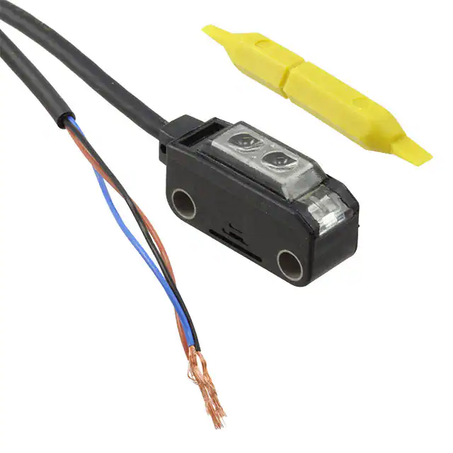

Ultra-compact Photoelectric Sensor Amplifier Built-in PNP output Light intensity type available monitor CX-400 PHOTOELECTRIC SENSORS EX-20 SERIES Conforming to EMC Directive EX-40 RX RX-LS200 UL Recognition (Excluding 5 m cable length type) Miniaturization by using single chip optical IC Long sensing range Clear beam spot using red LED dot light source The beam-receiving photodiode and the A/D conversion circuit have been fabricated on a single chip optical IC (full custom). Hence, in spite of its miniature size, it has a performance and reliability which is equal to or better than the conventional product. The EX-20 series achieves long distance sensing [thru-beam type: 2 m 6.562 ft, retroreflective type: 200 mm 7.874 in (when using the attached reflector), diffuse reflective type: 160 mm 6.299 in], despite its miniature size. Hence, it is usable even on a wide conveyor. The emission area of a dot light source is smaller than that of a conventional LED flat light source, and it is possible to design a high power, narrow beam. Since a red LED dot light source is used, the red beam spot is clear even at a far place, so that alignment and confirmation of sensing position is easy. Further, since the thrubeam type, too, incorporates a visible narrow beam, it can also reliably detect small parts, such as, chip components, lead frames, etc. EQ-30 EQ-20 Amplifier Built-in EX-10 EX-20 EX-30 Miniature-sized and still mountable with M3 screws 10.5 mm 0.413 in 8.2 mm 0.323 in 19 mm 0.748 in Thru-beam type 2 m 6.562 ft EX-28 Incorporates a sensitivity adjuster even in this size The sensor incorporates a sensitivity adjuster in spite of its miniature size. It is convenient when you need fine adjustment. Further, the receiver of the thru-beam, side sensing type sensor incorporates an operation mode switch which can change the output operation. Retroreflective type 200 mm 7.874 in Diffuse reflective type EX-26 160 mm 6.299 in " 5 mm " 0.197 in Setting distance: 80 mm 3.150 in spot " 1 mm " 0.039 in spot Setting distance: 10 mm 0.394 in Bright 2-color indicator Waterproof Globally usable A bright 2-color indicator (orange, green LED) has been incorporated in all types. The sensor can be hosed down because of its IP67 construction. Further, the sensor mounting bracket is also made of stainless steel. PNP output type, which is much in demand in Europe, is also available. Of course, it conforms to the EMC Directive and approved UL Recognition (excluding 5 m 16.404 ft cable length type). Note: However, take care that if it is exposed to water splashes during operation, it may detect a water drop itself. 218 Ramco Innovations - 1207 Maple Street, West Des Moines IA USA 50265 - 800-280-6933 - www.ramcoinnovations.com APPLICATIONS Checking protrusion of wafer Sensing objects from an opening Two types for suitable mounting Identical size Universal sensor mounting bracket is available Two types, side sensing type and front sensing type sensors are available. Select depending on the place of mounting. Front sensing type of thru-beam type and diffuse reflective type sensors have identical appearance. Moreover, since the mounting holes are symmetrical with respect to the beam axis center, the design becomes easy. Universal sensor mounting bracket (for thru-beam side sensing type EX-23 only) which can freely adjust the height and the angle of the sensor is available. Front sensing type Thru-beam type Height adjustment: 15 mm 0.591 in (Without sensitivity adjuster) EX-40 (With sensitivity adjuster) Height adjustment Diffuse reflective type EQ-30 Side sensing type Amplifier Built-in EQ-20 EX-10 EX-20 EX-30 CX-400 Detecting chip components PHOTOELECTRIC SENSORS EX-20 10 mm 0.394 in Mounting spacer for front sensing type is available It can be tightened with M3 screws. Moreover, metal inserts have been provided in the mounting holes so that the product is not damaged even in case of excess tightening. Mounting of the front sensing type is possible from the rear side by using the mounting spacer. Side sensing type Front sensing type Angle adjustment 360 rotation Mounting spacer Slit mask is available Metal inserts "0.5 mm "0.020 in round slit mask and 0.53 mm 0.0200.118 in rectangular slit mask are available for both side sensing type and front sensing type sensors. Mountable with M3 screw Ramco Innovations - 1207 Maple Street, West Des Moines IA USA 50265 - 800-280-6933 - www.ramcoinnovations.com RX Mounting section reinforced RX-LS200 10 mm 0.394 in 219 ORDER GUIDE Side sensing Side sensing Side sensing Front sensing Side sensing Diffuse reflective Long distance spot beam type Small spot beam type Diffused beam type Convergent reflective Narrow-view reflective Side sensing Thru-beam Retroreflective EX-30 EX-20 EX-10 EQ-20 Amplifier Built-in EQ-30 EX-40 Appearance Front sensing Type CX-400 PHOTOELECTRIC SENSORS EX-20 Sensing range Model No. Output EX-21A NPN open-collector transistor EX-21A-PN PNP open-collector transistor EX-21B NPN open-collector transistor EX-21B-PN PNP open-collector transistor EX-23 NPN open-collector transistor Output operation Light-ON 1m 3.281 ft Dark-ON Switchable either Light-ON or Dark-ON 2m 6.562 ft EX-23-PN PNP open-collector transistor EX-29A NPN open-collector transistor EX-29A-PN PNP open-collector transistor EX-29B NPN open-collector transistor EX-29B-PN PNP open-collector transistor EX-22A NPN open-collector transistor EX-22A-PN PNP open-collector transistor EX-22B NPN open-collector transistor EX-22B-PN PNP open-collector transistor EX-24A NPN open-collector transistor EX-24A-PN PNP open-collector transistor EX-24B NPN open-collector transistor EX-24B-PN PNP open-collector transistor EX-26A NPN open-collector transistor EX-26A-PN PNP open-collector transistor EX-26B NPN open-collector transistor EX-26B-PN PNP open-collector transistor EX-28A NPN open-collector transistor EX-28A-PN PNP open-collector transistor EX-28B NPN open-collector transistor EX-28B-PN PNP open-collector transistor Light-ON 30 to 200 mm 1.181 to 7.874 in (Note 1) Dark-ON Light-ON 5 to 160 mm 0.197 to 6.299 in (Note 2) Dark-ON Light-ON 2 to 25 mm 0.079 to 0.984 in (Convergent point: 10 mm 0.394 in) Dark-ON Light-ON 6 to 14 mm 0.236 to 0.551 in (Convergent point: 10 mm 0.394 in) Dark-ON Light-ON 45 to 115 mm 1.772 to 4.528 in Dark-ON RX-LS200 RX NOTE: Mounting bracket is not supplied with the sensor. Please select from the range of optional sensor mounting brackets (four types). Notes: 1) The sensing range of the retroreflective type sensor is specified for the RF-200 reflector. Further, the sensing range is the possible setting range for the reflector. The sensor can detect an object less than 30 mm 1.181 in away. However, if the reflector is set 100 mm 3.937 in or less away, the sensing object should be opaque. Notes: 2) In case of using this product at a sensing range of 50 mm 1.969 in or less, take care that the sensitivity adjustment range becomes extremely narrow. 220 Reflector cannot be placed in this range 200 mm Actual sensing range 7.874 in of the sensor 30 mm 1.181 in Setting range of the reflector Sensor Reflector Reflector Ramco Innovations - 1207 Maple Street, West Des Moines IA USA 50265 - 800-280-6933 - www.ramcoinnovations.com ORDER GUIDE Without reflector type and 5 m 16.404 ft cable length type Without reflector type and 5 m 16.404 ft cable length type (standard: 2 m 6.562 ft) are also available. PHOTOELECTRIC SENSORS EX-20 Side sensing Side sensing Diffused beam type Small spot beam type Front sensing Side sensing Long distance Side sensing spot beam type EX-21A EX-21A-C5 EX-21B EX-21B-C5 EX-23 EX-23-C5 Without reflector & 5 m 16.404 ft cable length type EX-29A EX-29A-Y EX-29A-C5 EX-29A-Y-C5 EX-29B EX-29B-Y EX-29B-C5 EX-29B-Y-C5 EX-22A EX-22A-C5 EX-22B EX-22B-C5 EX-24A EX-24A-C5 EX-24B EX-24B-C5 EX-26A EX-26A-C5 EX-26B EX-26B-C5 EX-28A EX-28A-C5 EX-28B EX-28B-C5 EX-20 Side sensing 5 m 16.404 ft cable length type EX-10 Front sensing Without reflector type EX-21A-PN Front sensing Side sensing EX-21B-PN EX-23-PN Side sensing EX-29A-PN EX-29A-PN-Y EX-29B-PN EX-29B-PN-Y EX-22A-PN Side sensing EX-22B-PN EX-24A-PN Front sensing Small spot beam type Side sensing EX-24B-PN EQ-30 Diffused beam type EX-26A-PN EX-26B-PN EX-28A-PN EX-28B-PN EX-40 Long distance spot beam type Side sensing EX-30 Standard Amplifier Built-in EQ-20 Diffuse Retroreflective Thru-beam reflective Convergent reflective Diffuse Narrow-view Retroreflective Thru-beam reflective reflective Convergent reflective Narrow-view reflective PNP output NPN output Type CX-400 • Table of Model Nos. Accessory RX-LS200 RX • RF-200 (Reflector) Ramco Innovations - 1207 Maple Street, West Des Moines IA USA 50265 - 800-280-6933 - www.ramcoinnovations.com 221 OPTIONS Round slit mask Designation ) ( ( Rectangular slit mask For thru-beam type sensor only For side For front For side For front sensing type sensing type sensing type sensing type Round slit mask For thru-beam type sensor only CX-400 EX-30 EX-20 EX-10 EQ-20 Amplifier Built-in EQ-30 EX-40 Model No. Fitted on the front face of the sensor with one-touch. Description • OS-EX20-05 ) PHOTOELECTRIC SENSORS EX-20 Reflector For retroreflective type sensor only ( ) Reflector mounting bracket OS-EX20-05 ( Slit size "0.5 mm 0.020 in OS-EX20E-05 ( Slit size "0.5 mm 0.020 in OS-EX20-053 Slit size 0.53 mm 0.0200.118 in ( ( ) RF-12 Sensor mounting bracket Universal sensor mounting bracket [For EX-23 only] Mounting spacer For front sensing type sensor only ( ) Sensor checker (Note) ) • Sensing range: 40 mm 1.575 in • Min. sensing object: "0.5 mm "0.020 in Slit on one side • Sensing range: 350 mm 13.780 in • Min. sensing object: "3 mm "0.118 in Slit on both sides • Sensing range: 70 mm 2.756 in • Min. sensing object: "0. 5mm "0.020 in Slit on one side • Sensing range: 600 mm 23.622 in • Min. sensing object: "2.6 mm "0.102 in Slit on both sides • Sensing range: 300 mm 11.811 in • Min. sensing object: 0.53 mm 0.0200.118 in ) RF-11 ( ) Slit on both sides • Sensing range: 800 mm 31.496 in OS-EX20E-053 Slit on one side • Min. sensing object: "3 mm "0.118 in Slit size 0.53 mm • Sensing range: 400 mm 15.748 in 0.0200.118 in Slit on both sides • Min. sensing object: 0.53 mm 0.0200.118 in • Sensing range: 50 to 400 mm 1.969 to 15.748 in RF-210 • Min. sensing object: "30 mm "1.181 in MS-RF21-1 Reflective tape For retroreflective type sensor only ) • OS-EX20E-05 • Sensing range: 200 mm 7.874 in Slit on one side • Min. sensing object: "2.6 mm "0.102 in Rectangular slit mask Fitted on the front face of the sensor with one-touch. • OS-EX20-053 • OS-EX20E-053 Reflector Reflector mounting bracket • RF-210 • MS-RF21-1 Protective mounting bracket for RF-210 It protects the reflector from damage and maintains alignment. • Ambient temperature: 25 to50 C 13 to122 F • Ambient humidity: 35 to 85 % RH Notes: i) Keep the tape free from stress. If it is pressed too much, its capability may deteriorate. Notes: ii) Do not cut the tape. It will deteriorate the sensing performance. • Sensing range: 70 to 200 mm 2.756 to 7.874 in • Sensing range: 60 to 280 mm 2.362 to 11.024 in MS-EX20-1 Back angled mounting bracket for front sensing type sensor (The thru-beam type sensor needs two brackets.) MS-EX20-2 Foot angled mounting bracket for side sensing type sensor (The thru-beam type sensor needs two brackets.) MS-EX20-3 L-shaped mounting bracket for front sensing type sensor (The thru-beam type sensor needs two brackets.) MS-EX20-4 Back angled mounting bracket for side sensing type sensor (The thru-beam type sensor needs two brackets.) MS-EX20-5 It can adjust the height and the angle of the sensor. (Two brackets are needed.) MS-EX20-FS It is used when mounting the front sensing type from the rear side. (One set consists of 10 pcs.) CHX-SC2 It is useful for beam alignment of thru-beam type sensors. The optimum receiver position is given by indicators, as well as an audio signal. 12.8 mm 0.504 in 11 mm 33.3 mm 0.433 in 1.311 in Two M3 (length 12 mm 0.472 in) screws with washers are attached. Reflective tape • RF-11 • RF-12 30 mm 1.181 in 0.7 mm 0.028 in 8 mm 0.315 in 0.7 mm 30 mm 0.028 in 1.181 in 25 mm 0.984 in Sensor mounting bracket • MS-EX20-1 • MS-EX20-2 RX-LS200 RX Note: Refer to p.414l for details of the sensor checker CHX-SC2. Mounting spacer Universal sensor mounting bracket • MS-EX20-FS • MS-EX20-5 360° rotation Material: Die-cast zinc alloy Material: Stainless steel (SUS304) Two M3 (length 5 mm 0.197 in) pan head screws [stainless steel (SUS304)] are attached. • MS-EX20-3 Material: Stainless steel (SUS304) Two M3 (length 14 mm 0.551 in) screws with washers [stainless steel (SUS304)] are attached. • MS-EX20-4 Height adjustment: 15 mm 0.591 in Mounting spacer Sensor checker • CHX-SC2 PO W ER C LE H VE L X- Material: Nylon 6 SC 2 Two M3 (length 12 mm 0.472 in) screws with washers [stainless steel (SUS304)], one M3 (length 10 mm 0.394 in) hexagon-sockethead bolt [stainless steel (SUS304)], and one M3 hexagon nut [stainless steel (SUS304)] are attached. Material: Stainless steel (SUS304) Two M3 (length 5 mm 0.197 in) pan head screws [stainless steel (SUS304)] are attached. Material: Stainless steel (SUS304) Two M3 (length 14 mm 0.551 in) screws with washers [stainless steel (SUS304)] are attached. Sensor checker 222 Ramco Innovations - 1207 Maple Street, West Des Moines IA USA 50265 - 800-280-6933 - www.ramcoinnovations.com SPECIFICATIONS Convergent reflective Narrow-view reflective Side sensing Side sensing Front sensing Side sensing Side sensing Model Light-ON EX-21A(-PN) No. (Note 1) Dark-ON EX-21B(-PN) EX-23(-PN) (Note 2) EX-29A(-PN) EX-22A(-PN) EX-24A(-PN) EX-26A(-PN) EX-28A(-PN) EX-29B(-PN) EX-22B(-PN) EX-24B(-PN) EX-26B(-PN) EX-28B(-PN) 6 to 14 mm 0.236 to 0.551 in (Conv. point: 10 mm 0.394 in) with white non-glossy paper (5050 mm 1.9691.969 in), spot diameter "1 mm "0.039 in with setting distance 10 mm 0.394 in 45 to 115 mm 1.772 to 4.528 in with white non-glossy paper (100100 mm 3.9373.937 in), spot diameter "5 mm "0.197 in with setting distance 80 mm 3.150 in Min. "0.1 mm "0.004 in copper wire Setting distance: 10 mm 0.394 in Opaque, translucent or transparent object Min. "1 mm "0.039 in copper wire at setting distance 80 mm 3.150 in Sensing range 1m 3.281 ft 2m 6.562 ft Sensing object Min. "2.6 mm "0.102 in opaque object Setting distance between emitter and receiver: 1 m 3.281 ft Min. "3 mm "0.118 in opaque object Setting distance between emitter and receiver: 2 m 6.562 ft ( )( 5 to 160 mm 2 to 25 mm 0.197 to 6.299 in 0.079 to 0.984 in 30 to 200 mm (Note 4) (Conv. point: 10 mm 0.394 in) 1.181 to 7.874 in with white non-glossy paper with white non-glossy paper (Note 3) (200200 mm) (5050 mm) (7.8747.874 in) (1.9691.969 in) ) "15 mm "0.591 in or more opaque or translucent object (Note 3) Opaque, translucent or transparent object Hysteresis Repeatability (perpendicular to sensing axis) ( )( )( ) 15 % or less of operation distance 0.1 mm 0.004 in or less 0.05 mm 0.002 in or less 0.5 mm 0.020 in or less 0.3 mm 0.012 in or less 0.3 mm 0.012 in or less (Setting distance: 10 mm 0.394 in) (Setting distance: 10 mm 0.394 in) 0.05 mm 0.002 in or less 12 to 24 V DC 10 % Ripple P-P 10 % or less Supply voltage Current consumption Min. "0.1 mm "0.004 in copper wire Setting distance: 10 mm 0.394 in EX-30 Side sensing CX-400 Diffused beam type Small spot beam type Long distance spot beam type Front sensing Emitter: 10 mA or less, Receiver: 15 mA or less EX-20 Item Retroreflective Diffuse reflective Thru-beam Type PHOTOELECTRIC SENSORS EX-20 20 mA or less DC-12 or DC-13 Short-circuit protection Incorporated Response time Green LED (lights up under stable light received condition or stable dark condition), located on the receiver Green LED (lights up under stable light received condition or stable dark condition) Sensitivity adjuster Continuously variable adjuster, located on the emitter Operation mode switch Located on the receiver Pollution degree 35 to 85 % RH, Storage: 35 to 85 % RH Sunlight: 10,000 #x at the light-receiving face, Incandescent light: 3,000 #x at the light-receiving face EMC Voltage withstandability to 70 °C 22 to 158 °F EN 50081-2, EN 50082-2, EN 60947-5-2 1,000 V AC for one min. between all supply terminals connected together and enclosure Insulation resistance 20 MΩ, or more, with 250 V DC megger between all supply terminals connected together and enclosure Vibration resistance 10 to 500 Hz frequency, 3 mm 0.118 in amplitude (20 G max.) in X, Y and Z directions for two hours each Shock resistance 500 m/s2 acceleration (50 G approx.) in X, Y and Z directions for three times each Emitting element Red LED (modulated) Material Cable Cable extension Weight Accessories EX-40 Environmental resistance IP67 (IEC) 25 to 55 °C 13 to 131 °F (No dew condensation or icing allowed), Storage: 30 Ambient humidity Ambient illuminance Continuously variable adjuster 3 (Industrial environment) Protection Ambient temperature Continuously variable adjuster RX Stability indicator Orange LED (lights up when the output is ON) (thru-beam type: located on the receiver) Enclosure: Polyethylene terephthalate, Lens: Polyalylate 0.1 mm2 3-core (thru-beam type sensor emitter: 2-core) cabtyre cable, 2 m 6.562 ft long Extension up to total 50 m 164.042 ft is possible with 0.3 mm2, or more, cable (thru-beam type: both emitter and receiver). Emitter: 20 g approx., Receiver: 20 g approx. 20 g approx. RF-200 (Reflector): 1 pc. Adjusting screwdriver: 1 pc. Adjusting screwdriver: 1 pc. Adjusting screwdriver: 1 pc. Notes: 1) Model Nos. having the suffix ‘-PN’ are PNP output type. Notes: 2) Either Light-ON or Dark-ON can be selected by the operation mode switch (located on the receiver). 3) The sensing range and the sensing object of the retroreflective type sensor are specified for the RF-200 reflector. Further, the sensing range is the possible setting range for the reflector. The sensor can detect an object less than 30 mm 1.181 in away. However, if the reflector is set 100 mm 3.937 in or less away, the sensing object should be opaque. Notes: 4) In case of using this product at a sensing range of 50 mm 1.969 in or less, take care that the sensitivity adjustment range becomes extremely narrow. Adjusting screwdriver: 1 pc. Reflector cannot be placed in this range 200 mm Actual sensing range 7.874 in of the sensor 30 mm 1.181 in Setting range of the reflector Sensor Reflector Ramco Innovations - 1207 Maple Street, West Des Moines IA USA 50265 - 800-280-6933 - www.ramcoinnovations.com Reflector 223 RX-LS200 Operation indicator 0.5 ms or less EQ-30 Utilization category Amplifier Built-in EQ-20 Output NPN open-collector transistor PNP open-collector transistor • Maximum sink current: 50 mA • Maximum source current: 50 mA • Applied voltage: 30 V DC or less (between output and 0 V) • Applied voltage: 30 V DC or less (between output and V) • Residual voltage: 1 V or less (at 50 mA sink current) • Residual voltage: 1 V or less (at 50 mA source current) 0.4 V or less (at 16 mA sink current) 0.4 V or less (at 16 mA source current) EX-10 PHOTOELECTRIC SENSORS EX-20 I/O CIRCUIT AND WIRING DIAGRAMS NPN output type I/O circuit diagram Wiring diagram CX-400 Color code Sensor circuit (Brown) V Color code D Load   (Black) Output (Note) ZD Tr 50 mA max. (Blue) 0 V 12 to 24 V DC 10 % Brown Load   EX-30 Black (Note) Internal circuit Users’ circuit Blue Note: The emitter of the thru-beam type sensor does not incorporate the output. Symbols ... D : Reverse supply polarity protection diode ZD: Surge absorption zener diode Tr : NPN output transistor EX-20 12 to 24 V DC 10 % Note: The emitter of the thru-beam type sensor does not incorporate the black wire. PNP output type I/O circuit diagram Wiring diagram Color code Color code ZD (Black) Output (Note) D   50 mA max. Load 12 to 24 V DC 10 % Brown (Blue) 0 V Internal circuit Load Users’ circuit Note: The emitter of the thru-beam type sensor does not incorporate the output. Symbols ... D : Reverse supply polarity protection diode ZD: Surge absorption zener diode Tr : PNP output transistor Note: The emitter of the thru-beam type sensor does not incorporate the black wire. SENSING CHARACTERISTICS (TYPICAL) EX-21 EX-23 10 5 EX-21 0 1 2 3 4 5 3.281 6.562 9.843 13.123 16.404 Setting distance L (m ft) 100 Excess gain 5 1 0 0.5 1.640 # 0 100 3.937 200 400 600 800 1,000 7.874 15.748 23.622 31.496 39.370 Setting distance L (mm in) Emitter L Receiver EX-22 10 5 0 224 50 100 150 200 250 1.969 3.937 5.906 7.874 9.843 Setting distance L (mm in) 200 7.874 Emitter # 0 20 0.787 Emitter $ L Receiver 0.5 1.640 20 0 20 Left Center Right Operating angle $ ( ° ) 40 Parallel deviation with rectangular slit masks (0.53 mm 0.0200.118 in) 800 31.496 Slit on one side Slit on both sides 100 3.937 1 3.281 0 40 50 0 50 100 1.969 1.969 3.937 Left Center Right Operating point ? (mm in) Parallel deviation with round slit masks ("0.5 mm "0.020 in) 50 1 10 Setting distance L (mm in) 1 EX-29 1 3.281 Setting distance L (m ft) 50 Angular deviation Parallel deviation Setting distance L (m ft) 50 Excess gain 100 Excess gain 100 Thru-beam type L Receiver 10 0 10 20 0.394 0.394 0.787 Left Center Right Operating point ? (mm in) Setting distance L (mm in) EX-21 EX-23 EX-29 EX-22 RX EX-40 12 to 24 V DC 10 % Blue Correlation between setting distance and excess gain RX-LS200   Black (Note) EQ-30 EQ-20 Amplifier Built-in EX-10 Sensor circuit (Brown) V Tr 600 23.622 400 15.748 200 7.874 0 40 1.575 Slit on one side Slit on both sides Emitter # L Receiver 20 0 20 40 0.787 0.787 1.575 Left Center Right Operating point ? (mm in) Ramco Innovations - 1207 Maple Street, West Des Moines IA USA 50265 - 800-280-6933 - www.ramcoinnovations.com SENSING CHARACTERISTICS (TYPICAL) Thru-beam type Parallel deviation with round slit masks ("0.5 mm "0.020 in) Emitter # L Sensor 10 0 10 20 0.394 0.394 0.787 Left Center Right Operating point ? (mm in) 200200 mm 7.8747.874 in Non-glossy paper 100 3.937 40 4 0.157 L 0 40 1.575 Receiver 20 0 20 40 0.787 0.787 1.575 Left Center Right Operating point ? (mm in) Reflector angular deviation Sensor angular deviation Reflector (RF-200) $ L Reflector angular deviation Reflector (RF-200) $ L Sensor Sensor 20 0 20 Left Center Right Operating angle $ ( ° ) 40 EQ-30 aa mm aa in White non-glossy paper L Sensor 2 0 2 4 0.079 0.079 0.157 Center Left Right Operating point # (mm in) EX-24 Sensor angular deviation 100 3.937 Sensor 0 Receiver 10 0 10 20 0.394 0.394 0.787 Left Center Right Operating point ? (mm in) L 0 50 100 150 1.969 3.937 5.906 White non-glossy paper side length a (mm in) 200 7.874 RX # # EX-40 White nonglossy paper 50 1.969 200 7.874 0 Sensing range L (mm in) Setting distance L (mm in) 100 3.937 L Correlation between sensing object size and sensing range As the sensing object size becomes smaller than the standard size (white non-glossy paper 200 200200 mm 7.8747.874 in), the sensing 7.874 range shortens, as shown in the left graph. Black non-glossy paper Lightness: 6 150 5.906 0 20 0.787 # Emitter Diffuse reflective type Sensing field 200 7.874 100 Slit on both 3.937 sides Slit on both sides 0.5 1.640 EX-10 Setting distance L (mm in) Setting distance L (mm in) # EX-22 50 0 50 100 Left Center Right $ Operating point (°) Emitter Slit on one side Angular deviation Reflector (RF-200) 20 0.787 L 200 7.874 1 3.281 Retroreflective type 200 7.874 0 $ 0 100 Parallel deviation 100 3.937 Emitter 1 3.281 Receiver Receiver 50 0 50 100 1.969 1.969 3.937 Left Center Right Operating point ? (mm in) EX-29 300 11.811 Amplifier Built-in EQ-20 0 100 3.937 L Slit on one side EX-20 1 3.281 2 6.562 Setting distance L (mm in) 2 6.562 Setting distance L (m ft) Setting distance L (m ft) 400 15.748 Parallel deviation with rectangular slit masks (0.53 mm 0.0200.118 in) CX-400 Angular deviation Convergent reflective type 40 1.575 30 1.181 10 0.394 0 4 0.157 5050 mm 1.9691.969 in White non-glossy paper # 8 mm 0.315 in L Sensor Setting distance L (mm in) Setting distance L (mm in) 40 1.575 2 0 2 4 0.079 0.079 0.157 Left Center Right Operating point ? (mm in) 30 1.181 RX-LS200 Sensing fields • Horizontal (left and right) direction • Vertical (up and down) direction 20 0.787 EX-30 Parallel deviation Setting distance L (m ft) EX-23 PHOTOELECTRIC SENSORS EX-20 5050 mm 1.9691.969 in White non-glossy paper 6 mm 0.236 in # L Sensor 20 0.787 10 0.394 0 4 0.157 2 0 2 4 0.079 0.079 0.157 Left Center Right Operating point ? (mm in) Ramco Innovations - 1207 Maple Street, West Des Moines IA USA 50265 - 800-280-6933 - www.ramcoinnovations.com 225 EX-24 Convergent reflective type Correlation between lightness and sensing range Correlation between material (5050 mm 1.9691.969 in) and sensing range 40 80 The sensing region is representThe bars in the graph indicate the 3.150 1.575 ed by oblique lines in the left sensing range for the respective figure. However, the sensitivity material. However, there is a 30 60 should be set with enough mar- 2.362 slight variation in the sensing 1.181 gin because of slight variation in range depending on the product. products. Further, if there is a reflective 20 40 1.575 0.787 object (conveyor, etc.) in the background of the sensing object, Sensing region 10 20 since it affects the sensing, 0.787 0.394 separate it by more than twice the sensing range shown in the left 0 0 graph. N2 N4 N6 N8 Lightness shown on the left Dark Lightness Light may differ slightly from the actual object condition. N1 N2 N3 N4 N5 N6 N7 N8 N9 EX-26 Mirror Distance to convergent point Aluminum plate Stainless steel plate (SUS304) ) White non-glossy paper ( Black-painted non-glossy plate Black non-glossy paper (N5) Distance to convergent point Sensing range L (mm in) Sensing range L (mm in) PHOTOELECTRIC SENSORS CX-400 SENSING CHARACTERISTICS (TYPICAL) EX-20 EX-30 EX-20 Convergent reflective type Sensing field • Horizontal (left and right) direction • Vertical (up and down) direction 20 0.787 Setting distance L (mm in) Setting distance L (mm in) 15 0.591 5050 mm 1.9691.969 in White nonglossy paper 10 0.394 5 0.197 4.1 mm 0.161 in # L 15 0.591 1 0.039 13.5 mm 0.531 in # L Sensor 10 0.394 5 0.197 Sensor 0.5 0 0.5 1 0.020 0.020 0.039 Left Center Right Operating point ? (mm in) 0 5050 mm 1.9691.969 in White non-glossy paper 0 1 0.039 0.5 0 0.5 1 0.020 0.020 0.039 Left Center Right Operating point ? (mm in) EX-28 Approach direction of black non-glossy paper White nonglossy paper 100 3.937 50 1.969 0 4 0.157 226 Distance to convergent point Mirror Aluminum plate Stainless steel plate (SUS304) ) Correlation between sensing object size and sensing range Black non-glossy paper Lightness: 6 100100 mm 3.9373.937 in Non-glossy paper 4.1 mm 0.161 in # L Sensor 2 0 2 4 0.079 0.079 0.157 Left Center Right Operating point ? (mm in) 200 7.874 Sensing range L (mm in) Setting distance L (mm in) RX-LS200 150 5.906 ( Narrow-view reflective type Sensing field 200 7.874 White non-glossy paper ) Black non-glossy paper (N5) ( Black-painted non-glossy plate ) Sensing range L (mm in) ( Distance to convergent point Sensing range L (mm in) Correlation between lightness and sensing range Correlation between material (5050 mm 1.9691.969 in) and sensing range 20 The sensing region is representThe bars in the graph indicate the 0.787 ed by oblique lines in the left sensing range for the respective 40 figure. However, the sensitivity material. However, there is a 15 1.575 0.591 should be set with enough marslight variation in the sensing gin because of slight variation in range depending on the product. products. Further, if there is a reflective 10 Sensing region 0.394 The graph is drawn for the object (conveyor, etc.) in the 20 0.787 maximum sensitivity setting. background of the sensing object, 5 since it affects the sensing, 0.197 separate it by more than twice the sensing range shown in the left 0 0 graph, or adjust the sensitivity N2 N4 N6 N8 Lightness shown on the left adjuster. Dark Lightness Light may differ slightly from the The graph is drawn for the actual object condition. N1 N2 N3 N4 N5 N6 N7 N8 N9 maximum sensitivity setting. RX EX-40 EQ-30 EQ-20 Amplifier Built-in EX-10 20 0.787 As the sensing object size becomes smaller than the standard size (white non-glossy paper 100100 mm 3.9373.937 in), the sensing range shortens, as shown in the left graph. 150 5.906 100 3.937 50 1.969 aa mm aa in White non-glossy paper L Sensor 0 50 100 150 1.969 3.937 5.906 White non-glossy paper side length a (mm in) 200 7.874 Ramco Innovations - 1207 Maple Street, West Des Moines IA USA 50265 - 800-280-6933 - www.ramcoinnovations.com Refer to p.1135l for general precautions. This product is not a safety sensor. Its use is not intended or designed to protect life and prevent body injury or property damage from dangerous parts of machinery. It is a normal object detection sensor. Mounting • Mount using M3 screws. The tightening torque should be 0.5 N m or less. Front sensing Side sensing Stability indicator • The stability indicator (green) lights up when the incident light intensity has sufficient margin with respect to the operation level. If the incident light intensity level is such that the stability indicator lights up, stable sensing can be done without the light received operation and the light interrupted operation being affected by a change in ambient temperature or supply voltage. PHOTOELECTRIC SENSORS PRECAUTIONS FOR PROPER USE CX-400 EX-20 Operation of stability indicator EX-30 M3 screws Light interruption margin the mounting spacer (MS-EX20-FS) and fix with screws. 100 EX-20 • When mounting the front sensing type from the backside, fit 25 % approx. Incident light intensity (%) Note: When mounting the front sensing type sensor, use M3 pan head screws without washers, etc. 15 % approx. Output operation level Light received operation M3 pan head screws (Note) Light interrupted operation Incident light margin Lights up Lights off Lights up Output operation 0 Glossy object sensing [EX-29(-PN)] • Please take care of the following points when detecting materials having a gloss. 1 Make L, shown in the diagram, sufficiently long. 2 Install at an angle of 10 to 30 degrees to the sensing object. Reflector Glossy surface Sensing object 10 to 30  M3 screws Step Sensitivity adjuster Description Sensor MAX Turn the sensitivity adjuster fully counterclockwise to the minimum sensitivity position (• mark). 1 MAX 2 A B MAX 3 Optimum position In the dark condition, turn the sensitivity adjuster further clockwise until the sensor enters the ‘Light’ state operation and then bring it back to confirm point b where the sensor just returns to the ‘Dark’ state operation. If the sensor does not enter the ‘Light’ state operation even when the sensitivity adjuster is turned fully clockwise, this extreme position is point b. B ) MAX The position at the middle of points is the optimum sensing position. @ and b L Make L sufficiently long Wiring • Make sure that the power supply is off while wiring. • Verify that the supply voltage variation is within the rating. • If power is supplied from a commercial switching regulator, ensure that the frame ground (F.G.) terminal of the power supply is connected to an actual ground. • In case noise generating equipment (switching regulator, inverter motor, etc.) is used in the vicinity of this product, connect the frame ground (F.G.) terminal of the equipment to an actual ground. • Do not run the wires together with high-voltage lines or power lines or put them in the same raceway. • This can cause malfunction due to induction. A Notes: 1) Use the attached adjusting screwdriver to turn the adjuster slowly. Turning with excessive strength will damage the adjuster. Notes: 2) In case of using EX-22 at a sensing distance of 50 mm 1.969 in or less, take care that the sensitivity adjustment range becomes extremely narrow. Operation mode switch (EX-23 only) Switch position L D L D Description Light-ON mode is obtained when the operation mode switch (located on the receiver) is turned fully clockwise (L side). Dark-ON mode is obtained when the operation mode switch (located on the receiver) is turned fully counterclockwise (D side). Others • Do not use during the initial transient time (50 ms) after the power supply is switched on. • If sensors are mounted close together and the ambient temperature is near the maximum rated value, provide for enough heat radiation / ventilation. • If a reflective object is present in the background, the sensing of EX-28A(-PN) and EX-28B(-PN) may be affected. When setting the sensor, make sure to confirm that the reflective object has no effect. In case the reflective object affects the sensing, take measures such as removing the reflective object or coloring it in black, etc. Note: Operation mode switch should be turned fully till it stops. Ramco Innovations - 1207 Maple Street, West Des Moines IA USA 50265 - 800-280-6933 - www.ramcoinnovations.com 227 RX-LS200 4 In the light received condition, turn the sensitivity adjuster slowly clockwise and confirm the point @ where the sensor enters the ‘Light’ state operation. ( A EQ-30 Sensitivity adjustment (side sensing type only) EX-40 Mounting spacer (Optional) 2 Align the mounting holes of the mounting spacer and the sensor and mount with M3 screws. The tightening torque should be 0.5 N m or less. RX 1 Fit the mounting spacer on the sensor. Amplifier Built-in EQ-20 Mounting method EX-10 0 Setting distance DIMENSIONS (Unit: mm in) EX-21 The CAD data in the dimensions can be downloaded from the SUNX website: http://www.sunx.co.jp/ EX-23 Sensor Sensor Operation indicator (Orange) (Note 1) CX-400 PHOTOELECTRIC SENSORS EX-20 Stability indicator (Green) (Note) Beam axis 4.5 0.177 16 0.630 Operation indicator (Orange) (Note) Stability indicator (Green) (Note 1) 8.2 0.323 EX-30 9.5 0.374 19 13 0.512 0.748 6.5 0.256 3 0.118 3 0.118 2-"3.2 "0.126 mounting holes "2.5 "0.098 cable, 2 m 6.562 ft long EX-10 EX-20 2-"3.2 "0.126 mounting holes 2.3 0.091 10 0.394 "2.5 "0.098 cable, 2 m 6.562 ft long 3.5 0.138 Note: Not incorporated on the emitter. Notes: 1) Not incorporated on the emitter. 2) It is the sensitivity adjuster on the emitter. EX-29 EX-22 EX-26 EX-28 Sensor EX-24 Sensor Operation indicator (Orange) 12.3 0.484 10 0.394 Stability indicator (Green) 8.2 0.323 Beamreceiving part Beamemitting part Stability indicator (Green) Beam-emitting part Sensitivity adjuster Beam-receiving part 4.5 0.177 2.8 0.110 16 0.630 5 0.197 Operation indicator (Orange) 3 0.118 11 0.433 5 0.197 5.5 0.217 EQ-30 EQ-20 Amplifier Built-in 2.8 0.110 3 0.118 Beam axis 18 9 0.709 0.354 Operation mode switch (Note 2) 10.5 0.413 18 9 0.709 0.354 22 16 0.630 0.866 3 0.118 3 0.118 2-"3.2 "0.126 mounting holes EX-40 5.3 0.209 RF-200 2-"3.2 "0.126 mounting holes 2.3 0.091 10 0.394 "2.5 "0.098 cable, 2 m 6.562 ft long "2.5 "0.098 cable, 2 m 6.562 ft long Reflector (Accessory for the retroreflective type sensor) RF-210 Reflector (Optional) RX 33.3 1.311 9.6 0.378 RX-LS200 17.5 0.689 7.75 0.305 6.5 0.256 4.6 0.181 1.5 0.059 12.8 0.504 "2.3 "0.091 Reflector 13 0.512 (13) (0.512) 2.3 0.091 3.5 0.138 11 0.433 3.2 0.126 "3.2 "0.126 mounting hole Material: Acrylic (Reflector) ABS (Base) 228 M3 nut mounting holes (for mounting at the back) Material: Acrylic (Reflector) ABS (Base) Two M3 (length 8 mm 0.315 in) screws with washers and two nuts are attached. Base 25 0.984 10 0.394 2-"3.4 "0.134 thru-holes (for mounting at the side) 2-"3.4 "0.134 holes, 6 0.236 deep (for mounting at the back) 2-M3 nut mounting holes (for mounting at the side) Ramco Innovations - 1207 Maple Street, West Des Moines IA USA 50265 - 800-280-6933 - www.ramcoinnovations.com RF-12 Reflective tape (Optional) Reflective tape (Optional) 30 1.181 (28)(1.102) 30 1.181 (28)(1.102) 0.7 0.028 CX-400 RF-11 The CAD data in the dimensions can be downloaded from the SUNX website: http://www.sunx.co.jp/ 0.7 0.028 (23) 25 0.984 (0.906) EX-30 DIMENSIONS (Unit: mm in) 8 0.315 Effective reflecting surface Effective reflecting surface Adhesive tape Material: Acrylic Material: Acrylic 5.5 0.217 Assembly dimensions 23 0.906 5.5 0.217 23 0.906 50 "36 "1.417 1.969 50 "36 "1.417 1.969 30  10 0.394 3.2 0.126 30  20  16 0.630 3.5 0.138 10 0.394 20  EQ-30 Material: Stainless steel (SUS304) Two M3 (length 12 mm 0.472 in) screws with washers are attached. EX-10 Reflector mounting bracket for RF-210 (Optional) Amplifier Built-in EQ-20 MS-RF21-1 Adhesive tape EX-20 (6) (0.236) R7.5 R0.295 "25 "0.984 46 25 1.811 0.984 12.5 0.492 13 0.512 PHOTOELECTRIC SENSORS EX-20 46 1.811 25 0.984 12.8 0.504 13 0.512 EX-40 t 1.2 t 0.047 Sensor mounting bracket (Optional) Assembly dimensions Mounting drawing with EX-21 t 1.5 t 0.059 10.5 0.413 t 1.5 t 0.059 10.5 0.413 RX MS-EX20-1 (1.2) (0.047) 5 0.197 4-M30.5 0.020 29.5 1.161 11 5 10 0.394 0.433 0.197 3.2 2 0.126 0.079 12 0.472 Material: Stainless steel (SUS304) 19 9 0.354 0.748 4.5 0.177 RX-LS200 (6.5)(0.256) 5 0.197 29.5 1.161 16 5 0.630 0.197 (12)(0.472) 16 0.630 3.2 0.126 2 0.079 19 9 1.5 0.354 10.5 0.748 0.413 0.059 Beam-receiving part 2 0.079 2 0.079 Two M3 (length 5 mm 0.197 in) pan head screws [stainless steel (SUS304)] are attached. 10 0.394 11 0.433 Ramco Innovations - 1207 Maple Street, West Des Moines IA USA 50265 - 800-280-6933 - www.ramcoinnovations.com 229 PHOTOELECTRIC SENSORS EX-20 DIMENSIONS (Unit: mm in) MS-EX20-2 1 Sensor mounting bracket (Optional) CX-400 8 0.315 3.5 0.138 3.2 0.126 2 0.079 EX-30 3.2 0.126 R13 R0.512 The CAD data in the dimensions can be downloaded from the SUNX website: http://www.sunx.co.jp/ 2 3-M30.5 0.020 3 0.118 2.5 0.098 13 0.512 16 0.630 14  3.2 0.126 EX-20 t 1.2 t 0.047 16 3 0.118 0.630 (24.1) (0.949) 7.5 0.295 12.5 0.492 10  2 0.079 16 0.630 14  8 0.315 R13 R0.512 Beam-receiving part 14.5 0.571 34 1.339 10.5 0.413 3.2 0.126 3 0.118 3.2 0.126 3.5 0.138 2.5 0.098 2.5 0.098 0.3 0.012 11.6 0.457 16 0.630 12.5 7.5 0.492 0.295 t 1.5 t 0.059 Assembly dimensions Mounting drawing with the receiver of EX-23 13 0.512 Material: Stainless steel (SUS304) Two M3 (length 14 mm 0.551 in) screws with washers [stainless steel (SUS304)] are attached. 34 1.339 17.5 0.689 24 0.945 EQ-30 EQ-20 Amplifier Built-in EX-10 t 1.2 t 0.047 MS-EX20-3 Sensor mounting bracket (Optional) Assembly dimensions Mounting drawing with the receiver of EX-21 t 1.5 t 0.059 14 0.551 9 0.354 3.2 0.126 2 0.079 4-M30.5 0.020 9 0.354 20 0.787 10 6.5 0.394 0.256 19 12 0.748 0.472 3.2 0.126 2 0.079 2 0.079 14 0.551 9 0.354 9 0.354 Material: Stainless steel (SUS304) Two M3 (length 5 mm 0.197 in) pan head screws [stainless steel (SUS304)] are attached. t 1.5 t 0.059 18.5 0.728 (1.2) (0.047) 4.5 0.177 3.5 16 0.138 0.630 11.5 0.453 1.5 0.059 10.5 19 0.413 0.748 Beam-receiving part 2 0.079 EX-40 10 0.394 MS-EX20-4 Sensor mounting bracket (Optional) 1 2 RX 3-M30.5 0.020 2.5 0.098 RX-LS200 13 0.512 13 0.512 8 0.315 R13 R0.512 3.2 0.126 3 0.118 3.2 0.126 t 1.2 t 0.047 17 0.669 14  2.5 0.098 t 1.5 t 0.059 230 3 0.118 0.3 0.012 (24.6) (0.969) 12.1 0.476 8.2 0.323 8 0.315 2.5 0.098 10  Beam-receiving part 13 0.512 R13 3.2 0.126 R0.512 3 0.118 3.5 0.138 4.5 0.177 13 12 0.512 0.472 8 0.315 10.5 0.413 16 0.630 14.5 12 0.472 23 0.571 0.906 5 0.197 3 0.118 Assembly dimensions Mounting drawing with the receiver of EX-23 Material: Stainless steel (SUS304) Two M3 (length 14 mm 0.551 in) screws with washers [stainless steel (SUS304)] are attached. 17 0.669 8 0.315 14  t 1.2 t 0.047 23 0.906 3 0.118 Ramco Innovations - 1207 Maple Street, West Des Moines IA USA 50265 - 800-280-6933 - www.ramcoinnovations.com Universal sensor mounting bracket (Optional) 2.6 0.102 1.5 0.059 4.1 0.161 22.5 19.5 0.886 0.768 23.5 25.5 0.925 1.004 2.2 0.087 9.5 16 0.374 0.630 2-M30.5 0.020 7 0.276 30 1.181 Assembly dimensions Mounting drawing with the receiver of EX-23 2.6 3.2 0.126 0.102 "7 "0.276 6 0.236 3 0.118 3 0.118 8.5 0.335 13 19.5 22.5 0.512 0.768 0.886 2-"3.2 "0.126 mounting holes 12 0.472 3.2 0.126 6 0.236 14 0.551 "7 "0.276 4.5 0.177 19.5 0.768 Material: Die-cast zinc alloy Two M3 (length 12 mm 0.472 in) screws with washers [stainless steel (SUS304)], one M3 (length 10 mm 0.394 in) hexagonsocket-head bolt [stainless steel (SUS304)], and one M3 hexagon nut [stainless steel (SUS304)] are attached. "7 "0.276 14 0.551 8.5 0.335 (15) (0.591)(Note) 30 1.181 12 15 0.472 0.591 6 0.236 Material: Nylon 6 13 0.512 25.5 1.004 6.5 0.256 4 0.157 2-"3.2 2-"3.3 "0.130 "0.126 thru-holes mounting holes 2 0.079 2.2 0.087 3 0.118 3 (6.7) 0.118 (0.264) 8 0.315 15 0.591 1.5 0.059 12 0.472 (7.3)(0.287) Beam5.5 0.217 receiving part 15.5 0.610 5.5 0.217 CX-400 2 2 0.079 19.5 0.768 Note: This is the adjustable range of the movable part. MS-EX20-FS Mounting spacer (Optional) 2.5 0.098 2-"3.4 "0.134 mounting holes 10 0.394 Beam-receiving part 0.3 0.012 16 0.630 4.2 0.165 10.7 8 4.9 0.315 0.421 0.193 9 23 0.354 0.906 8 0.315 6 0.236 Material: Polycarbonate EQ-30 4.5 0.177 4.5 0.177 Amplifier Built-in EQ-20 Assembly dimensions Mounting drawing with the receiver of EX-21 16 0.630 2 0.079 6 0.236 10 0.394 RX-LS200 RX EX-40 "2.5 "0.098 EX-30 1 EX-10 MS-EX20-5 The CAD data in the dimensions can be downloaded from the SUNX website: http://www.sunx.co.jp/ EX-20 DIMENSIONS (Unit: mm in) PHOTOELECTRIC SENSORS EX-20 Ramco Innovations - 1207 Maple Street, West Des Moines IA USA 50265 - 800-280-6933 - www.ramcoinnovations.com 231
