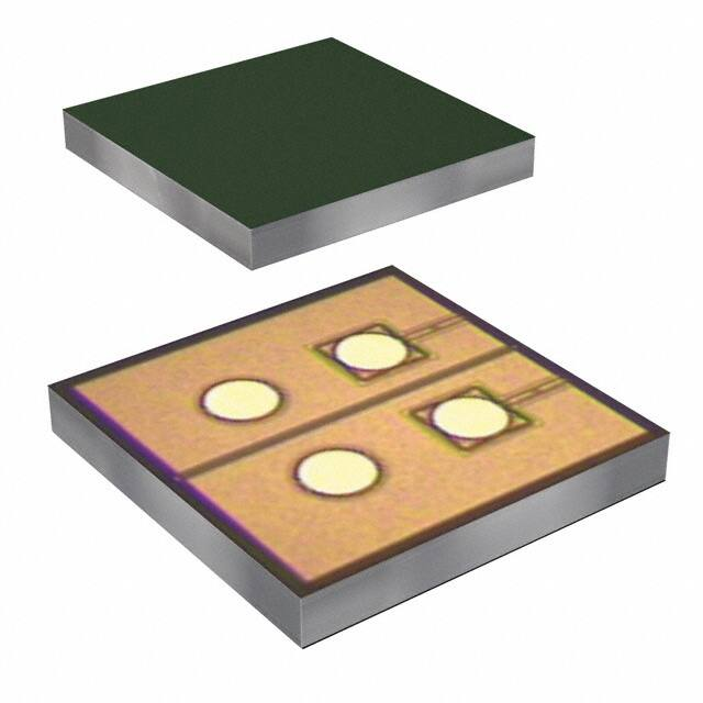

    带栅极电阻的双N沟道MOSFET用于锂离子二次电池保护电路
FC4B22180L1 数据手册
Doc No. TT4-EA-15078 Revision. 1 Product Standards MOS FET FC4B22180L1 FC4B22180L1 Gate resistor installed Dual N-channel MOS FET Unit: mm For lithium-ion secondary battery protection circuits 1.74 3 1 2  Features  Low source-source ON resistance:Rss(on) typ. = 10 mW(VGS = 3.8 V)  CSP(Chip Size Package)  RoHS compliant (EU RoHS / MSL:Level 1 compliant) 0.11 1.74 4 0.65 φ0.3  Marking Symbol: 17  Packaging Embossed type (Thermo-compression sealing) : 1 000 pcs / reel (standard) (0.545) 0.65 (0.545) 1. Source (FET1) 3. Gate (FET2) 2. Gate (FET1) 4. Source (FET2)  Absolute Maximum Ratings Ta = 25 C Parameter Symbol Source-source Voltage Gate-source Voltage Source Current Total Power Dissipation DC *1 DC *2 Pulse *3 DC *1 DC *2 Channel Temperature Storage Temperature Range Thermal Resistance (ch-a) Note DC *1 DC *2 VSS VGS IS1 IS2 ISp PD1 PD2 Tch Tstg Rth1 Rth2 Rating Unit 20 8 5 10 50 0.4 1.5 150 -55 to +150 312 83 V V A A A W W C C C/W C/W Panasonic JEITA Code MLGA004-W-1717-RB ― ― Equivalent circuit FET2 FET1 *1 Mounted on FR4 board (25.4mm  25.4mm  t1.0mm, 36mm Copper) *2 Mounted on Ceramic substrate (70 mm  70 mm  t1.0 mm). *3 t = 10 ms, Duty Cycle  1 % Page 1 of 5 Established : 2015-10-23 Revised : ####-##-## Doc No. TT4-EA-15078 Revision. 1 Product Standards MOS FET FC4B22180L1  Electrical Characteristics Ta = 25 C  3 C Parameter Symbol Source-source Breakdown Voltage Zero Gate Voltage Source Current VSSS ISSS Gate-source Leakage Current IGSS Gate-source Threshold Voltage Source-source On-state Resistance Body Diode Forward Voltage Input Capacitance *1 Output Capacitance *1 Reverse Transfer Capacitance Turn-on delay Time *1,*2 Rise Time *1,*2 Turn-off delay Time *1,*2 Fall Time *1,*2 Total Gate Charge *1 Gate-source Charge *1 Gate-drain Charge *1 Note *1 Vth RSS(on)1 RSS(on)2 RSS(on)3 RSS(on)4 VF(s-s) Ciss Coss Crss td(on) tr td(off) tf Qg Qgs Qgd Conditions Min IS = 1 mA, VGS = 0 V VSS = 20 V, VGS = 0 V VGS = 8 V, VSS = 0 V VGS = 5 V, VSS = 0 V IS = 0.64 mA, VSS = 10 V IS = 2.5 A, VGS = 4.5 V IS = 2.5 A, VGS = 3.8 V IS = 2.5 A, VGS = 3.1 V IS = 2.5 A, VGS = 2.5 V IF = 2.5 A, VGS = 0 V Typ Max Unit 20 0.35 7 7.3 8.1 8.6 VSS = 10 V, VGS = 0 V, f = 1 MHz VDD = 10 V, VGS = 0 to 4.0 V IS = 2.5 A VDD = 10 V, VGS = 4.0 to 0 V IS = 2.5 A VDD = 10 V VGS = 0 to 4.0 V, IS = 2.5 A 0.90 9.4 10 11.1 13.4 0.8 2440 200 160 0.9 1.6 5 2.4 23 6 5 V mA 1.0 10 1.0 1.4 11.9 12.9 15.8 22.6 1.2 mA V mW V pF ms ms nC Measuring methods are based on JAPANESE INDUSTRIAL STANDARD JIS C 7030 Measuring methods for transistors. *1 Guaranteed by design, not subject to production testing *2 Measurement circuit for Turn-on Delay Time / Rise Time / Turn-off Delay Time / Fall Time Note2 : Measurement circuit VDD = 10 V IS = 2.5 A RL = 4.0 W Vout S2 90 % Vin 10 % Rg G2 90 % G1 Vin 4V 90 % Vout Rg 10 % 10 % 50 W 0V PW = 10 ms D.C.  1 % S1 td(on) tr td(off) tf Page 2 of 5 Established : 2015-10-23 Revised : ####-##-## Doc No. TT4-EA-15078 Revision. 1 Product Standards MOS FET FC4B22180L1 Technical Data ( reference ) IS - VSS RSS(on) - IS Source-source ON-state Resistance RSS (on) ( mW ) 10 Source Current IS ( A ) VGS = 4.5 V 8 3.8 V 3.1 V 6 2.5 V 4 2.0 V 2 ※Pulse measurement 0 0 0.1 0.2 20 ※Pulse measurement 15 2.5 V 3.1 V 3.8 V 10 VGS = 4.5 V 5 0.3 1 3 IS - VGS 7 9 RSS(on) - VGS 10 Source-source ON-state Resistance RSS (on) ( mW ) 30 ※Pulse measurement Source Current IS ( A ) 5 Source Current IS (A) Source-source Voltage VSS (V) Ta = 85 °C 1 0.1 25 °C 0.01 -40 °C 0.001 0 0.5 1 1.5 2 ※Pulse measurement 20 Ta = 85 °C 10 25 °C 0 1 2 Gate-source Leakage Current IGS ( A ) ※Pulse measurement Ta = 85 °C 0.1 25 °C 0.01 -40 °C 0.001 0.2 0.4 4 5 IGS - VGS 10 0 3 Gate-source Voltage VGS ( V ) IF - VF 1 -40 °C IS = 2.5 A Gate-source Voltage VGS ( V ) Diode Forward Current IF ( A ) 2.0V 0.6 0.8 Body Diode Forward Voltage VF ( V ) 1 1.E-02 ※Pulse measurement 1.E-04 Ta = 85 °C 25 °C 1.E-06 1.E-08 -40 °C 1.E-10 0 2 4 6 8 10 Gate-source Voltage VGS (V) Page 3 of 5 Established : 2015-10-23 Revised : ####-##-## Doc No. TT4-EA-15078 Revision. 1 Product Standards MOS FET Technical Data ( reference ) ISS - VSS Dynamic Input/Output Characteristics 1.E-03 5.0 Gate - source Voltage VGS ( V ) Zero Gate Voltage Source Current ISS ( A ) FC4B22180L1 1.E-04 1.E-05 1.E-06 Ta = 85 °C 1.E-07 1.E-08 25 °C 1.E-09 -40 °C 1.E-10 4.5 IS = 2.5 A 4.0 8V 3.5 10 V 3.0 2.5 VDD = 12 V 2.0 1.5 1.0 0.5 0.0 0 5 10 15 20 25 30 0 Source-source Voltage VSS ( V ) 15 20 25 30 Safe Operating Area 1000 1000 limited by RSS(on) (VGS = 3.8 V) 100 10 1 Ta = 25 °C, Mounted on FR4 board ( 25.4 mm × 25.4 mm × t1.0 mm ) using the minimum recommended pad size (36mm Copper ). 0.1 Source Current IS ( A ) Thermal Resistance Rth ( °C/W ) 10 Gate Charge ( nC ) Rth - tsw 100 PW = 10 ms 10 500 ms 1 ms 3 ms 11 ms 100 ms 1s 1 0 Ta = 25 °C, Mounted on FR4 board ( 25.4 mm × 25.4 mm × t1.0 mm ) using the minimum recommended pad size (36mm Copper ). DC 0 0.0001 0.001 0.01 0.1 1 10 100 1000 Pulse Width tsw ( s ) Normalized Effective Transient Thermal Impedance 5 0.1 1 10 100 Source-source Voltage VSS ( V ) Thermal Response 10 Ta = 25 °C, Mounted on FR4 board ( 25.4 mm × 25.4 mm × t1.0 mm ) using the minimum recommended pad size (36mm Copper ). 1 Duty Cycle = 0.5 0.2 0.1 0.1 0.05 0.02 0.01 Single Pulse 0.001 0.0001 0.001 0.01 0.1 1 10 100 Square Wave Pulse Duration ( s ) Page 4 of 5 Established : 2015-10-23 Revised : ####-##-## Doc No. TT4-EA-15078 Revision. 1 Product Standards MOS FET FC4B22180L1  Outline (MLGA004-W-1717-RB) Unit: mm 1.74±0.04 3 1 2 +0.05 0.11-0.02 1.74±0.04 4 (0.545) 0.65 φ0.30±0.03 0.65 (0.545)  Land Pattern (Reference) Unit: mm 0.65 φ0.3 0.65 Page 5 of 5 Established : 2015-10-23 Revised : ####-##-## Request for your special attention and precautions in using the technical information and semiconductors described in this book (1) If any of the products or technical information described in this book is to be exported or provided to non-residents, the laws and regulations of the exporting country, especially, those with regard to security export control, must be observed. (2) The technical information described in this book is intended only to show the main characteristics and application circuit examples of the products. No license is granted in and to any intellectual property right or other right owned by Panasonic Corporation or any other company. Therefore, no responsibility is assumed by our company as to the infringement upon any such right owned by any other company which may arise as a result of the use of technical information described in this book. (3) The products described in this book are intended to be used for general applications (such as office equipment, communications equipment, measuring instruments and household appliances), or for specific applications as expressly stated in this book. Consult our sales staff in advance for information on the following applications: – Special applications (such as for airplanes, aerospace, automotive equipment, traffic signaling equipment, combustion equipment, life support systems and safety devices) in which exceptional quality and reliability are required, or if the failure or malfunction of the products may directly jeopardize life or harm the human body. It is to be understood that our company shall not be held responsible for any damage incurred as a result of or in connection with your using the products described in this book for any special application, unless our company agrees to your using the products in this book for any special application. (4) The products and product specifications described in this book are subject to change without notice for modification and/or improvement. At the final stage of your design, purchasing, or use of the products, therefore, ask for the most up-to-date Product Standards in advance to make sure that the latest specifications satisfy your requirements. (5) When designing your equipment, comply with the range of absolute maximum rating and the guaranteed operating conditions (operating power supply voltage and operating environment etc.). Especially, please be careful not to exceed the range of absolute maximum rating on the transient state, such as power-on, power-off and mode-switching. Otherwise, we will not be liable for any defect which may arise later in your equipment. Even when the products are used within the guaranteed values, take into the consideration of incidence of break down and failure mode, possible to occur to semiconductor products. Measures on the systems such as redundant design, arresting the spread of fire or preventing glitch are recommended in order to prevent physical injury, fire, social damages, for example, by using the products. (6) Comply with the instructions for use in order to prevent breakdown and characteristics change due to external factors (ESD, EOS, thermal stress and mechanical stress) at the time of handling, mounting or at customer's process. When using products for which damp-proof packing is required, satisfy the conditions, such as shelf life and the elapsed time since first opening the packages. (7) This book may be not reprinted or reproduced whether wholly or partially, without the prior written permission of our company. 20100202
