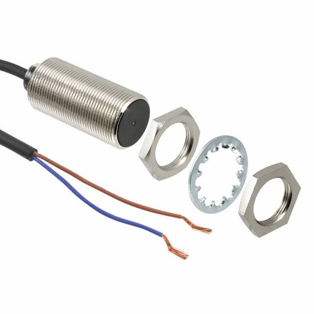

DC 2-wire Cylindrical Inductive Proximity Sensor Amplifier Built-in 2-wire type Oil resistant Metal embedding possible available GXL INDUCTIVE PROXIMITY SENSORS GX-U/FU SERIES GX-U/FU GL-18H/18HL GL-N12 Amplifier Built-in GL-8/8U GL-6 High performance & ease of use Conforming to EMC Directive Robust in tightening Compact size: "5.4 mm "0.213 in Long sensing range The tightening torque has been improved to approx. four times greater than that of conventional models because of its thick case. As the sensor can be securely tightened, it does not get loose due to vibration or shock. GX-5SU(B) is just 5.4 mm 0.213in in diameter, the smallest in existing DC two-wire sensors. It saves you space. The GX-U series features 1.6 times longer sensing range than conventional models. As it can be mounted at a sufficient distance from the object, there is no fear of the sensor and the object colliding. Conventional GX-18M(B) model 19.6 N•m or less 4 times approx. GX-18MU(B) GX-12MLU(B) "5.4 mm "0.213 in 8 mm 0.315 in 80 N•m or less s 1.6 GA-10/GH Amplifier-separated GX GX-N GX-12ML(B) time Conventional model 5 mm 0.197 in 2-color indicator Simple wiring Spatter-resistant type available The normally open type is equipped with a 2-color indicator. The normally closed type has the operation indicator instead. The operation is easily observable from any direction because the entire sensor tail lights up. The wiring cost is considerably reduced as it is DC 2-wire type. Further, each of GX-12MU(B), GX-18MU(B), GX-30MU(B) is available as a pigtailed model (300 mm 11.811 in long cable with attached connector) that makes replacement easy and quick. As the enclosure is entirely coated by fluorine resin, the sensor can be safely used at a place where welding spatters fly around. Both the pigtail cable and the mating cable are also spatter-resistant. ( ) 722 APPLICATIONS Controlling depth of drilling Positioning object at welding station (GX-FU-J only) By detecting the dog, the sensor decides the depth of the drilled hole. It can reliably detect even aluminum pallets because of its long sensing range. It can be safely used even where welding sparks (spatter) fly around. GL-6 GXL Detecting traveling aluminum pallets INDUCTIVE PROXIMITY SENSORS GX-U/FU GL-8/8U ORDER GUIDE Standard type "5.4 "0.213 1.5 mm 0.059 in 30 1.181 Maximum operation distance (0 to 1.2 mm 0 to 0.047 in) Stable sensing range 2 mm 0.079 in M8 30 1.181 (0 to 1.6 mm 0 to 0.063 in) 3 mm 0.118 in Threaded type Shielded type Sensing range (Note) M12 40.5 1.594 (0 to 2.4 mm 0 to 0.094 in) 7 mm 0.276 in Model No. Output Output operation GX-5SU Normally open GX-5SUB Normally closed GX-8MU Normally open GX-8MUB Normally closed GX-12MU Normally open GX-12MUB Normally closed GX-18MU Normally open GX-18MUB Normally closed GX-U/FU Appearance (mm in) Amplifier Built-in GL-18H/18HL GL-N12 Non-threaded type Type M18 GX-30MU 44.5 1.752 GX-30MUB (0 to 8 mm 0 to 0.315 in) 4 mm 0.157 in M8 30 1.181 (0 to 3.2 mm 0 to 0.126 in) Threaded type Non-shielded type 8 mm 0.315 in M12 40.5 1.594 (0 to 6.4 mm 0 to 0.252 in) 15 mm 0.591 in Non-contact DC 2-wire type Normally open Normally closed GX-8MLU Normally open GX-8MLUB Normally closed GX-12MLU Normally open GX-12MLUB Normally closed GX-18MLU Normally open GX-18MLUB Normally closed GX-30MLU Normally open GX-30MLUB Normally closed GX-N 10 mm 0.394 in M30 GX (0 to 5.6 mm 0 to 0.220 in) Amplifier-separated GA-10/GH 41.5 1.634 M18 41.5 1.634 (0 to 12 mm 0 to 0.472 in) 22 mm 0.866 in M30 44.5 1.752 (0 to 17.6 mm 0 to 0.693 in) Note: The maximum operation distance stands for the maximum distance for which the sensor can detect the standard sensing object. The stable sensing range stands for the sensing range for which the sensor can stably detect the standard sensing object even if there is an ambient temperature drift and/or supply voltage fluctuation. 723 INDUCTIVE PROXIMITY SENSORS GX-U/FU ORDER GUIDE 5 m 16.404 ft cable length type and pigtailed type 5 m 16.404 ft cable length type (standard : 2 m 6.562 ft) and pigtailed type (standard: cable type) are also available. Type GX-N Threaded type Threaded type Shielded type Non-shielded type GX-U/FU GL-18H/18HL GL-N12 Amplifier Built-in GL-8/8U GL-6 Non-threaded type GXL • Table of Model Nos. Standard 5 m 16.404 ft cable length type Pigtailed type (Note) GX-5SU GX-5SU-C5 GX-5SUB GX-5SUB-C5 GX-8MU GX-8MU-C5 GX-8MUB GX-8MUB-C5 GX-12MU GX-12MU-C5 GX-12MU-J GX-12MUB GX-12MUB-C5 GX-12MUB-J GX-18MU GX-18MU-C5 GX-18MU-J GX-18MUB GX-18MUB-C5 GX-18MUB-J GX-30MU GX-30MU-C5 GX-30MU-J GX-30MUB GX-30MUB-C5 GX-30MUB-J GX-8MLU GX-8MLU-C5 GX-8MLUB GX-8MLUB-C5 GX-12MLU GX-12MLU-C5 GX-12MLU-J GX-12MLUB GX-12MLUB-C5 GX-12MLUB-J GX-18MLU GX-18MLU-C5 GX-18MLU-J GX-18MLUB GX-18MLUB-C5 GX-18MLUB-J GX-30MLU GX-30MLU-C5 GX-30MLU-J GX-30MLUB GX-30MLUB-C5 GX-30MLUB-J Note: Please order the suitable mating cable separately for pigtailed type. • Mating cable • CN-22G-C2, CN-22G-C5 Model No. Description GX "14 mm "0.551 in CN-22G-C2 GA-10/GH Amplifier-separated CN-22G-C5 724 Length: 2 m 6.562 ft Length: 5 m 16.404 ft 0.3 mm2 2-core flame-resistant, spatter-resistant cable (outer dia "3.6 mm "0.142 in) with connector at one end 300 mm 11.811 in approx. Mating cable CN-22G-C2 (length 2 m 6.562 ft) CN-22G-C5 (length 5 m 16.404 ft) ORDER GUIDE Spatter-resistant type Sensing range (Note) 3 mm 0.118 in Threaded type Shielded type M12 40.5 1.594 Maximum operation distance (0 to 2.4 mm 0 to 0.094 in) Model No. Output Output operation Non-contact DC 2-wire type Normally open GXL Appearance (mm in) GX-F12MU-J Stable sensing range 7 mm 0.276 in GX-F18MU-J M18 41.5 1.634 (0 to 5.6 mm 0 to 0.220 in) GL-6 Type INDUCTIVE PROXIMITY SENSORS GX-U/FU 10 mm 0.394 in GX-F30MU-J M30 GL-8/8U (0 to 8 mm 0 to 0.315 in) 44.5 1.752 Note: The maximum operation distance stands for the maximum distance for which the sensor can detect the standard sensing object. The stable sensing range stands for the sensing range for which the sensor can stably detect the standard sensing object even if there is an ambient temperature drift and/or supply voltage fluctuation. • Mating cable Description "14 mm "0.551 in CN-22G-C2 CN-22G-C5 Length: 2 m 6.562 ft Length: 5 m 16.404 ft 0.3 mm2 2-core flame-resistant, spatter-resistant cable (outer dia "3.6 mm "0.142 in) with connector at one end 300 mm 11.811 in approx. Mating cable CN-22G-C2 (length 2 m 6.562 ft) CN-22G-C5 (length 5 m 16.404 ft) OPTIONS For GX-5SU(B) MS-H12 For GX-12MU(B) MS-H18 For GX-18MU(B) MS-H30 For GX-30MU(B) The sensor is easily mounted with this bracket. It protects the sensing surface from welding sparks (spatter), etc. Protection cover GX-N MS-SS5 • MS-SS5 • MS-H12 • MS-H18 • MS-H30 GX Sensor mounting bracket Protection cover Description Amplifier-separated GA-10/GH Model No. GX-U/FU Sensor mounting bracket Designation Amplifier Built-in GL-18H/18HL GL-N12 • CN-22G-C2, CN-22G-C5 Model No. 725 SPECIFICATIONS Standard type Type Model No. INDUCTIVE PROXIMITY SENSORS GXL GL-6 GX-U/FU Item Normally open Shielded type Non-threaded type GX-5SU Non-shielded type Threaded type GX-8MU GX-12MU Threaded type GX-18MU GX-30MU Normally closed GX-5SUB GX-8MUB GX-12MUB GX-18MUB GX-30MUB GX-8MLUB GX-12MLUB GX-18MLUB GX-30MLUB Max. operation distance (Note 1) 1.5 mm 0.059 in10% 2 mm 0.079 in10% 3 mm 0.118 in10% 7 mm 0.276 in10% 10 mm 0.394 in10% 4 mm 0.157 in10% 0 to 1.2 mm 0 to 0.047 in 0 to 1.6 mm 0 to 0.063 in 0 to 2.4 mm 0 to 0.094 in 0 to 5.6 mm 0 to 0.220 in 0 to 8 mm 0 to 0.315 in 0 to 3.2 mm 0 to 0.126 in 0 to 6.4 mm 0 to 0.252 in 0 to 12 mm 0 to 0.472 in 0 to 17.6 mm 0 to 0.693 in Standard sensing object Iron sheet 66t 1 mm Iron sheet 88t 1 mm Iron sheet 1212t 1 mm Iron sheet 1818t 1mm Iron sheet 3030t 1 mm Iron sheet 2020t 1 mm Iron sheet 3030t 1 mm Iron sheet 5050t 1 mm Iron sheet 7070t 1 mm 0.2360.236t 0.039 in 0.3150.315t 0.039 in 0.4720.472t 0.039 in 0.7090.709t 0.039 in 1.1811.181t 0.039 in 0.7870.787t 0.039 in 1.1811.181t 0.039 in 1.9691.969t 0.039 in 2.7562.756t 0.039 in 20 % or less of operation distance Hysteresis 10 12 to 24 V DC 15 % Ripple P-P 10 % or less Supply voltage 0.8 mA or less Non-contact DC 2-wire type • Load current: 3 to 70 mA (Note 3) • Residual voltage: 3 V or less (Note 4) GL-8/8U Output DC-12 or DC-13 Utilization category Incorporated Short-circuit protection Max. response frequency 1.7 kHz 1.2 kHz Environmental resistance GL-18H/18HL GL-N12 Amplifier Built-in 500 Hz 350 Hz 1 kHz 650 Hz 350 Hz 220 Hz Normally open type: Lights up in green under stable sensing condition, lights up in orange under unstable sensing condition 2-color indicator Pollution degree 3 (Industrial environment) Protection IP67 (IEC), IP67g (JEM) Ambient temperature 25 to70 °C 13 to158 °F, Storage:30 to80 °C 22 to176 °F Ambient humidity 45 to 85 % RH, Storage: 35 to 95 % RH EMC EN 50081-2, EN 50082-2, EN 60947-5-2 Voltage withstandability 1,000 V AC for one min. between all supply terminals connected together and enclosure Insulation resistance 50 MΩ, or more, with 250 V DC megger between all supply terminals connected together and enclosure Vibration resistance 10 to 55 Hz frequency, 1.5 mm 0.059 in amplitude in X, Y and Z directions for two hours each 1,000 m/s2 acceleration (100 G approx.) in X, Y and Z directions for three times each Shock resistance GX-U/FU 1.2 kHz Normally closed type: Orange LED (lights up when the output is ON) Operation indicator Sensing range Temperature characteristics variation Voltage characteristics Over ambient temperature range25 to70°C 13 to158 °F: within10 % of sensing range at 20 °C 68°F Within2 % for 10 % fluctuation of the supply voltage Enclosure: Brass (Nickel plated) [However, Stainless steel (SUS303) for GX-5SU(B), GX-8MU(B) and GX-8MLU(B)] Sensing part: Nylon [However, polyalylate for GX-5SU(B)], Indicator part: Nylon [excluding GX-5SU(B)] Material 0.3 mm2 [0.15 mm2 for GX-5SU(B), GX-8MU(B) and GX-8MLU(B)] 2-core oil, heat and cold resistant cabtyre cable, 2 m 6.562 ft long Cable GX-N 8 mm 0.315 in10% 15 mm 0.591 in10% 22 mm 0.866 in10% Stable sensing range (Note 1) Current consumption (Note 2) Cable extension Extension up to total 50 m 164.042 ft is possible with 0.3 mm2, or more, cable. Weight (Note 5) 20 g approx. 30 g approx. 55 g approx. 95 g approx. Accessories GX GX-8MLU GX-12MLU GX-18MLU GX-30MLU 220 g approx. 30 g approx. 55 g approx. 95 g approx. 220 g approx. Nut: 2 pcs., Toothed lock washer: 1 pc. Notes: 1) The maximum operation distance stands for the maximum distance for which the sensor can detect the standard sensing object. The stable sensing range stands for the sensing range for which the sensor can stably detect the standard sensing object even if there is an ambient temperature drift and/or supply voltage fluctuation. Notes: 2) It is the leakage current when the output is in the OFF state. Notes: 3) The maximum load current varies depending on the ambient temperature. Refer to ‘I/O CIRCUIT AND WIRING DIAGRAMS’ on p.727l for more details. Notes: 4) When the cable is extended, the residual voltage becomes larger. Notes: 5) The weight of the threaded type includes the weight of two nuts and one toothed lock washer. GA-10/GH Amplifier-separated Spatter-resistant type Shielded type Type Item Model No. Material Cable Cable extension Weight (Note) Accessories Normally open Threaded type GX-F12MU-J GX-F18MU-J GX-F30MU-J Enclosure: Brass (Fluorine resin coated), Sensing part: Polyalylate (Fluorine resin coated), Indicator part: Polyalylate 0.3 mm2 2-core spatter-resistant cable, 0.3 m 0.984 ft long with round type connector Extension up to total 50 m 164.042 ft is possible with 0.3 mm2, or more, cable. 35 g approx. 75 g approx. 200 g approx. Nut: 2 pcs. (Fluorine resin coated), Toothed lock washer: 1 pc. (Fluorine resin coated) The specifications other than the above-mentioned are identical to that of the standard type (GX-12MU, GX-18MU, GX-30MU). Note: The given weight includes the weight of two nuts and one toothed lock washer. 726 I/O CIRCUIT AND WIRING DIAGRAMS GX-U(B) I/O circuit diagram Wiring diagram Bleeder resistance Sensor circuit ZD Bleeder resistance Brown Load 3 to 70 mA in ON state (Note) 0.8 mA in OFF state  3 V in ON state Users’ circuit 12 to 24 V DC 10  15 % Blue Load Conditions for the load Symbols ... ZD: Surge absorption zener diode Tr : PNP output transistor Note: The maximum load current varies depending on the ambient temperature. 1) The load should not be actuated by the leakage current (0.8 mA) in the OFF state. 2) The load should be actuated by (supply voltage – 3 V) in the ON state. 3) The current in the ON state should be between 3 to 70 mA DC. In case the current is less than 3 mA, connect a bleeder resistance in parallel to the load so that a current of 3 mA, or more, flows. [ ] 70 35 Amplifier Built-in GL-18H/18HL GL-N12 Max. load current (mA)  12 to 24 V DC 10 % 15 Load (Blue) 0 V Internal circuit Load GL-6  GXL (Brown) Output GL-8/8U Color code Tr INDUCTIVE PROXIMITY SENSORS GX-U/FU 3 25 13 Ambient temperature (°C °F) 55 131 70 158 I/O circuit diagram GX-U/FU GX-U(B)-J Wiring diagram Color code of mating cable Color code of mating cable Bleeder resistance Bleeder resistance 3 to 70 mA in ON state (Note) 0.8 mA in OFF state  3 V in ON state  (Black) 0 V Internal circuit  Blue Users’ circuit [ ] Connector pin position GX-U-J (Normally open) 70 1 2 Not connected 35 3 Ambient temperature (°C °F) Load 1) The load should not be actuated by the leakage current (0.8 mA) in the OFF state. 2) The load should be actuated by (supply voltage – 3 V) in the ON state. 3) The current in the ON state should be between 3 to 70 mA DC. In case the current is less than 3 mA, connect a bleeder resistance in parallel to the load so that a current of 3 mA, or more, flows. Note: The maximum load current varies depending on the ambient temperature. 25 13 12 to 24 V DC 10% 15 Conditions for the load Load Symbols ... ZD: Surge absorption zener diode Tr : PNP output transistor Max. load current (mA)  12 to 24 V DC 10 % 15 GX-N ZD Load 55 131 70 158 3 Not connected V 4 0V GX-UB-J (Normally closed) 1 2 0V 3 Not connected V 4 Not connected Color code of mating cable / Connector pin No. (Brown / 1) Output White Not connected Blue (Black / 4) 0 V Color code of mating cable / Connector pin No. (Brown / 1) Output Black Not connected Blue (White / 2) 0 V 727 GX Tr Brown Load Amplifier-separated GA-10/GH Sensor circuit (Brown) Output INDUCTIVE PROXIMITY SENSORS GX-U/FU I/O CIRCUIT AND WIRING DIAGRAMS GX-FU-J I/O circuit diagram GXL GL-6 Sensor circuit (Brown / 1) Output Tr ZD Bleeder resistance Brown / 1 3 to 70 mA in ON state (Note) 0.8 mA in OFF state  3 V in ON state  12 to 24 V DC 10 % 15 Blue / 4 Load Conditions for the load 1) The load should not be actuated by the leakage current (0.8 mA) in the OFF state. 2) The load should be actuated by (supply voltage – 3 V) in the ON state. 3) The current in the ON state should be between 3 to 70 mA DC. In case the current is less than 3 mA, connect a bleeder resistance in parallel to the load so that a current of 3 mA, or more, flows. Users’ circuit [ Note: The maximum load current varies depending on the ambient temperature. ] Connector pin position 70 1 2 Not connected 35 V 3 25 13 Ambient temperature (°C °F) 55 131 70 158 3 Not connected 4 0V SENSING CHARACTERISTICS (TYPICAL) GX-5SU GX-5SUB 2 0.079 Correlation between sensing object size and sensing range Standard sensing object Iron sheet 66t 1 mm 0.2360.236t 0.039 in # L 1 0.039 GX 0 2 0.079 Sensing range L (mm in) Sensing field Sensing object aa mm aa in 2 t 1 mm t 0.039 in 0.079 L Iron 1 0.039 As the sensing object size becomes smaller than the standard size (iron sheet 6  6  t 1 mm 0.236 0.236 t 0.039 in), the sensing range shortens as shown in the left figure. Stainless steel (SUS304) Brass Aluminum 0 1 0 1 2 0.039 0.039 0.079 Center Left Right Operating point ?(mm in) 5 10 15 0.197 0.394 0.591 Sensing object side length a (mm in) 20 0.787 GX-8MU GX-8MUB Setting distance L (mm in) 2 0.079 1 0.039 0 4 0.157 728 Standard sensing object Iron sheet 88t 1 mm 0.3150.315 t 0.039 in # L 2 0 2 4 0.079 0.079 0.157 Center Left Right Operating point ?(mm in) Correlation between sensing object size and sensing range As the sensing object size becomes smaller than Sensing object aa mm aa in t 1 mm t 0.039 in the standard size (iron sheet 8  8  t 1 mm L Iron 2 0.315 0.315 t 0.039 in), the sensing range 0.079 shortens as shown in the left figure. Sensing range L (mm in) Sensing field 12 to 24 V DC 10  15 % Symbols ... ZD: Surge absorption zener diode Tr : PNP output transistor Max. load current (mA) Load Load (Blue / 4) 0 V Setting distance L (mm in) GL-8/8U GL-18H/18HL GL-N12 Amplifier Built-in GX-U/FU GX-N Color code of mating cable / Connector pin No. Load  Internal circuit GA-10/GH Amplifier-separated Wiring diagram Color code of mating cable / Connector pin No. Bleeder resistance Stainless steel (SUS304) 1 0.039 Brass Aluminum 0 5 10 15 0.197 0.394 0.591 Sensing object side length a (mm in) 20 0.787 SENSING CHARACTERISTICS (TYPICAL) GX-12MU GX-12MUB GX-F12MU-J 2 0.079 0 4 0.157 L As the sensing object size becomes smaller than the standard size (iron sheet 1212t 1 mm 0.472 0.472 t 0.039 in), the sensing range shortens as shown in the left figure. GXL 4 0.157 Sensing object aa mm aa in t 1 mm t 0.039 in Iron Stainless steel (SUS304) 2 0.079 Brass Aluminum GL-6 Standard sensing object Iron sheet 1212t 1 mm 0.4720.472t 0.039 mm # L 2 0 2 4 0.079 0.079 0.157 Center Left Right Operating point #(mm in) 0 10 20 30 0.394 0.787 1.181 Sensing object side length a (mm in) 40 1.575 GL-8/8U 4 0.157 Correlation between sensing object size and sensing range Sensing range L (mm in) Setting distance L (mm in) Sensing field GX-18MU GX-18MUB GX-F18MU-J Setting distance L (mm in) 5 0.197 0 20 0.787 Correlation between sensing object size and sensing range As the sensing object size becomes smaller than Sensing object aa mm aa in the standard size (iron sheet 1818t 1 mm t 1 mm t 0.039 in L 10 0.709 0.709 t 0.039 in), the sensing range 0.394 shortens as shown in the left figure. 10 0 10 20 0.394 0.394 0.787 Center Left Right Operating point #(mm in) Amplifier Built-in GL-18H/18HL GL-N12 Standard sensing object Iron sheet 1818t 1 mm 0.7090.709t 0.039 in # L Sensing range L (mm in) Sensing field 10 0.394 Iron Stainless steel (SUS304) 5 0.197 Brass Aluminum 0 10 20 30 0.394 0.787 1.181 Sensing object side length a (mm in) 40 1.575 0 20 0.787 10 0 10 20 0.394 0.394 0.787 Center Left Right Operating point #(mm in) 5 0.197 L 0 GX-N 5 0.197 (SUS304) Brass Sensing object aa mm aa in Aluminum t 1 mm t 0.039 in 20 40 60 0.787 1.575 2.362 Sensing object side length a (mm in) 80 3.150 GX Standard sensing object Iron sheet 3030t 1 mm 1.1811.181t 0.039 in # L Correlation between sensing object size and sensing range As the sensing object size becomes smaller than the standard size (iron sheet 3030t 1 mm Iron 10 1.181 1.181 t 0.039 in), the sensing range 0.394 shortens as shown in the left figure. Stainless steel Sensing range L (mm in) Setting distance L (mm in) Sensing field GX-U/FU GX-30MU GX-30MUB GX-F30MU-J 10 0.394 GX-8MLU GX-8MLUB 4 0.157 0 10 0.394 Standard sensing object Iron sheet 2020t 1 mm 0.7870.787 t 0.039 in # L 5 0 5 10 0.197 0.197 0.394 Center Left Right Operating point ?(mm in) Amplifier-separated GA-10/GH Correlation between sensing object size and sensing range As the sensing object size becomes smaller than Sensing object aa mm aa in t 1 mm t 0.039 in the standard size (iron sheet 2020t 1 mm L Iron 4 0.787 0.787 t 0.039 in), the sensing range 0.157 shortens as shown in the left figure. Sensing range L (mm in) Setting distance L (mm in) Sensing field 2 0.079 INDUCTIVE PROXIMITY SENSORS GX-U/FU Stainless steel (SUS304) 2 0.079 0 Brass Aluminum 10 20 30 0.394 0.787 1.181 Sensing object side length a (mm in) 40 1.575 729 SENSING CHARACTERISTICS (TYPICAL) GX-12MLU GX-12MLUB 5 0.197 Correlation between sensing object size and sensing range As the sensing object size becomes smaller than Sensing object aa mm aa in the standard size (iron sheet 3030t 1 mm t 1 mm t 0.039 in L 10 1.181 1.181 t 0.039 in), the sensing range 0.394 shortens as shown in the left figure. Iron Sensing range L (mm in) Setting distance L (mm in) Standard sensing object Iron sheet 3030t 1 mm 1.1811.181t 0.039 mm # L 10 0.394 0 20 0.787 10 0 10 20 0.394 0.394 0.787 Center Left Right Operating point #(mm in) Stainless steel (SUS304) 5 0.197 0 Brass Aluminum 20 40 60 0.787 1.575 2.362 Sensing object side length a (mm in) 80 3.150 GX-18MLU GX-18MLUB 20 0.787 Standard sensing object Iron sheet 5050t 1 mm 1.9691.969t 0.039 in # L 10 0.394 0 20 0.787 Correlation between sensing object size and sensing range As the sensing object size becomes smaller than Sensing object aa mm aa in the standard size (iron sheet 5050t 1 mm t 1 mm t 0.039 in L 20 1.969 1.969 t 0.039 in), the sensing range 0.787 shortens as shown in the left figure. Sensing range L (mm in) Setting distance L (mm in) Sensing field Iron 10 0.394 10 0 10 20 0.394 0.394 0.787 Center Left Right Operating point #(mm in) 0 Stainless steel (SUS304) Brass Aluminum 20 40 60 0.787 1.575 2.362 Sensing object side length a (mm in) 80 3.150 GX-30MLU GX-30MLUB Sensing field Setting distance L (mm in) GX-N GX-U/FU GL-18H/18HL GL-N12 Amplifier Built-in GL-8/8U GL-6 GXL Sensing field Correlation between sensing object size and sensing range As the sensing object size becomes smaller than Iron the standard size (iron sheet 7070t 1 mm 20 2.756 2.756 t 0.039 in), the sensing range 0.787 Stainless steel shortens as shown in the left figure. (SUS304) 20 0.787 10 0.394 GA-10/GH Amplifier-separated GX 0 20 0.787 730 Standard sensing object Iron sheet 7070t 1 mm 2.7562.756t 0.039 in # L 10 0 10 20 0.394 0.394 0.787 Center Left Right Operating point #(mm in) Sensing range L (mm in) INDUCTIVE PROXIMITY SENSORS GX-U/FU 10 0.394 0 Brass Aluminum Sensing object aa mm aa in t 1 mm t 0.039 in L 20 40 60 0.787 1.575 2.362 Sensing object side length a (mm in) 80 3.150 PRECAUTIONS FOR PROPER USE Refer to p.1152l for general precautions. This product is not a safety sensor. Its use is not intended or designed to protect life and prevent body injury or property damage from dangerous parts of machinery. It is a normal object detection sensor. Distance from surrounding metal • As metal around the sensor may affect the sensing performance, pay attention to the following points. Mounting • The tightening torque should be under the value given below. • The surrounding metal will affect the sensing performance. Keep the minimum distance specified in the table below. Model No. A (mm in) B (mm in) Tightening torque 0.78 Nm B • Do not fix on the operation indicator or opposite to it. Operation indicator Operation indicator Operation indicator Set screw GX-18MU(B) GX-F18MU-J 20 0.787 GX-30MU(B) GX-F30MU-J 40 1.575 GX-8MLU(B) 8 0.315 GX-12MLU(B) 22 0.866 GX-18MLU(B) 45 1.772 GX-30MLU(B) 75 2.953 GL-6 8 0.315 Embedding of the sensor in metal Mounting with nut C Attached toothed lock washer C • Sensing range may decrease if the sensor is completely embedded in metal. Especially for the non-threaded type and the non-shielded type, keep the minimum distance specified in the table below. Attached toothed lock washer Model No. E Mounting plate F Mounting plate E (mm in) F (mm in) GX-5SU(B) "12 "0.472 3 0.118 GX-8MLU(B) "24 "0.945 12 0.472 GX-12MLU(B) "50 "1.969 15 0.591 GX-18MLU(B) "75 "2.953 25 0.984 GX-30MLU(B) "105 "4.134 30 1.181 Metal Model No. Dimension C (mm in) Tightening torque 3 to 10.3 0.118 to 0.406 5.9 N m 10.3 0.406 or more 11.8 N m GX-8MU(B) GX-12MU(B) GX-F12MU-J 3.5 to 13.5 0.138 to 0.531 10 N m 13.5 0.531 or more 20 N m GX-18MU(B) GX-F18MU-J 4 to 18 0.157 to 0.709 45 N m 18 0.709 or more 80 N m GX-30MU(B) GX-F30MU-J 5 to 21 0.197 to 0.827 80 N m 21 0.827 or more 180 N m GX-8MLU(B) 12 0.472 or more 11.8 N m GX-12MLU(B) 15 0.591 or more 20 N m GX-18MLU(B) 25 0.984 or more 80 N m GX-30MLU(B) 30 1.181 or more 180 N m Note: With the non-shielded type, the sensing range may vary depending on the position of the nuts. Mutual interference • When two or more sensors are installed in parallel or face to face, keep the minimum separation distance specified below to avoid mutual interference. Face to face mounting G Parallel mounting Note: Mount such that the nuts do not protrude from the threaded portion. Model No. G (mm in) H (mm in) GX-5SU(B) 19 0.748 14 0.551 GX-8MU(B) 20 0.787 15 0.591 GX-12MU(B) GX-F12MU-J 35 1.378 20 0.787 GX-18MU(B) GX-F18MU-J 70 2.756 45 1.772 GX-30MU(B) GX-F30MU-J 115 4.528 70 2.756 GX-8MLU(B) 60 2.362 45 1.772 GX-12MLU(B) 145 5.709 95 3.740 H GX-18MLU(B) 250 9.843 165 6.496 GX-30MLU(B) 350 13.780 250 9.843 731 GX-N 3 0.118 4.5 0.177 GX-12MU(B) GX-F12MU-J GX 5 to 30 0.197 to 1.181 GX-8MU(B) Amplifier-separated GA-10/GH GX-5SU(B) D GL-8/8U 4.5 0.177 GX-U/FU Background metal • Tighten with the cup-point of a set screw (M4 or less). D (mm in) GX-5SU(B) Amplifier Built-in GL-18H/18HL GL-N12 Model No. GXL Influence of surrounding metal Mounting with a set screw Set screw (M4 or less) A INDUCTIVE PROXIMITY SENSORS GX-U/FU PRECAUTIONS FOR PROPER USE Sensing range • The sensing range is specified for the standard sensing object. With a non-ferrous metal, the sensing range is obtained by multiplying with the correction coefficient specified below. Correction coefficient Metal Iron GX-U/FU GL-18H/18HL GL-N12 Amplifier Built-in GL-8/8U GL-6 Model No. GX-N Refer to p.1152l for general precautions. Stainless steel (SUS304) Brass Aluminum Wiring • The sensor must be connected to a power supply via a load. If the sensor is connected to a power supply without a load, the short-circuit protection makes the sensor inoperable. (The output stays in the OFF state and the indicator does not light up.) In this case, rectify by connecting the power supply via a load. Now, the sensor becomes operable. Further, take care that if the power supply is connected with reverse polarity without a load, the sensor will get damaged. GX-5SU(B) 1 0.63 approx. 0.32 approx. 0.30 approx. GX-8MU(B) 1 0.59 approx. 0.32 approx. 0.29 approx. GX-12MU(B) GX-F12MU-J 1 0.75 approx. 0.51 approx. 0.49 approx. GX-18MU(B) GX-F18MU-J 1 0.75 approx. 0.50 approx. 0.48 approx. GX-30MU(B) GX-F30MU-J 1 0.69 approx. 0.44 approx. 0.42 approx. GX-8MLU(B) 1 0.64 approx. 0.38 approx. 0.38 approx. GX-12MLU(B) 1 0.67 approx. 0.44 approx. 0.43 approx. Series connection (AND circuit) Parallel connection (OR circuit) When all sensors are in the ON state, the load voltage VRL is given by: VRL VCCn3 (V) When all sensors are in the OFF state, the load leakage current lcc is given by: Blue lead wire Brown lead wire  DC power  supply  DC power  supply Brown lead wire GX-18MLU(B) 1 0.68 approx. 0.45 approx. 0.43 approx. GX-30MLU(B) 1 0.67 approx. 0.44 approx. 0.43 approx. Note: The sensing range also changes if the sensing object is plated. Protection cover (Optional) • It protects the sensing surface from welding sparks (spatter), etc. Mounting method Protection cover Sensor Material: Fluorine resin Vcc: supply voltage (24 V DC max.) n: number of sensors GX-12MU(B) MS-H18 GX-18MU(B) MS-H30 Note: The output is generated normally even if the indicator does not light up properly. Others • Do not use during the initial transient time (50 ms) after the power supply is switched on. Note: The load current in the ON state is given by: IL Vcc3 V (mA) Load resistance The load current must be 3 mAn h IL h 70 mA (n: number of sensors turned ON) Brown lead wire Load Brown lead wire Load VRL Blue lead wire  Blue lead wire  VCC Brown lead wire GX-30MU(B) Note: Mount the protection cover so that there is no gap between it and the sensing surface. lcc n0.8 (mA) (n: number of sensors) Make sure that the load can work properly. Make sure that the load can work properly at this voltage. Model No. Applicable model No. MS-H12 Blue lead wire • For series connection (AND circuit) or parallel connection (OR circuit) of sensors, take care of the following. ICC (IL) Brown lead wire Blue lead wire   VCC Blue lead wire • The residual voltage of the sensor is 3 V. Before connecting a relay as the load, take care of its actuation voltage. (Some 12 V relays may not be usable.) Relay INDUCTIVE PROXIMITY SENSORS GXL GX-U/FU • When the sensor is mounted on a moving base, stress should not be applied to the sensor cable joint. Relay actuation voltage: VR h123 V h9 V VR Relay actuation voltage Brown lead wire Vs 3 V Residual voltage when the sensor is in the ON state  12 V DC  power supply Blue lead wire Lights OFF Output operation level LED lights up in green Max. operation distance Switched OFF Stress Setting distance Stress Switched ON GA-10/GH Amplifier-separated GX 2-color indicator (Normally open type only) • When the sensing object is in the stable sensing range, the LED lights up in green, and when the sensing object is in the unstable sensing range, the LED lights up in orange. While the LED lights up in green, the sensing is performed stably without being affected by temperature drifts or voltage fluctuations. 0 Output operation 2-color indicator operation 732 Unstable range LED lights up in orange DIMENSIONS (Unit: mm in) GX-5SU GX-5SUB The CAD data in the dimensions can be downloaded from the SUNX website: http://www.sunx.co.jp/ GX-8MU GX-8MUB Sensor Sensor INDUCTIVE PROXIMITY SENSORS GX-U/FU "21 "0.827 Note: Normally closed type has an operation indicator (orange) instead of the 2-color indicator. GX-30MU GX-30MUB Sensor Indicator part 1.3 0.051 5 0.197 2 39.5 0.079 1.555 M301.5 0.059 36 1.417 "43 "1.693 GX-12MLU GX-12MLUB Toothed lock washer (Internally toothed) 24 0.945 Indicator part 1.3 0.051 5 0.197 2 39.5 0.079 12 1.555 0.472 M301.5 0.059 "3.6 "0.142 cable, 2 m 6.562 ft long Toothed lock washer (Internally toothed) "6.8 "0.268 "2.9 "0.114 cable, 2 m 6.562 ft long 5 0.197 2 36.5 0.079 1.437 M181 0.039 "5.5 "0.217 "10.4 "0.409 "15.2 "0.598 4 0.157 2-color indicator (Orange, green) (Note) Note: Normally closed type has an operation indicator (orange) instead of the 2-color indicator. Indicator part 1.3 0.051 "3.6 "0.142 cable, 2 m 6.562 ft long 2-color indicator Toothed lock washer (Orange, green) (Note) (Internally toothed) GL-6 Note: Normally closed type has an operation indicator (orange) instead of the 2-color indicator. GX-12MU-J GX-12MUB-J Sensor GX-F12MU-J 5 35.5 0.197 1.398 2 M121 0.039 0.079 17 0.669 "5.5 "0.217 "10.4 "0.409 5 0.236 3 0.118 2-color indicator (Orange, green) (Note) Sensor 10 0.394 2-color indicator (Orange, green) (Note) Sensor "43 "1.693 10 0.394 20 0.787 "29 "1.142 Note: Normally closed type has an operation indicator (orange) instead of the 2-color indicator. "26.6 "1.047 M81 0.039 Note: Normally closed type has an operation indicator (orange) instead of the 2-color indicator. "3.6 "0.142 cable, 2 m 6.562 ft long 3.5 0.138 36 1.417 Indicator part GX-18MLU GX-18MLUB Sensor "21 "0.827 Sensor 2-color indicator (Orange, green) (Note) Toothed lock washer (Internally toothed) Indicator part 5 0.197 2 35.5 1.3 1.398 0.051 0.079 M121 0.039 "5.5 "0.217 "10.4 "0.409 GX-30MLU GX-30MLUB GX-8MLU GX-8MLUB "6.5 "15 "0.256 6 "0.591 Toothed 0.236 lock washer (Internally toothed) Note: Normally closed type has an operation indicator (orange) instead of the 2-color indicator. "10.2 "0.402 Note: Normally closed type has an operation indicator (orange) instead of the 2-color indicator. "3.6 "0.142 cable, 2 m 6.562 ft long 5 0.197 "3.6 "0.142 cable, 2 m 6.562 ft long 2-color indicator Toothed lock washer (Orange, green) (Note) (Internally toothed) 4 0.157 12 0.472 "5.5 "0.217 "10.4 "0.409 7 0.276 "29 "1.142 "3.6 "0.142 cable, 2 m 6.562 ft long 2-color indicator Toothed lock washer (Orange, green) (Note) (Internally toothed) 3.5 0.138 5 Indicator part 0.197 2 36.5 1.3 0.079 1.437 0.051 M181 0.039 "5.5 "0.217 "10.4 "0.409 24 0.945 GL-8/8U Indicator part 1.3 0.051 2 0.079 "5.5 "0.217 "10.4 "0.409 Sensor GX-U/FU 5 0.197 35.5 1.398 M121 0.039 17 0.669 Note: Normally closed type has an operation indicator (orange) instead of the 2-color indicator. GX-18MU GX-18MUB Sensor 3 "2.9 "0.114 cable, 2 m 6.562 ft long 0.118 GX-N GX-12MU GX-12MUB 2-color indicator "6.8 (Orange, green) (Note) "0.268 GX Note: Normally closed type has an operation indicator (orange) instead of the 2-color indicator. 10 0.394 20 0.787 "15 Toothed "0.591 lock washer (Internally toothed) "2.9 "0.114 cable, 2 m 6.562 ft long 4 0.157 16.5 0.650 17 0.669 M81 0.039 Amplifier Built-in GL-18H/18HL GL-N12 12 0.472 "21 "0.827 3.5 0.138 Indicator part (300) (11.811) 44 1.732 1.3 0.051 "14 "0.551 M12 connector "3.6 "0.142 cable 2-color indicator Toothed lock washer (Orange, green) (Internally toothed) "10.4 "5.5 "0.409 "0.217 Note: Normally closed type has an operation indicator (orange) instead of the 2-color indicator. 733 Amplifier-separated GA-10/GH "5.4 "0.213 2-color indicator (Orange, green) (Note) GXL Indicator part 30 1.181 1.5 0.059 INDUCTIVE PROXIMITY SENSORS GX-U/FU DIMENSIONS (Unit: mm in) GX-18MU-J GX-18MUB-J Sensor GX-F18MU-J GXL GL-6 "29 "1.142 4 0.157 "10.4 "0.409 GL-8/8U Indicator part 1.3 0.051 "14 "0.551 M12 connector "3.6 "0.142 cable 7 0.276 "10.2 "0.402 5 (300) 35.5 0.197 (11.811) 1.398 2 44 0.079 M121 0.039 1.732 "5.5 "0.217 "10.4 "0.409 3.5 0.138 Indicator part 1.3 0.051 Note: Normally closed type has an operation indicator (orange) instead of the 2-color indicator. 36 1.417 2-color indicator (Orange, green) Toothed lock washer (Internally toothed) Sensor 5 (300) 36.5 0.197 1.437 (11.811) 2 0.079 M181 0.039 "5.5 "0.217 1.3 0.051 44 1.732 "14 "0.551 M12 connector "10.4 "0.409 "29 "1.142 Indicator part "3.6 "0.142 cable 4 0.157 Toothed lock washer (Internally toothed) 2-color indicator (Orange, green) (Note) Note: Normally closed type has an operation indicator (orange) instead of the 2-color indicator. Indicator part 1.3 0.051 "14 "0.551 "26.6 "1.047 M12 connector "3.6 "0.142 cable Toothed lock washer (Internally toothed) "10.4 "0.409 "43"1.693 5 0.197 2-color indicator (Orange, green) (Note) Note: Normally closed type has an operation indicator (orange) instead of the 2-color indicator. MS-SS5 GX-N Sensor mounting bracket for GX-5SU(B) (Optional) 2-"3.5 "0.138 mounting holes 8.3 0.327 MS-H12 MS-H18 MS-H30 0 GX Material: Nylon 66 734 Symbol A A 0.70.2 0 0.0280.008 Model No. BC 4 0.157 4 0.157 Protection cover (Optional) Thickness of front face 18 10 0.709 0.394 GA-10/GH Amplifier-separated M12 connector "3.6 "0.142 cable Sensor 5 (300) 39.5 0.197 1.555 (11.811) 44 2 0.079 1.732 M301.5 0.059 "5.5 "0.217 12 0.472 10 0.394 "15.2 "0.598 2-color indicator (Orange, green) (Note) "3.6 "0.142 cable Toothed lock washer (Internally toothed) GX-30MLU GX-30MLUB 24 0.945 "14 "0.551 M12 connector "10.4 "0.409 Note: Normally closed type has an operation indicator (orange) instead of the 2-color indicator. GX-18MLU-J GX-18MLUB-J Sensor "21 "0.827 "43 "1.693 5 0.197 2-color indicator (Orange, green) Note: Normally closed type has an operation indicator (orange) instead of the 2-color indicator. 17 0.669 Indicator part 1.3 0.051 5 (300) 39.5 0.197 (11.811) 1.555 2 44 M301.5 0.059 0.079 1.732 "5.5 "0.217 36 1.417 "14 "0.551 Toothed lock washer (Internally toothed) GX-12MLU-J GX-12MLUB-J GL-18H/18HL GL-N12 Amplifier Built-in GX-30MU-J GX-30MUB-J Sensor GX-F30MU-J 5 (300) 36.5 0.197 (11.811) 1.437 2 44 M181 0.039 0.079 1.732 "5.5 "0.217 24 0.945 GX-U/FU The CAD data in the dimensions can be downloaded from the SUNX website: http://www.sunx.co.jp/ 8 0.315 16 0.630 4 0.157 C Applicable model No. MS-H12 5 "11.5 "14 GX-12MU(B) "0.453 "0.551 MS-H18 6 "17.5 "20 GX-18MU(B) "0.689 "0.787 MS-H30 8 "29.4 "33 GX-30MU(B) "1.157 "1.299 Material: Fluorine resin 6.1 0.240 B
GX-18MU
物料型号: - GX-5SU(B) - GX-8MU(B) - GX-12MU(B)/GX-F12MU-J - GX-18MU(B)/GX-F18MU-J - GX-30MU(B)/GX-F30MU-J - GX-8MLU(B) - GX-12MLU(B) - GX-18MLU(B) - GX-30MLU(B)
器件简介: 这些是直流两线式圆柱形电感式接近传感器,具有内置放大器,符合EMC指令,具有油抵抗和金属嵌入可能,高性能且易于使用,具有双色指示器,紧凑尺寸,长感应范围。
引脚分配: - 输出:棕色线 - 0V:蓝色线
参数特性: - 工作电压:12到24V直流 - 电流消耗:在ON状态下3到70mA,在OFF状态下0.8mA - 输出类型:非接触式直流两线式 - 输出操作:常开或常闭 - 感应距离:根据不同型号,感应距离不同,例如GX-5SU(B)为5.4mm,GX-30MU(B)为30mm。
功能详解: 这些传感器具有长感应范围,可以安全地在焊接飞溅环境中使用。它们可以检测物体的存在并控制机械操作,如检测行进中的铝托盘或控制钻孔深度。
应用信息: 适用于检测铝托盘、控制钻孔深度、定位焊接站的物体等。
封装信息: 传感器有多种尺寸和感应范围,例如GX-5SU(B)直径为5.4mm,GX-30MU(B)直径为30mm。还提供了安装支架和保护盖作为配件,以保护传感器免受焊接飞溅等的损害。
