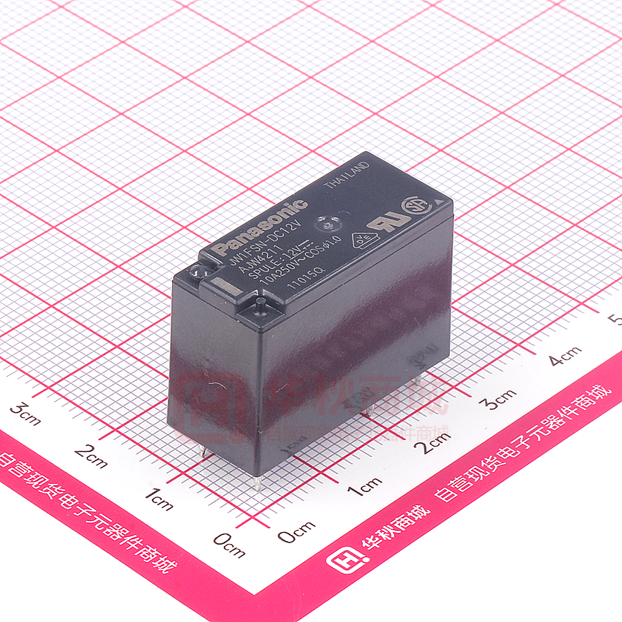

JW1FSN-DC12V
JW1FSN-DC12V
    NAIS(松下)
    RELAY_28.6X12.8MM_TM
    功率继电器 10A SPDT 12VDC
JW1FSN-DC12V 数据手册
1a/1c/2a/2c/5A/10A power relays for power supply RoHS compliant Protective construction: Flux-resistant type/Sealed type JW RELAYS FEATURES TYPICAL APPLICATIONS 1. Miniature package with universal terminal footprint 2. High dielectric withstanding for transient protection: 10,000 V surge in μs between coil and contact 3. Sealed construction 4. Class B coil insulation types available 5. VDE, TÜV, SEMKO, SEV, FIMKO also approved 6. Sockets are available 1. Home appliances TV sets, VCR, Microwave ovens 2. Office machines Photocopiers, Vending machines 3. Industrial equipment NC machines, Robots, Temperature controllers ORDERING INFORMATION JW N Contact arrangement 1: 1 Form C 1a: 1 Form A 2: 2 Form C 2a: 2 Form A Contact capacity Nil: Standard (5 A) F: High capacity (10 A)* Protective construction S: Sealed type H: Flux-resistant type Pick-up voltage N: 70% of nominal voltage Coil insulation class Nil: Class E insulation B: Class B insulation Nominal coil voltage DC5V, DC6V, DC9V, DC12V, DC24V, DC48V Contact material F: AgSnO2 type (1a) Nil: AgNi type (1c, 2a, 2c) –1– ASCTB190E 201702-T JW TYPES 1) 1 Form A Standard (5A) type Nominal coil voltage 5V DC 6V DC 9V DC 12V DC 24V DC 48V DC 2) 1 Form A High capacity (10 A) type Sealed type Part No. JW1aSN-DC5V-F JW1aSN-DC6V-F JW1aSN-DC9V-F JW1aSN-DC12V-F JW1aSN-DC24V-F JW1aSN-DC48V-F Flux-resistant type Part No. JW1aHN-DC5V-F JW1aHN-DC6V-F JW1aHN-DC9V-F JW1aHN-DC12V-F JW1aHN-DC24V-F JW1aHN-DC48V-F 5V DC 6V DC 9V DC 12V DC 24V DC 48V DC Standard packing: Carton 100 pcs. Case 500 pcs. 4) 1 Form C High capacity (10 A) type Sealed type Part No. JW1SN-DC5V JW1SN-DC6V JW1SN-DC9V JW1SN-DC12V JW1SN-DC24V JW1SN-DC48V 5V DC 6V DC 9V DC 12V DC 24V DC 48V DC Flux-resistant type Part No. JW1aFHN-DC5V-F JW1aFHN-DC6V-F JW1aFHN-DC9V-F JW1aFHN-DC12V-F JW1aFHN-DC24V-F JW1aFHN-DC48V-F Standard packing: Carton 100 pcs. Case 500 pcs. 3) 1 Form C Standard (5A) type Nominal coil voltage Sealed type Part No. JW1aFSN-DC5V-F JW1aFSN-DC6V-F JW1aFSN-DC9V-F JW1aFSN-DC12V-F JW1aFSN-DC24V-F JW1aFSN-DC48V-F Nominal coil voltage Flux-resistant type Part No. JW1HN-DC5V JW1HN-DC6V JW1HN-DC9V JW1HN-DC12V JW1HN-DC24V JW1HN-DC48V Sealed type Part No. JW1FSN-DC5V JW1FSN-DC6V JW1FSN-DC9V JW1FSN-DC12V JW1FSN-DC24V JW1FSN-DC48V Nominal coil voltage 5V DC 6V DC 9V DC 12V DC 24V DC 48V DC Standard packing: Carton 100 pcs. Case 500 pcs. Flux-resistant type Part No. JW1FHN-DC5V JW1FHN-DC6V JW1FHN-DC9V JW1FHN-DC12V JW1FHN-DC24V JW1FHN-DC48V Standard packing: Carton 100 pcs. Case 500 pcs. 5) 2 Form A Standard (5A) type 6) 2 Form C Standard (5A) type Nominal coil voltage Sealed type Part No. Flux-resistant type Part No. Nominal coil voltage 5V DC 6V DC 9V DC 12V DC 24V DC 48V DC JW2aSN-DC5V JW2aSN-DC6V JW2aSN-DC9V JW2aSN-DC12V JW2aSN-DC24V JW2aSN-DC48V JW2aHN-DC5V JW2aHN-DC6V JW2aHN-DC9V JW2aHN-DC12V JW2aHN-DC24V JW2aHN-DC48V 5V DC 6V DC 9V DC 12V DC 24V DC 48V DC Standard packing: Carton 100 pcs. Case 500 pcs. Sealed type Part No. JW2SN-DC5V JW2SN-DC6V JW2SN-DC9V JW2SN-DC12V JW2SN-DC24V JW2SN-DC48V Flux-resistant type Part No. JW2HN-DC5V JW2HN-DC6V JW2HN-DC9V JW2HN-DC12V JW2HN-DC24V JW2HN-DC48V Standard packing: Carton 100 pcs. Case 500 pcs. Note: Class B coil insulation type is available. Ex) JW1aSN-B-DC12V-F * Sockets available. RATING 1. Coil data Nominal coil voltage 5V DC 6V DC 9V DC 12V DC 24V DC 48V DC Pick-up voltage (at 20°C 68°F) 70%V or less of nominal voltage (Initial) Drop-out voltage (at 20°C 68°F) Nominal operating current [±10%] (at 20°C 68°F) Coil resistance [±10%] (at 20°C 68°F) 10%V or more of nominal voltage (Initial) 106mA 88mA 58mA 44mA 22mA 11mA 47Ω 68Ω 155Ω 270Ω 1,100Ω 4,400Ω Nominal operating power Max. applied voltage (at 20°C 68°F) 130%V of nominal voltage (at 60°C 140°F) 530mW 120%V of nominal voltage (at 85°C 185°F)*4 Note: The pick-up and drop out voltages rise approximately 0.4% for every 1°C 33.8°F given a standard ambient temperature of 20°C 68°F. Therefore, when using relays where the ambient temperature is high, please take into consideration the rise in pick-up and drop out voltages and keep the coil applied voltage within the maximum applied voltage. –2– ASCTB190E 201702-T JW 2. Specifications Characteristics Specifications Item Standard type High capacity type 1 Form A: AgSnO2 type 1 Form C, 2 Form A and 2 Form C: AgNi type 1 Form A, 1 Form C, 2 Form A and 2 Form C 1 Form A and 1 Form C Max. 100 mΩ (By voltage drop 6 V DC 1A) 5A 250V AC, 5A 30V DC 10A 250V AC, 10A 30V DC 1,250VA, 150W 2,500VA, 300W 250V AC, 30V DC 5A 10A 100mA, 5V DC Min. 1,000MΩ (at 500V DC) Measurement at same location as “Breakdown voltage” section. Contact material Contact Rating Arrangement Contact resistance (Initial) Nominal switching capacity (resistive load) Max. switching power (resistive load) Max. switching voltage Max. switching current Min. switching capacity (reference value)*1 Insulation resistance (Initial) Between open contacts Between contact and coil Between contact sets Surge breakdown voltage*2 (Between contact and coil) (Initial) Operate time (at nominal voltage) (at 20°C 68°F) Release time (at nominal voltage) (at 20°C 68°F) 1,000 Vrms for 1 min. (Detection current: 10 mA) 5,000 Vrms for 1 min. (Detection current: 10 mA) 3,000 Vrms for 1 min. (2 Form A, 2 Form C) (Detection current: 10 mA) Breakdown voltage (Initial) Electrical characteristics Expected life Functional Destructive Functional Vibration resistance Destructive Mechanical (at 180 times/min.) Conditions Conditions for operation, transport and storage*3 10,000 V Max. 15 ms (excluding contact bounce time.) Max. 5 ms (excluding contact bounce time) (Without diode) 98 m/s2 (Half-wave pulse of sine wave: 11 ms; detection time: 10μs.) 980 m/s2 (Half-wave pulse of sine wave: 6 ms.) 10 to 55 Hz at double amplitude of 1.6 mm (Detection time: 10μs.) 10 to 55 Hz at double amplitude of 2.0 mm Min. 5×106 Ambient temperature*4: –40°C to +60°C –40°F to 140°F (Class E), (Class B: –40°C to +85°C –40°F to 185°F) Humidity: 5 to 85% R.H. (Not freezing and condensing at low temperature) Approx. 13 g .46 oz Shock resistance Mechanical characteristics Unit weight * Specifications will vary with foreign standards certification ratings. Notes: *1. This value can change due to the switching frequency, environmental conditions, and desired reliability level, therefore it is recommended to check this with the actual load. *2. Wave is standard shock voltage of ±1.2×50μs according to JEC-212-1981 *3. The upper limit of the ambient temperature is the maximum temperature that can satisfy the coil temperature rise value. Refer to Usage, transport and storage conditions in NOTES. *4. The pick-up and drop out voltages rise approximately 0.4% for every 1°C 33.8°F given a standard ambient temperature of 20°C 68°F. Therefore, when using relays where the ambient temperature is high, please take into consideration the rise in pick-up and drop out voltages and keep the coil applied voltage within the maximum applied voltage. 3. Electrical life Condition: Resistive load, at 6 times/min. Types Switching capacity No. of operations 1 Form A, 1 Form C, 2 Form A, 2 Form C 5A 250V AC 5A 30V DC 10A 250V AC 10A 30V DC Min. 1×105 Min. 1×105 Min. 1×105 Min. 1×105 1 Form A, 1 Form C REFERENCE DATA JW 1 Form A Standard (5A) type 1. Maximum operating power 2. Operate/release time 3. Life curve Sample: JW1aSN-DC12V-F, 10 pcs. Ambient temperature: 20°C 68°F 1 Form A Standard (5 A) type 10 10 1 DC resistive AC resistive load load 100 Operate time Max. xMin. 5 Release time 10 100 Contact voltage, V 1,000 0 80 90 100 250 V AC resistive load 30 V DC resistive load 10 Max. xMin. 110 120 Coil applied voltage, %V –3– Life, ×104 Operate/release time, ms Contact current, A 100 5 10 15 Contact current, A ASCTB190E 201702-T JW JW 1 Form A High Capacity (10 A) type 1. Maximum operating power 2. Operate/release time 3. Life curve Sample: JW1aFSN-DC12V, 10 pcs. Ambient temperature: 20°C 68°F 10 10 1 DC resistive AC resistive load load 100 Operate time Max. xMin. 5 Release time 10 100 0 1,000 80 90 Contact voltage, V 100 110 Sample JW1aFSN-DC12V-F Point measured: Inside the coil Sample: JW1aFSN-DC12V-F Point measured: Inside the coil 40 30 Temperature rise, °C Temperature rise, °C 60°C 85°C 2 4 10 12 60°C 85°C 30 10 0 160 8 40 10 140 6 Contact current, A 50 20 120 0 25°C 60 20 100 1 120 70 25°C 50 0 10 Coil applied voltage, %V 4-(2). Coil temperature rise (Contact carrying current: 10 A) 60 250 V AC resistive load 30 V DC resistive load Max. xMin. 4-(1). Coil temperature rise (Contact carrying current: 5A) 70 Life, ×104 Operate/release time, ms Contact current, A 100 100 120 Coil applied voltage, %V 140 160 Coil applied voltage, %V JW 1 Form C Standard (5 A) type 1-(3). Maximum operating power JW 1 Form C High Capacity (10 A) type 2. Operate/release time 1. Maximum operating power Sample: JW1SN-DC12V-F, 6 pcs. Ambient temperature: 20°C 68°F AC resistive load (cosϕ = 1.0) 10 1 11 10 9 8 7 6 Max. xMin. Max. xMin. 5 4 3 2 0 10 100 1 1,000 80 90 Contact voltage, V 100 110 120 130 Coil applied voltage, %V Contact current, A Operate/release time, ms Contact current, A 13 12 AC resistive load (cosϕ = 1.0) 10 1 0 10 100 1,000 Contact voltage, V JW 2 Form A Standard (5 A) type 1. Maximum operating power 2. Operate/release time Sample: JW2aSN-DC24V-F, 6 pcs. Ambient temperature: 20°C 68°F Operate/release time, ms Contact current, A 14 AC resistive load (cosϕ = 1.0) 10 1 13 12 Operate time 10 Max. xMin. 8 6 4 Release time 2 0 10 100 Contact voltage, V 1,000 80 90 100 110 Max. xMin. 120 Coil applied voltage, %V –4– ASCTB190E 201702-T JW JW 2 Form C Standard (5 A) type 1. Maximum operating power 2. Operate/release time Sample: JW2SN-DC12V-F, 6 pcs. Ambient temperature: 20°C 68°F 9 Operate/release time, ms Contact current, A 8 AC resistive load (cosϕ = 1.0) 10 1 7 Operate time 6 Max. xMin. 5 4 Release time 3 Max. xMin. 2 1 0 10 100 0 1,000 80 90 Contact voltage, V 100 110 120 130 Coil applied voltage, %V DIMENSIONS (mm inch) The CAD data of the products with a CAD Data mark can be downloaded from: http://industrial.panasonic.com/ac/e/ JW 1 Form A External dimensions CAD Data Wiring diagram (Bottom view) N.O. 4 6 COM 20 .787 0.4 .016 1 2.4 .094 3.6 .142 1.1 .043 0.3 .012 0.3 .012 0.5 .020 8 Coil Note: Terminal numbers are not indicated on the relay. PC board pattern (Bottom view) 3.5 .138 Relay outline 2.4 .094 28.6 20 1.126 .787 7.6 .299 12.8 .504 0.9 .035 Dimension: Less than 1mm .039inch: Min. 1mm .039inch less than 3mm .118 inch: Min. 3mm .118 inch: General tolerance ±0.1 ±.004 7.6 12.8 .299 .504 ia. .5 d ia. 4-1 059 d . 4 ±0.2 ±.008 ±0.3 ±.012 20.0 .787 3.5 .138 Tolerance: ±0.1 ±.004 JW 1 Form C External dimensions CAD Data Wiring diagram (Bottom view) 4 2 N.O. COM 6 N.C. 20 .787 0.4 .016 1 1.1 .043 0.3 .012 0.3 .012 0.5 .020 3.6 .142 0.5 .020 PC board pattern (Bottom view) 3.5 .138 28.6 3.5 1.128 .138 16.5 .650 2.4 .094 7.6 .299 12.8 .504 0.8 .031 Dimension: Less than 1mm .039inch: Min. 1mm .039inch less than 3mm .118 inch: Min. 3mm .118 inch: –5– 8 Coil Note: Terminal numbers are not indicated on the relay. General tolerance ±0.1 ±.004 ±0.2 ±.008 ±0.3 ±.012 3.5 .138 16.5 .650 5 5- -1.5 .0 d 59 ia di . a. 2.4 .094 3.5 .138 7.6 .299 Relay outline Tolerance: ±0.1 ±.004 ASCTB190E 201702-T JW JW 2 Form A and 2 Form C External dimensions CAD Data Wiring diagram (Bottom view) 4 5 N.O. 3 6 COM 2 7 N.C. 20 .787 0.4 .016 1 1.1 .043 0.3 .012 5 .197 0.3 .012 0.5 .020 3.6 .142 0.5 .020 Note: Terminal numbers are not indicated on the relay. PC board pattern (Bottom view) 5 .197 Relay outline 8 8- -1.5 .0 d 59 ia di . a. 1.3 .051 8 Coil 28.6 1.128 15 .591 7.5 .295 12.8 .504 0.8 .031 Dimension: Less than 1mm .039inch: Min. 1mm .039inch less than 3mm .118 inch: Min. 3mm .118 inch: 7.5 .295 General tolerance ±0.1 ±.004 1.3 .051 ±0.2 ±.008 ±0.3 ±.012 15 .591 5 .197 5 .197 Tolerance: ±0.1 ±.004 Note: JW 2 Form A is as shown in the diagram above except the N.C. terminals are not present. SAFETY STANDARDS Types Standard type 1 Form A Standard type 1 Form C Standard type 2 Form A Standard type 2 Form C High capacity type 1 Form A High capacity type 1 Form C File No. UL/C-UL (Recognized) Contact rating E43028 5A 277V AC 5A 30V DC 1/8HP 250V AC 1/8HP 125V AC E43028 5A 277V AC 5A 30V DC 1/8HP 250V AC 1/8HP 125V AC E43028 5A 277V AC 5A 30V DC 1/8HP 250V AC 1/8HP 125V AC E43028 5A 277V AC 5A 30V DC 1/8HP 250V AC 1/8HP 125V AC E43028 10A 277V AC 10A 30V DC 1/3HP 250V AC 1/3HP 125V AC E43028 10A 277V AC 10A 30V DC 1/3HP 250V AC 1/3HP 125V AC CSA (Certified) Contact rating File No. Cycles LR26550 5A 277V AC 5A 30V DC 1/8HP 250V AC 1/8HP 125V AC – – 105 105 LR26550 5A 277V AC 5A 30V DC 1/8HP 250V AC 1/8HP 125V AC – – – – LR26550 5A 277V AC 5A 30V DC 1/8HP 250V AC 1/8HP 125V AC – 105 – – LR26550 5A 277V AC 5A 30V DC 1/8HP 250V AC 1/8HP 125V AC – 105 – – LR26550 10A 277V AC 10A 30V DC 1/3HP 250V AC 1/3HP 125V AC – – 105 105 LR26550 10A 277V AC 10A 30V DC 1/3HP 250V AC 1/3HP 125V AC 3×104 3×104 3×104 3×104 –6– ASCTB190E 201702-T JW Types File No. Standard type 1 Form A 40013854 Standard type 1 Form C 40013854 Standard type 2 Form A 40013854 Standard type 2 Form C 40013854 High capacity type 1 Form A 40013854 High capacity type 1 Form C 40013854 VDE (Certified) Contact rating 5A 250V AC (cosφ =1.0) 3A 250V AC (cosφ =0.4) 5A 250V AC (cosφ =1.0) 5A 30V DC (0ms) 3A 250V AC (cosφ =0.4) 5A 250V AC (cosφ =1.0) 5A 30V DC (0ms) 3A 250V AC (cosφ =0.4) 5A 250V AC (cosφ =1.0) 5A 30V DC (0ms) 3A 250V AC (cosφ =0.4) 10A 250V AC (cosφ =1.0) 7A 250V AC (cosφ =0.4) 10A 250V AC (cosφ =1.0) 10A 30V DC (0ms) 7A 250V AC (cosφ =0.4) Cycles 5×104 105 104 104 104 104 104 104 104 104 104 5×104 105 104 104 104 Temperature 85°C 185°F 85°C 185°F 85°C 185°F 85°C 185°F 85°C 185°F 85°C 185°F 85°C 185°F 85°C 185°F 85°C 185°F 85°C 185°F 85°C 185°F 85°C 185°F 85°C 185°F 85°C 185°F 85°C 185°F 85°C 185°F File No. CQC Rating Temperature 5A 250V AC 60°C 140°F 5A 250V AC 60°C 140°F 5A 250V AC 60°C 140°F 5A 250V AC 60°C 140°F 10A 250V AC 60°C 140°F 10A 250V AC 60°C 140°F CQC10002041727 EN/IEC VDE Certified INSULATION CHARACTERISTICS (IEC61810-1) Item Clearance/Creepage distance (IEC61810-1) Category of protection (IEC61810-1) Tracking resistance (IEC60112) Insulation material group Over voltage category Rated voltage Pollution degree Type of insulation (Between contact and coil) Type of insulation (Between open contacts) Characteristics Min. 5.5/8.0mm RT II, III PTI 175 III a III 250V 3 Reinforced insulation Micro disconnection NOTES 1. For cautions for use, please read “GENERAL APPLICATION GUIDELINES”. –7– ASCTB190E 201702-T JW RELAY PC BOARD SOCKETS ACCESSORIES FEATURES Space saving design TYPES Product name Number of poles Part No. 1 2 JW1-PS JW2-PS JW1 PC board socket JW2 PC board socket 1 Form A  Applicable relay type 1 Form C 2 Form A   Standard packing Inner carton Outer case 2 Form C 10 pcs.  100 pcs. SPECIFICATIONS PC board socket Type Item 1 pole 2 poles Breakdown voltage Insulation resistance 1,500 Vrms for 1 minute Min. 100 MΩ DIMENSIONS (mm inch) The CAD data of the products with a CAD Data mark can be downloaded from: http://industrial.panasonic.com/ac/e/ PC board socket External dimensions CAD Data PC board pattern (Bottom view) 1 Form A 1 Form C 0.8±0.1 .031±.004 5-1.3 dia. 5-.051 dia. 13±0.6 .512±.024 32±0.6 1.260±.024 7.6 .299 (4.4) (.173) 21.5±0.6 .846±.024 6.7±0.3 .264±.012 4±0.6 .157±.024 Pre-soldering 16.5 .650 3.5 .138 3.5 .138 2 Form A 2 Form C 0.3±0.1 .012±.004 0.35±0.1 .014±.004 8-1.3 dia. 8-.051 dia. 7.5 .295 (4) (.157) 15 5 5 .591 .197 .197 Tolerance: ±0.1 ±.004 –1– ASCTB108E 201702-T
