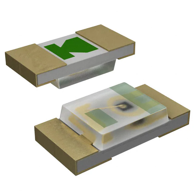

This product complies with the RoHS Directive (EU 2002/95/EC). Light Emitting Diodes LNJ826W83RA Surface Mounting Chip LED UTSS Type  Absolute Maximum Ratings Ta = 25°C Parameter  Lighting Color Symbol Rating Unit Power dissipation PD 45 mW Forward current IF 20 mA Pulse forward current * IFP 60 mA Reverse voltage VR 4 V Operating ambient temperature Topr –30 to +85 °C Storage temperature Tstg –40 to +100 °C  Orange Note) *: The conditon of IFP is duty 10%, pulse width 10 ms.  Electro-Optical Characteristics Ta = 25°C±3°C Parameter Symbol Conditions Min Typ Max Unit 11.5 19.0 47.3 mcd 100 µA 2.1 V Luminous intensity IO IF = 5 mA Reverse current IR VR = 4 V Forward voltage VF IF = 5 mA 1.9 Peak emission wavelength λP IF = 5 mA 630 Dominant emission wavelength λd IF = 5 mA Spectral half band width Δλ IF = 5 mA 615 nm 620 627 nm 13 nm Note) Be careful of the product destruction by static electricity. IO  I F 10 5 1 3 5 10 30 50 50 30 10 5 3 1 100 1.6 Forward current IF (mA) 1.8 2.0 2.2 80 30° 20° 10° 40° 60 50° 40 Peak emission wavelength λP (nm) Publication date: December 2008 90° 100 30° 40° 50° 60° 40° 70° 20° 80° 700 10° 20° 60° 70° 20 0° 80° 60° 650 50 30 −20 0 80 60 40 20 0 20 40 60 80 100 Ambient temperature Ta (°C) Directive characteristics 600 100 IF  Ta 25 100 550 300 Forward voltage VF (V) Relative luminous intensity  λP 0 500 10 2.4 Forward current IF (mA) Relative luminous intensity (%) Relative luminous intensity  Ta Relative luminous intensity (%) 50 1 IF  VF 100 Forward current IF (mA) Luminous intensity IO (mcd) 100 20 15 10 5 80° 20 40 60 Relative luminous intensity (%) SHD00603CEK 80 90° 100 0 0 20 40 60 80 100 Ambient temperature Ta (°C) 1 This product complies with the RoHS Directive (EU 2002/95/EC). LNJ826W83RA  Package (Unit: mm) KLTFTN2K2600  Pin name 1: Anode 2: Cathode 2 SHD00603CEK Request for your special attention and precautions in using the technical information and semiconductors described in this book (1) If any of the products or technical information described in this book is to be exported or provided to non-residents, the laws and regulations of the exporting country, especially, those with regard to security export control, must be observed. (2) The technical information described in this book is intended only to show the main characteristics and application circuit examples of the products. No license is granted in and to any intellectual property right or other right owned by Panasonic Corporation or any other company. Therefore, no responsibility is assumed by our company as to the infringement upon any such right owned by any other company which may arise as a result of the use of technical information described in this book. (3) The products described in this book are intended to be used for general applications (such as office equipment, communications equipment, measuring instruments and household appliances), or for specific applications as expressly stated in this book. Consult our sales staff in advance for information on the following applications: – Special applications (such as for airplanes, aerospace, automotive equipment, traffic signaling equipment, combustion equipment, life support systems and safety devices) in which exceptional quality and reliability are required, or if the failure or malfunction of the products may directly jeopardize life or harm the human body. It is to be understood that our company shall not be held responsible for any damage incurred as a result of or in connection with your using the products described in this book for any special application, unless our company agrees to your using the products in this book for any special application. (4) The products and product specifications described in this book are subject to change without notice for modification and/or improvement. At the final stage of your design, purchasing, or use of the products, therefore, ask for the most up-to-date Product Standards in advance to make sure that the latest specifications satisfy your requirements. (5) When designing your equipment, comply with the range of absolute maximum rating and the guaranteed operating conditions (operating power supply voltage and operating environment etc.). Especially, please be careful not to exceed the range of absolute maximum rating on the transient state, such as power-on, power-off and mode-switching. Otherwise, we will not be liable for any defect which may arise later in your equipment. Even when the products are used within the guaranteed values, take into the consideration of incidence of break down and failure mode, possible to occur to semiconductor products. Measures on the systems such as redundant design, arresting the spread of fire or preventing glitch are recommended in order to prevent physical injury, fire, social damages, for example, by using the products. (6) Comply with the instructions for use in order to prevent breakdown and characteristics change due to external factors (ESD, EOS, thermal stress and mechanical stress) at the time of handling, mounting or at customer's process. When using products for which damp-proof packing is required, satisfy the conditions, such as shelf life and the elapsed time since first opening the packages. (7) This book may be not reprinted or reproduced whether wholly or partially, without the prior written permission of our company. 20100202
