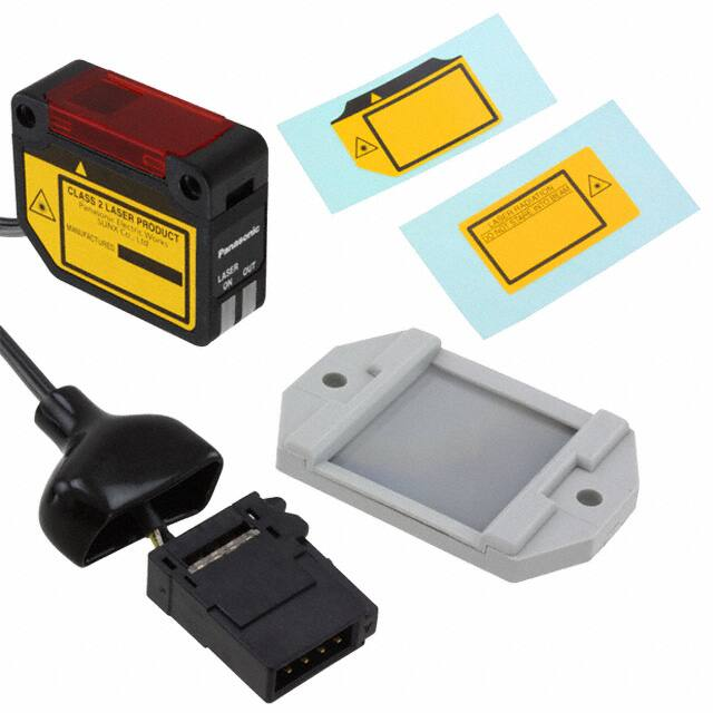

ORDER GUIDE
FIBER
SENSORS
LASER
SENSORS
Sensor heads
PHOTOELECTRIC
SENSORS
Type

LS-H92 (Note 1)
IEC / JIS / GB
LS-H92F (Note 2)
FDA / IEC / JIS
LS-H91 (Note 1)
IEC / JIS / GB
LS-H91F (Note 2)
FDA / IEC / JIS
LS-H91-A (Note 1)
IEC / JIS / GB
0.2 to 30 m 0.656 to 98.425 ft (Note 4)
0.2 to 20 m 0.656 to 65.617 ft (Note 4)
0.2 to 10 m 0.656 to 32.808 ft (Note 4)
0.1 to 7 m 0.328 to 22.966 ft (Note 4)
0.1 to 5 m 0.328 to 16.404 ft (Note 4)
0.1 to 3 m 0.328 to 9.843 ft (Note 4)
0.1 to 1 m 0.328 to 3.281 ft (Note 4)
LS-H91F-A (Note 2) FDA / IEC / JIS
LS-H21 (Note 1)
IEC / JIS / GB
LS-H21F (Note 2)
FDA / IEC / JIS
LS-H21-A (Note 1)
IEC / JIS / GB
LS-H21F-A (Note 2) FDA / IEC / JIS
LS-H22 (Note 1, 3)
: U-LG
: STD
: FAST
: H-SP
Sensing range
30 to 1,000 mm 1.181 to 39.370 in
30 to 500 mm 1.181 to 19.685 in
30 to 300 mm 1.181 to 11.811 in
30 to 250 mm 1.181 to 9.843 in
30 to 150 mm 1.181 to 5.906 in
IEC / JIS / GB
LS-H22F (Note 2, 3) FDA / IEC / JIS
NOTE: Mounting bracket is not supplied with the sensor head. Please select from the range of optional sensor head mounting
brackets.
Notes: 1) Obtained Korea’s S-mark certification.
2) This product complies with 21 CFR 1040.10 and 1040.11 Laser Notice No. 50, dated June 24, 2007, issued by CDRH (Center for Devices and
Radiological Health) under the FDA (Food and Drug Administration). For details, refer to the Laser Notice No. 50.
3) LS-H22(F) is the model No. for LS-H21(F) long sensing range spot reflective type sensor head combined with the LS-MR1 lens attachment for line
reflective type sensor head. Hence, LS-H21(F) appears on the sensor head itself.
4) The sensing range is the value for the RF-330 [RF-230 for the LS-H92(F)] reflector. In addition, the sensing range is the possible setting range for the
reflector. The sensor can detect an object less than 0.1 m 0.328 ft [LS-H92(F): 0.2 m 0.656 ft] away. Note that if there are white papers or specular
objects near the sensor head, reflected light from these objects may be received. In such cases, use the M.G.S. function of the amplifier unit to change
the response time or incident light sensitivity.
5 m 16.404 ft cable length type
5 m 16.404 ft cable length type (standard: 2 m 6.562 ft) is also available.
When ordering this type, suffix “-C5” to the model No.
• LS-H91-C5
• LS-H91-A-C5
• LS-H21-C5
• LS-H22-C5
Package without reflector
The LS-H91(F), LS-H91(F)-A and LS-H92(F) are also available without the reflector (RF-330 or RF-230).
When ordering this type, suffix “-Y” to the model No.
• LS-H92-Y
• LS-H92F-Y
• LS-H91-A-Y
• LS-H91F-A-Y
• LS-H91-Y
• LS-H91F-Y

Cautions for laser beams
• These products are class 2 (LS-H□-A:
Class 1) laser in compliance with IEC / JIS /
GB standards and FDA* regulations. Do not
look at the laser beam directly or through
optical system such as a lens.
• The following label is attached to the
product. Handle the product according to the
instruction given on the warning label.
SENSOR
OPTIONS
SIMPLE
WIRE-SAVING
UNITS
WIRE-SAVING
SYSTEMS
MEASUREMENT
SENSORS
STATIC
CONTROL
DEVICES
LASER
MARKERS
PLC
HUMAN
MACHINE
INTERFACES
ENERGY
MANAGEMENT
SOLUTIONS
FA
COMPONENTS
MACHINE
VISION
SYSTEMS
UV
CURING
SYSTEMS
IEC / JIS / GB Class 2 type
FDA Class 1 type
This product has warning labels attached
and included in the packaging that are
written in Japanese, English and Chinese
for compliance with various standards.
This product has explanation labels attached
written in Japanese, English and Chinese for
* This product complies with 21 CFR 1040.10 and 1040.11 Laser Notice
