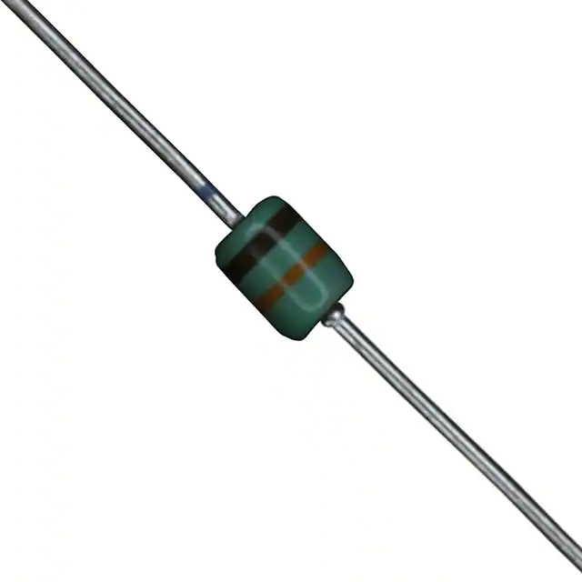

    DIODE ZENER 13V 370MW DO34
MAZ41300MF 数据手册
This product complies with the RoHS Directive (EU 2002/95/EC). Zener Diodes MAZ4xxx Series (MA4xxx Series) Silicon planar type Unit: mm For stabilization of power supply • High reliability, achieved by the DHD structure • Allowing to insert to a 5 mm pitch hole • Finely divided zener-voltage rank • Sharp rising performance • Wide voltage range: Zener voltage VZ = 2.0 V to 39.0 V 13.0 min. Colored band indicatesVz classification Forward current (Average) IF(AV) Repetitive peak forward current IFRM Power dissipation *1 PD Non-repetitive reverse surge *2 power dissipation PZSM Junction temperature Tj Storage temperature Tstg φ1.55±0.2 Anode di p Pl lan nclu ea e se pla m d m des ne ain ain foll htt visit d te t o p:/ fo /w llo dis disc nan enan wing ww wi co on ce c fo .se ng ntin tin ty e ty ur mi UR ue ued pe pe Pro co L a d t ty du n.p bo yp pe ct life an ut e d as lat cy on es cle ic. t in sta co fo ge .jp rm . /en at i o / n. Symbol 2.5+0.1 −0.3 Cathode 1st Band 2nd Band 3rd Band ■ Absolute Maximum Ratings Ta = 25°C Parameter 13.0 min. 2.7±0.3 φ 0.40±00.5 M Di ain sc te on na tin nc ue e/ d ■ Features Rating Unit 250 mA 250 mA 370 mW 30 W 200 °C −65 to +200 °C DO-34-A2 Package Note) *1: PD = 370 mW achieved with a printed circuit board *2: t = 100 µs, Tj = 150°C ce /D isc on tin ue ■ Common Electrical Characteristics Ta = 25°C ± 3°C *1 Parameter Forward voltage Zener voltage *2 an Zener rise operating resistance Ma int Reverse current en Zener operating resistance Temperature coefficient of zener voltage *3 Terminal capacitance Symbol Conditions Min Typ Max Unit 0.8 0.9 V VF IF = 10 mA VZ IZ Specified value V RZK IZ Specified value Ω RZ IZ Specified value IR1 VR Specified value IR2 VR Specified value SZ IZ Specified value Ct VR = 0 V, f = 1 MHz Specified value Refer to the list of the electrical characteristics within part numbers Ω µA mV/°C pF Note) 1. Measuring methods are based on JAPANESE INDUSTRIAL STANDARD JIS C 7031 measuring methods for diodes. 2. Absolute frequency of input and output is 50 MHz. 3. *1: The temperature must be controlled 25°C for VZ mesurement. VZ value measured at other temperature must be adjusted to VZ (25°C) *2: VZ guaranteed 20 ms after current flow. *3: Tj = 25°C to 150°C Note) The part number in the parenthesis shows conventional part number. Publication date: February 2007 SKE00004EED 1 This product complies with the RoHS Directive (EU 2002/95/EC). MAZ4xxx Series ■ Electrical Characteristics within Part Numbers Ta = 25°C ± 3°C • VZ = 2.0 V to 6.8 V (IZ = 5 mA) Zener voltage Reverse Zener Zener rise Temperature operating operating coefficient of resistance resistance zener voltage Terminal capacitance Ct (pF) IR1 (µA) IR2 (µA) RZ (Ω) RZK (Ω) SZ (mV/°C) R = 0 V) VR VR IZ = 5 mA IZ IZ = 5 mA (V f = 1 MHz (V) Max (V) Max Max (mA) Max Min Typ Max Typ Max current Part number 1.88 2.08 2.28 2.50 2.80 3.10 3.40 3.70 4.00 4.40 4.80 5.30 5.80 6.40 7.00 7.70 8.50 9.40 10.40 11.40 12.40 13.65 13.90 15.30 16.90 18.80 20.80 22.80 2.24 2.45 2.70 2.90 3.20 3.50 3.80 4.10 4.60 5.00 5.40 6.00 6.60 7.20 7.90 8.70 9.60 10.60 11.60 12.70 14.10 14.35 15.60 17.10 19.10 21.20 23.30 25.60 0.5 0.7 1.0 1.0 1.0 1.0 1.0 1.0 1.0 1.0 2.0 2.0 4.0 4.0 5 5 6 7 7 8 9 9 10 11 13 14 15 17 120 120 120 100 50 20 10 10 10 3 2 1 3 2 1 0.5 0.2 0.2 0.1 0.1 0.1 0.1 0.05 0.05 0.05 0.05 0.05 0.05             5.3 5.9 6.5 7.2 8.0 8.9 9.9 10.9 11.9 13.1 13.4 14.8 16.4 18.3 20.3 22.3             60 60 60 60 60 60 60 60 60 60 60 60 60 60 60 60 100 100 100 100 100 100 100 100 100 80 60 40 20 15 15 15 15 20 20 25 30 30 30 40 45 55 55 70 1 2000 1 2000 1 2000 1 1000 1 1000 1 1000 1 1000 1 1000 1 1000 1 900 1 800 1 500 0.5 300 0.5 140 0.5 120 0.5 120 0.5 130 0.5 130 0.5 170 0.5 170 0.5 170 0.5 170 0.5 170 0.5 170 0.5 170 0.5 180 0.5 180 0.5 180 −3.5 −1.5 0 −3.5 −1.5 0 −3.5 −1.6 0 −3.5 −2.0 0 −3.5 −2.1 0 −3.5 −2.4 0 −3.5 −2.4 0 −3.5 −2.5 0 −3.5 −2.5 0 −3.5 −1.4 0.2 −2.7 −0.8 1.2 −2.0 1.2 2.5 0.4 2.3 3.7 1.2 3.0 4.5 2.5 4.0 5.3 3.2 4.6 6.2 3.8 5.5 7.0 4.5 6.4 8.0 5.4 7.4 9.0 6.0 8.4 10.0 7.0 9.4 11.0 7.0 10.0 13.0 9.2 11.4 13.0 10.4 12.4 14.0 12.4 14.4 16.0 14.4 16.4 18.0 16.4 18.4 20.0 18.4 20.4 22.0 375 375 375 350 350 325 300 300 275 130 110 95 90 85 80 75 70 70 65 65 60 60 55 52 47 36 34 33 450 450 450 450 450 450 450 450 450 180 160 140 130 110 100 95 90 90 85 85 80 80 75 75 70 60 60 55 Ma Zener voltage Part number MAZ4270 MAZ4300 MAZ4330 MAZ4360 MAZ4390 2 VZ (V) IZ = 2 mA Min Max 25.10 28.00 31.00 34.00 37.00 ue ce /D isc on tin an int en • VZ = 27.0 V to 39.0 V (IZ = 2 mA) 28.90 32.00 35.00 38.00 41.00 Reverse Terminal capacicurrent tance Ct (pF) IR1 (µA) IR2 (µA) RZ (Ω) RZK (Ω) SZ (mV/°C) R = 0 V) VR VR IZ = 2 mA IZ IZ = 2 mA (V f = 1 MHz (V) Max (V) Max Max (mA) Max Min Typ Max Typ Max 19 21 23 25 27 ( ) 1st. 2nd. 3rd. Red Black Black Red Red Red Red Yellow Yellow Red Purple Purple Orange Black Black Orange Orange Orange Orange Blue Blue Orange White White Yellow Orange Orange Yellow Purple Purple Green Brown Brown Green Blue Blue Blue Red Red Blue Gray Gray Purple Green Green Gray Red Red White Brown Brown Brown Black  Brown Brown  Brown Red  Brown Orange  Brown Yellow  Brown Green  Brown Blue  Brown Gray  Red Black  Red Red  Red Yellow  di p Pl lan nclu ea e se pla m d m des ne ain ain foll htt visit d te t o p:/ fo /w llo dis disc nan enan wing ww wi co on ce c fo .se ng ntin tin ty e ty ur mi UR ue ued pe pe Pro co L a d t ty du n.p bo yp pe ct life an ut e d as lat cy on es cle ic. t in sta co fo ge .jp rm . /en at i o / n. M Di ain sc te on na tin nc ue e/ d MAZ4020 MAZ4022 MAZ4024 MAZ4027 MAZ4030 MAZ4033 MAZ4036 MAZ4039 MAZ4043 MAZ4047 MAZ4051 MAZ4056 MAZ4062 MAZ4068 MAZ4075 MAZ4082 MAZ4091 MAZ4100 MAZ4110 MAZ4120 MAZ4130 MAZ4140 MAZ4150 MAZ4160 MAZ4180 MAZ4200 MAZ4220 MAZ4240 VZ (V) IZ = 5 mA Min Max Marking symbol Color indication Main body: Light green 0.05 0.05 0.05 0.05 0.05 24.8 27.8 30.7 33.6 36.0 Zener Zener rise Temperature operating operating coefficient of resistance resistance zener voltage 60 60 60 60 60 80 80 80 90 130 0.5 0.5 0.5 0.5 0.5 SKE00004EED 200 200 200 200 250 21.4 24.4 27.4 30.4 33.4 23.4 26.6 29.7 33.0 36.4 25.3 29.4 33.4 37.4 41.2 30 27 25 23 21 50 50 45 45 45 Marking symbol Color indication Main body: Light green ( ) 1st. 2nd. 3rd. Red Purple  Orange Black  Orange Orange  Orange Blue  Orange White  This product complies with the RoHS Directive (EU 2002/95/EC). MAZ4xxx Series PD  Ta IF  VF Ta = 25°C (Prior to surge) 240 160 0 50 100 150 200 250 IZ  V Z 1 0 10 0.2 0.4 0.6 MAZ4043 40 Zener current IZ (mA) MAZ4036 MAZ4039 60 MAZ4091 MAZ4030 MAZ4033 80 MAZ4100 Zener current IZ (mA) MAZ4024 MAZ4027 1.2 IZ  VZ 100 120 1.0 40 Ta = 25°C Static Characteristics Ta = 25°C Static Characteristics 0.8 Forward voltage VF (V) 120 40 0 IZ  VZ 160 80 80 Pulse width tW (ms) Ambient temperature Ta (°C) Zener current IZ (mA) 1 10−1 MAZ4047 MAZ4051 MAZ4056 MAZ4062 MAZ4068 MAZ4075 MAZ4082 0 150°C (Prior to surge) 30 20 Ta = 25°C Static Characteristics MAZ4200 100 10 di p Pl lan nclu ea e se pla m d m des ne ain ain foll htt visit d te t o p:/ fo /w llo dis disc nan enan wing ww wi co on ce c fo .se ng ntin tin ty e ty ur mi UR ue ued pe pe Pro co L a d t ty du n.p bo yp pe ct life an ut e d as lat cy on es cle ic. t in sta co fo ge .jp rm . /en at i o / n. 200 10 MAZ4240 MAZ4270 MAZ4300 MAZ4330 MAZ4360 300 102 MAZ4110 MAZ4130 MAZ4160 400 Ta = 25°C Forward current IF (mA) Non-repetitive reverse surge power dissipation PZSM (W) Thickness of the printed-circuit board 1.6 mm Copper foil 0.035 mm, Hole distance 5 mm Anode side copper foil φ 3 mm Cathode side copper foil φ 3 mm M Di ain sc te on na tin nc ue e/ d Power dissipation PD (mW) PZSM  tW 320 500 20 IZ  V Z 2 4 8 10 12 120 MAZ4039 40 40 MAZ4043 0 1 2 3 4 Zener voltage VZ (V) 5 6 MAZ4100 MAZ4082 MAZ4091 MAZ4062 80 0 0 2 4 6 8 10 Zener voltage VZ (V) SKE00004EED 12 Zener current IZ (mA) MAZ4036 40 Tj = 25°C Dynamic Characteristics 80 MAZ4075 MAZ4033 80 30 IZ  VZ Tj = 25°C Dynamic Characteristics MAZ4068 MAZ4030 20 100 MAZ4047 MAZ4027 120 10 Zener voltage VZ (V) IZ  VZ MAZ4051 MAZ4056 Ma Zener current IZ (mA) MAZ4024 0 Zener voltage VZ (V) 160 int 160 en Tj = 25°C Dynamic Characteristics 0 6 200 an 200 Zener current IZ (mA) 0 0 ce /D isc on tin Zener voltage VZ (V) 0 60 MAZ4360 6 MAZ4300 MAZ4330 5 MAZ4270 4 MAZ4240 3 MAZ4200 2 MAZ4160 1 MAZ4110 MAZ4130 0 ue 0 40 20 0 0 10 20 30 40 Zener voltage VZ (V) 3 This product complies with the RoHS Directive (EU 2002/95/EC). MAZ4xxx Series RZ  IZ 104 1 Zener operating resistance RZ (Ω) Heat sink Thickness t = 1.6 mm Copper foil t = 0.035 mm Anode side φ 3 mm Cathode side φ 3 mm Lead distance 5 mm 103 102 M Di ain sc te on na tin nc ue e/ d Transient thermal impedance Zth (°C / mW) Zth  tW 10−1 1 102 10 MAZ4043 0 MAZ4039 −1 MAZ4036 MAZ4033 MAZ4030 −2 MAZ4024 MAZ4027 −3 0 20 40 60 80 100 10 Tj = 25°C to 150°C 6 an en int Ma 4 MAZ4091 MAZ4082 MAZ4075 2 MAZ4068 MAZ4062 MAZ4051 MAZ4056 MAZ4047 −2 −6 ce /D isc on tin Zener current IZ (mA) 120 Temperature coefficient of zener voltage SZ (mV / °C) SZ  IZ Tj = 25°C to 150°C MAZ4068 1 10 Zener current IZ (mA) 0 ue Temperature coefficient of zener voltage SZ (mV / °C) SZ  I Z 10 1 10−1 Pulse width tW (s) 1 MAZ4024 MAZ4300 MAZ4047 MAZ4200 MAZ4120 di p Pl lan nclu ea e se pla m d m des ne ain ain foll htt visit d te t o p:/ fo /w llo dis disc nan enan wing ww wi co on ce c fo .se ng ntin tin ty e ty ur mi UR ue ued pe pe Pro co L a d t ty du n.p bo yp pe ct life an ut e d as lat cy on es cle ic. t in sta co fo ge .jp rm . /en at i o / n. 10−1 MAZ4033 4 8 12 16 20 Zener current IZ (mA) SKE00004EED 24 102 Request for your special attention and precautions in using the technical information and semiconductors described in this book (1) If any of the products or technical information described in this book is to be exported or provided to non-residents, the laws and regulations of the exporting country, especially, those with regard to security export control, must be observed. (2) The technical information described in this book is intended only to show the main characteristics and application circuit examples of the products, and no license is granted under any intellectual property right or other right owned by our company or any other company. Therefore, no responsibility is assumed by our company as to the infringement upon any such right owned by any other company which may arise as a result of the use of technical information described in this book. M Di ain sc te on na tin nc ue e/ d (3) The products described in this book are intended to be used for standard applications or general electronic equipment (such as office equipment, communications equipment, measuring instruments and household appliances). Consult our sales staff in advance for information on the following applications: – Special applications (such as for airplanes, aerospace, automobiles, traffic control equipment, combustion equipment, life support systems and safety devices) in which exceptional quality and reliability are required, or if the failure or malfunction of the products may directly jeopardize life or harm the human body. – Any applications other than the standard applications intended. d pla inc ne lud se pla m d m es v ne ain ain foll htt isit d te t o p:/ fo /w llo dis disc nan enan wing ww wi co on ce c fo .se ng ntin tin ty e ty ur mi UR ue ued pe pe Pro co L a d t ty du n.p bo yp pe ct life an ut e d as lat cy on es cle ic. t in sta co fo ge .jp rm . /en at i o / n. (4) The products and product specifications described in this book are subject to change without notice for modification and/or improvement. At the final stage of your design, purchasing, or use of the products, therefore, ask for the most up-to-date Product Standards in advance to make sure that the latest specifications satisfy your requirements. (5) When designing your equipment, comply with the range of absolute maximum rating and the guaranteed operating conditions (operating power supply voltage and operating environment etc.). Especially, please be careful not to exceed the range of absolute maximum rating on the transient state, such as power-on, power-off and mode-switching. Otherwise, we will not be liable for any defect which may arise later in your equipment. Even when the products are used within the guaranteed values, take into the consideration of incidence of break down and failure mode, possible to occur to semiconductor products. Measures on the systems such as redundant design, arresting the spread of fire or preventing glitch are recommended in order to prevent physical injury, fire, social damages, for example, by using the products. (6) Comply with the instructions for use in order to prevent breakdown and characteristics change due to external factors (ESD, EOS, thermal stress and mechanical stress) at the time of handling, mounting or at customer's process. When using products for which damp-proof packing is required, satisfy the conditions, such as shelf life and the elapsed time since first opening the packages. Pl ea Ma int en an ce /D isc on tin ue (7) This book may be not reprinted or reproduced whether wholly or partially, without the prior written permission of Matsushita Electric Industrial Co., Ltd.
MAZ41300MF
物料型号:MAZ4xxx系列(MA4xxx系列)
器件简介:这是一系列由Panasonic生产的硅平面型稳压二极管,主要用于电源的稳定。
引脚分配:文档中提到了DO-34-A2封装,具有两个引脚,阳极和阴极,并且有一个彩色带表示稳压值的分类。
参数特性: - 正向平均电流(IRAV):250 mA - 重复峰值正向电流(IFRM):250 mA - 功率耗散(Pp):370 mW(在印刷电路板上实现) - 非重复反向浪涌功率耗散(PZSM):30 W - 结温(T):200℃ - 存储温度(Tsg):-65至+200℃
功能详解:这些稳压二极管具有高可靠性,采用DHD结构,允许插入到5毫米间距的孔中,精细划分的稳压电压等级,快速上升性能,以及宽电压范围(稳压电压VZ从2.0V到39.0V)。
应用信息:适用于需要电源稳定的场合,如电源电路的保护和稳定。
封装信息:提供了DO-34-A2封装的尺寸信息,包括长度、宽度和引脚直径。
