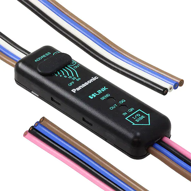

945 FIBER SENSORS Sensor & Wire-saving Link System S-LINK Related Information ■■General terms and conditions............ F-17 LASER SENSORS PHOTOELECTRIC SENSORS Conforming to EMC Directive (Excluding some models) MICRO PHOTOELECTRIC SENSORS AREA SENSORS LIGHT CURTAINS PRESSURE / FLOW SENSORS INDUCTIVE PROXIMITY SENSORS PARTICULAR USE SENSORS SENSOR OPTIONS SIMPLE WIRE-SAVING UNITS WIRE-SAVING SYSTEMS MEASUREMENT SENSORS STATIC CONTROL DEVICES ENDOSCOPE LASER MARKERS PLC / TERMINALS HUMAN MACHINE INTERFACES ENERGY CONSUMPTION VISUALIZATION COMPONENTS FA COMPONENTS MACHINE VISION SYSTEMS UV CURING SYSTEMS panasonic-electric-works.net/sunx This product is introduced to only limited countries. Please contact our office for details. S-LINK transmits 128 points on two signal lines, and “T”-branch multi-drop system enabling flexible cable layout We’ve realized a wire-saving system that’s easy to use Remote I/O Just with the wire-saving between the PLC and the sub-stations, you’ll be able to save a mountain of I/O device connection wires. S-LINK The remote I/O is one-dimensional wiring Allows for great wire-saving for all connections. Installation is made easy with no faulty wiring. The power supply line can also be wired up together enabling true wire-saving for I/O devices. The S-LINK is two-dimensional wiring For Large Scale Systems For Medium Scale Systems S-LINK Transmission distance: 200 m 656.168 ft (400 m 1312.336 ft when using booster) Total wiring length: 400 m 1312.336 ft (800 m 2624.672 ft when using one booster) Connectable I/O: 128 points The maximum number of sub-stations which can be connected: 128 nodes ( ) Sensor & Wire-saving Link System S-LINK High noise immunity Specifies malfunctioning S-LINK I/O devices Large voltage amplitude (24 V) and wide pulse width (35 µs) signal transmissions make for units less prone to impulse noise effects with no code errors. This high level of noise proofing enables them to be used even in worksites with conventional, high-priced optical communication remote I/O units. In the event that verification cannot be obtained from an S-LINK I/O unit, such as if the main cable is cutoff, the address of the particular unverifiable S-LINK I/O unit is specified and displayed allowing equipment recovery time to be greatly reduced. Address display 946 FIBER SENSORS LASER SENSORS PHOTOELECTRIC SENSORS MICRO PHOTOELECTRIC SENSORS AREA SENSORS LIGHT CURTAINS PRESSURE / FLOW SENSORS INDUCTIVE PROXIMITY SENSORS Alleviates the burden laid on engineer for designing and wiring Labor-saving hook-up connectors are used enabling multiple “T”-branch hookups. It goes without saying that cascade wiring (bus wiring) as well as multiple branch wiring (star wiring) is also possible. “T”-branch PARTICULAR USE SENSORS SENSOR OPTIONS SIMPLE WIRE-SAVING UNITS WIRE-SAVING SYSTEMS Cascade wiring “T”-branch Star wiring MEASUREMENT SENSORS STATIC CONTROL DEVICES ENDOSCOPE LASER MARKERS Simple and reliable connections We’ve provided all types of hook-up connectors. Connections from S-LINK I/O devices to the main cable and from sensors and other devices to S-LINK I/O devices are all realized with one-touch hook-up connectors. They can be connected anywhere quickly and maintenance is easy. Branch cable to main cable connection and S-LINK I/O device to main cable connection * The values in ( ) represent conductor cross-section areas. SL-CP1 (0.08 to 0.2 mm ) SL-CP2 (0.3 mm2) SL-CP3 (0.5 mm2) SL-CJ1 (0.08 to 0.2 mm ) SL-CJ2 (0.3 mm2) FA COMPONENTS MACHINE VISION SYSTEMS 3 4 SL-CP2 (0.3 mm2) SL-CP3 (0.5 mm2) 2 ENERGY CONSUMPTION VISUALIZATION COMPONENTS 4 2 HUMAN MACHINE INTERFACES 2 SL-J1A Connection from various connected units to S-LINK I/O devices * The values in ( ) represent conductor cross-section areas. PLC / TERMINALS UV CURING SYSTEMS 7 6 5 4 5 3 1 0 2 8 1 7 6 2 SL-JK (For cable end) SL-JK1 (For “T”-branch) 3 4 For Large Scale Systems For Medium Scale Systems SL-T8J SL-BMJ In addition, to enhance the reliability of the crimping, S-LINK exclusive pliers are made available so that anyone can do it with ease. Connected device extensions * The values in ( ) represent conductor cross-section areas. 4-pin type 2-pin type SL-CP1 (0.08 to 0.2 mm ) SL-CP2 (0.3 mm2) SL-CP3 (0.5 mm2) 2 SL-CP12 (0.08 to 0.2 mm2) SL-CP22 (0.3 mm2) SL-CJ1 (0.08 to 0.2 mm2) SL-CJ2 (0.3 mm2) SL-JK (0.5 mm2) Exclusive pliers SL-CJ12 (0.08 to 0.2 mm2) SL-CJ22 (0.3 mm2) S-LINK 947 FIBER SENSORS Sensor & Wire-saving Link System S-LINK Direct main cable connecting of sensors and actuators possible All types of transmission line direct-connecting type sensors are made available. Even partner makers are putting on the market manifold electromagnetic valves and limit switches that can be directly connected with the S-LINK system making wire-saving and labor-saving a reality. LASER SENSORS PHOTOELECTRIC SENSORS MICRO PHOTOELECTRIC SENSORS S-LINK direct hook-up area sensor SL-N15 Items offered by partner makers AREA SENSORS Manifold electromagnetic valve manufactured by Koganei Corp. LIGHT CURTAINS PRESSURE / FLOW SENSORS INDUCTIVE PROXIMITY SENSORS Manifold electromagnetic valve manufactured by SMC Pneumatics Manifold electromagnetic valve manufactured by CKD Corp. Component indicator lamp manufactured by Yazaki Industrial Chemical Co., Ltd. S-LINK direct hook-up photoelectric sensor SL-A series PARTICULAR USE SENSORS SENSOR OPTIONS SIMPLE WIRE-SAVING UNITS WIRE-SAVING SYSTEMS MEASUREMENT SENSORS STATIC CONTROL DEVICES ENDOSCOPE LASER MARKERS PLC / TERMINALS Mid-system main / branch cable installation and removal possible For conveyors or other large scale equipment, transport can also be done after dividing the whole into units of several meters in length right at the factory. Then, reassembly and wiring can be effectuated onsite afterwards. Because the S-LINK can be easily divided even from mid-system main / branch cables with the help of commercially available connectors and terminals, the segmented equipment can be wired up prior to transport. Once onsite, assembly work is all but complete with just the connecting of the individual units to each other. In addition, when assembling the equipment, the S-LINK can work even disconnected from the PLC enabling software (PLC programming) and hardware (machine assembly, I/O check) work to be done concurrently, which results in quick delivery time. With the handy monitor, I/O devices can be checked for each piece of equipment separately enabling subcontractors to conduct check work on delivery. This results in a total delivery deadline reduction and clearly defined subcontractor responsibilities. Also, checking can be performed even without programming so you’ll know immediately if malfunctions are coming from the PLC or the S-LINK. Dividing equipment into subunits possible Equipment 4 HUMAN MACHINE INTERFACES ENERGY CONSUMPTION VISUALIZATION COMPONENTS FA COMPONENTS S-LINK controller Equipment 1 Equipment 2 Commercially available connectors S-LINK I/O device Equipment 3 MACHINE VISION SYSTEMS UV CURING SYSTEMS Individual equipment subunits can be checked separately For Large Scale Systems For Medium Scale Systems S-LINK Checking inputs / outputs is easy. Handy monitor SL-HM1 Sensor & Wire-saving Link System S-LINK Total cost reductions and great savings in setup time Auxiliary materials reduced By introducing the S-LINK, you can reduce the total cost of system construction to one-fifth. Total costs including for materials go down dramatically and, by decreasing the workload, construction time is lessened which means you can easily meet that tough deadline. The S-LINK system: ● A hardware-only construction makes layout design simple ● With hook-up connectors, construction time is greatly reduced ● Layout modifications made easy ● Equipment divided into separate segments make for easy debugging ● Segmented equipment can be easily interlinked with commercially available connectors Great reductions in auxiliary materials such as cable racks, cable ducts, intermediate terminal blocks, and cables. This system also contributes greatly to the reduction waste caused by cutting cable ends. Conventional Design Construction Debug Shipment and setup Design Construction Debug Shipment and setup S-LINK 948 FIBER SENSORS LASER SENSORS PHOTOELECTRIC SENSORS MICRO PHOTOELECTRIC SENSORS AREA SENSORS LIGHT CURTAINS PRESSURE / FLOW SENSORS INDUCTIVE PROXIMITY SENSORS Space-saving Because of great reductions in the amount of intermediate terminal blocks and cables needed, you can save space and minimize the size of your control board and machines. This will finally let you put all that wasted space to good use. Construction time greatly reduced PARTICULAR USE SENSORS SENSOR OPTIONS SIMPLE WIRE-SAVING UNITS WIRE-SAVING SYSTEMS MEASUREMENT SENSORS The control box can be of smaller size STATIC CONTROL DEVICES ENDOSCOPE LASER MARKERS PLC / TERMINALS HUMAN MACHINE INTERFACES Upper-level network connection possible Because it can be connected to any main open network, long-distance and multi-point transmission networks can be constructed enabling a greatly enhanced network upgrade. Also, by wiring up scattered bit-oriented I/O devices that include mostly connected sensors and switches, an efficient wire-saving layout can be realized. If exporting equipment that was setup with any open network, it can be made to correspond to different networks just by installing an S-LINK gateway controller with the entire S-LINK system left as it is. S AD ES B0 T B1~ 31 OU 0 63 32~ 95 64~ 127 96~F OF IN AT. ST T SE SE ND ER CC-Link DR F OF K. CH ON N RUS. SYD. AD ER ER BK 1 BU 3 SH A 24 0 ID F 0 R NK Y CON EWA GAT S-LINK gateway controller 05 -G For Large Scale Systems For Medium Scale Systems I. OF ON G 24 S-LI UV CURING SYSTEMS 1 0 32 16 8 4 2 1 D G N8Q MACHINE VISION SYSTEMS RD B TE 24 0 SL FA COMPONENTS WH 4 DeviceNet ENERGY CONSUMPTION VISUALIZATION COMPONENTS LLE TRO U1 -D AN JAP S-LINK 949 FIBER SENSORS LASER SENSORS Sensor & Wire-saving Link System S-LINK APPLICATIONS Distributed installation Automatic storage PHOTOELECTRIC SENSORS MICRO PHOTOELECTRIC SENSORS AREA SENSORS LIGHT CURTAINS PRESSURE / FLOW SENSORS INDUCTIVE PROXIMITY SENSORS PARTICULAR USE SENSORS SENSOR OPTIONS SIMPLE WIRE-SAVING UNITS Because conveyors have multiple I/O device points, wire-saving and construction efficiency are the key to lowering overall costs. Other systems may be wire-saving but if they can’t prove useful for long-distance distribution lines and be reliable, then they are useless. On this point, the S-LINK system offers a total wiring length of 400 m 1312 ft, 800 m 2625 ft when using booster, with reliable T-branch I/O device connections that can be mounted in any desired location. Because T-branching renders layout designing simple, not only is it a wire-saving and construction efficient system, but you can even save time in the actual design stage. In addition, you can divide main and branch cables in mid-system with commercially available connectors and terminals so the time it takes to setup your conveyor decreases greatly. WIRE-SAVING SYSTEMS MEASUREMENT SENSORS Easy hook-up STATIC CONTROL DEVICES ENDOSCOPE LASER MARKERS PLC / TERMINALS HUMAN MACHINE INTERFACES ENERGY CONSUMPTION VISUALIZATION COMPONENTS Parking garage Display panel control FA COMPONENTS MACHINE VISION SYSTEMS 12 34 UV CURING SYSTEMS 12 Personal computer Sensor For Large Scale Systems For Medium Scale Systems S-LINK 12 12 34 12 Sensor 34 34 12 Sensor 34 34 Sensor The S-LINK system is very suitable to wire up car detection sensors in a large parking garage. It reduces wires and installation time. Display equipment can be mounted in automobile production lines to notify operators when malfunctions occur or just to keep a reliable count of units in each line. Because each type of display equipment shows variegated data, they necessitate a great amount of wiring. This wiring must be conducted in very large factories requiring a substantial amount of cables and wires. A wire-saving system in this situation would be most effective. Using the S-LINK system means that even display equipment can be wired up with just one flat cable, and clearing up all the bulky wiring inside the display panels themselves and realizing great material cost savings as well as a reduced workload. Sensor & Wire-saving Link System S-LINK APPLICATIONS 950 FIBER SENSORS Integrated installation LASER SENSORS Automatic assembly machine Turntable PHOTOELECTRIC SENSORS MICRO PHOTOELECTRIC SENSORS AREA SENSORS LIGHT CURTAINS PRESSURE / FLOW SENSORS INDUCTIVE PROXIMITY SENSORS PARTICULAR USE SENSORS SENSOR OPTIONS SIMPLE WIRE-SAVING UNITS WIRE-SAVING SYSTEMS MEASUREMENT SENSORS The wire-saving system is being greatly emphasized even for assembly lines crowded with multiple I/O devices. Also, to enhance productivity, using a wire-saving system is the key to reliability and avoiding the occurrence of troubles. In the S-LINK loop wiring, the system maintains signal transmission even when the loop may break at any one place. Also, the controller displays disconnected unit address. Further, when excess current flows or short-circuit occurs in the signal transmission lines, the signal transmission is stopped to protect the system. S-LINK is a wire-saving system optimal for the automatic assembly machinery. Handler The wiring of I/O devices mounted on a rotating board (turntable) used to be quite a difficult task. Because a slip ring with the same number of terminals as wires had to be used. Therefore, there have been difficulties such as employing a large slip ring or reduction of I/O point count. S-LINK enables the connection of up to 128 I/O points on a 4-pole slip ring. A compact slip ring can be used without worrying about I/O points. STATIC CONTROL DEVICES ENDOSCOPE LASER MARKERS PLC / TERMINALS HUMAN MACHINE INTERFACES ENERGY CONSUMPTION VISUALIZATION COMPONENTS Parts picking system FA COMPONENTS MACHINE VISION SYSTEMS UV CURING SYSTEMS For Large Scale Systems For Medium Scale Systems S-LINK “The handler” as the IC test equipment uses multiple sensors. Cost reduction or downsizing depends on how to reduce these wires and to save space. S-LINK realizes wire-saving and space-saving; hence these problems are solved all at once. Many small picking sensors are employed in the parts picking system in order to verify the correct selection of components. The number of input points is required as much as the number of shelves, the number of output points is also required to be the same in adopting the operational indicators. S-LINK system greatly contributes to wire-saving both in I/O points and in space. Also, extra shelves can be added easily. 951 FIBER SENSORS LASER SENSORS PHOTOELECTRIC SENSORS MICRO PHOTOELECTRIC SENSORS Sensor & Wire-saving Link System S-LINK SYSTEM LAYOUT Upper-level control devices PLC AREA SENSORS S-LINK control components PLC I/O connectors (for connectable PLC) SL-S□, SL-P□ Multi-core cable PLC I/O units (for screw-on terminal type PLC) SL-S, SL-SP, SL-P, SL-PP S-LINK controller SL-CU1A Booster SL-BS1A LIGHT CURTAINS PRESSURE / FLOW SENSORS INDUCTIVE PROXIMITY SENSORS PARTICULAR USE SENSORS SENSOR OPTIONS SIMPLE WIRE-SAVING UNITS PLC (Direct connection to PLC bus) S-LINK controller for direct connection to PLC bus / S-LINK control boards FPΣ S-LINK unit FPG-SL FP0 S-LINK Control unit FP0-SL1 FP2SH S-LINK unit FP2-SL2 For Mitsubishi Electric Corp. PLC MELSEC-Q series SL-MEL-Q For Yokogawa Electric Corp. PLC FA-M3 series SL-FAM3 WIRE-SAVING SYSTEMS MEASUREMENT SENSORS STATIC CONTROL DEVICES Items offered by partner makers Controllers manufactured by JTEKT Corp. THU-5291 ENDOSCOPE LASER MARKERS PLC / TERMINALS HUMAN MACHINE INTERFACES Personal computers For ISA bus SL-PCAT Open network compatible PLC For CC-Link SL-GU1-C For PC/104 bus SL-PC104 ENERGY CONSUMPTION VISUALIZATION COMPONENTS FA COMPONENTS MACHINE VISION SYSTEMS UV CURING SYSTEMS For Large Scale Systems For Medium Scale Systems S-LINK For Device Net SL-GU1-D Sensor & Wire-saving Link System S-LINK SYSTEM LAYOUT 952 FIBER SENSORS LASER SENSORS S-LINK I/O devices Analog I/O arrayed terminal unit SL-TBAD4, SL-TBDA1 1 • 2 channel I/O unit SL-CH□(-PN) 8 channel snap-connector I/O unit SL-T8J(-PN), SL-TP8J(-PN) PHOTOELECTRIC SENSORS For e-con 8 channel snap-connector I/O unit SL-T8E(-PN), SL-TP8E(-PN) MICRO PHOTOELECTRIC SENSORS AREA SENSORS LIGHT CURTAINS PRESSURE / FLOW SENSORS INDUCTIVE PROXIMITY SENSORS 4 inputs 1 output PARTICULAR USE SENSORS 16 channel MIL connector I/O unit SL-T16C1(-PN), SL-TP16C1(-PN) 8-branch connector tap SL-T8PW I/O arrayed terminal unit SL-TB□(-PN), SL-TBP□(-PN) SL-TBP□-TY Relay output terminal unit SL-TPR4, SL-TPR8 SENSOR OPTIONS SIMPLE WIRE-SAVING UNITS WIRE-SAVING SYSTEMS MEASUREMENT SENSORS STATIC CONTROL DEVICES 4, 8 or 16 inputs 4, 8 or 16 outputs Snap-connector sensor block SL-BMJ, SL-BXJ Plug-in unit sensor block SL-BM, SL-BX S-LINK direct hook-up photoelectric sensor SL-A□ S-LINK direct hook-up picking sensor SL-N15 ENDOSCOPE LASER MARKERS PLC / TERMINALS HUMAN MACHINE INTERFACES ENERGY CONSUMPTION VISUALIZATION COMPONENTS FA COMPONENTS MACHINE VISION SYSTEMS Items offered by partner makers Manifold electromagnetic valve manufactured by Koganei Corp. Manifold electromagnetic valve manufactured by SMC Pneumatics Manifold electromagnetic valve manufactured by CKD Corp. Component indicator lamp manufactured by Yazaki Industrial Chemical Co., Ltd. UV CURING SYSTEMS For Large Scale Systems For Medium Scale Systems S-LINK Plug-in units (for SL-BM, SL-BX) Amplifier-separated photoelectric sensor SU-7J Input terminal unit SL-TJ1 953 FIBER SENSORS Sensor & Wire-saving Link System S-LINK SYSTEM LAYOUT LASER SENSORS Connectors and cables PHOTOELECTRIC SENSORS SL-CH□(-PN) AREA SENSORS LIGHT CURTAINS I/O SIDE IN/OU T SEND OFF 1 2 4 8 16 32 64 ESS ADDR WIRE-SAVING SYSTEMS MEASUREMENT SENSORS STATIC CONTROL DEVICES SL-CP1, SL-CP2 or SL-CP3 Connect a thru-beam type photoelectric sensor emitter or an S-LINK I/O device to the SL-T8PW SL-T16C1(-PN) SL-TP16C1(-PN) SL-JK1 “T”-branch an S-LINK I/O device fitted with either a 0.3 mm2 cabtyre cable or a flat cable to the main or branch cable in mid-system MIL connector SL-CP2 or SL-CP3 PARTICULAR USE SENSORS SIMPLE WIRE-SAVING UNITS 1 2 3 SL-N15 SL-T8J(-PN) SL-TP8J(-PN) SL-CP1, SL-CP2 or SL-CP3 Connect an I/O device to the SL-T8J(-PN)/TP8J(-PN) SL-T8J(-PN) SL-TP8J(-PN) SL-BMJ SL-RCM100 SL-RCM200 [S-LINK exclusive 4-core flat cable] SL-J3A [Flat cable extension] SL-CJ1 or SL-CJ2 Connect an input device to the SL-BMJ SL-BMJ SL-CH2□(-PN) ADDR ESS SL X SUN -C X H1 OFF 1 2 4 8 16 32 64 SEND IN/OU T I/O SIDE LASER MARKERS SL-JK1 PLC / TERMINALS SL-CP1, SL-CP2 or SL-CP3 SL-A□ SL-CP2 HUMAN MACHINE INTERFACES [2-wire device cable extension] 2-wire device SL-JK SL-CP1, SL-CP2 or SL-CP3 SL-CJ2 ENERGY CONSUMPTION VISUALIZATION COMPONENTS MACHINE VISION SYSTEMS SL-TPR4 SL-TPR8 SL-BM SL-A□ 4 ENDOSCOPE FA COMPONENTS SL-T8PW SL-T8J(-PN) SL-TP8J(-PN) PRESSURE / FLOW SENSORS INDUCTIVE PROXIMITY SENSORS SENSOR OPTIONS SL-TPR4 SL-TPR8 SL-J1A [“T”-branch 4-core flat cables] SL X SUN -C X H1 MICRO PHOTOELECTRIC SENSORS SL-CP1□ [Connect an I/O device to the SL-CH2□(-PN)] [Cable extension] 1 SL-JK Connection S-LINK I/O device fitted with either a 0.3 mm cabtyre cable or a flat cable to the main or branch cable end-terminal SL-CP2 or SL-CP3 UV CURING SYSTEMS SL-CJ1□ 2 2 SL-JE To S-LINK input unit [For main cable terminal] SL-BM SL-N15 SL-A□ SL-BMJ SL-TB□(-PN) SL-TBP□(-PN) SL-TBP□-TY For Large Scale Systems For Medium Scale Systems [For main cable end terminal] (When using a cabtyre cable) SL-T8J(-PN) SL-TP8J(-PN) S-LINK SL-TPR4 SL-TPR8 Other S-LINK devices I/O modules SL-M□, SL-M□F 8 or 16 inputs 8 or 16 outputs 4 inputs and 4 outputs Handy monitor SL-HM1 SL-JE-RC Sensor & Wire-saving Link System S-LINK ORDER GUIDE FIBER SENSORS LASER SENSORS S-LINK control units Designation S-LINK controller Appearance (Note) 954 Model No. SL-CU1A Description It supplies the synchronization signal to the complete system to send and receive I/O data from external devices correctly. It also monitors the signal transmission line, and specifies the addresses of the disconnected devices if the line breaks, etc. PHOTOELECTRIC SENSORS MICRO PHOTOELECTRIC SENSORS AREA SENSORS LIGHT CURTAINS FPΣ S-LINK unit FPG-SL (AFPG780) FP0-SL1 (AFP02700) FP2SH S-LINK unit FP2-SL2 (AFP2780) Yokogawa Electric PLC bus S-LINK controller PC/AT S-LINK control board PC/104 bus S-LINK control board INDUCTIVE PROXIMITY SENSORS PARTICULAR USE SENSORS FP0 S-LINK Control unit Mitsubishi Electric PLC bus S-LINK controller It controls the S-LINK system by directly connecting to the FPΣ series. PRESSURE / FLOW SENSORS SL-MEL-Q SL-FAM3 SL-PCAT SL-PC104 It controls the S-LINK system by directly connecting to the FP0 series. SENSOR OPTIONS SIMPLE WIRE-SAVING UNITS WIRE-SAVING SYSTEMS It controls the S-LINK system by directly connecting to the FP2SH series. It can be directly connected to the bus line of the MELSEC-Q series PLC manufactured by Mitsubishi Electric Corp. Has S-LINK controller as well as PLC input and output connector functions so you don’t have to prepare for these items. Also, it doesn’t need a PLC input or output module. It can be directly connected to the bus line of the FA-M3 series PLC manufactured by Yokogawa Electric Corp. Has S-LINK controller as well as PLC input and output connector functions so you don’t have to prepare for these items. Also, it doesn’t need a PLC input or output module. It can be fitted into the expansion slot (ISA bus) of PC/AT series or compatible to control the S-LINK system. Has S-LINK controller as well as PLC input and output connector functions so you don’t have to prepare for these items. Controls the S-LINK system by directly coupling (stack) the PC/104 bus line to a PC/104 bus compatible PC board or panel computer. Has S-LINK controller as well as PLC input and output connector functions so you don’t have to prepare for these items. Note: Components with “ ” mark conform to the CE marking EMC Directive. The following condition must be met to conform to EN 61000-6-2. • Conditions 1 Cable length between the main power supply and the S-LINK control unit should be less than 10 m 32.808 ft. 2 When the power is supplied from S-LINK control unit to S-LINK I/O devices at a cable distance of more than 10 m 32.808 ft add a surge absorber between 24 V and 0 V at a cable distance of less than 10 m 32.808 ft, or use a local power supply at a cable distance of less than 10 m 32.808 ft from each S-LINK I/O device. MEASUREMENT SENSORS STATIC CONTROL DEVICES ENDOSCOPE LASER MARKERS PLC / TERMINALS HUMAN MACHINE INTERFACES ENERGY CONSUMPTION VISUALIZATION COMPONENTS FA COMPONENTS MACHINE VISION SYSTEMS UV CURING SYSTEMS For Large Scale Systems For Medium Scale Systems S-LINK 955 Sensor & Wire-saving Link System FIBER SENSORS ORDER GUIDE LASER SENSORS Products for open network AREA SENSORS LIGHT CURTAINS PRESSURE / FLOW SENSORS INDUCTIVE PROXIMITY SENSORS PARTICULAR USE SENSORS SENSOR OPTIONS SIMPLE WIRE-SAVING UNITS WIRE-SAVING SYSTEMS MEASUREMENT SENSORS Designation LASER MARKERS PLC / TERMINALS HUMAN MACHINE INTERFACES ENERGY CONSUMPTION VISUALIZATION COMPONENTS FA COMPONENTS MACHINE VISION SYSTEMS UV CURING SYSTEMS For Large Scale Systems For Medium Scale Systems S-LINK Model No. Description S-LINK gateway controller for CC-Link SL-GU1-C S-LINK gateway controller for connection to open network CC-Link, promoted by Mitsubishi Electric Corp. S-LINK gateway controller for DeviceNet SL-GU1-D S-LINK gateway controller for connection to open network DeviceNet. Note: Components with “ ” mark conform to the CE marking EMC Directive. The following condition must be met to conform to EN 61000-6-2. • Conditions 1 Cable length between the main power supply and the S-LINK control unit should be less than 10 m 32.808 ft. 2 When the power is supplied from S-LINK control unit to S-LINK I/O devices at a cable distance of more than 10 m 32.808 ft add a surge absorber between 24 V and 0 V at a cable distance of less than 10 m 32.808 ft, or use a local power supply at a cable distance of less than 10 m 32.808 ft from each S-LINK I/O device. PLC related units Designation STATIC CONTROL DEVICES ENDOSCOPE Appearance (Note) Multi-core cable PLC I/O unit Appearance (Note 1) NPN type MICRO PHOTOELECTRIC SENSORS PNP type PHOTOELECTRIC SENSORS S-LINK PLC Multi-core cable Model No. SL-S SL-P SL-SP SL-PP Multi-core cable PLC I/O unit Multi-core cable Description For input For output SL-L2000F This is the Multi-core cable PLC I/O unit for connecting the screwon terminal type PLC with the S-LINK system. Interfaces I/O data between the S-LINK controller and PLC. It includes the I/O data conversion circuit for serial to parallel or parallel to serial conversion. I/O points: 32 points per unit Connection to screw-on terminal type PLC is by an optional multicore cable attached with an MIL connector on one end. Length: 2 m 6.562 ft The multi-core cable attached with an MIL connector on one end links the multi-core cable PLC I/O unit to a screw-on terminal type PLC I/O module. ” mark conform to the CE marking EMC Directive. Notes: 1) Components with “ However, note that for the multi-core cable PLC I/O units to conform to CE marking EMC Directive, it is necessary to use cascade cable SL-F70, SL-F150 or SL-F250, control cable SL-C2000F and multi-core cable SL-L2000F. 2) In case the output circuit of the PLC output module contains capacitive components for improving the noise characteristics, since it is possible that the multi-core cable PLC output units SL-P, SL-PP may not be able to receive the signal correctly, please use output modules which have an output circuit capacitance of 0.01 µF or less. 3) Since the multi-core cable PLC output units SL-P, SL-PP are high input impedance, time division input type devices, please use PLC output modules whose output circuit can operate at a load current of even 0.1 mA. Sensor & Wire-saving Link System S-LINK ORDER GUIDE FIBER SENSORS LASER SENSORS PLC related units Designation Appearance (Note 1) Model No. SL-S2 SL-P1 SL-P2 Fujitsu Component connector specs. MIL connector specs. SL-S3 PLC input connector PLC input connectors PLC output connectors (Note 3) PLC output connector ) Max. four PLC I/O connectors can be cascaded with one S-LINK controller. PLC input connectors PLC output connectors (same shape) (Note 2) The listed PLC I/O modules (NPN I/O type) allow the mating PLC I/O connector to be plugged on them for signal transmission between the PLC and the S-LINK controller. ) PLC End connector Control cable Cascade cable The PLC I/O connector converts I/O data from serial to parallel, and vice versa. I/O points: 32 points per connector SL-S4 SL-S5 SL-S6 SL-S7 Cascade cable Control cable Description For input For output Manufacturer SL-S1 End connector 956 SL-P3 PLC PLC input module (Note 4) PLC output module (Note 4) FPΣ FPG-XY64D2T FPG-XY64D2T Panasonic (X side) (Y side) Electric Works (Excluding the FPG-C32T) SUNX Co.,Ltd. FP2 FP2-X32D2 FP2-Y32T Toshiba Machine Co., Ltd. TC200 TC64DI TC64DON NS-Y64-T1 NS-X64-1 NS series NS-XY64-1 (X side) NS-XY64-1 (Y side) NV1X3204 F55 NV1X3204-W NV1Y32T05P1 NV1X3206 NC1X3204 Fuji Electric FA NC1X3204-3 Components & NC1Y32T05P1 NC1X3206 Systems Co., F70 NC1Y64T05P1-1 NC1X6404 NC1W6406T (Y side) Ltd. NC1X6406 NC1W6406T (X side) F80H, F120H FTU125A FTU222A F120S FTU126A FTU227C F140S FTU127C F15XS FTU612A (X side) FTU612A (Y side) Fuji Electric FA Components NP1Y32T09P1 SX series SPH NP1X3206-W & Systems Co., Ltd. NP1X6406-W NP1Y64T09P1 A1SY41 A1SX41 A1SY42 AnS A1SX42 A1SH42 (X side) A1SH42 (Y side) AnN, AnA Mitsubishi AX42 AY42 AnU, QnA Electric Corp. AH42 (X side) AH42 (Y side) QnAs Q QX41, QX42 QY41P, QY42P A2CJ AJ35TC1-32D AJ35TC1-32T JW20, JW20H JW-234N JW-232S Sharp JW30H JW-264N JW-262S SL-P4 Manufacturing JW-34NC JW-32SC Systems Corp. JW50H JW-64NC JW-62SC CJ1W-ID231 CJ1W-OD231 CJ1 CJ1W-ID261 CJ1W-OD261 CJ1W-MD261 (X side) CJ1W-MD261 (Y side) CS1W-ID231 CS1W-OD231 CS1 CS1W-ID261 CS1W-OD261 CS1W-MD261 (X side) CS1W-MD261 (Y side) Omron Corp. CVM1, CV C500 C500-ID219 C500-OD213 C1000H C2000H C200H-OD218 C200H series C200H-ID216 C200H-ID217 C200H-OD219 SL-P5 CQM1 CQM1-ID213 CQM1-OD213 Hitachi Ltd. EH-150 EH-XD32 EH-YT32 YD64-1A XD64-6N FA500 WD64-6N (X side) WD64-6N (Y side) Yokogawa Electric Corp. F3XD32-3N F3YD32-1A FA-M3 F3XD64-3N F3YD64-1A DI-335 Toshiba Corp. T3 DO-335 DI-335H GL20, GL40S Yasukawa – B2604 GL60S, GL60H Electric Corp. GL70H H series XDC24D2H YTR24DH SL-P6 Hitachi Ltd. GL20, GL40S – Yasukawa – GL60S, GL60H B2605 Electric Corp. GL70H SL-E SL-F70 SL-F150 SL-F250 SL-F1000 SL-C1000 SL-C2000 SL-C5000 SL-C2000F It must be connected at the end of the last PLC I/O connector. Length: 70 mm 2.756 in Length: 150 mm 5.906 in Length: 250 mm 9.843 in It links PLC input / PLC output connectors. Length: 1,000 mm 39.370 in Length: 1 m 3.281 ft Length: 2 m 6.562 ft Length: 5 m 16.404 ft Length: 2 m 6.562 ft It links the S-LINK controller and the first PLC I/O connector. Notes: 1) Components with “ ” mark conform to the CE marking EMC Directive. However, note that for the PLC I/O connectors to conform to CE marking EMC Directive, it is necessary to use cascade cable SL-F70, SL-F150 or SL-F250 and control cable SL-C2000F. 2) The PLC I/O connectors use Fujitsu connectors. However, SL-S1, SL-S6, SL-P1 and SL-P6 connectors use MIL connectors. 3) PLC I/O connectors are connectable to S-LINK controller SL-CU1A only. 4) X side and Y side indicate the input and the output connectors, respectively, of the compound input / output module. PHOTOELECTRIC SENSORS MICRO PHOTOELECTRIC SENSORS AREA SENSORS LIGHT CURTAINS PRESSURE / FLOW SENSORS INDUCTIVE PROXIMITY SENSORS PARTICULAR USE SENSORS SENSOR OPTIONS SIMPLE WIRE-SAVING UNITS WIRE-SAVING SYSTEMS MEASUREMENT SENSORS STATIC CONTROL DEVICES ENDOSCOPE LASER MARKERS PLC / TERMINALS HUMAN MACHINE INTERFACES ENERGY CONSUMPTION VISUALIZATION COMPONENTS FA COMPONENTS MACHINE VISION SYSTEMS UV CURING SYSTEMS For Large Scale Systems For Medium Scale Systems S-LINK 957 Sensor & Wire-saving Link System ORDER GUIDE FIBER SENSORS S-LINK I/O devices Designation Appearance (Note 1) MICRO PHOTOELECTRIC SENSORS AREA SENSORS SL-CH1-PN PNP type SL-CH21 NPN type SL-CH21-PN PNP type SL-CH20 NPN type SL-CH20-PN PNP type SL-CH22 NPN type SL-CH22-PN PNP type SL-T8J 8 NPN inputs SL-T8J-PN 8 PNP inputs SL-TP8J 8 NPN outputs SL-TP8J-PN 8 PNP outputs SL-T16C1 16 NPN inputs SL-T16C1-PN 16 PNP inputs SL-TP16C1 16 NPN outputs SL-TP16C1-PN 16 PNP outputs SL-T8E 8 NPN inputs SL-T8E-PN 8 PNP inputs SL-TP8E 8 NPN outputs SL-TP8E-PN 8 PNP outputs Input terminal SL-TBAD4 4 inputs This is an analog input terminal unit which can connect 4 devices having an analog output. Since power supply terminals have been provided for each input channel, neat wiring is possible. Output terminal SL-TBDA1 1 output This is an analog output terminal unit which can connect one device requiring an analog input. It is incorporated with an output signal hold function, which retains the output state just prior to an error on the signal transmission line. 2 channel I/O mixed unit PARTICULAR USE SENSORS SIMPLE WIRE-SAVING UNITS 2 channel input unit 2 channel output unit ENDOSCOPE PLC / TERMINALS HUMAN MACHINE INTERFACES ENERGY CONSUMPTION VISUALIZATION COMPONENTS Connector I/O unit LASER MARKERS UV CURING SYSTEMS For Large Scale Systems For Medium Scale Systems S-LINK Analog I/O arrayed terminal unit MACHINE VISION SYSTEMS Connector I/O unit FA COMPONENTS 2 output devices are connectable. 8 channel snapconnector input unit 8 channel snapconnector output unit 16 channel MIL connector input unit 16 channel MIL connector output unit 8 channel snapconnector input unit 8 channel snapconnector output unit (Note 2) 8 input or 8 output devices are connectable with snap male connectors. The output unit is incorporated with an output signal hold function, which retains the output state just prior to an error on the signal transmission line. Since connection can be made with an MIL connector, 16 input or 16 output devices can be connected to this slim I/O unit. The output unit is incorporated with an output signal hold function, which retains the output state just prior to an error on the signal transmission line. Up to 8 input or output devices can be easily connected via e-CON. Also, when there is an abnormality in the signal communication line, the output status just before the abnormality can be preserved since the output unit is equipped with an output hold function. *For the connector, please separately purchase a commercial product which supports e-CON standards. ” mark conform to the CE marking EMC Directive. Notes: 1) Components with “ 2) It is convenient to use a MIL connector cable made by Panasonic Electric Works Co., Ltd. when connecting to a device. Connect the 20-core connector side to a 16 channel unit when using it. Contact our office for details. With crimp-type terminals (20 cores) 20 cores STATIC CONTROL DEVICES 1 input and 1 output are equipped. 1 input device and 1 output device are connectable. 2 input devices are connectable. WIRE-SAVING SYSTEMS MEASUREMENT SENSORS It can be used as either an input unit or an output unit by switch selection. Signals, such as from the sensor and limit switch, can be transmitted by the signal transmission line. These signals from the signal transmission line can turn ON / OFF the transistor output. NPN type PRESSURE / FLOW SENSORS SENSOR OPTIONS Description SL-CH1 1 channel I/O unit LIGHT CURTAINS INDUCTIVE PROXIMITY SENSORS Model No. 16 channel MIL connector input / output unit 20 cores PHOTOELECTRIC SENSORS 20 cores LASER SENSORS S-LINK Both ends: Cable with MIL connector (20 cores) Panasonic Electric Works Co., Ltd.: AY15840 and others Cables for use with cascading PC relay terminals / PC terminals 16 channel MIL connector input / output unit One end: C  able with MIL connector (20 cores) Panasonic Electric Works Co., Ltd.: AY15853 and others Cables with individual line crimp-type terminals for use with relay terminals 16 channnel MIL connector input / output unit give support for the Panasonic Electric Works Co., Ltd. MIL connector relay terminal pin arrangement. Contact our office for details. Sensor & Wire-saving Link System S-LINK ORDER GUIDE FIBER SENSORS LASER SENSORS S-LINK I/O devices Designation I/O arrayed terminal unit Model No. Description PHOTOELECTRIC SENSORS MICRO PHOTOELECTRIC SENSORS SL-TB4 4 NPN inputs SL-TB4-PN 4 PNP inputs SL-TB8 8 NPN inputs SL-TB8-PN 8 PNP inputs SL-TB16 16 NPN inputs INDUCTIVE PROXIMITY SENSORS SL-TB16-PN 16 PNP inputs PARTICULAR USE SENSORS SL-TBP4 4 NPN outputs SENSOR OPTIONS SL-TBP4-PN 4 PNP outputs SIMPLE WIRE-SAVING UNITS SL-TBP8 8 NPN outputs SL-TBP8-PN 8 PNP outputs SL-TBP16 16 NPN outputs SL-TBP16-PN 16 PNP outputs SL-TBP4-TY 4 NPN outputs SL-TBP8-TY 8 NPN outputs SL-TBP16-TY 16 NPN outputs 4 relay output SL-TPR4 4 outputs (Note 2) 8 relay output SL-TPR8 8 outputs (Note 2) Input terminal Output terminal Separate load power supply type Relay output terminal unit Appearance (Note 1) 958 AREA SENSORS They are screw-on terminal units to which 4, 8 or 16 input devices are connectable. Since power supply terminals have been provided for every two input channel, neat wiring is possible. They are screw-on terminal units to which 4, 8 or 16 output devices are connectable. The output unit is incorporated with an output signal hold function, which retains the output state just prior to an error on the signal transmission line. LIGHT CURTAINS PRESSURE / FLOW SENSORS WIRE-SAVING SYSTEMS MEASUREMENT SENSORS STATIC CONTROL DEVICES ENDOSCOPE In the case that a malfunction occurs to the output device that is being connected, they enable forced turning OFF of the output device connected to the output terminal without halting the complete S-LINK system, by switching off the load power supply. They are terminal units to which 4 or 8 output devices can be connected by slim socket relays that can be easily replaced. They are incorporated with an output signal hold function which retains the output state just prior to an error on the signal transmission line. Notes: 1) Components with “ ” mark conform to the CE marking EMC Directive. 2) Relay output is “Contact a” only. Further, when replacing the relay, use PA relay (APA3312) manufactured by Panasonic Electric Works Co., Ltd. LASER MARKERS PLC / TERMINALS HUMAN MACHINE INTERFACES ENERGY CONSUMPTION VISUALIZATION COMPONENTS FA COMPONENTS MACHINE VISION SYSTEMS UV CURING SYSTEMS For Large Scale Systems For Medium Scale Systems S-LINK 959 Sensor & Wire-saving Link System ORDER GUIDE FIBER SENSORS LASER SENSORS PHOTOELECTRIC SENSORS S-LINK S-LINK I/O devices Designation Appearance (Note) Model No. MICRO PHOTOELECTRIC SENSORS Snap-connector AREA SENSORS LIGHT CURTAINS INDUCTIVE PROXIMITY SENSORS PARTICULAR USE SENSORS SENSOR OPTIONS WIRE-SAVING SYSTEMS MEASUREMENT SENSORS STATIC CONTROL DEVICES LASER MARKERS PLC / TERMINALS HUMAN MACHINE INTERFACES ENERGY CONSUMPTION VISUALIZATION COMPONENTS FA COMPONENTS MACHINE VISION SYSTEMS Plug-in unit ENDOSCOPE It can generate the ORed self-diagnosis output of all the connected devices. In this case, the first channel gets occupied. It can follow either main block, and allows connection of 8 input devices. Sensor main block SL-BM It allows connection of various kinds of plug-in units and changes signals from plug-in units into serial signals and transmits them to the signal transmission line. One SL-BM can be extended by three SL-BXs or one SL-BX plus one SL-BXJ, up to 16 input points. Extension block SL-BX It can follow either main block, and allows connection of four plug-in units. Amplifierseparated photoelectric sensor SU-7J Its thickness is merely 10 mm 0.394 in. The sensitivity is automatically set with ease.12 kinds of sensor heads are suitable with it. (For details, refer to the SU-7/SH series pages.) Input terminal unit SL-TJ1 It allows connection of 1 No. of various kinds of input devices, such as, a photoelectric sensor, an inductive proximity sensor or a limit switch. SL-A11 Thru-beam type 10 m 32.808 ft SL-A13 Thru-beam type 30 m 98.425 ft It can generate the ORed self-diagnosis output of all connected units. In this case, the first channel gets occupied. Retroreflective type with polarizing filters S-LINK direct hook-up photoelectric sensor SL-A19 Thru-beam type Diffuse reflective type UV CURING SYSTEMS For Large Scale Systems S-LINK direct hook-up picking sensor For Medium Scale Systems S-LINK It allows connection of various kinds of input devices, such as, photoelectric sensors, inductive proximity sensors, limit switches, and push buttons with the snap female connectors. Changes signals from input devices into serial signals and transmits them to the signal transmission line. One SL-BMJ can be extended by one SL-BXJ or two SL-BXs, up to 16 input points. SL-BXJ For plug-in unit SIMPLE WIRE-SAVING UNITS SL-BMJ Extension block Sensor block PRESSURE / FLOW SENSORS Sensor main block Description SL-A12 SL-N15 These can be hooked up to the S-LINK cable, at any Retroreflective type with polarizing place, without any interface. filters 0.1 to 5 m 0.328 to 16.404 ft Diffuse reflective type 700 mm 27.559 in Sensing range: 0.2 to 3 m 0.656 to 9.843 ft It is a parts-taking verification sensor with five sensing 0.05 to 1 m 0.164 to 3.281 ft beams and can be hooked up to the S-LINK cable when the switch is set to SHORT without any interface. Both the emitter and the receiver are incorporated with Beam pitch: 25 mm 0.984 in bright orange LED job indicators that are easily visible Sensing height: 100 mm 3.937 in Sensing object: ø35 mm ø1.378 in or to the operator. more opaque object Note: Components with “ ” mark conform to the CE marking EMC Directive. Sensor & Wire-saving Link System S-LINK ORDER GUIDE FIBER SENSORS LASER SENSORS Connectors Designation Appearance Model No. SL-J1A Hook-up connector (Note) Cable extension hook-up connector 10 pcs. per set SL-J3A (Note) 10 pcs. per set SL-JE End hook-up connector (Note) 5 pcs. per set Cable attached end connector SL-JE-RC Cable end socketbranch hook-up connector SL-JK 1 pc. (Note) “T”-branch hook-up connector 10 pcs. per set SL-JK1 10 pcs. per set SL-CJ1 (White) 4-pin type snap female connector 1 2 3 4 (Note) 10 pcs. per set SL-CJ2 (Black) 1 2 3 4 (Note) 10 pcs. per set SL-CP1 (White) 1 4 3 2 (Note) 4-pin type snap male connector 960 10 pcs. per set SL-CP2 (Black) 1 2 3 4 (Note) 10 pcs. per set SL-CP3 (Greenish blue) (Note) 10 pcs. per set Note: For UL compatibility, please contact our office. Description It creates a “T”-branch connection between two S-LINK exclusive flat cables (4-core). For 0.5 mm2 flat cable to 0.5 mm2 flat cable connection (Gray) Applicable hook-up pliers: SL-JPS, SL-JPD It can extend the S-LINK exclusive flat cable (4-core). For 0.5 mm2 flat cable to 0.5 mm2 flat cable connection (Black) Applicable hook-up pliers: SL-JPS, SL-JPD It must be connected at the end of the main cable. For 0.5 mm2 flat cable (Gray) Applicable hook-up pliers: SL-JPS, SL-JPD When cabtyre cable is used as the main cable, it must be connected at the end of the main cable. It enables one I/O device to be connected at the S-LINK exclusive 0.5 mm2 flat cable (4-core) end with the snap male connector (SL-CP□). (Light blue) Applicable hook-up pliers: SL-JPS, SL-JPD It enables one I/O device to be branched off in the middle of the S-LINK exclusive 0.5 mm2 flat cable (4-core) with the snap male connector (SL-CP□). (Blue) Applicable hook-up pliers: SL-JPS, SL-JPD For 0.08 to 0.2 mm2 (Conductor cross-section area) Wire dia.: ø  0.7 to ø1.2 mm ø0.028 to ø0.047 in For 0.3 mm2 (Conductor cross-section area) Wire dia.: ø  1.1 to ø1.6 mm ø0.043 to ø 0.063 in For 0.08 to 0.2 mm2 (Conductor cross-section area) Wire dia.: ø  0.7 to ø1.2 mm ø0.028 to ø0.047 in For 0.3 mm2 (Conductor cross-section area) Wire dia.: ø  1.1 to ø1.6 mm ø0.043 to ø 0.063 in For 0.5 mm2 (Conductor cross-section area) Wire dia.: ø  1.7 to ø2.5 mm ø0.067 to ø0.098 in This snap female connector is used for plugging into the socket of SL-BMJ or SL-BXJ to connect an input device, or into the snap male connector SL-CP1 or SL-CP2. Applicable hook-up pliers: SL-JPC PHOTOELECTRIC SENSORS MICRO PHOTOELECTRIC SENSORS AREA SENSORS LIGHT CURTAINS PRESSURE / FLOW SENSORS INDUCTIVE PROXIMITY SENSORS PARTICULAR USE SENSORS SENSOR OPTIONS SIMPLE WIRE-SAVING UNITS WIRE-SAVING SYSTEMS MEASUREMENT SENSORS STATIC CONTROL DEVICES ENDOSCOPE This snap male connector is used for connecting S-LINK I/O devices to SL-T8J(-PN) and SL-TP8J(-PN) 8-channel snap-connector I/O units as well as to SL-JK and SL-JK1 hook-up connectors. Applicable hook-up pliers: SL-JPC (for the SL-CP1 and SL-CP2) SL-JPE (for the SL-CP3) LASER MARKERS PLC / TERMINALS HUMAN MACHINE INTERFACES ENERGY CONSUMPTION VISUALIZATION COMPONENTS FA COMPONENTS MACHINE VISION SYSTEMS UV CURING SYSTEMS For Large Scale Systems For Medium Scale Systems S-LINK 961 Sensor & Wire-saving Link System ORDER GUIDE FIBER SENSORS LASER SENSORS Basic units PHOTOELECTRIC SENSORS Designation MICRO PHOTOELECTRIC SENSORS Vertical type LIGHT CURTAINS SIMPLE WIRE-SAVING UNITS WIRE-SAVING SYSTEMS MEASUREMENT SENSORS Input module Horizontal type SENSOR OPTIONS LASER MARKERS PLC / TERMINALS HUMAN MACHINE INTERFACES ENERGY CONSUMPTION VISUALIZATION COMPONENTS I/O mixed module Output module STATIC CONTROL DEVICES ENDOSCOPE I/O mixed module Output module I/O module PRESSURE / FLOW SENSORS PARTICULAR USE SENSORS Appearance Input module AREA SENSORS INDUCTIVE PROXIMITY SENSORS S-LINK Model No. SL-M8 8 inputs SL-M16 16 inputs SL-M4P4 4 inputs and 4 outputs SL-MP8 8 outputs SL-MP16 16 outputs SL-M8F 8 inputs SL-M16F 16 inputs SL-M4P4F 4 inputs and 4 outputs SL-MP8F 8 outputs SL-MP16F 16 outputs UV CURING SYSTEMS For Large Scale Systems For Medium Scale Systems S-LINK These are IC type modules which enable external connection of address setting switches and operation indicators. They increase the design flexibility. Optional units Designation Appearance Booster Model No. Handy monitor Note: Components with “ Description SL-BS1A It can extend the signal transmission distance by 200 m 656.168 ft. A maximum of seven boosters can be connected for one S-LINK control unit. However, one booster can never be followed by another booster in series. SL-HM1 It can be connected at any place on the signal transmission line and the I/O states can be checked in batches of 16. The handy monitor is also incorporated with the S-LINK control functions, so that, for example, it can perform an I/O check on conveyor system segments, still under assembly, even without the S-LINK controller. FA COMPONENTS MACHINE VISION SYSTEMS Description ” mark conform to the CE marking EMC Directive. Sensor & Wire-saving Link System S-LINK ORDER GUIDE FIBER SENSORS LASER SENSORS Others Designation Appearance 8-branch connector tap Model No. SL-T8PW SL-CJ12 (White) 2-pin type snap female connector (Note) 10 pcs. per set SL-CJ22 (Black) (Note) 10 pcs. per set SL-CP12 (White) 2-pin type snap male connector (Note) 10 pcs. per set SL-CP22 (Black) (Note) 10 pcs. per set SL-RCM100 Exclusive flat cable (4-core) 962 ①⑤ ③ ④ Connects easily to up to 8 thru-beam type photoelectric sensor emitters or S-LINK I/O devices with snap male connectors. For 0.08 to 0.2 mm2 (Conductor cross-section area) Wire dia.: ø  0.7 to ø1.2 mm ø0.028 to ø0.047 in For 0.3 mm2 (Conductor cross-section area) Wire dia.: ø  1.1 to ø1.6 mm ø0.043 to ø 0.063 in For 0.08 to 0.2 mm2 (Conductor cross-section area) Wire dia.: ø  0.7 to ø1.2 mm ø0.028 to ø0.047 in For 0.3 mm2 (Conductor cross-section area) Wire dia.: ø  1.1 to ø1.6 mm ø0.043 to ø 0.063 in SL-RCM100-GN SL-RCM100-GY D line: White with gray stripe 4 (Note) SL-RCM200 PHOTOELECTRIC SENSORS MICRO PHOTOELECTRIC SENSORS AREA SENSORS LIGHT CURTAINS It can be used for cable extension of 2-wire I/O devices by combining with a 2-pin type snap male connector SL-CP□2. Applicable hook-up pliers: SL-JPC PRESSURE / FLOW SENSORS INDUCTIVE PROXIMITY SENSORS PARTICULAR USE SENSORS It can be used for cable extension of 2-wire I/O devices by combining with a 2-pin type snap female connector SL-CJ□2. Applicable hook-up pliers: SL-JPC SENSOR OPTIONS SIMPLE WIRE-SAVING UNITS WIRE-SAVING SYSTEMS D line: White 1 Length: D line: White with pink stripe 2 100 m 328.084 ft D line: White with green stripe 3 SL-RCM100-PK ② Description S-LINK / S-LINK V exclusive flat cable (4-core) Conductor cross-section area: 0.5 mm2 Outer diameter: ø2.5 mm ø0.098 in × 4 MEASUREMENT SENSORS STATIC CONTROL DEVICES ENDOSCOPE Length: 200 m 656.168 ft, D line: White 5 S-LINK / S-LINK V exclusive cabtyre cable (4-core) Conductor cross-section area: 0.5 mm2 Outer diameter: ø7.4 mm ø0.291 in (Hook-up connector cannot be used) Exclusive cabtyre cable (4-core) SL-CBM100 Length: 100 m 328.084ft SL-CBM200 Length: 200 m 656.168 ft Exclusive pliers SL-JPS Hook-up connector (SL-J□) can be connected in one grip. LASER MARKERS PLC / TERMINALS HUMAN MACHINE INTERFACES ENERGY CONSUMPTION VISUALIZATION COMPONENTS SL-CP3 exclusive pliers Male / female connector exclusive pliers Address label DIN rail mounting bracket for SL-CH□ I/O unit holder for SL-CH□ SL-JPE 4-pin type snap male connector (SL-CP3) can be connected in one grip. FA COMPONENTS MACHINE VISION SYSTEMS SL-JPC SL-MA1-SET 4 sheets. per set MS-CH×10 10 pcs. per set MS-SLH 5 pcs. per set Note: For UL compatibility, please contact our office. Snap female connector (SL-CJ1/CJ2, SL-CJ11/CJ12) and snap male connector (SL-CP1/CP2, SL-CP11/CP12) can be connected in one grip. By sticking the labels on the respective S-LINK devices, the set addresses can be confirmed at one glance. SL-MA1-SET is available in white, pink, green and gray colors, as a 4-sheet set, and is convenient when used by matching the color with that of the S-LINK exclusive flat cable (100 m 328.084 ft type). Mounting bracket enabling the SL-CH□(-PN) I/O units to be mounted onto a 35 mm 1.378 in width DIN rail. They can also be affixed with screws. (When affixing with screws, arrange two M4 pan-head screws separately.) It is used to mount the SL-CH□(-PN) unit. (Please arrange two M4 pan-head screws separately.) UV CURING SYSTEMS For Large Scale Systems For Medium Scale Systems S-LINK 963 FIBER SENSORS LASER SENSORS PHOTOELECTRIC SENSORS MICRO PHOTOELECTRIC SENSORS Sensor & Wire-saving Link System S-LINK ORDER GUIDE Accessories • NPS-CV Protective cover for the SL-CU1A, SL-BS1A or SL-CU1-485 • RF-230 (Reflector for the SL-A19) • MS-SL-2 (Mounting base for connector I/O units) AREA SENSORS LIGHT CURTAINS PRESSURE / FLOW SENSORS INDUCTIVE PROXIMITY SENSORS PARTICULAR USE SENSORS SENSOR OPTIONS OPTIONS Designation SIMPLE WIRE-SAVING UNITS WIRE-SAVING SYSTEMS MEASUREMENT SENSORS Sensor mounting bracket for SL-A□ STATIC CONTROL DEVICES ENDOSCOPE LASER MARKERS Sensor mounting bracket for SL-N15 Model No. MS-NX5-1 Foot angled mounting bracket (The thru-beam type sensor needs two brackets.) MS-NX5-2 Foot biangled mounting bracket (sensor protection bracket) (The thru-beam type sensor needs two brackets.) MS-NX5-3 Back angled mounting bracket (The thru-beam type sensor needs two brackets.) Four bracket set Four M4 (length 15 mm 0.591 in) screws with washers, eight nuts, four hooks, four spacers and eight M4 (length 18 mm 0.709 in) screws with washers are attached. (Spacers are not attached with MS-NA1-1.) MS-NA1-1 MS-NA2-1 PLC / TERMINALS HUMAN MACHINE INTERFACES ENERGY CONSUMPTION VISUALIZATION COMPONENTS MS-NA3 It protects the sensor body. Two bracket set (Silver) Four M4 (length 15 mm 0.591 in) screws with washers, and four nuts are attached. MS-NA3-BK It protects the sensor body. Two bracket set (Black) Four M4 (length 15 mm 0.591 in) screws with washers, and four nuts are attached. Reflector mounting bracket MS-RF23 Reflector mounting bracket for RF-230 Slit mask for SL-N15 The seal type slit mask restrains the amount of beam emitted or received. 10 sheets. per set Take care that the sensing range will be reduced when the slit mask is used. Sensor protection bracket for SL-N15 FA COMPONENTS MACHINE VISION SYSTEMS UV CURING SYSTEMS For Large Scale Systems For Medium Scale Systems S-LINK Description OS-NA1-5 Connector I/O unit mounting bracket, 8-branch connector tap mounting bracket MS-DIN-3 It is a DIN rail mounting bracket which can be fitted on the mounting base of SL-T8J, SL-TP8J, SL-T16C1, SL-TP16C1 and SL-T8PW. DIN rail adapter MS-DIN-IDC This adapter is used when mounting the SL-GU1-□ to the 35 mm 1.378 in width DIN rail. • MS-NX5-1 Two M4 (length 25 mm 0.984 in) screws with washers and two M4 nuts are attached. • MS-NX5-2 • MS-NX5-3 Two M4 (length 25 mm 0.984 in) screws with washers and two M4 nuts are attached. Two M4 (length 25 mm 0.984 in) screws with washers and two M4 nuts are attached. Sensor mounting bracket for SL-N15 • MS-NA1-1 • MS-NA2-1 M4 screws with washers, nuts and hooks are attached. M4 screws with washers, nuts, hooks and spacers are attached. Sensor protection bracket for SL-N15 Reflector mounting bracket • MS-NA3 • MS-NA3-BK • MS-RF23 Two M4 (length 10 mm 0.394 in) screws with washers are attached. M4 screws with washers and nuts are attached. DIN rail adapter • MS-DIN-IDC Two M4 (length 12 mm 0.472 in) screws with washers Two pcs. are attached with the DIN rail adapter Sensor mounting bracket for SL-A□ Slit mask for SL-N15 DIN rail adapter MS-DIN-IDC • OS-NA1-5 Connector I/O unit mounting bracket, 8-branch connector tap mounting bracket • MS-DIN-3 7 6 35 mm 1.378 in width DIN rail 5 4 3 2 SL-GU1-□ Stopper (located on the back) 1 0 Sensor & Wire-saving Link System S-LINK PRECAUTIONS FOR PROPER USE 964 FIBER SENSORS LASER SENSORS • Never use this product in a device for personal protection. • In case of using sensing devices for personnel protection, use products which meet laws and standards, such as OSHA, ANSI or IEC etc., for personnel protection applicable in each region or country. • Handle safety related or emergency stop signals without passing them through the S-LINK system due to failsafe considerations. • Before touching this product, remove any electrostatic charge that may be present on your body. There is a danger of this product getting damaged due to the electrostatic charge. The sensor & wire-saving link system S-LINK are not mutually interchangeable with the flexible wire-saving system S-LINK V and cannot be mixed or matched. Please exercise caution. Nevertheless, any of the exclusive 4-core flat cable, connectors, hook-up pliers, or SL-T8PW 8-branch connector taps can be used. PHOTOELECTRIC SENSORS MICRO PHOTOELECTRIC SENSORS AREA SENSORS LIGHT CURTAINS PRESSURE / FLOW SENSORS INDUCTIVE PROXIMITY SENSORS PARTICULAR USE SENSORS SENSOR OPTIONS Information about S-LINK partner makers Refer directly to our partner makers for more details pertaining to the S-LINK compatible devices introduced here. SIMPLE WIRE-SAVING UNITS WIRE-SAVING SYSTEMS [Controllers suitable for S-LINK] MEASUREMENT SENSORS JTEKT Corp. STATIC CONTROL DEVICES ENDOSCOPE LASER MARKERS PLC / TERMINALS HUMAN MACHINE INTERFACES [S-LINK direct hook-up I/O devices] Component indicator lamp Manifold electromagnetic valves Yazaki Industrial Chemical Co., Ltd. Koganei Corp. Manifold electromagnetic valves SMC Pneumatics ENERGY CONSUMPTION VISUALIZATION COMPONENTS FA COMPONENTS MACHINE VISION SYSTEMS UV CURING SYSTEMS Manifold electromagnetic valves CKD Corp. For Large Scale Systems For Medium Scale Systems S-LINK Information about the “Design Manual” and “Construction Manual” for the S-LINK sensor & wire-saving link system We have two manuals available with more detailed information pertaining to the S-LINK sensor & wire-saving link system. Please contact our office for details. S-LINK Design Manual Holds information necessary when designing the layout for the S-LINK system. Refer to it for specifications and for illustration showing exterior dimensions. S-LINK Construction Manual Holds information necessary when introducing, constructing, and activating the S-LINK system. Refer to it for construction or startup cautionary items.

物料型号: - S-LINK系统中使用了多种型号的传感器和连接设备,例如SL-CU1A(S-LINK控制器)、SL-BS1A(信号增强器)、SL-T8J(8通道快接输入单元)、SL-BMJ(传感器输入模块)等。
器件简介: - S-LINK系统是一种用于工业自动化的传感器和接线节省链接系统,它通过两根信号线传输128点信号,并支持"T"型分支多点系统,使得电缆布局更加灵活。
引脚分配: - 文档中提到了多种连接设备和传感器的引脚分配,例如SL-T8J具有8个NPN输入,SL-TP8J具有8个NPN输出等。
参数特性: - S-LINK系统具有高抗干扰性,能够抵抗大幅度的电压变化和宽脉冲宽度信号传输,使其在常规工作场所中也能稳定运行。传输距离可达200米,使用信号增强器可延长至400米。
功能详解: - S-LINK系统支持多种接线方式,包括总线接线(bus wiring)和多点分支接线(star wiring)。系统还提供了各种连接配件,如快接连接器、端接连接器等,方便用户进行安装和维护。
应用信息: - S-LINK系统适用于大规模系统和中等规模系统,如输送带、停车场、个人电脑等场合,能够实现接线节省和提高施工效率。
封装信息: - 文档中提供了S-LINK系统的多种封装选项,包括不同的传感器、控制器、输入/输出单元等,以及它们的安装和连接方式。
