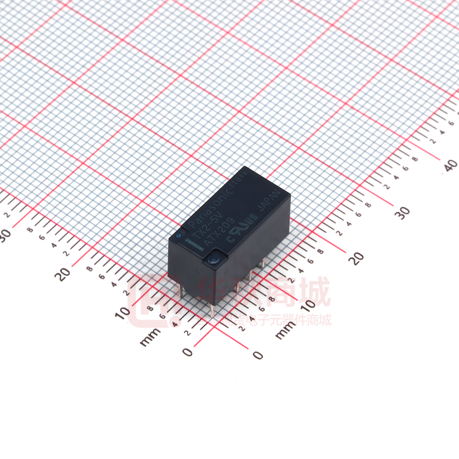

    信号继电器 DPDT 28.1mA 5V
TX2-5V 数据手册
TESTING 2 A CAPACITY RELAY WITH HIGH SURGE VOLTAGE & HIGH BREAKDOWN VOLTAGE 15 .591 7.4 .291 8.2 .323 15 .591 7.4 .291 8.4 .331 TX RELAYS FEATURES • Breakdown voltage between contacts and coil: 2,000 V • Surge withstand between contacts and coil: 2,500 V • High contact capacity: 2 A 30 V DC • Surface-mount type available mm inch SPECIFICATIONS Contact Arrangement Initial contact resistance, max. (By voltage drop 6 V DC 1 A) Contact material Nominal switching capacity (resistive load) Max. switching power (resistive load) Rating Max. switching voltage Max. switching current Min. switching capacity ❇1 Nominal operating power Single side stable 1 coil latching 2 coil latching Mechanical (at 180 cpm) 2 A 30 V DC resistive Electrical (at 20 cpm) 1 A 30 V DC resistive 2 Form C 100 mΩ Gold-clad silver alloy 2 A 30 V DC 60 W 220 V DC 2A 10 µA 10 mV DC 140 mW (1.5 to 24 V DC) 270 mW (48 V DC) 100 mW (1.5 to 24 V DC) 200 mW (1.5 to 24 V DC) 108 105 5×105 Characteristics Initial insulation resistance*1 Between open contacts Initial breakdown Between contact sets voltage Between contact and coil Between open contacts Initial surge (10×160 µs) voltage Between contacts and coil (2×10 µs) Temperature rise*2 (at 20°C) Min. 1,000 MΩ (at 500 V DC) 1,000 Vrms for 1 min. (Detection current: 10 mA) 1,000 Vrms for 1 min. (Detection current: 10 mA) 2,000 Vrms for 1 min. (Detection current: 10 mA) 1,500 V (FCC Part 68) 2,500 V (Telcordia) Max. 50°C Expected life (min. operations) Notes: ❇1 This value can change due to the switching frequency, environmental conditions, and desired reliability level, therefore it is recommended to check this with the actual load. (SX relays are available for low level load switching [10 µA 1 mV DC – 10 mA 10 V DC]) ❇2 The upper limit for the ambient temperature is the maximum temperature that can satisfy the coil temperature rise. Under the packing condition, allowable temperature range is from –40 to +70°C –40°C to +158°F. Remarks * Specifications will vary with foreign standards certification ratings. *1 Measurement at same location as "Initial breakdown voltage" section. *2 By resistive method, nominal voltage applied to the coil; contact carrying current: 2 A. *3 Nominal voltage applied to the coil, excluding contact bounce time. 4 Nominal voltage applied to the coil, excluding contact bounce time without diode. * *5 Half-wave pulse of sine wave: 6 ms; detection time: 10 µs. *6 Half-wave pulse of sine wave: 6 ms. *7 Detection time: 10 µs. *8 Refer to 6. Conditions for operation, transport and storage mentioned in AMBIENT ENVIRONMENT. Max. 4 ms (Approx. 2 ms) Operate time [Set time]*3 (at 20°C) [Max. 4 ms (Approx. 2 ms)] Max. 4 ms (Approx. 1 ms) Release time [Reset time]*4 (at 20°C) [Max. 4 ms (Approx. 2 ms)] Min. 750 m/s2 {75 G} Functional*5 Shock resistance Destructive*6 Min. 1,000 m/s2 {100 G} 196 m/s2 {20 G}, 10 to 55 Hz Functional*7 at double amplitude of 3.3 mm Vibration resistance 294 m/s2 {30G}, 10 to 55 Hz Destructive at double amplitude of 5 mm –40°C to +85°C (up to 24 V coil) Conditions for operation, transport and Ambient tem- –40°F to +185°F (up to 24 V coil) perature ❇2 –40°C to +70°C (48 V coil) storage*8 (Not freezing and –40°F to +158°F (48 V coil) condensing at low Humidity 5 to 85% R.H. temperature) Unit weight Approx. 2 g .071 oz All Rights Reserved © COPYRIGHT Matsushita Electric Works, Ltd. TX ORDERING INFORMATION Ex. TX Contact arrangement 2: 2 Form C Surface-mount availability Nil: Standard PC board terminal type or Nil: self-clinching terminal type SA: Standard surface-mount terminal type SL : High connection reliability surface-mount SL : terminal type SS: Space saving surface-mount terminal type 2 SA – L – H – 3V – Z Packing style Operating function Terminal shape Nil: Single side Nil: stable L: 1 coil latching L2: 2 coil latching Coil voltage (DC) Nil: Standard PC 1.5, 3, 4.5, 5, 6, Nil: Tube packing board terminal or 9, 12, 24, 48* V Z: Tape and reel surface-mount packing(picked terminal from the 8/9/10/12 H: Self-clinching -pin side terminal Notes: 1. Tape and reel (picked from 1/3/4/5-pin side) is also available by request. Part number suffix “-X” is *48 V coil type: Single side stable only needed when ordering. (ex.) TX2SA-3 V-X 2. Tape and reel packing symbol “-Z” or “-X” are not marked on the relay. TYPES AND COIL DATA (at 20°C 68°F) 1) Standard PC board terminal type and self-clinching terminal type 1. Single side stable Part No. Standard PC board terminal TX2-1.5 V TX2-3 V TX2-4.5 V TX2-5 V TX2-6 V TX2-9 V TX2-12 V TX2-24 V TX2-48 V Self-clinching terminal TX2-H-1.5 V TX2-H-3 V TX2-H-4.5 V TX2-H-5 V TX2-H-6 V TX2-H-9 V TX2-H-12 V TX2-H-24 V TX2-H-48 V Nominal voltage, V DC 1.5 3 4.5 5 6 9 12 24 48 Pick-up voltage, V DC (max.) 1.13 2.25 3.38 3.75 4.5 6.75 9 18 36 Drop-out voltage, V DC (min.) 0.15 0.3 0.45 0.5 0.6 0.9 1.2 2.4 4.8 Nominal operating current, mA (±10%) 93.8 46.7 31 28.1 23.3 15.5 11.7 5.8 5.6 Coil resistance, Ω (±10%) 16 64.3 145 178 257 579 1,028 4,114 8,533 Nominal operating power, mW 140 140 140 140 140 140 140 140 270 Max. allowable voltage, V DC 2.2 4.5 6.7 7.5 9 13.5 18 36 57.6 2. 1 Coil latching Part No. Standard PC board terminal TX2-L-1.5 V TX2-L-3 V TX2-L-4.5 V TX2-L-5 V TX2-L-6 V TX2-L-9 V TX2-L-12 V TX2-L-24 V Self-clinching terminal TX2-L-H-1.5 V TX2-L-H-3 V TX2-L-H-4.5 V TX2-L-H-5 V TX2-L-H-6 V TX2-L-H-9 V TX2-L-H-12 V TX2-L-H-24 V Nominal voltage, V DC 1.5 3 4.5 5 6 9 12 24 Set voltage, V DC (max.) 1.13 2.25 3.38 3.75 4.5 6.75 9 18 Reset voltage, V DC (max.) 1.13 2.25 3.38 3.75 4.5 6.75 9 18 Nominal operating current, mA (±10%) 66.7 33.3 22.2 20 16.7 11.1 8.3 4.2 Coil resistance, Ω (±10%) 22.5 90 202.5 250 360 810 1,440 5,760 Nominal operating power, mW 100 100 100 100 100 100 100 100 Max. allowable voltage, V DC 2.2 4.5 6.7 7.5 9 13.5 18 36 3. 2 Coil latching Part No. Standard PC board terminal TX2-L2-1.5 V TX2-L2-3 V TX2-L2-4.5 V TX2-L2-5 V TX2-L2-6 V TX2-L2-9 V TX2-L2-12 V TX2-L2-24 V Notes: Self-clinching terminal TX2-L2-H-1.5 V TX2-L2-H-3 V TX2-L2-H-4.5 V TX2-L2-H-5 V TX2-L2-H-6 V TX2-L2-H-9 V TX2-L2-H-12 V TX2-L2-H-24 V Nominal voltage, V DC 1.5 3 4.5 5 6 9 12 24 Set voltage, V DC (max.) 1.13 2.25 3.38 3.75 4.5 6.75 9 18 Reset voltage, V DC (max.) 1.13 2.25 3.38 3.75 4.5 6.75 9 18 Nominal operating current, mA (±10%) 133.9 66.7 44.5 40 33.3 22.2 16.7 8.3 Coil resistance, Ω (±10%) 11.2 45 101.2 125 180 405 720 2,880 Nominal operating power, mW 200 200 200 200 200 200 200 200 Max. allowable voltage, V DC 2.2 4.5 6.7 7.5 9 13.5 18 36 1. Specified value of pick-up, drop-out, set and reset voltage is with the condition of square wave coil pulse. 2. Standard packing: Tube: 40 pcs.; Case: 1,000 pcs. 3. In case of 5 V transistor drive circuit, it is recommended to use 4.5 V type relay. All Rights Reserved © COPYRIGHT Matsushita Electric Works, Ltd. TX 2) Surface-mount terminal type 1. Single side stable Part No. TX2S❍-1.5 V TX2S❍-3 V TX2S❍-4.5 V TX2S❍-5 V TX2S❍-6 V TX2S❍-9 V TX2S❍-12 V TX2S❍-24 V TX2S❍-48 V Nominal voltage, V DC 1.5 3 4.5 5 6 9 12 24 48 Pick-up voltage, V DC (max.) 1.13 2.25 3.38 3.75 4.5 6.75 9 18 36 Drop-out voltage, V DC (min.) 0.15 0.3 0.45 0.5 0.6 0.9 1.2 2.4 4.8 Nominal operating current, mA (±10%) 93.8 46.7 31 28.1 23.3 15.5 11.7 5.8 5.6 Coil resistance, Ω (±10%) 16 64.3 145 178 257 579 1,028 4,114 8,533 Nominal operating power, mW 140 140 140 140 140 140 140 140 270 Max. allowable voltage, V DC 2.2 4.5 6.7 7.5 9 13.5 18 36 57.6 2. 1 coil latching Part No. TX2S❍-L-1.5 V TX2S❍-L-3 V TX2S❍-L-4.5 V TX2S❍-L-5 V TX2S❍-L-6 V TX2S❍-L-9 V TX2S❍-L-12 V TX2S❍-L-24 V Nominal voltage, V DC 1.5 3 4.5 5 6 9 12 24 Set voltage, V DC (max.) 1.13 2.25 3.38 3.75 4.5 6.75 9 18 Reset voltage, V DC (max.) 1.13 2.25 3.38 3.75 4.5 6.75 9 18 Nominal operating current, mA (±10%) 66.7 33.3 22.2 20 16.7 11.1 8.3 4.2 Coil resistance, Ω (±10%) 22.5 90 202.5 250 360 810 1,440 5,760 Nominal operating power, mW 100 100 100 100 100 100 100 100 Max. allowable voltage, V DC 2.2 4.5 6.7 7.5 9 13.5 18 36 3. 2 coil latching Part No. TX2S❍-L2-1.5 V TX2S❍-L2-3 V TX2S❍-L2-4.5 V TX2S❍-L2-5 V TX2S❍-L2-6 V TX2S❍-L2-9 V TX2S❍-L2-12 V TX2S❍-L2-24 V Nominal voltage, V DC 1.5 3 4.5 5 6 9 12 24 Set voltage, V DC (max.) 1.13 2.25 3.38 3.75 4.5 6.75 9 18 Reset voltage, V DC (max.) 1.13 2.25 3.38 3.75 4.5 6.75 9 18 Nominal operating current, mA (±10%) 133.9 66.7 44.5 40 33.3 22.2 16.7 8.3 Coil resistance, Ω (±10%) 11.2 45 101.2 125 180 405 720 2,880 Nominal operating power, mW 200 200 200 200 200 200 200 200 Max. allowable voltage, V DC 2.2 4.5 6.7 7.5 9 13.5 18 36 ❍: For each surface-mounted terminal variation, input the following letter. SA type: A , SL type: L , SS type: S Notes: 1. Specified value of pick-up, drop-out, set and reset voltage is with the condition of square wave coil pulse. 2. Standard packing: Tube: 40 pcs.; Case: 1,000 pcs. 3. Tape and reel packing is also available for surface-mount type by request. Part number suffix "-X" or "-Z" is needed when ordering. In this case, "X" or "Z" are not marked on the relay. Quantity in tape and reel: 500 pcs. • TX2SA-L-3V-Z (ex.) • TX2SA-3V-X Picked from the 1/3/4/5-pin side Picked from the 8/9/10/12-pin side 4. In case of 5 V transistor drive circuit, it is recommended to use 4.5 V type relay. All Rights Reserved © COPYRIGHT Matsushita Electric Works, Ltd. TX DIMENSIONS 1. Single side stable and 1 coil latching type 15 Standard PC board terminal .591 0.65 8.2 .026 .323 3.5 .138 5.08 .200 15 .591 0.65 8.2 .026 .323 3.5 .138 5.08 .200 2.54 .100 5.08 .200 0.25 .010 2.54 .100 5.08 .200 0.25 .010 8-1.0 dia 8-.039 dia 7.4 .291 2.54 .100 7.4 .291 mm inch PC board pattern (Copper-side view) 10.16 .400 Schematic (Bottom view) Single side stable 1 coil latching (Deenergized condition) (Reset condition) + 5.08 .200 1 345 – + 1 345 0.5 .020 1.15 .045 – 12 10 9 8 12 10 9 8 Self clinching terminal Direction indication* Direction indication* Tolerance: ±0.1 ±.004 *Orientation stripe located on top of relay. 0.5 .020 1.15 .045 Surface-mount terminal SA type General tolerance: ±0.3 ±.012 Suggested mounting pad (Top view) 1 5.08 .039 .200 2.54 .100 1.6 .0.63 7.24 .285 Schematic (Top view) Single side stable 1 coil latching (Deenergized condition) (Reset condition) 15 .591 8.2 .323 0.5 .020 5.08 .200 0.65 2.54 .026 .100 8.4 .331 7.4 .291 3.16 .124 – + 12 10 9 8 + – 12 10 9 8 1 5.08 .200 0.25 9.4±0.5 .010 .370±.020 7.4 .291 8.2 .323 0.5 .020 5.08 .200 0.65 2.54 .026 .100 Max. 10.0 .390 5.08 0.25 .200 9.4±0.5 .010 .370±.020 7.4 .291 8.2 .323 0.5 .020 5.08 .200 0.65 2.54 .026 .100 Max. 10.0 .390 5.08 .200 7.4±0.5 .291±.020 0.25 .010 2.16 .085 1 5.08 .039 .200 2.54 .100 3.16 .124 7.24 .285 0.3 .012 15 .591 2.54 .100 For glue-pad 345 1 345 Direction indication Direction indication SL type 15 .591 1 5.08 .039 .200 SS type 15 .591 6.24 .246 General tolerance: ±0.3 ±.012 Tolerance: ±0.1 ±.004 PC board pattern (Copper side view) 2.54 .100 12.7 .500 2. Coil latching type Standard PC board terminal 15 .591 0.65 8.2 .026 .323 3.5 .138 5.08 .200 15 .591 0.65 8.2 .026 .323 3.5 .138 5.08 .200 2.54 .100 2.54 .100 7.4 .291 Schematic (Bottom view) 2 coil latching (Reset condition) 1 3456 + 5.08 .200 10-1.0 dia 10-.039 dia – – 10 9 8 7 0.5 .020 1.15 .045 5.08 .200 7.4 .291 0.25 .010 + 12 Direction indication* Self clinching terminal Tolerance: ±0.1 ±.004 0.5 .020 1.15 .045 5.08 .200 0.25 .010 General tolerance: ±0.3 ±.012 Surface-mount terminal SA type Suggested mounting pad (Top view) 15 .591 8.2 .323 0.5 .020 5.08 .200 0.65 2.54 .026 .100 8.4 .331 5.08 .200 0.25 9.4±0.5 .010 .370±.020 7.4 .291 8.2 .323 0.5 .020 5.08 .200 0.65 2.54 .026 .100 Max. 10.0 .390 5.08 0.25 .200 9.4±0.5 .010 .370±.020 7.4 .291 8.2 .323 0.5 .020 5.08 .200 0.65 2.54 .026 .100 Max. 10.0 .390 5.08 .200 7.4±0.5 .291±.020 0.25 .010 2.16 .085 6.24 .285 1 5.08 .039 .200 2.54 .100 7.4 .291 3.16 .124 1 5.08 .039 .200 2.54 .100 1.6 .0.63 7.24 .285 0.3 .012 1 5.08 .039 .200 3.16 .124 7.24 .285 Schematic (Top view) 2 coil latching (Reset condition) 12 10 9 8 7 + + 1 3 45 – – 6 SL type 15 .591 15 .591 2.54 .100 For glue-pad Direction indication SS type 15 .591 General tolerance: ±0.3 ±.012 Tolerance: ±0.1 ±.004 All Rights Reserved © COPYRIGHT Matsushita Electric Works, Ltd. TX REFERENCE DATA 1. Maximum switching capacity 2. Life curve 3. Mechanical life Tested sample: TX2-5V, 10 pcs. Operating frequency: 180 cpm 3.0 Switching current, A 2.0 DC resistive load 100 No. of operations ×104 50 30 20 10 30V DC resistive load Ratio against the rated voltage, %V 100 90 80 70 60 50 40 30 20 10 0 20 30 50 100 200 300 Contact voltage, V 0 1.0 2.0 Switching current, A 0 10 100 1,000 No. of operations, ×104 Drop-out voltage Max. Min. 10,000 Pick-up voltage Max. Min. 1.0 0.5 0.4 0.3 0.2 4. Electrical life Tested sample: TX2-5V, 6 pcs. Operating frequency: 20 cpm 5-(1). Coil temperature rise Tested sample: TX2-5V, 6 pcs. Point measured: Inside the coil Ambient temperature: 25°C 77°F, 85°C 185°F Change of pick-up and drop-out voltage Ratio against the rated voltage, %V 100 90 80 70 60 50 40 30 20 10 0 1 2 3 456789 No. of operations, ×104 Min. 10 Drop-out voltage Max. Pick-up voltage Max. Min. Change of contact resistance 100 Contact resistance, mΩ 90 80 70 60 50 40 30 20 10 0 1 2 3 456789 4 No. of operations, ×10 10 10 0 100 110 120 130 140 150 No. of operate, ×104 Max. Min. Temperature rise, °C 70 60 50 40 30 20 2A 2A 0A 0A +25°C +77°F +85°C +185°F 5-(2). Coil temperature rise Tested sample: TX2-48V, 6 pcs. Point measured: Inside the coil Ambient temperature: 25°C 77°F, 70°C 158°F 70 Temperature rise, °C 60 50 40 30 20 10 0 100 110 120 130 140 150 No. of operations, ×104 +25°C +77°F +70°C +158°F 6-(1). Operate and release time (with diode) Tested sample: TX2-5V, 10 pcs. 6-(2). Operate and release time (without diode) 5 Operate and release time, ms Operate and release time, ms Operate time Release time 4 Max. Min. 5 Operate time Release time Max. Min. 4 2A 2A 0A 0A 3 3 2 Max. Min. 2 Max. Min. 1 0 1 0 70 80 90 100 110 120 Coil applied voltage, %V 70 80 90 100 110 120 Coil applied voltage, %V 7. Distribution of pick-up and drop-out voltage Tested sample: TX2-5V, 50 pcs. 8. Distribution of set and reset voltage Tested sample: TX2-L2-12V, 30 pcs. Set voltage Reset voltage 9. Ambient temperature characteristics Tested sample: TX2-5V, 5 pcs. Rate of change, % 40 Drop-out voltage x x Pick-up voltage 20 40 60 80 Ambient temperature, °C –20 30 ;;;;;;;; ;; ; ; ; ; ;;;;; Pick-up voltage 15 Quantity Quantity Drop-out voltage 20 20 ;;;;;;; ;;;;;; 10 0 0 10 –40 –20 5 0 –40 0 0 10 20 30 40 50 60 70 80 90 100 Ratio against the rated voltage, %V 10 20 30 40 50 60 70 80 90 100 Ratio against the rated voltage, %V All Rights Reserved © COPYRIGHT Matsushita Electric Works, Ltd. TX 10. Distribution of contact resistance Tested sample: TX2-5V, 30 pcs. (30 × 4 contacts) 1 345 11-(1). High frequency characteristics Tested sample: TX2-12V, 2 pcs. Isolation characteristics 11-(2). High frequency characteristics Tested sample: TX2-12V, 2 pcs. Insertion loss characteristics 35 Terminal Nos. 4-5, 8-9 30 Quantity 25 20 ;; ;;;;;;;; ;; ; ;;;; 15 10 5 0 12-(1). Malfunctional shock (single side stable) Tested sample: TX2-5V, 6 pcs Z' Y Y' Z XX' Y 1000m/s 2 Deenergized condition Energized condition 13-(1). Influence of adjacent mounting Rate of change, % Rate of change, % 5 Pick-up voltage 0 –5 ON ON 5 Pick-up voltage 0 –5 ON Rate of change, % Rate of change, % Rate of change, % 5 0 –5 0 2 46 8 10 .079 .157 .236 .315 .394 Inter-relay distance Drop-out voltage OFF OFF 5 Drop-out voltage 0 OFF Rate of change, % 14. Pulse dialing test Tested sample: TX2-5V, 6 pcs. (35 mA 48 V DC wire spring relay load) Ratio against the rated voltage, %V Circuit Contact resistance, mΩ ;;;; ;;; ; ;;;;;;;;; ;; 0 20 X 1000m/s2 1000m/s 2 Z' 1000m/s 2 Y' 458 Ω 0.08 µF 458 Ω (BOTTOM VIEW) Isolation, dB 100 Terminal Nos. 3-4, 9-10 Insertion loss, dB 10 100 Frequency, MHz 1,000 12 10 9 8 1.0 0.8 0.6 0.4 0.2 10 100 Frequency, MHz 1,000 50 30 40 50 Contact resistance, mΩ 12-(2). Malfunctional shock (latching) Tested sample: TX2-L2-12V, 6 pcs. Z' Y Y' Z XX' Y 1000m/s 2 Reset state Set state Z 1000m/s2 X 1000m/s2 Z 1000m/s2 1000m/s2 X' 1000m/s 2 Z' 1000m/s 2 Y' 1000m/s2 X' 13-(2). Influence of adjacent mounting 13-(3). Influence of adjacent mounting 5 Pick-up voltage 0 –5 ON ON ON ON ON ON ON 5 0 –5 0 OFF Drop-out voltage OFF OFF OFF 2 46 8 10 .079 .157 .236 .315 .394 Inter-relay distance , mm inch OFF –5 OFF 0 2 46 8 10 .079 .157 .236 .315 .394 Inter-relay distance OFF , mm inch , mm inch Change of pick-up and drop-out voltage 100 90 80 70 60 50 40 30 20 10 0 10 20 30 40 4 No. of operation, ×10 50 Drop-out voltage Max. Min. Pick-up voltage Max. Min. Change of contact resistance 100 90 80 70 60 50 40 30 20 10 0 10 20 30 40 No. of operations, ×104 50 Min. Max. 0.08 µF 48V DC + 4 3 – Wire spring relay Note: Data of surface-mount type are the same as those of PC board terminal type. All Rights Reserved © COPYRIGHT Matsushita Electric Works, Ltd. TX Notes 1. Packing style 1) The relay is packed in a tube with the relay orientation mark on the left side, as shown in the figure below. Orientation (indicates PIN No.1)stripe +0.1 0 Relay polarity bar 1.5 +.004dia. .059 0 dia. 2.0 (Z type) .079 2) Tape and reel packing (surface-mount terminal type) (1) Tape dimensions (i) SA type mm inch 1.75 .069 B (2) Dimensions of plastic reel mm inch 21 ±0.6 dia. .827 ±.024 dia. 2.0 ±0.5 .079 ±.020 4.0 .157 C A 0.4 .016 15.5 .610 13 dia. .512 ±.020 dia. 24.4+2 0 .961+.079 0 ±0.5 11.5 .453 100 ±1 dia. 3.937 ±.039 dia. 370 ±2 dia. 14.567 ±.079 dia. Stopper (gray) Stopper (green) TX/TX-D/TX-S -SMD relays D 16.0 10.0 .394 .630 24.0 ±0.3 ±0.2 .945 ±.012 9.2±.008 .362 Tape coming out direction (ii) SL type mm inch +0.1 0 Relay polarity bar 1.5 +.004dia. .059 0 dia. 2.0 (Z type) .079 2.0±0.2 .079±.008 4.0 .157 1.75 .069 11.5 .453 15.5 .610 0.4 .016 TX/TX-D/TX-S -SMD relays 10.0 .394 Tape coming out direction 16.0 .630 24.0 ±0.3 .945 ±.012 10.8±0.2 .425±.008 (iii) SS type mm inch +0.1 0 Relay polarity bar 1.5 +.004dia. 2.0 .059 0 dia. (Z type) .079 2.2 dia. .087 dia. 4.0 1.75 .157 .069 11.5 .453 15.5 .610 0.4 .016 TX/TX-D/TX-S -SMD relays 16.0 .630 Tape coming out direction 8.0 24.0 ±0.3 ±.012 .315 .945 10.8±0.2 .425±.008 For Cautions for Use, see Relay Technical Information. All Rights Reserved © COPYRIGHT Matsushita Electric Works, Ltd.
