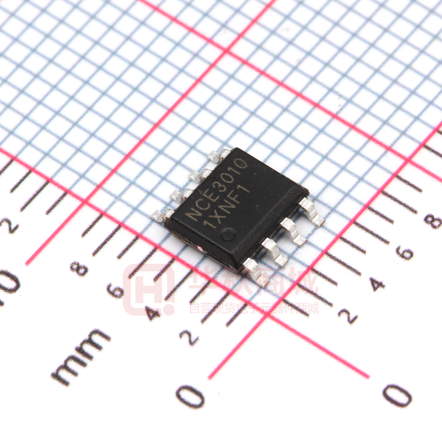

    MOS管 N-Channel VDS=30V VGS=±20V ID=10A SO8_150MIL
NCE3010S 数据手册
Pb Free Product http://www.ncepower.com NCE3010S NCE N-Channel Enhancement Mode Power MOSFET DESCRIPTION The NCE3010S uses advanced trench technology and design to provide excellent RDS(ON) with low gate charge. It can be used in a wide variety of applications. GENERAL FEATURES ● VDS =30V,ID =10A RDS(ON) < 13.5mΩ @ VGS=10V RDS(ON) < 20mΩ @ VGS=4.5V ● High density cell design for ultra low Rdson ● Fully characterized Avalanche voltage and current Schematic diagram Application ● ● ● Power switching application Hard Switched and High Frequency Circuits Uninterruptible Power Supply Marking and pin Assignment 100% UIS TESTED! SOP-8 top view Package Marking And Ordering Information Device Marking 3010S Device NCE3010S Device Package SOP-8 Reel Size Ø330mm Tape width 12mm Quantity 2500 units Absolute Maximum Ratings (TA=25℃unless otherwise noted) Parameter Symbol Drain-Source Voltage VDS Gate-Source Voltage VGS Drain Current-Continuous Drain Current-Continuous(TC=100℃) Pulsed Drain Current Maximum Power Dissipation Operating Junction and Storage Temperature Range Limit 30 ±20 10 6 50 2.5 -55 To 150 Unit V V A A A W ℃ ID ID (100℃) IDM PD TJ,TSTG Thermal Characteristic Thermal Resistance,Junction-to-Case(Note 2) RθJC 50 ℃/W Electrical Characteristics (TA=25℃unless otherwise noted) Wuxi NCE Power Semiconductor Co., Ltd Page 1 v1.0 Pb Free Product http://www.ncepower.com Parameter Off Characteristics Drain-Source Breakdown Voltage Zero Gate Voltage Drain Current Gate-Body Leakage Current On Characteristics (Note 3) Gate Threshold Voltage Drain-Source On-State Resistance Forward Transconductance Dynamic Characteristics (Note4) Input Capacitance Output Capacitance Reverse Transfer Capacitance Switching Characteristics (Note 4) Turn-on Delay Time Turn-on Rise Time Turn-Off Delay Time Turn-Off Fall Time Total Gate Charge Gate-Source Charge Gate-Drain Charge Drain-Source Diode Characteristics Diode Forward Voltage (Note 3) Diode Forward Current (Note 2) VSD IS VGS=0V,IS=10A td(on) tr td(off) tf Qg Qgs Qgd VDS=15V,ID=10A, VGS=5V VDD=25V,ID=1A VGS=10V,RGEN=6Ω Clss Coss Crss VDS=15V,VGS=0V, F=1.0MHz VGS(th) RDS(ON) gFS VDS=VGS,ID=250μA VGS=10V, ID=10A VGS=4.5V, ID=5A VDS=15V,ID=10A 15 1 BVDSS IDSS IGSS VGS=0V ID=250μA VDS=30V,VGS=0V VGS=±20V,VDS=0V 30 NCE3010S Condition Min Typ Max Unit V 1 ±100 3 11 16.5 13.5 20 μA nA V mΩ S 1550 300 180 30 20 100 80 13 5.5 3.5 1.2 10 PF PF PF nS nS nS nS nC nC nC V A Symbol Notes: 1. Repetitive Rating: Pulse width limited by maximum junction temperature. 2. Surface Mounted on FR4 Board, t ≤ 10 sec. 3. Pulse Test: Pulse Width ≤ 300μs, Duty Cycle ≤ 2%. 4. Guaranteed by design, not subject to production Wuxi NCE Power Semiconductor Co., Ltd Page 2 v1.0 Pb Free Product http://www.ncepower.com NCE3010S Test circuit 1)EAS test Circuits 2)Gate charge test Circuit: 3)Switch Time Test Circuit: Wuxi NCE Power Semiconductor Co., Ltd Page 3 v1.0 Pb Free Product http://www.ncepower.com TYPICAL ELECTRICAL AND THERMAL CHARACTERISTICS (Curves) NCE3010S Normalized On-Resistance ID- Drain Current (A) Vds Drain-Source Voltage (V) TJ-Junction Temperature(℃) Figure 1 Output Characteristics Figure 4 Rdson-JunctionTemperature Vgs Gate-Source Voltage (V) ID- Drain Current (A) Vgs Gate-Source Voltage (V) Qg Gate Charge (nC) Figure 2 Transfer Characteristics Rdson On-Resistance Normalized Is- Reverse Drain Current (A) Figure 5 Gate Charge ID- Drain Current (A) Vsd Source-Drain Voltage (V) Figure 3 Rdson- Drain Current Figure 6 Source- Drain Diode Forward Wuxi NCE Power Semiconductor Co., Ltd Page 4 v1.0 Pb Free Product http://www.ncepower.com NCE3010S C Capacitance (pF) Normalized BVdss Vds Drain-Source Voltage (V) TJ-Junction Temperature(℃) Figure 7 Capacitance vs Vds Figure 9 BVDSS vs Junction Temperature ID- Drain Current (A) Vth (V) Variance Vds Drain-Source Voltage (V) TJ-Junction Temperature(℃) Figure 8 Safe Operation Area Figure 10 VGS(th) vs Junction Temperatur r(t),Normalized Effective Transient Thermal Impedance Square Wave Pluse Duration(sec) Figure 11 Normalized Maximum Transient Thermal Impedance Wuxi NCE Power Semiconductor Co., Ltd Page 5 v1.0 Pb Free Product http://www.ncepower.com NCE3010S SOP-8 PACKAGE IN FORMATION Wuxi NCE Power Semiconductor Co., Ltd Page 6 v1.0 Pb Free Product http://www.ncepower.com ATTENTION: ■ NCE3010S ■ ■ ■ ■ ■ ■ ■ ■ Any and all NCE power products described or contained herein do not have specifications that can handle applications that require extremely high levels of reliability, such as life-support systems, aircraft's control systems, or other applications whose failure can be reasonably expected to result in serious physical and/or material damage. Consult with your NCE power representative nearest you before using any NCE power products described or contained herein in such applications. NCE power assumes no responsibility for equipment failures that result from using products at values that exceed, even momentarily, rated values (such as maximum ratings, operating condition ranges, or other parameters) listed in products specifications of any and all NCE power products described or contained herein. Specifications of any and all NCE power products described or contained herein stipulate the performance, characteristics, and functions of the described products in the independent state, and are not guarantees of the performance, characteristics, and functions of the described products as mounted in the customer’s products or equipment. To verify symptoms and states that cannot be evaluated in an independent device, the customer should always evaluate and test devices mounted in the customer’s products or equipment. NCE power Semiconductor CO.,LTD. strives to supply high-quality high-reliability products. However, any and all semiconductor products fail with some probability. It is possible that these probabilistic failures could give rise to accidents or events that could endanger human lives, that could give rise to smoke or fire, or that could cause damage to other property. When designing equipment, adopt safety measures so that these kinds of accidents or events cannot occur. Such measures include but are not limited to protective circuits and error prevention circuits for safe design, redundant design, and structural design. In the event that any or all NCE power products(including technical data, services) described or contained herein are controlled under any of applicable local export control laws and regulations, such products must not be exported without obtaining the export license from the authorities concerned in accordance with the above law. No part of this publication may be reproduced or transmitted in any form or by any means, electronic or mechanical, including photocopying and recording, or any information storage or retrieval system, or otherwise, without the prior written permission of NCE power Semiconductor CO.,LTD. Information (including circuit diagrams and circuit parameters) herein is for example only ; it is not guaranteed for volume production. NCE power believes information herein is accurate and reliable, but no guarantees are made or implied regarding its use or any infringements of intellectual property rights or other rights of third parties. Any and all information described or contained herein are subject to change without notice due to product/technology improvement, etc. When designing equipment, refer to the "Delivery Specification" for the NCE power product that you intend to use. This catalog provides information as of Sep.2010. Specifications and information herein are subject to change without notice. Wuxi NCE Power Semiconductor Co., Ltd Page 7 v1.0
