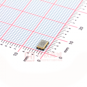

CRYSTAL CLOCK OSCILLATORS Positive ECL (PECL) Data Sheet 0012B Rev. H SJ-870 Series Description The SJ-870 Series of quartz crystal oscillators provide MECL 10K and 10KH series compatible signals in a ceramic SMD package. Systems designers may now specify space-saving, cost-effective packaged PECL oscillators to meet their timing requirements. Features • Wide frequency range–15.0MHz to 250.0MHz • User specified tolerance available • Will withstand vapor phase temperatures of 253°C for 4 minutes maximum • Space-saving alternative to discrete component oscillators • High shock resistance, to 3000g • Metal lid electrically connected to ground to reduce EMI • Low Jitter Electrical Connection Pin 1 2 3 4 Connection N.C. VEE /Ground Output VCC • MECL 10K and 10KH series compatible output on Pin 3 • High Q Crystal actively tuned oscillator circuit • Power supply decoupling internal • No internal PLL avoids cascading PLL problems • High frequencies due to proprietary design • Gold plated leads - Solder dipped leads available upon request • RoHS Compliant, Lead Free Construction (unless solder dipped leads are supplied) 357 Beloit Street, P.O. Box 457, Burlington, WI 53105-0457 U.S.A. Phone 262/763-3591 FAX 262/763-2881 Email: nelsales@nelfc.com www.nelfc.com CRYSTAL CLOCK OSCILLATORS SJ-870 Series Continued Positive ECL (PECL) Operating Conditions and Output Characteristics Electrical Characteristics Parameter Frequency Duty Cycle Logic 0 (2) Logic 1(2) Rise & Fall Time Jitter, RMS(3) Frequency Stability (1) Symbol Conditions Min --------15.0MHz ----@ VCC-1.29V 45/55% VOL ----VCC-1.95V VOH ----VCC-1.02V tr,tf 20-80%VO with 50 ohm load to VCC-2V ----------------dF/F Overall conditions including: -100ppm voltage, calibration, temp., 10 yr aging, shock, vibration Data Sheet 0012B Rev. H Typical ----------------1.0 ns --------- Max 250.0MHz 55/45% VCC-1.60V VCC-0.74V 1.5 ns 5 psec +100ppm General Characteristics Parameter Supply Voltage Supply Current Output current Operating temperature Storage temperature Power Dissipation Lead temperature Load Start-up time Conditions Min ----4.75V 50 ohm termination 0.0 mA To 2.00V below VCC IO Low level Output Current 0.0 mA -----0°C TA TS -----55°C --------PD TL Soldering, 10 sec. ----50 Ohm to VCC-2V or Thevenin Equivalent, Bias Required --------tS Symbol VCC ICC Typical 5.0V ------------------------2 ms Max 5.25V 80 mA ±50.0 mA 70°C 125°C 420 mW 300°C 10 ms Environmental and Mechanical Characteristics Mechanical Shock Thermal Shock Vibration Soldering Condition Hermetic Seal ESD Sensitivity Per MIL-STD-202, Method 213, Condition E Per MIL-STD-833, Method 1011, Condition A 0.060" double amplitude 10 Hz to 55 Hz, 35g’s 55Hz to 2000 Hz 300°C for 10 seconds Leak rate less than 1 x 10 -8 atm.cc/sec of helium Human Body Model per ON Semiconductor 10kH series ECL: 500V min. Footnotes: 1) Standard frequency stability (±20,±25,±50ppm & others available) 2) VOL, VOH, referenced to ground (VEE) with VCC = 5V 3) Jitter performance is frequency dependent. Please contact factory for full characterization. RMS jitter bandwidth of 12kHz to 20MHz. Creating a Part Number SJ - A87X - FREQ Package Code SJ 4 J Lead SMD Tolerance/Performance 0 ±100ppm 0-70°C 1 ±50ppm 0-70°C 7 ±25ppm 0-70°C 9 Customer Specific A ±20ppm 0-70°C B ±50ppm -40 to +85°C C ±100ppm -40 to +85°C Input Voltage Code Specification A 3.3V 5V 357 Beloit Street, P.O. Box 457, Burlington, WI 53105-0457 U.S.A. Phone 262/763-3591 FAX 262/763-2881 Email: nelsales@nelfc.com www.nelfc.com
