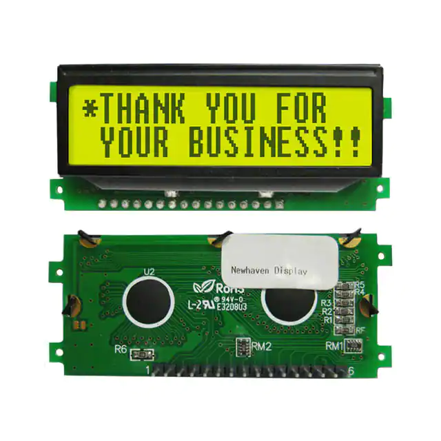

      NHD‐0216T2Z‐FSY‐YBW‐P  Character Liquid Crystal Display Module    NHD‐  0216‐  T2Z‐  F‐  SY‐  Y‐  B‐  W‐  P‐                                                  Newhaven Display  2 lines x 16 characters  Model  Transflective    Side Yellow/Green LED Backlight  STN‐ Yellow/Green  6:00 view  Wide Temperature (‐20°C~+70°C)  Pin header  RoHS Compliant                                          Newhaven Display International, Inc.  2511 Technology Drive, Suite 101  Elgin IL, 60124  Ph: 847‐844‐8795  Fax: 847‐844‐8796  www.newhavendisplay.com  nhtech@newhavendisplay.com   nhsales@newhavendisplay.com              [1]            Document Revision History  Revision  0            Date  1/14/2011  Description  Initial Release  Functions and Features  • • • • •   2 lines x 16 characters  Built‐in controller (ST7066U‐0A)  +5.0V Power Supply  1/16 duty, 1/5 bias  RoHS compliant                                                    [2]    Changed by  MC  Mechanical Drawing 1 2 3 4 REV 1.0 5 6 DATE DESCRIPTION: First 2009-8-7 1.1 Add PIN header 2009-9-15 1.2 Length changes for PIN header 2010-4-20 A A LED+ LED- 16 R A K 1 B B PIN SIGNAL VSS 1 VDD 2 V0 3 4 RS 5 R/W 6 E 7 DB0 8 DB1 9 DB2 10 DB3 11 DB4 12 DB5 13 DB6 14 DB7 LED+ 15 LED16 C D Feature: 1. Display mode: STN(Yellow-green)/ Positive/ Transflective 2. Driving: Duty:1/16, 1/5 Bias, VLCD: 5.0V 3. Viewing Direction: 6 O'clock 4. Backlight: LED sidelight(Color: Yellow-green) 5. Driver : ST7066-0A VDD: 5.0 V 6. Operating temp. : -20°C ~ 70°C Storage temp. : -25°C ~ 75°C 7. ROHS Compliant 1 2 Model Name: NHD-0216T2Z-FSY-YBW-P GENERAL TOL: APPROVALS DWN: DATE CHK: 3 4 (3) APP: 5 Newhaven Display DRAWN NO. SCALE: SIZE: UNIT: A4 mm 6 Page: C D Pin Description and Wiring Diagram  Pin No.  Symbol  1  2  3  4  5  6  7‐10  VSS  VDD  V0  RS  R/W  E  DB0 – DB3  External  Connection  Power Supply   Power Supply  Adj Power Supply  MPU  MPU  MPU  MPU  11‐14  15  16  DB4 – DB7  LED+  LED‐  MPU  Power Supply  Power Supply  Function Description Ground Supply Voltage for logic (+5.0V) Power supply for contrast (approx. 0.5V) Register select signal. RS=0: Command, RS=1: Data  Read/Write select signal, R/W=1: Read R/W: =0: Write   Operation enable signal. Falling edge triggered.  Four low order bi‐directional three‐state data bus lines.  These four  are not used during 4‐bit operation.  Four high order bi‐directional three‐state data bus lines.   Power supply for LED Backlight (+5.0V via on‐board resistor)  Ground for Backlight   LCD connector: 2.54mm pitch pins  Backlight connector:  ‐‐‐                      [4]        Electrical Characteristics    Item  Operating Temperature Range  Storage Temperature Range  Supply Voltage  Supply Current  Supply for LCD (contrast)  “H” Level input  “L” Level input  “H” Level output  “L” Level output  Backlight Supply Voltage  Backlight Supply Current   Symbol  Top  Tst  VDD  IDD  VDD‐V0  Vih  Vil  Voh  Vol  Vled  Iled  Condition Absolute Max Absolute Max Ta=25°C, VDD=5.0V Ta=25°C  Min. ‐20 ‐30 4.7 ‐ ‐ 0.7* VDD ‐0.3 3.9 ‐ Typ. ‐ ‐ 5.0 1.5 4.5 ‐ ‐ ‐ ‐ Max.  +70  +80  5.5  2.0  ‐  VDD  0.6  VDD  0.4  Unit ⁰C ⁰C V mA V V V V V ‐ Vled=5.0V ‐ ‐ 5.0 15 ‐  ‐  V mA   Optical Characteristics  Item  Viewing Angle – Vertical (top)  Viewing Angle – Vertical (bottom)  Viewing Angle – Horizontal (left)  Viewing Angle – Horizontal (right)  Contrast Ratio  Response Time (rise)  Response Time (fall)  Symbol  AV  AV  AH  AH  Cr  Tr  Tf  Condition Cr ≥ 2 Cr ≥ 2 Cr ≥ 2 Cr ≥ 2 ‐ ‐ Min. ‐ ‐ ‐ ‐ ‐ ‐ ‐ Typ. 25 70 30 30 2 120 120 Max.  ‐  ‐  ‐  ‐  ‐  150  150  Unit ⁰  ⁰  ⁰  ⁰  ‐  ms ms           Controller Information  Built‐in ST7066U.  Download specification at http://www.newhavendisplay.com/app_notes/ST7066U.pdf                                     [5]      Built‐in Font Table              [6]      Example Initialization Program  8-bit Initialization: /**********************************************************/ void command(char i) { P1 = i; //put data on output Port D_I =0; //D/I=LOW : send instruction R_W =0; //R/W=LOW : Write E = 1; Delay(1); //enable pulse width >= 300ns E = 0; //Clock enable: falling edge } /**********************************************************/ void write(char i) { P1 = i; //put data on output Port D_I =1; //D/I=LOW : send data R_W =0; //R/W=LOW : Write E = 1; Delay(1); //enable pulse width >= 300ns E = 0; //Clock enable: falling edge } /**********************************************************/ void init() { E = 0; Delay(100); //Wait >15 msec after power is applied command(0x30); //command 0x30 = Wake up Delay(30); //must wait 5ms, busy flag not available command(0x30); //command 0x30 = Wake up #2 Delay(10); //must wait 160us, busy flag not available command(0x30); //command 0x30 = Wake up #3 Delay(10); //must wait 160us, busy flag not available command(0x38); //Function set: 8-bit/2-line command(0x10); //Set cursor command(0x0c); //Display ON; Cursor ON command(0x06); //Entry mode set } /**********************************************************/ [7]    4-bit Initialization: /**********************************************************/ void command(char i) { P1 = i; //put data on output Port D_I =0; //D/I=LOW : send instruction R_W =0; //R/W=LOW : Write Nybble(); //Send lower 4 bits i = i  50⁰C,30min = 1 cycle  10 cycles  10‐55Hz , 15mm amplitude.  60 sec in each of 3 directions  X,Y,Z  For 15 minutes  VS=800V, RS=1.5kΩ, CS=100pF   One time    Note 1: No condensation to be observed.  Note 2: Conducted after 4 hours of storage at 25⁰C, 0%RH.  Note 3: Test performed on product itself, not inside a container.      Precautions for using LCDs/LCMs  See Precautions at www.newhavendisplay.com/specs/precautions.pdf    Warranty Information and Terms & Conditions  http://www.newhavendisplay.com/index.php?main_page=terms      [9]    Note +80⁰C , 48hrs 3
