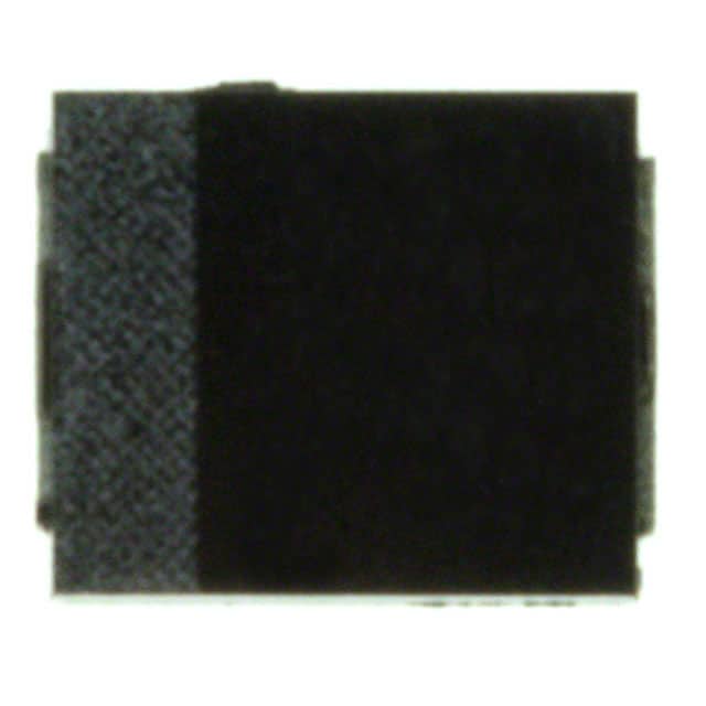

F320G107MBA
F320G107MBA
    NICHICON(尼吉康)
    B3528-21
    钽电容 100μF ±20% 4V
F320G107MBA 数据手册
CONDUCTIVE POLYMER TANTALUM SOLID ELECTROLYTIC CAPACITORS F32 Conductive Polymer Resin-molded Chip Adapted to the RoHS directive (2002/95/EC). Specifications Item Category Temperature Range Capacitance Tolerance Dissipation Factor(at 120Hz) ESR (100kHz) Leakage Current Ripple Current Damp Heat (Steady State) Type numbering system (Example : 6.3V 100µF) 1 2 4 3 F 3 2 5 6 7 8 9 10 1 0 7 M B A 0 J Temperature Cycles 11 Taping code (Refer to page 302 for details) Resistance to Soldering Heat Case code Capacitance tolerance Rated Capacitance Surge Rated voltage Series Dimensions A • B Case Endurance 1 C • N Case L L W1 W1 H W2 S Endurance 2 H W2 S S S (mm) Case code L W1 W2 H S A 3.2±0.2 1.6±0.2 1.2±0.1 1.6±0.2 0.8±0.2 3.5±0.2 2.8±0.2 2.2±0.1 1.9±0.2 0.8±0.2 6.0±0.2 3.2±0.2 2.2±0.1 2.5±0.2 1.3±0.2 N 7.3±0.2 4.3±0.2 2.4±0.1 2.8±0.2 1.3±0.2 Terminal Strength 1mm B C Shear Test Performance Characteristics Ð55 to +105ûC (Rated temperature + 85ûC) ±20% (120Hz) Refer to the list below Refer to the list below After 5 minutes' application of rated voltage, leakage current at 20ûC is not more than 0.1CV Refer to the list below At 60ûC, 90 to 95% R.H. 500hours (No voltage applied) Capacitance Change..Within Ð20 to +30% of initial value Dissipation Factor.......1.5 times Initial specified value or less Leakage Current.........Initial specified value or less Ð55ûC / +105ûC 30 minutes each 5 cycle Capacitance Change..Within ±20% of initial value Dissipation Factor.......Initial specified value or less Leakage Current.........Initial specified value or less Test Condition;10 second reflow at 240ûC Capacitance Change..Within ±20% of initial value Dissipation Factor.......1.3 times Initial specified value or less Leakage Current.........Initial specified value or less After application of surge voltage in series with a 1k½ resistor at the rate of 30 seconds ON, 30 seconds OFF, for 1000 successive test cycles at 85ûC, capacitors meet the characteristics requirements listed below. Capacitance Change...Within ±20% of initial value Dissipation Factor........Initial specified value or less Leakage Current..........Initial specified value or less After 1000 hours' application of rated voltage in series with a 3½ resistor at 85ûC. Capacitance Change....Within ±20% of initial value Dissipation Factor...1.5 times Initial specified value or less Leakage Current...Initial specified value or less After 1000 hours' application of rated voltage in series with a 3½ resistor at 105ûC,capacitors meet the characteristic requirements listed below Capacitance Change....Within ±20% of initial value Dissipation Factor...3 times Initial specified value or less Leakage Current...Initial specified value or less After applying the pressure load of 5N for 10±1 seconds horizontally to the center of capacitor side body which has no electrode and has been soldered beforehand on an aluminum substrate, there shall be 5N (0.51kg ¥ f) found neither exfoliation nor its sign at the For 10±1 seconds terminal electrode. Keeping a capacitor surface-mounted on a substrate upside down and supporting the substrate at both of the opposite bottom points 45mm apart from the center of the capacitor, the pressure strength is applied with 20 R230 a specified jig at the center of the substrate so that the substrate may bend by 1mm as illustrated. Then, 45 45 there shall be found no remarkable abnormality on the capacitor terminals. Marking A Case B Case Rated Capacitance ( µ F) Capacitance code 68 P6v Jar Month code Rated Voltage code (Voltage code) Conductive Polymer C Case N Case Rated Capacitance ( µ F) 220 P4v Conductive Polymer Month code Rated Voltage (6.3V is marked as "6V " ) Rated Capacitance ( µ F) Month code P 680 4v Conductive Polymer Month code Rated Voltage (6.3V is marked as "6V " ) Rated Voltage (6.3V is marked as "6V " ) Standard ratings V Cap. (µF) Code 2.5 4 6.3 10 0E 0G 0J 1A code a 10 226 A 22 226 A 33 336 A A 47 476 A A B 68 686 A B 100 107 B B 150 157 B (B) ¥ C C 220 227 B (B) ¥ C N N 330 337 (B) ¥ C C N 680 687 1000 108 N N Capacitance n s w C ∗ As for the surge voltage refer to page 301 for details. Standard ratings Rated Rated Volt Capaci tance Case code (V ) (µF) B 220 2.5 C 330 N 1000 A 47 A 68 B 100 B 4 150 C 220 C 330 N 680 33 A 47 A 68 B 6.3 100 B C 150 N 220 N 330 10 A 22 A 33 A 10 B 47 C 100 C 150 N 220 Part Number F320E227MBA F320E337MCC F320E108MNC F320G476MAA F320G686MAA F320G107MBA F320G157MBA F320G227MCC F320G337MCC F320G687MNC F320J336MAA F320J476MAA F320J686MBA F320J107MBA F320J157MCC F320J227MNC F320J337MNC F321A106MAA F321A226MAA F321A336MAA F321A476MBA F321A107MCC F321A157MCC F321A227MNC Leakage Disspation ESR Rated Ripple Current Factor (µA) (%@120Hz) (m½@100kHz) (mArms@100kHz) 55.0 82.5 250 18.8 27.2 40.0 60.0 88.0 132 272 21 29.6 42.9 63.0 94.5 139 208 10 22.0 33.0 47.0 100 150 220 8 10 10 6 6 8 8 8 10 10 6 6 8 8 9 10 10 6 6 6 8 9 9 10 45 (35) 55 (45) 25 180 180 70 (45,35) 45 (35) 55 (45) 55 25 180 180 70 70 (45,35) 100 (55,45) 55 (40) 40 (25) 180 180 200 70 55 55 55 (40,25) 1374 1414 2449 645 645 1102 1374 1414 1414 2449 645 645 1102 1102 1049 1651 1936 645 645 612 1102 1414 1414 1651 ( ) ESR specification types are also available upon request. Please contact to your local Nichicon sales office when these series are being designed in your application. CAT.8100X
