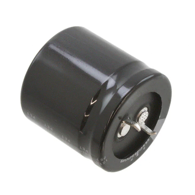

LGU2W151MELB
LGU2W151MELB
    NICHICON(尼吉康)
    插件,D30xL30mm
    150UF ±20% 450V
LGU2W151MELB 数据手册
ALUMINUM ELECTROLYTIC CAPACITORS LGU Snap-in Terminal Type, 105°C Standard Withstanding 3000 hours application of rated ripple current at 105°C. Compliant to the RoHS directive (2011/65/EU,(EU)2015/863). LGW LGU High Ripple Current Smaller Low Profile LGN LGJ LGY Long Life Specifications Item Performance Characteristics Category Temperature Range – 40 to + 105°C (16 to 250V) , – 25 to +105°C (315 to 450V) Rated Voltage Range 16 to 450V Rated Capacitance Range Capacitance Tolerance 47 to3 47000µF CV ± 20% 3 at CV120Hz,  20°C Leakage Current I 3 CV (µA) (After 5 minutes' application of rated voltage at 20°C) [C : Rated Capacitance (µF) V : Voltage (V)] Measurement frequency : 120Hz at 20°C Rated voltage (V) Tangent of loss angle (tan δ) tan δ (max.) 16 0.50 25 0.40 50 0.30 35 0.35 63 0.25 80 • 100 160 to 420 0.20 0.15 450 0.20 Measurement frequency : 120Hz Rated voltage (V) Z(– 25°C) / Z(+20°C) Impedance ratio (max.) Z(– 40°C) / Z(+20°C) Stability at Low Temperature 16 to 100 4 20 The specifications listed at right shall be met when the capacitors are restored to 20°C after D.C. bias plus rated ripple current is applied for 3000 hours at 105°C, the peak voltage shall not exceed the rated voltage. Endurance After storing the capacitors under no load at 105°C for 1000 hours and then performing voltage treatment based on JIS C 5101-4 clause 4.1 at 20°C, they shall meet the characteristic requirements listed at right. Shelf Life Marking 160 to 250 3 12 315 to 450 8 — Capacitance change Within ±20% of the initial capacitance value tan δ 200% or less than the initial specified value Leakage current Less than or equal to the initial specified value Capacitance change Within ±15% of the initial capacitance value tan δ 150% or less than the initial specified value Leakage current Less than or equal to the initial specified value Printed with white color letter on black sleeve. Drawing Type numbering system (Example : 200V 680µF) Polarity bar 1 φD+1.5max. φD +1MAX. Sleeve (P.E.T.) 4.0±0.5 L ±2 Pressure relief vent L2 Pressure relief vent 3 4 10 4.0 0.5 ±0 4.0±0.5 4.0 0.5 (2.5) 2.5 .1 10 0 .1 2×φ 2± 0.1 0.1 (PC board2-2φ hole±dimensions) (PC board hole dimensions) 5 6 7 8 9 10 11 12 13 14 Configuration Configuration Capacitance tolerance (±20%) Capacitance tolerance (±20%) Rated capacitance (180µF) Rated capacitance (680µF) Rated voltage (400V) Rated voltage (200V) Series name Series name Type (1 0) 0.8 +0.2 -0.1 10 2 L1 G E 11 L 12 A 2 5 2 G 3 2 4 G 5 1 6 8 7 1 8 M 9 10 LGU 2 D 6 8 1 ME L A Sleeve (PET) Polarity bar 0.8 +0.2 -0.1 Type .2 +0 .1 0 Case length code Case dia. code Case dia. code Code φD φD Code Z 22 20 YA 25 22 ZB 30 25 AC 35 30 B 35 C 0.8 .2 +0 .1 0 0.8 - 1.5 +0.2 -0.1 +0.2 (Terminal 1.5dimensions) -0.1 Other terminations available upon request. (Terminal dimensions) Please refer to the Guidelines for Aluminum Electrolytic Capacitors. The other terminal is also available upon request. Please refer page 272 for schematic of dimensions. Frequency coefficient of rated ripple current 16 to 100V 160 to 250V 315 to 450V Frequency (Hz) Coeff.   50 0.88 0.81 0.77 60 0.90 0.85 0.82 120 1.00 1.00 1.00 300 1.07 1.17 1.16 1k 1.15 1.32 1.30 10k 1.15 1.45 1.41 50k or more 1.15 1.50 1.43 Dimension table in next page. CAT.8100M ALUMINUM ELECTROLYTIC CAPACITORS LGU Dimensions 16V (1C) Cap. (µF) 6800 8200 10000 12000 15000 18000 22000 27000 33000 39000 47000 25V (1E) Size φD×L(mm) 22 × 25 22 × 30 22 × 30 25 × 25 22 × 35 25 × 30 30 × 25 22 × 40 25 × 35 30 × 30 22 × 45 25 × 40 30 × 30 25 × 45 30 × 35 35 × 30 25 × 50 30 × 40 35 × 30 30 × 45 35 × 35 30 × 50 35 × 40 35 × 45 Rated ripple (mArms) Leakage Current Code 1750 2000 2100 2050 2310 2300 2380 2680 2680 2570 2980 3160 3000 3400 3390 3250 3850 3830 3740 4300 4270 4810 4800 5530 0.98 1.08 1.20 1.20 1.31 1.31 1.31 1.46 1.46 1.46 1.60 1.60 1.60 1.77 1.77 1.77 1.97 1.97 1.97 2.17 2.17 2.36 2.36 2.60 LGU1C682MELZ LGU1C822MELZ LGU1C103MELZ LGU1C103MELA LGU1C123MELZ LGU1C123MELA LGU1C123MELB LGU1C153MELZ LGU1C153MELA LGU1C153MELB LGU1C183MELZ LGU1C183MELA LGU1C183MELB LGU1C223MELA LGU1C223MELB LGU1C223MELC LGU1C273MELA LGU1C273MELB LGU1C273MELC LGU1C333MELB LGU1C333MELC LGU1C393MELB LGU1C393MELC LGU1C473MELC Size φD×L(mm) 22 × 25 22 × 30 22 × 35 25 × 25 22 × 35 25 × 30 30 × 25 22 × 40 25 × 35 30 × 25 22 × 50 25 × 40 30 × 30 25 × 45 30 × 35 25 × 50 30 × 40 35 × 30 30 × 45 35 × 35 35 × 40 35 × 50 Rated ripple (mArms) Leakage Current Code 1450 1690 2020 1780 2130 2040 2120 2410 2310 2310 2850 2730 2750 3050 3050 3370 3280 3200 3740 3690 4370 4920 1.01 1.10 1.21 1.21 1.32 1.32 1.32 1.46 1.46 1.46 1.60 1.60 1.60 1.77 1.77 1.94 1.94 1.94 2.17 2.17 2.38 2.63 LGU1V332MELZ LGU1V392MELZ LGU1V472MELZ LGU1V472MELA LGU1V562MELZ LGU1V562MELA LGU1V562MELB LGU1V682MELZ LGU1V682MELA LGU1V682MELB LGU1V822MELZ LGU1V822MELA LGU1V822MELB LGU1V103MELA LGU1V103MELB LGU1V123MELA LGU1V123MELB LGU1V123MELC LGU1V153MELB LGU1V153MELC LGU1V183MELC LGU1V223MELC (mA) Cap. (µF) 4700 5600 6800 8200 10000 12000 15000 18000 22000 27000 33000 Size φD×L(mm) 22 × 25 22 × 30 22 × 30 25 × 25 22 × 35 25 × 30 30 × 25 22 × 40 25 × 35 30 × 30 22 × 45 25 × 40 30 × 30 25 × 45 30 × 35 35 × 30 25 × 50 30 × 40 35 × 35 30 × 45 35 × 35 35 × 45 35 × 50 Rated ripple (mArms) Leakage Current Code 1610 1800 1910 1910 2140 2340 2250 2650 2610 2610 2690 2810 2740 3270 3130 3260 3540 3560 3840 4240 3960 4750 5500 1.02 1.12 1.23 1.23 1.35 1.35 1.35 1.50 1.50 1.50 1.64 1.64 1.64 1.83 1.83 1.83 2.01 2.01 2.01 2.22 2.22 2.46 2.72 LGU1E472MELZ LGU1E562MELZ LGU1E682MELZ LGU1E682MELA LGU1E822MELZ LGU1E822MELA LGU1E822MELB LGU1E103MELZ LGU1E103MELA LGU1E103MELB LGU1E123MELZ LGU1E123MELA LGU1E123MELB LGU1E153MELA LGU1E153MELB LGU1E153MELC LGU1E183MELA LGU1E183MELB LGU1E183MELC LGU1E223MELB LGU1E223MELC LGU1E273MELC LGU1E333MELC Size φD×L(mm) Rated ripple (mArms) Leakage Current Code 22 × 25 22 × 30 25 × 25 22 × 35 25 × 30 22 × 40 25 × 30 30 × 25 22 × 45 25 × 35 30 × 30 22 × 50 25 × 40 30 × 30 25 × 45 30 × 35 35 × 30 30 × 40 35 × 35 30 × 50 35 × 40 35 × 45 35 × 50 1340 1700 1700 1980 2000 2250 2280 2220 2560 2610 2580 2890 2810 2950 3370 3390 3310 3710 3660 4090 4070 4560 4770 0.90 1.10 1.10 1.21 1.21 1.32 1.32 1.32 1.45 1.45 1.45 1.58 1.58 1.58 1.74 1.74 1.74 1.92 1.92 2.12 2.12 2.32 2.59 LGU1H182MELZ LGU1H272MELZ LGU1H272MELA LGU1H332MELZ LGU1H332MELA LGU1H392MELZ LGU1H392MELA LGU1H392MELB LGU1H472MELZ LGU1H472MELA LGU1H472MELB LGU1H562MELZ LGU1H562MELA LGU1H562MELB LGU1H682MELA LGU1H682MELB LGU1H682MELC LGU1H822MELB LGU1H822MELC LGU1H103MELB LGU1H103MELC LGU1H123MELC LGU1H153MELC 35V (1V) Cap. (µF) 3300 3900 4700 5600 6800 8200 10000 12000 15000 18000 22000 (mA) 50V (1H) (mA) Cap. (µF) 1800 2700 3300 3900 4700 5600 6800 8200 10000 12000 15000 (mA) Rated ripple current (mArms) at 105°C 120Hz CAT.8100M ALUMINUM ELECTROLYTIC CAPACITORS LGU Dimensions 63V (1J) Cap. (µF) 1200 1500 1800 2200 2700 3300 3900 4700 5600 6800 8200 10000 Size φD×L(mm) 22 × 25 22 × 30 25 × 25 22 × 30 25 × 25 22 × 35 25 × 30 22 × 40 25 × 35 30 × 25 22 × 45 25 × 35 30 × 30 25 × 40 30 × 35 25 × 50 30 × 40 35 × 30 30 × 40 35 × 35 30 × 50 35 × 40 35 × 45 35 × 50 80V (1K) Rated ripple (mArms) Leakage Current Code 1250 1470 1440 1580 1520 1820 1750 2070 2110 1930 2330 2270 2240 2540 2550 2970 2900 2830 3280 3240 3730 3710 4160 4690 0.82 0.92 0.92 1.01 1.01 1.11 1.11 1.23 1.23 1.23 1.36 1.36 1.36 1.48 1.48 1.63 1.63 1.63 1.78 1.78 1.96 1.96 2.15 2.38 LGU1J122MELZ LGU1J152MELZ LGU1J152MELA LGU1J182MELZ LGU1J182MELA LGU1J222MELZ LGU1J222MELA LGU1J272MELZ LGU1J272MELA LGU1J272MELB LGU1J332MELZ LGU1J332MELA LGU1J332MELB LGU1J392MELA LGU1J392MELB LGU1J472MELA LGU1J472MELB LGU1J472MELC LGU1J562MELB LGU1J562MELC LGU1J682MELB LGU1J682MELC LGU1J822MELC LGU1J103MELC (mA) Cap. (µF) 820 1000 1200 1500 1800 2200 2700 3300 3900 4700 5600 6800 Size φD×L(mm) 22 × 25 22 × 25 22 × 30 25 × 25 22 × 30 25 × 25 22 × 35 25 × 30 30 × 25 22 × 40 25 × 35 30 × 25 25 × 40 30 × 30 25 × 45 30 × 35 35 × 30 25 × 50 30 × 40 35 × 30 30 × 45 35 × 35 30 × 50 35 × 40 35 × 45 Rated ripple (mArms) Leakage Current Code 1110 1290 1440 1390 1610 1620 1830 1860 1810 2090 2010 2100 2430 2430 2760 2780 2710 2920 3120 3070 3520 3500 3800 3870 4190 0.76 0.84 0.92 0.92 1.03 1.03 1.13 1.13 1.13 1.25 1.25 1.25 1.39 1.39 1.54 1.54 1.54 1.67 1.67 1.67 1.83 1.83 2.00 2.00 2.21 LGU1K821MELZ LGU1K102MELZ LGU1K122MELZ LGU1K122MELA LGU1K152MELZ LGU1K152MELA LGU1K182MELZ LGU1K182MELA LGU1K182MELB LGU1K222MELZ LGU1K222MELA LGU1K222MELB LGU1K272MELA LGU1K272MELB LGU1K332MELA LGU1K332MELB LGU1K332MELC LGU1K392MELA LGU1K392MELB LGU1K392MELC LGU1K472MELB LGU1K472MELC LGU1K562MELB LGU1K562MELC LGU1K682MELC Size φD×L(mm) 20 × 25 20 × 30 20 × 30 22 × 25 20 × 35 22 × 30 25 × 25 20 × 40 22 × 35 25 × 30 30 × 25 20 × 45 22 × 40 25 × 30 30 × 25 22 × 45 25 × 35 30 × 30 35 × 25 22 × 50 25 × 40 30 × 30 35 × 25 25 × 45 30 × 35 35 × 30 30 × 40 35 × 30 30 × 45 35 × 35 35 × 45 35 × 50 Rated ripple (mArms) Leakage Current Code 0.62 0.68 0.74 0.74 0.82 0.82 0.82 0.89 0.89 0.89 0.89 0.98 0.98 0.98 0.98 1.08 1.08 1.08 1.08 1.20 1.20 1.20 1.20 1.31 1.31 1.31 1.46 1.46 1.60 1.60 1.77 1.97 LGU2C271MELY LGU2C331MELY LGU2C391MELY LGU2C391MELZ LGU2C471MELY LGU2C471MELZ LGU2C471MELA LGU2C561MELY LGU2C561MELZ LGU2C561MELA LGU2C561MELB LGU2C681MELY LGU2C681MELZ LGU2C681MELA LGU2C681MELB LGU2C821MELZ LGU2C821MELA LGU2C821MELB LGU2C821MELC LGU2C102MELZ LGU2C102MELA LGU2C102MELB LGU2C102MELC LGU2C122MELA LGU2C122MELB LGU2C122MELC LGU2C152MELB LGU2C152MELC LGU2C182MELB LGU2C182MELC LGU2C222MELC LGU2C272MELC 100V (2A) Cap. (µF) 560 820 1000 1200 1500 1800 2200 2700 3300 3900 4700 Size φD×L(mm) Rated ripple (mArms) 22 × 25 22 × 30 25 × 25 22 × 30 25 × 30 22 × 40 25 × 30 30 × 25 22 × 45 25 × 35 30 × 30 25 × 40 30 × 35 25 × 50 30 × 35 35 × 30 30 × 45 35 × 35 30 × 50 35 × 40 35 × 45 35 × 50 1070 1350 1350 1540 1560 1740 1760 1710 1990 2030 2000 2280 2270 2570 2590 2520 2940 2900 3320 3310 3690 4140 (mA) 160V (2C) Leakage Current Code Cap.(µF) 0.70 0.85 0.85 0.94 0.94 1.03 1.03 1.03 1.16 1.16 1.16 1.27 1.27 1.40 1.40 1.40 1.55 1.55 1.72 1.72 1.87 2.05 LGU2A561MELZ LGU2A821MELZ LGU2A821MELA LGU2A102MELZ LGU2A102MELA LGU2A122MELZ LGU2A122MELA LGU2A122MELB LGU2A152MELZ LGU2A152MELA LGU2A152MELB LGU2A182MELA LGU2A182MELB LGU2A222MELA LGU2A222MELB LGU2A222MELC LGU2A272MELB LGU2A272MELC LGU2A332MELB LGU2A332MELC LGU2A392MELC LGU2A472MELC 0270 0330 (mA) 0390 0470 0560 0680 0820 1000 1200 1500 1800 2200 2700 1100 1200 1300 1300 1340 1550 1550 1500 1670 1670 1670 1700 1820 1820 1820 2040 2040 2040 2040 2250 2250 2250 2250 2490 2490 2490 2840 2840 3320 3000 3500 4000 (mA) Rated ripple current (mArms) at 105°C 120Hz CAT.8100M ALUMINUM ELECTROLYTIC CAPACITORS LGU Dimensions 180V (2Z) Cap.(µF) 0220 0270 0330 0390 0470 0560 0680 0820 1000 1200 1500 1800 2200 Size φD×L(mm) 20 × 25 20 × 30 20 × 30 22 × 25 20 × 35 22 × 30 25 × 25 20 × 40 22 × 35 25 × 30 30 × 25 20 × 45 22 × 40 25 × 30 30 × 25 22 × 45 25 × 35 30 × 30 35 × 25 22 × 50 25 × 40 30 × 30 35 × 25 25 × 45 30 × 35 35 × 30 25 × 50 30 × 40 35 × 30 30 × 45 35 × 35 35 × 45 35 × 50 200V (2D) Rated ripple (mArms) Leakage Current (mA) Code Cap.(µF) 1000 1100 1200 1200 1300 1350 1350 1400 1500 1500 1500 1550 1670 1670 1670 1780 1780 1780 1780 2040 2040 2040 2040 2300 2300 2300 2550 2550 2550 2900 2900 3300 3650 0.59 0.66 0.73 0.73 0.79 0.79 0.79 0.87 0.87 0.87 0.87 0.95 0.95 0.95 0.95 1.04 1.04 1.04 1.04 1.15 1.15 1.15 1.15 1.27 1.27 1.27 1.39 1.39 1.39 1.55 1.55 1.70 1.88 LGU2Z221MELY LGU2Z271MELY LGU2Z331MELY LGU2Z331MELZ LGU2Z391MELY LGU2Z391MELZ LGU2Z391MELA LGU2Z471MELY LGU2Z471MELZ LGU2Z471MELA LGU2Z471MELB LGU2Z561MELY LGU2Z561MELZ LGU2Z561MELA LGU2Z561MELB LGU2Z681MELZ LGU2Z681MELA LGU2Z681MELB LGU2Z681MELC LGU2Z821MELZ LGU2Z821MELA LGU2Z821MELB LGU2Z821MELC LGU2Z102MELA LGU2Z102MELB LGU2Z102MELC LGU2Z122MELA LGU2Z122MELB LGU2Z122MELC LGU2Z152MELB LGU2Z152MELC LGU2Z182MELC LGU2Z222MELC 0220 0270 0330 0390 0470 0560 0680 0820 1000 1200 1500 1800 2200 Size φD×L(mm) 20 × 25 20 × 30 22 × 25 20 × 35 22 × 30 25 × 25 20 × 40 22 × 30 25 × 25 20 × 45 22 × 35 25 × 30 30 × 25 20 × 50 22 × 40 25 × 30 30 × 25 22 × 45 25 × 35 30 × 30 35 × 25 25 × 45 30 × 30 35 × 25 25 × 50 30 × 35 35 × 30 30 × 40 35 × 35 30 × 50 35 × 40 35 × 45 35 × 50 Rated ripple (mArms) Leakage Current (mA) Code 1000 1100 1100 1200 1250 1250 1310 1350 1350 1450 1500 1500 1500 1580 1670 1670 1670 1780 1780 1780 1780 2040 2040 2040 2300 2300 2300 2650 2650 3080 3080 3480 3780 0.62 0.69 0.69 0.77 0.77 0.77 0.83 0.83 0.83 0.91 0.91 0.91 0.91 1.00 1.00 1.00 1.00 1.10 1.10 1.10 1.10 1.21 1.21 1.21 1.34 1.34 1.34 1.46 1.46 1.64 1.64 1.80 1.98 LGU2D221MELY LGU2D271MELY LGU2D271MELZ LGU2D331MELY LGU2D331MELZ LGU2D331MELA LGU2D391MELY LGU2D391MELZ LGU2D391MELA LGU2D471MELY LGU2D471MELZ LGU2D471MELA LGU2D471MELB LGU2D561MELY LGU2D561MELZ LGU2D561MELA LGU2D561MELB LGU2D681MELZ LGU2D681MELA LGU2D681MELB LGU2D681MELC LGU2D821MELA LGU2D821MELB LGU2D821MELC LGU2D102MELA LGU2D102MELB LGU2D102MELC LGU2D122MELB LGU2D122MELC LGU2D152MELB LGU2D152MELC LGU2D182MELC LGU2D222MELC Size φD×L(mm) 20 × 25 20 × 30 20 × 30 22 × 25 20 × 35 22 × 35 25 × 25 20 × 40 22 × 40 25 × 30 30 × 25 20 × 50 22 × 45 25 × 35 30 × 25 22 × 50 25 × 40 30 × 30 35 × 25 25 × 45 30 × 35 35 × 25 25 × 50 30 × 40 35 × 30 30 × 45 35 × 35 30 × 50 35 × 40 35 × 45 35 × 50 Rated ripple (mArms) Leakage Current (mA) Code 0790 0900 1000 1000 1100 1180 1180 1200 1300 1300 1300 1450 1490 1490 1490 1650 1650 1650 1650 1800 1800 1800 2000 2000 2000 2300 2300 2470 2470 2600 3000 0.58 0.63 0.70 0.70 0.77 0.77 0.77 0.86 0.86 0.86 0.86 0.93 0.93 0.93 0.93 1.02 1.02 1.02 1.02 1.12 1.12 1.12 1.23 1.23 1.23 1.35 1.35 1.50 1.50 1.64 1.83 LGU2E151MELY LGU2E181MELY LGU2E221MELY LGU2E221MELZ LGU2E271MELY LGU2E271MELZ LGU2E271MELA LGU2E331MELY LGU2E331MELZ LGU2E331MELA LGU2E331MELB LGU2E391MELY LGU2E391MELZ LGU2E391MELA LGU2E391MELB LGU2E471MELZ LGU2E471MELA LGU2E471MELB LGU2E471MELC LGU2E561MELA LGU2E561MELB LGU2E561MELC LGU2E681MELA LGU2E681MELB LGU2E681MELC LGU2E821MELB LGU2E821MELC LGU2E102MELB LGU2E102MELC LGU2E122MELC LGU2E152MELC 250V (2E) 220V (2P) Cap.(µF) 0180 0220 0270 0330 0390 0470 0560 0680 0820 1000 1200 1500 Size φD×L(mm) 20 × 25 20 × 30 22 × 25 20 × 35 22 × 30 20 × 40 22 × 35 25 × 25 20 × 45 22 × 35 25 × 30 20 × 50 22 × 40 25 × 35 30 × 25 22 × 45 25 × 40 30 × 30 25 × 45 30 × 35 35 × 25 25 × 50 30 × 40 35 × 30 30 × 45 35 × 35 30 × 50 35 × 40 35 × 45 Cap.(µF) Rated ripple (mArms) Leakage Current (mA) Code 0900 1000 1000 1150 1150 1250 1250 1250 1400 1400 1400 1450 1450 1450 1450 1700 1700 1700 1780 1780 1780 2100 2100 2100 2400 2400 2600 2600 3000 0.59 0.66 0.66 0.73 0.73 0.80 0.80 0.80 0.87 0.87 0.87 0.96 0.96 0.96 0.96 1.05 1.05 1.05 1.16 1.16 1.16 1.27 1.27 1.27 1.40 1.40 1.54 1.54 1.72 LGU2P181MELY LGU2P221MELY LGU2P221MELZ LGU2P271MELY LGU2P271MELZ LGU2P331MELY LGU2P331MELZ LGU2P331MELA LGU2P391MELY LGU2P391MELZ LGU2P391MELA LGU2P471MELY LGU2P471MELZ LGU2P471MELA LGU2P471MELB LGU2P561MELZ LGU2P561MELA LGU2P561MELB LGU2P681MELA LGU2P681MELB LGU2P681MELC LGU2P821MELA LGU2P821MELB LGU2P821MELC LGU2P102MELB LGU2P102MELC LGU2P122MELB LGU2P122MELC LGU2P152MELC 0150 0180 0220 0270 0330 0390 0470 0560 0680 0820 1000 1200 1500 Rated ripple current (mArms) at 105°C 120Hz CAT.8100M ALUMINUM ELECTROLYTIC CAPACITORS LGU Dimensions 400V (2G) 315V (2F) Cap.(µF) 082 100 120 150 180 220 270 330 390 470 560 680 820 Size φD×L(mm) 20 × 25 20 × 30 20 × 30 22 × 25 20 × 35 22 × 30 25 × 25 20 × 40 22 × 35 25 × 25 20 × 50 22 × 40 25 × 30 30 × 25 22 × 45 25 × 35 30 × 25 22 × 50 25 × 40 30 × 30 35 × 25 25 × 45 30 × 35 35 × 30 25 × 50 30 × 40 35 × 30 30 × 45 35 × 35 30 × 50 35 × 40 35 × 45 Rated ripple (mArms) Leakage Current (mA) Code Cap.(µF) 0640 0690 0750 0750 0820 0820 0820 0900 0920 0920 1000 1040 1040 1040 1160 1160 1160 1330 1330 1330 1330 1470 1470 1470 1700 1700 1700 2050 2050 2170 2170 2200 0.48 0.53 0.58 0.58 0.65 0.65 0.65 0.71 0.71 0.71 0.78 0.78 0.78 0.78 0.87 0.87 0.87 0.96 0.96 0.96 0.96 1.05 1.05 1.05 1.15 1.15 1.15 1.26 1.26 1.38 1.38 1.52 LGU2F820MELY LGU2F101MELY LGU2F121MELY LGU2F121MELZ LGU2F151MELY LGU2F151MELZ LGU2F151MELA LGU2F181MELY LGU2F181MELZ LGU2F181MELA LGU2F221MELY LGU2F221MELZ LGU2F221MELA LGU2F221MELB LGU2F271MELZ LGU2F271MELA LGU2F271MELB LGU2F331MELZ LGU2F331MELA LGU2F331MELB LGU2F331MELC LGU2F391MELA LGU2F391MELB LGU2F391MELC LGU2F471MELA LGU2F471MELB LGU2F471MELC LGU2F561MELB LGU2F561MELC LGU2F681MELB LGU2F681MELC LGU2F821MELC 56 0 68 0 082 Size φD×L(mm) 20 × 25 20 × 30 20 × 35 22 × 25 20 × 35 22 × 30 25 × 25 20 × 40 22 × 35 25 × 30 20 × 50 22 × 40 25 × 35 30 × 25 22 × 45 25 × 35 30 × 30 22 × 50 25 × 45 30 × 35 35 × 25 25 × 50 30 × 40 35 × 30 30 × 45 35 × 35 30 × 50 35 × 40 35 × 45 35 × 50 Rated ripple (mArms) Leakage Current (mA) Code Cap.(µF) 0510 0560 0640 0640 0700 0700 0700 0750 0750 0750 0880 0880 0880 0880 0950 0950 0950 1100 1100 1100 1100 1220 1220 1220 1450 1450 1550 1550 1900 2150 0.46 0.50 0.55 0.55 0.61 0.61 0.61 0.67 0.67 0.67 0.75 0.75 0.75 0.75 0.82 0.82 0.82 0.91 0.91 0.91 0.91 1.01 1.01 1.01 1.11 1.11 1.21 1.21 1.33 1.45 LGUW6560MELY LGUW6680MELY LGUW6820MELY LGUW6820MELZ LGUW6101MELY LGUW6101MELZ LGUW6101MELA LGUW6121MELY LGUW6121MELZ LGUW6121MELA LGUW6151MELY LGUW6151MELZ LGUW6151MELA LGUW6151MELB LGUW6181MELZ LGUW6181MELA LGUW6181MELB LGUW6221MELZ LGUW6221MELA LGUW6221MELB LGUW6221MELC LGUW6271MELA LGUW6271MELB LGUW6271MELC LGUW6331MELB LGUW6331MELC LGUW6391MELB LGUW6391MELC LGUW6471MELC LGUW6561MELC 047 056 068 100 120 150 180 220 270 330 390 470 560 Size φD×L(mm) 20 × 25 20 × 30 20 × 30 22 × 25 20 × 35 22 × 30 25 × 25 20 × 40 22 × 35 25 × 25 20 × 45 22 × 40 25 × 30 30 × 25 22 × 45 25 × 35 30 × 30 35 × 25 22 × 50 25 × 40 30 × 30 35 × 25 25 × 45 30 × 35 35 × 30 25 × 50 30 × 40 35 × 30 30 × 45 35 × 35 30 × 50 35 × 40 35 × 45 Rated ripple (mArms) Leakage Current (mA) Code 0510 0560 0640 0640 0700 0700 0700 0750 0750 0750 0830 0880 0880 0880 0980 0980 0980 0980 1100 1100 1100 1100 1220 1220 1220 1440 1440 1440 1600 1600 1900 1900 2120 0.44 0.49 0.54 0.54 0.60 0.60 0.60 0.65 0.65 0.65 0.73 0.73 0.73 0.73 0.80 0.80 0.80 0.80 0.88 0.88 0.88 0.88 0.98 0.98 0.98 1.08 1.08 1.08 1.18 1.18 1.30 1.30 1.41 LGU2G560MELY LGU2G680MELY LGU2G820MELY LGU2G820MELZ LGU2G101MELY LGU2G101MELZ LGU2G101MELA LGU2G121MELY LGU2G121MELZ LGU2G121MELA LGU2G151MELY LGU2G151MELZ LGU2G151MELA LGU2G151MELB LGU2G181MELZ LGU2G181MELA LGU2G181MELB LGU2G181MELC LGU2G221MELZ LGU2G221MELA LGU2G221MELB LGU2G221MELC LGU2G271MELA LGU2G271MELB LGU2G271MELC LGU2G331MELA LGU2G331MELB LGU2G331MELC LGU2G391MELB LGU2G391MELC LGU2G471MELB LGU2G471MELC LGU2G561MELC Size φD×L(mm) 20 × 25 20 × 30 20 × 35 20 × 35 22 × 30 25 × 25 20 × 45 22 × 35 25 × 30 20 × 50 22 × 40 25 × 30 30 × 25 22 × 45 25 × 35 30 × 30 22 × 50 25 × 40 30 × 30 25 × 45 30 × 35 35 × 30 30 × 40 35 × 35 30 × 50 35 × 40 35 × 40 35 × 50 Rated ripple (mArms) Leakage Current (mA) Code 0390 0510 0560 0640 0640 0640 0690 0690 0690 0750 0800 0800 0800 0880 0880 0880 1000 1000 1000 1120 1120 1120 1280 1280 1450 1450 1500 1850 0.43 0.47 0.52 0.57 0.57 0.57 0.63 0.63 0.63 0.69 0.69 0.69 0.69 0.77 0.77 0.77 0.85 0.85 0.85 0.94 0.94 0.94 1.04 1.04 1.15 1.15 1.25 1.37 LGU2W470MELY LGU2W560MELY LGU2W680MELY LGU2W820MELY LGU2W820MELZ LGU2W820MELA LGU2W101MELY LGU2W101MELZ LGU2W101MELA LGU2W121MELY LGU2W121MELZ LGU2W121MELA LGU2W121MELB LGU2W151MELZ LGU2W151MELA LGU2W151MELB LGU2W181MELZ LGU2W181MELA LGU2W181MELB LGU2W221MELA LGU2W221MELB LGU2W221MELC LGU2W271MELB LGU2W271MELC LGU2W331MELB LGU2W331MELC LGU2W391MELC LGU2W471MELC 450V (2W) 420V (W6) Cap.(µF) 056 068 082 100 120 150 180 220 270 330 390 470 560 082 100 120 150 180 220 270 330 390 470 Rated ripple current (mArms) at 105°C 120Hz CAT.8100M
