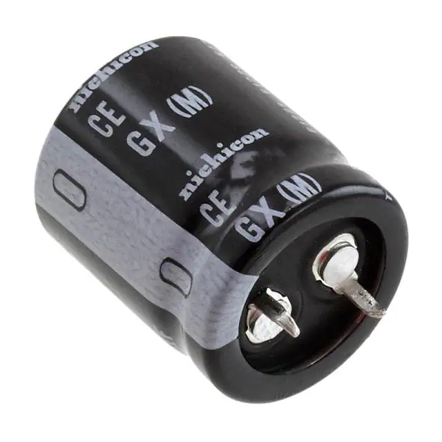

    插件,D22xL25mm
    330UF ±20% 200V
LGX2D331MELZ25 数据手册
ALUMINUM ELECTROLYTIC CAPACITORS LGX Snap-in Terminal Type, 105°C Long Life Assurannce, Smaller-Sized Long life assurance series withstanding 5000 hours application of rated ripple current at 105°C. Suited for rectifier circuit of general inverter, switching power supply. Addition of 500V rated voltage. Compliant to the RoHS directive (2011/65/EU,(EU)2015/863). LGY Smaller LGX Specifications Item Performance Characteristics Category Temperature Range – 25 to +105°C Rated Voltage Range 200 to 500V Rated Capacitance Range 56 to 2200µF Capacitance Tolerance 3 CV ± 20% at 120Hz, 20°C Leakage Current I 3 CV (µA) (After 5 minutes' application of rated voltage) [C : Rated Capacitance (µF) V : Voltage (V)] 3 CV Rated voltage(V) Tangent of loss angle (tan δ) tan δ (MAX.) 200 to 400 0.15 Impedance ratio (MAX.) 250 200 Rated voltage(V) Stability at Low Temperature Z–25°C/ Z+20°C Measurement frequency : 120Hz at 20°C 450 to 500 0.20 Measurement frequency : 120Hz 400 to 500 4 8 Endurance The specifications listed at right shall be met when the capacitors are restored to 20°C after D.C. bias plus rated ripple current is applied for 5000 hours at 105°C, the peak voltage shall not exceed the rated voltage. Capacitance change tan δ Leakage current Within ±20% of the initial capacitance value 200% or less than the initial specified value Less than or equal to the initial specified value Shelf Life After storing the capacitors under no load at 105°C for 1000 hours and then performing voltage treatment based on JIS C 5101-4 clause 4.1 at 20°C, they shall meet the requirements listed at right. Capacitance change tan δ Leakage current Within ±15% of the initial capacitance value 150% or less than the initial specified value Less than or equal to the initial specified value Marking Printed with white color letter on black sleeve. Drawing Type numbering system (Example : 400V 120µF) 1 2 1 3 2 4 3 5 4 6 5 7 6 8 7 9 8 9 10 11 10 11 12 12 13 14 13 14 L GLXG 2X G2 1G 21 12 M1 EM LE ZL Z3 03 0 (1 0) 4.0±0.5 4.0±0.5 (1 0) 0.8 +0.2 -0.1 +0.2 -0.1 (2.5) 4.0±0.5 (2.5) 4.0±0.5 0.8 1.5 0.8 .2 +0 .1 .2 +0 .1 0.8 -0 -0 Case length code Case length code Case dia. code Case dia. code Configuration φD Code Configuration φD Code Capacitance tolerance (±20%) 22 Z Capacitance tolerance (±20%) 22 Z 25 A Rated capacitance (120µF) 25 A Rated capacitance (120µF) 30 B Rated voltage (400V) 30 B Rated voltage (400V) 35 C 35 C Series name Series name Type Type +0.2 1.5 -0.1 +0.2 -0.1 Other terminations available upon request. Please refer to the Guidelines for Aluminum Electrolytic Capacitors. Minimum order quantity : 50pcs. Dimension table in next page. CAT.8100K ALUMINUM ELECTROLYTIC CAPACITORS LGX Dimensions 200V (2D) Cap. (µF) 330 390 470 560 680 820 1000 1200 1500 1800 2200 250V (2E) Size φD × L(mm) Rated ripple (mArms) Leakage Current Code × 25 22 × 30 22 × 35 25 × 25 22 × 35 22 × 40 25 × 35 30 × 30 22 × 50 25 × 40 25 × 45 30 × 35 35 × 30 25 × 50 30 × 40 35 × 35 30 × 50 35 × 40 35 × 45 35 × 50 1100 0.77 LGX2D331MELZ25 1380 0.83 LGX2D391MELZ30 1550 0.91 LGX2D471MELZ35 1390 0.91 LGX2D471MELA25 1550 1.00 LGX2D561MELZ35 1730 1.10 LGX2D681MELZ40 1870 1.10 LGX2D681MELA35 1980 1.10 LGX2D681MELB30 2180 1.21 LGX2D821MELZ50 2090 1.21 LGX2D821MELA40 2350 1.34 LGX2D102MELA45 2220 1.34 LGX2D102MELB35 2610 1.34 LGX2D102MELC30 2400 1.46 LGX2D122MELA50 2530 1.46 LGX2D122MELB40 2880 1.46 LGX2D122MELC35 3000 1.64 LGX2D152MELB50 3080 1.64 LGX2D152MELC40 3280 1.80 LGX2D182MELC45 3450 1.98 LGX2D222MELC50 22 (mA) Cap. (µF) Size φD × L(mm) Rated ripple (mArms) Leakage Current Code 22 0.77 LGX2E271MELZ25 22 1200 0.86 LGX2E331MELZ30 1320 0.86 LGX2E331MELA25 1440 0.93 LGX2E391MELZ35 1430 0.93 LGX2E391MELA30 1620 1.02 LGX2E471MELZ40 1600 1.02 LGX2E471MELA35 1510 1.02 LGX2E471MELB25 1800 1.12 LGX2E561MELZ45 1780 1.12 LGX2E561MELA35 1830 1.12 LGX2E561MELB30 2000 1.23 LGX2E681MELZ50 2000 1.23 LGX2E681MELA40 2060 1.23 LGX2E681MELB35 1910 1.23 LGX2E681MELC25 2150 1.35 LGX2E821MELA45 2060 1.35 LGX2E821MELB35 2150 1.35 LGX2E821MELC30 2330 1.50 LGX2E102MELB40 2380 1.50 LGX2E102MELC35 2680 1.64 LGX2E122MELB50 2720 1.64 LGX2E122MELC40 1800 × 25 × 30 25 × 25 22 × 35 25 × 30 22 × 40 25 × 35 30 × 25 22 × 45 25 × 35 30 × 30 22 × 50 25 × 40 30 × 35 35 × 25 25 × 45 30 × 35 35 × 30 30 × 40 35 × 35 30 × 50 35 × 40 35 × 45 35 × 50 1010 3050 3300 1.83 2.01 LGX2E152MELC45 LGX2E182MELC50 Cap. (µF) Size φD × L(mm) Rated ripple (mArms) Leakage Current Code 22 × 25 × 30 25 × 25 22 × 35 25 × 30 22 × 40 25 × 30 30 × 25 22 × 45 25 × 35 30 × 30 35 × 25 25 × 40 30 × 35 35 × 25 25 × 50 30 × 40 35 × 30 30 × 45 35 × 35 30 × 50 35 × 40 35 × 45 35 × 50 590 0.57 LGX2W820MELZ25 22 690 0.63 LGX2W101MELZ30 700 0.63 LGX2W101MELA25 770 0.69 LGX2W121MELZ35 880 0.69 LGX2W121MELA30 880 0.77 LGX2W151MELZ40 880 0.77 LGX2W151MELA30 930 0.77 LGX2W151MELB25 900 0.85 LGX2W181MELZ45 920 0.85 LGX2W181MELA35 1030 0.85 LGX2W181MELB30 1100 0.85 LGX2W181MELC25 1030 0.94 LGX2W221MELA40 1170 0.94 LGX2W221MELB35 1100 0.94 LGX2W221MELC25 1310 1.04 LGX2W271MELA50 1330 1.04 LGX2W271MELB40 1240 1.04 LGX2W271MELC30 1510 1.15 LGX2W331MELB45 1390 1.15 LGX2W331MELC35 1670 1.25 LGX2W391MELB50 1730 1.25 LGX2W391MELC40 1830 1.37 LGX2W471MELC45 1980 1.50 LGX2W561MELC50 270 330 390 470 560 680 820 1000 1200 1500 450V (2W) 400V (2G) Cap. (µF) 100 120 150 180 220 270 330 390 470 560 680 (mA) Size φD × L(mm) Rated ripple (mArms) Leakage Current Code 22 × 25 × 30 22 × 35 25 × 25 22 × 35 25 × 30 30 × 25 22 × 45 25 × 35 22 × 50 25 × 40 30 × 30 35 × 25 25 × 45 30 × 35 25 × 50 30 × 40 35 × 30 30 × 45 35 × 35 35 × 40 35 × 45 660 0.60 LGX2G101MELZ25 22 750 0.65 LGX2G121MELZ30 860 0.73 LGX2G151MELZ35 860 0.73 LGX2G151MELA25 860 0.80 LGX2G181MELZ35 (mA) 970 0.80 LGX2G181MELA30 1020 0.80 LGX2G181MELB25 1090 0.88 LGX2G221MELZ45 1120 0.88 LGX2G221MELA35 1230 0.98 LGX2G271MELZ50 1260 0.98 LGX2G271MELA40 1270 0.98 LGX2G271MELB30 1220 0.98 LGX2G271MELC25 1300 1.08 LGX2G331MELA45 1430 1.08 LGX2G331MELB35 1440 1.18 LGX2G391MELA50 1600 1.18 LGX2G391MELB40 1520 1.18 LGX2G391MELC30 1810 1.30 LGX2G471MELB45 1670 1.30 LGX2G471MELC35 1900 1.41 LGX2G561MELC40 2120 1.56 LGX2G681MELC45 82 100 120 150 180 220 270 330 390 470 560 (mA) Rated ripple current (mArms) at 105°C 120Hz CAT.8100K ALUMINUM ELECTROLYTIC CAPACITORS LGX Dimensions 500V (2H) Cap. (µF) 56 Size φD × L(mm) Rated ripple (mArms) Leakage Current Code × 25 22 × 30 25 × 25 22 × 35 25 × 30 22 × 40 22 × 50 25 × 35 30 × 25 25 × 45 30 × 30 35 × 25 25 × 50 30 × 35 35 × 30 30 × 45 35 × 35 30 × 50 35 × 40 35 × 45 35 × 50 35 × 58 560 0.50 LGX2H560MELZ25 590 0.55 LGX2H680MELZ30 650 0.55 LGX2H680MELA25 720 0.60 LGX2H820MELZ35 740 0.60 LGX2H820MELA30 770 0.67 LGX2H101MELZ40 930 0.73 LGX2H121MELZ50 930 0.73 LGX2H121MELA35 68 82 100 120 150 180 220 270 330 390 470 22 (mA) 820 0.73 LGX2H121MELB25 1080 0.82 LGX2H151MELA45 910 0.82 LGX2H151MELB30 990 0.82 LGX2H151MELC25 1200 0.90 LGX2H181MELA50 1040 0.90 LGX2H181MELB35 1100 0.90 LGX2H181MELC30 1330 0.99 LGX2H221MELB45 1230 0.99 LGX2H221MELC35 1500 1.10 LGX2H271MELB50 1420 1.10 LGX2H271MELC40 1600 1.21 LGX2H331MELC45 1780 1.32 LGX2H391MELC50 2030 1.45 LGX2H471MELC58 Rated ripple current (mArms) at 105°C 120Hz Frequency coefficient of rated ripple current Frequency (Hz) Coeff. 200 • 250V 400 to 500V 50 0.81 0.77 60 0.85 0.82 120 1.00 1.00 300 1.17 1.16 1k 1.32 1.30 10k 1.45 1.41 50k or more 1.50 1.43 Minimum order quantity : 50pcs. CAT.8100K
