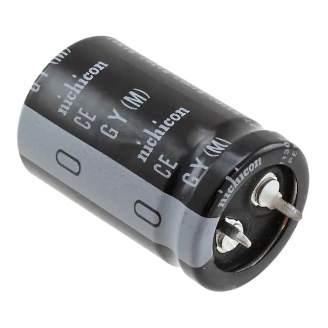

LGY2A102MELZ35 数据手册
ALUMINUM ELECTROLYTIC CAPACITORS LGY Snap-in Terminal Type, 105°C Long Life Assurance Long life assurance series withstanding 5000 hours application of ripple current at 105°C. Suited for use in industrial power supplies applications where high reliability and dependable performance are the most important. Suited for ballast application. Compliant to the RoHS directive (2011/65/EU,(EU)2015/863). LGR Long Life LGY Long Life LGU Smaller LGX Specifications Item Performance Characteristics Category Temperature Range – 40 to +105°C Rated Voltage Range 16 to 100V Rated Capacitance Range 560 to 47000µF Capacitance Tolerance 3 CV ± 20% at 120Hz, 20°C Leakage Current I 3 CV (µA) (After 5 minutes' application of rated voltage) [C : Rated Capacitance (µF) V : Voltage (V)] 3 CV Measurement frequency : 120Hz at 20°C 16 0.50 Rated voltage(V) Tangent of loss angle (tan δ) tan δ (MAX.) 25 0.40 35 0.35 50 0.30 80 63 0.25 100 0.20 Measurement frequency : 120Hz 16 to 100 Rated voltage(V) 4 Z–25°C/ Z+20°C Impedance ratio 20 Z–40°C/ Z+20°C ZT/Z20 (MAX.) Stability at Low Temperature Endurance The specifications listed at right shall be met when the capacitors are restored to 20°C after D.C. bias plus rated ripple current is applied for 5000 hours at 105°C, the peak voltage shall not exceed the rated voltage. tan δ Leakage current Within ±25% of the initial capacitance value 250% or less than the initial specified value Less than or equal to the initial specified value Shelf Life After storing the capacitors under no load at 105°C for 1000 hours and then performing voltage treatment based on JIS C 5101-4 clause 4.1 at 20°C, they shall meet the requirements listed at right. Capacitance change tan δ Leakage current Within ±15% of the initial capacitance value 150% or less than the initial specified value Less than or equal to the initial specified value Marking Printed with white color letter on black sleeve. Drawing Capacitance change Type numbering system (Example : 100V 680µF) Polarity bar Sleeve (P.E.T.) 1 φD +1MAX. φD +1.5MAX. Polarity bar Sleeve (P.E.T.) 12 13 14 L G Y 2 A 6 8 1 M E L Z 2 3 0 1 3 2 4 3 5 4 6 5 7 6 8 7 13 14 L G Y 2 A 6 8 1 M E L Z 3 0 L±2 4.0±0.5 Pressure relief ventL±2 0.8 (1 0) +0.2 -0.1 0.8 10 ± vent Pressure relief 0. 10 ± 4.0±0.5 4.0±0.5 2.5 (2.5) 1 0.1 2- 2 φ ±0.1 0.8 9 10 11 Case height code Case dia. code Configuration Capacitance tolerance (±20%) Case φD height Codecode 22Case dia. Z code Configuration Rated capacitance (680µF) Capacitance tolerance (±20%) Rated voltage (100V) 25φD 3022 Rated capacitance (680 F) Series name .2 +0 .1 -0 Rated voltage Type (100V) .2 +0 .1 .8 -0 +0.2 -0.1 8 10 11 12 10 4.0±0.5 9 Series name 0 3525 A Code BZ CA 30 B 35 C Type +0.2 1.5 -0.1 +0.2 (Terminal dimensions) 1.5 -0.1 (PC board hole dimensions) 2- 2 φ ±0.1 (Terminal dimensions) (PC board hole dimensions) Other terminations available upon request. Please refer to the Guidelines for Aluminum Electrolytic Capacitors. Frequency coefficient of rated ripple current Frequency (Hz) 16 to 100V 50 0.88 60 0.90 120 1.00 300 1.07 1k 1.15 10k 1.15 50k or more 1.15 Minimum order quantity : 50pcs. Dimension table in next page. CAT.8100K ALUMINUM ELECTROLYTIC CAPACITORS LGY Dimensions 16V (1C) Cap. (µF) 6800 8200 10000 12000 15000 18000 22000 27000 33000 39000 47000 25V (1E) Code Cap. (µF) 0.98 LGY1C682MELZ25 4700 1.08 LGY1C822MELZ30 5600 2200 1.20 LGY1C103MELZ30 2200 1.20 LGY1C103MELA25 2400 1.31 LGY1C123MELZ35 2400 1.31 LGY1C123MELA30 2400 1.31 LGY1C123MELB25 2700 1.46 LGY1C153MELZ40 2700 1.46 LGY1C153MELA35 2700 1.46 LGY1C153MELB30 3000 1.60 LGY1C183MELZ50 3000 1.60 LGY1C183MELA40 3000 1.60 LGY1C183MELB30 3300 1.77 LGY1C223MELA45 3300 1.77 LGY1C223MELB35 3300 1.77 LGY1C223MELC30 3600 1.97 LGY1C273MELA50 3600 1.97 LGY1C273MELB40 3600 1.97 LGY1C273MELC30 4000 2.17 LGY1C333MELB45 4000 2.17 LGY1C333MELC35 4300 2.36 LGY1C393MELB50 27000 4300 2.36 LGY1C393MELC40 4700 2.60 LGY1C473MELC45 Size φD × L(mm) Rated ripple Leakage Current (mArms) (mA) 22 1.02 LGY1E472MELZ25 1800 1.12 LGY1E562MELZ30 1900 1.23 LGY1E682MELZ30 1900 1.23 LGY1E682MELA25 2100 1.35 LGY1E822MELZ35 2100 1.35 LGY1E822MELA30 2100 1.35 LGY1E822MELB25 2300 1.50 LGY1E103MELZ40 2300 1.50 LGY1E103MELA35 2300 1.50 LGY1E103MELB30 2600 1.64 LGY1E123MELZ45 2600 1.64 LGY1E123MELA40 2600 1.64 LGY1E123MELB30 2900 1.83 LGY1E153MELA45 2900 1.83 LGY1E153MELB35 2900 1.83 LGY1E153MELC30 3100 2.01 LGY1E183MELA50 3100 2.01 LGY1E183MELB40 3100 2.01 LGY1E183MELC35 3500 2.22 LGY1E223MELB45 3500 2.22 LGY1E223MELC35 3800 2.46 LGY1E273MELC45 33000 × 25 × 30 22 × 30 25 × 25 22 × 35 25 × 30 30 × 25 22 × 40 25 × 35 30 × 30 22 × 45 25 × 40 30 × 30 25 × 45 30 × 35 35 × 30 25 × 50 30 × 40 35 × 35 30 × 45 35 × 35 35 × 45 35 × 50 1600 22 4200 2.72 LGY1E333MELC50 Size φD × L(mm) 22 × 25 Rated ripple Leakage Current (mArms) (mA) LGY1V332MELZ25 Cap. (µF) 1800 1300 0.90 LGY1H182MELZ25 LGY1V392MELZ30 2200 × 25 22 × 30 25 × 25 22 × 35 25 × 30 22 × 40 25 × 30 30 × 25 22 × 45 25 × 35 30 × 30 22 × 50 25 × 40 30 × 30 25 × 45 30 × 35 35 × 30 30 × 40 35 × 35 30 × 50 35 × 40 35 × 45 35 × 50 1400 0.99 LGY1H222MELZ25 1600 1.10 LGY1H272MELZ30 1600 1.10 LGY1H272MELA25 1800 1.21 LGY1H332MELZ35 1800 1.21 LGY1H332MELA30 1900 1.32 LGY1H392MELZ40 1900 1.32 LGY1H392MELA30 1900 1.32 LGY1H392MELB25 2100 1.45 LGY1H472MELZ45 2100 1.45 LGY1H472MELA35 2100 1.45 LGY1H472MELB30 2300 1.58 LGY1H562MELZ50 2300 1.58 LGY1H562MELA40 2300 1.58 LGY1H562MELB30 2500 1.74 LGY1H682MELA45 2500 1.74 LGY1H682MELB35 2500 1.74 LGY1H682MELC30 2800 1.92 LGY1H822MELB40 2800 1.92 LGY1H822MELC35 3100 2.12 LGY1H103MELB50 3100 2.12 LGY1H103MELC40 3400 2.32 LGY1H123MELC45 3800 2.59 LGY1H153MELC50 Size φD × L(mm) 22 × 25 Rated ripple Leakage Current (mArms) (mA) 1800 × 30 22 × 30 25 × 25 22 × 35 25 × 30 30 × 25 22 × 40 25 × 35 30 × 30 22 × 50 25 × 40 30 × 30 25 × 45 30 × 35 35 × 30 25 × 50 30 × 40 35 × 30 30 × 45 35 × 35 30 × 50 35 × 40 35 × 45 2000 Size φD × L(mm) 22 × 25 Rated ripple Leakage Current (mArms) (mA) 1500 1.01 × 30 22 × 35 25 × 25 22 × 35 25 × 30 30 × 25 22 × 40 25 × 35 30 × 25 22 × 50 25 × 40 30 × 30 25 × 45 30 × 35 25 × 50 30 × 40 35 × 30 30 × 45 35 × 35 35 × 40 35 × 50 1600 1.10 1800 1.21 LGY1V472MELZ35 1800 1.21 LGY1V472MELA25 2000 1.32 LGY1V562MELZ35 2000 1.32 LGY1V562MELA30 2000 1.32 LGY1V562MELB25 2200 1.46 LGY1V682MELZ40 2200 1.46 LGY1V682MELA35 2200 1.46 LGY1V682MELB25 2400 1.60 LGY1V822MELZ50 2400 1.60 LGY1V822MELA40 2400 1.60 LGY1V822MELB30 2600 1.77 LGY1V103MELA45 2600 1.77 LGY1V103MELB35 2900 1.94 LGY1V123MELA50 2900 1.94 LGY1V123MELB40 2900 1.94 LGY1V123MELC30 3200 2.17 LGY1V153MELB45 3200 2.17 LGY1V153MELC35 3500 2.38 LGY1V183MELC40 3900 2.63 LGY1V223MELC50 22 6800 8200 10000 12000 15000 18000 22000 35V (1V) Cap. (µF) 3300 3900 4700 5600 6800 8200 10000 12000 15000 18000 22000 22 Code 50V (1H) Code 2700 3300 3900 4700 5600 6800 8200 10000 12000 15000 22 Code Rated ripple current (mArms) at 105°C 120Hz CAT.8100K ALUMINUM ELECTROLYTIC CAPACITORS LGY Dimensions 63V (1J) 80V (1K) Size φD × L(mm) Rated ripple Leakage Current (mArms) (mA) 22 0.82 LGY1J122MELZ25 820 1500 0.92 LGY1J152MELZ30 1000 1500 0.92 LGY1J152MELA25 1600 1.01 LGY1J182MELZ30 1600 1.01 LGY1J182MELA25 1800 1.11 LGY1J222MELZ35 1800 1.11 LGY1J222MELA30 2000 1.23 LGY1J272MELZ40 2000 1.23 LGY1J272MELA35 2000 1.23 LGY1J272MELB25 2200 1.36 LGY1J332MELZ45 2200 1.36 LGY1J332MELA35 2200 1.36 LGY1J332MELB30 2400 1.48 LGY1J392MELA40 2400 1.48 LGY1J392MELB35 2600 1.63 LGY1J472MELA50 2600 1.63 LGY1J472MELB40 2600 1.63 LGY1J472MELC30 2800 1.78 LGY1J562MELB45 2800 1.78 LGY1J562MELC35 3100 1.96 LGY1J682MELB50 3100 1.96 LGY1J682MELC40 5600 3400 2.15 LGY1J822MELC45 6800 10000 × 25 × 30 25 × 25 22 × 30 25 × 25 22 × 35 25 × 30 22 × 40 25 × 35 30 × 25 22 × 45 25 × 35 30 × 30 25 × 40 30 × 35 25 × 50 30 × 40 35 × 30 30 × 45 35 × 35 30 × 50 35 × 40 35 × 45 35 × 50 1300 22 3800 2.38 LGY1J103MELC50 Cap. (µF) Size φD × L(mm) Rated ripple Leakage Current (mArms) (mA) 22 × 25 × 30 22 × 30 25 × 25 22 × 35 25 × 30 22 × 40 25 × 35 30 × 25 22 × 45 25 × 40 30 × 30 25 × 45 30 × 35 25 × 50 30 × 40 35 × 30 30 × 45 35 × 35 30 × 50 35 × 40 35 × 45 35 × 50 1100 0.70 LGY2A561MELZ25 22 1200 0.78 LGY2A681MELZ30 1300 0.85 LGY2A821MELZ30 1300 0.85 LGY2A821MELA25 1500 0.94 LGY2A102MELZ35 1500 0.94 LGY2A102MELA30 1600 1.03 LGY2A122MELZ40 1600 1.03 LGY2A122MELA35 1600 1.03 LGY2A122MELB25 1800 1.16 LGY2A152MELZ45 1800 1.16 LGY2A152MELA40 1800 1.16 LGY2A152MELB30 2000 1.27 LGY2A182MELA45 2000 1.27 LGY2A182MELB35 2200 1.40 LGY2A222MELA50 2200 1.40 LGY2A222MELB40 2200 1.40 LGY2A222MELC30 2400 1.55 LGY2A272MELB45 2400 1.55 LGY2A272MELC35 2700 1.72 LGY2A332MELB50 2700 1.72 LGY2A332MELC40 2900 1.87 LGY2A392MELC45 3200 2.05 LGY2A472MELC50 Cap. (µF) 1200 1500 1800 2200 2700 3300 3900 4700 5600 6800 8200 Code Cap. (µF) 1200 1500 1800 2200 2700 3300 3900 4700 Size φD × L(mm) Rated ripple Leakage Current (mArms) (mA) 22 × 25 × 25 22 × 30 25 × 25 22 × 35 25 × 25 22 × 35 25 × 30 30 × 25 22 × 45 25 × 35 30 × 25 25 × 40 30 × 30 25 × 45 30 × 35 35 × 30 30 × 40 35 × 30 30 × 45 35 × 35 35 × 40 35 × 45 1200 0.76 LGY1K821MELZ25 22 1300 0.84 LGY1K102MELZ25 1500 0.92 LGY1K122MELZ30 1500 0.92 LGY1K122MELA25 1600 1.03 LGY1K152MELZ35 1600 1.03 LGY1K152MELA25 1800 1.13 LGY1K182MELZ35 1800 1.13 LGY1K182MELA30 1800 1.13 LGY1K182MELB25 2000 1.25 LGY1K222MELZ45 2000 1.25 LGY1K222MELA35 2000 1.25 LGY1K222MELB25 2200 1.39 LGY1K272MELA40 2200 1.39 LGY1K272MELB30 2400 1.54 LGY1K332MELA45 2400 1.54 LGY1K332MELB35 2400 1.54 LGY1K332MELC30 2600 1.67 LGY1K392MELB40 2600 1.67 LGY1K392MELC30 2900 1.83 LGY1K472MELB45 2900 1.83 LGY1K472MELC35 3100 2.00 LGY1K562MELC40 3500 2.21 LGY1K682MELC45 Code 100V (2A) 560 680 820 1000 1200 1500 1800 2200 2700 3300 3900 4700 Code Rated ripple current (mArms) at 105°C 120Hz CAT.8100K
LGY2A102MELZ35
1. 物料型号:文档列出了不同电压和容量的电容器型号,如LGY1C682MELZ25、LGY1V332MELZ25等。
2. 器件简介:LGY系列电容器适用于105°C下5000小时的纹波电流应用,适合工业电源供应应用,符合RoHS指令。
3. 引脚分配:文档提供了电容器的尺寸和引脚配置,如极性条、套筒尺寸等。
4. 参数特性:包括工作温度范围(-40至+105°C)、额定电压范围(16至100V)、电容范围(560至47000μF)、电容公差(±20% at 120Hz, 20°C)、漏电流、损耗角正切值等。
5. 功能详解:描述了电容器在不同条件下的性能,如低温稳定性、耐久性、储存寿命等。
6. 应用信息:适用于工业电源供应和电子镇流器应用。
7. 封装信息:提供了详细的封装尺寸和标记方式。
8. 订购信息:最小订购量为50件,提供了不同电压和容量的电容器尺寸表。
