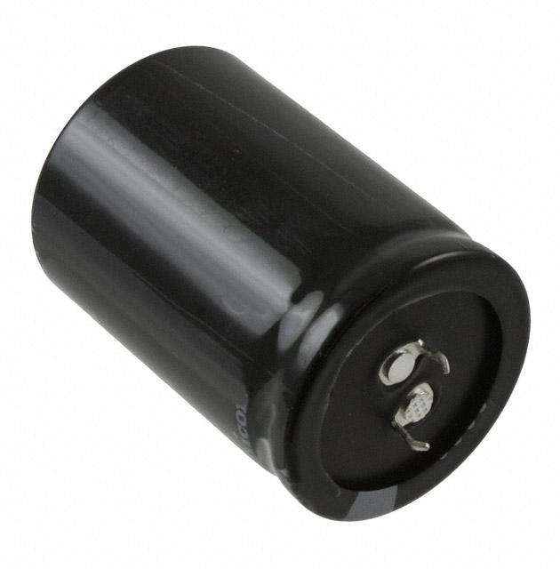

ALUMINUM ELECTROLYTIC CAPACITORS LG Snap-in Terminal Type, Ultra-Smaller-Sized series One rank smaller case sized than LN series. Suited for equipment down sizing. Adapted to the RoHS directive (2002/95/EC). LN Smaller LG Specifications Item Performance Characteristics Category Temperature Range Rated Voltage Range Rated Capacitance Range Capacitance Tolerance Leakage Current tan δ – 40 ~ + 85°C (160 ~ 250V), – 25 ~ + 85°C (400 ~ 450V) 160 ~ 450V 120 ~ 3900µF ± 20% at 120Hz, 20°C I 3 CV (µA) (After 5 minutes' application of rated voltage) [C : Rated Capacitance (µF) V : Voltage (V)] Rated voltage (V) tan δ ( MAX.) 160 ~ 400 0.15 450 0.20 160 ~ 250 4 Measurement frequency : 120Hz, Temperature : 20°C Stability at Low Temperature Rated voltage(V) 400 ~ 450 8 Measurement frequency : 120Hz Impedance ratio ZT/Z20 (MAX.) Z – 25°C/ Z+20°C Endurance After an application of DC voltage (in the range of rated DC voltage even after over-lapping the specified ripple current) for 2000 hours at 85°C, capacitors meet the characteristic requirements listed at right. After storing the capacitors under no load at 85°C for 1000 hours, and after performing voltage treatment based on JIS C 5101-4 clause 4.1 at 20°C, they will meet the characteristic requirements listed at right. Capacitance change tan δ Leakage current Within ± 20% of initial value 200% or less of initial specified value Initial specified value or less Shelf Life Capacitance change tan δ Leakage current Within ± 20% of initial value 200% or less of initial specified value Initial specified value or less Marking Printed with white color letter on black sleeve. Drawing Type numbering system ( Example : 400V 180µF) Polarity bar Sleeve (P.E.T.) D +1.5MAX. L LG 2G 1 8 1 MEL A 2 5 10 1 2 3 4 5 6 7 8 9 10 11 12 13 14 Case length code Case dia.code fD Code 22 Z 25 A 30 B 35 C L±2 Pressure relief vent 4.0±0.5 0.8+0.2 -0.1 4.0±0.5 2.5 10± 0.1 2-2 f ± 0.1 (PC board hole dimensions) 0.8 -0.1 +0.2 Configuration Capacitance tolerane (±20%) Rated Capacitance (180µF) Rated voltage (400V) Series name Type f 1.5 +0.2 -0.1 (Terminal dimensions) The other terminal is also available upon request. Please refer to page 237 for schematic of dimensions. Minimum order quantity : 50pcs. Dimension table in next page. CAT.8100V ALUMINUM ELECTROLYTIC CAPACITORS LG Cap. (µF) 560 680 820 1000 series Dimensions 160V (2C) Size φD × L(mm) 22 22 22 25 22 25 22 25 30 22 25 30 35 25 30 35 30 35 30 35 35 35 Rated ripple (mA) 180V (2Z) Leakage Current (mA) 0.89 0.98 1.08 1.08 1.20 1.20 1.31 1.31 1.31 1.46 1.46 1.46 1.46 1.60 1.60 1.60 1.77 1.77 1.97 1.97 2.17 2.36 Code LLG2C561MELZ25 LLG2C681MELZ30 LLG2C821MELZ35 LLG2C821MELA25 LLG2C102MELZ40 LLG2C102MELA30 LLG2C122MELZ40 LLG2C122MELA35 LLG2C122MELB25 LLG2C152MELZ50 LLG2C152MELA40 LLG2C152MELB30 LLG2C152MELC25 LLG2C182MELA45 LLG2C182MELB35 LLG2C182MELC30 LLG2C222MELB40 LLG2C222MELC35 LLG2C272MELB45 LLG2C272MELC40 LLG2C332MELC45 LLG2C392MELC50 Cap. (µF) 560 680 820 Size φD × L(mm) 22 22 25 22 25 22 25 30 22 25 30 35 25 30 35 25 30 35 30 35 30 35 35 Rated ripple (mA) tan δ 0.15 0.15 0.15 0.15 0.15 0.15 0.15 0.15 0.15 0.15 0.15 0.15 0.15 0.15 0.15 0.15 0.15 0.15 0.15 0.15 0.15 0.15 tan δ 0.15 0.15 0.15 0.15 0.15 0.15 0.15 0.15 0.15 0.15 0.15 0.15 0.15 0.15 0.15 0.15 0.15 0.15 0.15 0.15 0.15 0.15 0.15 1200 1500 1800 2200 2700 3300 3900 × 25 × 30 × 35 × 25 × 40 × 30 × 40 × 35 × 25 × 50 × 40 × 30 × 25 × 45 × 35 × 30 × 40 × 35 × 45 × 40 × 45 × 50 2250 2500 2750 2520 3000 3000 3050 3250 3050 3400 3400 3400 3400 3800 4200 4100 4450 4780 4900 5450 5750 6000 1000 1200 1500 1800 2200 2700 3300 × 25 × 30 × 25 × 35 × 30 × 40 × 35 × 25 × 45 × 40 × 30 × 25 × 45 × 35 × 30 × 50 × 40 × 30 × 45 × 35 × 50 × 40 × 45 1800 1900 2100 2450 2400 2800 2700 2650 2900 3000 3000 3000 3300 3300 3300 3600 3600 3400 4300 4300 4700 4700 5000 Leakage Current (mA) 0.95 1.04 1.04 1.15 1.15 1.27 1.27 1.27 1.39 1.39 1.39 1.39 1.55 1.55 1.55 1.70 1.70 1.70 1.88 1.88 2.09 2.09 2.31 Code LLG2Z561MELZ25 LLG2Z681MELZ30 LLG2Z681MELA25 LLG2Z821MELZ35 LLG2Z821MELA30 LLG2Z102MELZ40 LLG2Z102MELA35 LLG2Z102MELB25 LLG2Z122MELZ45 LLG2Z122MELA40 LLG2Z122MELB30 LLG2Z122MELC25 LLG2Z152MELA45 LLG2Z152MELB35 LLG2Z152MELC30 LLG2Z182MELA50 LLG2Z182MELB40 LLG2Z182MELC30 LLG2Z222MELB45 LLG2Z222MELC35 LLG2Z272MELB50 LLG2Z272MELC40 LLG2Z332MELC45 200V (2D) Cap. (µF) 470 560 680 820 Size φD × L(mm) 22 22 25 22 25 22 25 22 25 30 22 25 30 35 25 30 35 30 35 30 35 35 35 Rated ripple (mA) 250V (2E) Leakage Current (mA) 0.91 1.00 1.00 1.10 1.10 1.21 1.21 1.34 1.34 1.34 1.46 1.46 1.46 1.46 1.64 1.64 1.64 1.80 1.80 1.98 1.98 2.20 2.55 Code LLG2D471MELZ25 LLG2D561MELZ30 LLG2D561MELA25 LLG2D681MELZ35 LLG2D681MELA30 LLG2D821MELZ40 LLG2D821MELA30 LLG2D102MELZ45 LLG2D102MELA35 LLG2D102MELB30 LLG2D122MELZ50 LLG2D122MELA40 LLG2D122MELB30 LLG2D122MELC25 LLG2D152MELA50 LLG2D152MELB35 LLG2D152MELC30 LLG2D182MELB40 LLG2D182MELC35 LLG2D222MELB50 LLG2D222MELC40 LLG2D272MELC45 LLG2D332MELC50 Cap. (µF) 330 390 470 560 Size φD × L(mm) 22 22 25 22 25 22 25 30 25 30 35 25 30 35 30 35 30 35 35 35 Rated ripple (mA) tan δ 0.15 0.15 0.15 0.15 0.15 0.15 0.15 0.15 0.15 0.15 0.15 0.15 0.15 0.15 0.15 0.15 0.15 0.15 0.15 0.15 0.15 0.15 0.15 tan δ 0.15 0.15 0.15 0.15 0.15 0.15 0.15 0.15 0.15 0.15 0.15 0.15 0.15 0.15 0.15 0.15 0.15 0.15 0.15 0.15 Leakage Current (mA) 0.86 0.93 1.02 1.12 1.12 1.23 1.23 1.23 1.35 1.35 1.35 1.50 1.50 1.50 1.64 1.64 1.83 1.83 2.01 2.22 Code LLG2E331MELZ25 LLG2E391MELZ30 LLG2E471MELA25 LLG2E561MELZ40 LLG2E561MELA30 LLG2E681MELZ50 LLG2E681MELA35 LLG2E681MELB25 LLG2E821MELA40 LLG2E821MELB30 LLG2E821MELC25 LLG2E102MELA50 LLG2E102MELB35 LLG2E102MELC30 LLG2E122MELB40 LLG2E122MELC35 LLG2E152MELB50 LLG2E152MELC40 LLG2E182MELC45 LLG2E222MELC50 1000 1200 1500 1800 2200 2700 3300 × 25 × 30 × 25 × 35 × 30 × 40 × 30 × 45 × 35 × 30 × 50 × 40 × 30 × 25 × 50 × 35 × 30 × 40 × 35 × 50 × 40 × 45 × 50 1430 2070 2070 2280 2280 2490 2340 2550 2550 2760 2810 2810 2810 2810 3290 2980 3290 3320 3670 4180 4180 4340 4420 680 820 1000 1200 1500 1800 2200 × 25 × 30 × 25 × 40 × 30 × 50 × 35 × 25 × 40 × 30 × 25 × 50 × 35 × 30 × 40 × 35 × 50 × 40 × 45 × 50 1300 1910 2000 2250 2250 2500 2500 2500 2770 2770 2770 3320 3320 3320 3840 3840 4250 4250 4550 4750 Rated Ripple (mArms) at 85°C 120Hz CAT.8100V ALUMINUM ELECTROLYTIC CAPACITORS LG Cap. (µF) 150 180 220 270 series Dimensions 400V (2G) Size φD × L(mm) 22 Rated ripple (mA) 450V (2W) Leakage Current Code (mA) 0.73 LLG2G151MELZ25 0.80 0.80 0.88 0.88 0.98 0.98 1.08 1.08 1.08 1.18 1.18 1.18 1.18 1.30 1.30 1.30 1.41 1.41 1.56 1.56 1.71 1.89 LLG2G181MELZ30 LLG2G181MELA25 LLG2G221MELZ35 LLG2G221MELA30 LLG2G271MELZ40 LLG2G271MELA35 LLG2G331MELZ45 LLG2G331MELA35 LLG2G331MELB30 LLG2G391MELZ50 LLG2G391MELA40 LLG2G391MELB30 LLG2G391MELC25 LLG2G471MELA50 LLG2G471MELB35 LLG2G471MELC30 LLG2G561MELB40 LLG2G561MELC35 LLG2G681MELB45 LLG2G681MELC35 LLG2G821MELC40 LLG2G102MELC50 680 820 560 470 390 330 270 220 180 Cap. (µF) 120 150 Size φD × L(mm) 22 Rated ripple (mA) tan δ 0.15 0.15 0.15 0.15 0.15 0.15 0.15 0.15 0.15 0.15 0.15 0.15 0.15 0.15 0.15 0.15 0.15 0.15 0.15 0.15 0.15 0.15 0.15 tan δ 0.20 0.20 0.20 0.20 0.20 0.20 0.20 0.20 0.20 0.20 0.20 0.20 0.20 0.20 0.20 0.20 0.20 0.20 0.20 0.20 0.20 0.20 0.20 330 390 470 560 680 820 1000 × 25 × 30 25 × 25 22 × 35 25 × 30 22 × 40 25 × 35 22 × 45 25 × 35 30 × 30 22 × 50 25 × 40 30 × 30 35 × 25 25 × 50 30 × 35 35 × 30 30 × 40 35 × 35 30 × 45 35 × 35 35 × 40 35 × 50 22 1030 1160 1160 1400 1400 1500 1500 1700 1700 1700 1900 1900 1900 1900 2130 2130 2130 2390 2390 2690 2690 2960 3300 × 25 × 30 25 × 25 22 × 35 25 × 30 22 × 40 25 × 35 30 × 25 22 × 45 25 × 40 30 × 30 25 × 45 30 × 35 35 × 30 25 × 50 30 × 35 35 × 30 30 × 40 35 × 35 30 × 50 35 × 40 35 × 45 35 × 50 22 930 1040 1040 1300 1300 1400 1500 1400 1660 1800 1800 1950 1950 1950 2100 2100 2100 2320 2320 2660 2660 2820 3000 Leakage Current Code (mA) 0.69 LLG2W121MELZ25 0.77 0.77 0.85 0.85 0.94 0.94 0.94 1.04 1.04 1.04 1.15 1.15 1.15 1.25 1.25 1.25 1.37 1.37 1.50 1.50 1.65 1.82 LLG2W151MELZ30 LLG2W151MELA25 LLG2W181MELZ35 LLG2W181MELA30 LLG2W221MELZ40 LLG2W221MELA35 LLG2W221MELB25 LLG2W271MELZ45 LLG2W271MELA40 LLG2W271MELB30 LLG2W331MELA45 LLG2W331MELB35 LLG2W331MELC30 LLG2W391MELA50 LLG2W391MELB35 LLG2W391MELC30 LLG2W471MELB40 LLG2W471MELC35 LLG2W561MELB50 LLG2W561MELC40 LLG2W681MELC45 LLG2W821MELC50 Rated Ripple (mArms) at 85°C 120Hz Frequency coefficient of rated ripple current Frequency (Hz) 160~250V 400~450V 50 0.81 0.77 60 0.85 0.82 120 1.00 1.00 300 1.17 1.16 1k 1.32 1.30 10k 1.45 1.41 50k~ 1.50 1.43 coeff CAT.8100V
