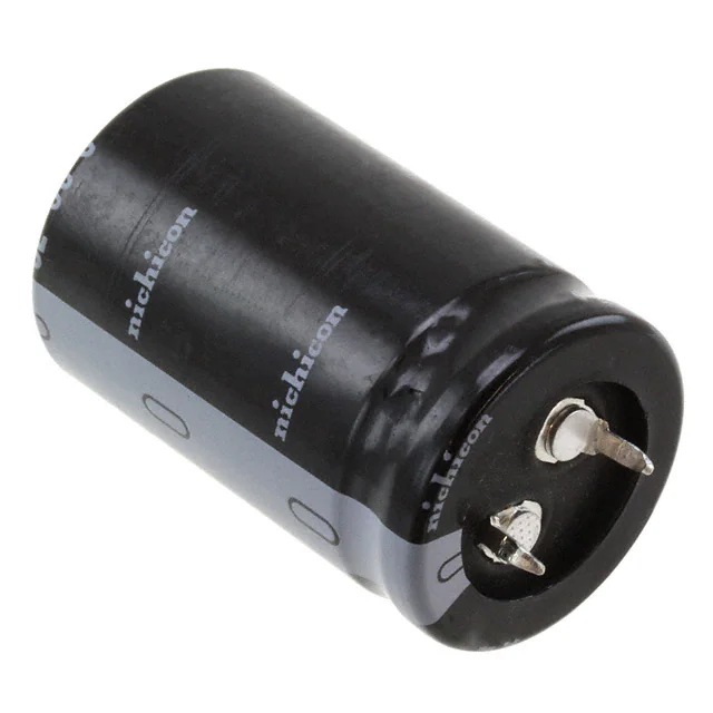

LLS2E681MELA
LLS2E681MELA
    NICHICON(尼吉康)
    插件,D25xL40mm
LLS2E681MELA 数据手册
ALUMINUM ELECTROLYTIC CAPACITORS LLS Snap-in Terminal Type, 85°C Standard Withstanding 3000 hours application of rated ripple current at 85°C. Compliant to the RoHS directive (2011/65/EU,(EU)2015/863). LLS Smaller LLG Specifications Item Performance Characteristics Category Temperature Range – 40 to +85°C (16 to 250V), – 25 to +85°C (350 to 450V) Rated Voltage Range 16 to 450V Rated Capacitance Range 56 to 56000µF Capacitance Tolerance ± 20% 3 CVat 120Hz, 20°C Leakage Current I 3 CV (µA) (After 5 minutes' application of rated voltage) [C : Rated Capacitance (µF) V : Voltage (V)] 3 CV 16 0.50 Rated voltage (V) tan δ (MAX.) Tangent of loss angle (tan δ) 25 0.40 35 0.35 50 0.30 63 0.25 80 0.20 100 0.20 160 0.15 Measurement frequency :120Hz at 20°C 200 250 350 400 450 0.15 0.15 0.15 0.15 0.20 180 0.15 Measurement frequency : 120Hz Rated voltage (V) Stability at Low Temperature Impedance ratio ZT/Z20(MAX.) Z – 25°C/ Z+20°C 16 to 100 4 160 to 250 3 350 to 450 8 Z – 40°C/ Z+20°C 20 12 — Endurance The specifications listed at right shall be met when the capacitors are restored to 20°C after D.C. bias plus rated ripple current is applied for 3000 hours at 85°C, the peak voltage shall not exceed the rated voltage. Capacitance change tan δ Leakage current Within ±20% of the initial capacitance value 200% or less than the initial specified value Less than or equal to the initial specified value Shelf Life After storing the capacitors under no load at 85°C for 1000 hours and then performing voltage treatment based on JIS C 5101-4 clause 4.1 at 20°C, they shall meet the requirements listed at right. Capacitance change tan δ Leakage current Within ±15% of the initial capacitance value 150% or less than the initial specified value Less than or equal to the initial specified value Marking Printed with white color letter on black sleeve. Drawing Type numbering system ( Example : 200V 390µF) 1 Polarity bar 2 3 4 5 6 7 8 9 10 11 12 L L S 2 D 3 9 1 ME L Z Sleeve (P.E.T.) φ D +1.5MAX. Case dia.code Configuration Capacitance tolerance(±20%) L±2 4.0±0.5 (1 0) Rated capacitance(390μF) Rated voltage(200V) Pressure relief vent Series name 0.8 +0.2 -0.1 (2.5) 4.0±0.5 10 ±0 .1 .2 +0 .1 0.8 -0 φD 20 22 25 30 35 Code Y Z A B C Type 1.5 +0.2 -0.1 2-2φ ±0.1 (PC board hole dimensions) (Terminal dimensions) Other terminations available upon request. Please refer to the Guidelines for Aluminum Electrolytic Capacitors. Coeff. Frequency coefficient of rated ripple current Frequency (Hz) 16 to 100V 160 to 250V 350 to 450V 50 0.88 0.81 0.77 60 0.90 0.85 0.82 120 1.00 1.00 1.00 300 1.07 1.17 1.16 1k 1.15 1.32 1.30 10k 1.15 1.45 1.41 50k or more 1.15 1.50 1.43 Minimum order quantity : 50pcs. Dimension table in next page. CAT.8100K ALUMINUM ELECTROLYTIC CAPACITORS LLS Dimensions 25V (1E) 16V (1C) Cap. (µF) 8200 10000 12000 15000 18000 22000 27000 33000 39000 47000 56000 Size φD × L(mm) 22 × 25 22 × 30 22 × 30 25 × 25 22 × 35 25 × 30 30 × 25 22 × 40 25 × 35 30 × 30 22 × 50 25 × 40 30 × 30 25 × 45 30 × 35 35 × 30 25 × 50 30 × 40 35 × 30 30 × 45 35 × 35 30 × 50 35 × 40 35 × 45 Rated ripple (mArms) 2560 2890 3130 3010 3690 3640 3730 3980 3980 3880 4520 4440 4380 4980 4950 4820 5490 5600 5460 6210 6120 6930 6890 7690 Leakage Current Code 1.08 1.20 1.31 1.31 1.46 1.46 1.46 1.60 1.60 1.60 1.77 1.77 1.77 1.97 1.97 1.97 2.17 2.17 2.17 2.36 2.36 2.60 2.60 2.83 LLS1C822MELZ LLS1C103MELZ LLS1C123MELZ LLS1C123MELA LLS1C153MELZ LLS1C153MELA LLS1C153MELB LLS1C183MELZ LLS1C183MELA LLS1C183MELB LLS1C223MELZ LLS1C223MELA LLS1C223MELB LLS1C273MELA LLS1C273MELB LLS1C273MELC LLS1C333MELA LLS1C333MELB LLS1C333MELC LLS1C393MELB LLS1C393MELC LLS1C473MELB LLS1C473MELC LLS1C563MELC Leakage Current Code 1.10 1.21 1.21 1.32 1.32 1.46 1.46 1.46 1.60 1.60 1.60 1.77 1.77 1.77 1.94 1.94 1.94 2.17 2.17 2.17 2.38 2.38 2.63 2.91 LLS1V392MELZ LLS1V472MELZ LLS1V472MELA LLS1V562MELZ LLS1V562MELA LLS1V682MELZ LLS1V682MELA LLS1V682MELB LLS1V822MELZ LLS1V822MELA LLS1V822MELB LLS1V103MELZ LLS1V103MELA LLS1V103MELB LLS1V123MELA LLS1V123MELB LLS1V123MELC LLS1V153MELA LLS1V153MELB LLS1V153MELC LLS1V183MELB LLS1V183MELC LLS1V223MELC LLS1V273MELC (mA) Cap. (µF) 5600 6800 8200 10000 12000 15000 18000 22000 27000 33000 39000 Size φD × L(mm) 22 × 25 22 × 30 25 × 25 22 × 35 25 × 25 22 × 35 25 × 30 22 × 40 25 × 35 30 × 25 22 × 50 25 × 40 30 × 30 25 × 45 30 × 35 35 × 30 25 × 50 30 × 40 35 × 35 30 × 45 35 × 40 35 × 45 35 × 50 35V (1V) Cap. (µF) 3900 4700 5600 6800 8200 10000 12000 15000 18000 22000 27000 Size φD × L(mm) 22 × 25 22 × 30 25 × 25 22 × 35 25 × 30 22 × 40 25 × 30 30 × 25 22 × 45 25 × 35 30 × 30 22 × 50 25 × 40 30 × 30 25 × 45 30 × 35 35 × 30 25 × 50 30 × 40 35 × 35 30 × 45 35 × 40 35 × 45 35 × 50 Rated ripple (mArms) 2220 2460 2430 2790 2750 2970 2890 3090 3470 3330 3290 3750 3650 3610 4150 4140 4270 4800 4800 4950 5300 5710 6380 6900 Rated ripple (mArms) 2310 2560 2470 2860 2780 3310 3160 3770 3630 3800 4210 4100 4000 4680 4660 4680 5190 5330 5260 6020 6020 6750 7560 Leakage Current Code 1.12 1.23 1.23 1.35 1.35 1.50 1.50 1.64 1.64 1.64 1.83 1.83 1.83 2.01 2.01 2.01 2.22 2.22 2.22 2.46 2.46 2.72 2.96 LLS1E562MELZ LLS1E682MELZ LLS1E682MELA LLS1E822MELZ LLS1E822MELA LLS1E103MELZ LLS1E103MELA LLS1E123MELZ LLS1E123MELA LLS1E123MELB LLS1E153MELZ LLS1E153MELA LLS1E153MELB LLS1E183MELA LLS1E183MELB LLS1E183MELC LLS1E223MELA LLS1E223MELB LLS1E223MELC LLS1E273MELB LLS1E273MELC LLS1E333MELC LLS1E393MELC Leakage Current Code 0.99 1.10 1.21 1.21 1.32 1.32 1.45 1.45 1.45 1.58 1.58 1.58 1.74 1.74 1.74 1.92 1.92 1.92 2.12 2.12 2.32 2.32 2.59 2.84 LLS1H222MELZ LLS1H272MELZ LLS1H332MELZ LLS1H332MELA LLS1H392MELZ LLS1H392MELA LLS1H472MELZ LLS1H472MELA LLS1H472MELB LLS1H562MELZ LLS1H562MELA LLS1H562MELB LLS1H682MELZ LLS1H682MELA LLS1H682MELB LLS1H822MELA LLS1H822MELB LLS1H822MELC LLS1H103MELB LLS1H103MELC LLS1H123MELB LLS1H123MELC LLS1H153MELC LLS1H183MELC (mA) 50V (1H) (mA) Cap. (µF) 2200 2700 3300 3900 4700 5600 6800 8200 10000 12000 15000 18000 Size φD × L(mm) 22 × 25 22 × 30 22 × 30 25 × 25 22 × 35 25 × 30 22 × 40 25 × 30 30 × 25 22 × 45 25 × 35 30 × 30 22 × 50 25 × 40 30 × 35 25 × 45 30 × 35 35 × 30 30 × 40 35 × 35 30 × 50 35 × 40 35 × 45 35 × 50 Rated ripple (mArms) 1930 2210 2410 2380 2720 2680 3020 3070 3010 3430 3470 3430 3940 3870 3930 4440 4470 4410 5080 4920 5720 5690 6560 7140 (mA) Rated ripple current (mArms) at 85°C 120Hz CAT.8100K ALUMINUM ELECTROLYTIC CAPACITORS LLS Dimensions 80V (1K) 63V (1J) Cap. (µF) 1800 2200 2700 3300 3900 4700 5600 6800 8200 10000 12000 Size φD × L(mm) 22 × 25 22 × 30 25 × 25 22 × 35 25 × 30 22 × 35 25 × 30 30 × 25 22 × 40 25 × 35 30 × 30 22 × 50 25 × 40 30 × 30 25 × 45 30 × 35 35 × 30 25 × 50 30 × 40 35 × 30 30 × 45 35 × 35 30 × 50 35 × 40 35 × 45 Rated ripple (mArms) 1900 2350 2300 2500 2520 2720 2740 2840 3090 3130 3090 3690 3590 3540 4010 4000 3750 4520 4550 4440 5120 5050 5780 5750 6470 Leakage Current Code 1.01 1.11 1.11 1.23 1.23 1.36 1.36 1.36 1.48 1.48 1.48 1.63 1.63 1.63 1.78 1.78 1.78 1.96 1.96 1.96 2.15 2.15 2.38 2.38 2.60 LLS1J182MELZ LLS1J222MELZ LLS1J222MELA LLS1J272MELZ LLS1J272MELA LLS1J332MELZ LLS1J332MELA LLS1J332MELB LLS1J392MELZ LLS1J392MELA LLS1J392MELB LLS1J472MELZ LLS1J472MELA LLS1J472MELB LLS1J562MELA LLS1J562MELB LLS1J562MELC LLS1J682MELA LLS1J682MELB LLS1J682MELC LLS1J822MELB LLS1J822MELC LLS1J103MELB LLS1J103MELC LLS1J123MELC (mA) Cap. (µF) 1200 1500 1800 2200 2700 3300 3900 4700 5600 6800 8200 10000 Size φD × L(mm) 22 × 25 22 × 30 22 × 30 25 × 25 22 × 35 25 × 30 30 × 25 22 × 40 25 × 35 30 × 30 22 × 45 25 × 40 30 × 30 22 × 50 25 × 45 30 × 35 25 × 50 30 × 40 35 × 30 30 × 45 35 × 35 30 × 50 35 × 40 35 × 45 35 × 50 Rated ripple (mArms) 1770 2010 2110 2260 2530 2530 2560 2930 2930 2910 3230 3290 3250 3620 3710 3700 4280 4230 4120 4700 4640 5270 5240 5890 6630 Leakage Current Code 0.92 1.03 1.13 1.13 1.25 1.25 1.25 1.39 1.39 1.39 1.54 1.54 1.54 1.67 1.67 1.67 1.83 1.83 1.83 2.00 2.00 2.21 2.21 2.42 2.68 LLS1K122MELZ LLS1K152MELZ LLS1K182MELZ LLS1K182MELA LLS1K222MELZ LLS1K222MELA LLS1K222MELB LLS1K272MELZ LLS1K272MELA LLS1K272MELB LLS1K332MELZ LLS1K332MELA LLS1K332MELB LLS1K392MELZ LLS1K392MELA LLS1K392MELB LLS1K472MELA LLS1K472MELB LLS1K472MELC LLS1K562MELB LLS1K562MELC LLS1K682MELB LLS1K682MELC LLS1K822MELC LLS1K103MELC (mA) 100V (2A) Cap. (µF) 820 1000 1200 1500 1800 2200 2700 3300 3900 4700 5600 6800 Size φD × L(mm) 22 × 25 22 × 30 22 × 30 25 × 25 22 × 35 25 × 30 30 × 25 22 × 40 25 × 35 30 × 25 22 × 45 25 × 40 30 × 30 25 × 45 30 × 35 35 × 30 25 × 50 30 × 40 35 × 35 30 × 45 35 × 35 30 × 50 35 × 40 35 × 45 35 × 50 Rated ripple (mArms) 1860 2020 2120 2110 2450 2470 2560 2770 2810 2650 3150 3210 3170 3660 3650 3770 4150 4180 4070 4670 4610 5260 5230 5880 6010 Leakage Current Code 0.85 0.94 1.03 1.03 1.16 1.16 1.16 1.27 1.27 1.27 1.40 1.40 1.40 1.55 1.55 1.55 1.72 1.72 1.72 1.87 1.87 2.05 2.05 2.24 2.47 LLS2A821MELZ LLS2A102MELZ LLS2A122MELZ LLS2A122MELA LLS2A152MELZ LLS2A152MELA LLS2A152MELB LLS2A182MELZ LLS2A182MELA LLS2A182MELB LLS2A222MELZ LLS2A222MELA LLS2A222MELB LLS2A272MELA LLS2A272MELB LLS2A272MELC LLS2A332MELA LLS2A332MELB LLS2A332MELC LLS2A392MELB LLS2A392MELC LLS2A472MELB LLS2A472MELC LLS2A562MELC LLS2A682MELC (mA) Rated ripple current (mArms) at 85°C 120Hz CAT.8100K ALUMINUM ELECTROLYTIC CAPACITORS LLS Dimensions 180V (2Z) 160V (2C) Cap. (µF) 270 330 390 470 560 680 820 1000 1200 1500 1800 2200 2700 Size φD × L(mm) 20 × 25 20 × 25 20 × 30 22 × 25 20 × 30 22 × 30 25 × 25 20 × 35 22 × 30 25 × 25 20 × 40 22 × 35 25 × 30 30 × 25 22 × 40 25 × 30 30 × 25 22 × 45 25 × 35 30 × 30 25 × 40 30 × 30 35 × 25 25 × 50 30 × 35 35 × 30 30 × 40 35 × 35 30 × 50 35 × 40 35 × 45 Rated ripple (mArms) 1280 1550 1630 1630 1900 1860 1860 2140 2150 2150 2350 2350 2330 2330 2680 2650 2640 3020 3000 2960 3430 3410 3400 3960 3960 3940 4310 4280 4960 4960 5570 Leakage Current Code 0.62 0.68 0.74 0.74 0.82 0.82 0.82 0.89 0.89 0.89 0.98 0.98 0.98 0.98 1.08 1.08 1.08 1.20 1.20 1.20 1.31 1.31 1.31 1.46 1.46 1.46 1.60 1.60 1.77 1.77 1.97 LLS2C271MELY LLS2C331MELY LLS2C391MELY LLS2C391MELZ LLS2C471MELY LLS2C471MELZ LLS2C471MELA LLS2C561MELY LLS2C561MELZ LLS2C561MELA LLS2C681MELY LLS2C681MELZ LLS2C681MELA LLS2C681MELB LLS2C821MELZ LLS2C821MELA LLS2C821MELB LLS2C102MELZ LLS2C102MELA LLS2C102MELB LLS2C122MELA LLS2C122MELB LLS2C122MELC LLS2C152MELA LLS2C152MELB LLS2C152MELC LLS2C182MELB LLS2C182MELC LLS2C222MELB LLS2C222MELC LLS2C272MELC Leakage Current Code 0.62 0.69 0.69 0.77 0.77 0.83 0.83 0.83 0.91 0.91 0.91 1.00 1.00 1.00 1.00 1.10 1.10 1.10 1.21 1.21 1.21 1.34 1.34 1.34 1.46 1.46 1.64 1.64 1.80 1.80 1.98 LLS2D221MELY LLS2D271MELY LLS2D271MELZ LLS2D331MELY LLS2D331MELZ LLS2D391MELY LLS2D391MELZ LLS2D391MELA LLS2D471MELY LLS2D471MELZ LLS2D471MELA LLS2D561MELY LLS2D561MELZ LLS2D561MELA LLS2D561MELB LLS2D681MELZ LLS2D681MELA LLS2D681MELB LLS2D821MELZ LLS2D821MELA LLS2D821MELB LLS2D102MELZ LLS2D102MELA LLS2D102MELB LLS2D122MELB LLS2D122MELC LLS2D152MELB LLS2D152MELC LLS2D182MELB LLS2D182MELC LLS2D222MELC (mA) Cap. (µF) 270 330 390 470 560 680 820 1000 1200 1500 1800 2200 2700 Size φD × L(mm) 20 × 25 20 × 30 22 × 25 20 × 30 22 × 25 20 × 35 22 × 30 25 × 25 20 × 40 22 × 35 25 × 25 22 × 35 25 × 30 30 × 25 22 × 40 25 × 35 30 × 25 22 × 50 25 × 40 30 × 30 25 × 45 30 × 35 35 × 30 30 × 40 35 × 35 30 × 45 35 × 35 35 × 40 35 × 50 200V (2D) Cap. (µF) 220 270 330 390 470 560 680 820 1000 1200 1500 1800 2200 Size φD × L(mm) 20 × 25 20 × 25 22 × 25 20 × 30 22 × 25 20 × 35 22 × 30 25 × 25 20 × 35 22 × 30 25 × 25 20 × 40 22 × 35 25 × 30 30 × 25 22 × 40 25 × 30 30 × 25 22 × 45 25 × 35 30 × 30 22 × 50 25 × 40 30 × 35 30 × 35 35 × 30 30 × 45 35 × 35 30 × 50 35 × 40 35 × 45 Rated ripple (mArms) 1190 1390 1370 1560 1510 1740 1730 1710 2030 1970 1950 2180 2180 2150 2150 2480 2480 2480 2810 2790 2800 3280 3280 3150 3610 3570 4130 4060 4600 4590 5250 Rated ripple (mArms) 1290 1770 1770 1840 1840 1910 1910 2080 2150 2250 2150 2480 2500 2460 2860 2750 2690 3100 3060 3100 3630 3550 3490 4100 4020 4550 4540 4830 5300 Leakage Current Code 0.66 0.73 0.73 0.79 0.79 0.87 0.87 0.87 0.95 0.95 0.95 1.04 1.04 1.04 1.15 1.15 1.15 1.27 1.27 1.27 1.39 1.39 1.39 1.55 1.55 1.70 1.70 1.88 2.09 LLS2Z271MELY LLS2Z331MELY LLS2Z331MELZ LLS2Z391MELY LLS2Z391MELZ LLS2Z471MELY LLS2Z471MELZ LLS2Z471MELA LLS2Z561MELY LLS2Z561MELZ LLS2Z561MELA LLS2Z681MELZ LLS2Z681MELA LLS2Z681MELB LLS2Z821MELZ LLS2Z821MELA LLS2Z821MELB LLS2Z102MELZ LLS2Z102MELA LLS2Z102MELB LLS2Z122MELA LLS2Z122MELB LLS2Z122MELC LLS2Z152MELB LLS2Z152MELC LLS2Z182MELB LLS2Z182MELC LLS2Z222MELC LLS2Z272MELC Leakage Current Code 0.63 0.70 0.70 0.77 0.77 0.86 0.86 0.86 0.93 0.93 0.93 1.02 1.02 1.02 1.12 1.12 1.12 1.23 1.23 1.35 1.35 1.35 1.50 1.50 1.64 1.64 1.83 2.01 LLS2E181MELY LLS2E221MELY LLS2E221MELZ LLS2E271MELY LLS2E271MELZ LLS2E331MELY LLS2E331MELZ LLS2E331MELA LLS2E391MELY LLS2E391MELZ LLS2E391MELA LLS2E471MELZ LLS2E471MELA LLS2E471MELB LLS2E561MELZ LLS2E561MELA LLS2E561MELB LLS2E681MELA LLS2E681MELB LLS2E821MELA LLS2E821MELB LLS2E821MELC LLS2E102MELB LLS2E102MELC LLS2E122MELB LLS2E122MELC LLS2E152MELC LLS2E182MELC (mA) 250V (2E) (mA) Cap. (µF) 180 220 270 330 390 470 560 680 820 1000 1200 1500 1800 Size φD × L(mm) 20 × 25 20 × 25 22 × 25 20 × 30 22 × 25 20 × 35 22 × 30 25 × 25 20 × 40 22 × 35 25 × 30 22 × 35 25 × 35 30 × 25 22 × 40 25 × 35 30 × 25 25 × 40 30 × 30 25 × 45 30 × 35 35 × 30 30 × 40 35 × 35 30 × 45 35 × 35 35 × 40 35 × 50 Rated ripple (mArms) 1200 1260 1240 1420 1500 1680 1660 1610 1920 1880 1880 2150 2150 2040 2480 2350 2350 2670 2710 3010 2980 2960 3560 3480 3990 3840 4330 4540 (mA) Rated ripple current (mArms) at 85°C 120Hz CAT.8100K ALUMINUM ELECTROLYTIC CAPACITORS LLS Dimensions 350V (2V) Cap. (µF) 120 150 180 220 270 330 390 470 560 680 820 1000 Size φD × L(mm) 20 × 30 22 × 25 20 × 30 22 × 30 25 × 25 20 × 35 22 × 30 25 × 25 22 × 35 25 × 30 30 × 25 22 × 40 25 × 35 30 × 25 22 × 45 25 × 35 30 × 30 25 × 40 30 × 35 35 × 30 25 × 50 30 × 35 35 × 30 30 × 40 35 × 35 30 × 50 35 × 40 35 × 45 35 × 50 Rated ripple (mArms) 0960 1040 1100 1200 1220 1240 1340 1370 1470 1530 1540 1700 1730 1800 1870 1970 2030 2140 2230 2300 2550 2530 2550 2730 2750 3150 3150 3470 3600 400V (2G) Leakage Current Code 0.61 0.61 0.68 0.68 0.68 0.75 0.75 0.75 0.83 0.83 0.83 0.92 0.92 0.92 1.01 1.01 1.01 1.10 1.10 1.10 1.21 1.21 1.21 1.32 1.32 1.46 1.46 1.60 1.77 LLS2V121MELY LLS2V121MELZ LLS2V151MELY LLS2V151MELZ LLS2V151MELA LLS2V181MELY LLS2V181MELZ LLS2V181MELA LLS2V221MELZ LLS2V221MELA LLS2V221MELB LLS2V271MELZ LLS2V271MELA LLS2V271MELB LLS2V331MELZ LLS2V331MELA LLS2V331MELB LLS2V391MELA LLS2V391MELB LLS2V391MELC LLS2V471MELA LLS2V471MELB LLS2V471MELC LLS2V561MELB LLS2V561MELC LLS2V681MELB LLS2V681MELC LLS2V821MELC LLS2V102MELC Leakage Current Code 0.47 0.52 0.52 0.57 0.57 0.63 0.63 0.63 0.69 0.69 0.69 0.69 0.77 0.77 0.77 0.85 0.85 0.85 0.94 0.94 0.94 1.04 1.04 1.15 1.15 1.25 1.25 1.37 1.50 LLS2W560MELY LLS2W680MELY LLS2W680MELZ LLS2W820MELY LLS2W820MELZ LLS2W101MELY LLS2W101MELZ LLS2W101MELA LLS2W121MELY LLS2W121MELZ LLS2W121MELA LLS2W121MELB LLS2W151MELZ LLS2W151MELA LLS2W151MELB LLS2W181MELZ LLS2W181MELA LLS2W181MELB LLS2W221MELA LLS2W221MELB LLS2W221MELC LLS2W271MELB LLS2W271MELC LLS2W331MELB LLS2W331MELC LLS2W391MELB LLS2W391MELC LLS2W471MELC LLS2W561MELC (mA) Cap. (µF) 68 82 100 120 150 180 220 270 330 390 470 560 680 Size φD × L(mm) 20 × 25 20 × 30 22 × 25 20 × 30 22 × 25 20 × 35 22 × 30 25 × 25 20 × 40 22 × 35 25 × 30 22 × 40 25 × 30 30 × 25 22 × 45 25 × 35 30 × 30 25 × 40 30 × 30 25 × 45 30 × 35 35 × 30 30 × 40 35 × 35 30 × 45 35 × 35 30 × 50 35 × 40 35 × 50 Rated ripple (mArms) 0750 0820 0840 0950 0950 1070 1090 1130 1220 1240 1270 1410 1440 1520 1580 1640 1660 1790 1820 2000 2050 2050 2260 2280 2510 2510 2850 2850 3100 Leakage Current Code 0.49 0.54 0.54 0.60 0.60 0.65 0.65 0.65 0.73 0.73 0.73 0.80 0.80 0.80 0.88 0.88 0.88 0.98 0.98 1.08 1.08 1.08 1.18 1.18 1.30 1.30 1.41 1.41 1.56 LLS2G680MELY LLS2G820MELY LLS2G820MELZ LLS2G101MELY LLS2G101MELZ LLS2G121MELY LLS2G121MELZ LLS2G121MELA LLS2G151MELY LLS2G151MELZ LLS2G151MELA LLS2G181MELZ LLS2G181MELA LLS2G181MELB LLS2G221MELZ LLS2G221MELA LLS2G221MELB LLS2G271MELA LLS2G271MELB LLS2G331MELA LLS2G331MELB LLS2G331MELC LLS2G391MELB LLS2G391MELC LLS2G471MELB LLS2G471MELC LLS2G561MELB LLS2G561MELC LLS2G681MELC (mA) 450V (2W) Cap. (µF) 56 68 82 100 120 150 180 220 270 330 390 470 560 Size φD × L(mm) 20 × 25 20 × 30 22 × 25 20 × 35 22 × 25 20 × 35 22 × 30 25 × 25 20 × 40 22 × 35 25 × 30 30 × 25 22 × 40 25 × 30 30 × 25 22 × 45 25 × 35 30 × 30 25 × 40 30 × 30 35 × 25 30 × 35 35 × 30 30 × 40 35 × 35 30 × 45 35 × 40 35 × 45 35 × 50 Rated ripple (mArms) 0610 0710 0710 0800 0860 0880 0950 0970 0990 1070 1090 1120 1180 1250 1290 1320 1400 1450 1590 1640 1590 1890 1900 2120 2150 2350 2380 2680 2880 (mA) Rated ripple current (mArms) at 85°C 120Hz CAT.8100K
LLS2E681MELA
物料型号: 该文档描述的是michicon品牌的LLS系列铝电解电容器。
器件简介: LLS系列电容器是符合85°C标准的产品,具有较小的体积,并且符合RoHS指令。
引脚分配: 文档中提到了电容器的安装类型为插针式,但没有具体说明引脚分配
参数特性: - 工作温度范围:-40至+85°C(16至250V),-25至+85°C(350至450V) - 额定电压范围:16至450V - 额定电容范围:56至56000微法拉 - 电容公差:在120Hz、20°C时为±20% - 漏电流:根据公式I ≤ 3.0CµA(V) - 损耗角正切(tan δ):在20°C、120Hz时,不同电压下的tan δ最大值不同
功能详解: - 耐久性:在85°C下,电容器在施加额定纹波电流和直流偏压3000小时后,应满足规定的规格。 - 储存寿命:在85°C下无负载储存1000小时后,应满足规定的规格。
应用信息: 文档中提到电容器能够承受在85°C下3000小时的额定纹波电流应用。
封装信息: 提供了详细的尺寸和型号编码系统,以及电容器的物理尺寸和额定纹波电流。
