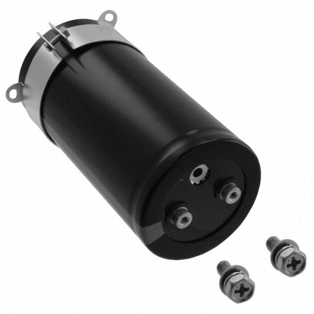

    3300 µF 450 V 铝电解电容器 径向,Can - 螺丝端子 85°C 时为 5000 小时
LNK2W332MSEH 数据手册
ALUMINUM ELECTROLYTIC CAPACITORS LNK Screw Terminal Type, 85°C Smaller-sized Load life 5000 hours application of ripple current at 85°C. Compliant to the RoHS directive (2011/65/EU,(EU)2015/863). LNX Smaller LNK Specifications Item Performance Characteristics Category Temperature Range Rated Voltage Range Rated Capacitance Range – 25 to +85°C Capacitance Tolerance ± 20% at 120Hz, 20°C Leakage Current After 5 minutes' application of rated voltage, leakage current is not more than 3 CV (µA) or 5 mA, whichever is smaller (at 20°C). [C : Rated Capacitance(µF), V : Voltage ( V ) ] Tangent of loss angle (tan δ) See refer to next page (Measurement frequency : 120Hz at 20°C) 350 to 500V 1000 to 18000µF 3 CV Rated voltage (V) Stability at Low Temperature 3 CV Measurement frequency : 120Hz 350 to 500 Z(–25°C) / Z(+20°C) 8 Impedance ratio (max.) Insulation Resistance Voltage proof The insulation resistance shall be more than 100MΩ at DC 500V application between terminal and bracket. There is no abnormality during AC 2500V 1 minute's application between terminal and bracket. Endurance The specifications listed at right shall be met when the capacitors are restored to 20°C after D.C. bias plus rated ripple current is applied for 5000 hours at 85°C, the peak voltage shall not exceed the rated voltage. Capacitance change tan δ Leakage current Within ±20% of the initial capacitance value 300% or less than the initial specified value Less than or equal to the initial specified value After storing the capacitors under no load at 85°C for 1000 hours and then performing voltage treatment based on JIS C 5101-4 clause 4.1 at 20°C, they shall meet the specified value for endurance characteristics listed at right. Capacitance change Shelf Life Within ±20% of the initial capacitance value 300% or less than the initial specified value Less than or equal to the initial specified value Marking Printed with white color letter on black sleeve. tan δ Leakage current Screw terminal types for φ 51 and larger Drawing Bottom plate Hexagenal headed bolt Sleeve 0° 12 Type numbering system (Example : 400V 10000µF) 1 2 3 4 5 6 7 8 9 10 11 12 13 14 L N K 2 G 1 0 3 M S E J Mounting bracket D+2max. W±1 Pressure relief vent S L+ max. T P±2 B U A±2 ±1 U S P T B 3-leg brackets for φ90 capacitors have different hole shapes from the ordinary ones illustrated below. P A±2 h H±1 Configuration 5 Cr(Ⅲ) Plating (RoHS compliant) SE 7 Please refer to the Guidelines for Aluminum Electrolytic Capacitors for dimensions information. Please contact to us if PVCless products are required. Pressure relief vent Note) The brackets will be supplied in the separate box. 30° • Flame-retardant type electrolyte is also available. Please contact to Nichicon representative for the rated ripple current value. Dimension of terminal pitch (W) and length (R) and Nominal dia.of bolt φD 51 63.5 76.2 90 W 22.0 28.6 31.8 31.8 α 3 3 3 3 R 6 6 6 6 (mm) M5 M5 M5 M5 Frequency coefficient of rated ripple current Frequency (Hz) Coefficient 50 0.80 60 0.82 120 1.00 360 1.20 Dimensions of mounting bracket 1k 1.35 10k or more 1.40 φD Symbol P A T S U ° H h (mm) 3­--Leg Leg shape Nominal dia. of bolt 51 32.5 38.5 7.5 5.0 12 60 20 15 63.5 38.1 43 8.0 5.0 14 60 25 20 76.2 44.5 49.2 7.0 5.0 14 60 30 24 2­--Leg 90 50.8 58.5 8.0 5.0 18 60 35 25 51 33.2 40 6.0 4.5 14 30 25 15 63.5 40.5 46.5 7.0 4.5 14 30 35 20 76.2 46.5 53 6.0 4.5 14 30 35 20 90 53 59 6.0 4.5 14 30 35 20 Dimension table in next page. CAT.8100L ALUMINUM ELECTROLYTIC CAPACITORS LNK Dimensions Cap. (µF) 1000 350V (2V) Size Rated ripple tan δ φD × L(mm) (Arms) 51 × 60 4.8 0.20 400V (2G) Size Rated ripple tan δ φD × L(mm) (Arms) 51 × 65 5.0 0.20 1.77 LNK2V102MSEF Cap. (µF) 1000 1.89 LNK2G102MSEF 1200 51 × 70 5.5 0.20 1.94 LNK2V122MSEF 1200 51 × 75 5.8 0.20 2.07 LNK2G122MSEF 1500 51 × 75 6.5 0.20 2.17 LNK2V152MSEF 1500 51 × 90 6.8 0.20 2.32 LNK2G152MSEF 1800 51 × 90 7.3 0.20 2.38 LNK2V182MSEF 1800 51 × 95 7.3 0.20 2.54 LNK2G182MSEF 2200 51 × 95 8.2 0.20 2.63 LNK2V222MSEF 51 × 105 8.8 0.20 2.81 LNK2G222MSEF 51 × 105 9.3 0.20 2.91 LNK2V272MSEF 8.9 0.20 2.81 LNK2G222MSEG 63.5 × 85 9.9 0.20 2.91 LNK2V272MSEG 10.2 0.20 3.11 LNK2G272MSEF 63.5 × 95 11.8 0.20 3.22 LNK2V332MSEG 63.5 × 90 10.8 0.20 3.11 LNK2G272MSEG 63.5 × 100 12.8 0.20 3.50 LNK2V392MSEG 76.2 × 75 10.6 0.20 3.11 LNK2G272MSEH 76.2 × 85 13.0 0.20 3.50 LNK2V392MSEH 63.5 × 95 11.8 0.20 3.44 LNK2G332MSEG 63.5 × 115 13.8 0.20 3.84 LNK2V472MSEG 76.2 × 90 12.0 0.20 3.44 LNK2G332MSEH 76.2 × 90 14.2 0.20 3.84 LNK2V472MSEH 63.5 × 115 12.8 0.20 3.74 LNK2G392MSEG 63.5 × 130 17.3 0.20 4.20 LNK2V562MSEG 76.2 × 95 13.0 0.20 3.74 LNK2G392MSEH 76.2 × 100 16.8 0.20 4.20 LNK2V562MSEH 63.5 × 130 14.8 0.20 4.11 LNK2G472MSEG 63.5 × 155 19.6 0.20 4.62 LNK2V682MSEG 76.2 × 110 15.0 0.20 4.11 LNK2G472MSEH 76.2 × 115 19.0 0.20 4.62 LNK2V682MSEH 63.5 × 155 17.0 0.20 4.48 LNK2G562MSEG 63.5 × 190 22.6 0.20 5.00 LNK2V822MSEG 76.2 × 115 16.5 0.20 4.48 LNK2G562MSEH 76.2 × 130 21.0 0.20 5.00 LNK2V822MSEH 63.5 × 190 20.6 0.20 4.94 LNK2G682MSEG 90 × 120 24.0 0.20 5.00 LNK2V822MSEJ 76.2 × 130 19.2 0.20 4.94 LNK2G682MSEH 76.2 × 155 25.1 0.20 5.00 LNK2V103MSEH 90 × 120 20.7 0.20 4.94 LNK2G682MSEJ 90 × 140 25.9 0.20 5.00 LNK2V103MSEJ 76.2 × 155 22.7 0.20 5.00 LNK2G822MSEH 90 × 150 28.4 0.20 5.00 LNK2V123MSEJ 90 × 120 22.9 0.20 5.00 LNK2G822MSEJ 76.2 × 170 26.2 0.20 5.00 LNK2G103MSEH 90 × 130 24.2 0.20 5.00 LNK2G103MSEJ 12000 90 × 155 28.5 0.20 5.00 LNK2G123MSEJ 15000 90 × 190 34.8 0.20 5.00 LNK2G153MSEJ 18000 90 × 235 41.2 0.20 5.00 LNK2G183MSEJ 2700 3300 3900 4700 5600 6800 8200 10000 12000 Leakage Current (mA) Code 2200 51 × 115 2700 3300 3900 4700 5600 6800 8200 10000 Cap. (µF) 1000 450V (2W) Size Rated ripple tan δ φD × L(mm) (Arms) 51 × 75 5.2 0.20 Leakage Current (mA) Code 2.01 LNK2W102MSEF 1200 51 × 85 6.3 0.20 2.20 LNK2W122MSEF 1500 51 × 95 6.4 0.20 2.46 LNK2W152MSEF 51 × 105 7.6 0.20 2.70 LNK2W182MSEF 63.5 × 85 7.6 0.20 2.70 LNK2W182MSEG 63.5 × 90 9.0 0.20 2.98 LNK2W222MSEG 76.2 × 85 9.4 0.20 2.98 LNK2W222MSEH 63.5 × 95 10.5 0.20 3.30 76.2 × 90 11.0 0.20 63.5 × 115 12.1 76.2 × 100 63.5 × 85 Cap. (µF) 500V (2H) Size Rated ripple tan δ φD × L(mm) (Arms) 51 × 100 4.2 0.20 Leakage Current (mA) Leakage Current (mA) Code Code 2.12 LNK2H102MSEF 4.2 0.20 2.12 LNK2H102MSEG 6.2 0.20 2.32 LNK2H122MSEF 63.5 × 85 6.3 0.20 2.32 LNK2H122MSEG 51 × 130 7.3 0.20 2.59 LNK2H152MSEF 63.5 × 90 7.1 0.20 2.59 LNK2H152MSEG 1800 63.5 × 105 8.3 0.20 2.84 LNK2H182MSEG LNK2W272MSEG 2200 63.5 × 120 9.6 0.20 3.14 LNK2H222MSEG 3.30 LNK2W272MSEH 2700 76.2 × 110 10.7 0.20 3.48 LNK2H272MSEH 0.20 3.65 LNK2W332MSEG 3300 76.2 × 115 12.4 0.20 3.85 LNK2H332MSEH 12.9 0.20 3.65 LNK2W332MSEH 76.2 × 150 14.4 0.20 4.18 LNK2H392MSEH 76.2 × 110 14.2 0.20 3.97 LNK2W392MSEH 90 × 120 14.4 0.20 4.18 LNK2H392MSEJ 63.5 × 155 15.6 0.20 4.36 LNK2W472MSEG 76.2 × 170 16.5 0.20 4.59 LNK2H472MSEH 76.2 × 115 15.1 0.20 4.36 LNK2W472MSEH 90 × 130 15.8 0.20 4.59 LNK2H472MSEJ 63.5 × 190 18.7 0.20 4.76 LNK2W562MSEG 76.2 × 190 19.0 0.20 5.00 LNK2H562MSEH 90 × 120 18.6 0.20 4.76 LNK2W562MSEJ 90 × 150 18.6 0.20 5.00 LNK2H562MSEJ 76.2 × 155 20.7 0.20 5.00 LNK2W682MSEH 6800 90 × 170 21.2 0.20 5.00 LNK2H682MSEJ 90 × 125 20.0 0.20 5.00 LNK2W682MSEJ 8200 90 × 190 24.5 0.20 5.00 LNK2H822MSEJ 8200 76.2 × 190 19.1 0.20 5.00 LNK2W822MSEH 10000 90 × 235 29.3 0.20 5.00 LNK2H103MSEJ 12000 90 × 190 29.7 0.20 5.00 LNK2W123MSEJ 15000 90 × 235 35.9 0.20 5.00 LNK2W153MSEJ 1800 2200 2700 3300 3900 4700 5600 6800 1000 1200 1500 3900 4700 5600 63.5 × 80 51 × 115 Rated ripple current (Arms) at 85°C 120Hz CAT.8100L

物料型号:LNK系列
器件简介:这是nichicon公司生产的铝电解电容器,具有较小的尺寸和较高的耐温性能(85°C),适用于在85°C下有纹波电流的应用场合。符合RoHS指令。
引脚分配:文档中未明确指出引脚分配,但提到了六角头螺栓、底板套筒和压力释放阀等部件。
参数特性: - 工作温度范围:-25至+85°C - 额定电压范围:350至500V - 额定电容范围:1000至18000微法拉 - 电容公差:在120Hz、20°C时为20% - 漏电流:在额定电压下5分钟后,不超过3.0μF(CV)或5mA(以较小者为准) - 损耗角正切(tan δ):详见下一页(测量频率为20°C时的120Hz)
功能详解: - 低温稳定性:在-25°C时的阻抗比不超过8 - 绝缘电阻:在DC 500V下,端子与夹具之间的绝缘电阻应大于100MΩ - 耐压测试:在端子与夹具之间施加AC 2500V 1分钟无异常 - 耐久性:在85°C下施加直流偏置和额定纹波电流5000小时后,电容变化在初始值的+20%以内,tan δ不超过初始值的300%,漏电流不超过初始值
应用信息:适用于需要较小尺寸和高耐温性能的场合,如电源电路等。
封装信息:提供了详细的尺寸信息和安装支架的尺寸,以及端子间距和长度的规格。
