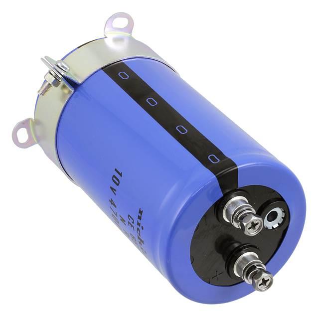

    470000 µF 10 V 铝电解电容器 径向,Can - 螺丝端子 85°C 时为 5000 小时
LNR1A474MSE 数据手册
ALUMINUM ELECTROLYTIC CAPACITORS NR Screw Terminal Type series Load life of 5000 hours application of rated ripple current at 85°C . Extended rarge up to φ100 × 250L size. Available for adapted to the RoHS directive (2002/95/EC). NT High Temperature High ripple, Longer life NX NR High Voltage NW Specifications Item Category Temperature Range Rated Voltage Range Rated Capacitance Range Capacitance Tolerance Leakage Current Performance Characteristics – 40 ~ +85°C (10~100V) , – 25 ~ +85°C (160~250V) 10 ~ 250V 1000 ~ 2200000µF ± 20% at 120Hz, 20°C After 5 minutes' application of rated voltage, leakage current is not more than 3 CV (µA) or 5 mA, whichever is smaller (at 20°C) . [C:Rated Capacitance (µF) , V:Voltage(V)] φD 35 51 L V 80 ~100 120 70 ~100 tan δ (MAX) 63.5 76.2 90 100 120~140 100 120~140 100 120~140 140~220 250 10 0.6 0.7 0.9 1.0 0.9 1.2 1.6 1.6 2.0 2.4 16 0.4 0.55 0.6 0.8 — 0.75 — 1.1 1.5 1.5 25 0.35 0.4 0.45 0.5 — 0.65 — 0.75 1.0 1.0 35 0.3 0.3 0.35 0.4 0.5 — 0.65 0.75 0.9 0.9 50 0.25 0.25 0.25 0.3 0.35 — — 0.55 0.75 0.75 63 0.25 0.25 0.25 0.25 0.3 0.3 — 0.5 0.6 0.6 80 0.2 0.2 0.2 0.2 0.25 0.3 — 0.35 0.4 0.4 100 0.12 0.15 0.15 0.15 — 0.2 — 0.3 0.3 0.3 160~250 0.15 0.15 0.15 0.15 0.2 0.2 0.2 0.2 0.25 0.25 Measurement frequency: 120Hz, Temperature : 20°C Measurement frequeny : 120Hz Stability at Low Temperature Rated voltage(V) Impedance ratio ZT/Z20(MAX.) 10~100 Z – 4 0 ° C / Z+20°C 12 Capacitance change tan δ Leakage current Capacitance change tan δ Leakage current 160~250 Z – 2 5° C / Z+20° C 8 Within ±15% of initial value 175% or less of initial specified value Initial specified value or less Within ±20% of initial value 175% or less of initial specified value Initial specified value or less Endurance After an application of DC voltage (in the range of rated DC voltage even after over-lapping the specified rated ripple current) for 5000 hours at 85° C, capacitors meet the characteristic requirements listed at right. Shelf Life After storing the capacitors under no load at 85° C for 1000 hours, and after performing voltage treatment based on JIS C 5101-4 clause 4.1 at 20° C, they will meet the requirements listed at right. Printed with black color letter on light blue sleeve. Marking Drawing B 35 Screw terminal type Hexagenal headed bolt (M5) Bottom plate Sleeve Type numbering system (Example : 250V 2200µF) LNR 2 E 2 2 2 MSE Pressure relief vent 3.5 45±1 1 2 3 4 5 6 7 8 9 10 11 12 Mounting bracket Configuration ( 35) Capacitance tolerance (±20%) Code less 2-leg brackets N No brackets Rated Capacitance (2200 F) 51~ 90) Rated voltage (250V) Code less 3-leg brackets B 2-leg brackets Series name N No brackets Type 100) Code less 3-leg brackets N No brackets f m (f f (f 81 35 +2MAX 12.7±1 30¡ + 7 10 10 24 15±0.5 L +3MAX. Configuration 111 6±1 29±1 Cr ( ) Plating (RoHS compliant) SE Cr ( ) Plating SM Resin bushing available upon request. Please contact to us if PVCless products are required. Dimension table in next page. CAT.8100V ALUMINUM ELECTROLYTIC CAPACITORS NR Bottom plate series Screw terminal types for B 51 and larger Sleeve Hexagenal headed bolt ¡ 120 Method to mount resin bushing (φ76.2) ( Apply to L=150 or more) Resin bushing Hexagenal headed bolt φ4.5 31.8±1 105 120 83.7 88.2 Pressure relief vent D + 2 MAX. Bottom plate Sleeve Pressure relief vent W±1 h H ±1 L+ MAX. ±1 B P ±2 A ±2 U S T S U 74.4 L+3MAX. Pressure relief vent 30¡ ∗B 7 5 3-leg brackets for φ90 capacitors have different hole shapes from the ordinary ones as illustrated below. P 65.7 L+3MAX. 57.5 63.5 φ6.0 7 Dimension of terminal pitch (W) and length (R) and Nominal dia.of bolt φD 51.5 63.5 76.2 90.5 100.50 5 (mm) M5 M5 M5 M5 M8 W 22.0 28.6 31.8 31.8 41.5 R 6 6 6 6 10 α 3 3 3 3 4 Nominal dia.of bolt Dimensions of mounting bracket Leg Shape (mm) 2-Legs 90 50.8 58.5 8.0 5.0 18 60 35 25 100 56.3 62 8.0 5.0 16 60 36 30 51 33.2 40 6.0 4.5 14 30 25 15 63.5 40.5 46.5 7.0 4.5 14 30 35 20 76.2 46.5 53 6.0 4.5 14 30 35 20 90 53 59 6.0 4.5 14 30 35 20 76.2 44.5 49.2 7.0 5.0 14 60 30 24 Symbol φD 3-Legs 51 32.5 38.5 7.5 5.0 12 63.5 38.1 43 8.0 5.0 14 60 25 20 P A T S U ° H h 60 20 15 Dimensions V(Code) Surge Cap.(µF) Code 333 33000 473 47000 683 68000 104 100000 154 150000 224 220000 334 330000 474 470000 684 680000 105 1000000 155 1500000 225 2200000 10V (1A) 13V φ D × L (mm) 16V (1C) 20V φ D × L (mm) 25V (1E) 32V Case size φ D × L (mm) 35 × 80 35 × 100 35 × 120 51 × 100 51 × 120 63.5 × 120 76.2 × 120 90 × 170 90 × 220 100 × 250 Case size Rated ripple 6.0 7.2 8.8 10.7 13.0 15.9 19.0 22.8 27.7 33.9 41.1 Case size Rated ripple 6.4 7.9 10.6 11.5 15.6 25.1 30.5 33.0 36.0 39.7 35 × 80 35 × 80 35 × 100 51 × 80 51 × 100 63.5 × 100 63.5 × 120 76.2 × 120 90 × 170 90 × 220 100 × 250 35 × 80 35 × 100 35 × 120 51 × 100 51 × 120 63.5 × 120 76.2 × 120 90 × 170 90 × 220 100 × 250 Rated ripple 6.2 8.2 9.4 12.0 15.3 18.9 24.8 30.8 33.3 36.4 Rated Ripple (Arms) at 85°C 120Hz CAT.8100V 31.8±1 102.5 95.5 Note: Capacitors with body dia. φ 51 or larger are furnished with 3-leg brackets shown above as standard. If these capacitors are preferred to have 2P leg brackets as shown right, add "B" in the 12th digit of type numbering system. Method to mount resin bushing (φ90) (Apply to L=150 or more) A ±2 Hexagenal headed bolt ° 120 T P Bottom plate Sleeve Resin bushing Pressure relief vent ALUMINUM ELECTROLYTIC CAPACITORS NR series Dimensions V(Code) Surge Cap.(µF) Code 103 10000 153 15000 223 22000 333 33000 473 47000 683 68000 104 100000 154 150000 224 220000 334 330000 474 470000 684 680000 105 1000000 35V (1V) 44V φ D × L (mm) 50V (1H) 63V φ D × L (mm) 63V (1J) 79V Case size φ D × L (mm) 35 × 80 35 × 100 35 × 120 51 × 80 51 × 120 63.5 × 100 63.5 × 140 76.2 × 140 90 × 170 90 × 220 100 × 250 Case size Rated ripple Case size Rated ripple 5.4 6.1 7.0 8.6 11.0 14.2 18.6 20.3 25.3 33.2 36.0 35 × 80 35 × 120 51 × 80 51 × 120 63.5 × 100 76.2 × 100 76.2 × 140 90 × 170 90 × 220 100 × 250 6.2 8.2 9.3 13.6 14.5 16.8 24.8 32.6 35.2 38.5 35 × 80 35 × 100 51 × 70 51 × 90 51 × 100 63.5 × 100 76.2 × 120 90 × 140 90 × 170 90 × 220 100 × 250 Rated ripple 4.1 5.5 7.1 8.8 11.7 15.0 20.8 26.0 28.3 31.2 33.6 V(Code) Surge Cap.(µF) Code 2200 222 3300 332 4700 472 6800 682 10000 103 15000 153 22000 223 33000 333 47000 473 68000 683 100000 104 150000 154 220000 224 330000 334 Case size 80V (1K) 100V φ D × L (mm) Rated ripple Case size 100V (2A) 125V φ D × L (mm) Rated ripple 35 × 80 35 × 120 51 × 80 51 × 120 63.5 × 100 63.5 × 140 76.2 × 140 90 × 170 90 × 220 100 × 250 4.2 6.0 6.5 9.2 12.7 15.5 21.3 26.5 28.9 31.8 35 × 80 35 × 100 35 × 120 51 × 80 51 × 100 51 × 140 63.5 × 140 76.2 × 140 90 × 170 90 × 220 100 × 250 3.8 4.5 5.3 6.0 6.8 10.0 14.4 18.2 22.1 27.0 32.7 160V (2C) 200V Case size φ D × L (mm) Rated ripple 35 × 80 3.2 35 × 120 4.7 51 × 80 5.0 51 × 100 6.4 63.5 × 100 9.1 76.2 × 100 12.0 76.2 × 140 16.9 90 × 140 19.2 90 × 170 20.6 90 × 220 22.3 100 × 250 24.4 V(Code) Surge Cap.(µF) Code 1000 102 1500 152 2200 222 3300 332 4700 472 6800 682 10000 103 15000 153 22000 223 33000 333 47000 473 68000 683 Case size 200V (2D) 250V φ D × L (mm) Rated ripple 2.9 3.5 4.8 6.3 7.3 9.8 13.0 15.9 19.5 20.9 22.6 35 × 80 35 × 100 51 × 80 51 × 100 51 × 140 63.5 × 120 76.2 × 120 90 × 140 90 × 170 90 × 220 100 × 250 250V (2E) 300V Case size φ D × L (mm) Rated ripple 35 × 80 2.4 35 × 100 3.0 51 × 80 4.0 51 × 100 5.4 63.5 × 100 7.3 63.5 × 120 8.9 76.2 × 120 11.8 90 × 140 16.4 90 × 170 17.9 90 × 220 19.7 100 × 250 21.2 Rated Ripple (Arms) at 85°C 120Hz Frequency coefficient of rated ripple current Frequency (Hz) Coeff. 10~100V 160~250V 60 0.90 0.88 120 1.00 1.00 360 1.08 1.08 1k 1.15 1.15 10k~ 1.15 1.20 CAT.8100V
