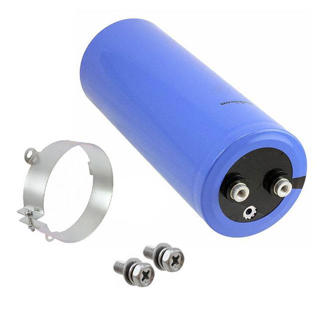

    47000 µF 250 V 铝电解电容器 径向,Can - 螺丝端子 85°C 时为 5000 小时
LNR2E473MSE 数据手册
ALUMINUM ELECTROLYTIC CAPACITORS LNR Screw Terminal Type, 85°C Standard Load life of 5000 hours application of rated ripple current at 85°C. Extended rarge up to φ100 × 250L size. Compliant to the RoHS directive (2011/65/EU,(EU)2015/863). LNT LNY High Temperature High Voltage LNR Specifications Item Performance Characteristics Category Temperature Range – 40 to +85°C (10 to 100V) , – 25 to +85°C (160 to 250V) Rated Voltage Range 10 to 250V Rated Capacitance Range 1000 to 680000µF Capacitance Tolerance ± 20% at 120Hz,  20°C Leakage Current After 5 minutes' application of rated voltage, leakage current is not more than 3 CV (µA) or 5 mA, whichever is smaller (at 20°C) . [C:Rated Capacitance (µF) , V:Voltage(V)] 3 CV Tangent of loss angle (tan δ) (max.) 3 CV See refer to next page (Measurement frequency : 120Hz at 20°C) Measurement frequeny : 120Hz 160 to 250 Z(–25°C) / Z(+20°C) 8 10 to 100 Z(–40°C) / Z(+20°C) 12 Rated voltage (V) Stability at Low Temperature Impedance ratio (max.) Endurance The specifications listed at right shall be met when the capacitors are restored to 20°C after D.C. bias plus rated ripple current is applied for 5000 hours at 85°C, the peak voltage shall not exceed the rated voltage. Capacitance change tan δ Leakage current Within ±15% of the initial capacitance value 175% or less than the initial specified value Less than or equal to the initial specified value Shelf Life After storing the capacitors under no load at 85°C for 1000 hours and then performing voltage treatment based on JIS C 5101-4 clause 4.1 at 20°C, they shall meet the requirements listed at right. Capacitance change tan δ Leakage current Within ±20% of the initial capacitance value 175% or less than the initial specified value Less than or equal to the initial specified value Marking Printed with black color letter on light blue sleeve. Drawing Type numbering system (Example : 250V 2200µF) 1 φ35 Screw terminal type 2 3 4 5 6 Hexagenal headed bolt (M5) Bottom plate 8 9 10 11 12 Mounting bracket Configuration Sleeve Capacitance tolerance (±20%) 3.5 + 24 15±0.5 6±1 Rated capacitance (2200µF) 29±1 Rated voltage (250V) 10 45±1 30° 12.7±1 10 35+2max. Pressure relief vent L+3max. 7 L NR 2 E 2 2 2 M S E Series name 7 Type Configuration Cr (III) Plating (RoHS compliant) SE Please refer to the Guidelines for Aluminum Electrolytic Capacitors for dimensions information. Please contact to us if PVCless products are required. Dimension table in next page. CAT.8100M W±1 L+ max. Screw terminal types for φ 51 and larger Sleeve 0° 12 have different hole shapes from the Pressure relief vent φD +2 max. W±1 P ordinary ones as illustrated below. P P T P±2 B 5 S h H±1 L+ max. U S 3-leg brackets for φ90 capacitors T Hexagenal headed bolt ±1 U A±2 5 Bottom plate D+ 2 max. h H±1 A±2 LNR S ALUMINUM ELECTROLYTIC CAPACITORS Configuration (φ 35) Code less 2-leg brackets No brackets N Rated Capacitance (2200μF) (φ 51~ φ 100) Rated voltage (250V) Code less 3-leg brackets 2-leg brackets T B P±2 Series name B UN No brackets A±2 Type Capacitance tolerance (20%) 7 Pressure relief vent 30° 7 ±1 Note: Capacitors with body dia. φ51 or larger are furnished with 3-leg brackets shown above as standard. If these capacitors are preferred to have 2-leg brackets as shown right, add "B" in the 12th digit of type numbering system. Dimension of terminal pitch (W) and length (R) and Nominal dia.of bolt φD W R α 51.5 22.0 6 63.5 28.6 6 76.2 31.8 6 90.5 31.8 6 100.50 41.5 10 3 3 3 3 4 (mm) Nominal dia.of bolt M5 M5 M5 M5 M8 Dimensions of mounting bracket φD (mm) 3-Legs Leg Shape 2-Legs 51 63.5 76.2 90 100 51 63.5 76.2 90 P 32.5 38.1 44.5 50.8 56.3 33.2 40.5 46.5 53 A 38.5 43 49.2 58.5 62 40 46.5 53 59 T 7.5 8.0 7.0 8.0 8.0 6.0 7.0 6.0 6.0 S 5.0 5.0 5.0 5.0 5.0 4.5 4.5 4.5 4.5 U 12 14 14 18 16 14 14 14 14 60 60 60 60 60 30 30 30 30 H 20 25 30 35 36 25 35 35 35 h 15 20 24 25 30 15 20 20 20 Symbol ° Dimensions 10V (1A) Cap. (µF) Size Rated ripple φD × L(mm) (Arms) tan δ 16V (1C) Leakage Current (mA) Code Cap. (µF) Size Rated ripple φD × L(mm) (Arms) tan δ Leakage Current (mA) Code 47000 35 × 80 6.0 0.60 2.05 LNR1A473MSE 47000 35 × 80 06.4 0.40 2.60 LNR1C473MSE 68000 35 × 80 7.2 0.60 2.47 LNR1A683MSE 68000 35 × 100 07.9 0.40 3.12 LNR1C683MSE 100000 35 × 100 8.8 0.60 3.00 LNR1A104MSE 100000 35 × 120 10.6 0.55 3.79 LNR1C104MSE 150000 51 × 80 10.7 0.90 3.67 LNR1A154MSE 150000 51 × 100 11.5 0.60 4.64 LNR1C154MSE 220000 51 × 100 13.0 0.90 4.44 LNR1A224MSE 220000 51 × 120 15.6 0.80 5.00 LNR1C224MSE 330000 63.5 × 100 15.9 0.90 5.00 LNR1A334MSE 330000 63.5 × 120 25.1 0.75 5.00 LNR1C334MSE 470000 63.5 × 120 19.0 1.20 5.00 LNR1A474MSE 470000 76.2 × 120 30.5 1.10 5.00 LNR1C474MSE 680000 76.2 × 120 22.8 1.60 5.00 LNR1A684MSE 680000 90 × 170 33.0 1.50 5.00 LNR1C684MSE Rated ripple current (Arms) at 85°C 120Hz CAT.8100M ALUMINUM ELECTROLYTIC CAPACITORS LNR Dimensions 35V (1V) 25V (1E) Cap. (µF) Size Rated ripple φD × L(mm) (Arms) tan δ Leakage Current (mA) Cap. (µF) Code Size Rated ripple φD × L(mm) (Arms) tan δ Leakage Current (mA) Code 33000 35 × 80 6.2 0.35 2.72 LNR1E333MSE 33000 35 × 80 6.2 0.30 3.22 LNR1V333MSE 47000 35 × 100 8.2 0.35 3.25 LNR1E473MSE 47000 35 × 120 8.2 0.30 3.84 LNR1V473MSE 68000 35 × 120 9.4 0.40 3.91 LNR1E683MSE 68000 51 × 80 9.3 0.35 4.62 LNR1V683MSE 100000 51 × 100 12.0 0.45 4.74 LNR1E104MSE 100000 51 × 120 13.6 0.40 5.00 LNR1V104MSE 150000 51 × 120 15.3 0.50 5.00 LNR1E154MSE 150000 63.5 × 100 14.5 0.50 5.00 LNR1V154MSE 220000 63.5 × 120 18.9 0.65 5.00 LNR1E224MSE 220000 76.2 × 100 16.8 0.65 5.00 LNR1V224MSE 330000 76.2 × 120 24.8 0.75 5.00 LNR1E334MSE 330000 76.2 × 140 24.8 0.75 5.00 LNR1V334MSE 470000 90 × 170 30.8 1.00 5.00 LNR1E474MSE 470000 90 × 170 32.6 0.90 5.00 LNR1V474MSE 680000 90 × 220 33.3 1.00 5.00 LNR1E684MSE 680000 90 × 220 35.2 0.90 5.00 LNR1V684MSE 50V (1H) 63V (1J) Cap. (µF) Size Rated ripple φD × L(mm) (Arms) Cap. (µF) Size Rated ripple φD × L(mm) (Arms) tan δ tan δ 15000 35 × 80 5.4 0.25 2.59 LNR1H153MSE 22000 35 × 100 6.1 0.25 3.14 LNR1H223MSE 10000 35 × 80 4.1 0.25 2.38 LNR1J103MSE 15000 35 × 100 5.5 0.25 2.91 LNR1J153MSE 33000 51 × 70 7.0 0.25 3.85 47000 51 × 90 8.6 0.25 4.59 LNR1H333MSE 22000 35 × 120 7.1 0.25 3.53 LNR1J223MSE LNR1H473MSE 33000 51 × 80 8.8 0.25 4.32 LNR1J333MSE 68000 51 × 100 11.0 0.25 100000 63.5 × 100 14.2 0.35 5.00 LNR1H683MSE 47000 51 × 120 11.7 0.25 5.00 LNR1J473MSE 5.00 LNR1H104MSE 68000 63.5 × 100 15.0 0.30 5.00 LNR1J683MSE 150000 76.2 × 120 18.6 220000 90 × 140 20.3 0.55 5.00 LNR1H154MSE 100000 63.5 × 140 20.8 0.30 5.00 LNR1J104MSE 0.75 5.00 LNR1H224MSE 150000 76.2 × 140 26.0 0.50 5.00 LNR1J154MSE 330000 90 × 170 470000 90 × 220 25.3 0.75 5.00 LNR1H334MSE 220000 90 × 170 28.3 0.60 5.00 LNR1J224MSE 33.2 0.75 5.00 LNR1H474MSE 330000 90 × 220 31.2 0.60 5.00 LNR1J334MSE 680000 100 × 250 36.0 0.75 5.00 LNR1H684MSE 470000 100 × 250 33.6 0.60 5.00 LNR1J474MSE Leakage Current (mA) Code Leakage Current (mA) Code 100V (2A) 80V (1K) Cap. (µF) Size Rated ripple φD × L(mm) (Arms) Cap. (µF) tan δ 10000 35 × 80 4.2 0.20 2.68 LNR1K103MSE 15000 35 × 120 6.0 0.20 3.28 LNR1K153MSE 22000 51 × 80 6.5 0.20 3.97 LNR1K223MSE 33000 51 × 120 9.2 0.20 4.87 47000 63.5 × 100 12.7 0.25 5.00 68000 63.5 × 140 15.5 0.30 100000 76.2 × 140 21.3 0.35 150000 90 × 170 26.5 220000 90 × 220 28.9 330000 100 × 250 31.8 Size Rated ripple φD × L(mm) (Arms) tan δ 4700 35 × 80 3.8 0.12 2.05 LNR2A472MSE 6800 35 × 100 4.5 0.12 2.47 LNR2A682MSE 10000 35 × 120 5.3 0.15 3.00 LNR2A103MSE LNR1K333MSE 15000 51 × 80 6.0 0.15 3.67 LNR2A153MSE LNR1K473MSE 22000 51 × 100 6.8 0.15 4.44 LNR2A223MSE 5.00 LNR1K683MSE 33000 51 × 140 10.0 0.15 5.00 LNR2A333MSE 5.00 LNR1K104MSE 47000 63.5 × 140 14.4 0.20 5.00 LNR2A473MSE 0.40 5.00 LNR1K154MSE 68000 76.2 × 140 18.2 0.30 5.00 LNR2A683MSE 0.40 5.00 LNR1K224MSE 100000 90 × 170 22.1 0.30 5.00 LNR2A104MSE 0.40 5.00 LNR1K334MSE 150000 90 × 220 27.0 0.30 5.00 LNR2A154MSE 220000 100 × 250 32.7 0.30 5.00 LNR2A224MSE Leakage Current (mA) Code Leakage Current (mA) Code Rated ripple current (Arms) at 85°C, 120Hz CAT.8100M ALUMINUM ELECTROLYTIC CAPACITORS LNR Dimensions Cap. (µF) 160V (2C) Size Rated ripple tan δ φD × L(mm) (Arms) Leakage Current Cap. (µF) Code (mA) 200V (2D) Size Rated ripple tan δ φD × L(mm) (Arms) Leakage Current (mA) Code 2200 35 × 80 3.2 0.15 1.77 LNR2C222MSE 1500 35 × 80 2.9 0.15 1.64 LNR2D152MSE 3300 35 × 120 4.7 0.15 2.17 LNR2C332MSE 2200 35 × 100 3.5 0.15 1.98 LNR2D222MSE 4700 51 × 80 5.0 0.15 2.60 LNR2C472MSE 3300 51 × 80 4.8 0.15 2.43 LNR2D332MSE 6800 51 × 100 6.4 0.15 3.12 LNR2C682MSE 4700 51 × 100 6.3 0.15 2.90 LNR2D472MSE 10000 63.5 × 100 9.1 0.20 3.79 LNR2C103MSE 6800 51 × 140 7.3 0.15 3.49 LNR2D682MSE 15000 76.2 × 100 12.0 0.20 4.64 LNR2C153MSE 10000 63.5 × 120 9.8 0.20 4.24 LNR2D103MSE 22000 76.2 × 140 16.9 0.20 5.00 LNR2C223MSE 15000 76.2 × 120 13.0 0.20 5.00 LNR2D153MSE 33000 90 × 140 19.2 0.25 5.00 LNR2C333MSE 22000 90 × 140 15.9 0.25 5.00 LNR2D223MSE 47000 90 × 170 20.6 0.25 5.00 LNR2C473MSE 33000 90 × 170 19.5 0.25 5.00 LNR2D333MSE 68000 90 × 220 22.3 0.25 5.00 LNR2C683MSE 47000 90 × 220 20.9 0.25 5.00 LNR2D473MSE 68000 100 × 250 22.6 0.25 5.00 LNR2D683MSE Cap. (µF) 250V (2E) Size Rated ripple tan δ φD × L(mm) (Arms) Leakage Current Code (mA) 1000 35 × 80 2.4 0.15 1.50 LNR2E102MSE 1500 35 × 100 3.0 0.15 1.83 LNR2E152MSE 2200 51 × 80 4.0 0.15 2.22 LNR2E222MSE 3300 51 × 100 5.4 0.15 2.72 LNR2E332MSE 4700 63.5 × 100 7.3 0.20 3.25 LNR2E472MSE 6800 63.5 × 120 8.9 0.20 3.91 LNR2E682MSE 10000 76.2 × 120 11.8 0.20 4.74 LNR2E103MSE 15000 90 × 140 16.4 0.25 5.00 LNR2E153MSE 22000 90 × 170 17.9 0.25 5.00 LNR2E223MSE 33000 90 × 220 19.7 0.25 5.00 LNR2E333MSE 47000 100 × 250 21.2 0.25 5.00 LNR2E473MSE Rated ripple current (Arms) at 85°C, 120Hz Frequency coefficient of rated ripple current Frequency (Hz) Coeff. 10 to 100V 160 to 250V 60 0.90 0.88 120 1.00 1.00 360 1.08 1.08 1k 1.15 1.15 10k or more 1.15 1.20 CAT.8100M
