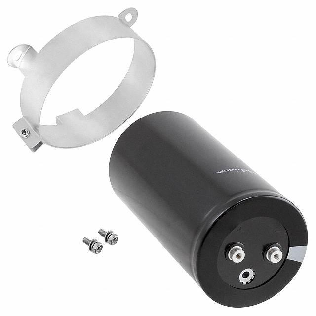

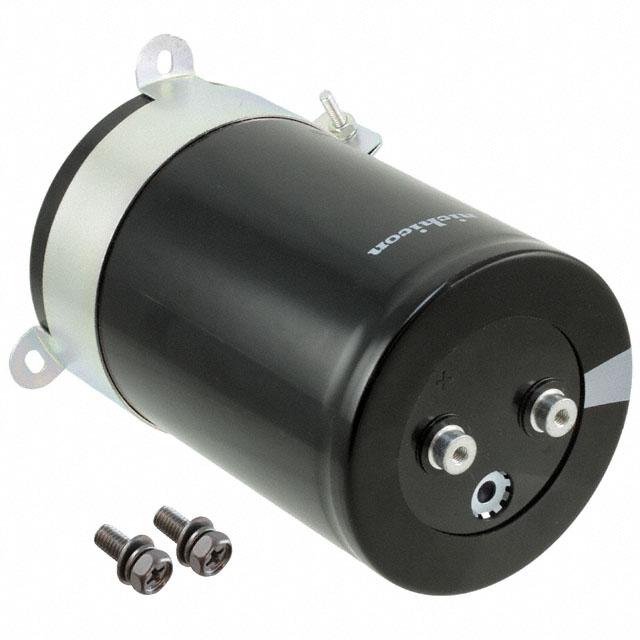

    15000 µF 250 V 铝电解电容器 径向,Can - 螺丝端子 105°C 时为 2000 小时
LNT2E153MSE 数据手册
ALUMINUM ELECTROLYTIC CAPACITORS LNT Screw Terminal Type, 105°C Standard Load life of 5,000 hours (2,000 hours for 10 to 250V,500V) application of rated ripple current at +105°C. Extended voltage range from 10V up to 500V. Extended range up to φ100 × 250L 2size. Compliant to the RoHS directive (2011/65/EU,(EU)2015/863). LNT Smaller High Voltage Wide Temperature LNU LNR Specifications Item Performance Characteristics Category Temperature Range – 40 to +105°C (10 to 100V) , – 25 to +105°C (160 to 500V) Rated Voltage Range 10 to 500V Rated Capacitance Range 220 to 680000µF Capacitance Tolerance ± 20% at 120Hz,  20°C Leakage Current After 5 minutes’ application of rated voltage, leakage current is not more than 3 CV (µA) or 5mA, whichever is smaller. (at 20°C) [C:Rated Capacitance (µF) , V:Voltage(V)] Tangent of loss angle (tan δ) (max.) 3 CV See refer to next page (Measurement frequency : 120Hz at 20°C) 3 CV Rated voltage (V) Stability at Low Temperature Impedance ratio (max.) Z(–25°C) / Z(+20°C) Z(–40°C) / Z(+20°C) 160 to 500 8 — 10 to 100 — 12 Measurement frequency : 120Hz Endurance The specifications listed at right shall be met when the capacitors are restored to 20°C after D.C. bias plus rated ripple current is applied for 5000 hours (2000 hours for 10 to 250V/500V) at 105°C, the peak voltage shall not exceed the rated voltage. Capacitance change tan δ Leakage current Within ±20% of the initial capacitance value 300% or less than the initial specified value Less than or equal to the initial specified value Shelf Life After storing the capacitors under no load at 105°C for 1000 hours and then performing voltage treatment based on JIS C 5101-4 clause 4.1 at 20°C, they shall meet the requirements listed at right. Capacitance change tan δ Leakage current Within ±20% of the initial capacitance value 300% or less than the initial specified value Less than or equal to the initial specified value Marking Printed with white color letter on black sleeve. Type numbering system Drawing Voltage 250V or less (Example : 250V 3300µF) φ 35 Screw terminal type 1 1 Bottom plate 2 2 3 3 4 4 5 5 6 6 7 7 8 8 9 11 9 10 10 11 L N T 2 E 3 3 2 MS E Hexagenal headed bolt (M5) 12 12 Mounting Mounting bracket bracket Configuration (φ35) Configuration (φ35) Capacitance tolerance (±20%) 2-leg brackets Code less Capacitance tolerance (20%) Code less 2-leg brackets No N Rated No brackets brackets N Ratedcapacitance capacitance(3300µF) (3300F) Sleeve 10 3.5 + 24 15±0.5 L+3max. 6±1 29±1 Rated Rated voltage voltage (250V) (250V) (φ51 (φ51 to to φ100) φ100) Series Series name name Code 3-leg brackets brackets Code less less 3-leg Type 2-leg Type B 2-leg brackets brackets B No brackets N No brackets N 10 45±1 30° 12.7±1 φ35+2max. Pressure relief vent 7 Voltage 350V or more (Example : 450V 2200µF) 1 1 2 2 3 3 4 4 5 5 6 6 7 7 8 8 9 9 10 11 12 10 11 12 13 13 14 14 L N T 2W 2 2 2 M S E G Configuration Configuration (20%) Capacitancetolerance tolerance(±20%) Capacitance (2200F) Ratedcapacitance capacitance(2200µF) Rated Rated (450V) Rated voltage voltage (450V) Series Series name name Type Type Configuration Configuration Mounting Mounting bracket bracket Case (φ35) Case dia. dia. code code (φ35) Code 2-leg brackets brackets Code less less 2-leg φD φD Code Code No BN No brackets brackets BN C 35 C 35 F 51 (φ51 F 51 (φ51 to to φ90) φ90) 63.5 Code G 63.5 G 3-leg brackets brackets Code less less 3-leg H 76.2 2-leg BB 76.2 H 2-leg brackets brackets BB No brackets JJ 90 BN No brackets 90 BN K 100 K 100 (φ100) (φ100) Code 3-leg brackets brackets Code less less 3-leg No BN No brackets brackets BN Cr III) Plating Cr ((III) Plating (RoHS (RoHS compliant) compliant) SE SE Resin bushing available upon request. Please refer to the Guidelines for Aluminum Electrolytic Capacitors for dimensions information. Please contact to us if PVCless products are required. Dimension table in next page. CAT.8100M ALUMINUM ELECTROLYTIC CAPACITORS LNT Screw terminal types for φ51 and larger Screw terminal type for φ 51 and larger Bottom plate Hexagenal headed bolt Sleeve 0° 12 W±1 φD +2 max. Pressure relief vent S h L+ max. T P±2 B H±1 U A±2 ±1 P A±2 T U S ∗B 3-leg brackets for φ90 capacitors have different P hole shapes from the ordinary ones as illustrated 5 below. Pressure relief vent 30° 5 7 P 7 Dimension of terminal pitch (W) and length (R) and Nominal dia.of bolt φD W R 51.5 22.0 6 63.5 28.6 6 76.2 31.8 6 90.5 31.8 6 100.50 41.5 10 (mm) Nominal.of bolt α 3 3 3 3 4 M5 M5 M5 M5 M8 Dimensions of mounting bracket (mm) 3-Legs Leg Shape 2-Legs 51 63.5 76.2 90 100 51 63.5 76.2 90 P 32.5 38.1 44.5 50.8 56.3 33.2 40.5 46.5 53 A 38.5 43 49.2 58.5 62 40 46.5 53 59 T 7.5 8.0 7.0 8.0 8.0 6.0 7.0 6.0 6.0 S 5.0 5.0 5.0 5.0 5.0 4.5 4.5 4.5 4.5 U 12 14 14 18 16 14 14 14 14 60 60 60 60 60 30 30 30 30 H 20 25 30 35 36 25 35 35 35 h 15 20 24 25 30 15 20 20 20 φD Symbol ° Dimensions 10V (1A) Cap. (µF) Size Rated ripple φD × L(mm) (Arms) tan δ 16V (1C) Leakage Current (mA) Code Cap. (µF) Size Rated ripple φD × L(mm) (Arms) tan δ Leakage Current (mA) Code 33000 35 × 80 4.8 0.65 1.72 LNT1A333MSE 33000 35 × 80 5.2 0.45 2.17 LNT1C333MSE 47000 35 × 100 6.2 0.65 2.05 LNT1A473MSE 47000 35 × 100 6.8 0.45 2.60 LNT1C473MSE 68000 51 × 80 6.8 0.80 2.47 LNT1A683MSE 68000 51 × 80 7.1 0.60 3.12 LNT1C683MSE 100000 51 × 100 8.6 0.80 3.00 LNT1A104MSE 100000 51 × 100 9.6 0.60 3.79 LNT1C104MSE 150000 51 × 120 10.8 0.85 3.67 LNT1A154MSE 150000 51 × 120 11.0 0.60 4.64 LNT1C154MSE 220000 63.5 × 120 13.2 1.20 4.44 LNT1A224MSE 220000 63.5 × 120 14.1 0.80 5.00 LNT1C224MSE 330000 76.2 × 120 15.8 2.00 5.00 LNT1A334MSE 330000 76.2 × 120 20.6 1.20 5.00 LNT1C334MSE 470000 90 × 140 17.0 2.40 5.00 LNT1A474MSE 470000 90 × 140 22.1 2.00 5.00 LNT1C474MSE LNT1A684MSE 680000 90 × 170 24.0 2.00 5.00 LNT1C684MSE 680000 90 × 170 18.4 2.40 5.00 Rated ripple current (Arms) at 105°C 120Hz CAT.8100M ALUMINUM ELECTROLYTIC CAPACITORS LNT Dimensions 35V (1V) 25V (1E) Cap. (µF) Size Rated ripple φD × L(mm) (Arms) tan δ Leakage Current (mA) Code Cap. (µF) Size Rated ripple φD × L(mm) (Arms) tan δ Leakage Current (mA) Code 22000 35 × 80 4.9 0.40 2.22 LNT1E223MSE 10000 35 × 80 4.7 0.30 1.77 LNT1V103MSE 33000 35 × 100 6.2 0.40 2.72 LNT1E333MSE 15000 35 × 80 5.1 0.30 2.17 LNT1V153MSE 47000 51 × 80 8.3 0.50 3.25 LNT1E473MSE 22000 35 × 100 5.6 0.30 2.63 LNT1V223MSE 68000 51 × 120 10.2 0.50 3.91 LNT1E683MSE 33000 51 × 80 7.4 0.40 3.22 LNT1V333MSE 47000 100000 63.5 × 100 11.5 0.65 4.74 LNT1E104MSE 51 × 100 8.4 0.40 3.84 LNT1V473MSE 150000 63.5 × 120 13.8 0.70 5.00 LNT1E154MSE 68000 51 × 120 12.3 0.40 4.62 LNT1V683MSE 220000 76.2 × 120 17.0 0.90 5.00 LNT1E224MSE 100000 63.5 × 120 13.6 0.50 5.00 LNT1V104MSE 330000 90 × 140 20.8 1.50 5.00 LNT1E334MSE 150000 76.2 × 120 15.1 0.70 5.00 LNT1V154MSE 470000 90 × 170 22.4 1.50 5.00 LNT1E474MSE 220000 90 × 140 17.4 1.00 5.00 LNT1V224MSE 680000 90 × 220 24.2 1.50 5.00 LNT1E684MSE 330000 90 × 170 21.3 1.00 5.00 LNT1V334MSE 470000 90 × 220 25.4 1.00 5.00 LNT1V474MSE 680000 100 × 250 27.5 1.00 5.00 LNT1V684MSE 50V (1H) 63V (1J) Cap. (µF) Size Rated ripple φD × L(mm) (Arms) Cap. (µF) Size Rated ripple φD × L(mm) (Arms) tan δ tan δ 10000 35 × 80 4.9 0.25 2.12 LNT1H103MSE 10000 35 × 100 5.0 0.25 2.38 LNT1J103MSE 15000 35 × 100 5.5 0.25 2.59 22000 LNT1H153MSE 15000 51 × 80 5.9 0.25 2.91 LNT1J153MSE 3.14 LNT1H223MSE 22000 51 × 80 6.3 0.25 33000 51 × 120 8.0 0.30 51 × 100 6.9 0.25 3.53 LNT1J223MSE 3.85 LNT1H333MSE 33000 63.5 × 100 9.4 0.30 4.32 LNT1J333MSE 47000 63.5 × 100 9.9 68000 63.5 × 120 12.8 0.35 4.59 LNT1H473MSE 47000 63.5 × 120 11.2 0.30 5.00 LNT1J473MSE 0.35 5.00 LNT1H683MSE 68000 76.2 × 120 13.5 0.50 5.00 LNT1J683MSE 100000 76.2 × 120 150000 90 × 140 16.8 0.55 5.00 LNT1H104MSE 100000 90 × 140 17.8 0.60 5.00 LNT1J104MSE 19.5 0.75 5.00 LNT1H154MSE 150000 90 × 170 21.0 0.60 5.00 LNT1J154MSE 220000 330000 90 × 170 22.0 0.75 5.00 LNT1H224MSE 220000 90 × 220 23.7 0.60 5.00 LNT1J224MSE 90 × 220 24.3 0.75 5.00 LNT1H334MSE 330000 100 × 250 26.1 0.60 5.00 LNT1J334MSE 470000 100 × 250 26.1 0.75 5.00 LNT1H474MSE Leakage Current (mA) Code Size Rated ripple φD × L(mm) (Arms) tan δ 35 × 80 0.20 4700 6800 35 × 100 3.9 0.20 10000 51 × 80 5.4 0.20 15000 51 × 100 6.4 22000 63.5 × 100 8.4 33000 76.2 × 100 47000 76.2 × 120 68000 90 × 140 100000 90 × 170 150000 220000 (mA) Code 100V (2A) 80V (1K) Cap. (µF) Leakage Current Leakage Current (mA) Cap. (µF) Code Size Rated ripple φD × L(mm) (Arms) tan δ Leakage Current (mA) Code LNT1K472MSE 2200 35 × 80 2.4 0.12 1.40 LNT2A222MSE 2.21 LNT1K682MSE 3300 35 × 80 3.3 0.12 1.72 LNT2A332MSE 2.68 LNT1K103MSE 4700 35 × 100 3.8 0.12 2.05 LNT2A472MSE 0.20 3.28 LNT1K153MSE 6800 51 × 80 5.2 0.15 2.47 LNT2A682MSE 0.25 3.97 LNT1K223MSE 10000 51 × 100 6.7 0.15 3.00 LNT2A103MSE 9.9 0.30 4.87 LNT1K333MSE 15000 63.5 × 100 7.8 0.20 3.67 LNT2A153MSE 13.4 0.35 5.00 LNT1K473MSE 22000 76.2 × 100 9.9 0.30 4.44 LNT2A223MSE 17.0 0.40 5.00 LNT1K683MSE 33000 76.2 × 140 12.7 0.30 5.00 LNT2A333MSE 18.6 0.40 5.00 LNT1K104MSE 47000 90 × 140 17.0 0.30 5.00 LNT2A473MSE 90 × 220 21.6 0.40 5.00 LNT1K154MSE 68000 90 × 170 18.2 0.30 5.00 LNT2A683MSE 100 × 250 24.8 0.40 5.00 LNT1K224MSE 100000 90 × 220 20.6 0.30 5.00 LNT2A104MSE 150000 100 × 220 23.4 0.30 5.00 LNT2A154MSE 3.5 1.83 Rated ripple current (Arms) at 105°C 120Hz CAT.8100M ALUMINUM ELECTROLYTIC CAPACITORS LNT Dimensions 160V (2C) Cap. (µF) Size Rated ripple φD × L(mm) (Arms) tan δ 200V (2D) Leakage Current (mA) Cap. (µF) Code Size Rated ripple φD × L(mm) (Arms) tan δ Leakage Current (mA) Code 1000 35 × 80 1.6 0.15 1.20 LNT2C102MSE 1000 35 × 80 1.7 0.15 1.34 LNT2D102MSE 1500 35 × 80 2.1 0.15 1.46 LNT2C152MSE 1500 35 × 100 2.3 0.15 1.64 LNT2D152MSE 2200 35 × 100 2.7 0.15 1.77 LNT2C222MSE 2200 51 × 80 2.9 0.15 1.98 LNT2D222MSE 3300 51 × 80 3.8 0.15 2.17 LNT2C332MSE 3300 51 × 100 3.9 0.15 2.43 LNT2D332MSE 4700 51 × 100 4.5 0.15 2.60 LNT2C472MSE 4700 63.5 × 100 5.1 0.20 2.90 LNT2D472MSE 6800 63.5 × 100 6.8 0.20 3.12 LNT2C682MSE 6800 63.5 × 120 7.0 0.20 3.49 LNT2D682MSE 10000 63.5 × 120 7.8 0.20 3.79 LNT2C103MSE 10000 76.2 × 120 8.2 0.20 4.24 LNT2D103MSE 15000 76.2 × 120 9.8 0.20 4.64 LNT2C153MSE 15000 76.2 × 140 10.4 0.20 5.00 LNT2D153MSE 22000 76.2 × 140 12.5 0.20 5.00 LNT2C223MSE 22000 90 × 140 15.1 0.25 5.00 LNT2D223MSE 33000 90 × 140 13.4 0.25 5.00 LNT2C333MSE 33000 90 × 220 16.6 0.25 5.00 LNT2D333MSE 47000 90 × 220 17.2 0.25 5.00 LNT2C473MSE 47000 90 × 250 19.9 0.25 5.00 LNT2D473MSE 68000 100 × 250 19.2 0.25 5.00 LNT2C683MSE Cap. (µF) Size Rated ripple φD × L(mm) (Arms) tan δ Cap. (µF) Size Rated ripple φD × L(mm) (Arms) tan δ 350V (2V) 250V (2E) Leakage Current (mA) Code Leakage Current (mA) Code 680 35 × 80 1.4 0.15 1.23 LNT2E681MSE 330 35 × 80 2.1 0.20 1.01 LNT2V331MSEC 1000 35 × 100 1.9 0.15 1.50 LNT2E102MSE 470 35 × 80 2.8 0.20 1.21 LNT2V471MSEC 1500 51 × 80 2.4 0.15 1.83 LNT2E152MSE 680 51 × 80 4.1 0.20 1.46 LNT2V681MSEF 2200 51 × 100 3.2 0.15 2.22 LNT2E222MSE 1000 51 × 80 6.5 0.20 1.77 LNT2V102MSEF 3300 63.5 × 100 4.3 0.20 2.72 LNT2E332MSE 1500 51 × 100 8.6 0.20 2.17 LNT2V152MSEF 4700 63.5 × 120 5.9 0.20 3.25 LNT2E472MSE 2200 51 × 120 11.0 0.20 2.63 LNT2V222MSEF 6800 76.2 × 120 7.1 0.20 3.91 LNT2E682MSE 2700 63.5 × 100 12.7 0.20 2.91 LNT2V272MSEG 10000 90 × 140 9.6 0.25 4.74 LNT2E103MSE 3300 63.5 × 110 14.4 0.20 3.22 LNT2V332MSEG 15000 90 × 170 12.7 0.25 5.00 LNT2E153MSE 3900 63.5 × 130 16.8 0.20 3.50 LNT2V392MSEG 22000 90 × 220 15.4 0.25 5.00 LNT2E223MSE 0.20 3.84 LNT2V472MSEG 100 × 250 17.0 0.25 5.00 LNT2E333MSE 4700 19.8 33000 63.5 × 150 76.2 × 120 19.7 0.20 3.84 LNT2V472MSEH 63.5 × 170 22.7 0.20 4.20 LNT2V562MSEG 76.2 × 130 22.2 0.20 4.20 LNT2V562MSEH 76.2 × 150 26.2 0.20 4.62 LNT2V682MSEH 76.2 × 170 30.3 0.20 5.00 LNT2V822MSEH 90 × 150 29.3 0.20 5.00 LNT2V822MSEJ 5600 6800 8200 10000 90 × 150 32.4 0.20 5.00 LNT2V103MSEJ 12000 90 × 190 36.0 0.20 5.00 LNT2V123MSEJ 15000 90 × 220 42.9 0.20 5.00 LNT2V153MSEJ 22000 100 × 250 48.0 0.20 5.00 LNT2V223MSEK Rated ripple current (Arms) at 105°C 120Hz CAT.8100M ALUMINUM ELECTROLYTIC CAPACITORS LNT Dimensions 450V (2W) 400V (2G) Cap. (µF) Size Rated ripple φD × L(mm) (Arms) tan δ Leakage Current (mA) Cap. (µF) Code Size Rated ripple φD × L(mm) (Arms) tan δ Leakage Current Code (mA) 220 35 × 80 1.6 0.20 0.88 LNT2G221MSEC 220 35 × 80 1.8 0.20 0.94 LNT2W221MSEC 330 35 × 80 2.3 0.20 1.08 LNT2G331MSEC 330 35 × 100 2.4 0.20 1.15 LNT2W331MSEC 470 35 × 100 3.1 0.20 1.30 LNT2G471MSEC 470 51 × 80 3.4 0.20 1.37 LNT2W471MSEF 680 51 × 80 4.2 0.20 1.56 LNT2G681MSEF 680 51 × 100 4.4 0.20 1.65 LNT2W681MSEF 1000 51 × 80 6.6 0.20 1.89 LNT2G102MSEF 1000 51 × 100 7.0 0.20 2.01 LNT2W102MSEF 1500 51 × 120 9.1 0.20 2.32 LNT2G152MSEF 1500 51 × 120 9.2 0.20 2.46 LNT2W152MSEF 2200 63.5 × 100 11.5 0.20 2.81 LNT2G222MSEG 2200 63.5 × 110 11.8 0.20 2.98 LNT2W222MSEG 2700 63.5 × 110 13.1 0.20 3.11 LNT2G272MSEG 63.5 × 130 13.8 0.20 3.30 LNT2W272MSEG 3300 63.5 × 130 15.4 0.20 3.44 LNT2G332MSEG 76.2 × 110 14.5 0.20 3.30 LNT2W272MSEH 63.5 × 150 17.9 0.20 3.74 LNT2G392MSEG 63.5 × 150 16.5 0.20 3.65 LNT2W332MSEG 76.2 × 110 18.2 0.20 3.74 LNT2G392MSEH 63.5 × 170 20.7 0.20 4.11 76.2 × 130 20.3 0.20 76.2 × 150 23.7 0.20 76.2 × 170 27.6 90 × 150 26.9 3900 2700 3300 76.2 × 130 17.1 0.20 3.65 LNT2W332MSEH LNT2G472MSEG 3900 63.5 × 170 18.3 0.20 3.97 LNT2W392MSEG 4.11 LNT2G472MSEH 4700 76.2 × 150 21.7 0.20 4.36 LNT2W472MSEH 4.48 LNT2G562MSEH 76.2 × 190 26.4 0.20 4.76 LNT2W562MSEH 0.20 4.94 LNT2G682MSEH 0.20 4.94 4700 5600 6800 8200 90 × 170 31.0 0.20 10000 90 × 190 32.9 12000 90 × 220 38.3 15000 100 × 220 44.5 Cap. (µF) Size Rated ripple φD × L(mm) (Arms) tan δ 5600 90 × 150 24.1 0.20 4.76 LNT2W562MSEJ LNT2G682MSEJ 6800 90 × 170 28.3 0.20 5.00 LNT2W682MSEJ 5.00 LNT2G822MSEJ 8200 90 × 190 32.5 0.20 5.00 LNT2W822MSEJ 0.20 5.00 LNT2G103MSEJ 10000 90 × 220 35.1 0.20 5.00 LNT2W103MSEJ 0.20 5.00 LNT2G123MSEJ 12000 90 × 230 39.2 0.20 5.00 LNT2W123MSEJ 0.20 5.00 LNT2G153MSEK 15000 90 × 250 45.6 0.20 5.00 LNT2W153MSEJ 500V (2H) Leakage Current (mA) Code 330 51 × 80 2.7 0.20 1.21 LNT2H331MSEF 470 51 × 80 3.2 0.20 1.45 LNT2H471MSEF 680 51 × 100 4.2 0.20 1.74 LNT2H681MSEF 1000 51 × 120 5.5 0.20 2.12 LNT2H102MSEF 1500 63.5 × 110 7.1 0.20 2.59 LNT2H152MSEG 2200 63.5 × 130 9.3 0.20 3.14 LNT2H222MSEG 2700 63.5 × 150 11.0 0.20 3.48 LNT2H272MSEG 76.2 × 130 11.0 0.20 3.48 LNT2H272MSEH 63.5 × 170 12.9 0.20 3.85 LNT2H332MSEG 76.2 × 150 13.0 0.20 3.85 LNT2H332MSEH 76.2 × 150 14.1 0.20 4.18 LNT2H392MSEH 76.2 × 190 17.2 0.20 4.59 LNT2H472MSEH 90 × 150 16.3 0.20 4.59 LNT2H472MSEJ 3300 3900 4700 5600 90 × 150 17.8 0.20 5.00 LNT2H562MSEJ 6800 90 × 170 20.7 0.20 5.00 LNT2H682MSEJ 8200 90 × 220 25.5 0.20 5.00 LNT2H822MSEJ 10000 90 × 250 29.9 0.20 5.00 LNT2H103MSEJ Rated ripple current (Arms) at 105°C 120Hz Frequency coefficient of rated ripple current Frequency (Hz) 10 to 100V Coeff. 160 to 250V 350 to 500V 60 0.90 0.88 0.82 120 1.00 1.00 1.00 360 1.08 1.08 1.20 1k 1.15 1.15 1.35 10k or more 1.15 1.20 1.40 CAT.8100M

物料型号:LNT系列,nichicon品牌的铝电解电容器。
器件简介:LNT系列是螺丝端子类型的铝电解电容器,符合105°C标准,具有5000小时的负载寿命(10至250V、500V的产品为2000小时),并且符合RoHS指令。
引脚分配:文档中提到了螺丝端子类型,包括六角头螺栓(M5)和底板套筒,以及压力释放通风孔。
参数特性: - 工作温度范围:-40至+105°C(10至100V),-25至+105°C(160至500V)。 - 额定电压范围:10至500V。 - 额定电容范围:220至680,000微法拉。 - 电容公差:在120Hz、20°C时为20%。 - 漏电流:在5分钟额定纹波电流应用后,不超过3×10^-5或5mA(在20°C时)。 - 损耗角正切(tan δ):最大值,具体数值见下一页(测量频率:20°C时的120Hz)。 - 低温稳定性:在120Hz测量频率下,10至100V的额定电压范围内。
功能详解:文档提供了详细的电容器规格,包括在不同温度和电压条件下的阻抗比、耐久性、储存寿命和标记方式。
应用信息:LNT系列适用于需要高可靠性和长寿命的应用场合,如电源电路、电源滤波器等。
封装信息:文档提供了不同尺寸和电压等级的电容器的详细尺寸,包括直径、螺丝端子间距、长度等。
