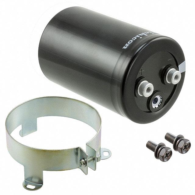

ALUMINUM ELECTROLYTIC CAPACITORS LNU Screw Terminal Type, 105°C High Voltage, Smaller Sized. Suited for use in industrial power supplies for inverter circuitry, etc. Rated voltage range up to DC525V. Load life of 5000 hours application of ripple current at 105°C. High voltage / Smaller sized than LNT. Coped with loading of high speed charge-discharge. Suited for high frequency regenerative voltage for AC servomotor, general inverter. Compliant to the RoHS directive (2011/65/EU,(EU)2015/863). LNU High Voltage Smaller LNT Specifications Item Performance Characteristics Category Temperature Range Rated Voltage Range Rated Capacitance Range – 40 to +105°C 400 to 525V 680 to 18000µF 3 CV Capacitance Tolerance ± 20% (120Hz, 20°C) Leakage Current After 5 minutes' application of rated voltage, leakage current is not more than 3 CV (µA) or 5 mA, whichever is smaller. (at 20°C) [C : Rated Capacitance(µF), V : Voltage ( V ) ] Tangent of loss angle (tan δ) See refer to next page (Measurement frequency : 120Hz at 20°C) Measurement frequeny : 120Hz 400 to 525 Z(–40°C) / Z(+20°C) 8 Rated voltage (V) Stability at Low Temperature 3 CV Impedance ratio (max.) Insulation Resistance Voltage proof The insulation resistance shall be more than 100MΩ at DC 500V application between terminal and bracket. There is no abnormality during AC 2500V 1 minute's application between terminal and bracket. Endurance The specifications listed at right shall be met when the capacitors are restored to 20°C after D.C. bias plus rated ripple current is applied for 5000 hours at 105°C, the peak voltage shall not exceed the rated voltage. Capacitance change tan δ Leakage current Within ±20% of the initial capacitance value 200% or less than the initial specified value Less than or equal to the initial specified value Shelf Life After storing the capacitors under no load at 105°C for 1000 hours Capacitance change and then performing voltage treatment based on JIS C 5101-4 tan δ clause 4.1 at 20°C, they shall meet the reguirements listed at right. Leakage current Within ±20% of the initial capacitance value 200% or less than the initial specified value Less than or equal to the initial specified value Endurance of charge discharge behavior After an application of charge-discharge voltage for 50million times Capacitance change (charge-discharge voltage difference(ΔV) = rated voltage × 0.3, cycle 3Hz) tan δ capacitors shall meet the characteristics requirement listed at right. Leakage current Within ±20% of the initial capacitance value 200% or less than the initial specified value Less than or equal to the initial specified value Marking Printed with white color letter on black sleeve Drawing Screw terminal types for φ 51 and larger Bottom plate Hexagenal headed bolt Sleeve Type numbering system (Example : 500V 4700µF) 0° 12 1 3 4 5 6 7 8 9 10 11 12 13 14 Mounting bracket φD + 2 max. W±1 2 L NU 2 H 4 7 2 M S E H Pressure relief vent S h L+ max. T P±2 B H±1 U A±2 ±1 U S Configuration P A± 2 T B 3-leg brackets for φ90 capacitors have different hole shapes from the ordinary ones illustrated below. standerd specifications stud mount type SE TE Resin bushing available upon request. Please refer to the Guidelines for Aluminum Electrolytic Capacitors for dimensions information. Please contact to us if PVCless products are required. 5 P Pressure relief vent 30° 7 Dimensions of mounting bracket Note) The brackets will be supplied in the separate box. Dimension of terminal pitch (W) and length (R) and Nominal dia.of bolt φD 51 63.5 76.2 90 W 22.0 28.6 31.8 31.8 R 6 6 6 6 α 3 3 3 3 (mm) Nominal dia. of bolt M5 M5 M5 M5 About product of stud bolt Nylon nut and nylon washer attachment are shown in the standard specifications. (Please refer to the Guidelines for Aluminum Electrolytic Capacitors) It is not attached to the bracket. Field 13 and 14 become blank in Type number system. φD Symbol ° H h 51 32.5 38.5 P A T S U (mm) 3­--Leg Leg shape 7.5 5.0 12 60 20 15 63.5 38.1 43 8.0 5.0 14 60 25 20 76.2 44.5 49.2 7.0 5.0 14 60 30 24 2­--Leg 90 50.8 58.5 8.0 5.0 18 60 35 25 51 33.2 40 6.0 4.5 14 30 25 15 63.5 40.5 46.5 7.0 4.5 14 30 35 20 76.2 46.5 53 6.0 4.5 14 30 35 20 90 53 59 6.0 4.5 14 30 35 20 Dimension table in next page. CAT.8100M ALUMINUM ELECTROLYTIC CAPACITORS LNU Dimensions 400V (2G) Cap. (µF) 2700 3300 3900 Size Rated ripple φD × L(mm) (Arms) tan δ 450V (2W) Leakage Current (mA) Code Cap. (µF) 2700 63.5 × 80 11.9 0.20 3.11 LNU2G272MSEG 63.5 × 95 13.6 0.20 3.44 LNU2G332MSEG 76.2 × 75 13.1 0.20 3.44 LNU2G332MSEH 63.5 × 100 14.6 0.20 3.74 LNU2G392MSEG 3300 3900 76.2 × 85 14.3 0.20 3.74 LNU2G392MSEH 63.5 × 120 16.1 0.20 4.11 LNU2G472MSEG 76.2 × 95 15.8 0.20 4.11 LNU2G472MSEH 63.5 × 135 17.7 0.20 4.48 LNU2G562MSEG 76.2 × 105 17.1 0.20 4.48 LNU2G562MSEH 76.2 × 125 19.5 0.20 4.94 LNU2G682MSEH 90 × 105 18.8 0.20 4.94 LNU2G682MSEJ 76.2 × 170 24.2 0.20 5.00 LNU2G822MSEH 90 × 125 23.1 0.20 5.00 LNU2G822MSEJ 10000 90 × 145 25.9 0.20 5.00 LNU2G103MSEJ 10000 12000 90 × 165 30.1 0.20 5.00 LNU2G123MSEJ LNU2G153MSEJ LNU2G183MSEJ 4700 5600 6800 8200 15000 90 × 195 33.5 0.20 5.00 18000 90 × 235 38.0 0.20 5.00 4700 5600 6800 Size Rated ripple φD × L(mm) (Arms) Size Rated ripple φD × L(mm) (Arms) tan δ Leakage Current (mA) Code 63.5 × 100 13.1 0.20 3.30 LNU2W272MSEG 63.5 × 120 15.0 0.20 3.65 LNU2W332MSEG 76.2 × 95 14.4 0.20 3.65 LNU2W332MSEH 63.5 × 135 16.3 0.20 3.97 LNU2W392MSEG 76.2 × 105 15.4 0.20 3.97 LNU2W392MSEH 63.5 × 165 18.5 0.20 4.36 LNU2W472MSEG 76.2 × 130 17.9 0.20 4.36 LNU2W472MSEH 76.2 × 150 20.5 0.20 4.76 LNU2W562MSEH 90 × 105 19.6 0.20 4.76 LNU2W562MSEJ 76.2 × 170 23.4 0.20 5.00 LNU2W682MSEH 90 × 125 22.5 0.20 5.00 LNU2W682MSEJ 76.2 × 195 25.7 0.20 5.00 LNU2W822MSEH 90 × 145 24.7 0.20 5.00 LNU2W822MSEJ 90 × 165 27.3 0.20 5.00 LNU2W103MSEJ 12000 90 × 195 29.9 0.20 5.00 LNU2W123MSEJ 15000 90 × 235 34.5 0.20 5.00 LNU2W153MSEJ 8200 500V (2H) Cap. (µF) tan δ 525V (N7) Leakage Current Code (mA) Cap. (µF) Size Rated ripple φD × L(mm) (Arms) tan δ Leakage Current (mA) Code 680 51 × 75 4.0 0.20 1.74 LNU2H681MSEF 680 51 × 85 4.4 0.20 1.79 LNUN7681MSEF 1000 51 × 90 5.0 0.20 2.12 LNU2H102MSEF 1000 51 × 95 5.4 0.20 2.17 LNUN7102MSEF 1200 1500 1800 2200 2700 3300 3900 4700 51 × 115 5.7 0.20 2.32 LNU2H122MSEF 1500 63.5 × 95 7.2 0.20 2.66 LNUN7152MSEG 63.5 × 80 5.7 0.20 2.32 LNU2H122MSEG 1800 63.5 × 105 8.0 0.20 2.91 LNUN7182MSEG 63.5 × 135 9.2 0.20 3.22 LNUN7222MSEG 76.2 × 100 9.2 0.20 3.22 LNUN7222MSEH 51 × 135 6.6 0.20 2.59 LNU2H152MSEF 63.5 × 90 6.6 0.20 2.59 LNU2H152MSEG 63.5 × 100 7.4 0.20 2.84 LNU2H182MSEG 2700 76.2 × 115 10.6 0.20 3.57 LNUN7272MSEH 76.2 × 70 7.4 0.20 2.84 LNU2H182MSEH 3300 76.2 × 140 12.1 0.20 3.94 LNUN7332MSEH 63.5 × 120 8.5 0.20 3.14 LNU2H222MSEG 76.2 × 185 15.2 0.20 4.71 LNUN7472MSEH LNU2H222MSEH 90 × 135 15.2 0.20 4.71 LNUN7472MSEJ LNU2H272MSEG 90 × 155 17.5 0.20 5.00 LNUN7562MSEJ 76.2 × 95 8.5 0.20 3.14 63.5 × 135 9.6 0.20 3.49 76.2 × 105 9.6 0.20 3.49 LNU2H272MSEH 63.5 × 165 10.9 0.20 3.85 LNU2H332MSEG 76.2 × 130 10.9 0.20 3.85 LNU2H332MSEH 76.2 × 145 12.4 0.20 4.18 LNU2H392MSEH 90 × 105 12.4 0.20 4.18 LNU2H392MSEJ 76.2 × 165 13.9 0.20 4.59 LNU2H472MSEH 90 × 125 13.9 0.20 4.59 LNU2H472MSEJ 5600 90 × 145 15.8 0.20 5.00 LNU2H562MSEJ 6800 90 × 165 18.5 0.20 5.00 LNU2H682MSEJ 8200 90 × 205 20.2 0.20 5.00 LNU2H822MSEJ 2200 4700 5600 Rated ripple current (Arms) at 105°C 120Hz Frequency coefficient of rated ripple current Frequency (Hz) Coefficient 50 0.80 60 0.82 120 1.00 360 1.20 1k 1.30 10k or more 1.40 CAT.8100M

物料型号:LNU系列,由nichicon生产,是一种铝电解电容器。
器件简介:LNU系列电容器是螺丝端子类型,适用于105°C环境,具有高电压和小尺寸的特点。它们适用于工业电源、逆变器电路等,额定电压范围高达DC525V。
引脚分配:文档中没有提供具体的引脚分配图,但提到了螺丝端子类型,通常这类电容器会有正负两个端子。
参数特性: - 工作温度范围:-40°C至+105°C - 额定电压范围:400V至525V - 额定电容范围:680μF至18000μF - 电容公差:±20%(在120Hz,20°C时) - 漏电流:在额定电压下5分钟后,漏电流不超过3/CV(μA)或5mA(以较小者为准,20°C时) - 损耗角正切(tan δ):详见下一页(测量频率:20°C时120Hz) - 低温稳定性:在-40°C时的阻抗比最大为8 - 绝缘电阻:在DC 500V下,端子与支架间的绝缘电阻应大于100MΩ - 耐电压:在AC 2500V下1分钟无异常 - 耐久性:在105°C下,施加5000小时的直流偏置和额定纹波电流后,峰值电压不超过额定电压
功能详解:LNU系列电容器适用于高速充放电负载,适合用于交流伺服电机和通用逆变器的高频再生电压。
应用信息:适用于工业电源、逆变器电路等,特别是在需要高电压和小尺寸解决方案的场合。
封装信息:提供了详细的安装支架尺寸信息,包括支架孔径、端子间距(W)、长度(R)和螺栓公称直径。还提供了不同类型的安装支架的尺寸表。
