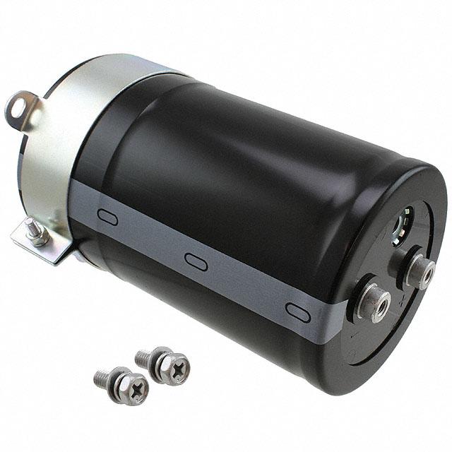

    3300 µF 450 V 铝电解电容器 径向,Can - 螺丝端子 85°C 时为 20000 小时
LNX2W332MSEH 数据手册
ALUMINUM ELECTROLYTIC CAPACITORS LNX Screw Terminal Type, 85°C High ripple longer life. Suited for use in industrial power supplies for inverter circuitry, etc. High ripple current, extra-high voltage application. High reliability, long life for 20,000 hours application of rated ripple current at +85°C. Extended range up to φ100 × 250L size. Flame retardant electroly to type available. Compliant to the RoHS directive (2011/65/EU,(EU)2015/863). LQR High Speed chargedischarge LNX Long life LNY Specifications Item Performance Characteristics Category Temperature Range Rated Voltage Range Rated Capacitance Range – 25 to +85°C Capacitance Tolerance ± 20% at 120Hz, 20°C Leakage Current After 5 minutes' application of rated voltage, leakage current is not more than 3 CV (µA) or 5 mA, whichever is smaller (at 20°C). [C : Rated Capacitance(µF), V : Voltage ( V ) ] Tangent of loss angle (tan δ) See refer to next page (Measurement frequency : 120Hz at 20°C) 350 to 550V 1000 to 27000µF 3 CV Rated voltage (V) Stability at Low Temperature 3 CV Measurement frequency : 120Hz 350 to 550 Z(– 25°C) / Z(+20°C) 8 Impedance ratio (max.) Endurance The specifications listed at right shall be met when the capacitors are restored to 20°C after the standard ripple current is applied for 20000 hours at 85°C, the peak voltage shall not exceed the rated voltage.(5000 hours at 85°C for the parts rated at 500V and 550V) The specifications listed at right shall be met when the capacitors are restored to Capacitance change Within ±20% of the initial capacitance value 20°C after D.C. bias plus rated ripple current is applied for 5000 hours at 85°C, tan δ 300% or less than the initial specified value the peak voltage shall not exceed the rated voltage. Leakage current Less than or equal to the initial specified value Shelf Life After storing the capacitors under no load at 85°C for 1000 hours and then performing voltage treatment based on JIS C 5101-4 clause 4.1 at 20°C, they shall meet the specified values for the endurance characteristics listed above. Marking Printed with white color letter on black sleeve. Drawing Screw terminal types for φ51 and larger Method mount metal bracket Bottom plate Hexagenal headed bolt Sleeve Type numbering system (Example : 450V 2200µF) 0° 12 1 3 4 5 6 7 8 9 10 11 12 13 14 Mounting bracket φD + 2 max. W±1 2 L N X 2W 2 2 2 M S E Pressure relief vent S h L+ max. T P±2 B H±1 U A±2 ±1 U S Configuration Cr (III) Plating (RoHS compliant) SE A± 2 P T B 3-leg brackets for φ90 capacitors have different hole shapes from the ordinary ones illustrated below. Resin bushing available upon request. Please refer to the Guidelines for Aluminum Electrolytic Capacitors for dimensions information. Please contact to us if PVCless products are required. 5 P Pressure relief vent 30° 7 Dimension of terminal pitch (W) and length (R) and Nominal dia.of bolt φD 51 63.5 76.2 90 100 W 22.0 28.6 31.8 31.8 41.5 R 6 6 6 6 10 α 3 3 3 3 4 (mm) Dimensions of mounting bracket M5 M5 M5 M5 M8 φD Symbol P A T S U ° H h (mm) 3­--Leg Leg shape Nominal dia. of bolt 51 32.5 38.5 7.5 5.0 12 60 20 15 63.5 38.1 43 8.0 5.0 14 60 25 20 76.2 44.5 49.2 7.0 5.0 14 60 30 24 2­--Leg 90 50.8 58.5 8.0 5.0 18 60 35 25 100 56.3 62 8.0 5.0 16 60 36 30 51 33.2 40 6.0 4.5 14 30 25 15 63.5 40.5 46.5 7.0 4.5 14 30 35 20 76.2 46.5 53 6.0 4.5 14 30 35 20 90 53 59 6.0 4.5 14 30 35 20 Dimension table in next page. CAT.8100M ALUMINUM ELECTROLYTIC CAPACITORS LNX Dimensions 350V (2V) 1000 51 × 60 3.5 4.6 0.2 1.77 LNX2V102MSEF 0.2 1.89 LNX2G102MSEF 1200 51 × 70 4.2 5.3 0.2 1.94 LNX2V122MSEF 1200 51 × 80 4.5 5.8 0.2 2.07 LNX2G122MSEF 1500 51 × 80 4.9 6.3 0.2 2.17 LNX2V152MSEF 1500 51 × 100 5.3 6.8 0.2 2.32 LNX2G152MSEF 1800 51 × 90 5.6 7.3 0.2 2.38 LNX2V182MSEF 1800 51 × 110 6.0 8.2 0.2 2.54 LNX2G182MSEF 2200 51 × 110 6.7 8.8 0.2 2.63 LNX2V222MSEF 51 × 130 7.0 9.3 0.2 2.81 LNX2G222MSEF 51 × 130 8.0 10.3 0.2 2.91 LNX2V272MSEF 63.5 × 90 6.8 8.9 0.2 2.81 LNX2G222MSEG LNX2G272MSEG 2700 Standard Rated Size ripple ripple φD × L(mm) (Arms) 1 (Arms) 2 400V (2G) Standard Rated Size ripple ripple φD × L(mm) (Arms) 1 (Arms) 2 1000 5.0 3.8 51 × 70 Cap. (µF) tan δ Leakage Current (mA) Code Cap. (µF) 2200 7.7 9.9 0.2 2.91 LNX2V272MSEG 51 × 150 9.2 12.1 0.2 3.22 LNX2V332MSEF 63.5 × 100 9.0 11.8 0.2 3.22 LNX2V332MSEG 63.5 × 110 10.4 12.5 0.2 3.50 LNX2V392MSEG 76.2 × 90 10.3 12.2 0.2 3.50 LNX2V392MSEH 63.5 × 130 12.0 14.8 0.2 3.84 LNX2V472MSEG 76.2 × 100 11.9 14.0 0.2 3.84 LNX2V472MSEH 63.5 × 150 14.0 17.0 0.2 4.20 LNX2V562MSEG 76.2 × 110 13.5 16.4 0.2 4.20 LNX2V562MSEH 63.5 × 170 16.3 19.6 0.2 4.62 LNX2V682MSEG 76.2 × 130 16.0 19.1 0.2 4.62 LNX2V682MSEH 76.2 × 150 18.7 22.0 0.2 5.00 LNX2V822MSEH 90 × 130 18.2 21.4 0.2 5.00 LNX2V822MSEJ 76.2 × 170 21.8 25.5 0.2 5.00 LNX2V103MSEH 90 × 150 21.3 25.3 0.2 5.00 LNX2V103MSEJ 76.2 × 190 25.1 29.1 0.2 5.00 LNX2V123MSEH 90 × 150 24.8 28.8 0.2 5.00 LNX2V123MSEJ 12000 90 × 190 29.0 36.0 0.2 5.00 LNX2V153MSEJ 18000 90 × 220 32.4 39.7 0.2 5.00 22000 100 × 220 38.0 43.2 0.2 5.00 27000 100 × 250 42.0 47.0 0.2 5.00 LNX2V273MSEK 3300 3900 4700 5600 6800 8200 10000 12000 15000 63.5 × 90 2700 3300 3900 4700 5600 6800 8200 tan δ Leakage Current (mA) Code 63.5 × 110 8.2 10.8 0.2 3.11 76.2 × 90 8.1 10.6 0.2 3.11 LNX2G272MSEH 63.5 × 130 9.6 12.9 0.2 3.44 LNX2G332MSEG 76.2 × 100 9.3 12.4 0.2 3.44 LNX2G332MSEH 63.5 × 150 11.0 14.4 0.2 3.74 LNX2G392MSEG 76.2 × 100 10.5 13.9 0.2 3.74 LNX2G392MSEH 63.5 × 170 12.6 16.6 0.2 4.11 LNX2G472MSEG 76.2 × 130 12.3 16.0 0.2 4.11 LNX2G472MSEH 63.5 × 190 14.7 18.8 0.2 4.48 LNX2G562MSEG 76.2 × 150 14.3 18.3 0.2 4.48 LNX2G562MSEH 76.2 × 170 16.7 21.2 0.2 4.94 LNX2G682MSEH 90 × 130 16.3 20.7 0.2 4.94 LNX2G682MSEJ 76.2 × 190 19.3 24.1 0.2 5.00 LNX2G822MSEH 90 × 150 19.0 23.7 0.2 5.00 LNX2G822MSEJ 76.2 × 220 22.7 28.3 0.2 5.00 LNX2G103MSEH 90 × 170 22.2 28.0 0.2 5.00 LNX2G103MSEJ 90 × 190 25.5 31.9 0.2 5.00 LNX2G123MSEJ 15000 100 × 190 29.6 37.0 0.2 5.00 LNX2G153MSEK LNX2V183MSEJ 18000 100 × 220 33.0 40.5 0.2 5.00 LNX2G183MSEK LNX2V223MSEK 22000 100 × 250 41.4 44.7 0.2 5.00 LNX2G223MSEK Leakage Current Code 10000 450V (2W) 500V (2H) 0.2 2.01 LNX2W102MSEF Standard Rated Size ripple ripple φD × L(mm) (Arms) 1 (Arms) 2 4.2 – 1000 51 × 110 0.2 2.12 LNX2H102MSEF 1200 51 × 100 4.7 6.3 0.2 2.20 LNX2W122MSEF 1200 63.5 × 90 4.8 – 0.2 2.32 LNX2H122MSEG 1500 51 × 110 5.4 7.3 0.2 2.46 LNX2W152MSEF 1500 63.5 × 90 5.5 – 0.2 2.59 LNX2H152MSEG 51 × 130 6.4 8.7 0.2 2.70 LNX2W182MSEF 1800 63.5 × 110 6.5 – 0.2 2.84 LNX2H182MSEG 63.5 × 90 6.1 7.6 0.2 2.70 LNX2W182MSEG 2200 63.5 × 130 7.7 – 0.2 3.14 LNX2H222MSEG 63.5 × 110 7.2 9.6 0.2 2.98 LNX2W222MSEG 2700 76.2 × 110 8.8 – 0.2 3.48 LNX2H272MSEH 76.2 × 90 7.1 9.4 0.2 2.98 LNX2W222MSEH 3300 76.2 × 130 10.4 – 0.2 3.85 LNX2H332MSEH 63.5 × 130 8.6 11.3 0.2 3.30 LNX2W272MSEG 3900 76.2 × 150 12.1 – 0.2 4.18 LNX2H392MSEH 76.2 × 100 8.3 11.0 0.2 3.30 LNX2W272MSEH 4700 90 × 130 13.7 – 0.2 4.59 LNX2H472MSEJ 63.5 × 150 10.0 13.3 0.2 3.65 LNX2W332MSEG 5600 90 × 150 15.9 – 0.2 5.00 LNX2H562MSEJ 76.2 × 110 9.7 12.9 0.2 3.65 LNX2W332MSEH 6800 90 × 170 18.5 – 0.2 5.00 LNX2H682MSEJ 63.5 × 170 11.4 15.1 0.2 3.97 LNX2W392MSEG 8200 90 × 190 21.4 – 0.2 5.00 LNX2H822MSEJ 76.2 × 130 11.2 14.6 0.2 3.97 LNX2W392MSEH 10000 100 × 190 23.8 – 0.2 5.00 LNX2H103MSEK 63.5 × 190 13.0 17.3 0.2 4.36 LNX2W472MSEG 12000 100 × 220 27.8 – 0.2 5.00 LNX2H123MSEK 76.2 × 150 12.9 16.9 0.2 4.36 LNX2W472MSEH 76.2 × 170 15.4 19.4 0.2 4.76 LNX2W562MSEH 90 × 150 15.3 19.1 0.2 4.76 LNX2W562MSEJ 76.2 × 190 17.3 22.0 0.2 5.00 LNX2W682MSEH Standard Rated Size ripple ripple φD × L(mm) (Arms) 1 (Arms) 2 51 × 80 1000 5.2 4.0 Cap. (µF) 1800 2200 2700 3300 3900 4700 5600 6800 8200 tan δ Leakage Current (mA) Code 90 × 150 17.1 21.6 0.2 5.00 LNX2W682MSEJ 76.2 × 220 20.3 25.7 0.2 5.00 LNX2W822MSEH 90 × 170 19.8 25.4 0.2 5.00 LNX2W822MSEJ 10000 90 × 190 23.0 29.6 0.2 5.00 LNX2W103MSEJ 12000 90 × 220 26.9 33.5 0.2 5.00 LNX2W123MSEJ 15000 100 × 220 31.1 38.0 0.2 5.00 LNX2W153MSEK 18000 100 × 250 37.0 41.3 0.2 5.00 LNX2W183MSEK Cap. (µF) tan δ (mA) Ripple current (Arms) at 85°C 120Hz CAT.8100M ALUMINUM ELECTROLYTIC CAPACITORS LNX Dimensions 550V (2L) Standard Rated Size ripple ripple φD × L(mm) (Arms) 1 (Arms) 2 – 4.3 51 × 130 1000 Cap. (µF) tan δ Leakage Current (mA) Code 0.2 2.22 LNX2L102MSEF 1200 63.5 × 110 5.0 – 0.2 2.43 LNX2L122MSEG 1500 63.5 × 130 6.0 – 0.2 2.72 LNX2L152MSEG 1800 76.2 × 110 6.7 – 0.2 2.98 LNX2L182MSEH 2200 76.2 × 130 8.0 – 0.2 3.30 LNX2L222MSEH 2700 76.2 × 150 9.4 – 0.2 3.65 LNX2L272MSEH 3300 76.2 × 170 11.0 – 0.2 4.04 LNX2L332MSEH 3900 90 × 150 12.5 – 0.2 4.39 LNX2L392MSEJ 4700 90 × 170 14.5 – 0.2 4.82 LNX2L472MSEJ 5600 90 × 190 16.6 – 0.2 5.00 LNX2L562MSEJ 6800 90 × 220 19.5 – 0.2 5.00 LNX2L682MSEJ 8200 100 × 220 21.6 – 0.2 5.00 LNX2L822MSEK 10000 100 × 250 25.2 – 0.2 5.00 LNX2L103MSEK Ripple current (Arms) at 85°C 120Hz Frequency coefficient of rated ripple current Frequency (Hz) Coefficient ( ( 50 0.80 60 0.82 120 1.00 360 1.20 1k 10k or more 1.35 1.40 1) • S  tandard ripple current: Ripple current value allowable for the life time of 20,000 hours at 85°C. (5,000 hours at 85°C for the voltage rating of 500V and 550V.) 2) • Maximum rated ripple current: Ripple current value allowable for the life time of 5,000 hours at 85°C. • 3-leg bracket is furnished as standard. In case no-bracket or 2-leg bracket required, please put BN or BB at the and of type number. Ex. 3-leg bracket LNX2G472MSEH 2-leg bracket LNX2G472MSEHBB No bracket LNX2G472MSEHBN • Flame-retardant type electrolyte is also available. Please contact to Nichicon representative for the rated ripple current value. CAT.8100M
