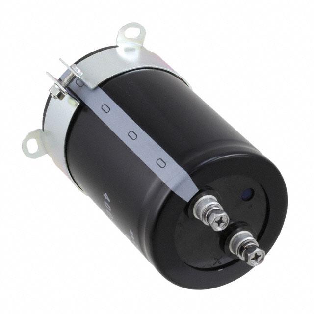

ALUMINUM ELECTROLYTIC CAPACITORS LNY Screw Terminal Type, 85°C Higher Capacitance LNY Suited for equipment down sizing. Load life of 2000 hours application of ripple current at 85°C Compliant to the RoHS directive (2011/65/EU,(EU)2015/863). High Voltage LNR Specifications Item Performance Characteristics Category Temperature Range Rated Voltage Range Rated Capacitance Range – 40 to +85°C 350 to 450V 820 to 22000µF Capacitance Tolerance ± 20% (120Hz, 20°C) Leakage Current After 5 minutes' application of rated voltage, leakage current is not more than 3 CV (µA) or 5 mA, whichever is smaller. (at 20°C) [C : Rated Capacitance(µF), V : Voltage ( V ) ] Tangent of loss angle (tan δ) See refer to next page (Measurement frequency : 120Hz at 20°C) 3 CV Rated voltage (V) Stability at Low Temperature 3 CV Measurement frequeny : 120Hz 350 to 450 Z(–40°C) / Z(+20°C) 12 Impedance ratio (max.) Insulation Resistance Voltage proof The insulation resistance shall be more than 100MΩ at DC 500V application between terminal and bracket. There is no abnormality during AC 2500V 1 minute's application between terminal and bracket. Endurance The specifications listed at right shall be met when the capacitors are restored to 20°C after D.C. bias plus rated ripple current is applied for 2000 hours at 85°C, the peak voltage shall not exceed the rated voltage. Capacitance change tan δ Leakage current Within ±20% of the initial capacitance value 300% or less than the initial specified value Less than or equal to the initial specified value Shelf Life After storing the capacitors under no load at 85°C for 1000 hours Capacitance change and then performing voltage treatment based on JIS C 5101-4 tan δ clause 4.1 at 20°C, they shall meet the reguirements listed at right. Leakage current Within ±20% of the initial capacitance value 300% or less than the initial specified value Less than or equal to the initial specified value Marking Printed with white color letter on black sleeve Type numbering system (Example: 400V 10000 F) Drawing 1 Hexagenal headed bolt Bottom plate 4 3 5 6 7 8 9 10 11 12 13 14 Mounting bracket Case dia. code ° Sleeve 2 L N Y 2 G 1 0 3 M S E J ° 120 Configuration Pressure relief vent W±1 φD+2max. Capacitance tolerance (±20%) Rated Capacitance (10000 F) Rated Voltage (400V) 3-leg brackets Code less 2-leg brackets BB No brackets BN Type U Configuration ±1 Cr (III) Plating (RoHS compliant) U S SE P T B 3-leg brackets for φ 90 capacitors have different hole shapes from the ordinary ones illustrated below. T P±2 A±2 A±2 B H±1 L+ max. Code F G H J Series name S h φD 051.0 063.5 076.2 090.0 (φ 51 to φ90) P Please refer to the Guidelines for Aluminum Electrolytic Capacitors for dimensions information. Please contact to us if PVCless products are required. 5 Dimension of terminal pitch (W) and length ( ) and Nominal dia. of bolt Pressure relief vent 7 Note) The brackets will be supplied in the separate box. 30° W 22.0 28.6 31.8 31.8 φD 51 63.5 76.2 90 α 3 3 3 3 6 6 6 6 Dimension of mounting bracket Leg shape Symbol P A T S U Dimension table in next page. H h φD 51 32.5 38.5 7.5 5.0 12 60 20 15 3-Leg 63.5 76.2 38.1 44.5 43 49.2 8.0 7.0 5.0 5.0 14 14 60 60 25 30 20 24 (mm) Nominal dia. of bolt M5 M5 M5 M5 (mm) 90 50.8 58.5 8.0 5.0 18 60 35 25 51 33.2 40 6.0 4.5 14 30 25 15 2-Leg 63.5 76.2 40.5 46.5 46.5 53 7.0 6.0 4.5 4.5 14 14 30 30 35 35 20 20 90 53 59 6.0 4.5 14 30 35 20 CAT.8100M ALUMINUM ELECTROLYTIC CAPACITORS LNY Dimensions 350V (2V) Cap. (µF) 1500 1800 2200 2700 3300 3900 4700 5600 6800 8200 10000 12000 15000 18000 22000 Size Rated ripple φD × L (mm) (Arms) 9.3 51 × 60 10.0 51 × 70 11.1 51 × 80 12.2 51 × 90 11.9 63.5 × 65 13.8 51 × 105 13.1 63.5 × 75 14.8 51 × 130 14.1 63.5 × 80 15.9 51 × 140 15.8 63.5 × 90 15.7 76.2 × 70 17.1 63.5 × 100 17.0 76.2 × 85 19.2 63.5 × 125 18.8 76.2 × 95 20.6 63.5 × 145 20.2 76.2 × 105 23.2 63.5 × 165 23.5 76.2 × 125 23.5 90 × 95 24.0 76.2 × 150 24.1 90 × 110 28.0 76.2 × 190 29.2 90 × 140 30.2 76.2 × 210 31.1 90 × 155 35.4 90 × 190 tan δ 0.25 0.25 0.25 0.25 0.25 0.25 0.25 0.25 0.25 0.25 0.25 0.25 0.25 0.25 0.25 0.25 0.25 0.25 0.25 0.25 0.25 0.25 0.25 0.25 0.25 0.25 0.25 0.25 400V (2G) Leakage Current (mA) 2.17 2.38 2.63 2.92 2.92 3.22 3.22 3.50 3.50 3.84 3.84 3.84 4.20 4.20 4.62 4.62 5.00 5.00 5.00 5.00 5.00 5.00 5.00 5.00 5.00 5.00 5.00 5.00 Code LNY2V152MSEF LNY2V182MSEF LNY2V222MSEF LNY2V272MSEF LNY2V272MSEG LNY2V332MSEF LNY2V332MSEG LNY2V392MSEF LNY2V392MSEG LNY2V472MSEF LNY2V472MSEG LNY2V472MSEH LNY2V562MSEG LNY2V562MSEH LNY2V682MSEG LNY2V682MSEH LNY2V822MSEG LNY2V822MSEH LNY2V103MSEG LNY2V103MSEH LNY2V103MSEJ LNY2V123MSEH LNY2V123MSEJ LNY2V153MSEH LNY2V153MSEJ LNY2V183MSEH LNY2V183MSEJ LNY2V223MSEJ Cap. (µF) 1000 1200 1500 1800 2200 2700 3300 3900 4700 5600 6800 8200 10000 12000 15000 18000 Size Rated ripple φD × L (mm) (Arms) 51 × 60 6.4 51 × 65 7.1 8.1 51 × 75 8.7 51 × 85 9.1 63.5 × 65 9.6 51 × 95 10.1 63.5 × 75 10.5 51 × 115 11.6 63.5 × 85 12.4 51 × 145 13.0 63.5 × 95 13.8 51 × 170 14.2 63.5 × 105 14.6 76.2 × 85 16.1 63.5 × 125 16.2 76.2 × 95 16.9 63.5 × 140 17.6 76.2 × 105 19.1 63.5 × 165 21.2 63.5 × 210 21.2 76.2 × 150 21.0 90 × 120 22.4 76.2 × 170 22.0 90 × 130 26.0 76.2 × 220 26.0 90 × 155 28.3 90 × 190 30.6 90 × 230 tan δ Leakage Current Code (mA) 1.89 2.07 2.32 2.54 2.54 2.81 2.81 3.11 3.11 3.44 3.44 3.74 3.74 3.74 4.11 4.11 4.48 4.48 4.94 5.00 5.00 5.00 5.00 5.00 5.00 5.00 5.00 5.00 0.25 0.25 0.25 0.25 0.25 0.25 0.25 0.25 0.25 0.25 0.25 0.25 0.25 0.25 0.25 0.25 0.25 0.25 0.25 0.25 0.25 0.25 0.25 0.25 0.25 0.25 0.25 0.25 LNY2G102MSEF LNY2G122MSEF LNY2G152MSEF LNY2G182MSEF LNY2G182MSEG LNY2G222MSEF LNY2G222MSEG LNY2G272MSEF LNY2G272MSEG LNY2G332MSEF LNY2G332MSEG LNY2G392MSEF LNY2G392MSEG LNY2G392MSEH LNY2G472MSEG LNY2G472MSEH LNY2G562MSEG LNY2G562MSEH LNY2G682MSEG LNY2G822MSEG LNY2G822MSEH LNY2G822MSEJ LNY2G103MSEH LNY2G103MSEJ LNY2G123MSEH LNY2G123MSEJ LNY2G153MSEJ LNY2G183MSEJ 450V (2W) Cap. (µF) 820 1000 1200 1500 1800 2200 2700 3300 3900 4700 5600 6800 8200 10000 12000 15000 Size Rated ripple φD × L (mm) (Arms) 4.9 51 × 60 51 × 70 5.5 6.0 51 × 75 6.8 51 × 85 7.9 63.5 × 65 7.9 51 × 95 8.9 63.5 × 75 9.2 51 × 125 9.8 63.5 × 85 10.3 51 × 145 10.8 63.5 × 90 11.1 51 × 170 12.0 63.5 × 105 12.6 76.2 × 85 13.5 63.5 × 125 14.0 76.2 × 95 15.2 63.5 × 145 15.6 76.2 × 105 17.0 63.5 × 165 17.6 76.2 × 125 19.1 63.5 × 210 19.6 76.2 × 150 19.5 90 × 120 20.1 76.2 × 170 20.1 90 × 130 23.0 76.2 × 210 22.9 90 × 155 26.0 90 × 190 29.6 90 × 220 tan δ 0.25 0.25 0.25 0.25 0.25 0.25 0.25 0.25 0.25 0.25 0.25 0.25 0.25 0.25 0.25 0.25 0.25 0.25 0.25 0.25 0.25 0.25 0.25 0.25 0.25 0.25 0.25 0.25 0.25 Leakage Current (mA) 1.82 2.01 2.20 2.46 2.46 2.70 2.70 2.98 2.98 3.30 3.30 3.65 3.65 3.65 3.97 3.97 4.36 4.36 4.76 4.76 5.00 5.00 5.00 5.00 5.00 5.00 5.00 5.00 5.00 Code LNY2W821MSEF LNY2W102MSEF LNY2W122MSEF LNY2W152MSEF LNY2W152MSEG LNY2W182MSEF LNY2W182MSEG LNY2W222MSEF LNY2W222MSEG LNY2W272MSEF LNY2W272MSEG LNY2W332MSEF LNY2W332MSEG LNY2W332MSEH LNY2W392MSEG LNY2W392MSEH LNY2W472MSEG LNY2W472MSEH LNY2W562MSEG LNY2W562MSEH LNY2W682MSEG LNY2W682MSEH LNY2W682MSEJ LNY2W822MSEH LNY2W822MSEJ LNY2W103MSEH LNY2W103MSEJ LNY2W123MSEJ LNY2W153MSEJ Rated ripple current (Arms) at 85°C 120Hz Frequency coefficient of rated ripple current Frequency (Hz) Coefficient 50 0.80 60 0.82 120 1.00 360 1.20 1k 1.35 10k or more 1.40 CAT.8100M

参数特性: - 工作温度范围:-40至+85°C - 额定电压范围:350至450V - 额定电容范围:820至22000微法拉 - 电容公差:+20%(在120Hz,20°C下) - 漏电流:在额定电压下5分钟后不超过3.0 C V的微安培或5毫安,取较小值 - 损耗角正切值(tan δ):见下一页 - 低温稳定性:在-40°C时的阻抗与+20°C时的阻抗比不超过12 - 绝缘电阻:在DC 500V下,端子与支架间的绝缘电阻应大于100MΩ - 耐电压耐久性:在AC 2500V下1分钟无异常
功能详解:文档提供了详细的规格表,包括电容值、尺寸、额定纹波电流、损耗角正切值、漏电流和型号编码。
应用信息:适用于需要小型化和高电容的应用,且在85°C下有2000小时的负载寿命。
封装信息:提供了详细的尺寸信息,包括端子间距、长度和螺栓直径。
