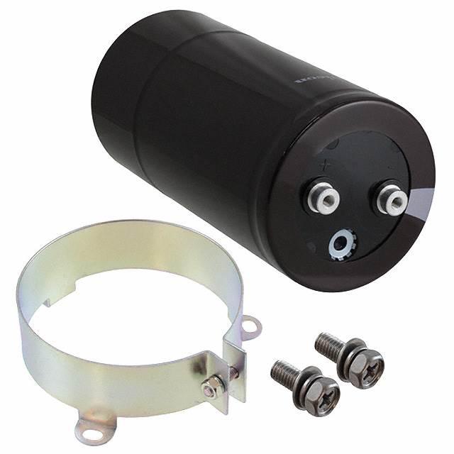

    8200 µF 350 V 铝电解电容器 径向,Can - 螺丝端子 85°C 时为 5000 小时
LQR2V822MSEH 数据手册
ALUMINUM ELECTROLYTIC CAPACITORS QR Screw Terminal Type, High speed charge-discharge series Suited for high frequency regenerative voltage for AC servomotor, general inverter. Suited for equipment used at valtage fluctuating area. Suited for rectifier circuit of voltage doubler Available for adapted to the RoHS directive (2002/95/EC). QR Hi speed chargedischarge Specifications Item NX Performance Characteristics Category Temperature Range Rated Voltage Range Rated Capacitance Range Capacitance Tolerance Leakage Current – 25 ~ +85°C 350 ~ 450V 680 ~ 15000µF ± 20% at 120Hz, 20°C After 5 minutes' application of rated voltage, leakage current is not more than 3 CV (µA) or 5 mA, whichever is smaller (at 20°C). [C : Rated Capacitance(µF), V : Voltage ( V ) ] (Measurement frequency:120Hz, Temperature:20°C) 450 0.15 Rated voltage (V) tan δ (MAX.) Rated voltage (V) 350 0.15 400 0.15 tan δ Stability at Low Temperature Impedance ratio ZT/Z20(MAX.) 350 ~ 450 Z – 25°C / Z+20°C 8 Measurement frequency : 120Hz Endurance of chargedischarge behavior After an application of charge-discharge voltage for 20million times (charge-discharge voltage difference(∆V)=rated voltage × 0.3, cycle 3Hz)capacitors shell meet the characteristics requirement listed at right Capacitance change tan δ Leakage current Appearance Within ±20% of initial value 300% or less of initial specified value Initial specified value or less There shell be found to remarkable abnormality on the capacitor Within ±20% of initial value 300% or less of initial specified value Initial specified value or less Endurance After an application of DC voltage (in the range of rated voltage even after over-lapping the standard ripple current) for 5,000 hours at 85°C, capacitors meet the characteristics requirements listed at right. Capacitance change tan δ Leakage current Shelf Life Marking After storing the capacitors under no load at 85°C for 1000 hours, and after performing voltage treatment based on JIS C 5101-4 clause 4.1 at 20°C, they will meet the specified value for endurance characteristics listed above. Printed with white color letter on darkbrown sleeve. Drawing B 35 Screw terminal type Hexagenal headed bolt (M5) Bottom plate Sleeve φ 51 ~ 90 Screw terminal type Bottom plate Sleeve Hexagenal headed bolt ¡ 120 Pressure relief vent Pressure relief vent 35 +2MAX 12.7±1 3.5 45±1 D + 2 MAX. W±1 S 10 30¡ + 7 h H ±1 L+ MAX. ±1 B P ±2 A ±2 U S T T U 10 24 15±0.5 L +3MAX. 6±1 29±1 P Pressure relief vent 30¡ 7 Type numbering system (Example : 400V 1800µF) 1 2 3 4 5 6 7 8 9 10 11 12 13 14 Mounting bracket Dimension of terminal pitch (W) and length (R) and Nominal dia. of bolt φD 51 63.5 76.2 90 W 22.0 28.6 31.8 31.8 R 6 6 6 6 α 3 3 3 3 M5 M5 M5 M5 5 A ±2 B 3-leg brackets for φ90 capacitors have different hole shapes from the ordinary ones illustrated below. P (mm) Nominal dia. of bolt L QR 2G 1 8 2 M SE F Case dia. code Configuration Capacitance tolerance (±20%) Rated Capacitance (1800µF) Rated voltage (400V) Series name Type Configuration Cr (III) Plating (RoHS compliant) φD Code C 35 F 51 63.5 G 76.2 H J 90 (φ35) Code less 2-leg brackets BN No brackets (φ51 ~ φ90) Code less 3-leg brackets 2-leg brackets BB No brackets BN Dimension of mounting bracket Leg shape (mm) 3--Leg 51 32.5 38.5 7.5 5.0 12 60 20 15 63.5 38.1 43 8.0 5.0 14 60 25 20 76.2 44.5 49.2 7.0 5.0 14 60 30 24 90 50.8 58.5 8.0 5.0 18 60 35 25 51 33.2 40 6.0 4.5 14 30 25 15 2--Leg 63.5 40.5 46.5 7.0 4.5 14 30 35 20 76.2 46.5 53 6.0 4.5 14 30 35 20 90 53 59 6.0 4.5 14 30 35 20 Symbol φD P A T S U ° SE Resin bushing available upon request. Please contact us if PVCless products are required H h Dimension table in next page. CAT.8100V ALUMINUM ELECTROLYTIC CAPACITORS QR V (code) Surge Cap. (µF) 820 1000 1800 2200 2700 3300 3900 4700 5600 series Dimensions 350V (2V) Size φD × L(mm) 35 × 100 51 × 80 51 × 100 63.5 × 80 51 63.5 × 90 51 × 110 35 × 80 Rated ripple (Arms) V (code) Surge Cap. (µF) 680 820 1500 1800 2200 2700 3300 3900 4700 5600 6800 8200 10000 12000 15000 Size φD × L(mm) 35 × 80 51 × 80 51 × 90 35 × 100 Rated ripple (Arms) 400V (2G) 450V Leakage Current tan δ Code (mA) LQR2G681MSEC 0.15 1.56 0.15 0.15 0.15 0.15 0.15 0.15 0.15 0.15 0.15 0.15 0.15 0.15 0.15 0.15 0.15 0.15 0.15 0.15 0.15 1.71 2.32 2.54 2.81 3.11 3.44 3.44 3.74 3.74 4.11 4.11 4.48 4.48 4.94 5.00 5.00 5.00 5.00 5.00 LQR2G821MSEC LQR2G152MSEF LQR2G182MSEF LQR2G222MSEF LQR2G272MSEG LQR2G332MSEF LQR2G332MSEG LQR2G392MSEG LQR2G392MSEH LQR2G472MSEG LQR2G472MSEH LQR2G562MSEG LQR2G562MSEH LQR2G682MSEH LQR2G822MSEH LQR2G822MSEJ LQR2G103MSEJ LQR2G123MSEJ LQR2G153MSEJ 3.3 4.3 7.2 9.1 10.8 10.6 12.4 11.9 14.6 14.1 17.0 16.4 20.4 19.7 23.5 22.9 22.5 27.1 26.4 31.1 30.2 35.7 40.5 400V Leakage Current tan δ Code (mA) LQR2V821MSEC 0.15 1.60 0.15 0.15 0.15 0.15 0.15 0.15 0.15 0.15 0.15 0.15 0.15 0.15 0.15 0.15 0.15 0.15 0.15 0.15 0.15 0.15 0.15 0.15 1.77 2.38 2.63 2.91 2.91 3.22 3.22 3.50 3.50 3.84 3.84 4.20 4.20 4.62 4.62 4.62 5.00 5.00 5.00 5.00 5.00 5.00 LQR2V102MSEC LQR2V182MSEF LQR2V222MSEF LQR2V272MSEF LQR2V272MSEG LQR2V332MSEF LQR2V332MSEG LQR2V392MSEG LQR2V392MSEH LQR2V472MSEF LQR2V472MSEH LQR2V562MSEG LQR2V562MSEH LQR2V682MSEG LQR2V682MSEH LQR2V682MSEJ LQR2V822MSEG LQR2V822MSEH LQR2V103MSEH LQR2V103MSEJ LQR2V123MSEH LQR2V153MSEJ 3.2 4.1 7.5 9.1 10.4 11.5 13.7 13.2 16.0 15.3 18.7 18.3 22.0 21.4 25.4 28.6 27.8 32.7 37.6 43.0 × 130 63.5 × 900 51 × 110 51 × 150 63.5 × 110 76.2 × 80 51 × 170 63.5 × 110 63.5 × 130 76.2 × 900 63.5 × 150 76.2 × 110 63.5 × 170 76.2 × 130 76.2 × 150 76.2 × 170 90 × 130 90 × 150 90 × 170 90 × 220 76.2 × 900 63.5 × 150 76.2 × 110 63.5 × 170 76.2 × 130 63.5 × 190 76.2 × 150 76.2 × 170 76.2 × 190 90 × 190 90 × 130 90 × 100 6800 8200 10000 12000 15000 V (code) Surge Cap. (µF) 680 820 1200 1500 1800 2200 2700 3300 Size φD × L(mm) 35 × 100 35 × 110 51 × 80 51 × 100 63.5 × 80 51 × 110 51 × 130 51 × 150 Rated ripple (Arms) 450V (2W) 500V tan δ 0.15 0.15 0.15 0.15 0.15 0.15 0.15 0.15 0.15 0.15 0.15 0.15 0.15 0.15 0.15 0.15 0.15 0.15 0.15 0.15 0.15 0.15 0.15 0.15 Leakage Current Code (mA) LQR2W681MSEC 1.65 1.82 2.20 2.46 2.70 2.70 2.98 2.98 3.30 3.30 3.65 3.65 3.97 3.97 3.97 4.36 4.36 4.36 4.76 4.76 5.00 5.00 5.00 5.00 LQR2W821MSEC LQR2W122MSEF LQR2W152MSEF LQR2W182MSEF LQR2W182MSEG LQR2W222MSEF LQR2W222MSEG LQR2W272MSEF LQR2W272MSEH LQR2W332MSEG LQR2W332MSEH LQR2W392MSEG LQR2W392MSEH LQR2W392MSEJ LQR2W472MSEG LQR2W472MSEH LQR2W472MSEJ LQR2W562MSEG LQR2W562MSEJ LQR2W682MSEH LQR2W822MSEJ LQR2W103MSEJ LQR2W123MSEJ 3.5 3.9 5.2 6.3 7.4 7.9 8.7 8.6 10.2 10.0 12.4 11.8 13.7 14.1 13.6 16.5 16.3 15.8 19.4 19.1 23.3 26.1 31.3 35.5 63.5 × 100 76.2 × 80 63.5 × 130 76.2 × 100 63.5 × 150 76.2 × 110 63.5 × 170 90 × 90 3900 4700 76.2 × 130 63.5 × 190 76.2 × 170 90 × 150 90 × 190 90 × 220 90 × 130 90 × 110 5600 6800 8200 10000 12000 Rated Ripple (Arms) at 85°C 120Hz Frequency coefficient of rated ripple current Frequency (Hz) Coefficient 60 0.82 120 1.00 360 1.20 1k 1.35 10k~ 1.40 CAT.8100V
