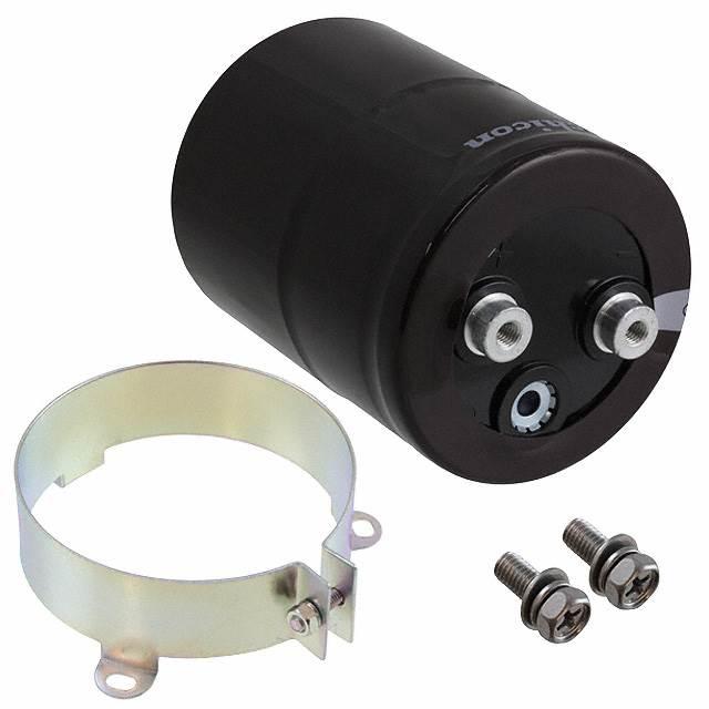

    1800 µF 450 V 铝电解电容器 径向,Can - 螺丝端子 85°C 时为 5000 小时
LQR2W182MSEG 数据手册
ALUMINUM ELECTROLYTIC CAPACITORS LQR Screw Terminal Type, 85°C High speed charge-discharge Suited for high frequency regenerative voltage for AC servomotor, general inverter. Suited for equipment used at valtage fluctuating area. Suited for rectifier circuit of voltage doubler Compliant to the RoHS directive (2011/65/EU,(EU)2015/863). LQR Hi speed chargedischarge LNX Specifications Item Performance Characteristics Category Temperature Range Rated Voltage Range Rated Capacitance Range – 25 to +85°C Capacitance Tolerance ± 20% at 120Hz, 20°C Leakage Current After 5 minutes' application of rated voltage, leakage current is not more than 3 CV (µA) or 5 mA, whichever is smaller (at 20°C). [C : Rated Capacitance(µF), V : Voltage ( V ) ] Tangent of loss angle (tan δ) See refer to next page (Measurement frequency : 120Hz at 20°C) 350 to 450V 680 to 15000µF 3 CV Rated voltage (V) Stability at Low Temperature 3 CV Measurement frequency : 120Hz 350 to 450 Z(–25°C) / Z(+20°C) 8 Impedance ratio (max.) Capacitance change tan δ Leakage current Within ±20% of the initial capacitance value 300% or less than the initial specified value Less than or equal to the initial specified value Endurance The specifications listed at right shall be met when the capacitors are restored to 20°C after D.C. bias plus rated ripple current is applied for 5000 hours at 85°C, the peak voltage shall not exceed the rated voltage. Shelf Life After storing the capacitors under no load at 85°C for 1000 hours and then performing voltage treatment based on JIS C 5101-4 clause 4.1 at 20°C, they shall meet the specified value for endurance characteristics listed above. Endurance of chargedischarge behavior After an application of charge-discharge voltage for 20million times (charge-discharge voltage difference(ΔV)=rated voltage × 0.3, cycle 3Hz)capacitors shell meet the characteristics requirement listed at right Marking Printed with white color letter on darkbrown sleeve. Capacitance change tan δ Leakage current Appearance Within ±20% of the initial capacitance value 300% or less than the initial specified value Less than or equal to the initial specified value There shell be found to remarkable abnormality on the capacitor Screw terminal types for φ51 and larger Drawing φ 51 to 90 Screw terminal type Bottom plate φ 35 Screw terminal type Hexagenal headed bolt Sleeve 0° 12 Pressure relief vent W±1 Sleeve 3.5 10 45±1 30° 35+2max. + S 12.7±1 Pressure relief vent h 7 L+ max. 10 ±1 24 U S B 3-leg brackets for φ90 capacitors have different hole shapes from the ordinary ones illustrated below. P T 6±1 L+3max. U A±2 15±0.5 29±1 T P±2 B H±1 A±2 Bottom plate D+ 2 max. Hexagenal headed bolt (M5) 5 P Pressure relief vent 30° 7 Type numbering system (Example : 400V 1800µF) 1 2 3 4 5 6 7 8 9 10 11 12 13 14 L QR 2 G 1 8 2 M S E F Mounting bracket Case dia. code Configuration Capacitance tolerance (±20%) Rated Capacitance (1800µF) Rated voltage (400V) φD Code C 35 F 51 63.5 G 76.2 H J 90 (φ35) Code less 2-leg brackets BN No brackets (φ51 to φ90) Code less 3-leg brackets BB 2-leg brackets No brackets BN Series name Type Configuration Cr (III) Plating (RoHS compliant) SE Please refer to the Guidelines for Aluminum Electrolytic Capacitors for dimensions information. Please contact to us if PVCless products are required. Dimension of terminal pitch (W) and length (R) and Nominal dia. of bolt W 22.0 28.6 31.8 31.8 φD 51 63.5 76.2 90 (mm) Nominal dia. of bolt α 3 3 3 3 R 6 6 6 6 M5 M5 M5 M5 Dimension of mounting bracket φD Symbol P A T S U ° H h (mm) 3­--Leg Leg shape 51 32.5 38.5 7.5 5.0 12 60 20 15 63.5 38.1 43 8.0 5.0 14 60 25 20 76.2 44.5 49.2 7.0 5.0 14 60 30 24 2­--Leg 90 50.8 58.5 8.0 5.0 18 60 35 25 51 33.2 40 6.0 4.5 14 30 25 15 63.5 40.5 46.5 7.0 4.5 14 30 35 20 76.2 46.5 53 6.0 4.5 14 30 35 20 90 53 59 6.0 4.5 14 30 35 20 Dimension table in next page. CAT.8100L ALUMINUM ELECTROLYTIC CAPACITORS LQR Dimensions 400V (2G) 350V (2V) Cap. (µF) 820 Size Rated ripple φD × L(mm) (Arms) 3.3 0.35 × 800 0.15 1.60 LQR2V821MSEC 680 Size Rated ripple φD × L(mm) (Arms) 03.2 0.35 × 800 0.15 1.56 LQR2G681MSEC 1000 0.35 × 100 4.3 0.15 1.77 LQR2V102MSEC 820 0.35 × 100 04.1 0.15 1.71 LQR2G821MSEC 1800 0.51 × 800 7.2 0.15 2.38 LQR2V182MSEF 1500 0.51 × 800 07.5 0.15 2.32 LQR2G152MSEF 2200 0.51 × 100 9.1 0.15 2.63 LQR2V222MSEF 1800 0.51 × 900 09.1 0.15 2.54 LQR2G182MSEF 0.51 × 110 10.8 0.15 2.91 LQR2V272MSEF 2200 0.51 × 110 10.4 0.15 2.81 LQR2G222MSEF 63.5 × 800 10.6 0.15 2.91 LQR2V272MSEG 2700 63.5 × 900 11.5 0.15 3.11 LQR2G272MSEG 0.51 × 130 12.4 0.15 3.22 LQR2V332MSEF 0.51 × 150 13.7 0.15 3.44 LQR2G332MSEF 63.5 × 900 11.9 0.15 3.22 LQR2V332MSEG 63.5 × 110 13.2 0.15 3.44 LQR2G332MSEG 63.5 × 110 14.6 0.15 3.50 LQR2V392MSEG 63.5 × 130 16.0 0.15 3.74 LQR2G392MSEG 76.2 × 800 14.1 0.15 3.50 LQR2V392MSEH 76.2 × 900 15.3 0.15 3.74 LQR2G392MSEH 0.51 × 170 17.0 0.15 3.84 LQR2V472MSEF 63.5 × 150 18.7 0.15 4.11 LQR2G472MSEG 76.2 × 900 16.4 0.15 3.84 LQR2V472MSEH 76.2 × 110 18.3 0.15 4.11 LQR2G472MSEH 63.5 × 150 20.4 0.15 4.20 LQR2V562MSEG 63.5 × 170 22.0 0.15 4.48 LQR2G562MSEG 76.2 × 110 19.7 0.15 4.20 LQR2V562MSEH 76.2 × 130 21.4 0.15 4.48 LQR2G562MSEH 63.5 × 170 23.5 0.15 4.62 LQR2V682MSEG 76.2 × 150 25.4 0.15 4.94 LQR2G682MSEH 76.2 × 130 22.9 0.15 4.62 LQR2V682MSEH 76.2 × 170 28.6 0.15 5.00 LQR2G822MSEH 0.90 × 100 22.5 0.15 4.62 LQR2V682MSEJ 0.90 × 130 27.8 0.15 5.00 LQR2G822MSEJ 63.5 × 190 27.1 0.15 5.00 LQR2V822MSEG 10000 0.90 × 150 32.7 0.15 5.00 LQR2G103MSEJ 76.2 × 150 26.4 0.15 5.00 LQR2V822MSEH 12000 0.90 × 170 37.6 0.15 5.00 LQR2G123MSEJ 76.2 × 170 0.90 × 130 31.1 0.15 5.00 LQR2V103MSEH 15000 0.90 × 220 43.0 0.15 5.00 LQR2G153MSEJ 30.2 0.15 5.00 LQR2V103MSEJ 76.2 × 190 0.90 × 190 35.7 0.15 5.00 LQR2V123MSEH 40.5 0.15 5.00 LQR2V153MSEJ 2700 3300 3900 4700 5600 6800 8200 10000 12000 15000 tan δ Leakage Current Code (mA) Cap. (µF) 3300 3900 4700 5600 6800 8200 tan δ Leakage Current (mA) Code 450V (2W) Cap. (µF) 680 Size Rated ripple φD × L(mm) (Arms) 3.5 0.35 × 100 tan δ Leakage Current Code (mA) 0.15 1.65 LQR2W681MSEC 820 0.35 × 110 3.9 0.15 1.82 LQR2W821MSEC 1200 0.51 × 800 5.2 0.15 2.20 LQR2W122MSEF 1500 0.51 × 100 6.3 0.15 2.46 LQR2W152MSEF 0.51 × 110 7.4 0.15 2.70 LQR2W182MSEF 63.5 × 800 7.9 0.15 2.70 LQR2W182MSEG 0.51 × 130 8.7 0.15 2.98 LQR2W222MSEF 63.5 × 100 8.6 0.15 2.98 LQR2W222MSEG 0.51 × 150 10.2 0.15 3.30 LQR2W272MSEF 76.2 × 800 10.0 0.15 3.30 LQR2W272MSEH 63.5 × 130 12.4 0.15 3.65 LQR2W332MSEG 76.2 × 100 11.8 0.15 3.65 LQR2W332MSEH 63.5 × 150 13.7 0.15 3.97 LQR2W392MSEG 76.2 × 110 14.1 0.15 3.97 LQR2W392MSEH 0.90 × 900 13.6 0.15 3.97 LQR2W392MSEJ 63.5 × 170 16.5 0.15 4.36 LQR2W472MSEG 76.2 × 130 16.3 0.15 4.36 LQR2W472MSEH 0.90 × 110 15.8 0.15 4.36 LQR2W472MSEJ 63.5 × 190 19.4 0.15 4.76 LQR2W562MSEG 1800 2200 2700 3300 3900 4700 5600 0.90 × 130 19.1 0.15 4.76 LQR2W562MSEJ 6800 76.2 × 170 23.3 0.15 5.00 LQR2W682MSEH 8200 0.90 × 150 26.1 0.15 5.00 LQR2W822MSEJ 10000 0.90 × 190 31.3 0.15 5.00 LQR2W103MSEJ 12000 0.90 × 220 35.5 0.15 5.00 LQR2W123MSEJ Rated ripple current (Arms) at 85°C 120Hz Frequency coefficient of rated ripple current Frequency (Hz) Coefficient 50 0.80 60 0.82 120 1.00 360 1.20 1k 1.35 10k or more 1.40 CAT.8100L
