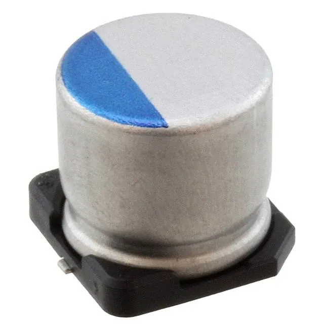

    铝聚合物电容器 CAP_D10X12.7MM_SM 15µF ±20% 125V Ф10.00mm 48mΩ
PCV2B150MCL1GS 数据手册
CONDUCTIVE POLYMER ALUMINUM SOLID ELECTROLYTIC CAPACITORS PCV Chip Type, High Voltage / Long Life High voltage (to 125V), Low ESR, High ripple current. Load life of 3000 hours at 105°C. SMD type : Lead free reflow soldering condition at 260°C peak correspondence. Compliant to the RoHS directive (2011/65/EU,(EU)2015/863). AEC-Q200 compliant. Please contact us for details. PCX PCV High Temperature Specifications Item Performance Characteristics Category Temperature Range – 55 to +105°C Rated Voltage Range 16 to 125V Rated Capacitance Range 5.6 to 680µF Capacitance Tolerance ± 20% at 120Hz, 20°C Tangent of loss angle (tan δ) Less than or equal to the specified value at 120Hz, 20°C ESR ( 1) Less than or equal to the specified value at 100kHz, 20°C Leakage Current ( 2) Less than or equal to the specified value . 1.25 1.25 After 2 minutes' application of rated voltage at 20°C (100kHz) Temperature Characteristics (Max.Impedance Ratio) Z+105°C / Z+20°C Z– 55°C / Z+20°C Endurance The specifications listed at right shall be met when the capacitors are restored to 20°C after the rated voltage is applied for 3000 hours at 105°C. Capacitance change tan δ ESR ( 1) Leakage current ( 2) Within ± 20% of the initial capacitance value ( 3) 150% or less than the initial specified value 150% or less than the initial specified value Less than or equal to the initial specified value Damp Heat (Steady State) The specifications listed at right shall be met when the capacitors are restored to 20°C after the rated voltage is applied for 1000 hours at 60°C, 90% RH. Capacitance change tan δ ESR ( 1) Leakage current ( 2) Within ± 20% of the initial capacitance value ( 3) 150% or less than the initial specified value 150% or less than the initial specified value Less than or equal to the initial specified value Resistance to Soldering Heat After soldering the capacitor under the soldering conditions prescribed here, the capacitor shall meet the specifications listed at right. Pre-heating shall be done at 150 to 200°C and for 60 to 180 sec. The duration for over +230°C temperature at capacitor surface shall not exceed 60 seconds. In case peak temperature is 250°C or less, reflow soldering shall be two times maximum. In case peak temperature is 260°C or less, reflow soldering shall be once. Measurement for solder temperature profile shall be made at the capacitor top. Capacitance change tan δ ESR ( 1) Leakage current ( 2) Within ± 10% of the initial capacitance value ( 3) 130% or less than the initial specified value 130% or less than the initial specified value Less than or equal to the initial specified value Marking Navy blue print on the case top 1 ESR should be measured at both of the terminal ends closest where the terminals protrude through the plastic platform. 2 Conditioning : If any doubt arises, measure the leakage current after the voltage treatment of applying DC rated voltage continuously to the capacitor for 120 minutes at 105°C. 3 Initial value : The value before test of examination of resistance to soldering. Dimensions Lot No. 0.3 MAX. 1 0.5 MAX. Capacitance Type numbering system (Example : 35V 82µF) Positive Plastic platform C±0.2 2 3 4 5 6 7 8 9 10 11 12 13 14 PCV 1 V 8 2 0 MC L 1 GS Taping code A±0.2 E B±0.2 φD±0.5 CV 82 V 012 Size code Configuration Capacitance tolerance (±20%) Rated capacitance (82µF) L +0.1 -0.4 Voltage (V:35V) Series Rated voltage (35V) Negative H Series name Type (mm) Size φ6.3 ×6L φ8 ×7L φ8 ×10L φ8 ×12L φ10 ×8L φ10 ×10L φ10×12.7L φD 6.3 8.0 8.0 8.0 10.0 10.0 10.0 L 5.9 6.9 9.9 11.9 7.9 9.9 12.6 A 7.3 9.0 9.0 9.0 11.0 11.0 11.0 B 6.6 8.3 8.3 8.3 10.3 10.3 10.3 C 6.6 8.3 8.3 8.3 10.3 10.3 10.3 E 2.1 3.2 3.2 3.2 4.6 4.6 4.6 H 0.5 to 0.8 0.8 to 1.1 0.8 to 1.1 0.8 to 1.1 0.8 to 1.1 0.8 to 1.1 0.8 to 1.1 Dimension table in next page. Voltage V 16 20 25 35 50 63 80 100 125 Code C D E V H J K 2A 2B Frequency coefficient of rated ripple current 0 Frequency0/ 120Hz Coefficient 0.05 1kHz 0.30 10kHz 100kHz or more 0.70 1.00 CAT.8100K CONDUCTIVE POLYMER ALUMINUM SOLID ELECTROLYTIC CAPACITORS PCV Dimensions Rated Voltage (V) (code) Surge Voltage (V) Case Size φD × L (mm) tan δ Leakage Current (µA) at 20°C after 2 minutes 56 6.3 × 6 0.12 179 82 6.3 × 6 0.12 262 100 8×7 0.12 150 8×7 220 8 × 10 Rated Capacitance (µF) 220 16 (1C) 20 (1D) 18.4 23.0 28.7 40.2  50 1000 PCV1C560MCL1GS 47 1300 PCV1C820MCL2GS 320  36 1500 PCV1C101MCL1GS 0.12 480 34 1700 PCV1C151MCL2GS 0.12 704  27 2000 PCV1C221MCL6GS 0.12 704 31 2000 PCV1C221MCL1GS ) 8 × 10 0.12 864 21 3800 PCV1C271MCL7GS 270 8 × 12 0.12 864  26 2300 PCV1C271MCL1GS 270 10 × 8 0.12 864 24 3200 PCV1C271MCL2GS 330 10 × 10 0.12 1056  26 2400 PCV1C331MCL1GS 390 8 × 12 0.12 1248 20 4100 PCV1C391MCL2GS 470 10 × 10 0.12 1504 21 3900 PCV1C471MCL2GS 470 10 × 12.7 0.12 1504  25 2800 PCV1C471MCL1GS 680 10 × 12.7 0.12 2176 19 4400 PCV1C681MCL2GS 47 6.3 × 6 0.12 188  55 1000 PCV1D470MCL1GS 56 6.3 × 6 0.12 224 48 1300 PCV1D560MCL2GS 68 8×7 0.12 272  45 1300 PCV1D680MCL1GS 100 8×7 0.12 400 42 1400 PCV1D101MCL2GS 150 8 × 10 0.12 600  28 2000 PCV1D151MCL6GS 150 10 × 8 0.12 600 33 1900 PCV1D151MCL1GS 180 10 × 8 0.12 720 25 3100 PCV1D181MCL2GS 220 8 × 10 0.12 880 22 3700 PCV1D221MCL7GS 220 8 × 12 0.12 880  27 2300 PCV1D221MCL1GS 270 8 × 12 0.12 1080 21 4000 PCV1D271MCL2GS 270 10 × 10 0.12 1080   27 2300 PCV1D271MCL1GS 330 10 × 10 0.12 1320 22 3800 PCV1D331MCL2GS 330 10 × 12.7 0.12 1320  26 2700 PCV1D331MCL1GS 470 10 × 12.7 0.12 1880 20 4300 PCV1D471MCL2GS 33 6.3 × 6 0.12 165  60 1000 PCV1E330MCL1GS 47 6.3 × 6 0.12 235 49 1300 PCV1E470MCL2GS 56 8×7 0.12 280  50 1300 PCV1E560MCL1GS 82 8×7 0.12 410 47 1400 PCV1E820MCL2GS 120 8 × 10 0.12 600  29 1900 PCV1E121MCL6GS 0.12 600 35 1800 PCV1E121MCL1GS 10 × 8 150 8 × 10 0.12 750 23 3600 PCV1E151MCL7GS 150 8 × 12 0.12 750  28 2200 PCV1E151MCL1GS 150 10 × 8 0.12 750 26 3000 PCV1E151MCL2GS 180 10 × 10 0.12 900   28 2300 PCV1E181MCL1GS 220 8 × 12 0.12 1100 22 3800 PCV1E221MCL2GS 270 10 × 10 0.12 1350 23 3700 PCV1E271MCL2GS 270 10 × 12.7 0.12 1350  27 2700 PCV1E271MCL1GS 390 10 × 12.7 0.12 1950 21 4200 PCV1E391MCL2GS 18 6.3 × 6 0.12 126 64 900 PCV1V180MCL1GS 22 6.3 × 6 0.12 154 50 1300 PCV1V220MCL2GS 27 8× 7 0.12 189  55 1200 PCV1V270MCL1GS 39 8× 7 0.12 273 52 1400 PCV1V390MCL2GS 56 8 × 10 0.12 392  31 1900 PCV1V560MCL1GS 0.12 476 37 1800 PCV1V680MCL1GS 68 35 (1V) Part Number ( 270 120 25 (1E) 10 × 8 Rated Ripple (mArms) (105°C/100kHz) ESR (mΩ) (20°C/100kHz) 10 × 8 82 8 × 10 0.12 574 24 3600 PCV1V820MCL7GS 82 8 × 12 0.12 574  29 2200 PCV1V820MCL1GS 82 10 × 8 0.12 574 27 3000 PCV1V820MCL2GS 100 10 × 10 0.12 700   29 2200 PCV1V101MCL1GS 120 8 × 12 0.12 840 23 3800 PCV1V121MCL7GS 120 10 × 10 0.12 840 24 3700 PCV1V121MCL2GS 150 10 × 12.7 0.12 1050  28 2600 PCV1V151MCL1GS 180 10 × 12.7 0.12 1260 22 4100 PCV1V181MCL2GS CAT.8100K CONDUCTIVE POLYMER ALUMINUM SOLID ELECTROLYTIC CAPACITORS PCV Dimensions Rated Voltage (V) (code) Surge Voltage (V) Rated Capacitance (µF) 80 (1K) 72.4 92.0 125 (2B) 115 143 ) Part Number 0.12 82    81 800 PCV1H8R2MCL1GS 0.12 120 55 1200 PCV1H120MCL2GS 15 8×7 0.12 150  63 1100 PCV1H150MCL1GS 22 8×7 0.12 220 60 1300 PCV1H220MCL2GS 33 8 × 10 0.12 330  36 1700 PCV1H330MCL6GS 0.12 330 49 1500 PCV1H330MCL1GS 10 × 8 39 8 × 12 0.12 390  34 2000 PCV1H390MCL1GS 47 8 × 10 0.12 470 29 3300 PCV1H470MCL7GS 47 10 × 8 0.12 470 37 2600 PCV1H470MCL2GS 47 10 × 10 0.12 470   30 2200 PCV1H470MCL1GS 56 8 × 12 0.12 560 28 3400 PCV1H560MCL2GS 68 10 × 10 0.12 680 29 3400 PCV1H680MCL2GS 68 10 × 12.7 0.12 680  29 2600 PCV1H680MCL1GS 100 10 × 12.7 0.12 1000 27 3600 PCV1H101MCL2GS 5.6 6.3 × 6 0.12 71 105 700 PCV1J5R6MCL1GS 8.2 6.3 × 6 0.12 103 56 1200 PCV1J8R2MCL2GS 10 8×7 0.12 126  75 1000 PCV1J100MCL1GS 12 8×7 0.12 151 70 1100 PCV1J120MCL2GS 22 8 × 10 0.12 277  37 1700 PCV1J220MCL6GS 0.12 277 56 1400 PCV1J220MCL1GS 10 × 8 27 8 × 10 0.12 340 30 3200 PCV1J270MCL7GS 27 8 × 12 0.12 340  35 2000 PCV1J270MCL1GS 27 10 × 8 0.12 340 38 2500 PCV1J270MCL2GS 33 10 × 10 0.12 416   31 2200 PCV1J330MCL1GS 39 8 × 12 0.12 491 29 3400 PCV1J390MCL2GS 47 10 × 10 0.12 592 30 3300 PCV1J470MCL2GS 47 10 × 12.7 0.12 592  30 2500 PCV1J470MCL1GS 56 10 × 12.7 0.12 706 28 3400 PCV1J560MCL2GS 10 8 × 10 0.12 160 43 1600 PCV1K100MCL1GS 12 8 × 12 0.12 192 41 1800 PCV1K120MCL1GS 15 10 × 10 0.12 240 39 1900 PCV1K150MCL1GS 22 10 × 12.7 0.12 352 38 2200 PCV1K220MCL1GS 8 × 10 0.12 136 48 1500 PCV2A6R8MCL1GS 10 8 × 12 0.12 200 45 1700 PCV2A100MCL1GS 12 10 × 10 0.12 240 42 1900 PCV2A120MCL1GS 18 10 × 12.7 0.12 360 41 2100 PCV2A180MCL1GS 6.8 8 × 10 0.12 170 93 1100 PCV2B6R8MCL1GS 8.2 8 × 12 0.12 205 84 1300 PCV2B8R2MCL1GS 12 10 × 10 0.12 300 69 1400 PCV2B120MCL1GS 15 10 × 12.7 0.12 375 48 2000 PCV2B150MCL1GS 6.8 100 (2A) ( ESR Rated Ripple (mΩ) (mArms) (20°C/100kHz) (105°C/100kHz) 6.3 ×6 22 63 (1J) Leakage Current (µA) at 20°C after 2 minutes 6.3 × 6 33 57.5 tan δ 12 8.2 50 (1H) Case Size φD × L (mm) For taping specifications, recommended land size/soldering by reflow and minimum order quantity, please refer to the Guidelines for Aluminum Electrolytic Capacitors. No marked, 1 : In this case, : In this case, : In this case, will be put 2 will be 6 will be 7 will be at 12th digit of type numbering system. put at 12th digit of type numbering system. put at 12th digit of type numbering system. put at 12th digit of type numbering system. CAT.8100K
