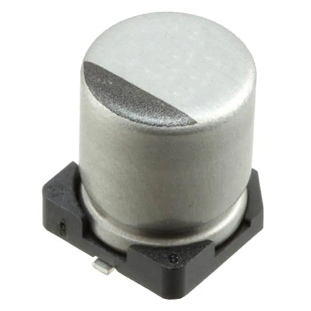

UCD1K100MCL1GS
UCD1K100MCL1GS
    NICHICON(尼吉康)
    SMD,D6.3xL7.7mm
    10UF ±20% 80V
UCD1K100MCL1GS 数据手册
ALUMINUM  ELECTROLYTIC  CAPACITORS U U U U Specifications Item Performance Characteristics Category Temperature Range – 55 to +105°C Rated Voltage Range 6.3 to 100V Rated Capacitance Range 1 to 3300µF Capacitance Tolerance ±20% at 120Hz, 20°C Leakage Current After 2 minutes' application of rated voltage at 20°C, leakage current is not more than 0.01 CV or 3 (µA), whichever is greater. 6.3 0.26 Rated voltage (V) tan δ (MAX.) Tangent of loss angle (tan δ) 10 0.19 16 0.16 25 0.14 35 0.12 50 0.10 63 0.08 80 0.08 100 0.07 Measurement frequency:120Hz at 20°C For capacitance of more than 1000µF, add 0.02 for every increase of 1000µF. (φ12.5 to φ18) Rated voltage (V) 6.3 10 16 25 35 50 63 80 100 2 2 2 2 2 2 2 2 2 3 3 3 3 3 3 3 3 3 4 4 4 3 3 3 3 3 3 Z—25°C / Z+20°C Stability at Low Temperature Impedance ratio Z—40°C / Z+20°C (MAX.) Z—55°C / Z+20°C The specifications listed below shall be met when the capacitors are restored to 20°C after the rated voltage is applied at 105°C for the conditions listed at right. Endurance Capacitance Change tan δ Leakage current Size ( mm ) Measurement frequency :120Hz ∼7.7L 10L 6.3 ∼ 50V 2000hrs. 5000hrs. 5000hrs. 5000hrs. 63 ∼100V 2000hrs. 2000hrs. — 5000hrs. Rated Voltage φ10×13.5L 13.5L ∼ Within ± 30% of the initial capacitance value 200% or less than the initial specified value 300% or less than the initial specified value for 63V or more Less than or equal to the initial specified value Shelf Life After storing the capacitors under no load at 105°C for 1000 hours and then performing voltage treatment based on JIS C 5101-4 clause 4.1 at 20°C, they shall meet the specified values for the endurance characteristics listed above. Resistance to soldering heat The capacitors are kept on a hot plate for 30 seconds, which is maintained at 250°C. The capacitors shall meet the characteristic requirements listed at right when they are removed from the plate and restored to 20°C. Marking Black print on the case top. Capacitance Change Within ± 10% of the initial capacitance value tan δ Less than or equal to the initial specified value Leakage current Less than or equal to the initial specified value Type numbering system (Example : 16V 100µF) (φ4 to φ8 × 6.2) Plastic platform Voltage ( j : 6.3V ) 2 3 4 5 6 7 8 9 Capacitance tolerance (±20%) L±1.0 Series 0.5 MAX. A±0.2 E A±0.2 H Negative φ8 × 10L, φ10 × 10L, φ12.5 × 13.5L, φ16 × 16.5L, φ18 × 16.5L : The vibration structure-resistant product is also available upon request, please ask for details. Dimension table in next page. Type φD×L A B C E L H φD×L 0.5 MAX. C±0.2 B±0.2 φ D±0.5 Pressure relief vent Capacitance Positive 0.3 MAX. Lot No. Series name Negative 2 : Except : φ10 × 7.7L Plastic platform Voltage 330 µF CD 50V H1015 nichicon Trade mark H L±0.5 Rated voltage (16V) A±0.2 E A±0.2 B±0.2 φD±0.5 A2 220E CD (φ12.5 to φ18) C±0.2 0.3 MAX. Pressure 2 relief vent Capacitance Lot No. Rated capacitance (100µF) Positive Plastic platform Trade mark Taping code Code GS MS Size code Configuration Negative (φ8 × 10, φ10) Series 12 13 14 Size φ4 to 10 φ12.5 to 18 1: Size φ8 × 6.2 only Voltage ( E : 25V ) 10 11 A±0.2 E A±0.2 B±0.2 φD±0.5 A2 47 j CD 1 UCD 1 C 1 0 1 M C L 1 GS H L±0.3 Capacitance Lot No. C±0.2 0.3 MAX. Series 1 Trade mark 0.5 MAX. Positive A B C E L H φD Code 4 to 6.3 CL 8 (6.2L) CL 10(7.7L) CL 8 (10L) • NL 10(10L,13.5L) 12.5 to 18 NJ 12.5 to 18 NQ ※ ※ NQ is scheduled to be discontinued. 4 × 5.8 5 × 5.8 6.3 × 5.8 6.3 × 7.7 8 × 6.2 8 × 10 10 × 7.7 10 × 10 3.3 3.2 1.8 2.9 2.1 3.2 2.4 2.4 8.3 10.3 4.3 8.3 5.3 10.3 6.6 6.6 8.3 10.3 4.3 8.3 5.3 10.3 6.6 6.6 2.3 4.5 1.0 3.1 1.3 4.5 2.2 2.2 6.2 10 5.8 10 5.8 7.7 5.8 7.7 0.5 to 0.8 0.5 to 0.8 0.5 to 0.8 0.5 to 0.8 0.5 to 0.8 0.8 to 1.1 0.8 to 1.1 0.8 to 1.1 (mm) 10 × 13.5 12.5 × 13.5 16 × 16.5 18 × 16.5 4.8 5.4 6.4 3.2 13.6 17.1 19.1 10.3 13.6 17.1 19.1 10.3 4.0 6.3 6.3 4.5 13.5 16.5 16.5 13.5 0.8 to 1.1 1.0 to 1.4 1.0 to 1.4 1.0 to 1.4 Voltage V Code 6.3 j 10 A 16 C 25 E 35 V 50 H 63 J 80 K 100 2A Frequency coefficient of rated ripple current Frequency Coefficient 50Hz 0.35 120Hz 0.50 300Hz 0.64 1kHz 0.83 10kHz or more 1.00 CAT.8100K ALUMINUM  ELECTROLYTIC  CAPACITORS UCD Dimensions Rated Voltage (V) (code) 6.3 (0J) 10 (1A) 16 (1C) Rated Capacitance (µF) Leakage Current Rated Ripple Impedance(Ω) (µA) (mArms) MAX. at 20℃ after (20℃/100kHz) (105℃/100kHz) 2 minutes Case Size φD×L(mm) tan δ 22 4× 5.8 0.26 3 1.35 90 UCD0J220MCL1GS 27 4× 5.8 0.26 3 1.35 90 UCD0J270MCL1GS 33 5× 5.8 0.26 3 0.70 160 UCD0J330MCL1GS 47 4× 5.8 0.26 3 1.35 90 UCD0J470MCL6GS 47 5× 5.8 0.26 3 0.70 160 UCD0J470MCL1GS 56 5× 5.8 0.26 3.528 0.70 160 UCD0J560MCL1GS 68 6.3× 5.8 0.26 4.284 0.36 240 UCD0J680MCL1GS 100 5× 5.8 0.26 6.3 0.70 160 UCD0J101MCL6GS 100 6.3× 5.8 0.26 6.3 0.36 240 UCD0J101MCL1GS 150 6.3× 5.8 0.26 9.45 0.36 240 UCD0J151MCL1GS 220 6.3× 5.8 0.26 13.86 0.36 240 UCD0J221MCL1GS 330 6.3× 7.7 0.26 20.79 0.32 290 UCD0J331MCL1GS 330 8× 6.2 0.26 20.79 0.26 300 UCD0J331MCL6GS 470 8× 10 0.26 29.61 0.16 600 UCD0J471MNL1GS 470 10× 7.7 0.26 29.61 0.18 600 UCD0J471MCL6GS 680 8× 10 0.26 42.84 0.16 600 UCD0J681MNL1GS 680 10× 7.7 0.26 42.84 0.18 600 UCD0J681MCL6GS 1000 8× 10 0.26 63 0.16 600 UCD0J102MNL1GS 1500 10×10 0.26 94.5 0.080 850 UCD0J152MNL1GS 2200 10×13.5 0.26 138.6 0.080 950 UCD0J222MNL1GS 3300 12.5× 13.5 0.30 207.9 0.080 1100 UCD0J332MNJ1MS ( ) Part Number 22 4× 5.8 0.19 3 1.35 90 UCD1A220MCL1GS 27 5× 5.8 0.19 3 0.70 160 UCD1A270MCL1GS 33 4×5.8 0.19 3.3 1.35 90 UCD1A330MCL6GS 33 5×5.8 0.19 3.3 0.70 160 UCD1A330MCL1GS 47 6.3× 5.8 0.19 4.7 0.36 240 UCD1A470MCL1GS 56 6.3× 5.8 0.19 5.6 0.36 240 UCD1A560MCL1GS 6.8 68 6.3× 5.8 0.19 0.36 240 UCD1A680MCL1GS 100 6.3×5.8 0.19 10 0.36 240 UCD1A101MCL1GS 150 6.3× 5.8 0.19 15 0.36 240 UCD1A151MCL1GS 220 6.3× 7.7 0.19 22 0.32 290 UCD1A221MCL1GS 220 8× 6.2 0.19 22 0.26 300 UCD1A221MCL6GS 330 8× 10 0.19 33 0.16 600 UCD1A331MNL1GS 330 10× 7.7 0.19 33 0.18 600 UCD1A331MCL6GS 470 8× 10 0.19 47 0.16 600 UCD1A471MNL1GS 470 10× 7.7 0.19 47 0.18 600 UCD1A471MCL6GS 680 10× 10 0.19 68 0.080 850 UCD1A681MNL1GS 1000 10× 10 0.19 100 0.080 850 UCD1A102MNL1GS 1500 10× 13.5 0.19 150 0.080 950 UCD1A152MNL1GS 2200 12.5× 13.5 0.21 220 0.080 1100 UCD1A222MNJ1MS 10 4× 5.8 0.16 3 1.35 90 UCD1C100MCL1GS 15 4×5.8 0.16 3 1.35 90 UCD1C150MCL1GS 22 4×5.8 0.16 3.52 1.35 90 UCD1C220MCL6GS 22 5×5.8 0.16 3.52 0.70 160 UCD1C220MCL1GS 27 5×5.8 0.16 4.32 0.70 160 UCD1C270MCL1GS 33 6.3 ×5.8 0.16 5.28 0.36 240 UCD1C330MCL1GS 47 5×5.8 0.16 7.52 0.70 160 UCD1C470MCL6GS 47 6.3 ×5.8 0.16 7.52 0.36 240 UCD1C470MCL1GS 56 6.3 ×5.8 0.16 8.96 0.36 240 UCD1C560MCL1GS 68 6.3 ×5.8 0.16 10.88 0.36 240 UCD1C680MCL1GS 100 6.3× 5.8 0.16 16 0.36 240 UCD1C101MCL1GS CAT.8100K ALUMINUM  ELECTROLYTIC  CAPACITORS UCD Dimensions Rated Voltage (V) (code) 16 (1C) 25 (1E) Rated Capacitance (µF) 50 (1H) tan δ Leakage Current Rated Ripple Impedance(Ω) (µA) (mArms) MAX. at 20℃ after (20℃/100kHz) (105℃/100kHz) 2 minutes ( ) Part Number 150 6.3×7.7 0.16 24 0.32 290 UCD1C151MCL1GS 220 6.3× 7.7 0.16 35.2 0.32 290 UCD1C221MCL1GS 220 8× 6.2 0.16 35.2 0.26 300 UCD1C221MCL6GS 330 8× 10 0.16 52.8 0.16 600 UCD1C331MNL1GS 330 10 ×7.7 0.16 52.8 0.18 600 UCD1C331MCL6GS 470 8×10 0.16 75.2 0.16 600 UCD1C471MNL1GS 470 10× 7.7 0.16 75.2 0.18 600 UCD1C471MCL6GS 680 10× 10 0.16 108.8 0.080 850 UCD1C681MNL1GS 1000 10× 13.5 0.16 160 0.080 950 UCD1C102MNL1GS 1500 12.5× 13.5 0.16 240 0.080 1100 UCD1C152MNJ1MS 10 4×5.8 0.14 3 1.35 90 UCD1E100MCL1GS 15 5×5.8 0.14 3.75 0.70 160 UCD1E150MCL1GS 22 5×5.8 0.14 5.5 0.70 160 UCD1E220MCL1GS 27 6.3× 5.8 0.14 6.75 0.36 240 UCD1E270MCL1GS 33 5×5.8 0.14 8.25 0.70 160 UCD1E330MCL6GS 33 6.3× 5.8 0.14 8.25 0.36 240 UCD1E330MCL1GS 47 6.3× 5.8 0.14 11.75 0.36 240 UCD1E470MCL1GS 56 6.3× 5.8 0.14 14 0.36 240 UCD1E560MCL1GS 68 6.3× 5.8 0.14 17 0.36 240 UCD1E680MCL1GS 100 6.3×7.7 0.14 25 0.32 290 UCD1E101MCL1GS 100 8×6.2 0.14 25 0.26 300 UCD1E101MCL6GS 150 8×10 0.14 37.5 0.16 600 UCD1E151MNL1GS 150 10× 7.7 0.14 37.5 0.18 600 UCD1E151MCL6GS 220 8×10 0.14 55 0.16 600 UCD1E221MNL1GS 220 10×7.7 0.14 55 0.18 600 UCD1E221MCL6GS 330 8× 10 0.14 82.5 0.16 600 UCD1E331MNL1GS 470 10 ×10 0.14 117.5 0.080 850 UCD1E471MNL1GS 680 10 ×13.5 0.14 170 0.080 950 UCD1E681MNL1GS 1000 12.5× 13.5 0.14 250 0.080 1100 UCD1E102MNJ1MS 2200 16× 16.5 0.16 550 0.035 1800 UCD1E222MNJ1MS 4×5.8 0.12 3 90 UCD1V4R7MCL1GS 4.7 35 (1V) Case Size φD×L(mm) 1.35 10 4× 5.8 0.12 3.5 1.35 90 UCD1V100MCL6GS 10 5× 5.8 0.12 3.5 0.70 160 UCD1V100MCL1GS 22 5× 5.8 0.12 7.7 0.70 160 UCD1V220MCL1GS 33 6.3×5.8 0.12 11.55 0.36 240 UCD1V330MCL1GS 47 6.3×5.8 0.12 16.45 0.36 240 UCD1V470MCL1GS 68 6.3×7.7 0.12 23.8 0.32 290 UCD1V680MCL1GS 100 6.3× 7.7 0.12 35 0.32 290 UCD1V101MCL6GS 100 8× 10 0.12 35 0.16 600 UCD1V101MNL1GS 150 8× 10 0.12 52.5 0.16 600 UCD1V151MNL1GS 150 10 ×7.7 0.12 52.5 0.18 600 UCD1V151MCL6GS 220 8×10 0.12 77 0.16 600 UCD1V221MNL1GS 220 10 ×7.7 0.12 77 0.18 600 UCD1V221MCL6GS 330 10 ×10 0.12 115.5 0.080 850 UCD1V331MNL1GS 470 10 ×13.5 0.12 164.5 0.080 950 UCD1V471MNL6GS 470 12.5 ×13.5 0.12 164.5 0.080 1100 UCD1V471MNJ1MS 680 12.5 ×13.5 0.12 238 0.080 1100 UCD1V681MNJ1MS 1000 16 ×16.5 0.12 350 0.035 1800 UCD1V102MNJ1MS 4×5.8 0.10 3 60 UCD1H010MCL1GS 1 2.70 2.2 4×5.8 0.10 3 2.70 60 UCD1H2R2MCL1GS 3.3 4× 5.8 0.10 3 2.70 60 UCD1H3R3MCL1GS CAT.8100K ALUMINUM  ELECTROLYTIC  CAPACITORS UCD Dimensions Rated Voltage (V) (code) Rated Capacitance (µF) 4.7 50 (1H) ( ) Part Number 0.10 3 2.70 60 UCD1H4R7MCL1GS 5× 5.8 0.10 5 1.50 90 UCD1H100MCL6GS 10 6.3×5.8 0.10 5 0.86 170 UCD1H100MCL1GS 22 6.3×5.8 0.10 11 0.86 170 UCD1H220MCL1GS 33 6.3×7.7 0.10 16.5 0.66 195 UCD1H330MCL1GS 33 8× 6.2 0.10 16.5 0.63 200 UCD1H330MCL6GS 47 6.3×7.7 0.10 23.5 0.66 195 UCD1H470MCL1GS 47 8× 6.2 0.10 23.5 0.63 200 UCD1H470MCL6GS 100 8× 10 0.10 50 0.32 350 UCD1H101MNL1GS 100 10 ×7.7 0.10 50 0.36 330 UCD1H101MCL6GS 150 10 ×10 0.10 75 0.16 700 UCD1H151MNL1GS 220 10× 10 0.10 110 0.16 700 UCD1H221MNL1GS 330 10× 13.5 0.10 165 0.14 800 UCD1H331MNL6GS 330 12.5×13.5 0.10 165 0.12 900 UCD1H331MNJ1MS 390 12.5×13.5 0.10 195 0.12 900 UCD1H391MNJ1MS 470 16× 16.5 0.10 235 0.073 1610 UCD1H471MNJ1MS 680 16×16.5 0.10 340 0.073 1610 UCD1H681MNJ1MS 5×5.8 0.08 3 50 UCD1J4R7MCL1GS 3.00 10 6.3× 5.8 0.08 6.3 1.50 80 UCD1J100MCL1GS 22 6.3× 7.7 0.08 13.86 1.20 120 UCD1J220MCL1GS 22 8×6.2 0.08 13.86 1.20 120 UCD1J220MCL6GS 33 8×10 0.08 20.79 0.65 250 UCD1J330MNL1GS 47 8×10 0.08 29.61 0.65 250 UCD1J470MNL1GS 68 10× 10 0.08 42.84 0.35 400 UCD1J680MNL1GS 100 10× 10 0.08 63 0.35 400 UCD1J101MNL1GS 150 12.5 ×13.5 0.08 94.5 0.16 800 UCD1J151MNJ1MS 220 12.5 ×13.5 0.08 138.6 0.16 800 UCD1J221MNJ1MS 470 16×16.5 0.08 296.1 0.082 1410 UCD1J471MNJ1MS 680 18 ×16.5 0.08 428.4 0.080 1690 UCD1J681MNJ1MS 5× 5.8 0.08 3 5.00 25 UCD1K3R3MCL1GS 4.7 100 (2A) Leakage Current Rated Ripple Impedance(Ω) (µA) (mArms) MAX. at 20℃ after (20℃/100kHz) (105℃/100kHz) 2 minutes 4× 5.8 3.3 80 (1K) tan δ 10 4.7 63 (1J) Case Size φD×L(mm) 6.3×5.8 0.08 3.76 3.00 40 UCD1K4R7MCL1GS 10 6.3×7.7 0.08 8 2.40 60 UCD1K100MCL1GS 10 8× 6.2 0.08 8 2.40 60 UCD1K100MCL6GS 22 8× 10 0.08 17.6 1.30 130 UCD1K220MNL1GS 33 8× 10 0.08 26.4 1.30 130 UCD1K330MNL1GS 47 10×10 0.08 37.6 0.70 200 UCD1K470MNL1GS 68 12.5× 13.5 0.08 54.4 0.32 500 UCD1K680MNJ1MS 100 12.5× 13.5 0.08 80 0.32 500 UCD1K101MNJ1MS 150 12.5× 13.5 0.08 120 0.32 500 UCD1K151MNJ1MS 330 16×16.5 0.08 264 0.17 793 UCD1K331MNJ1MS 470 18×16.5 0.08 376 0.15 917 UCD1K471MNJ1MS 22 8×10 0.07 22 1.30 130 UCD2A220MNL1GS 33 10 ×10 0.07 33 0.70 200 UCD2A330MNL1GS 47 12.5×13.5 0.07 47 0.32 500 UCD2A470MNJ1MS 68 12.5×13.5 0.07 68 0.32 500 UCD2A680MNJ1MS 100 16 ×16.5 0.07 100 0.17 793 UCD2A101MNJ1MS 150 16 ×16.5 0.07 150 0.17 793 UCD2A151MNJ1MS 220 18 ×16.5 0.07 220 0.15 917 UCD2A221MNJ1MS 330 18× 16.5 0.07 330 0.15 917 UCD2A331MNJ1MS For taping specifications, recommended land size/soldering by reflow and minimum order quantity, please refer to the Guidelines for Aluminum Electrolytic Capacitors. CAT.8100K
