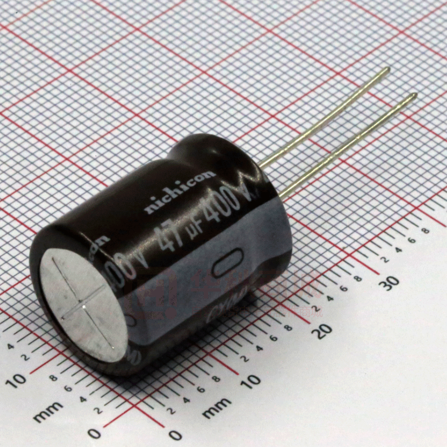

UCY2G470MHD
UCY2G470MHD
    NICHICON(尼吉康)
    插件,D16xL20mm
    直插铝电解电容 插件,D16xL20mm 47µF ±20% Ф16.00 x 20.00mm 400V 520mA 12000Hrs@105℃
UCY2G470MHD 数据手册
ALUMINUM ELECTROLYTIC CAPACITORS UCY Miniature Sized, High Ripple Current, High Reliability Dimensions High ripple current and Long Life product withstanding V 160 hours at +105°C. 200 250 load life of 10000 to 12000 Suited for power supply 2Cand ballast application. 2D 2E Code Cap.(µF) Compliant to the RoHS directive (2011/65/EU,(EU) 2015/863). 6.8 6R8 AEC-Q200 compliant. Please contact us for details. 10 100 12 120 15 150 ULD 350 2V 10 × 16 –40 to +105°C 160 to 500V 27Capacitance 270 Range Rated 10 × 16 6.8 to 680µF Capacitance Tolerance ± 20% at 120Hz, 20°C 225 10 × 16 225 235 10 × 20 255 420 450 2G W6 2W 500 2H 140 150 175 10 × 16 10 × 20 10 × 20 105 135 150 10 × 16 10 × 20 10 × 20 105 135 150 × 16 Long10Life 160 10 × 20 180 10 × 20 180 10 × 25 185 10 × 25 185 10 × 20 215 10 × 25 235 10 × 31.5 215 10 × 31.5 12.5 × 20 215 255 285 12.5 × 25 300 340 12.5 × 25 340 UCY Characteristics 10 × 25 Performance 255 12.5 × 20 10 × 31.5 275 215 10 × 20 12.5 × 20 325 10 × 31.5 305 12.5 × 25 12.5 × 20 360 10 × 25 255 Item Rated Voltage Range Smaller 400 10 × 16 10 × 16 10 × 20 18 180 Specifications 22 Temperature 220 Range Category UCS 12.5 × 20 160 12.5 × 25 220 16 × 20 12.5 × 31.5 220 240 16 × 20 12.5 × 35.5 16 × 25 18 × 20 12.5 × 40 16 × 25 240 280 280 280 310 310 10 × 20 305 12.5 × 20 380 12.5 × 25 385 12.5 × 31.5 400 12.5 × 31.5 400 16 × 31.5 350 305 10 × 20 application 260 1 minute's After of rated voltage at 20°C, leakage current is not more than 0.04CV+100 (µA) 400 12.5 × 20 18 × 25 350 16 × 20 450 16 × 20 450 16 × 20 385 16 × 20 385 frequency : 120Hz at 20°C 12.5 × Measurement 31.5 465 12.5 × 35.5 460 345 12.5 × 25 455 295 × 16 39 of loss 390angle 10 10 × 20 (V) 325 16010 × 25 200 12.5 × 31.5450430 16 × 35.5 380 Rated voltage Tangent (tan δ) 250 350 500 12.5 ×400 25 385 420 18 × 20 440 tan δ (max.) 0.20 0.20 0.20 0.24 0.24 0.24 0.24 0.24 12.5 × 25 510 16 × 20 520 16 × 40 440 10 × 31.5 405 12.5 × 35.5 505 12.5 × 40 525 10 × 20 360 345 47 470 12.5 × 31.5 510 10 × 25 16 × 25 500 375 10 × 20 Measurement frequency : 120Hz 16 × 20 540 490 12.5 ×Rated 20 16 × 25 500 18 × 31.5 440 500 250 18350 200 voltage 12.5 (V) × 20 490 160 × 20 400 590 420 18 × 20450 480 Stability at Low Temperature 6 6 6 3 5903 12.5 5× 35.5 5630 312.5 × 31.5 Z(–25°C) / Z(+20°C) 16 × 31.5 585 Impedance ratio (max.) ---6 6 6 6 6 Z(–40°C) 380 12.5 × 20/ Z(+20°C) 515 415 10 × 25 10 × 20 56 560 18 × 35.5 480 16 × 25 585 12.5 × 40 570 18 × 25 560 16 × 20 565 18 × 20 600 The specifications listed at right shall be met when the 455 10 × 25 capacitors 12.5 × after 25 D.C. 615 bias 12.5plus × 35.5 12.5 × 40 720 10 × 31.5restored 485 to 20˚C 16 × 31.5 Within 645 ±20% of the initial capacitance value Capacitance change are rated695 200% or less than initial specified tan δ 640 Endurance ripple current is applied for 12000 hours (10000 20L 16 × 25 18 × 40 value525 16 × 35.5the660 16 hours × 25 for 700 68 680 16 × 20 650 12.5 × 20 or590 18 × 25 615 12.5 × 20 650 Less than or equal to the initial specified value Leakage less, 500V) at 105˚C, the peak voltage shall18not 735 current × 20exceed 690the 18 × 25 534 voltage. 10 × 31.5 rated 16 × 40 750 12.5 × 25 645 12.5 × 31.5 715 16 × 31.5 740 16 × 31.5 805 16 × 35.5 725 455 storing 12.5105˚C × 40 for785 10 × 25 After load at 1000 hours and then performing voltage treatment based on JIS C 12.5 × the 20 capacitors 645 12.5under × 25 no615 Shelf82 Life 820 5101-4 clause 4.1 at 20°C, they shall meet the endurance characteristics 18listed × 31.5 above. 730 18 × 31.5 730 18 ×for 25 the765 16 ×specified 25 700 values 640 16 × 20 690 16 × 20 690 12.5 × 20 18 × 25 765 Marking Printed with white color letter on dark brown sleeve. 16 × 31.5 825 16 × 35.5 850 16 × 40 825 16 × 20 715 12.5 × 25 695 18 × 35.5(μF), 835V : Rated Voltage (V) ※ I : Leakage Current (μA), C : Rated Capacitance 645 12.5 × 20 100 101 18 × 25 790 18 × 31.5 875 18 × 35.5 835 12.5 × 35.5 785 16 × 20 710 16 × 35.5 925 18 × 40 930 18 × 40 930 16 × 25 845 18 × 31.5 940 16 × 20 775 16 × 40 numbering 950 12.5 × 35.5 785 Type system (Example : 250V 100µF) Radial 760 12.5 × 25 120 Lead 121 Type 18 × 46 945 18 × 46 945 18 × 31.5 940 12.5 × 31.5 810 12.5 × 40 890 18 ×235.53 960 1 4 5 6 7 8 9 10 11 12 18 × 20 815 U C Y 2 E 1 0 1 M HD T 12.5 × 31.5 905 12.5 × 35.5 965 18 × 25 970 18 × 35.5 1080 φd Sleeve (PET) 760 12.5 × 25 18 × 40 1030 150 151 Size code 16 × 25 945 16 × 40 1000 12.5 × 40 990 945 16 × 20 18 × 20 910 Configuration 16 × 20 1000 12.5 × 40 1090 16 × 31.5 1110 Capacitance tolerance (±20%) 18 × 40 1205 18 × 46 1110 12.5 × 31.5 905 180 181 16 × 25 1035 18 × 25 1050 Rated capacitance (100µF) 12.5 × 35.5 1050 18 × 20 910 Rated voltage (250V) 1200 12.5 × 40 16 × 31.5 1230 16 × 40 1295 Series name 12.5 × 35.5 1050 12.5 × 40 1090 16 × 35.5 1220 18 × 46 1300 220 Pressure 221 relief vent 1185 Type 15min. 4min. L ±16 1.5× 25 18 × 25 1185 18 × 31.5 1160 18 × 20 1105 Configuration 18 × 25 1235 16 × 35.5 1400 18 × 35.5 1450 Pb-free leadwire φD 270 271 Pb-free PET sleeve 12.5 × 40 1300 16 × 40 1350 18 × 31.5 1410 10 PD (mm) 16 × 31.5 1510 18 × 46 1600 16 × 40 1595 12.5 to 18 HD 330 331φD 10 12.5 16 18 18 × 25 1445 18 × 40 1530 18 × 31.5 1560 P 5.0 7.5 7.5 × 405.0 1730 16 18 × 40 1780 φd 0.6 0.6 0.8 0.8 16 × 35.5 1510 390 391 18 × 35.5 1690 18 × 31.5 1695 10 × 16 470 560 680 P±0.5 φD+0.5max. Leakage 33 Current 330 ※ 18 × 40 1850 18 × 35.5 1920 471 16 × 40 1730 18 × 46 1900 Please the Guidelines for Aluminum Electrolytic Capacitors × 40 to2130 18 refer 561 for end seal configuration information. 18 × 46 2300 681 Case size φD × L (mm) : Rated ripple current (mArms) at 105°C 120Hz Frequency coefficient of rated ripple current Frequency 50Hz 120Hz 1kHz 10kHz 100kHz or more Coefficient 0.80 1.00 1.60 1.80 2.00 : In this case, 6 will be put at 12th digit of type numbering system. : In this case, 3 will be put at 12th digit of type numbering system. : In this case, 9 will be put at 12th digit of type numbering system. Dimension table in next page. CAT.8100L ALUMINUM ELECTROLYTIC CAPACITORS UCY Dimensions Rated Voltage (V) (code) 160 (2C) Rated Capacitance (µF) tan δ Leakage Current (µA) at 20℃ after 1 minute ( ) Rated Ripple (mArms) (105℃/120Hz) Part Number 33 10×16 0.20 311.2 260 UCY2C330MPD 39 10× 16 0.20 349.6 295 UCY2C390MPD 47 10× 20 0.20 400.8 375 UCY2C470MPD 56 10× 20 0.20 458.4 380 UCY2C560MPD 68 10× 25 0.20 535.2 455 UCY2C680MPD 68 12.5× 20 0.20 535.2 590 UCY2C680MHD3 82 10× 30.5 0.20 624.8 534 UCY2C820MPD 82 10×25 0.20 624.8 455 UCY2C820MPD9 82 12.5× 20 0.20 624.8 640 UCY2C820MHD3 100 12.5× 20 0.20 740 645 UCY2C101MHD 120 12.5× 25 0.20 868 760 UCY2C121MHD 150 12.5× 30.5 0.20 1060 905 UCY2C151MHD 150 12.5× 25 0.20 1060 760 UCY2C151MHD9 150 16×20 0.20 1060 945 UCY2C151MHD3 180 16× 20 0.20 1252 1000 UCY2C181MHD 180 12.5× 30.5 0.20 1252 905 UCY2C181MHD9 180 12.5× 35.5 0.20 1252 1050 UCY2C181MHD6 220 12.5× 40 0.20 1508 1200 UCY2C221MHD 220 12.5× 35.5 0.20 1508 1050 UCY2C221MHD9 220 16× 25 0.20 1508 1185 UCY2C221MHD3 220 18× 20 0.20 1508 1105 UCY2C221MHD6 270 18× 25 0.20 1828 1235 UCY2C271MHD 270 12.5× 40 0.20 1828 1300 UCY2C271MHD6 0.20 2212 1510 UCY2C331MHD 330 200 (2D) Case Size φD×L(mm) 16× 30.5 330 18× 25 0.20 2212 1445 UCY2C331MHD6 390 16× 40 0.20 2596 1730 UCY2C391MHD 390 16×35.5 0.20 2596 1510 UCY2C391MHD9 390 18× 30.5 0.20 2596 1695 UCY2C391MHD6 470 18× 35.5 0.20 3108 1920 UCY2C471MHD 470 16× 40 0.20 3108 1730 UCY2C471MHD6 560 18× 40 0.20 3684 2130 UCY2C561MHD 680 18× 46 0.20 4452 2300 UCY2C681MHD 22 10× 16 0.20 276 225 UCY2D220MPD 27 10× 16 0.20 316 235 UCY2D270MPD 33 10×20 0.20 364 305 UCY2D330MPD 39 10× 20 0.20 412 325 UCY2D390MPD 47 10× 20 0.20 476 360 UCY2D470MPD 47 12.5× 20 0.20 476 490 UCY2D470MHD3 56 10× 25 0.20 548 415 UCY2D560MPD 68 68 10× 30.5 12.5× 20 0.20 644 485 UCY2D680MPD 0.20 644 650 UCY2D680MHD3 82 12.5× 25 0.20 756 645 UCY2D820MHD 82 12.5× 20 0.20 756 645 UCY2D820MHD9 82 16× 20 0.20 756 690 UCY2D820MHD3 100 12.5× 25 0.20 900 695 UCY2D101MHD 100 16× 20 0.20 900 710 UCY2D101MHD3 For cut leads, formed leads or taped parts, please add the appropriate code after the size code (12th digit ). If there is no size code in the part number, please add size code “1” and then add the appropriate code. CAT.8100L ALUMINUM ELECTROLYTIC CAPACITORS UCY Dimensions Rated Voltage (V) (code) Rated Capacitance (µF) 120 250 (2E) 16× 20 tan δ 0.20 Leakage Current (µA) at 20℃ after 1 minute Rated Ripple (mArms) (105℃/120Hz) Part Number 1060 775 UCY2D121MHD ( ) 120 12.5× 30.5 0.20 1060 810 UCY2D121MHD6 150 12.5× 35.5 0.20 1300 965 UCY2D151MHD 150 16× 25 0.20 1300 945 UCY2D151MHD3 150 18× 20 0.20 1300 910 UCY2D151MHD6 180 12.5× 40 0.20 1540 1090 UCY2D181MHD 180 16× 25 0.20 1540 1035 UCY2D181MHD6 180 18×20 0.20 1540 910 UCY2D181MHD3 220 200 (2D) Case Size φD×L(mm) 0.20 1860 1230 UCY2D221MHD 220 12.5× 40 16× 30.5 0.20 1860 1090 UCY2D221MHD6 220 18× 25 0.20 1860 1185 UCY2D221MHD3 270 16×35.5 0.20 2260 1400 UCY2D271MHD 270 18× 30.5 0.20 2260 1410 UCY2D271MHD6 330 16× 40 0.20 2740 1595 UCY2D331MHD 330 18× 30.5 0.20 2740 1560 UCY2D331MHD6 390 18× 40 0.20 3220 1780 UCY2D391MHD 390 18× 35.5 0.20 3220 1690 UCY2D391MHD9 470 18× 40 0.20 3860 1850 UCY2D471MHD 470 18× 46 0.20 3860 1900 UCY2D471MHD6 22 10× 16 0.20 320 225 UCY2E220MPD 27 10×20 0.20 370 255 UCY2E270MPD 33 10× 20 0.20 430 305 UCY2E330MPD 33 12.5× 20 0.20 430 400 UCY2E330MHD3 39 10× 25 0.20 490 345 UCY2E390MPD 47 10× 30.5 0.20 570 405 UCY2E470MPD 47 10× 25 0.20 570 345 UCY2E470MPD9 47 12.5× 20 0.20 570 490 UCY2E470MHD3 56 12.5× 20 0.20 660 515 UCY2E560MHD 68 12.5× 25 0.20 780 615 UCY2E680MHD 68 16× 20 0.20 780 650 UCY2E680MHD3 82 12.5× 30.5 0.20 920 715 UCY2E820MHD 82 12.5× 25 0.20 920 615 UCY2E820MHD9 82 16× 20 0.20 920 690 UCY2E820MHD3 100 16× 20 0.20 1100 715 UCY2E101MHD 100 12.5× 35.5 0.20 1100 785 UCY2E101MHD6 120 16× 25 0.20 1300 845 UCY2E121MHD 120 12.5× 35.5 0.20 1300 785 UCY2E121MHD9 120 12.5× 40 0.20 1300 890 UCY2E121MHD3 120 18× 20 0.20 1300 815 UCY2E121MHD6 150 18× 25 0.20 1600 970 UCY2E151MHD 150 12.5× 40 0.20 1600 990 UCY2E151MHD6 180 16× 30.5 0.20 1900 1110 UCY2E181MHD 180 18×25 0.20 1900 1050 UCY2E181MHD6 220 16× 40 0.20 2300 1295 UCY2E221MHD 220 16× 35.5 0.20 2300 1220 UCY2E221MHD9 220 18× 30.5 0.20 2300 1160 UCY2E221MHD3 For cut leads, formed leads or taped parts, please add the appropriate code after the size code (12th digit ). If there is no size code in the part number, please add size code “1” and then add the appropriate code. CAT.8100L ALUMINUM ELECTROLYTIC CAPACITORS UCY Dimensions Rated Voltage (V) (code) 250 (2E) Rated Capacitance (µF) Case Size φD×L(mm) tan δ 270 18× 35.5 0.20 Part Number 2800 1450 UCY2E271MHD ( ) 270 16× 40 0.20 2800 1350 UCY2E271MHD6 18× 46 0.20 3400 1600 UCY2E331MHD 330 18× 40 0.20 3400 1530 UCY2E331MHD9 12 10× 16 0.24 268 160 UCY2V120MPD 15 10× 20 0.24 310 180 UCY2V150MPD 18 10× 20 0.24 352 215 UCY2V180MPD 22 10× 25 0.24 408 255 UCY2V220MPD 22 10× 20 0.24 408 215 UCY2V220MPD9 22 12.5× 20 0.24 408 325 UCY2V220MHD3 0.24 478 305 UCY2V270MPD 10× 30.5 27 10× 25 0.24 478 255 UCY2V270MPD9 33 12.5× 20 0.24 562 380 UCY2V330MHD 33 16× 20 0.24 562 450 UCY2V330MHD3 39 12.5× 25 0.24 646 455 UCY2V390MHD 47 12.5× 25 0.24 758 510 UCY2V470MHD 47 16× 20 0.24 758 540 UCY2V470MHD3 56 12.5× 30.5 0.24 884 590 UCY2V560MHD 56 16×20 0.24 884 565 UCY2V560MHD6 68 12.5× 35.5 0.24 1052 695 UCY2V680MHD 68 16× 25 0.24 1052 700 UCY2V680MHD3 68 18× 20 0.24 1052 690 UCY2V680MHD6 82 16× 30.5 0.24 1248 740 UCY2V820MHD 0.24 1248 785 UCY2V820MHD6 82 12.5×40 82 16× 25 0.24 1248 700 UCY2V820MHD9 82 18× 25 0.24 1248 765 UCY2V820MHD3 16× 30.5 0.24 1500 825 UCY2V101MHD 100 100 18× 25 0.24 1500 790 UCY2V101MHD3 120 16× 35.5 0.24 1780 925 UCY2V121MHD 120 18× 30.5 0.24 1780 940 UCY2V121MHD6 150 18× 35.5 0.24 2200 1080 UCY2V151MHD 150 16× 40 0.24 2200 1000 UCY2V151MHD6 180 18× 40 0.24 2620 1205 UCY2V181MHD 220 18× 46 0.24 3180 1300 UCY2V221MHD 6.8 400 (2G) Rated Ripple (mArms) (105℃/120Hz) 330 27 350 (2V) Leakage Current (µA) at 20℃ after 1 minute 10× 16 0.24 208.8 140 UCY2G6R8MPD 10 10× 16 0.24 260 150 UCY2G100MPD 12 10× 20 0.24 292 175 UCY2G120MPD 15 10× 20 0.24 340 180 UCY2G150MPD 18 10× 25 0.24 388 235 UCY2G180MPD 22 10× 30.5 0.24 452 275 UCY2G220MPD 27 12.5× 20 0.24 532 360 UCY2G270MHD 33 12.5× 25 0.24 628 385 UCY2G330MHD 33 16× 20 0.24 628 450 UCY2G330MHD3 39 12.5× 30.5 0.24 724 465 UCY2G390MHD 39 12.5× 25 0.24 724 385 UCY2G390MHD9 47 16× 20 0.24 852 520 UCY2G470MHD For cut leads, formed leads or taped parts, please add the appropriate code after the size code (12th digit ). If there is no size code in the part number, please add size code “1” and then add the appropriate code. CAT.8100L ALUMINUM ELECTROLYTIC CAPACITORS UCY Dimensions Rated Voltage (V) (code) 400 (2G) Rated Capacitance (µF) Leakage Current (µA) at 20℃ after 1 minute ( ) Rated Ripple (mArms) (105℃/120Hz) Part Number 47 12.5×30.5 0.24 852 510 UCY2G470MHD6 18× 20 0.24 852 590 UCY2G470MHD3 56 12.5× 35.5 0.24 996 630 UCY2G560MHD 56 16× 25 0.24 996 585 UCY2G560MHD6 56 18× 20 0.24 996 600 UCY2G560MHD3 68 12.5× 40 0.24 1188 720 UCY2G680MHD 68 16× 25 0.24 1188 640 UCY2G680MHD9 68 18×25 0.24 1188 735 UCY2G680MHD3 82 16× 30.5 0.24 1412 805 UCY2G820MHD 82 18× 25 0.24 1412 765 UCY2G820MHD3 16× 35.5 0.24 1700 850 UCY2G101MHD 100 18× 30.5 0.24 1700 875 UCY2G101MHD6 120 18× 30.5 0.24 2020 940 UCY2G121MHD 120 16× 40 0.24 2020 950 UCY2G121MHD6 120 18× 35.5 0.24 2020 960 UCY2G121MHD3 150 18× 40 0.24 2500 1030 UCY2G151MHD 180 18× 46 0.24 2980 1110 UCY2G181MHD 10× 16 0.24 105 UCYW66R8MPD 6.8 214.24 10 10× 20 0.24 268 135 UCYW6100MPD 12 10× 20 0.24 301.6 150 UCYW6120MPD 15 10× 25 0.24 352 185 UCYW6150MPD 18 0.24 402.4 215 UCYW6180MPD 22 12.5× 20 0.24 469.6 285 UCYW6220MHD 27 12.5× 25 0.24 553.6 340 UCYW6270MHD 33 12.5× 30.5 0.24 654.4 400 UCYW6330MHD 33 16× 20 0.24 654.4 385 UCYW6330MHD3 10×30.5 39 12.5× 30.5 0.24 755.2 430 UCYW6390MHD 47 12.5× 35.5 0.24 889.6 505 UCYW6470MHD 47 16× 25 0.24 889.6 500 UCYW6470MHD6 47 18× 20 0.24 889.6 480 UCYW6470MHD3 56 12.5× 40 0.24 1040.8 570 UCYW6560MHD 68 16× 30.5 0.24 1242.4 645 UCYW6680MHD 68 18× 25 0.24 1242.4 615 UCYW6680MHD3 82 16× 35.5 0.24 1477.6 725 UCYW6820MHD 82 18× 30.5 0.24 1477.6 730 UCYW6820MHD6 100 16× 40 0.24 1780 825 UCYW6101MHD 100 18×35.5 0.24 1780 835 UCYW6101MHD6 120 18× 40 0.24 2116 930 UCYW6121MHD 120 18× 46 0.24 2116 945 UCYW6121MHD6 10× 16 0.24 105 UCY2W6R8MPD 6.8 450 (2W) tan δ 47 100 420 (W6) Case Size φD×L(mm) 222.4 10 10× 20 0.24 280 135 UCY2W100MPD 12 10× 20 0.24 316 150 UCY2W120MPD 15 10× 25 0.24 370 185 UCY2W150MPD 18 10× 30.5 0.24 424 215 UCY2W180MPD 18 12.5× 20 0.24 424 255 UCY2W180MHD6 22 12.5× 25 0.24 496 300 UCY2W220MHD For cut leads, formed leads or taped parts, please add the appropriate code after the size code (12th digit ). If there is no size code in the part number, please add size code “1” and then add the appropriate code. CAT.8100L ALUMINUM ELECTROLYTIC CAPACITORS UCY Dimensions Rated Voltage (V) (code) 450 (2W) 500 (2H) Rated Capacitance (µF) Case Size φD×L(mm) tan δ Leakage Current (µA) at 20℃ after 1 minute ( ) Rated Ripple (mArms) (105℃/120Hz) Part Number 27 12.5×25 0.24 586 340 UCY2W270MHD 33 12.5× 30.5 0.24 694 400 UCY2W330MHD 33 16× 20 0.24 694 385 UCY2W330MHD3 39 12.5×35.5 0.24 802 460 UCY2W390MHD 39 18× 20 0.24 802 440 UCY2W390MHD3 47 12.5× 40 0.24 946 525 UCY2W470MHD 47 16× 25 0.24 946 500 UCY2W470MHD6 56 16× 30.5 0.24 1108 585 UCY2W560MHD 56 18× 25 0.24 1108 560 UCY2W560MHD3 68 16× 35.5 0.24 1324 660 UCY2W680MHD 82 16×40 0.24 1576 750 UCY2W820MHD 82 18× 30.5 0.24 1576 730 UCY2W820MHD6 100 18× 35.5 0.24 1900 835 UCY2W101MHD 120 18× 40 0.24 2260 930 UCY2W121MHD 120 18× 46 0.24 2260 945 UCY2W121MHD6 10 12.5× 20 0.24 300 160 UCY2H100MHD 15 12.5× 25 0.24 400 220 UCY2H150MHD 15 16× 20 0.24 400 220 UCY2H150MHD3 18 12.5× 30.5 0.24 460 240 UCY2H180MHD 18 16× 20 0.24 460 240 UCY2H180MHD3 22 12.5× 35.5 0.24 540 280 UCY2H220MHD 22 16× 25 0.24 540 280 UCY2H220MHD6 22 18× 20 0.24 540 280 UCY2H220MHD3 27 12.5× 40 0.24 640 310 UCY2H270MHD 27 16×25 0.24 640 310 UCY2H270MHD6 33 16× 30.5 0.24 760 350 UCY2H330MHD 33 18× 25 0.24 760 350 UCY2H330MHD3 39 16× 35.5 0.24 880 380 UCY2H390MHD 47 16× 40 0.24 1040 440 UCY2H470MHD 47 18× 30.5 0.24 1040 440 UCY2H470MHD6 56 18× 35.5 0.24 1220 480 UCY2H560MHD 68 18×40 0.24 1460 525 UCY2H680MHD For cut leads, formed leads or taped parts, please add the appropriate code after the size code (12th digit ). If there is no size code in the part number, please add size code “1” and then add the appropriate code. For formed lead or taped product specifications and minimum order quantity, please refer to the Guidelines for Aluminum Electrolytic Capacitors. CAT.8100L
UCY2G470MHD
物料型号:ALUMINUM ELECTROLYTIC CAPACITORS UCY
器件简介:nichicon公司生产的小型化、高纹波电流、高可靠性的铝电解电容器。适用于电源和镇流器应用。
引脚分配:文档中未明确提供引脚分配信息。
参数特性: - 工作温度范围:-40至+105°C - 额定电压范围:160至500V - 额定电容范围:6.8至680微法拉 - 电容公差:在120Hz、20°C时,+20% - 漏电流:在20°C下,额定电压施加1分钟后,不超过0.04CV+100微安 - 损耗角正切(tan δ):在120Hz、20°C时,不同额定电压的最大值不同
功能详解:电容器在10000至12000小时的+105°C条件下,能够承受高纹波电流和长寿命,符合AEC-Q200标准。
应用信息:适用于电源供应和镇流器应用。
封装信息:提供了多种尺寸和形状的封装,包括径向引线类型和表面贴装类型,具体尺寸和封装类型见文档中的“Dimensions”部分。
