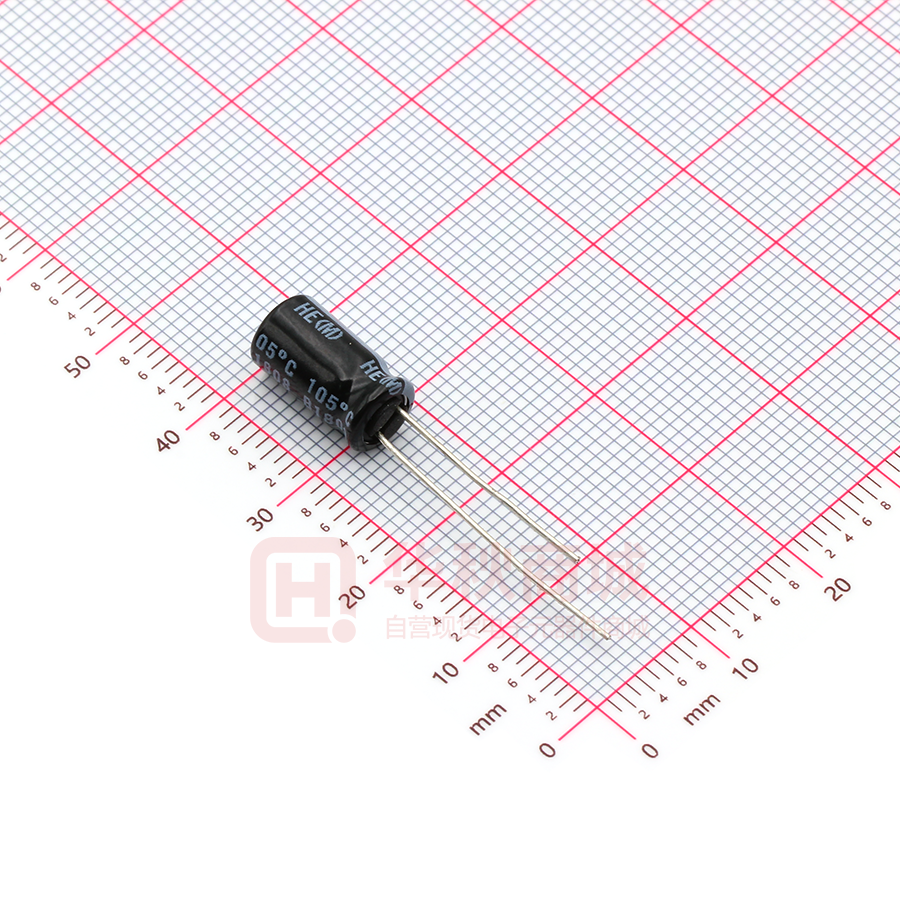

    直插铝电解电容 插件,D6.3xL11mm 100µF ±20% Ф6.30 x 11.00mm 25V 220mΩ 340mA 5000Hrs@105℃
UHE1E101MED 数据手册
ALUMINUM ELECTROLYTIC CAPACITORS UHE Miniature Sized, Low Impedance, High Reliability Approved by Reliability Center for Electronic Component, Japan-Certification No. RCJ-03-23C Low impedance and high reliability withstanding 4000 hours to 10000 hours. Compliant to the RoHS directive (2011/65/EU,(EU)2015/863). Valued marked with an ※ in the dimension table are scheduled to be discontinued and are not recommended for new designs. UHE UHD Long Life Specifications Performance Characteristics ltem Category Temperature Range –40 to +105˚C Rated Voltage Range 6.3 to 100V Rated Capacitance Range 2.2 to 18000µF Capacitance Tolerance ± 20% at 120Hz, 20˚C Leakage Current ※ After 2 minutes' application of rated voltage at 20°C, leakage current is not more than 0.01CV or 3 (µA), whichever is greater. Rated voltage (V) 6.3 10 16 25 35 50 63 100 120Hz tan δ (max.) 0.22 0.19 0.16 0.14 0.12 0.10 0.09 0.08 20˚C 120Hz Tangent of loss angle (tan δ) For capacitance of more than 1000µF, add 0.02 for every increase of 1000µF. Rated voltage (V) 6.3 10 16 25 35 50 63 100 4 3 2 2 2 2 2 2 8 6 4 3 3 3 3 3 Impedance ratio Z(–25˚C) / Z(+20˚C) (max.) Z(–40˚C) / Z(+20˚C) Stability at Low Temperature The following specifications shall be met when the capacitors are restored to 20˚C after D.C. bias plus rated ripple current is applied at 105˚C , the peak voltage shall not exceed the rated voltage. φD < = 6.3 φD = 8 , 10 6.3 to 10V 4000 hours 6000 hours 8000 hours 16 to 100V 5000 hours 7000 hours 10000 hours Case size Rated voltage Endurance φD > = 12.5 Capacitance change Within ± 25% of the initial capacitance value tan δ 200% or less than the initial specified value Leakage current Less than or equal to the initial specified value Printed with white color letter on black sleeve. Marking ※ I : Leakage Current (μA), C : Rated Capacitance (μF), V : Rated Voltage (V) Radial Lead Type Type numbering system (Example : 10V 1000µF) φd Sleeve (PET) 1 2 3 4 5 6 7 8 9 10 11 12 φD+ 0.5max. U HE 1 A 1 0 2 M PD P±0.5 Size code Configuration Capacitance tolerance ( ±20%) Rated capacitance (1000µF) 15min. L± 4min. Rated voltage (10V) Pressurerelief vent (φ6.3up) Series name (mm) (L < 20) 1.5 (L 20) 2.0 φD 5 6.3 8 10 12.5 16 18 P 2.0 2.5 3.5 5.0 5.0 7.5 7.5 φd 0.5 0.5 0.6 0.6 0.6 0.8 0.8 Type Configuration φD In case L > 25 for the φ12.5 dia. unit, lead dia. φd = 0.8mm  lease refer to the Guidelines for Aluminum Electrolytic Capacitors P for end seal configuration information. Pb-free leadwire Pb-free PET sleeve 5 DD 6.3 8 · 10 12.5 to 18 ED PD HD Frequency coefficient of rated ripple current Frequency 50Hz 120Hz 300Hz 1kHz 10kHz or more 2.2 to 33 0.45 0.55 0.70 0.90 1.00 39 to 330 0.60 0.70 0.85 0.95 1.00 390 to 1000 0.65 0.75 0.90 0.98 1.00 1200 to 18000 0.75 0.80 0.95 1.00 1.00 Cap. (µF) Dimension table in next page. CAT.8100L ALUMINUM ELECTROLYTIC CAPACITORS UHE Dimensions Rated Voltage (V) (code) 6.3 (0J) 10 (1A) Rated Capacitance (µF) Case Size φD×L(mm) tan δ 150 5× 11 0.22 330 6.3×11 0.22 Leakage Current (µA) at 20℃ after 2 minutes Impedance(Ω) max. Rated Ripple (mArms) (105℃/100kHz) Part Number 20℃/ 100kHz -10℃/ 100kHz 9.45 0.58 2.30 210 ※UHE0J151MDD 20.79 0.22 0.87 340 ※UHE0J331MED  UHE0J681MPD ( ) 680 8× 11.5 0.22 42.84 0.13 0.52 640 820 10× 12.5 0.22 51.66 0.080 0.32 865  UHE0J821MPD 1000 8× 15 0.22 63 0.087 0.35 840  UHE0J102MPD 1200 8× 20 0.22 75.6 0.069 0.27 1050  UHE0J122MPD 1200 10× 16 0.22 75.6 0.060 0.24 1210  UHE0J122MPD6 1500 10× 20 0.22 94.5 0.046 0.18 1400  UHE0J152MPD 1800 12.5× 15 0.22 113.4 0.049 0.16 1450  UHE0J182MHD 2200 10× 25 0.24 138.6 0.042 0.17 1650  UHE0J222MPD 2700 10× 30.5 0.24 170.1 0.031 0.12 1910  UHE0J272MPD6  UHE0J272MHD 2700 16×15 0.24 170.1 0.042 0.12 1940 3300 12.5× 20 0.26 207.9 0.035 0.12 1900  UHE0J332MHD 3900 12.5× 25 0.26 245.7 0.027 0.089 2230  UHE0J392MHD 3900 18× 15 0.26 245.7 0.043 0.11 2210  UHE0J392MHD6 4700 12.5×30.5 0.28 296.1 0.024 0.078 2650  UHE0J472MHD 5600 12.5× 35.5 0.30 352.8 0.020 0.065 2880  UHE0J562MHD 5600 16× 20 0.30 352.8 0.027 0.078 2530  UHE0J562MHD6 6800 12.5× 40 0.32 428.4 0.017 0.056 3350  UHE0J682MHD 6800 16×25 0.32 428.4 0.021 0.060 2930  UHE0J682MHD6 6800 18×20 0.32 428.4 0.026 0.067 2860  UHE0J682MHD3 8200 16× 30.5 0.36 516.6 0.017 0.050 3450  UHE0J822MHD 10000 16× 35.5 0.40 630 0.015 0.044 3610  UHE0J103MHD 10000 18× 25 0.40 630 0.019 0.049 3140  UHE0J103MHD6 12000 16× 40 0.44 756 0.013 0.038 4080  UHE0J123MHD 12000 18× 30.5 0.44 756 0.015 0.040 4170  UHE0J123MHD6 15000 18× 35.5 0.50 945 0.014 0.038 4220  UHE0J153MHD 18000 18× 40 0.56 1134 0.012 0.032 4280  UHE0J183MHD 100 5× 11 0.19 10 0.58 2.30 210 ※UHE1A101MDD 220 6.3×11 0.19 22 0.22 0.87 340 ※UHE1A221MED  UHE1A471MPD 470 8× 11.5 0.19 47 0.13 0.52 640 680 8× 15 0.19 68 0.087 0.35 840  UHE1A681MPD 680 10×12.5 0.19 68 0.080 0.32 865  UHE1A681MPD6 1000 8× 20 0.19 100 0.069 0.27 1050  UHE1A102MPD 1000 10× 16 0.19 100 0.060 0.24 1210  UHE1A102MPD6  UHE1A122MPD 1200 10× 20 0.19 120 0.046 0.18 1400 1500 10× 25 0.19 150 0.042 0.17 1650  UHE1A152MPD 1500 12.5× 15 0.19 150 0.049 0.16 1450  UHE1A152MHD6 2200 2200 10× 30.5 12.5 ×20 0.21 220 0.031 0.12 1910  UHE1A222MPD 0.21 220 0.035 0.12 1900  UHE1A222MHD6 2200 16 ×15 0.21 220 0.042 0.12 1940  UHE1A222MHD3 2700 18 ×15 0.21 270 0.043 0.11 2210  UHE1A272MHD 3300 12.5× 25 0.23 330 0.027 0.089 2230  UHE1A332MHD 3900 12.5× 30.5 0.23 390 0.024 0.078 2650  UHE1A392MHD 3900 16× 20 0.23 390 0.027 0.078 2530  UHE1A392MHD6 4700 12.5 ×35.5 0.25 470 0.020 0.065 2880  UHE1A472MHD 5600 12.5×40 0.27 560 0.017 0.056 3350  UHE1A562MHD 5600 16 ×25 0.27 560 0.021 0.060 2930  UHE1A562MHD6 For cut leads, formed leads or taped parts, please add the appropriate code after the size code (12th digit ). If there is no size code in the part number, please add size code “1” and then add the appropriate code. CAT.8100L ALUMINUM ELECTROLYTIC CAPACITORS UHE Dimensions Rated Voltage (V) (code) 10 (1A) Rated Capacitance (µF) 25 (1E) tan δ Leakage Current (µA) at 20℃ after 2 minutes ( ) Impedance(Ω) max. 20℃/ 100kHz -10℃/ 100kHz Rated Ripple (mArms) (105℃/100kHz) Part Number 5600 18× 20 0.27 560 0.026 0.067 2860  UHE1A562MHD3 6800 16×30.5 0.29 680 0.017 0.050 3450  UHE1A682MHD 6800 18× 25 0.29 680 0.019 0.049 3140  UHE1A682MHD6 8200 16× 35.5 0.33 820 0.015 0.044 3610  UHE1A822MHD 8200 18× 30.5 0.33 820 0.015 0.040 4170  UHE1A822MHD6 10000 16× 40 0.37 1000 0.013 0.038 4080  UHE1A103MHD 10000 18× 35.5 0.37 1000 0.014 0.038 4220  UHE1A103MHD6 12000 18× 40 0.41 1200  UHE1A123MHD 56 5×11 0.16 120 6.3× 11 0.16 0.012 0.032 4280 0.58 2.30 210 ※UHE1C560MDD 19.2 0.22 0.87 340 ※UHE1C121MED 8.96 330 8× 11.5 0.16 52.8 0.13 0.52 640  UHE1C331MPD 470 8× 15 0.16 75.2 0.087 0.35 840  UHE1C471MPD 470 10×12.5 0.16 75.2 0.080 0.32 865  UHE1C471MPD6 680 8× 20 0.16 108.8 0.069 0.27 1050  UHE1C681MPD 680 10× 16 0.16 108.8 0.060 0.24 1210  UHE1C681MPD6 1000 10× 20 0.16 160 0.046 0.18 1400  UHE1C102MPD 1000 12.5× 15 0.16 160 0.049 0.16 1450  UHE1C102MHD6 1200 10× 25 0.16 192 0.042 0.17 1650  UHE1C122MPD  UHE1C152MPD 1500 16 (1C) Case Size φD×L(mm) 0.16 240 0.031 0.12 1910 1500 12.5× 20 10× 30.5 0.16 240 0.035 0.12 1900  UHE1C152MHD6 1500 16×15 0.16 240 0.042 0.12 1940  UHE1C152MHD3 2200 12.5× 25 0.18 352 0.027 0.089 2230  UHE1C222MHD 2200 18× 15 0.18 352 0.043 0.11 2210  UHE1C222MHD6 2700 12.5×30.5 0.18 432 0.024 0.078 2650  UHE1C272MHD 2700 16× 20 0.18 432 0.027 0.078 2530  UHE1C272MHD6  UHE1C332MHD 3300 12.5× 35.5 0.20 528 0.020 0.065 2880 3900 12.5× 40 0.20 624 0.017 0.056 3350  UHE1C392MHD 3900 16× 25 0.20 624 0.021 0.060 2930  UHE1C392MHD6 3900 16×20 0.20 624 0.026 0.067 2860  UHE1C392MHD3 4700 16× 30.5 0.22 752 0.017 0.050 3450  UHE1C472MHD 4700 18× 25 0.22 752 0.019 0.049 3140  UHE1C472MHD6 5600 16× 35.5 0.24 896 0.015 0.044 3610  UHE1C562MHD 5600 18× 30.5 0.24 896 0.015 0.040 4170  UHE1C562MHD6 6800 16× 40 0.26 1088 0.013 0.038 4080  UHE1C682MHD 8200 18× 35.5 0.30 1312 0.014 0.038 4220  UHE1C822MHD 10000 18× 40 0.34 1600 0.012 0.032 4280  UHE1C103MHD 47 5× 11 0.14 11.75 0.58 2.30 210 ※UHE1E470MDD 100 6.3× 11 0.14 25 0.22 0.87 340 ※UHE1E101MED 220 8× 11.5 0.14 55 0.13 0.52 640  UHE1E221MPD 330 8× 15 0.14 82.5 0.087 0.35 840  UHE1E331MPD 330 10× 12.5 0.14 82.5 0.080 0.32 865  UHE1E331MPD6 470 8× 20 0.14 117.5 0.069 0.27 1050  UHE1E471MPD 470 10× 16 0.14 117.5 0.060 0.24 1210  UHE1E471MPD6 680 10× 20 0.14 170 0.046 0.18 1400  UHE1E681MPD 680 12.5×15 0.14 170 0.049 0.16 1450  UHE1E681MHD6 820 10× 25 0.14 205 0.042 0.17 1650  UHE1E821MPD 1000 1000 10× 30.5 12.5× 20 0.14 250 0.031 0.12 1910  UHE1E102MPD 0.14 250 0.035 0.12 1900  UHE1E102MHD6 For cut leads, formed leads or taped parts, please add the appropriate code after the size code (12th digit ). If there is no size code in the part number, please add size code “1” and then add the appropriate code. CAT.8100L ALUMINUM ELECTROLYTIC CAPACITORS UHE Dimensions Rated Voltage (V) (code) 25 (1E) Rated Capacitance (µF) 50 (1H) tan δ Leakage Current (µA) at 20℃ after 2 minutes ( ) Impedance(Ω) max. 20℃/ 100kHz -10℃/ 100kHz Rated Ripple (mArms) (105℃/100kHz) Part Number 1000 16× 15 0.14 250 0.042 0.12 1940  UHE1E102MHD3 1200 18× 15 0.14 300 0.043 0.11 2210  UHE1E122MHD 1500 12.5× 25 0.14 375 0.027 0.089 2230  UHE1E152MHD 1800 12.5× 30.5 0.14 450 0.024 0.078 2650  UHE1E182MHD 1800 16× 20 0.14 450 0.027 0.078 2530  UHE1E182MHD6 2200 12.5× 35.5 0.16 550 0.020 0.065 2880  UHE1E222MHD 2200 18× 20 0.16 550 0.026 0.067 2860  UHE1E222MHD6 2700 12.5× 40 0.16 675 0.017 0.056 3350  UHE1E272MHD 2700 16× 25 0.16 675 0.021 0.060 2930  UHE1E272MHD6 3300 16× 30.5 0.18 825 0.017 0.050 3450  UHE1E332MHD 3300 18× 25 0.18 825 0.019 0.049 3140  UHE1E332MHD6 3900 16× 35.5 0.18 975 0.015 0.044 3610  UHE1E392MHD 3900 18× 30.5 0.18 975 0.015 0.040 4170  UHE1E392MHD6 4700 16× 40 0.20 1175 0.013 0.038 4080  UHE1E472MHD 4700 18× 35.5 0.20 1175 0.014 0.038 4220  UHE1E472MHD6 5600 18× 40 0.22 1400 0.012 0.032 4280  UHE1E562MHD 33 5× 11 0.12 11.55 0.58 2.30 210 ※UHE1V330MDD 47 6.3× 11 0.12 16.45 0.22 0.87 250 ※UHE1V470MED 56 6.3× 11 0.12 19.6 0.22 0.87 340 ※UHE1V560MED 100 8×11.5 0.12 35 0.13 0.52 640  UHE1V101MPD 150 8×11.5 0.12 52.5 0.13 0.52 640  UHE1V151MPD  UHE1V221MPD 220 8× 15 0.12 77 0.087 0.35 840 220 10× 12.5 0.12 77 0.080 0.32 865  UHE1V221MPD6 270 8× 20 0.12 94.5 0.069 0.27 1050  UHE1V271MPD 330 10×16 0.12 115.5 0.060 0.24 1210  UHE1V331MPD 470 10× 20 0.12 164.5 0.046 0.18 1400  UHE1V471MPD 470 12.5× 15 0.12 164.5 0.049 0.16 1450  UHE1V471MHD6 560 10× 25 0.12 196 0.042 0.17 1650  UHE1V561MPD 10× 30.5  UHE1V681MPD 680 35 (1V) Case Size φD×L(mm) 0.12 238 0.031 0.12 1910 680 12.5×20 0.12 238 0.035 0.12 1900  UHE1V681MHD6 680 16× 15 0.12 238 0.042 0.12 1940  UHE1V681MHD3  UHE1V102MHD 1000 12.5× 25 0.12 350 0.027 0.089 2230 1000 18× 15 0.12 350 0.043 0.11 2210  UHE1V102MHD6 1200 12.5× 30.5 0.12 420 0.024 0.078 2650  UHE1V122MHD 1200 16× 20 0.12 420 0.027 0.078 2530  UHE1V122MHD6 1500 12.5× 35.5 0.12 525 0.020 0.065 2880  UHE1V152MHD 1800 12.5× 40 0.12 630 0.017 0.056 3350  UHE1V182MHD 1800 16× 25 0.12 630 0.021 0.060 2930  UHE1V182MHD6 1800 18 ×20 0.12 630 0.026 0.067 2860  UHE1V182MHD3 2200 16 ×30.5 0.14 770 0.017 0.050 3450  UHE1V222MHD 2200 18 ×25 0.14 770 0.019 0.049 3140  UHE1V222MHD6 2700 16 ×35.5 0.14 945 0.015 0.044 3610  UHE1V272MHD 2700 18 ×30.5 0.14 945 0.015 0.040 4170  UHE1V272MHD6 3300 16 ×40 0.16 1155 0.013 0.038 4080  UHE1V332MHD 3300 18 ×35.5 0.16 1155 0.014 0.038 4220  UHE1V332MHD6 3900 18 ×40 0.16 1365 0.012 0.032 4280  UHE1V392MHD 2.2 5×11 0.10 3 2.50 10.00 43 ※UHE1H2R2MDD 3.3 5×11 0.10 3 2.20 8.80 53 ※UHE1H3R3MDD For cut leads, formed leads or taped parts, please add the appropriate code after the size code (12th digit ). If there is no size code in the part number, please add size code “1” and then add the appropriate code. CAT.8100L ALUMINUM ELECTROLYTIC CAPACITORS UHE Dimensions Rated Voltage (V) (code) Rated Capacitance (µF) 4.7 63 (1J) tan δ Leakage Current (µA) at 20℃ after 2 minutes ( ) Impedance(Ω) max. 20℃/ 100kHz -10℃/ 100kHz Rated Ripple (mArms) (105℃/100kHz) Part Number 5× 11 0.10 3 1.90 7.60 88 10 5× 11 0.10 5 1.50 6.00 100 ※UHE1H100MDD 22 5× 11 0.10 11 0.70 2.80 180 ※UHE1H220MDD 33 6.3× 11 0.10 16.5 0.30 1.20 295 ※UHE1H330MED 47 6.3× 11 0.10 23.5 0.30 1.20 295 ※UHE1H470MED 56 6.3× 11 0.10 28 0.30 1.20 295 ※UHE1H560MED 8× 11.5 0.10 50 0.17 0.68 555  UHE1H101MPD 120 8× 15 0.10 60 0.12 0.48 730  UHE1H121MPD 150 10× 12.5 0.10 75 0.12 0.48 760  UHE1H151MPD 180 8× 20 0.10 90 0.091 0.36 910  UHE1H181MPD 220 10× 16 0.10 110 0.084 0.34 1050  UHE1H221MPD 270 10× 20 0.10 135 0.060 0.24 1220  UHE1H271MPD 270 12.5× 15 0.10 135 0.061 0.20 1260  UHE1H271MHD6 330 10× 25 0.10 165 0.055 0.22 1440  UHE1H331MPD 330 10× 20 0.10 165 0.060 0.24 1220  UHE1H331MPD6 470 10× 30.5 0.10 235 0.043 0.17 1690  UHE1H471MPD 100 50 (1H) Case Size φD×L(mm) ※UHE1H4R7MDD 470 12.5× 20 0.10 235 0.045 0.15 1660  UHE1H471MHD6 470 16× 15 0.10 235 0.055 0.17 1690  UHE1H471MHD3 560 12.5× 25 0.10 280 0.034 0.11 1950  UHE1H561MHD 560 18× 15 0.10 280 0.054 0.15 1930  UHE1H561MHD6 680 12.5× 30.5 0.10 340 0.030 0.10 2310  UHE1H681MHD 820 12.5× 35.5 0.10 410 0.025 0.083 2510  UHE1H821MHD 820 16× 20 0.10 410 0.034 0.10 2210  UHE1H821MHD6 1000 12.5× 40 0.10 500 0.021 0.069 2920  UHE1H102MHD 1000 16× 25 0.10 500 0.025 0.075 2555  UHE1H102MHD6 1000 18× 20 0.10 500 0.036 0.097 2490  UHE1H102MHD3 1200 16× 30.5 0.10 600 0.022 0.066 3010  UHE1H122MHD 1200 18× 25 0.10 600 0.026 0.070 2740  UHE1H122MHD6 1500 16× 35.5 0.10 750 0.019 0.057 3150  UHE1H152MHD 1800 16× 40 0.10 900 0.016 0.048 3710  UHE1H182MHD 1800 18× 30.5 0.10 900 0.021 0.057 3635  UHE1H182MHD6 2200 18× 35.5 0.12 1100 0.017 0.046 3680  UHE1H222MHD6 2700 18× 40 0.12 1350 0.014 0.038 3800  UHE1H272MHD 15 5× 11 0.09 9.45 2.30 9.30 62 ※UHE1J150MDD 33 6.3× 11 0.09 20.79 1.20 5.00 126 ※UHE1J330MED  UHE1J470MPD 47 8× 11.5 0.09 29.61 0.63 2.80 260 56 8× 11.5 0.09 35.28 0.63 2.80 260  UHE1J560MPD 82 8×15 0.09 51.66 0.45 2.10 335  UHE1J820MPD 82 10 ×12.5 0.09 51.66 0.43 1.80 325  UHE1J820MPD6 120 8×20 0.09 75.6 0.33 1.60 408  UHE1J121MPD 120 10 ×16 0.09 75.6 0.31 1.50 400  UHE1J121MPD6 180 10 ×20 0.09 113.4 0.21 0.94 518  UHE1J181MPD 180 12.5 ×15 0.09 113.4 0.23 1.10 527  UHE1J181MHD6 220 10 ×25 0.09 138.6 0.20 0.84 595  UHE1J221MPD 270 10 ×30.5 0.09 170.1 0.15 0.71 740  UHE1J271MPD 270 12.5 ×20 0.09 170.1 0.16 0.64 765  UHE1J271MHD6 270 16 ×15 0.09 170.1 0.14 0.66 895  UHE1J271MHD3 330 12.5 ×25 0.09 207.9 0.12 0.45 875  UHE1J331MHD For cut leads, formed leads or taped parts, please add the appropriate code after the size code (12th digit ). If there is no size code in the part number, please add size code “1” and then add the appropriate code. CAT.8100L ALUMINUM ELECTROLYTIC CAPACITORS UHE Dimensions Rated Voltage (V) (code) 63 (1J) Rated Capacitance (µF) tan δ Impedance(Ω) max. Leakage Current (µA) at 20℃ after 2 minutes 20℃/ 100kHz -10℃/ 100kHz ( ) Rated Ripple (mArms) (105℃/100kHz) Part Number 390 18× 15 0.09 245.7 0.12 0.50 1030  UHE1J391MHD 470 12.5× 30.5 0.09 296.1 0.10 0.42 1010  UHE1J471MHD 470 16× 20 0.09 296.1 0.091 0.38 1130  UHE1J471MHD6 560 12.5× 35.5 0.09 352.8 0.083 0.35 1140  UHE1J561MHD 560 16× 25 0.09 352.8 0.073 0.27 1350  UHE1J561MHD6 680 12.5× 40 0.09 428.4 0.071 0.30 1280  UHE1J681MHD 680 18× 20 0.09 428.4 0.080 0.30 1300  UHE1J681MHD6 820 16× 30.5 0.09 516.6 0.054 0.20 1650  UHE1J821MHD 820 18× 25 0.09 516.6 0.057 0.21 1560  UHE1J821MHD6 1000 16× 35.5 0.09 630 0.045 0.17 1900  UHE1J102MHD 1000 18× 30.5 0.09 630 0.047 0.17 1720  UHE1J102MHD6 1200 16× 40 0.09 756 0.040 0.15 2130  UHE1J122MHD 1200 18× 35.5 0.09 756 0.040 0.15 1890  UHE1J122MHD6 1500 18× 40 0.09 945 0.036 0.13 2470  UHE1J152MHD 6.8 15 5× 11 0.08 6.3× 11 0.08 6.8 15 2.30 9.30 62 ※UHE2A6R8MDD 1.20 5.00 126 ※UHE2A150MED 27 8× 11.5 0.08 27 0.63 2.80 260  UHE2A270MPD 39 8× 15 0.08 39 0.45 2.10 335  UHE2A390MPD 47 10× 12.5 0.08 47 0.43 1.80 325  UHE2A470MPD 56 8× 20 0.08 56 0.33 1.60 408  UHE2A560MPD 68 10× 16 0.08 68 0.31 1.50 400  UHE2A680MPD 82 10× 20 0.08 82 0.21 0.94 518  UHE2A820MPD 82 12.5× 15 0.08 82 0.23 1.10 527  UHE2A820MHD6  UHE2A101MPD 100 10× 25 0.08 100 0.20 0.84 595 100 12.5× 20 0.08 100 0.20 0.84 740  UHE2A101MHD6 0.08 120 0.15 0.71 740  UHE2A121MPD 120 100 (2A) Case Size φD×L(mm) 10×30.5 120 12.5× 20 0.08 120 0.16 0.64 765  UHE2A121MHD6 150 16×15 0.08 150 0.14 0.66 895  UHE2A151MHD 180 12.5× 25 0.08 180 0.12 0.45 875  UHE2A181MHD 180 18× 15 0.08 180 0.12 0.50 1030  UHE2A181MHD6 220 12.5× 30.5 0.08 220 0.10 0.42 1010  UHE2A221MHD 220 16× 20 0.08 220 0.091 0.38 1130  UHE2A221MHD6 270 12.5× 35.5 0.08 270 0.083 0.35 1140  UHE2A271MHD 270 16× 25 0.08 270 0.073 0.27 1350  UHE2A271MHD6 330 12.5×40 0.08 330 0.071 0.30 1280  UHE2A331MHD 330 18× 20 0.08 330 0.080 0.30 1300  UHE2A331MHD6 390 16× 30.5 0.08 390 0.054 0.20 1650  UHE2A391MHD 390 18 × 25 0.08 390 0.057 0.21 1560  UHE2A391MHD6 470 16 × 35.5 0.08 470 0.045 0.17 1900  UHE2A471MHD 470 18 × 30.5 0.08 470 0.047 0.17 1720  UHE2A471MHD6 560 16 × 40 0.08 560 0.040 0.15 2130  UHE2A561MHD 680 18 × 35.5 0.08 680 0.040 0.15 1890  UHE2A681MHD 820 18 × 40 0.08 820 0.036 0.13 2470  UHE2A821MHD For cut leads, formed leads or taped parts, please add the appropriate code after the size code (12th digit ). If there is no size code in the part number, please add size code “1” and then add the appropriate code. For formed lead or taped product specifications and minimum order quantity, please refer to the Guidelines for Aluminum Electrolytic Capacitors. CAT.8100L
