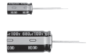

ALUMINUM ELECTROLYTIC CAPACITORS
UHE
Miniature Sized, Low Impedance,
High Reliability
Approved by Reliability Center for Electronic
Component, Japan-Certification No. RCJ-03-23C
Low impedance and high reliability withstanding 4000 hours to 10000 hours.
Compliant to the RoHS directive (2011/65/EU,(EU)2015/863).
Valued marked with an ※ in the dimension
table are scheduled to be discontinued and
are not recommended for new designs.
UHE
UHD
Long Life

Printed with white color letter on black sleeve.
Marking
※ I : Leakage Current (μA), C : Rated Capacitance (μF), V : Rated Voltage (V)
Radial Lead Type
