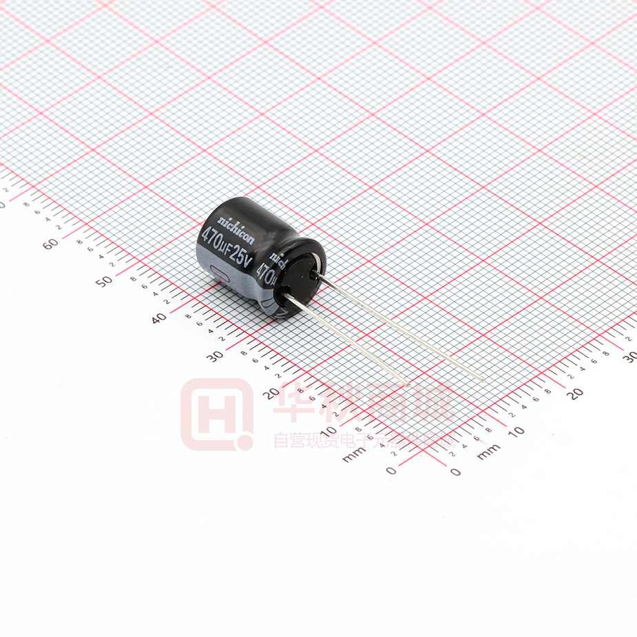

    插件,D10xL12.5mm
    直插铝电解电容 插件,D10xL12.5mm 470µF ±20% Ф10.00 x 12.50mm 25V 43mΩ 1.36A 6000Hrs@105℃
UHV1E471MPD 数据手册
ALUMINUM ELECTROLYTIC CAPACITORS UHV High Ripple Low Impedance Approved by Reliability Center for Electronic Component, Japan-Certification No. RCJ-03-23C Lower impedance at high frequency range. Smaller case size and high ripple current. Compliant to the RoHS directive (2011/65/EU,(EU)2015/863). UHD Valued marked with an ※ in the dimension table are scheduled to be discontinued and are not recommended for new designs. Smaller UHW UHV Long Life Specifications Performance Characteristics ltem Category Temperature Range –40 to +105˚C Rated Voltage Range 6.3 to 35V Rated Capacitance Range 47 to 8200µF Capacitance Tolerance ± 20% at 120Hz, 20˚C Leakage Current ※ After 2 minutes' application of rated voltage at 20°C, leakage current is not more than 0.01CV or 3 (µA), whichever is greater. Tangent of loss angle (tan δ) Rated voltage (V) 6.3 10 16 25 35 tan δ (max.) 0.21 0.18 0.15 0.13 0.11 120Hz 20˚C For capacitance of more than 1000µF, add 0.02 for every increase of 1000µF. 6.3 10 16 25 35 Z(–25˚C) / Z(+20˚C) 2 2 2 2 2 Z(–40˚C) / Z(+20˚C) 3 3 3 3 3 Rated voltage (V) Stability at Low Temperature Impedance ratio (max.) The specifications listed at right shall be met when the capacitors are restored to 20˚C after D.C. bias plus rated ripple current is applied for 6000 hours (5000 hours for φD=5 and 6.3) at 105˚C, the peak voltage shall not exceed the rated voltage. Endurance 120Hz Capacitance change Within ± 25% of the initial capacitance value (6.3V 10V : ± 30%) tan δ 200% or less than the initial specified value Leakage current Less than or equal to the initial specified value Printed with white color letter on black sleeve. Marking ※ I : Leakage Current (μA), C : Rated Capacitance (μF), V : Rated Voltage (V) Radial Lead Type Type numbering system (Example : 25V 150µF) φd Sleeve (PET) 1 2 3 4 5 6 7 8 9 10 11 12 P±0.5 φD +0.5max. U HV 1 E 1 5 1 M E D Pressure relief vent (φ6.3up) L± 15min. 4min. (mm) (L < 20) 1.5 (L 20) 2.0 φD 5 6.3 8 10 12.5 16 P 2.0 2.5 3.5 5.0 5.0 7.5 φd 0.5 0.5 0.6 0.6 0.6 0.8 Configuration φD Pb-free leadwire Pb-free PET sleeve 5 DD 6.3 8 · 10 12.5 · 16 ED PD HD  lease refer to the Guidelines for Aluminum Electrolytic Capacitors P for end seal configuration information. Frequency coefficient of rated ripple current Cap. (µF) Frequency 47 to 150 220 to 560 680 to 1800 2200 to 3900 4700 to 8200 120Hz 1kHz 10kHz 100kHz or more 0.40 0.50 0.60 0.75 0.85 0.75 0.85 0.87 0.90 0.95 0.90 0.94 0.95 0.95 0.98 1.00 1.00 1.00 1.00 1.00 Dimension table in next page. CAT.8100L ALUMINUM ELECTROLYTIC CAPACITORS UHV ■ Dimensions Rated Voltage (V) (code) Rated Capacitance (µF) 220 6.3 (0J) 10 (1A) Case Size φD×L(mm) tan δ 5× 11 0.21 Leakage Current (µA) at 20℃ after 2 minutes Impedance(Ω) max. Rated Ripple (mArms) (105℃/100kHz) Part Number 20℃/ 100kHz -10℃/ 100kHz 13.86 0.23 0.76 360 ※UHV0J221MDD ( ) 330 6.3×11 0.21 20.79 0.10 0.33 460 ※UHV0J331MED 470 6.3× 11 0.21 29.61 0.10 0.33 550 ※UHV0J471MED 680 8× 11.5 0.21 42.84 0.059 0.181 900  UHV0J681MPD 820 8× 11.5 0.21 51.66 0.059 0.181 990  UHV0J821MPD 1000 10×12.5 0.21 63 0.043 0.133 1250  UHV0J102MPD 1200 10×12.5 0.21 75.6 0.043 0.133 1360  UHV0J122MPD 1200 8× 15 0.21 75.6 0.046 0.143 1330  UHV0J122MPD6 1500 8× 20 0.21 94.5 0.031 0.105 1550  UHV0J152MPD 1800 10×16 0.21 113.4 0.030 0.095 1815  UHV0J182MPD 2200 10×20 0.23 138.6 0.019 0.057 2160  UHV0J222MPD 2700 10×25 0.23 170.1 0.017 0.051 2475  UHV0J272MPD 3300 12.5×20 0.25 207.9 0.016 0.041 2500  UHV0J332MHD 3900 12.5×20 0.25 245.7 0.016 0.041 2725  UHV0J392MHD 4700 12.5×25 0.27 296.1 0.014 0.036 3190  UHV0J472MHD 5600 12.5×30.5 0.29 352.8 0.012 0.031 3795  UHV0J562MHD 6800 12.5×35.5 0.31 428.4 0.011 0.029 3925  UHV0J682MHD 6800 16×20 0.31 428.4 0.014 0.036 3575  UHV0J682MHD6 8200 16×25 0.35 516.6 0.012 0.033 3990  UHV0J822MHD 150 5× 11 0.18 15 0.23 0.76 360 ※UHV1A151MDD 220 6.3×11 0.18 22 0.10 0.33 450 ※UHV1A221MED 330 6.3× 11 0.18 33 0.10 0.33 550 ※UHV1A331MED 470 8× 11.5 0.18 47 0.059 0.181 820  UHV1A471MPD 680 8× 11.5 0.18 68 0.059 0.181 990  UHV1A681MPD 820 10× 12.5 0.18 82 0.043 0.133 1250  UHV1A821MPD 1000 10× 12.5 0.18 100 0.043 0.133 1360  UHV1A102MPD 1000 8× 15 0.18 100 0.046 0.143 1330  UHV1A102MPD6 1200 10× 16 0.18 120 0.030 0.095 1650  UHV1A122MPD 1500 10× 16 0.18 150 0.030 0.095 1815  UHV1A152MPD 1500 8× 20 0.18 150 0.031 0.105 1550  UHV1A152MPD6 1800 10× 20 0.18 180 0.019 0.057 2160  UHV1A182MPD 2200 10× 25 0.20 220 0.017 0.051 2475  UHV1A222MPD 2700 12.5× 20 0.20 270 0.016 0.041 2475  UHV1A272MHD 3300 12.5× 20 0.22 330 0.016 0.041 2725  UHV1A332MHD 3900 12.5× 25 0.22 390 0.014 0.036 3190  UHV1A392MHD 4700 12.5× 30.5 0.24 470 0.012 0.031 3795  UHV1A472MHD 4700 16× 20 0.24 470 0.014 0.036 3575  UHV1A472MHD6 5600 12.5× 35.5 0.26 560 0.011 0.029 3975  UHV1A562MHD 6800 16 ×25 0.28 680 0.012 0.033 3990  UHV1A682MHD For cut leads, formed leads or taped parts, please add the appropriate code after the size code (12th digit ). If there is no size code in the part number, please add size code “1” and then add the appropriate code. CAT.8100L ALUMINUM ELECTROLYTIC CAPACITORS UHV ■ Dimensions Rated Voltage (V) (code) Rated Capacitance (µF) Case Size φD×L(mm) tan δ 100 5× 11 0.15 150 6.3× 11 220 6.3× 11 25 (1E) Impedance(Ω) max. Rated Ripple (mArms) (105℃/100kHz) Part Number 20℃/ 100kHz -10℃/ 100kHz 16 0.23 0.76 360 ※UHV1C101MDD 0.15 24 0.10 0.33 450 ※UHV1C151MED 0.15 35.2 0.10 0.33 550 ※UHV1C221MED 8× 11.5 0.15 52.8 0.059 0.181 830  UHV1C331MPD 470 8× 11.5 0.15 75.2 0.059 0.181 990  UHV1C471MPD 680 10×12.5 0.15 108.8 0.043 0.133 1360  UHV1C681MPD 680 8× 15 0.15 108.8 0.046 0.143 1330  UHV1C681MPD6 820 10× 16 0.15 131.2 0.030 0.095 1650  UHV1C821MPD 1000 10× 16 0.15 160 0.030 0.095 1815  UHV1C102MPD 1000 8× 20 0.15 160 0.031 0.105 1550  UHV1C102MPD6 1200 10× 20 0.15 192 0.019 0.057 1930  UHV1C122MPD 1500 10× 20 0.15 240 0.019 0.057 2160  UHV1C152MPD 1800 10× 25 0.15 288 0.017 0.051 2475  UHV1C182MPD 2200 12.5× 20 0.17 352 0.016 0.041 2725  UHV1C222MHD 2700 12.5× 25 0.17 432 0.014 0.036 3190  UHV1C272MHD 3300 12.5× 30.5 0.19 528 0.012 0.031 3795  UHV1C332MHD 3300 16× 20 0.19 528 0.014 0.036 3575  UHV1C332MHD6 3900 12.5× 35.5 0.19 624 0.011 0.029 3925  UHV1C392MHD 4700 16×25 0.21 752 0.012 0.033 3990  UHV1C472MHD 330 16 (1C) Leakage Current (µA) at 20℃ after 2 minutes ( ) 68 5× 11 0.13 17 0.23 0.76 360 ※UHV1E680MDD 100 6.3× 11 0.13 25 0.10 0.33 450 ※UHV1E101MED 150 6.3× 11 0.13 37.5 0.10 0.33 550 ※UHV1E151MED 220 8× 11.5 0.13 55 0.059 0.181 810  UHV1E221MPD 270 8× 11.5 0.13 67.5 0.059 0.181 900  UHV1E271MPD 330 8× 11.5 0.13 82.5 0.059 0.181 990  UHV1E331MPD 390 8× 15 0.13 97.5 0.046 0.143 1330  UHV1E391MPD 470 10×12.5 0.13 117.5 0.043 0.133 1360  UHV1E471MPD 560 8× 20 0.13 140 0.031 0.105 1550  UHV1E561MPD 680 10×16 0.13 170 0.030 0.095 1815  UHV1E681MPD 820 10×20 0.13 205 0.019 0.057 2160  UHV1E821MPD 1000 10× 25 0.13 250 0.017 0.051 2475  UHV1E102MPD 1200 12.5× 20 0.13 300 0.016 0.041 2475  UHV1E122MHD 1500 12.5× 20 0.13 375 0.016 0.041 2725  UHV1E152MHD 1800 12.5× 25 0.13 450 0.014 0.036 3190  UHV1E182MHD 2200 12.5× 30.5 0.15 550 0.012 0.031 3795  UHV1E222MHD 2200 16× 20 0.15 550 0.014 0.036 3575  UHV1E222MHD6 2700 12.5×35.5 0.15 675 0.011 0.029 3925  UHV1E272MHD 3300 16× 25 0.17 825 0.012 0.033 3990  UHV1E332MHD For cut leads, formed leads or taped parts, please add the appropriate code after the size code (12th digit ). If there is no size code in the part number, please add size code “1” and then add the appropriate code. CAT.8100L ALUMINUM ELECTROLYTIC CAPACITORS UHV ■ Dimensions Rated Voltage (V) (code) 35 (1V) Rated Capacitance (µF) Impedance(Ω) max. Leakage Current (µA) at 20℃ after 2 minutes 20℃/ 100kHz -10℃/ 100kHz 0.11 16.45 0.23 6.3× 11 0.11 23.8 6.3× 11 0.11 35 Case Size φD×L(mm) tan δ 47 5× 11 68 100 ( ) Rated Ripple (mArms) (105℃/100kHz) Part Number 0.76 360 ※UHV1V470MDD 0.10 0.33 450 ※UHV1V680MED 0.10 0.33 550 ※UHV1V101MED 150 8× 11.5 0.11 52.5 0.059 0.181 820  UHV1V151MPD 220 8× 11.5 0.11 77 0.059 0.181 990  UHV1V221MPD 270 8× 15 0.11 94.5 0.046 0.143 1330  UHV1V271MPD 330 10×12.5 0.11 115.5 0.043 0.133 1360  UHV1V331MPD 390 8× 20 0.11 136.5 0.031 0.105 1550  UHV1V391MPD 470 10× 16 0.11 164.5 0.030 0.095 1815  UHV1V471MPD 560 10× 20 0.11 196 0.019 0.057 2160  UHV1V561MPD 680 10× 25 0.11 238 0.017 0.051 2475  UHV1V681MPD 820 12.5× 20 0.11 287 0.016 0.041 2725  UHV1V821MHD 1000 12.5× 20 0.11 350 0.016 0.041 2920  UHV1V102MHD 1200 12.5× 25 0.11 420 0.014 0.041 3190  UHV1V122MHD 1500 12.5× 30.5 0.11 525 0.012 0.031 3795  UHV1V152MHD 1500 16× 20 0.11 525 0.014 0.036 3575  UHV1V152MHD6 1800 12.5×35.5 0.11 630 0.011 0.029 3925  UHV1V182MHD 2200 16× 25 0.13 770 0.012 0.033 3990  UHV1V222MHD For cut leads, formed leads or taped parts, please add the appropriate code after the size code (12th digit ). If there is no size code in the part number, please add size code “1” and then add the appropriate code. For formed lead or taped product specifications and minimum order quantity, please refer to the Guidelines for Aluminum Electrolytic Capacitors. CAT.8100L
